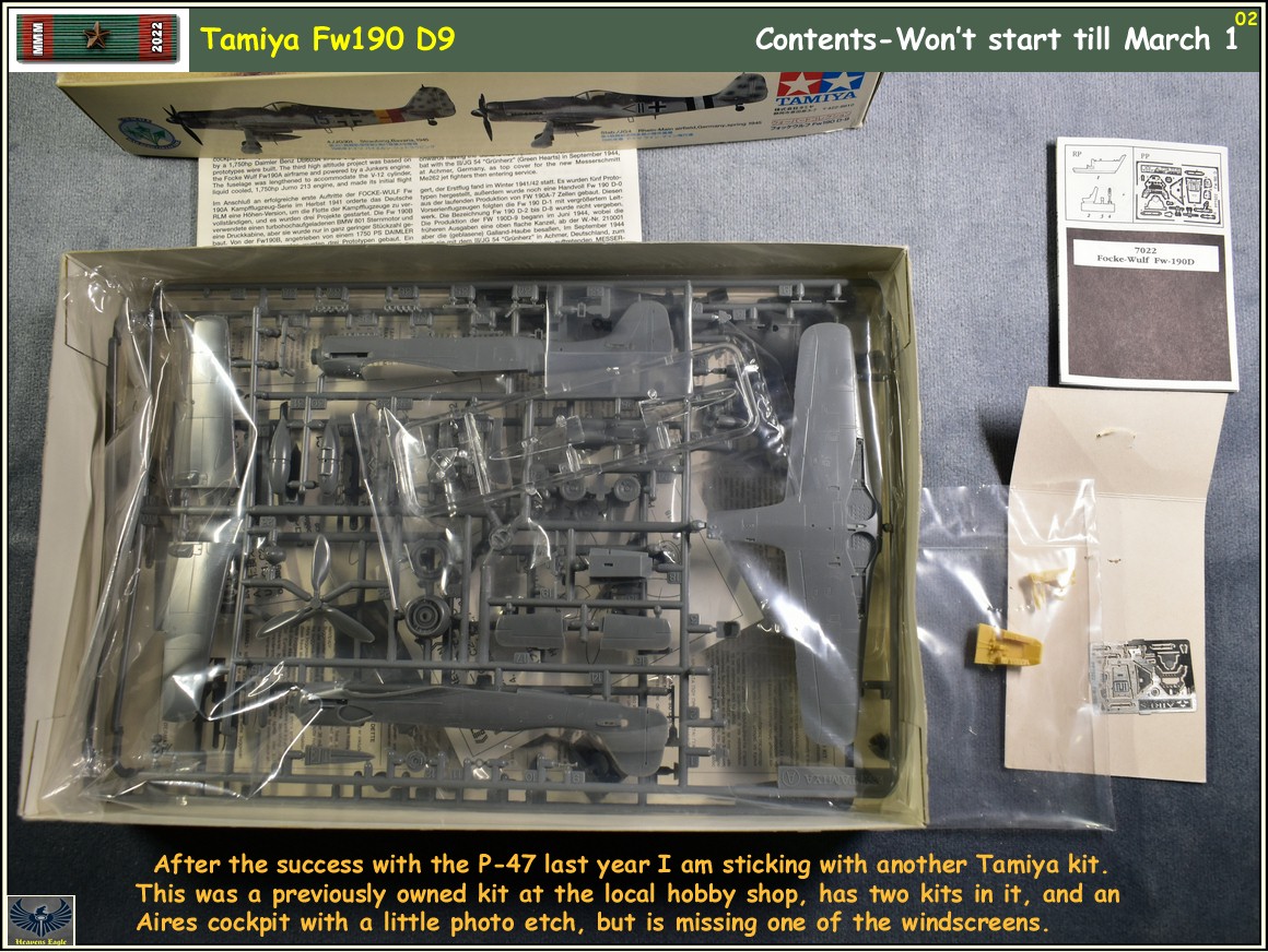

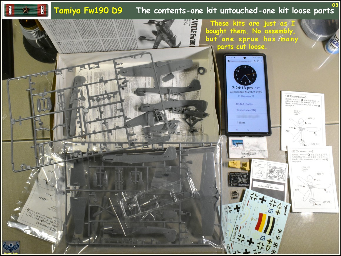

This is my build for this year. I had such a good build with the Tamiya P-47 last year that I chose this one a couple of weeks ago while in the Hobby Shop. This was a previously owned kit and actually has "almost" two full kits in it. Alas one of the windscreens is missing So that would have to be scratch built for the second kit (when/if built) I will worry about that at a later date.
Here are the two place holder photos and I will do a formal start photo March 1st.

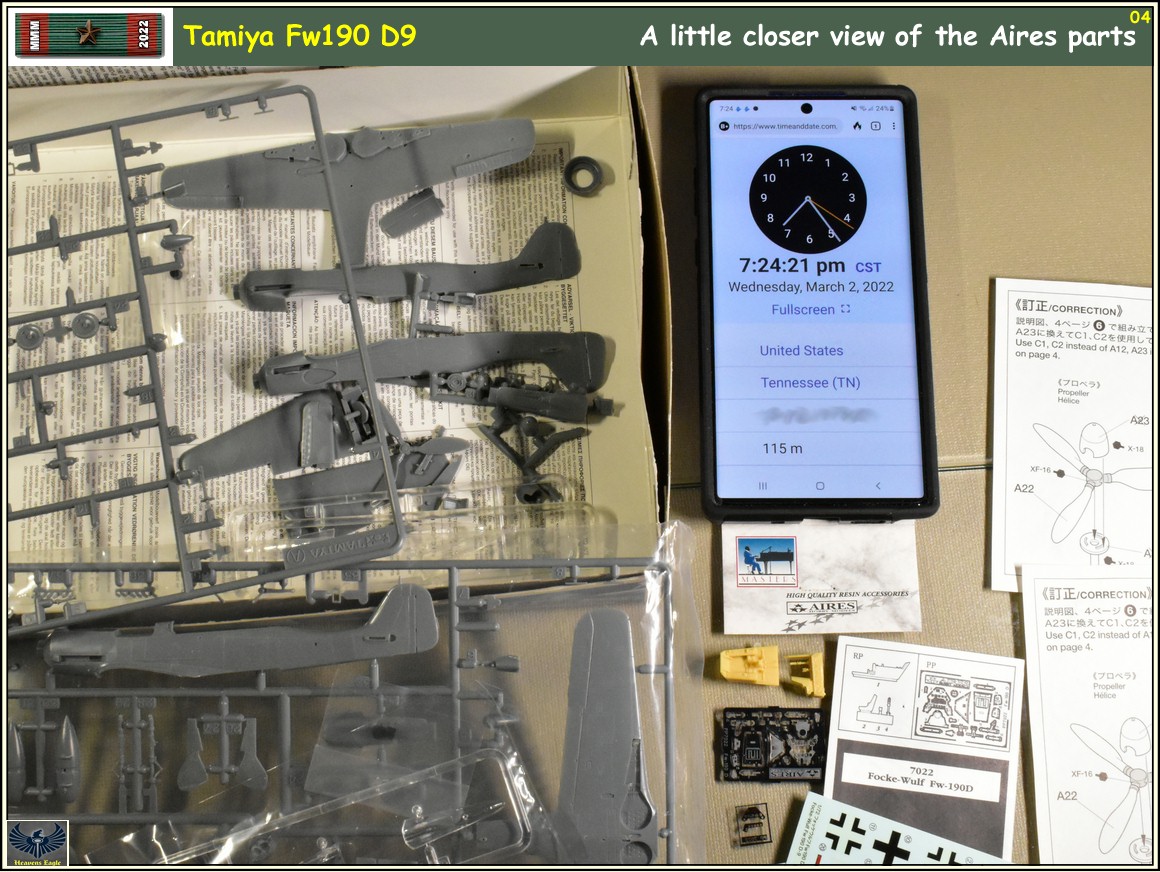

I will be using the Aires resin cockpit and photo etch as well. Shouldn't be too much extra work. Plus I have at least one minor mod and maybe a second one. We will see when the time comes.
Aires resin cockpit in 1/72 is a challenge to put it mildly , go for it Paul, I cant wait :)

OK, here is the launch photos. I might go in and do some build work tonight yet. Played around with the turbine airbrush last night a little. Might use it on some of the camo on this, but will wait and see.
As I said this box had "almost" 2 full kits in it. One is still in the bag and is all there. The other had many of the parts cut loose and all the colored parts were still there. There are also 2 extra clear sprues with the sliding canopy parts, but alas no extra windscreen. As that part is 3 flat pieces that are angled, I might scratch build it for grins. We will see how it all flows.

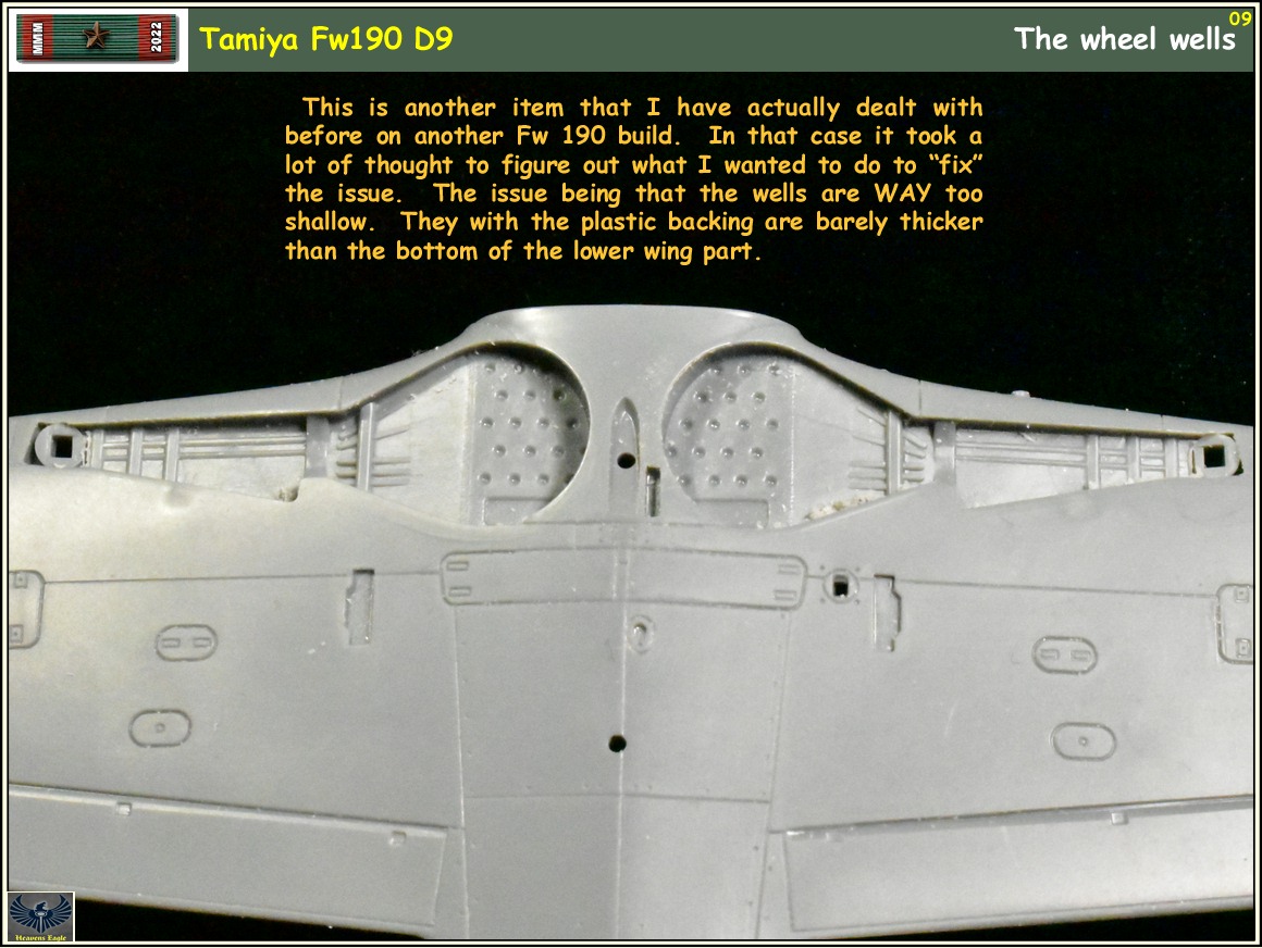

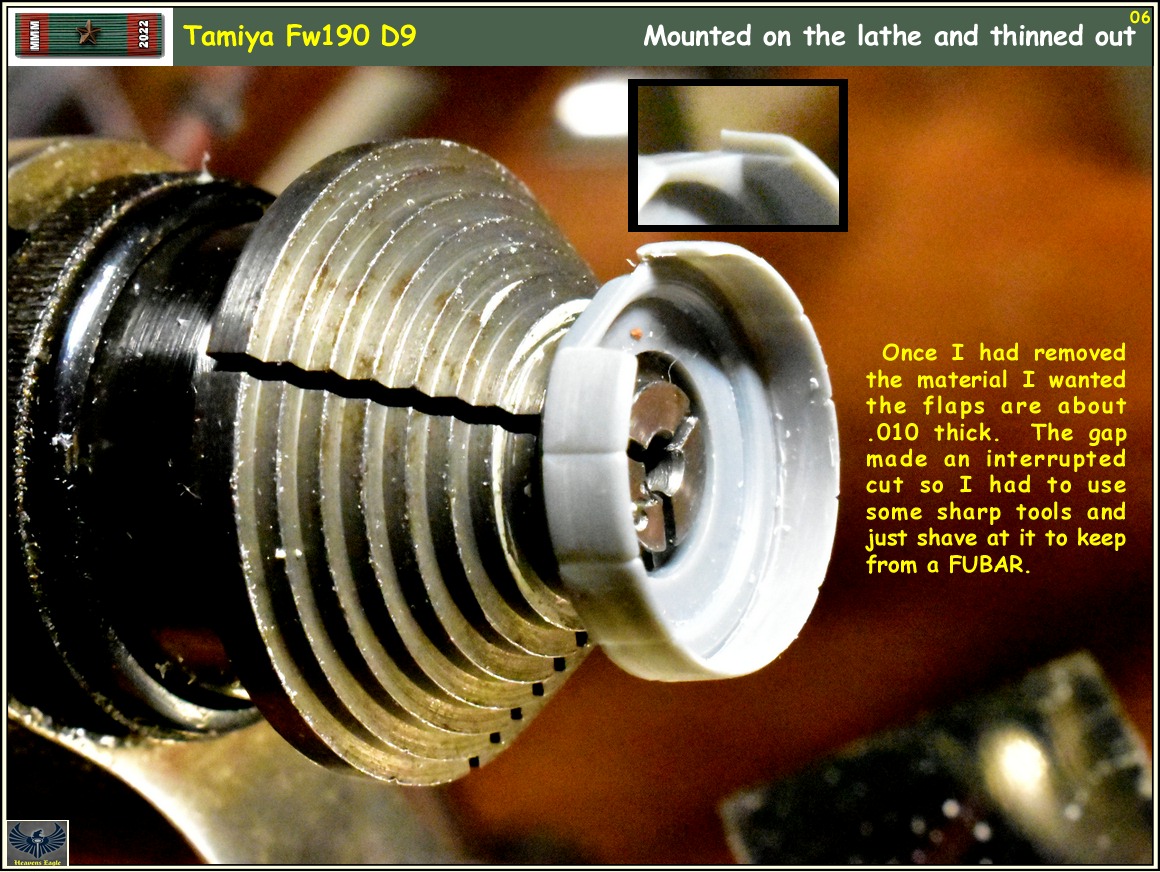

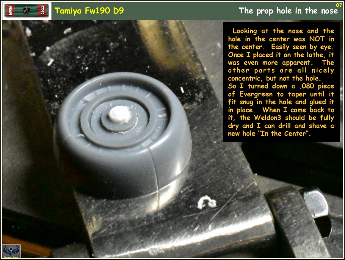

Here is a quick update what I did tonight. Had been thinking about this so it all went fairly quickly. As it is a Tamiya, I expect it to at least have some what of a decent fit. Here is the first update.
Do all the parts mods and then assemble. Looks like the Aires cockpit should fit fairly well though it looks a bit different than the kit one.
