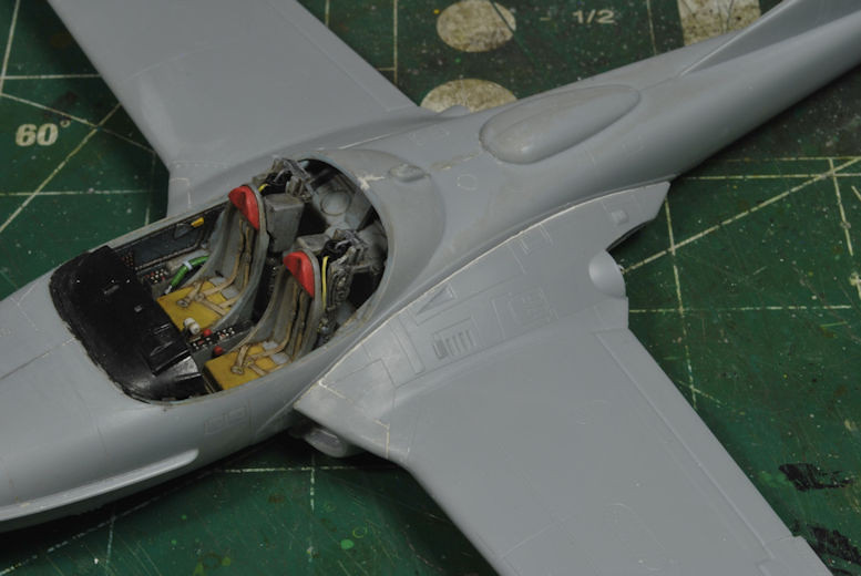

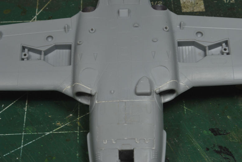

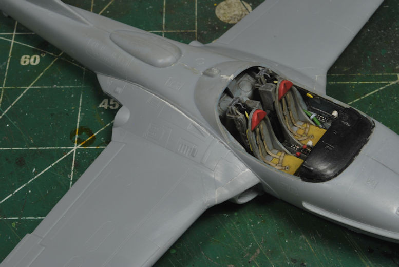

As often happens, I thought I had taken photos of the difficult areas when fitting the wings to this fuselage, but nope, sorry. I believe it was a case of the memory card not registering and I was snapping away, unawares, oops. I know there are a few who have this kit, so I wanted to show what difficulties I ran into, but I’ll mention them now.
The engine intakes, according to the instructions, are secured in place as well as the exhaust nozzle, just before the fuselage goes on, but be prepared to sand the sides of the intakes. I spent quite a bit of time sanding down the inner portions of each intake, plus I sanded the bottom of the cockpit tub, and trimmed the fuselage sides not visible once the wings are attached. When attaching the wings you will notice a gap up front, or in back, whichever end gets placed first. Using a bright light, you will see inside how the intakes and sides of the fuselage interfere with the assembly, then get to work sanding. I stopped numerous times to check the fit, but back to sanding I went. Plan on a lot, it was several sessions worth, btw.
Once I felt I was close enough and ran 500 test fits, seems like it, I ran a bead of super Glue and put it together. Naturally, when you’ve got wet glue it wigs out on you and the fit jacks all ta heck, then you fight it before it’s permanent. There will be a gap up top along the wing root, but none to speak of below. After dropping some glue into the gap and compressing the pieces together for a minute or so, I ran a small bead of Testors tube putty and pressed it in and cleaned up the mess. There is some touch up to do, but not much.
The intake trim was not exactly sized correctly, so plan on clean-up there as well. Once you’ve got them where you can work them over it’s just a matter of careful sanding to avoid wiping out the panel details.
There is one more final issue I was consistently running into, and completely avoidable, and that was the cockpit dashboard kept getting popped off because of where I was gripping the fuselage when working on the underside. It’s in an odd spot for holding the fuselage when you’re working on it, so be aware of that.
