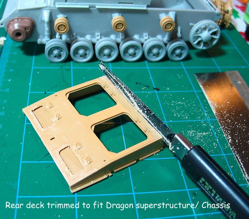

Progress update
Holidays are wonderful - I can actually get some models built with all this time.

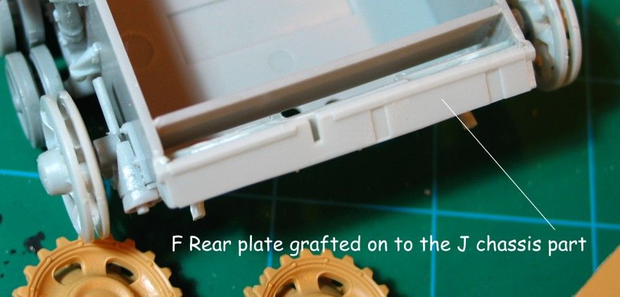

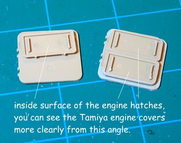

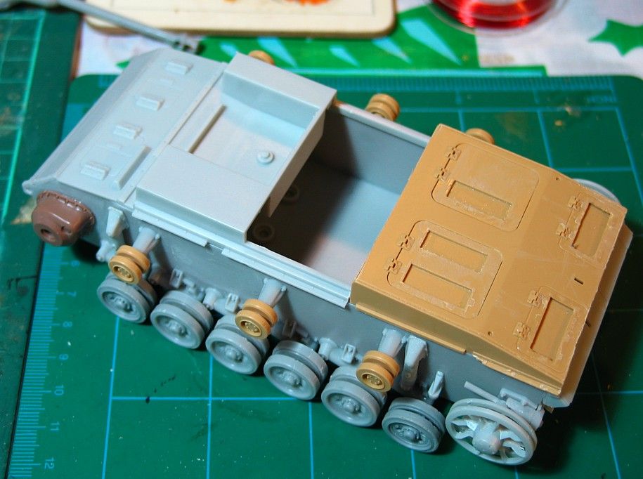

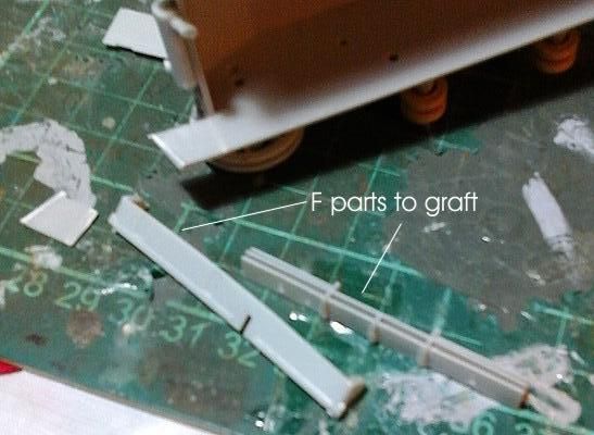

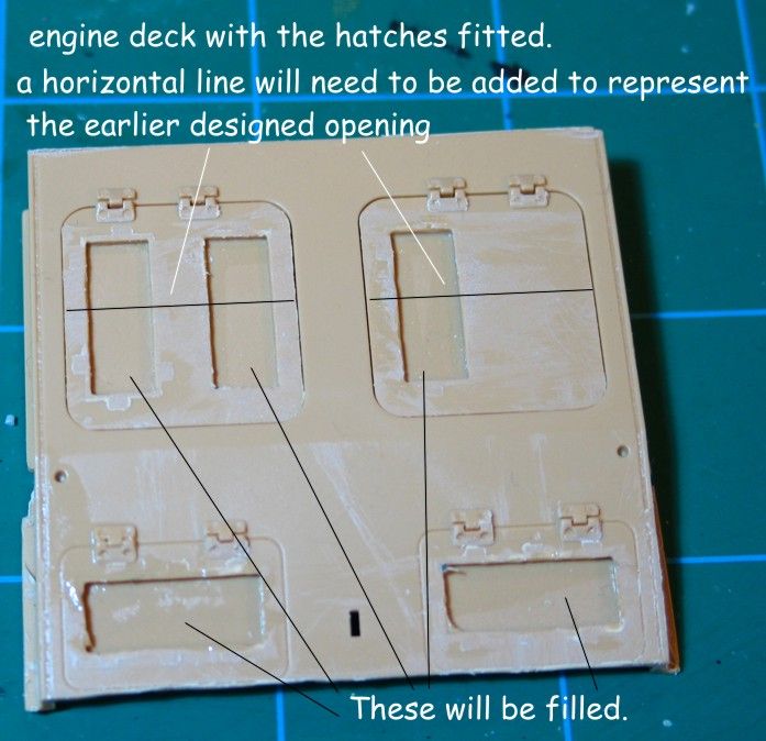

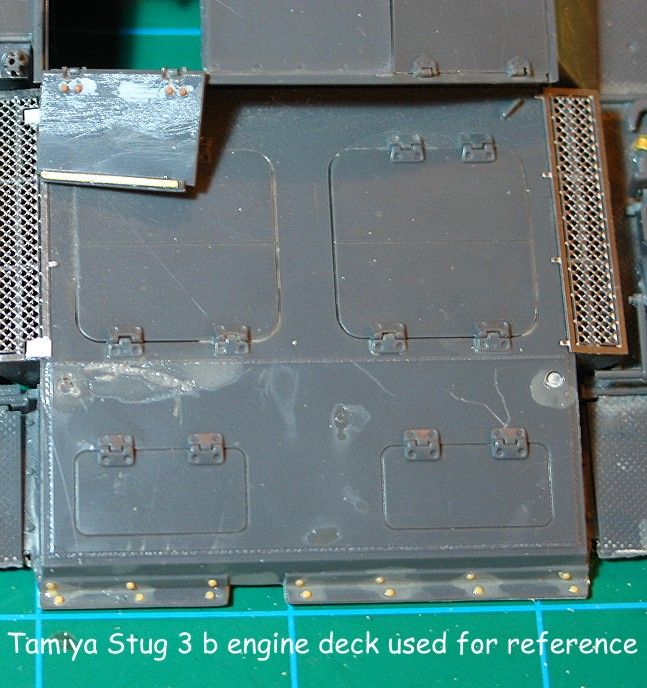

I have had my eye on a weird C/D model waiting for the right time, and this seems to be it.
April 1945 East Prussia (Speilberger stug 3) I also found the same tank in a photo from another angle in another ref (Tank Power Vol. 14)
Obviously something strange -C/D model with a Saukopf mantlet 75mm gun mounted.

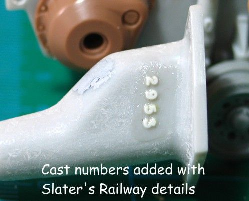

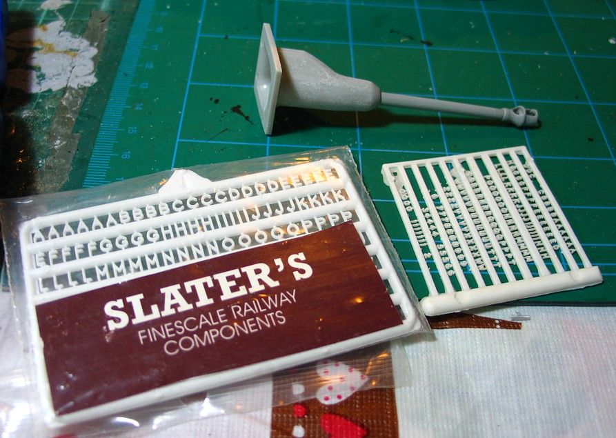

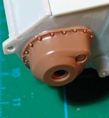

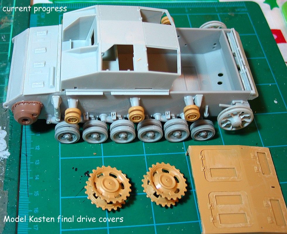

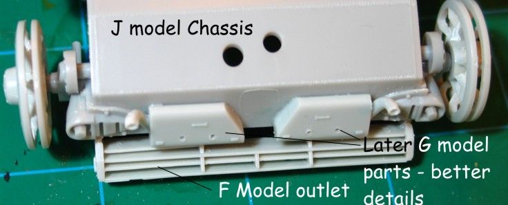

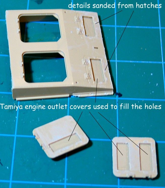

I began the many 'mods' I needed to make this one a runner as a C/D model
Now to start the 'mini' mods as well
Totaly awesome detail, excellent work Ian :ro: The effect with the casting number is superb!
