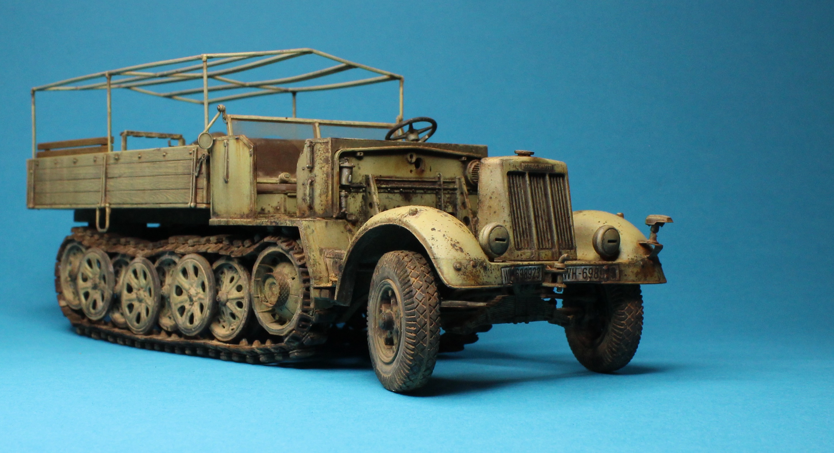

For the Trumpeter kit I'm going to copy the factory fresh example in plain Dunky yellow. It requires some smaller 'late' type headlights, a resin set of front wheels, and a few other visual improvements

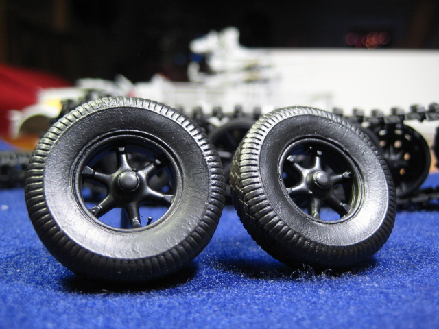

The front wheels look a lot like the ones included in the Dragon kit, for those that don't mind their DS100 (but I do as sometimes it is unstable).
@AndyFettes used them in his build but he also had trouble.
The Trumpeter wheels are plastic but the tyres are fully DS. I didnt paint over the rubber on my original fifteen year old build, I just weathered them with pigments and it still wears them without melting any styrene. They they do look to be of better quality compared to the melting qualities of some other brands 'rubber' tyres.
The tread pattern is also authentic and no clean up is necerssary. Its just I think that some resin alternatives can look better.
The dragon 8 ton kits offer a strange 2/3rds rubber tyre with the rear portion remaining in styrene leaving a noticable gap. I have never used these on a completed build.
