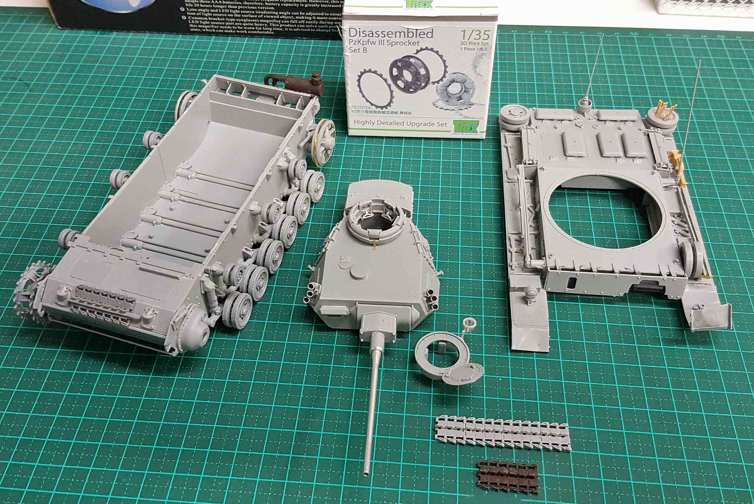

THE MODEL

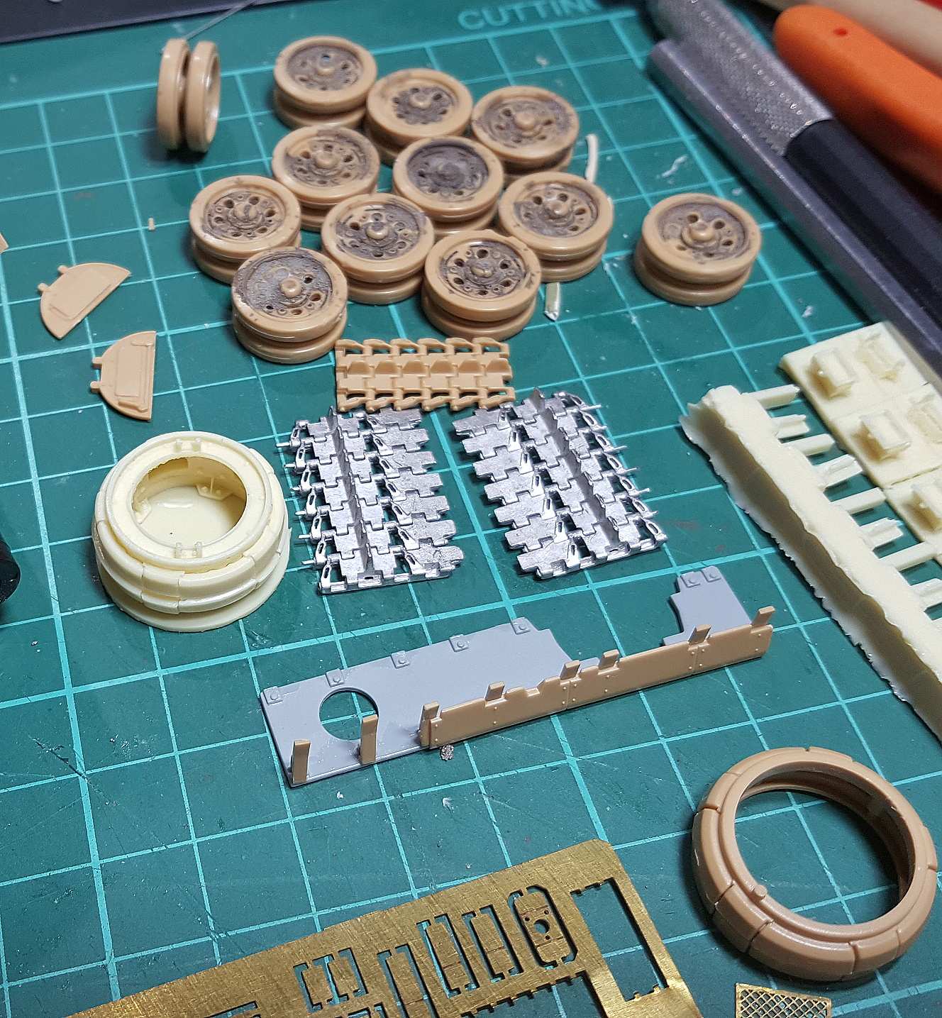

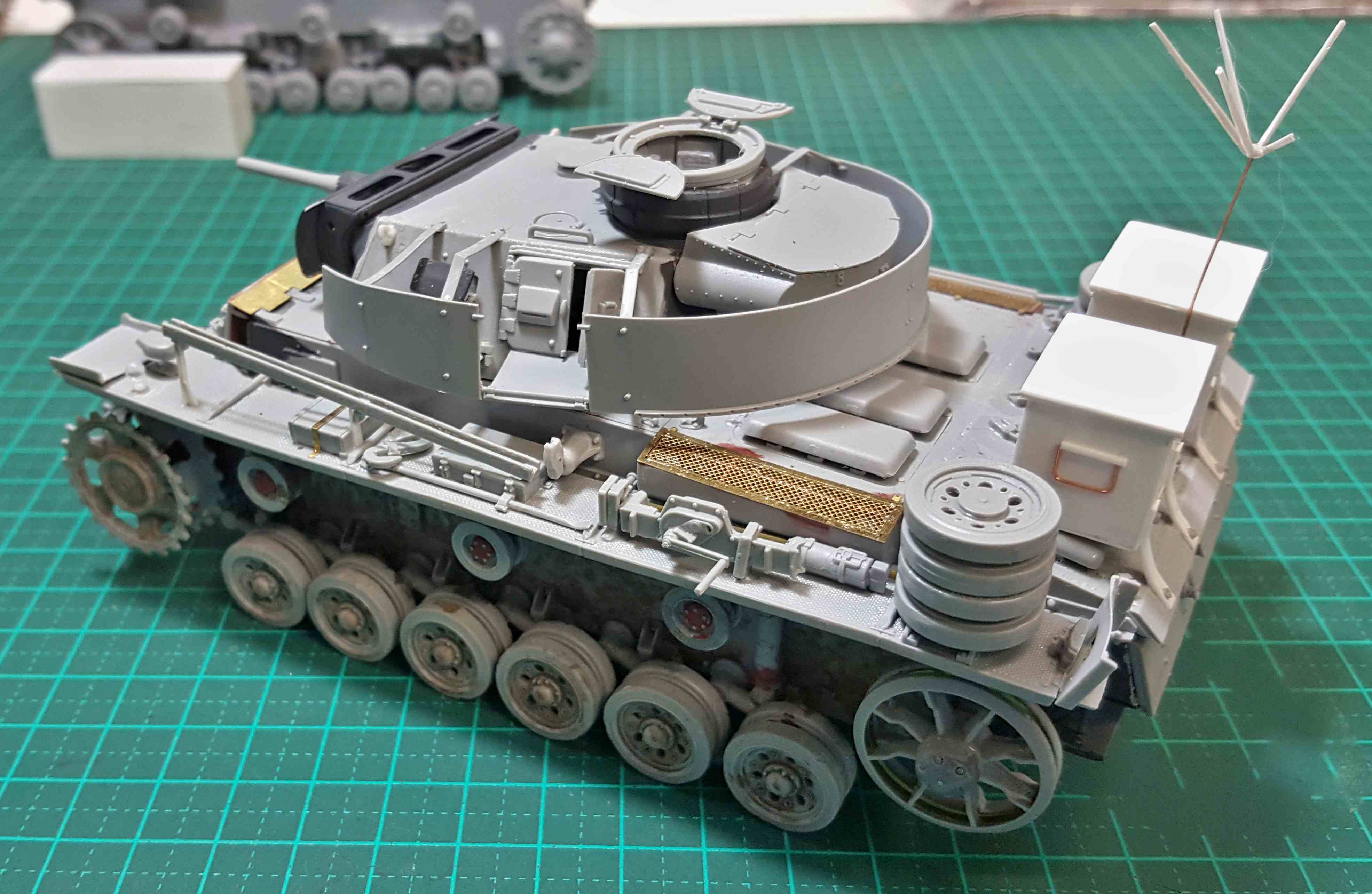

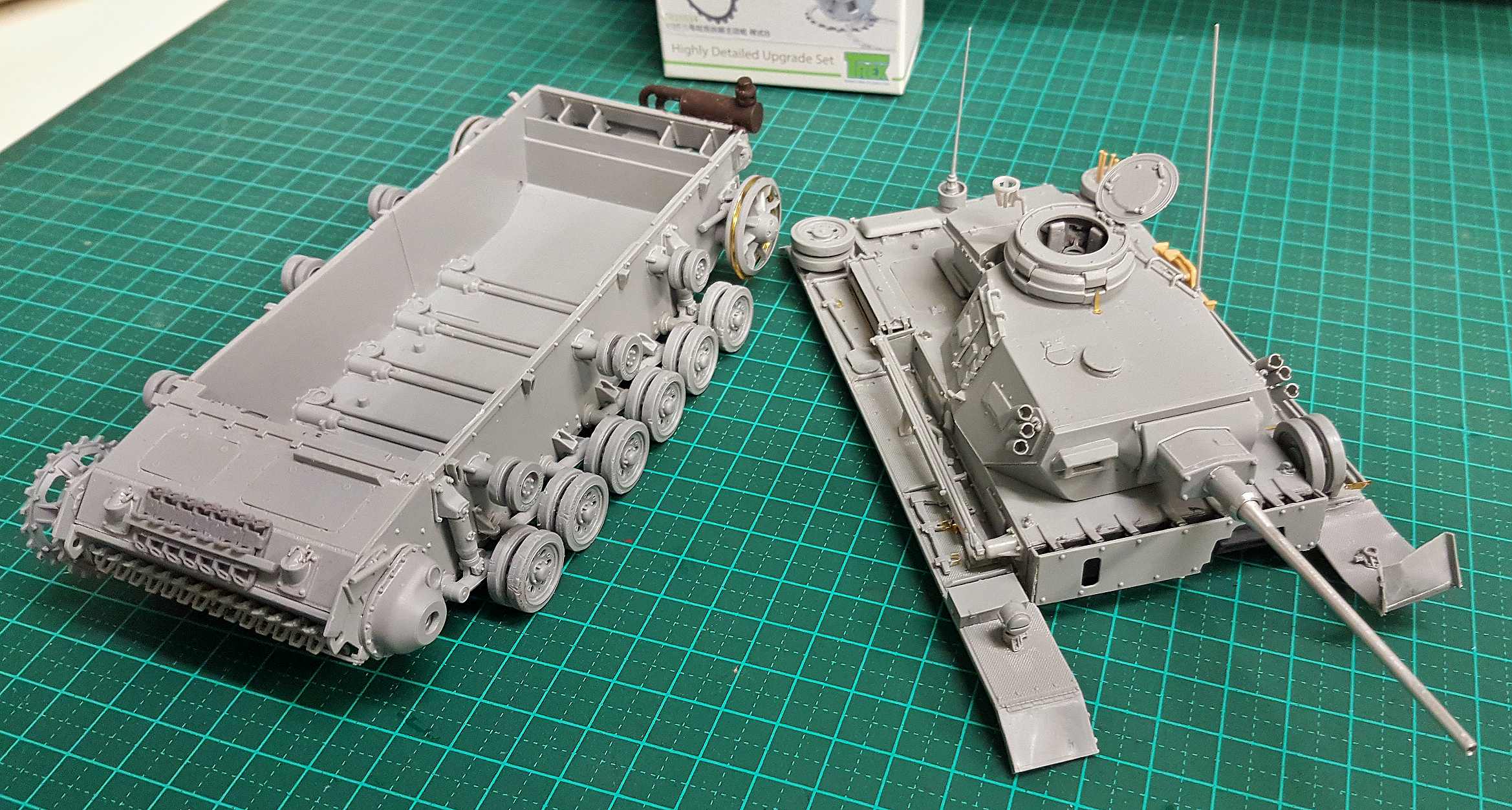

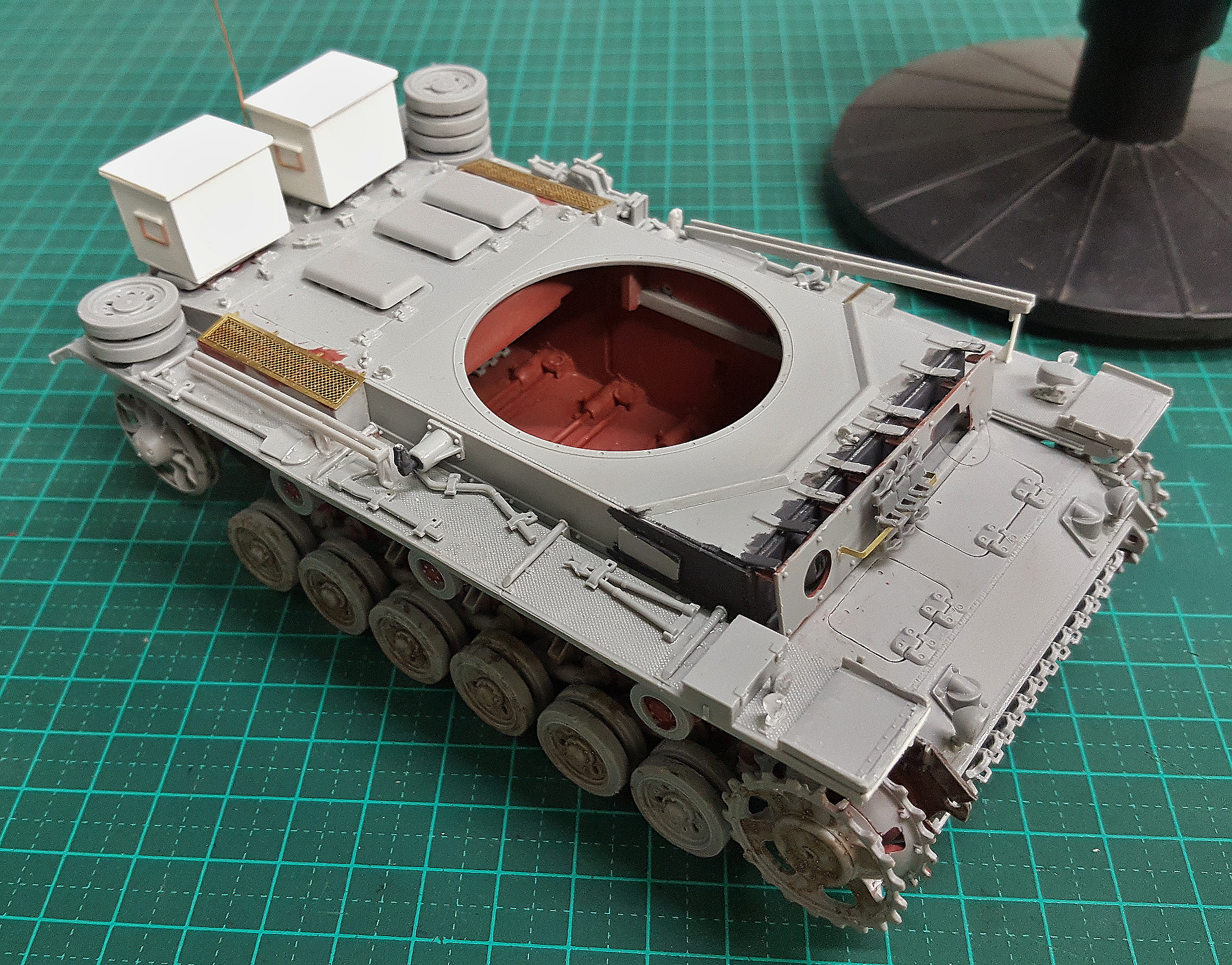

Here are the completed parts as per their assemblies.
The metal tracks were for an earlier model, so I ended up keeping them for either the E, F or G.

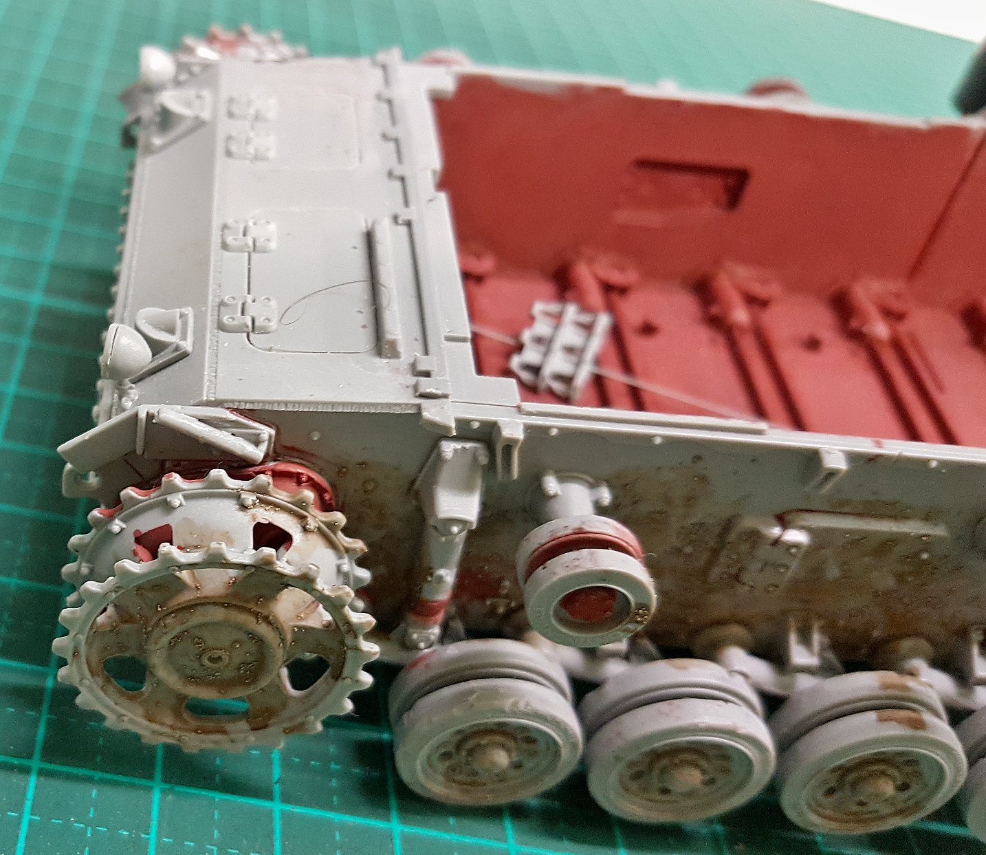

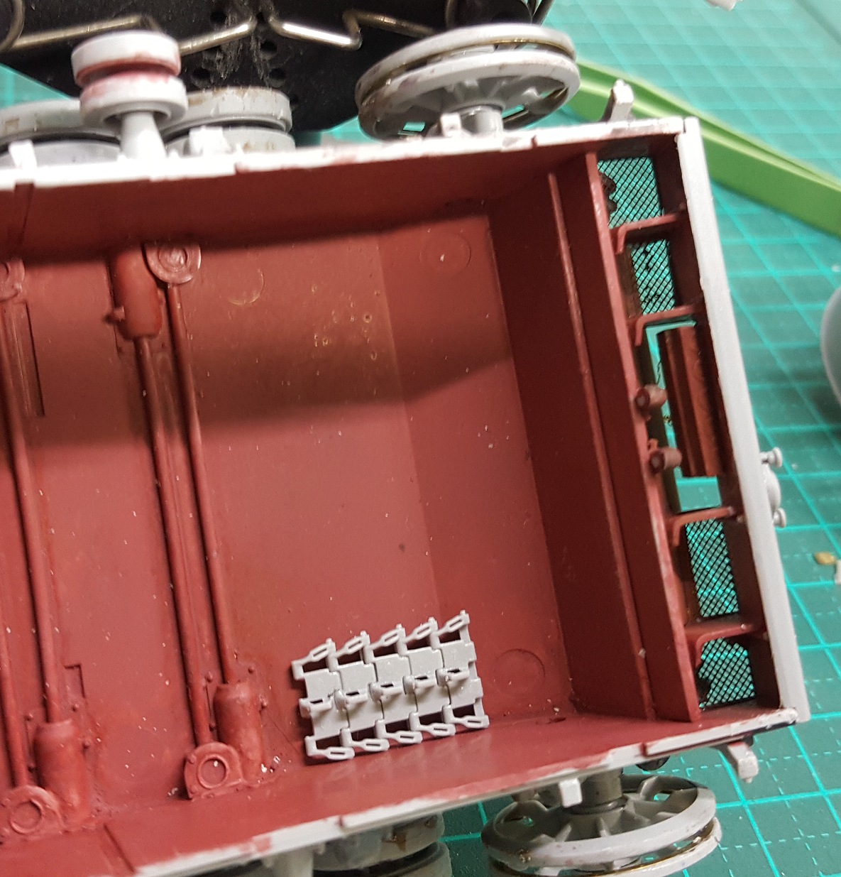

I painted the red primer on the interior just as a base coat and 'ratted' the command antenna and its 'armoured pot' base from my old pzr3 K kit from the late 90's.
The kit will stay like this until the tracks can be attached and painted.

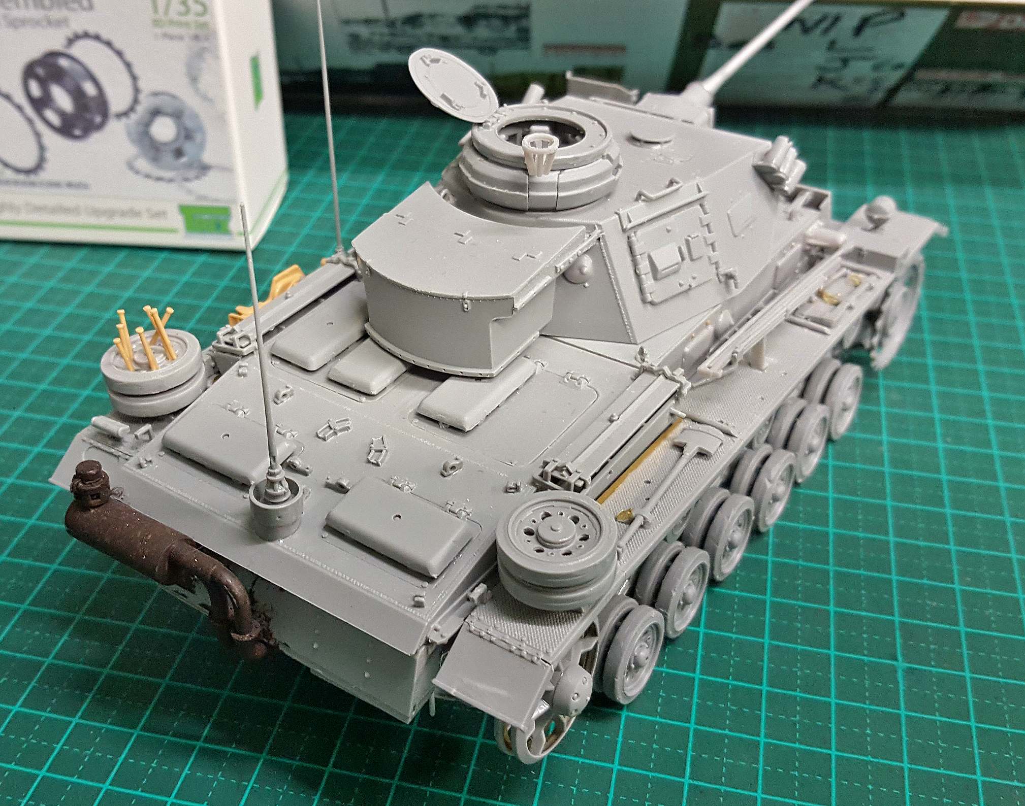

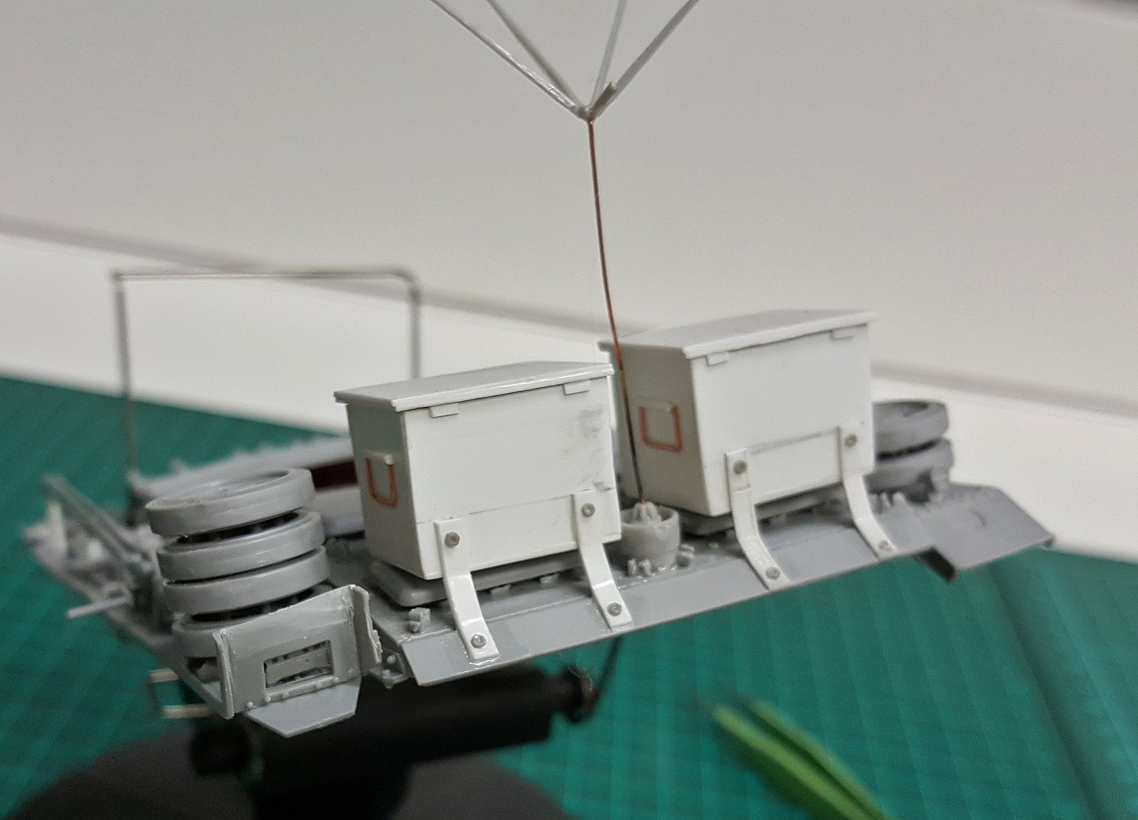

Notice the twin ariels and rear star antenna of the command version.

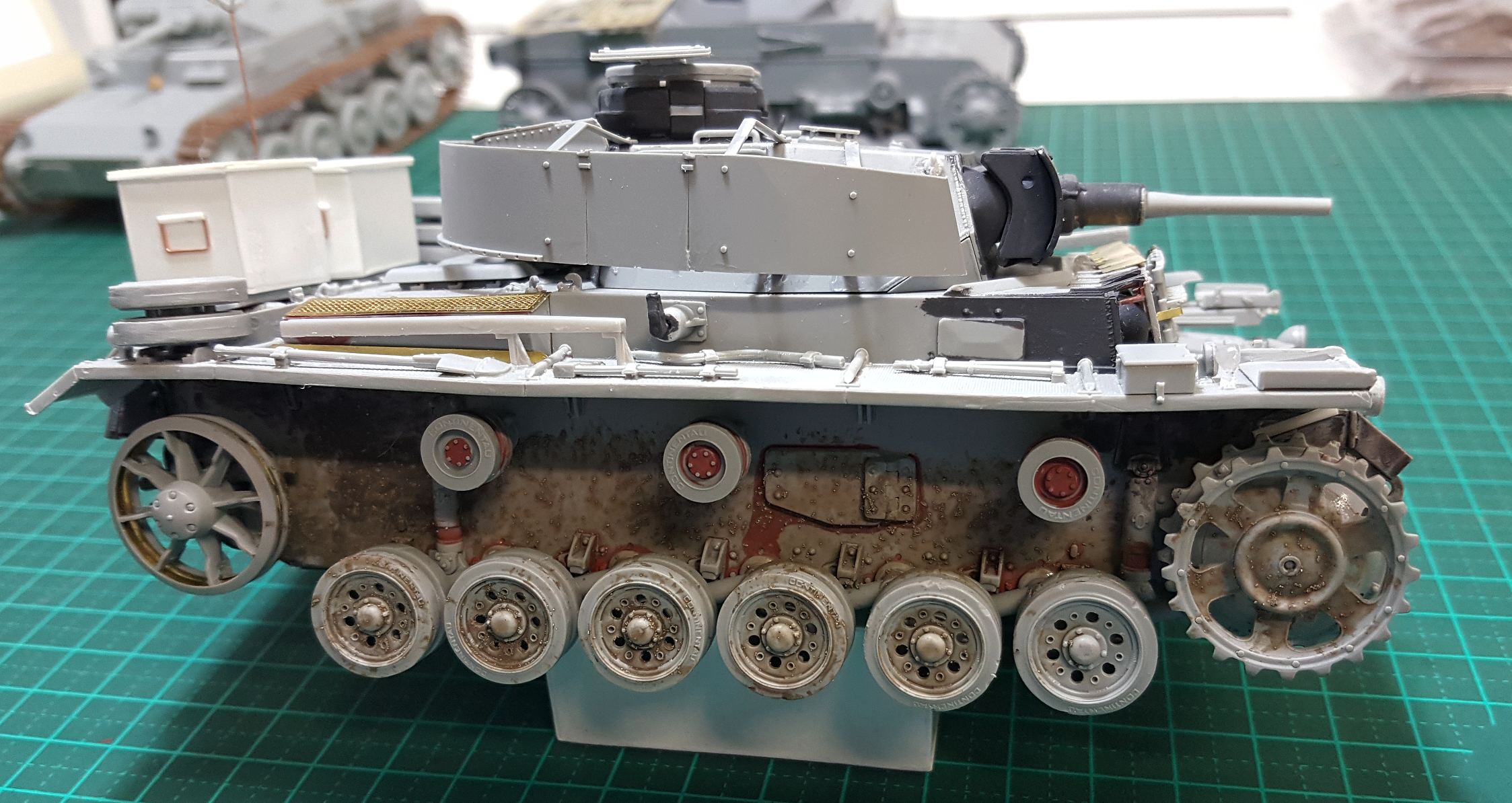

The stowage boxes were made from sheet plastic and the nuts from an old Grant line set for trains. I used copper wire for the grab handles. The antenna length was made from copper wire also.

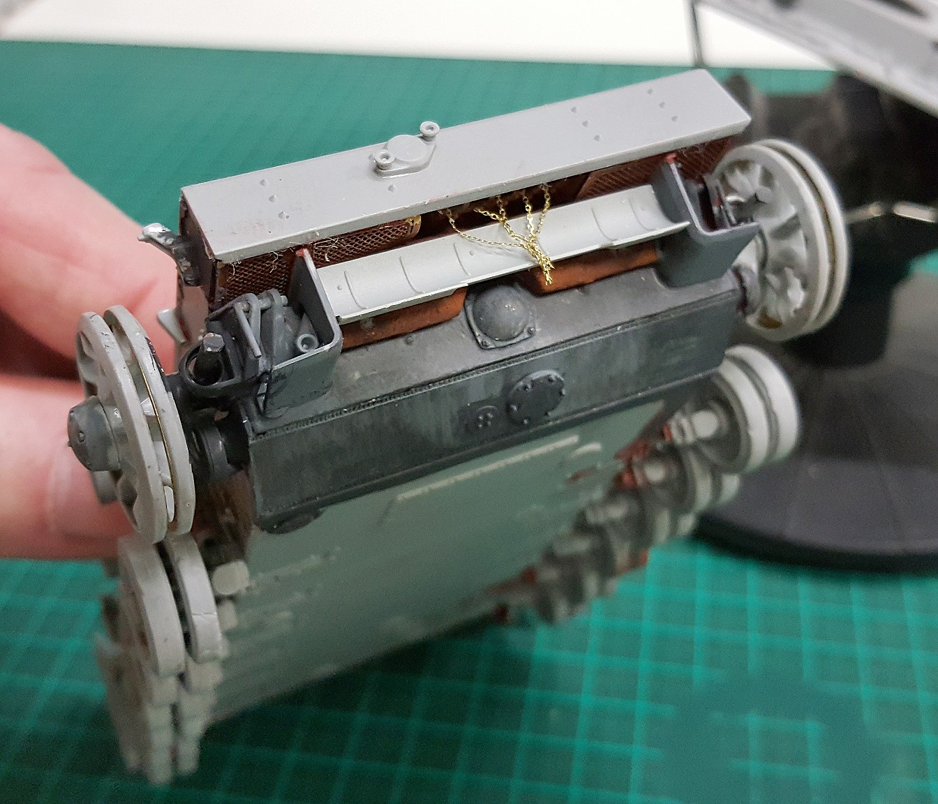

The chassis details are very crisp and clean on this kit with lots of details.

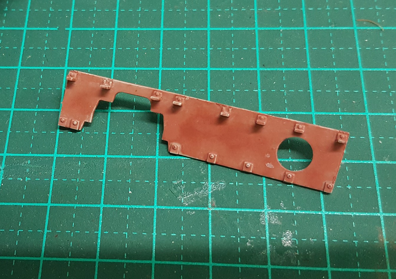

The Vorpanzer spaced armour sheet on the front was painted red primer on the back and the opposing original mantlet in grey, as per the rest of the tank. The top sheet is provided as PE. I figured that the side facing the tank would not have got the grey coat as the tank was painted before the Vorpanzer was fitted.
The back side of the Vorpanzer plate even has top and bottom bolt details for attaching to the front plate.

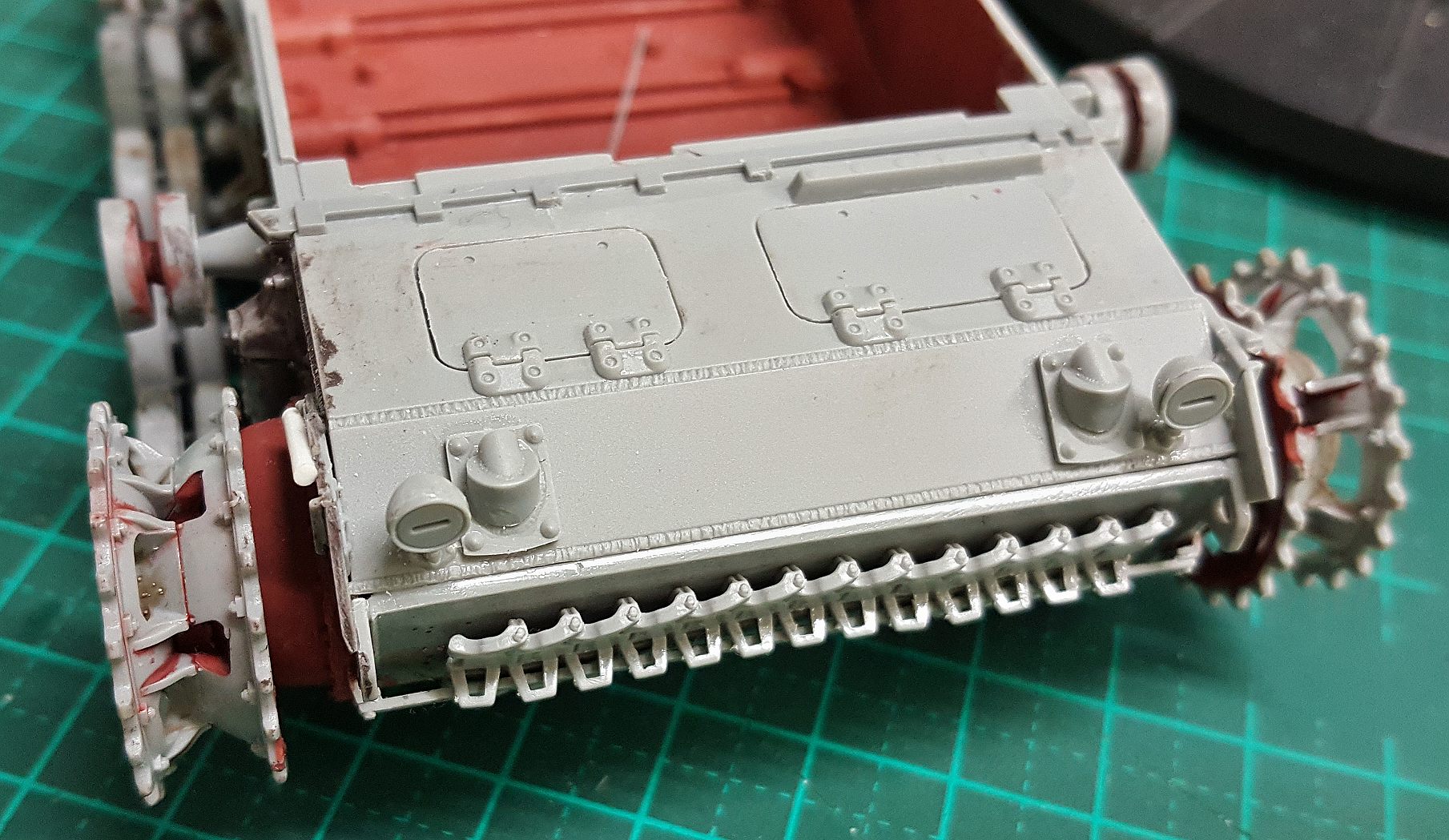

The rear has the late cooling outlet shields and PE chains for the smoke candles.

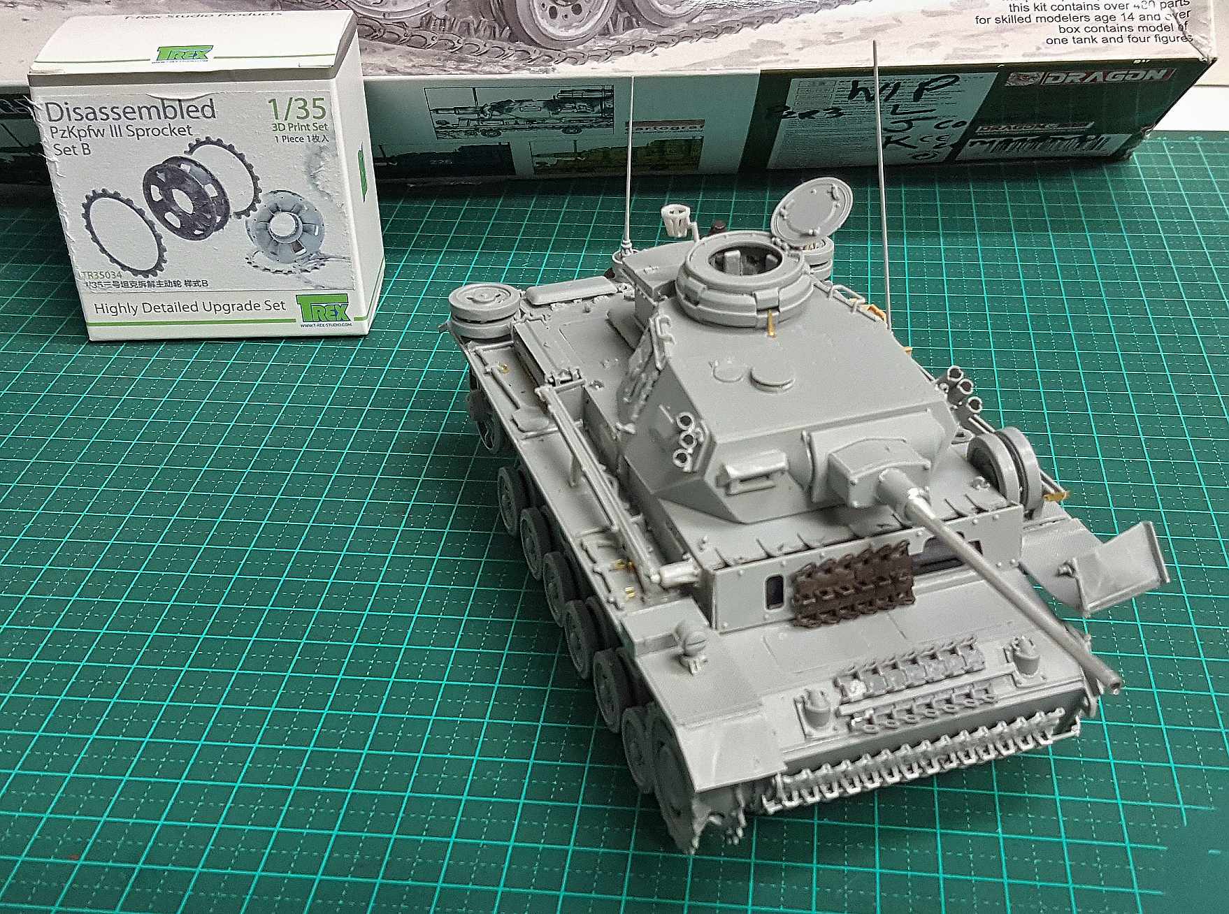

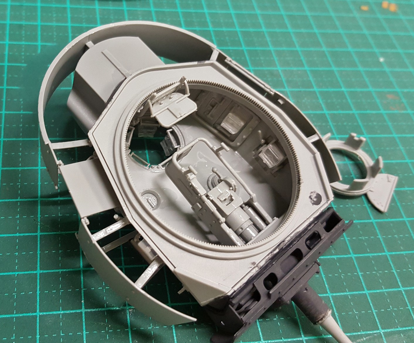

The turret has some hatches open, so I am still creating enough interior to see through the opening. The turret shield armour is very nice and scaled well, except that fitting them can be a little tricky.
The model is nearly complete except for some small final detals such as the tracks and some small interior parts. The tank assembly parts are still not attached, as seen in the first photo but that will be done once the tracks are completed and painted.

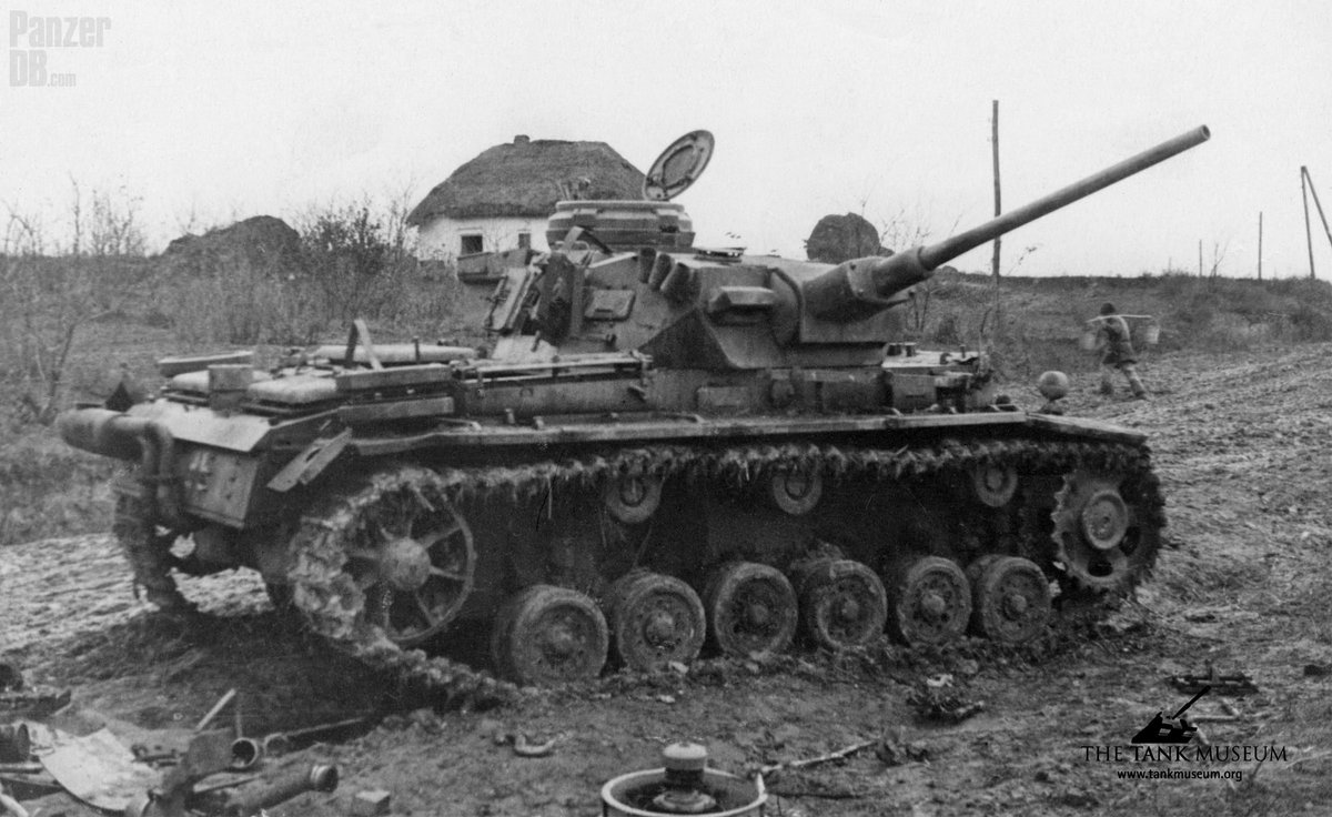

Vehicle at Stalingrad
A rare picture of one of the test vehicles with track guard mounted S-Mine launchers in Mid 1942.

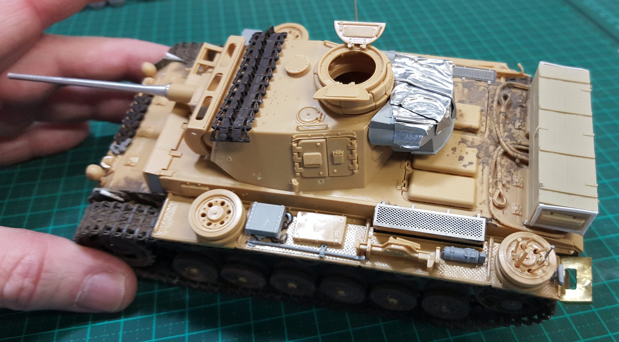

This Kit still stands up nicely and is a simple but accurate model, that is over a third of the price of a Dragon kit. This one is perfect for a weekend build as it goes together like a dream without any 'fiddly' components. It's also a great platform for adding extra after-market products.

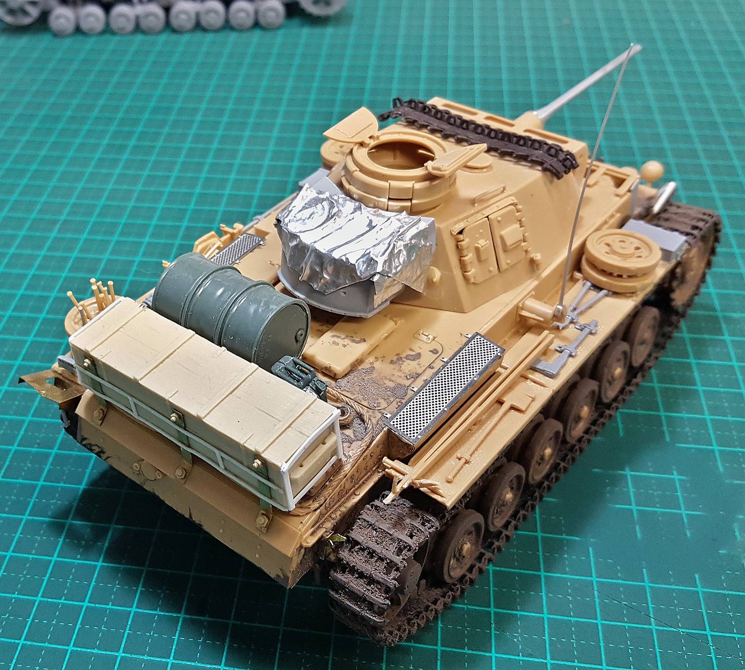

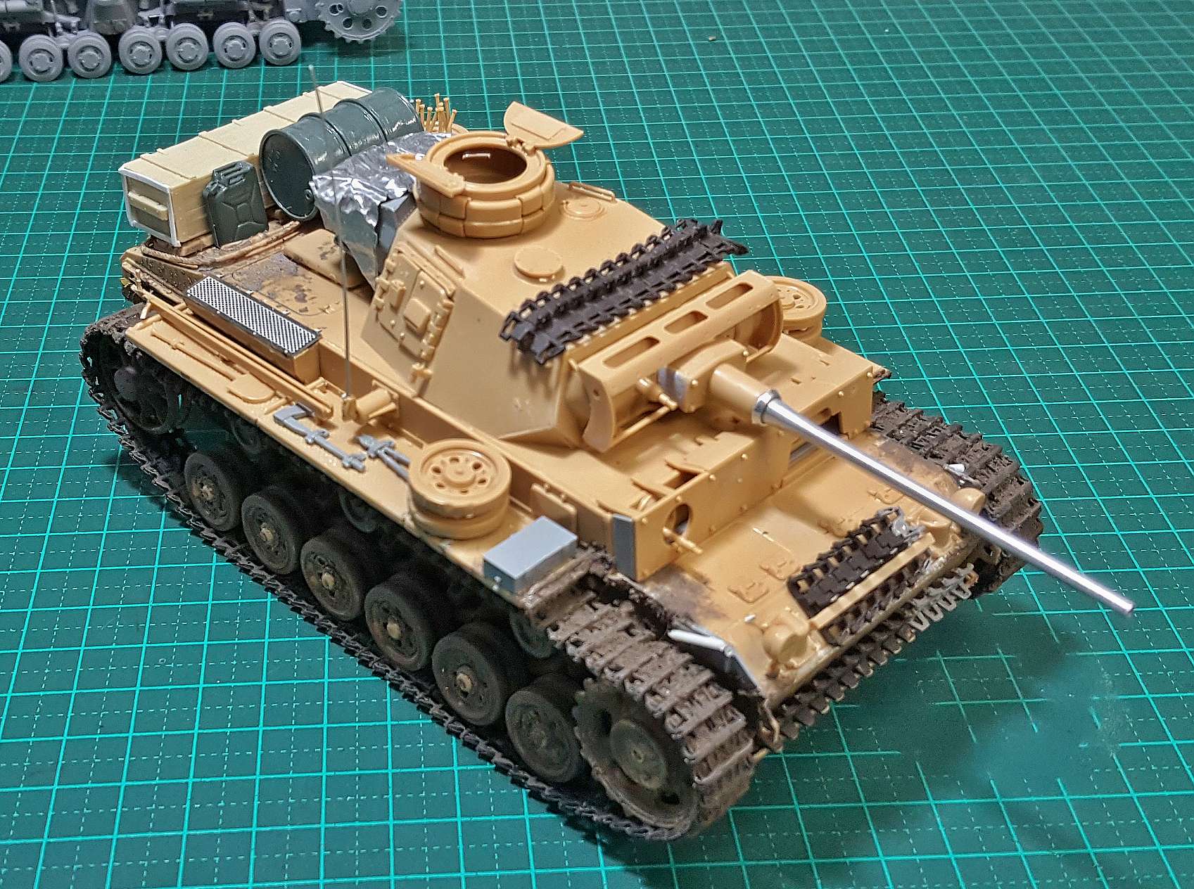

April -May 1942 Prod.

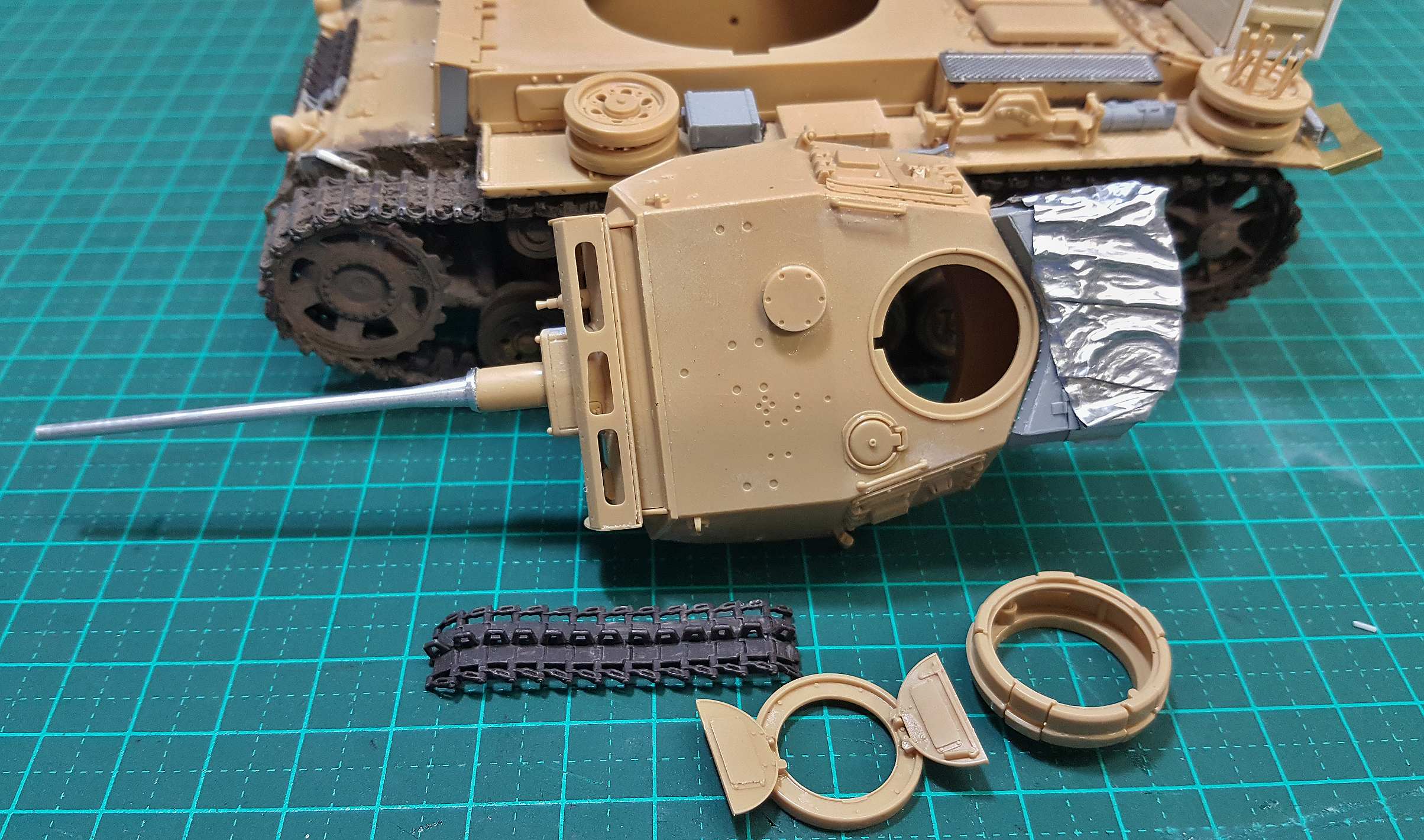

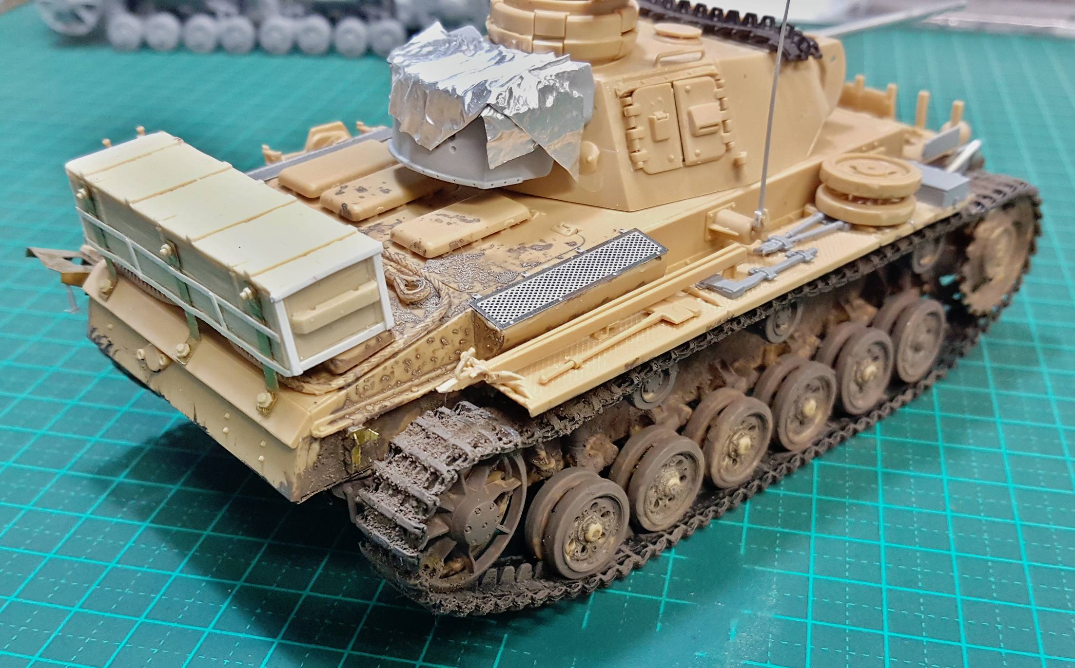

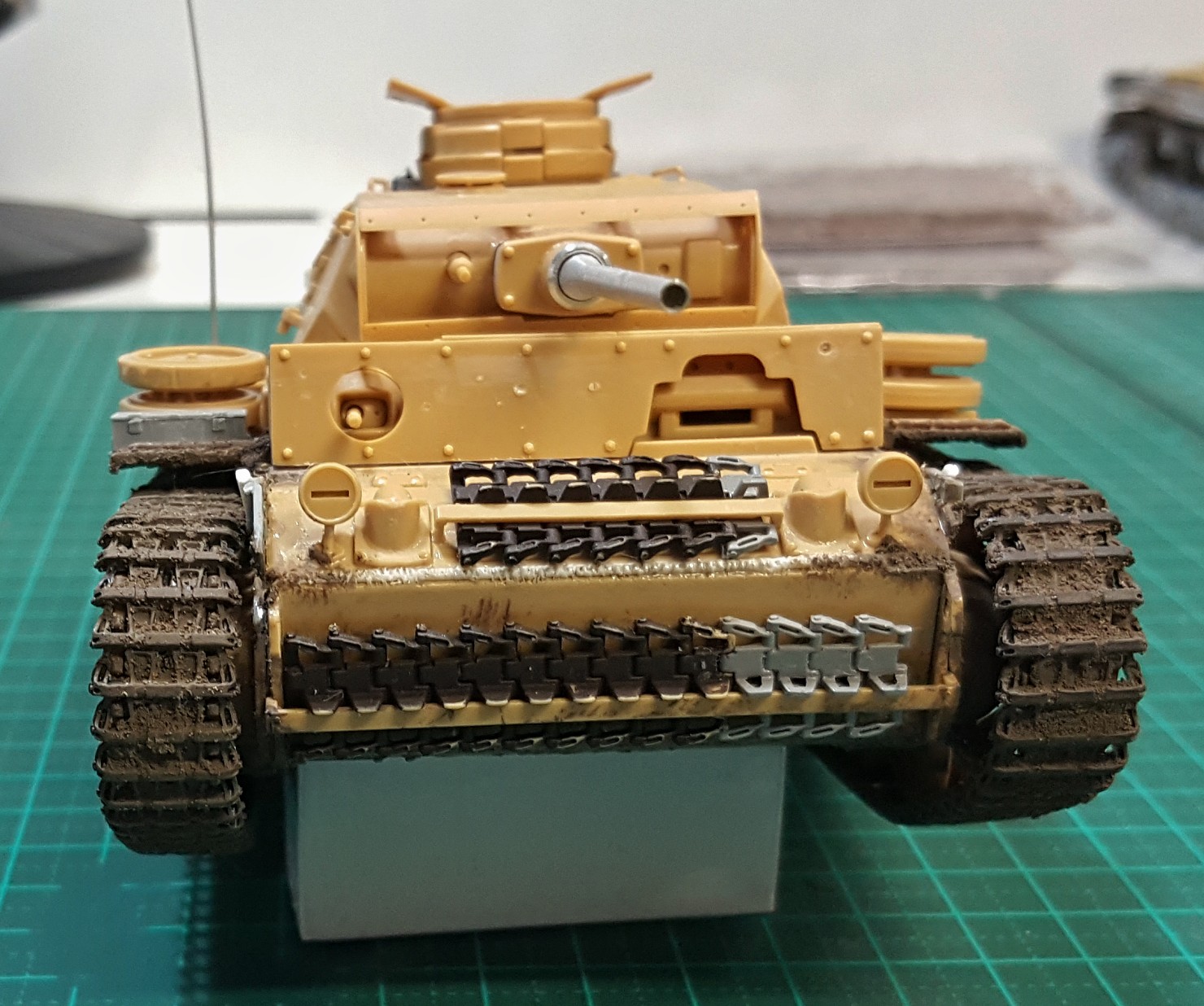

I wanted to add a few extras but not to many. My aim was to create a typical L that did not look like a J or an M, so I went for a mid production version with battle damage.

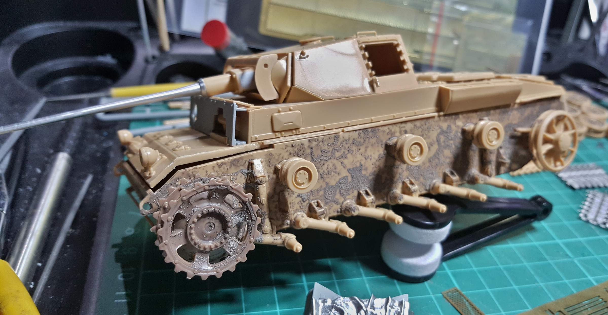

I started by adding a turned Aluminium barrel(from Elephant). I had a number of these in my stash that have been used throughout all of these builds. I also used one of my StuG 3 drive sprockets from Modelkasten that has the center cover missing' to reflect the work done in the field for damage sustained with the guards missing.

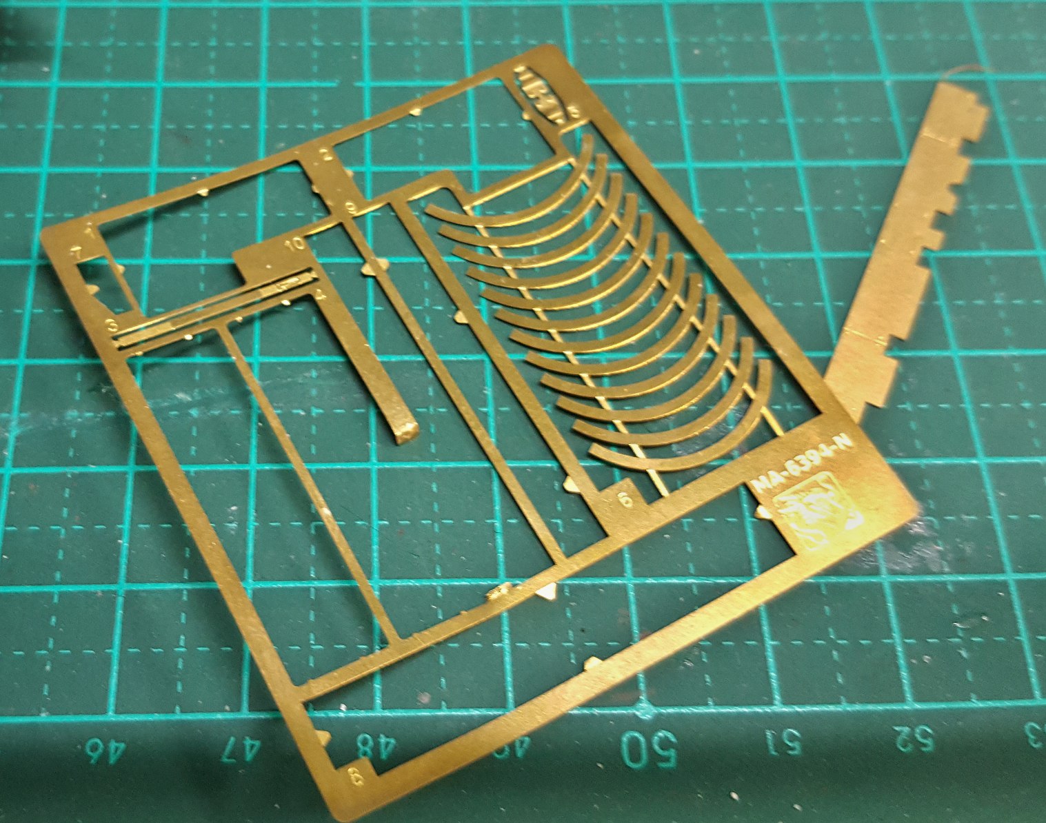

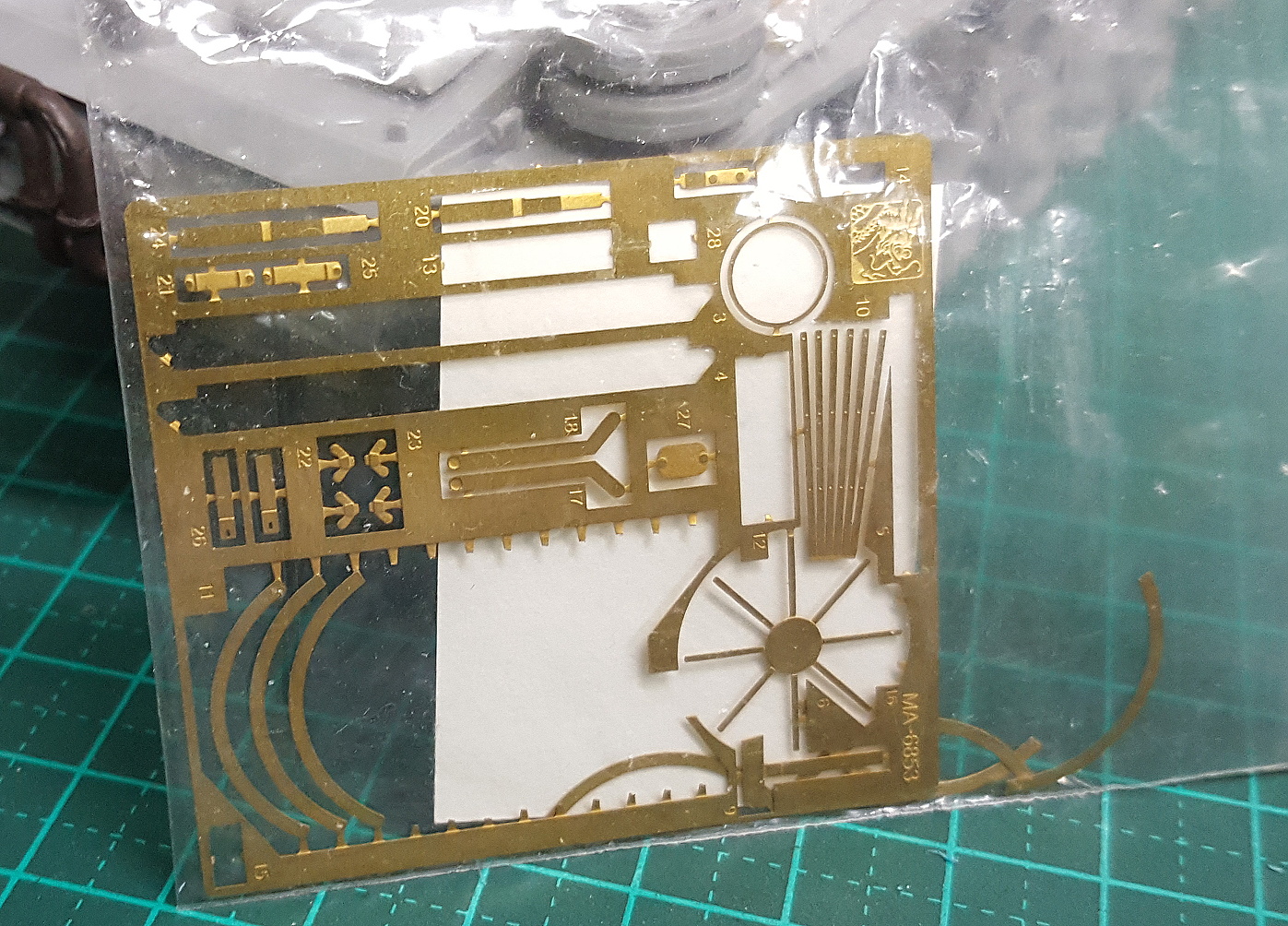

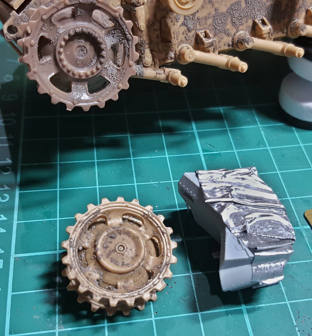

The next stage was to add some texture for mud and source some PE exhaust grills. I also wanted to give it a unique look from the J's by adding a Def Model Pzr3 stowage box to the engine deck rear. I built the frame from the brass on the PE sheet as well as using a bit of strip plastic and nut heads.

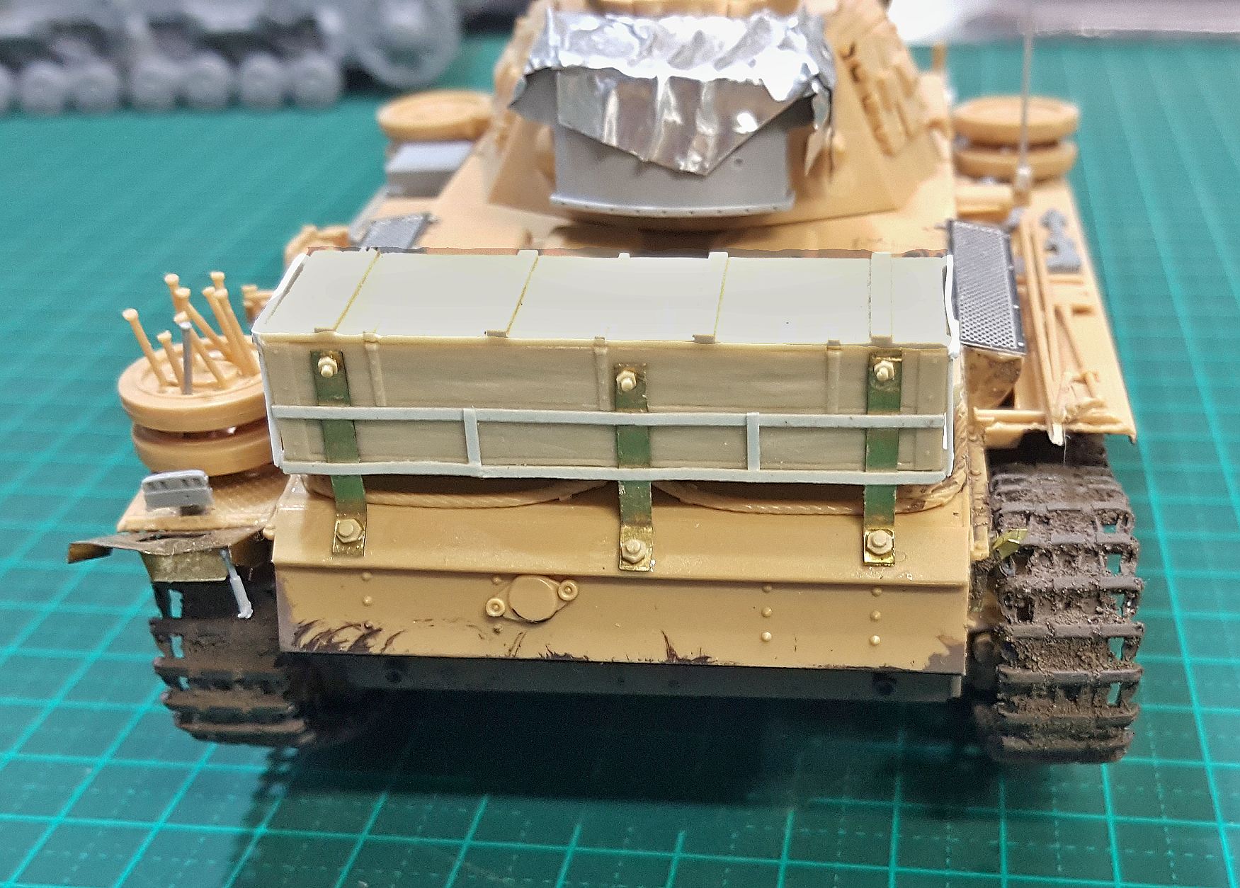

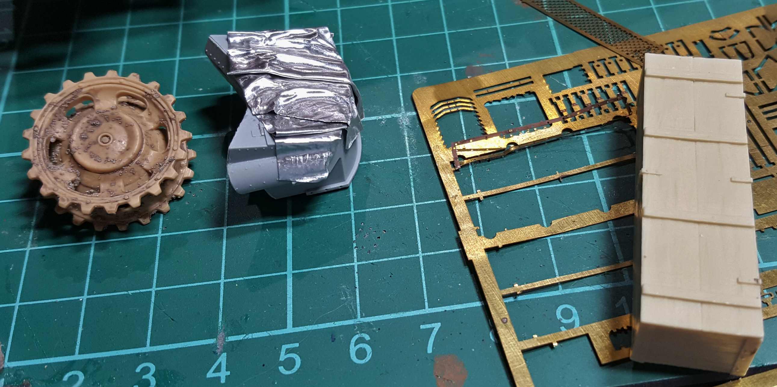

I swapped the stowage bin for a Dragon spare, as the detail was better. I also added a tarp to the stowage bin by using some aluminium foil. I initially swapped out the Vorpanzer for a Dragon spare but then changed my mind as the detail behind would be very hidden and the gap plating at the top fitted much better.
I used some Dragon tools because they had the clasp handles molded on (they just need to be drilled-out a bit).
Also added the Dragon track guard, chassis mounts at the front with scratched white support bars.
I still need to add some finemolds clear perscopes to the cupola so that isn't attached properly yet and smoke candles at the rear.
This model will be painted in German Grey and will be one of the tanks assigned to a Tiger unit on the Eastern front.

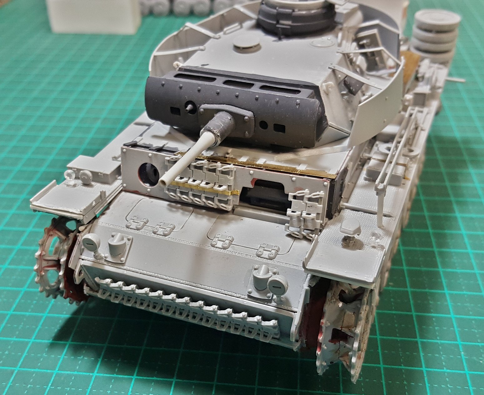

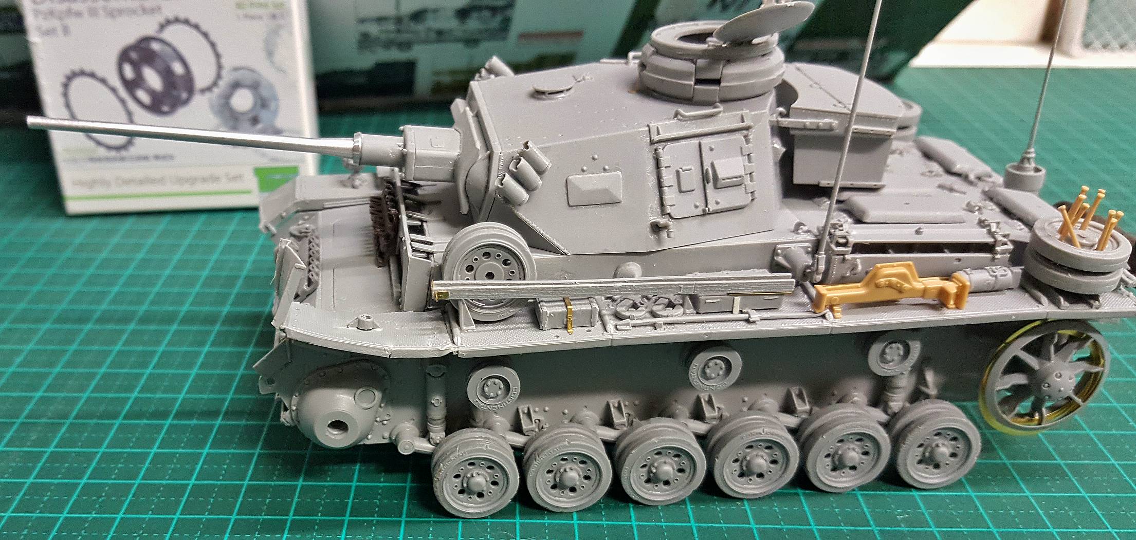

Another great Dragon kit that delivers on accuracy and detail with figures included.

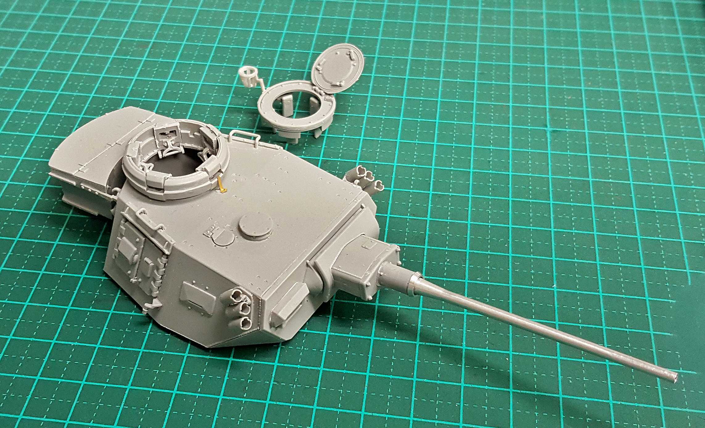

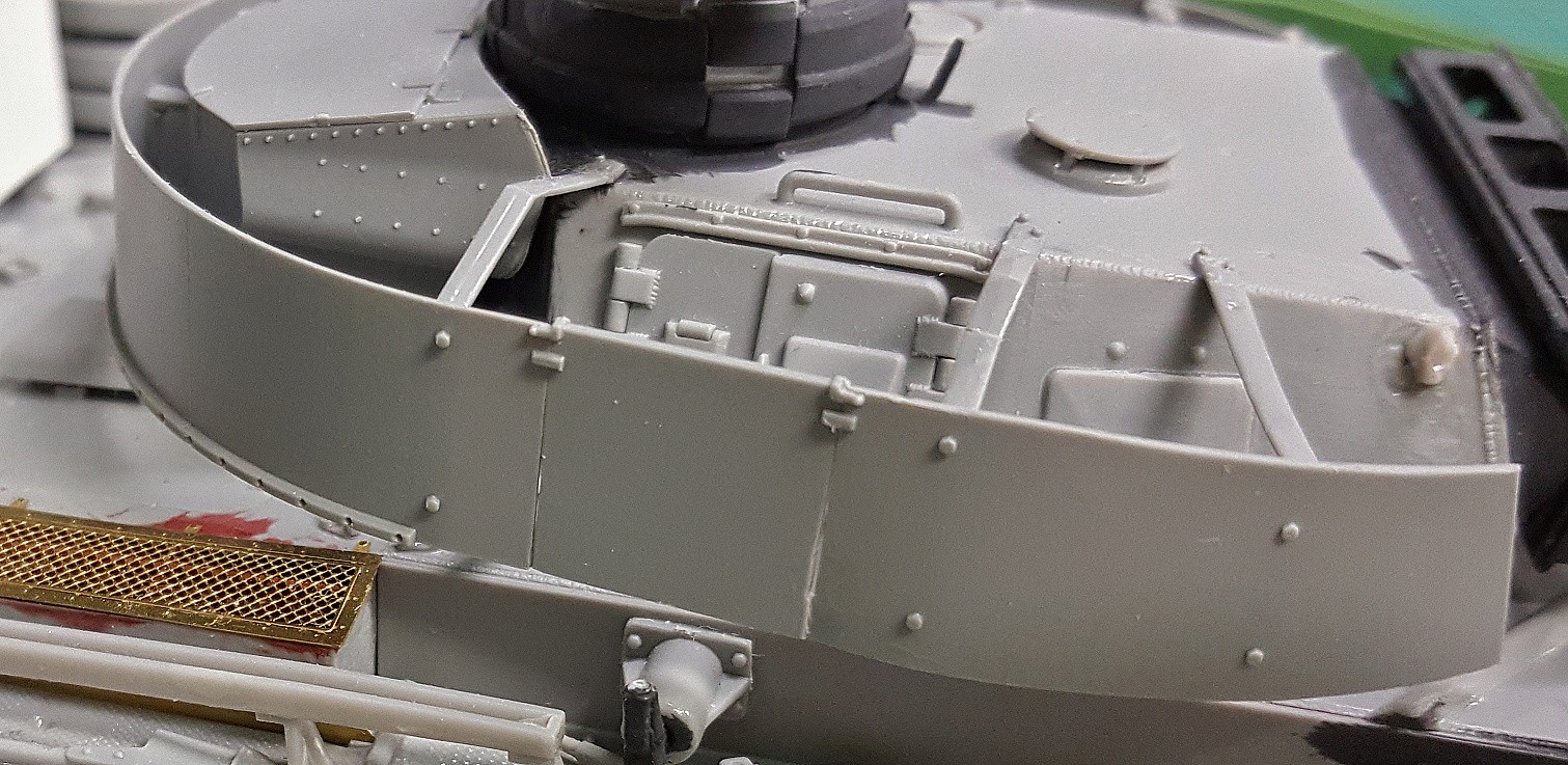

This kit has all the parts mentioned in previous builds, plus a panzer 4 F turret and new hull top plate with the enlarged turret race. I will be modelling this with a damaged front drive sprocket so that I can use the T-REX 3d printed, dissassembled drive sprocket kit I have . I originally was going to use a Model kasten wheel(with the cap missing) but I ended-up using that on the L model. I will have the K damaged by a mine, so I bent up the front section of the left guard.
As with the other builds, I still have a couple of details to complete once the tracks are on and painted , including the top of the Star ariel at the back. 'On the trail' of small deatail changes between each model, I will leave off the sheet metal cover right accross the top of the front Vorpanzer gap, as I have seen this on a number of command tanks and normal versions as well.
As with the other L60 versions, I used my Elephant turned metal gun barrel, as I had a number in my stash that I had bought some years ago. The barrel provided in the kit is very good and probably of equal quality, as it is slide molded but I needed to use these aftermarket barrels.
