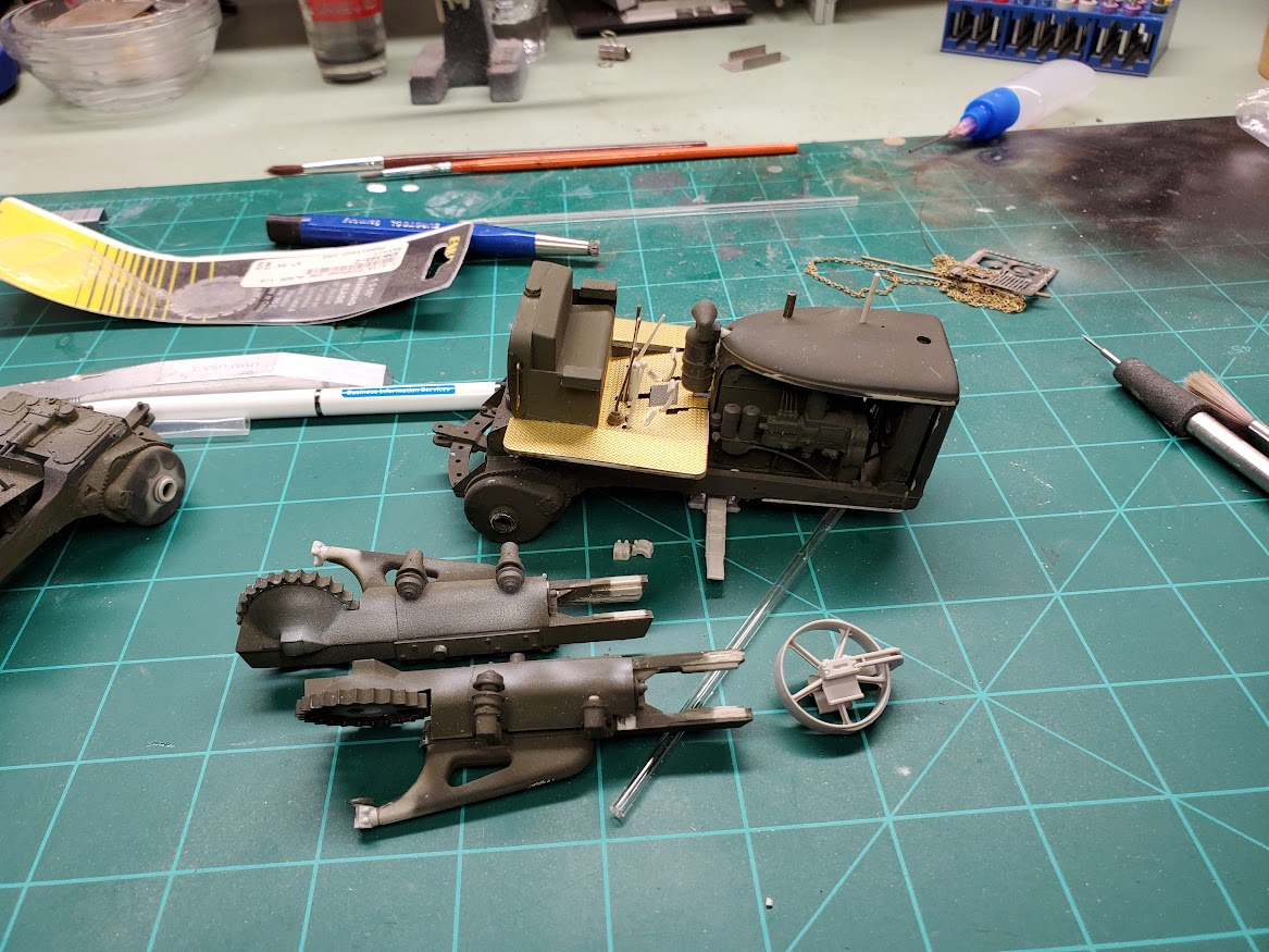

If you can find a picture where i left off, you'll see this probably not as far as long as it was. I had some alignment issues with the running gear so I had to tear it down and rebuild. Used some of the original assembly but had to rebuild that big leaf spring in the center. It's now live, as well as the point of contact on the running gear, that'll give me some wiggle room.
Going to start on the tracks (after I repair some of the damage from being boxed up for a year or mor... :bang head )
those are not the Friul tracks, kit tracks. I may try to rebuild the LeTourneau winch on the back and make actual pulleys.

What was wrong with the transverse spring?
Thanks for giving it a name. :rotf
First, it was glued in off center then where it attached to the drive assembly it was glue in place too short. Made the alignment of the tracks almost like a V. All that's fixed as the spring is live. Previously when I had the blade in place it wouldn't clear the tracks when it moved up and down, looks like there's better clearance now. :soldier

I've started with the tracks and found the guide around the idler is too wide for the opening of the track links. Was on the kit parts but I didn't notice then. I'm thinning that guide now. These Friul tracks look great, pictures later. :soldier
Not certain, but, when I built my resin one, I seem to remember I had the same problem with the tracks. I'd like to give you a suggestion, but, I honestly can't remember what I did to fix the problem? That was seven years ago!
The center raised part of the front idler is too wide? Where's your lathe?

I would love to chuck it up in the lathe but i've already attached the yoke and removing all that assembly is like... :idonno
Stirring up the pot on this.
I pulled the drive assembly off in order to figure out where I went wrong on this the first time.
