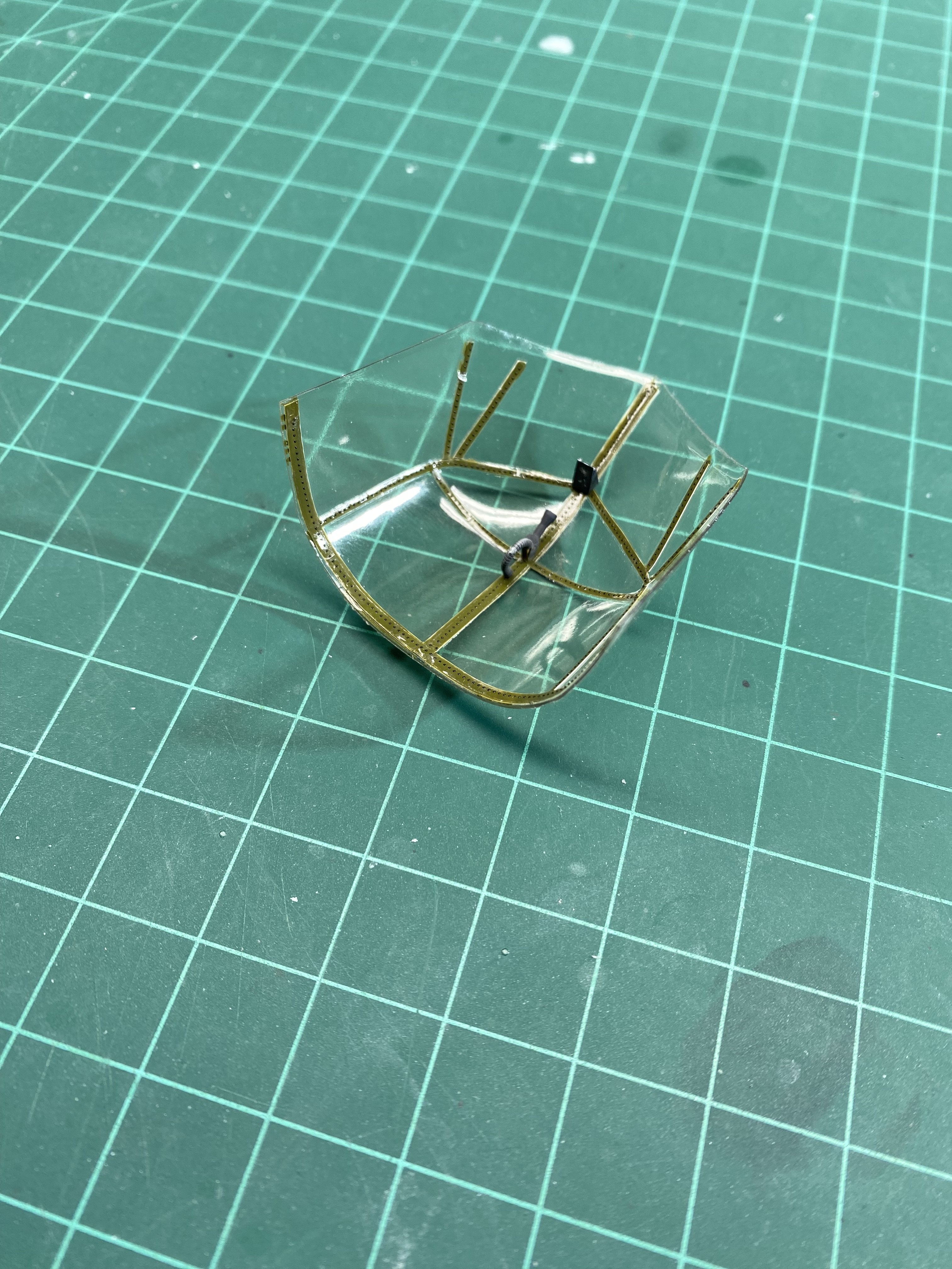

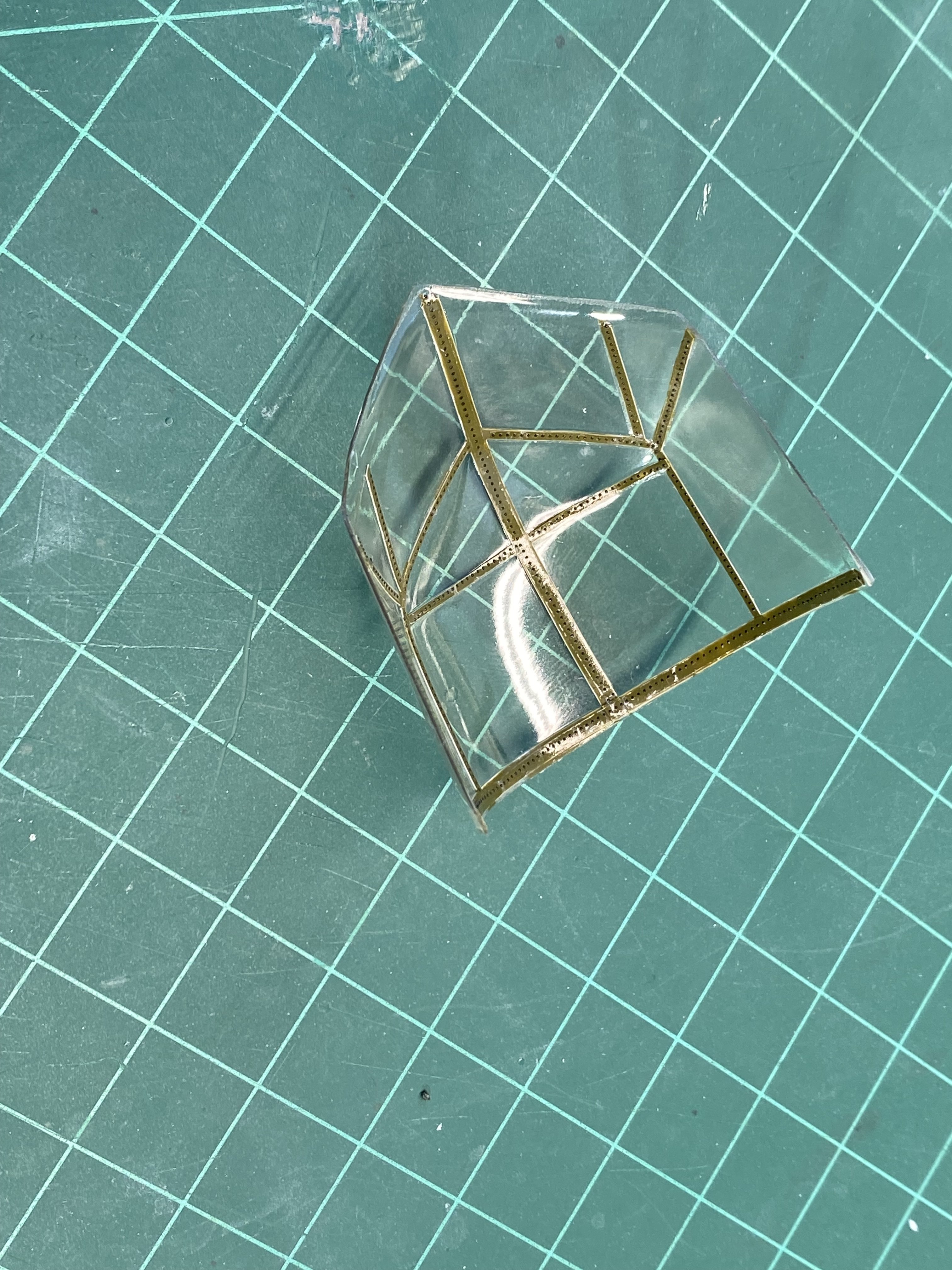

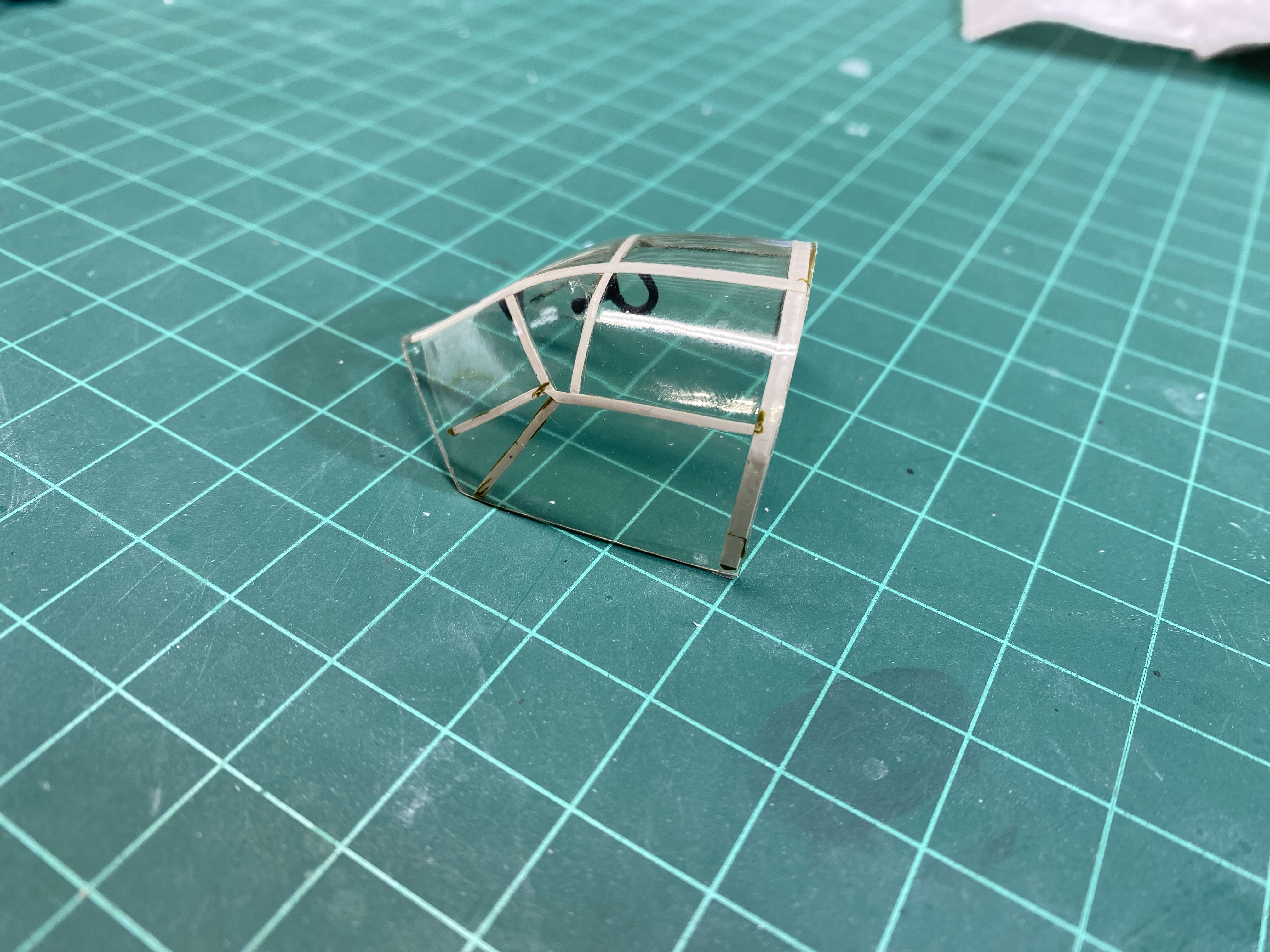

I wanted to try making my own frames for the cockpit just to see if I could, I liked (still do like) the result but during closing up and sanding of the seams I may have squeezed a little to tight or hit it on something and damaged the very thin and quite weak centre framing as its now broken in thee places and both large side windows have broken away from the glue joints, causing me to rethink and revisit the idea of cleaning up and installing the kit supplied cockpit cover/ windshield.
my own fault for not paying heed, I knew the joint was a weak spot but mishandled it during seam filling and sanding
every failure is a learning experience…so I’m told
Well, I tried fixing my broken frames, tried a few times in fact, kind of a frustrating thing, couldn't get every frame aligned and looking right. I guess the first time was the charm (beginners luck?) so...I added a shim of sheet plastic to the rear of the cockpit opening, another on one lower front side (the vac. clear part was smaller than the window openings I had made) I did much trimming sanding test fitting (a kind of all day job) until I got to a point I think I can live with (no other choice really) if I want to finish this model.

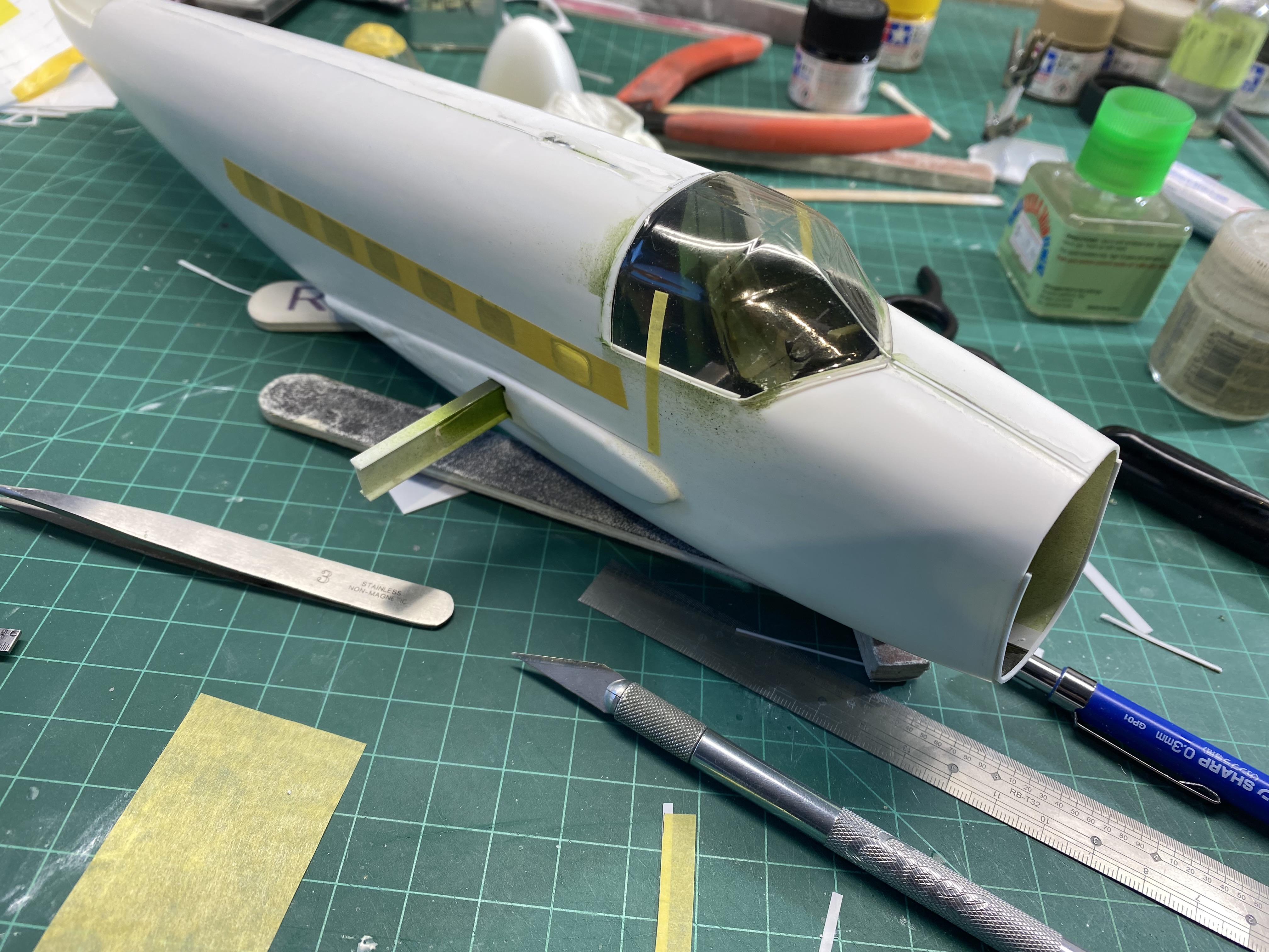

So here's where I am tonight, here's the clear part being fitted:
And with framing added, painted and dipped in "clear"

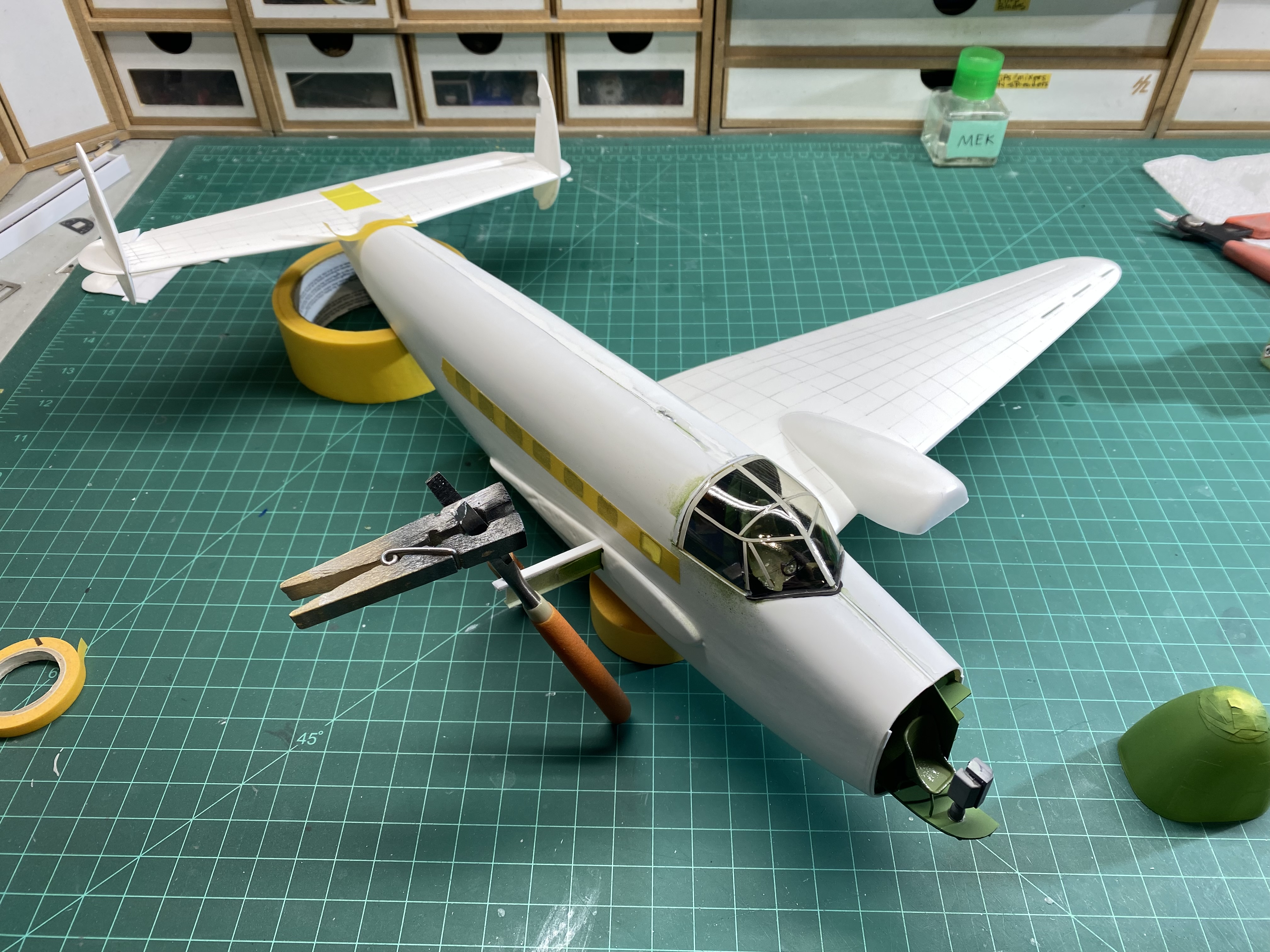

I've added some "stuff" to the bomb aimers position and masked off the windows and may be able to install these clear parts tomorrow

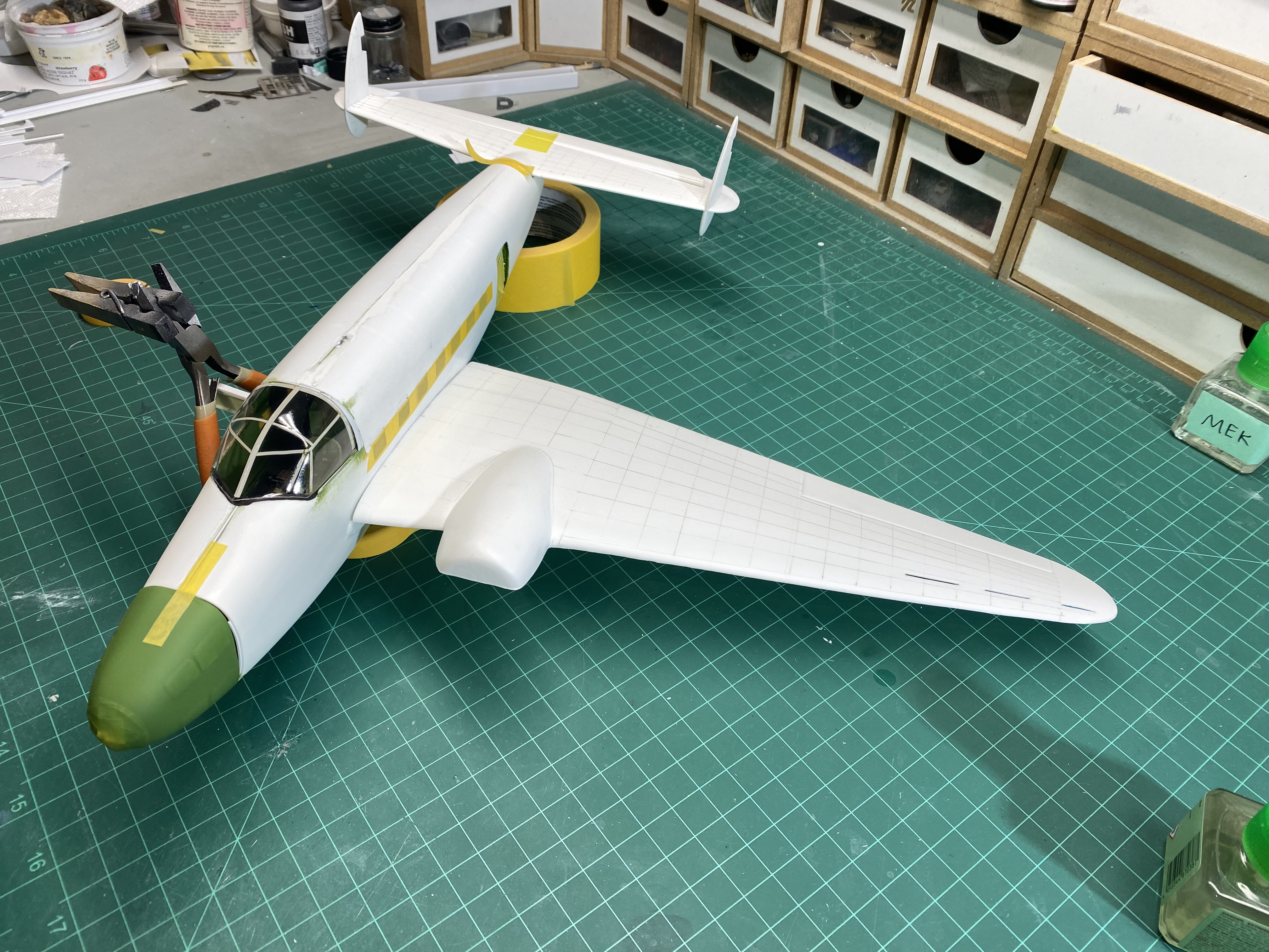

Couldn't resist seeing what it looks like with the airoplane bits added to it and the bench cleaned off a bit
Thanks for looking

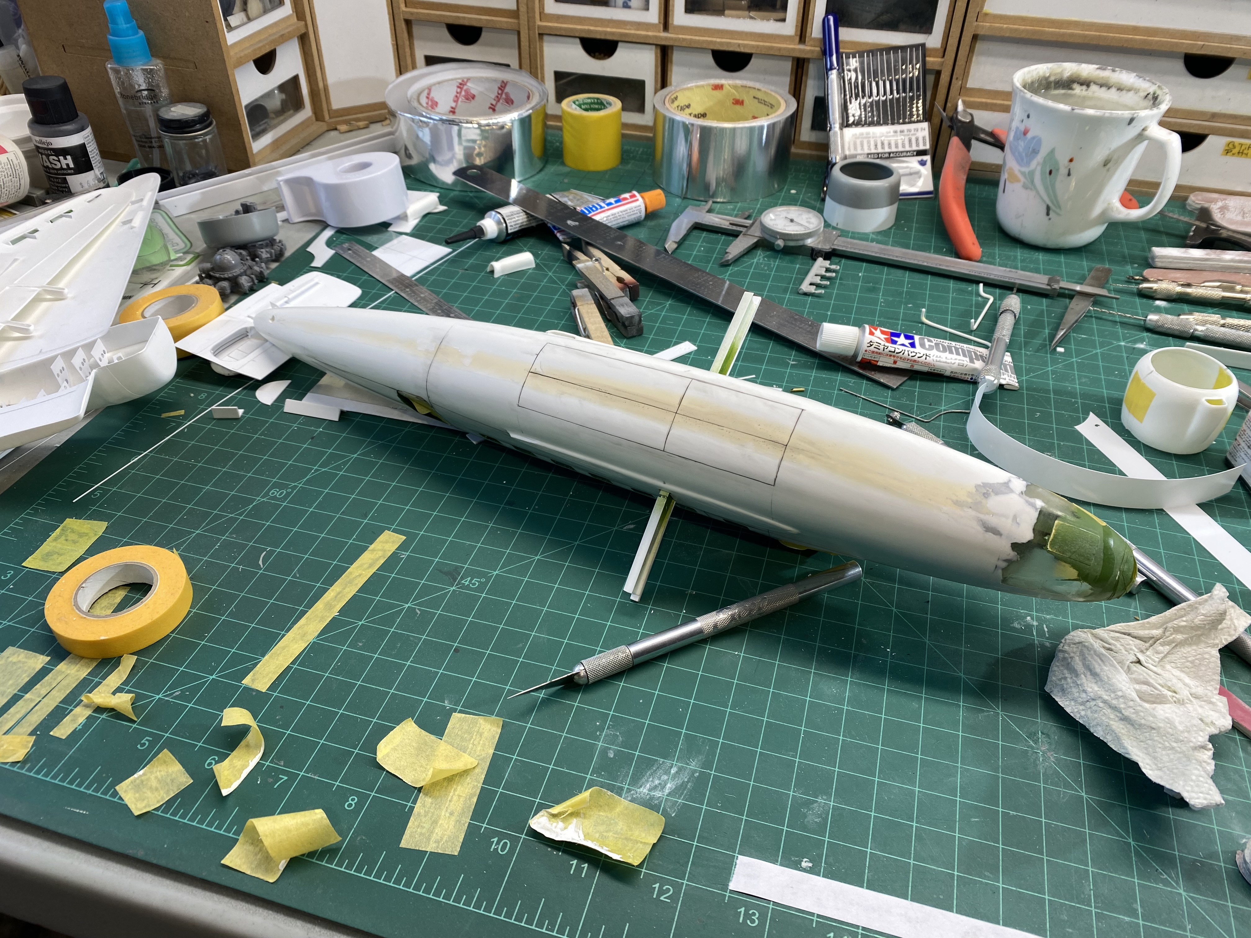

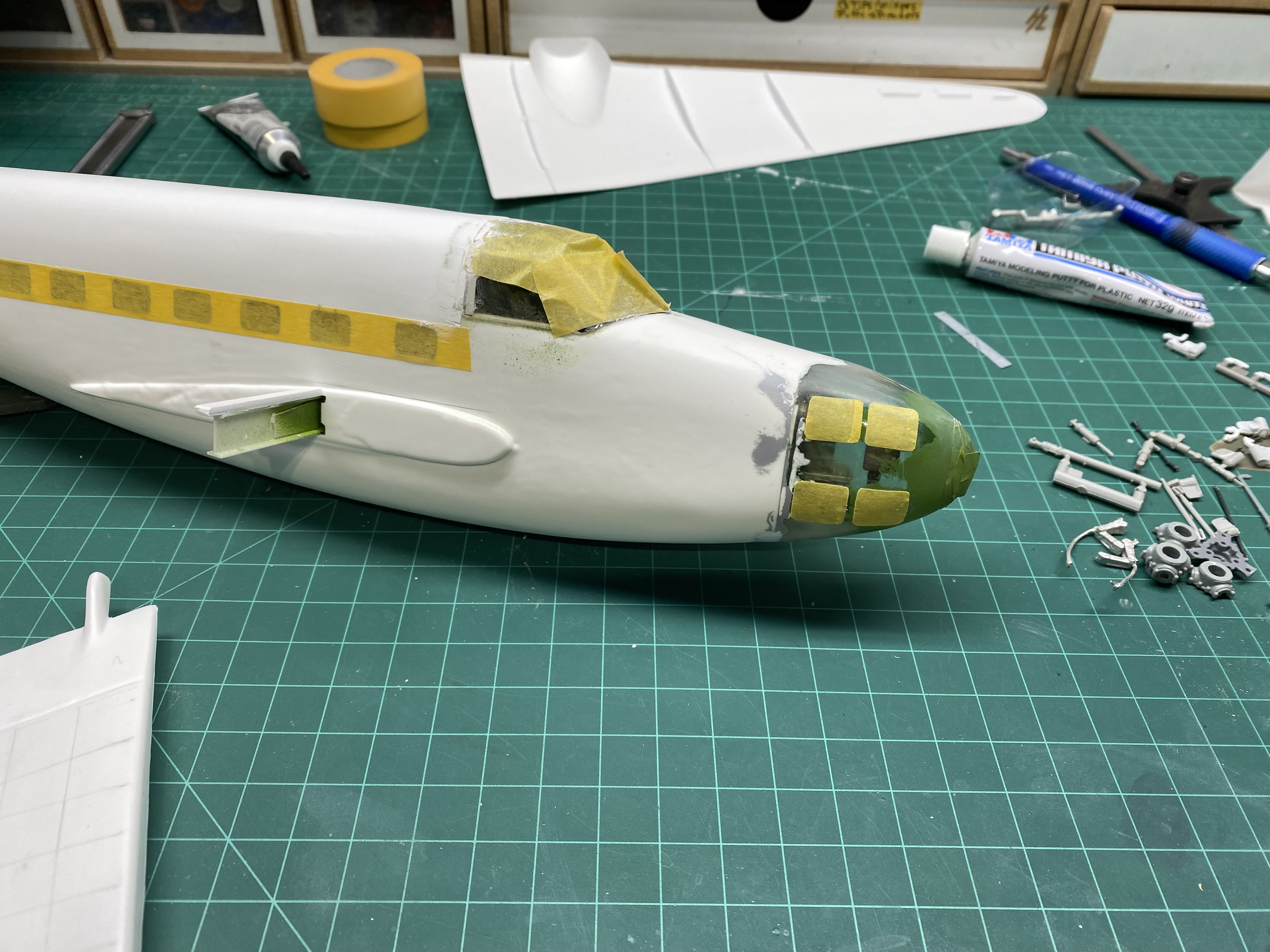

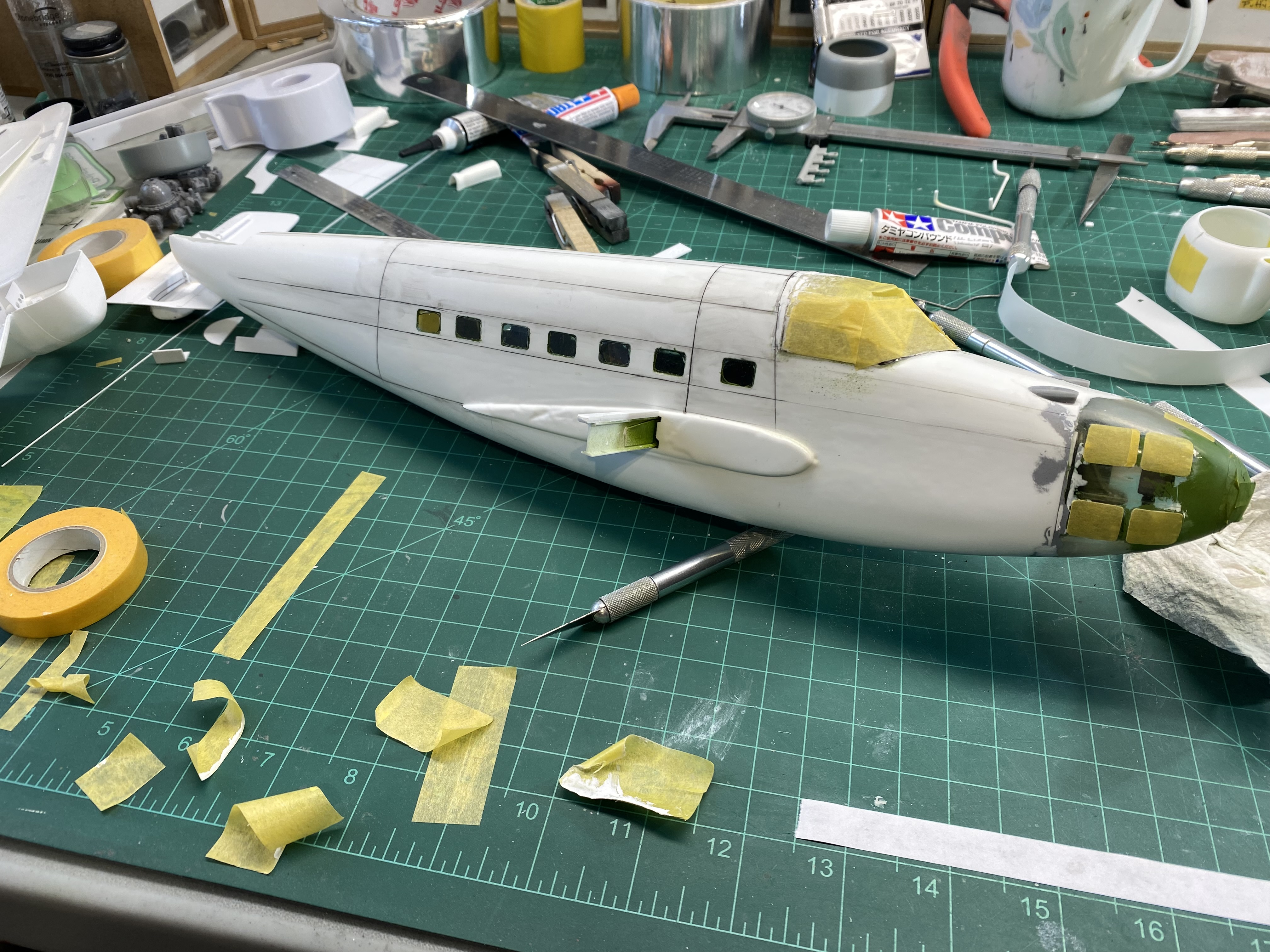

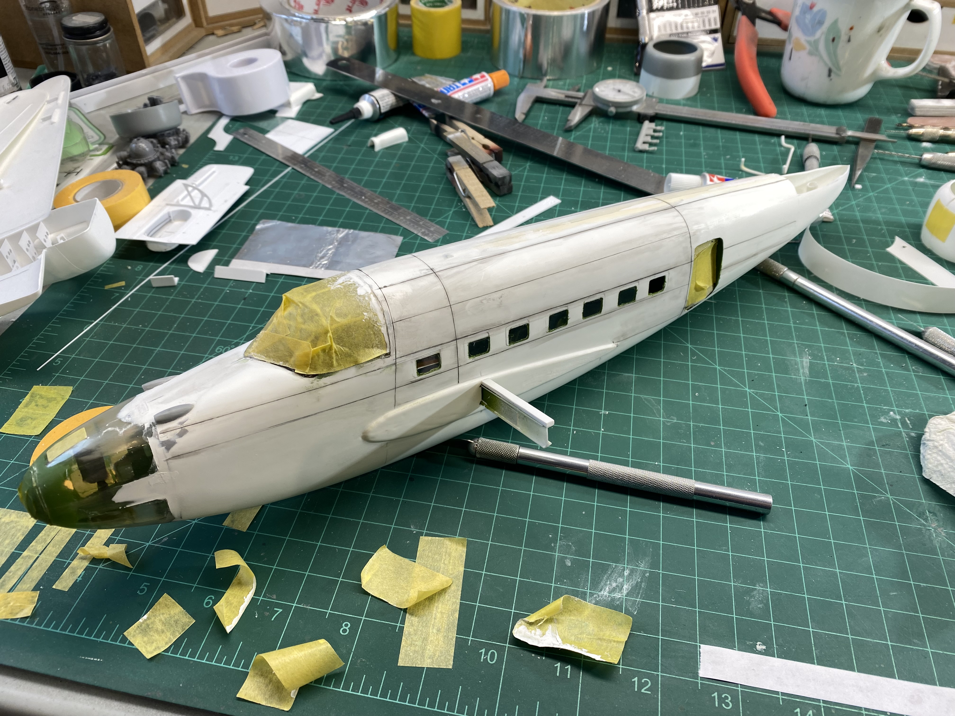

a bit more moving forward (kind of diagonally forward but still)

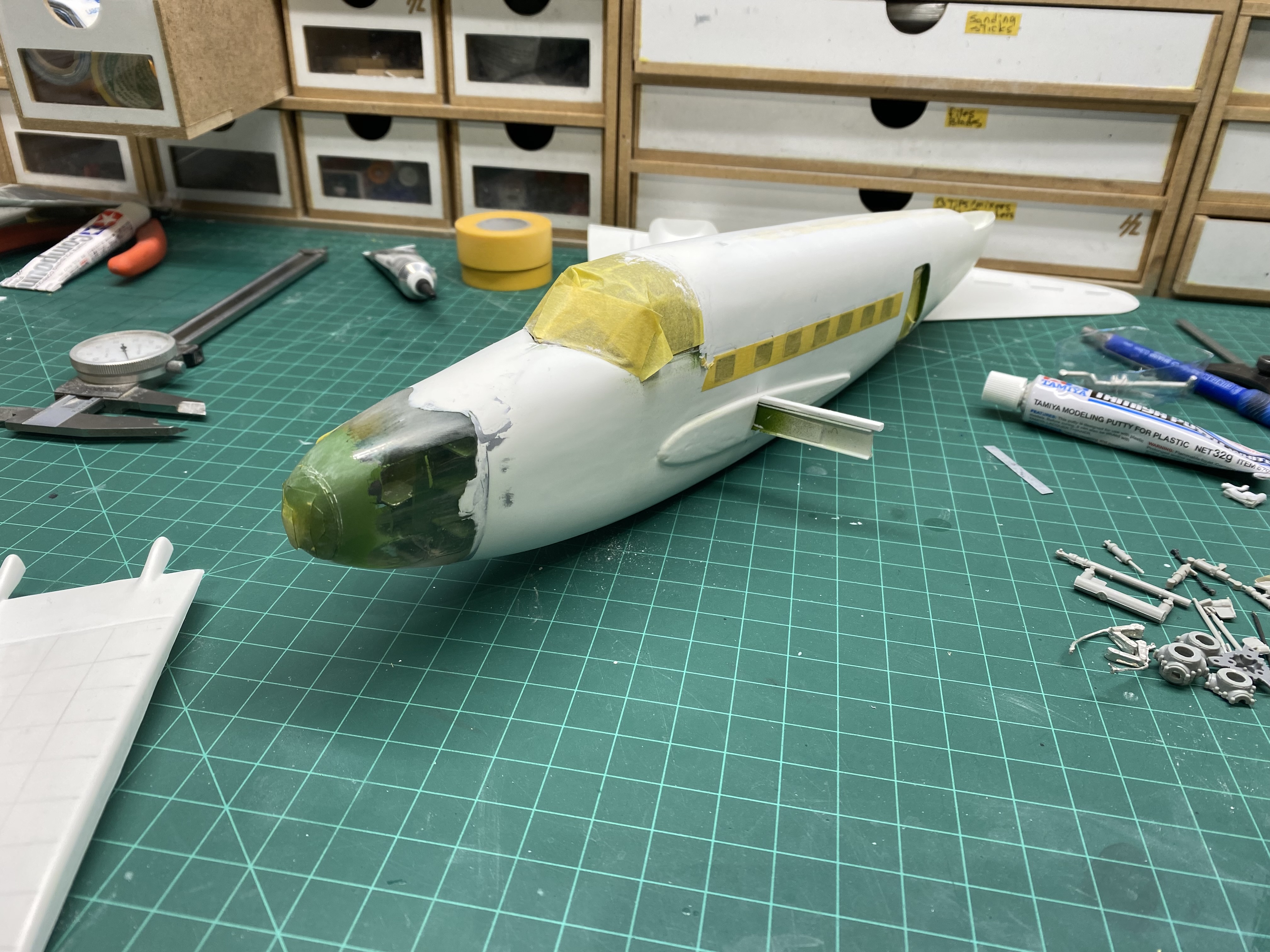

The nose and canopy are installed and filling/ fairing/ filleting in is mostly done. the clear parts (to remain clear) have been masked off to reduce damage from filler and sanding

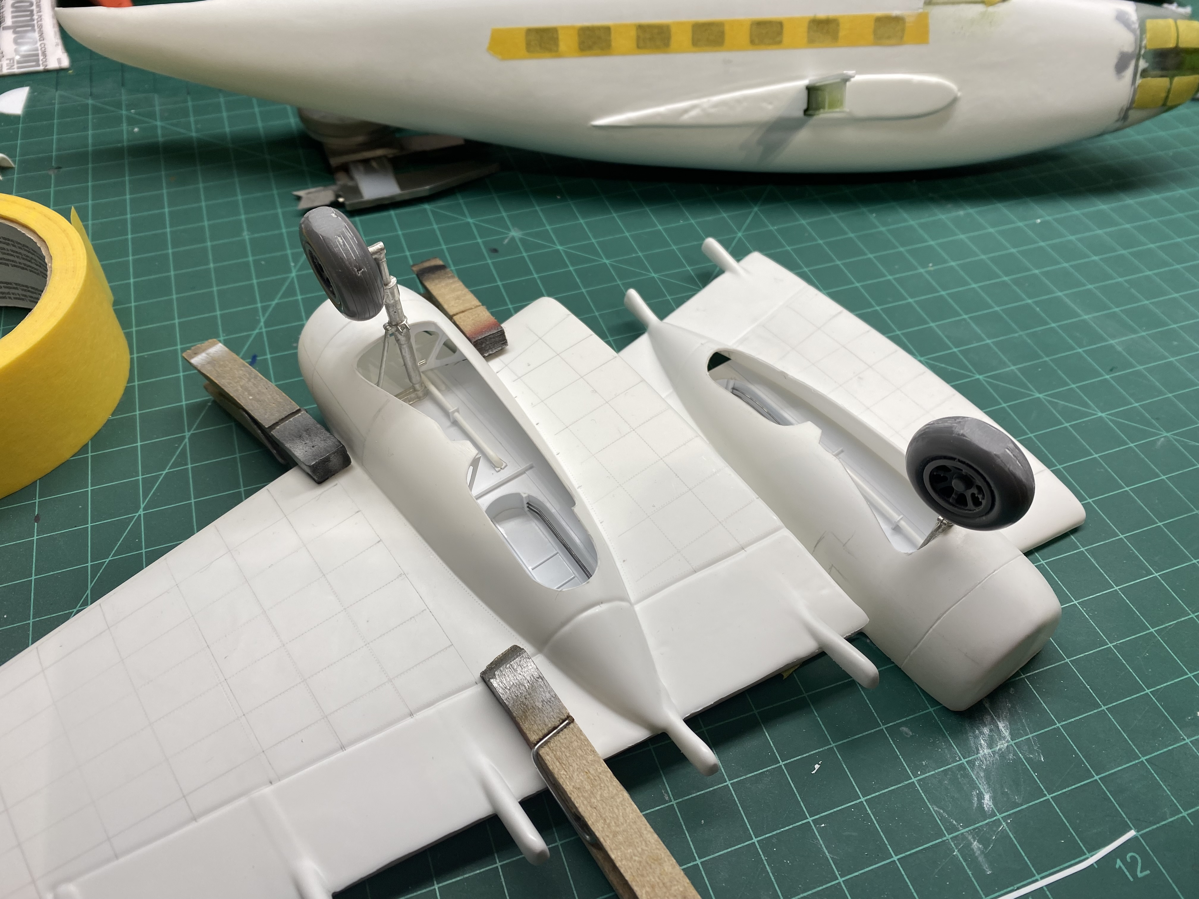

Having done much head scratching and procrastinating, I decided on trying SAC white metal landing gear designed for the Trumpeter 1/32 P-38 Lightning. This was duly ordered from Hannants along with Aires wheels. A test fit is very encouraging

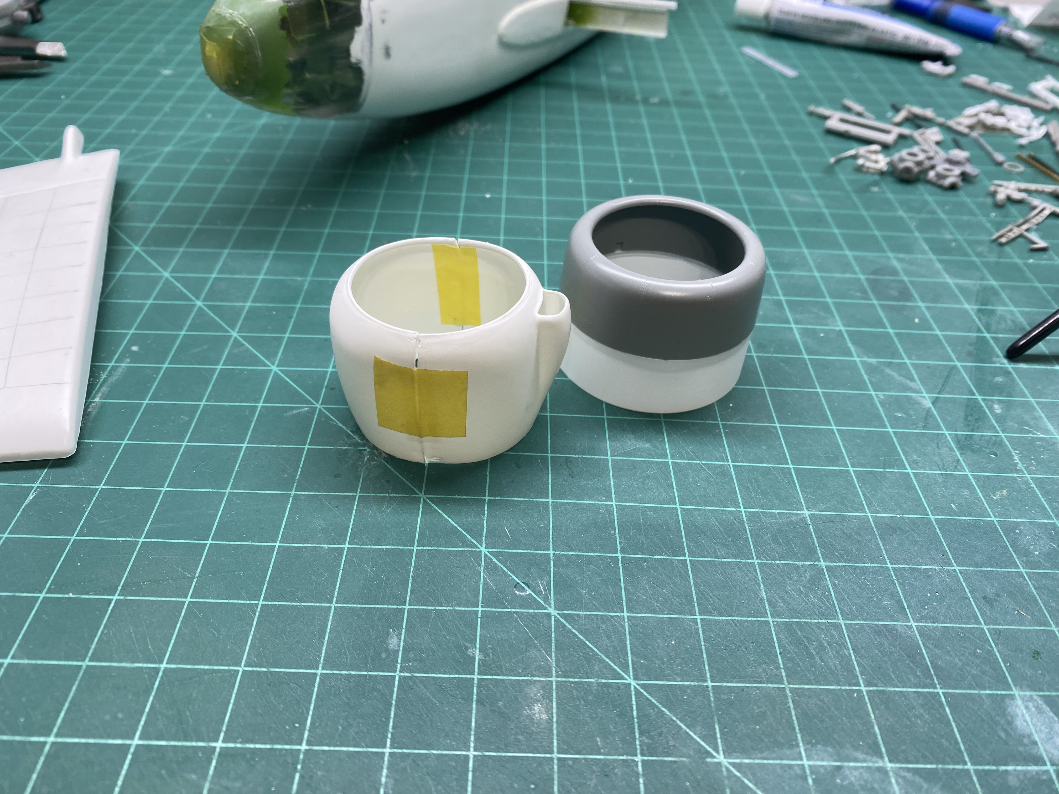

And, having a not real confident feeling for the kits engine cowls, a dig through the spares box found surplus (optional) cowls for HK Models 1/32 B-17 E/F I have added a strip of Evergreen .010" plastic to match (kinda) the chord of the kit cowls, not completely convinced this will work either but I'm liking it as a start for another choice.
Thanks for looking

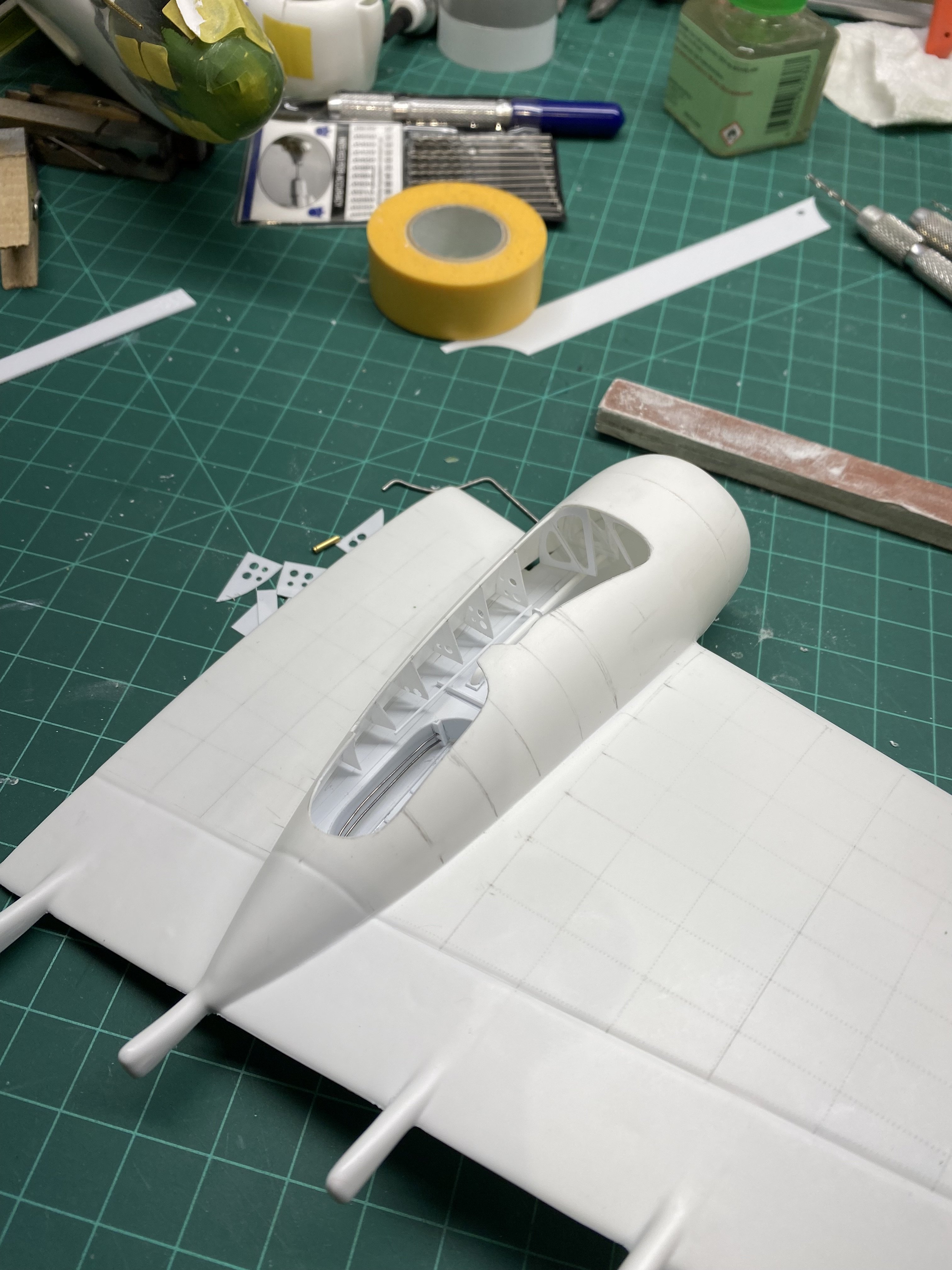

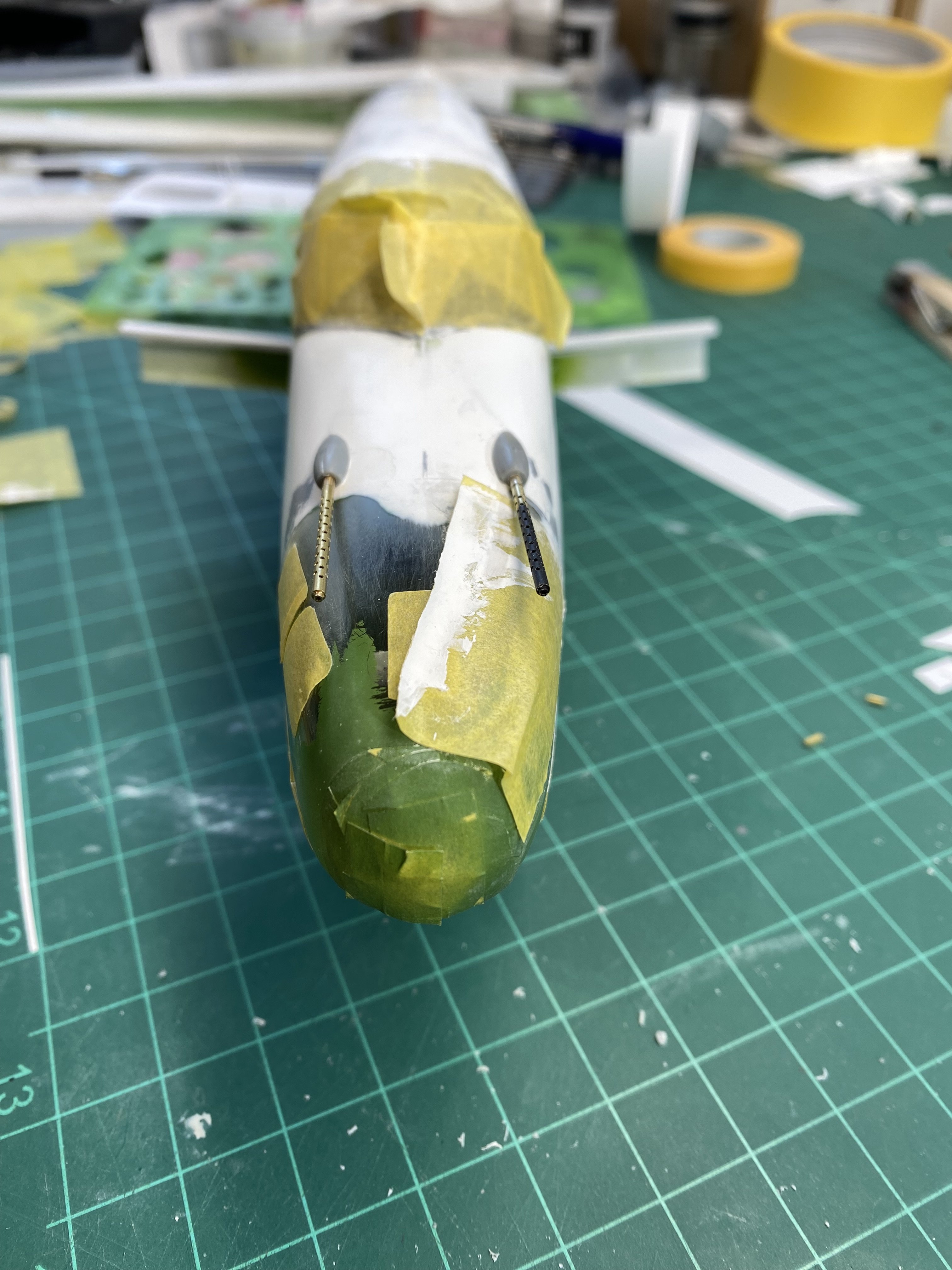

I'm trying to fit guns adding fairings from a Ju-87 and have added the last of the structure to the inside of the gear bays, I'll add a couple more pipes (gizmology) to the bays then the pivot points for the main gear legs, then close up the wings I guess.

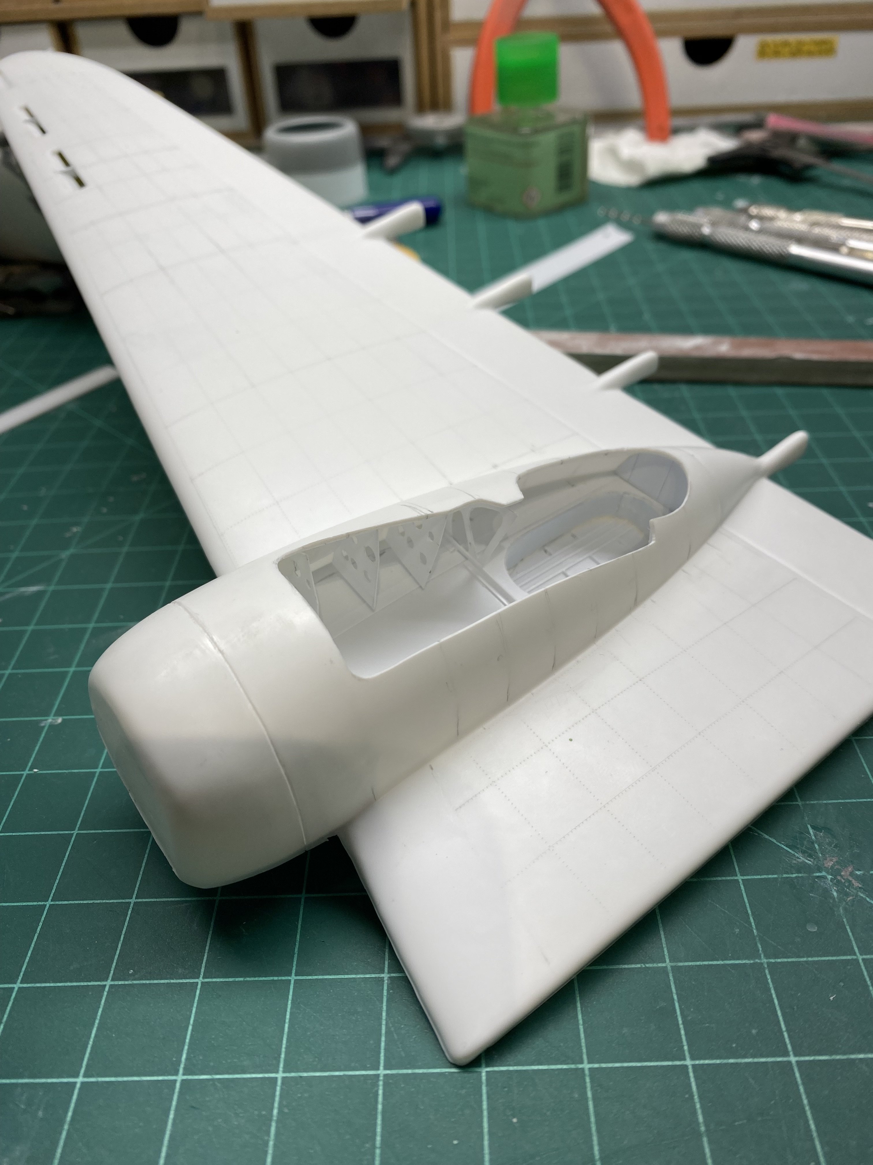

making and adding ribs to the nacelles;
Thanks for looking

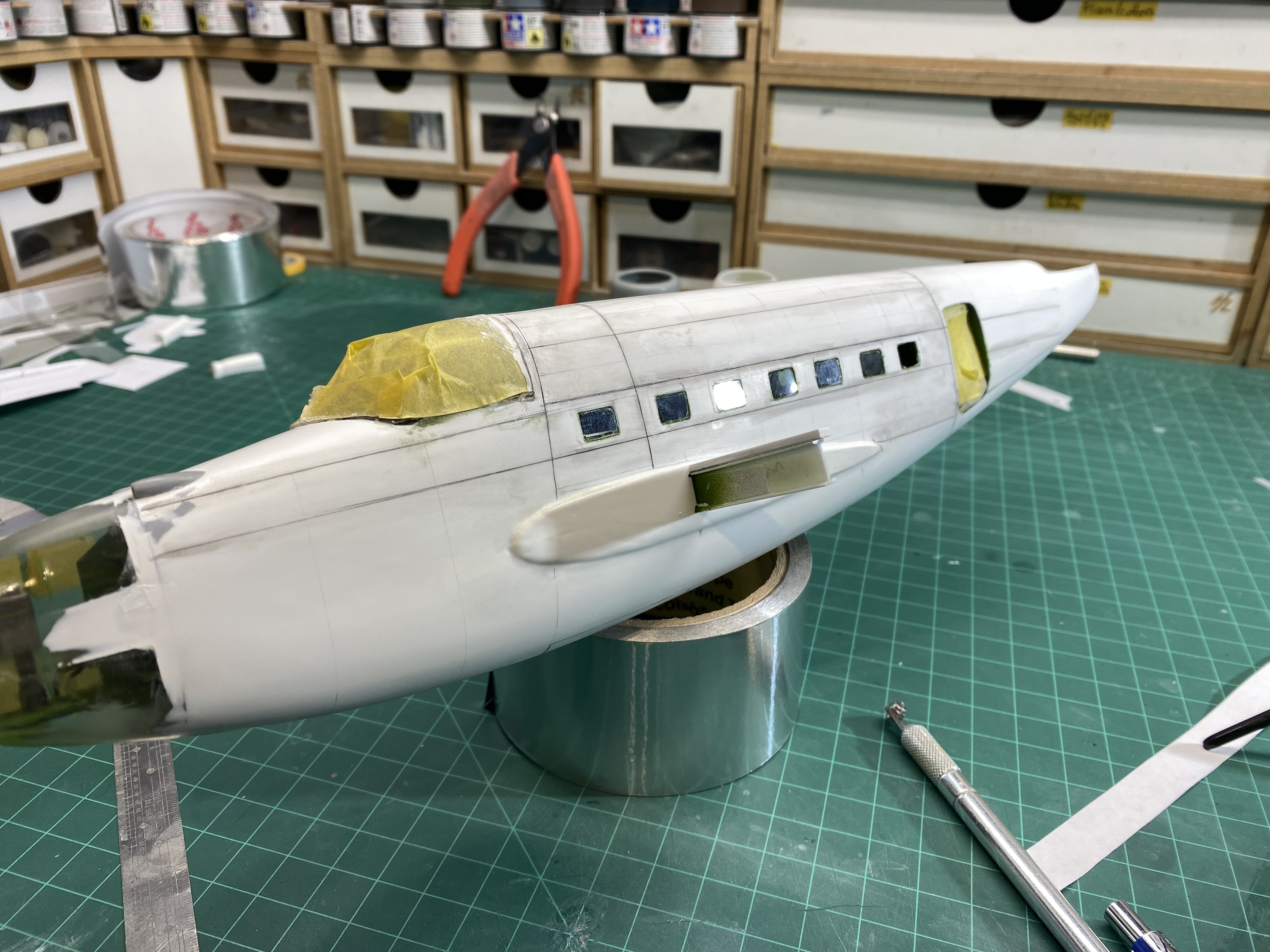

I've begun adding panel lines and rivet details to the fuselage. A lot of the details may (will) need to be touched up after adding the flying surfaces and puttying those joins but I wanted to get as much of the details added without the wings as it's so much easier to roll the model this way and that to scribe and rivet on without working around the wings.
The rivet lines are hard to see (impossible?) but they're there...well, some are anyway.
Thanks for looking
Yeah the rivet lines are hard to see with the white plastic. Get some lead pencil dust on your finger and lightly rub it on the surface and they will pop out. They will also be easier to see once there is paint on the subject.
Keep up the good work!

Amazing, since you haven't fixed the gun barrels could you cut them back a bit before seating them? Looked like you had the full barrel sticking out and the fairing wouldn't allow where the body of the M2 to be. Not sure that makes sense...no coffy yet. :needcoffee:
Yes, you’re correct, the images shown are just to rest fit the guns in the drilled holes and give an idea of alignment. In actual fact when (if ever) completed the model,is, the barrels will be cut down to around 3 to 5 mm long protruding from the fairings
