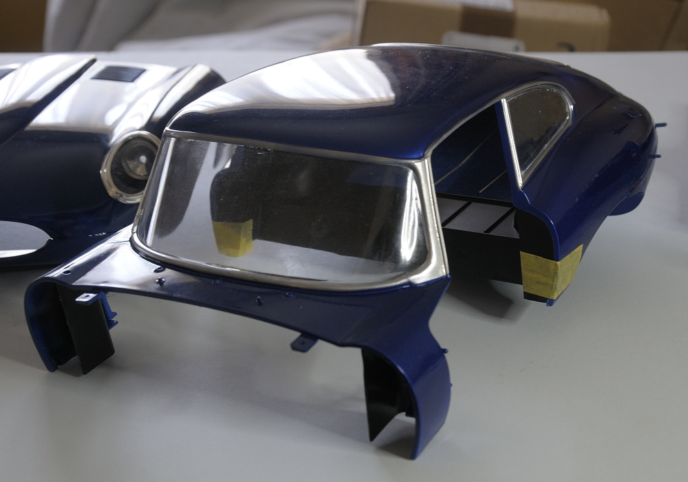

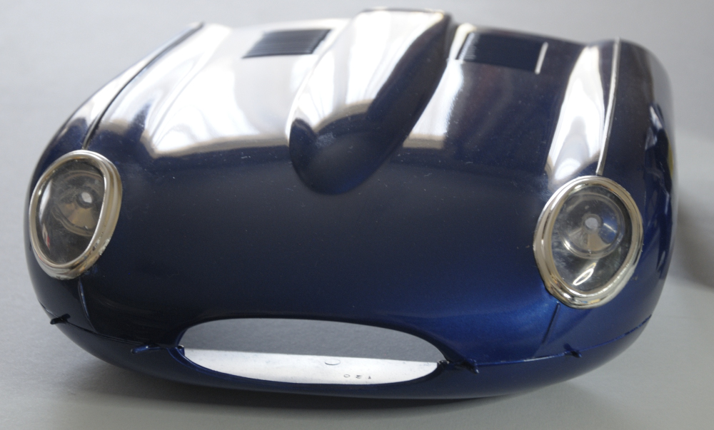

The chrome surrounds around the headlights dont really fit, they have to follow a really strange shape and they dont. The only way to fix them in place is super glue and thats fogged the glasses and attacked the blue paint. None of the windows really fit so they all have poor edges that show and nothing makes the car look more like a model than crap windows :)

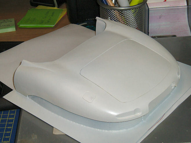

This where i have got too. Its not the models fault but if i join the front to the back it doesnt even fit on my work bench :)

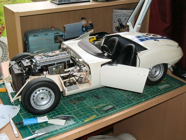

There is a guy in the UK making a resin back for this kit so its a roadster.
The huge advantage with this is.....no windows, no roof and easy access to the interior for trim.
Then build it as a track car and you can dump all the chrome as well. Look how easy it would be to fit the dash and seats without a roof :cool:
The only question is what he does with the screen, my guess is he cuts down the kit item and the frame to suit ?
I am wondering about converting it to a roadster. Trouble is the Rear end is £100 which is almost as much as the whole kit ...

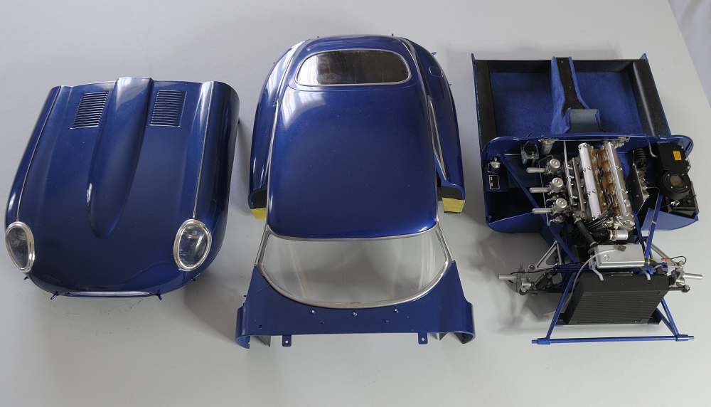

So do i prize the lights out, clean up the hood and respray, spray the chrome bits chrome again, polish the light lenses and dip them in future to get back where i was yesterday ?... and try and re assemble.

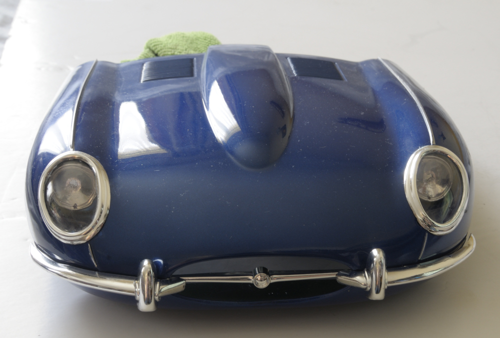

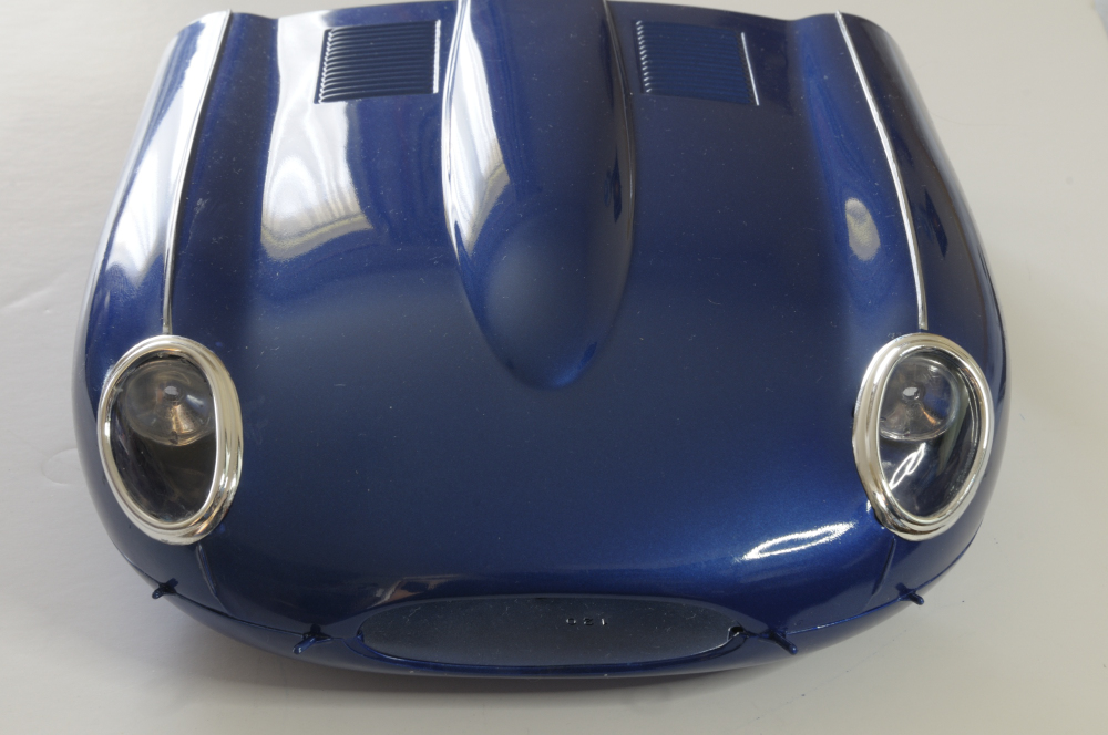

This evening i have prized the front headlight chrome surrounds off with the lenses and glass covers, i got most of the super glue off, cleaned the inside of the glass, chiselled away at the whole lot to get a better fit and re attached the whole lot using a 2 part epoxy rather than super glue or styrene cement. I will have a look tomorrow and see if its been a success.

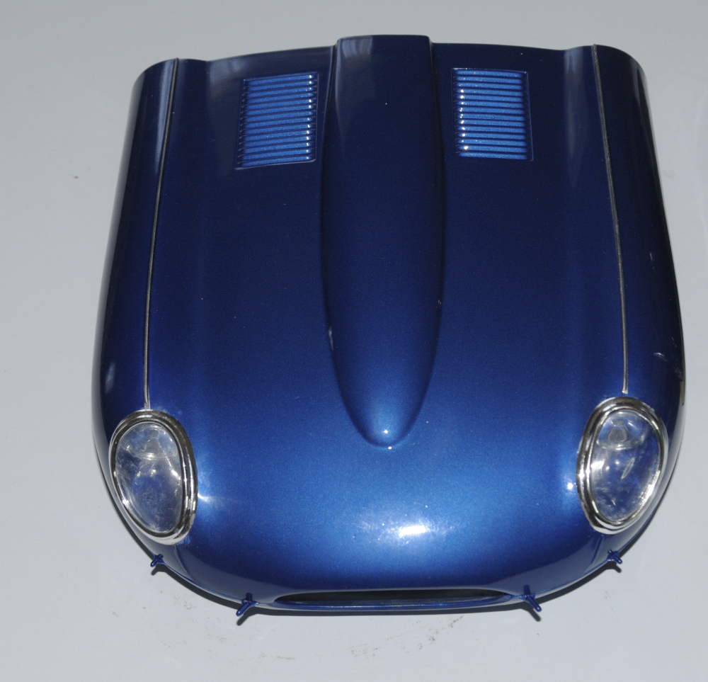

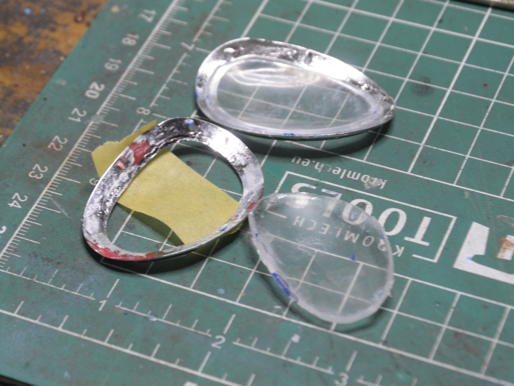

These are the light lenses and surrounds once prized off the hood. What a mess :) I got most of the super glue off with a scalpel ( if only Acetone didnt melt plastic), polished the glass areas with finishing polish from Tamiya and glues them back in place with a 2 pack epoxy. this is great stuff as unlike super glue it doesnt need point contact and you can put it on thick and it forms its own shape/seat and fills gaps between parts that super glue doesnt do, it also doesnt fog the glass.
Not perfect but i can live with this.....I added the bumpers and grill bar and it looks better

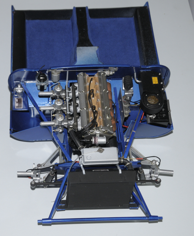

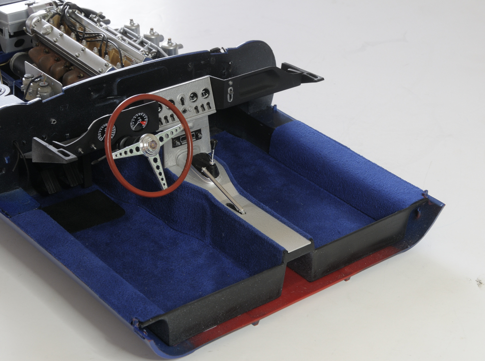

Inspired by my success i even finished the carpets :)
Strangely there are no fixing for the seats ? (even under the carpet)
No real problem Bob its just a case of stick them where you want, no mounts or markings to show where they go so just glue to the carpet...lol
Cant imagine they would be much good in a crash :)
