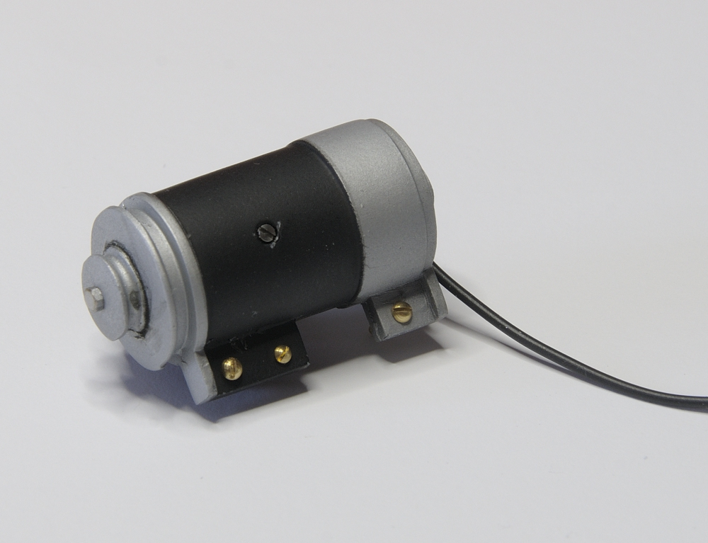

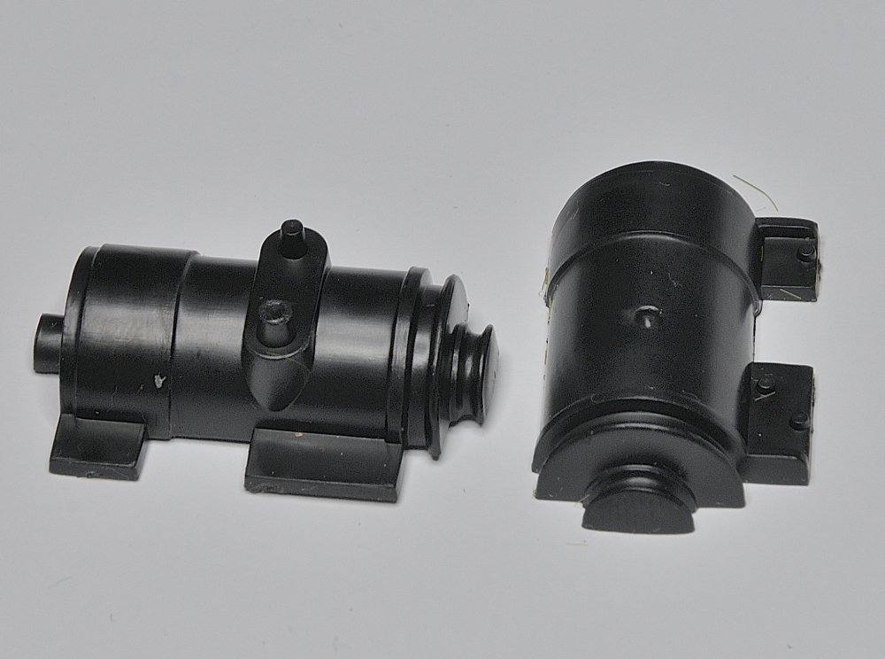

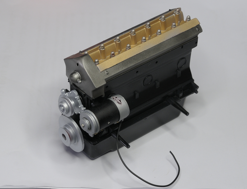

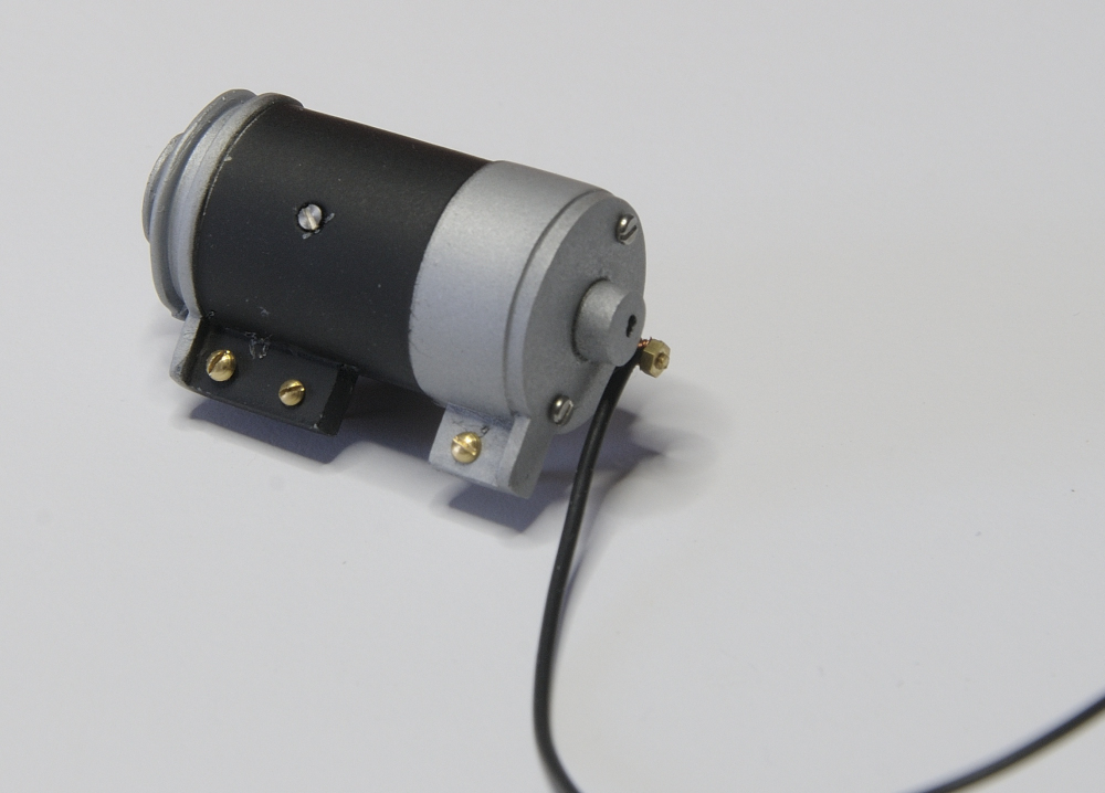

Here is the Dynamo OTB
its not to bad, a separate pully would have been nice, but as i say this is a Revell kits so its basic :)
Here it is with some cleaning up, some paint various screws and a pully nut
Getting the joining seam out was the only trick bit but quit doable.

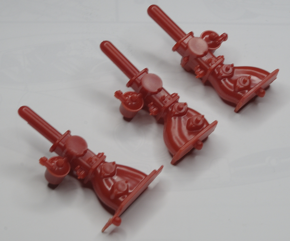

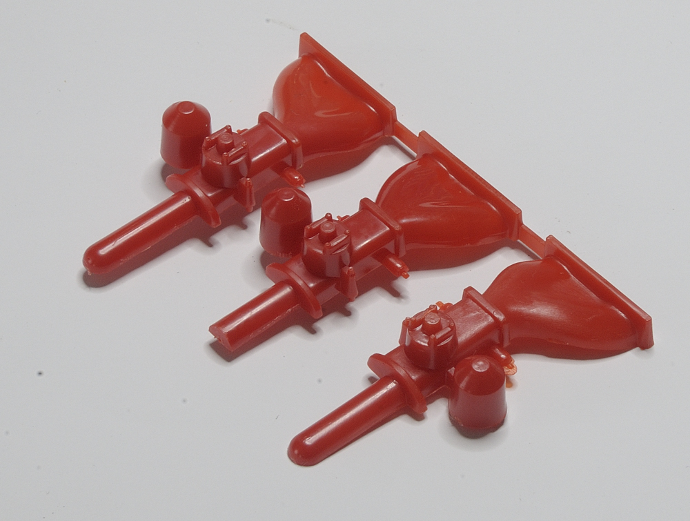

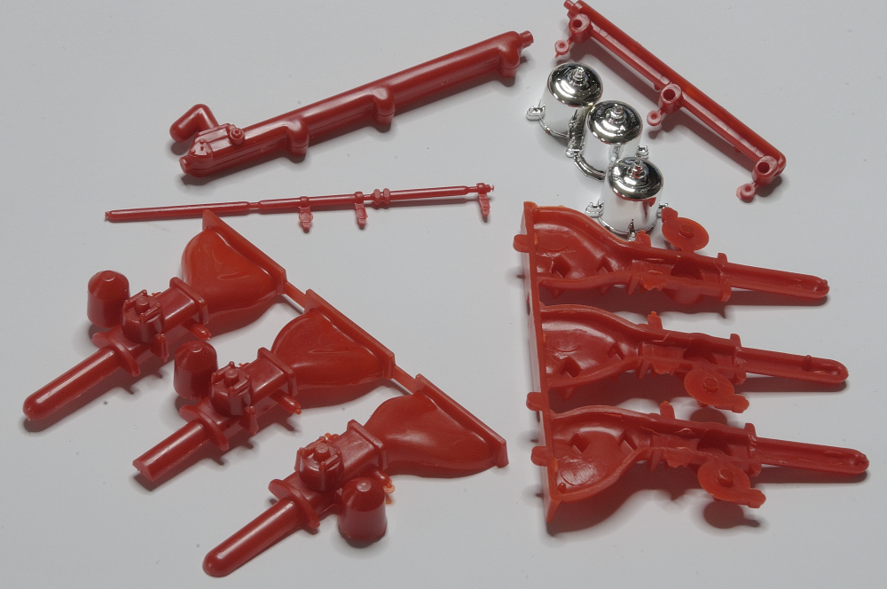

these are what you get.....
These are SU carbs, any one here who has had an MGB will recognise them, its a shame the carb is moulded with the manifold but i am sure we can do something about this.
the 2 halves joined and upside down.
I cain't wait to see what a professional such as yourself does with the crude carb's.

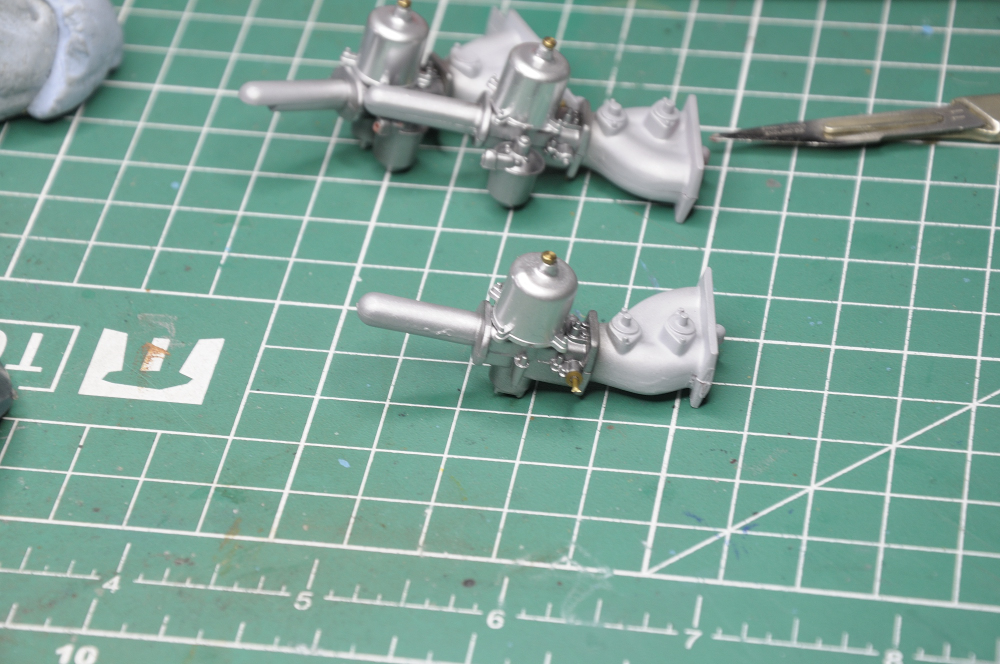

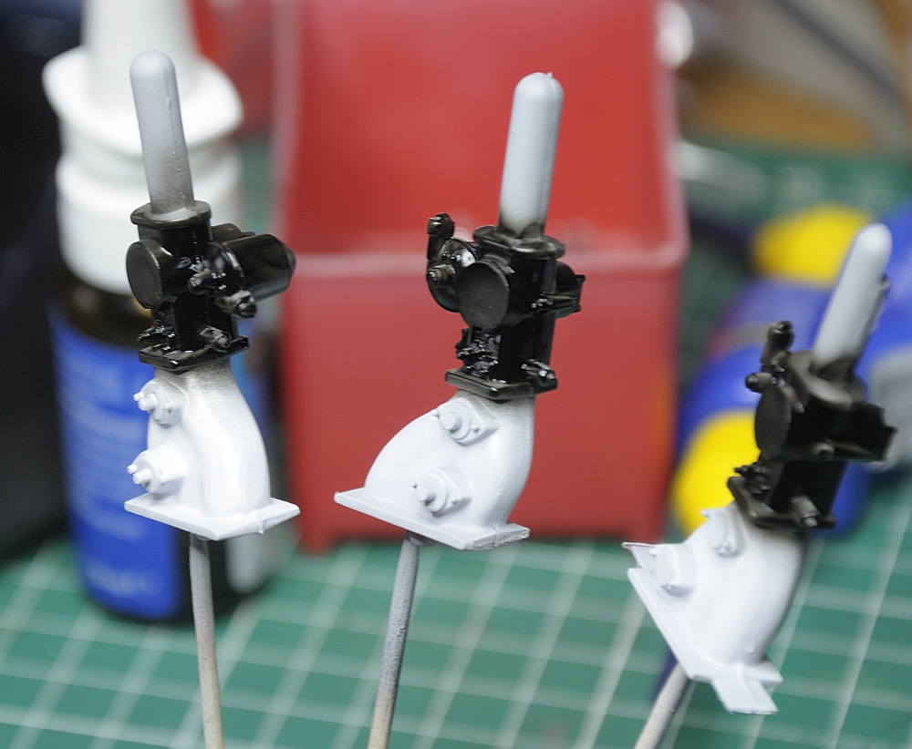

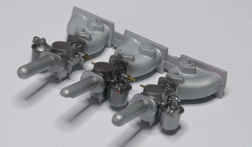

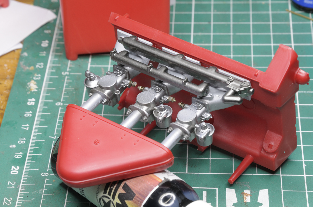

I decided to separate the carbs
I need to be able to drill into the sides of them and it also makes them easier to paint black and white
painting them black and white means when i spray the silver i get more definition between the cast manifold and the machined carb body
easier than spraying to different silvers
Note i have now drilled the carbs to take a brass throttle linkage as well

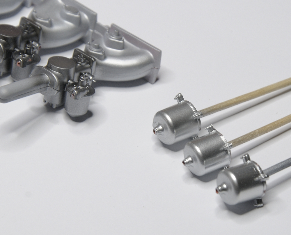

Dash pots were the kit chrome as a base and a fine coat of alloy spray as above

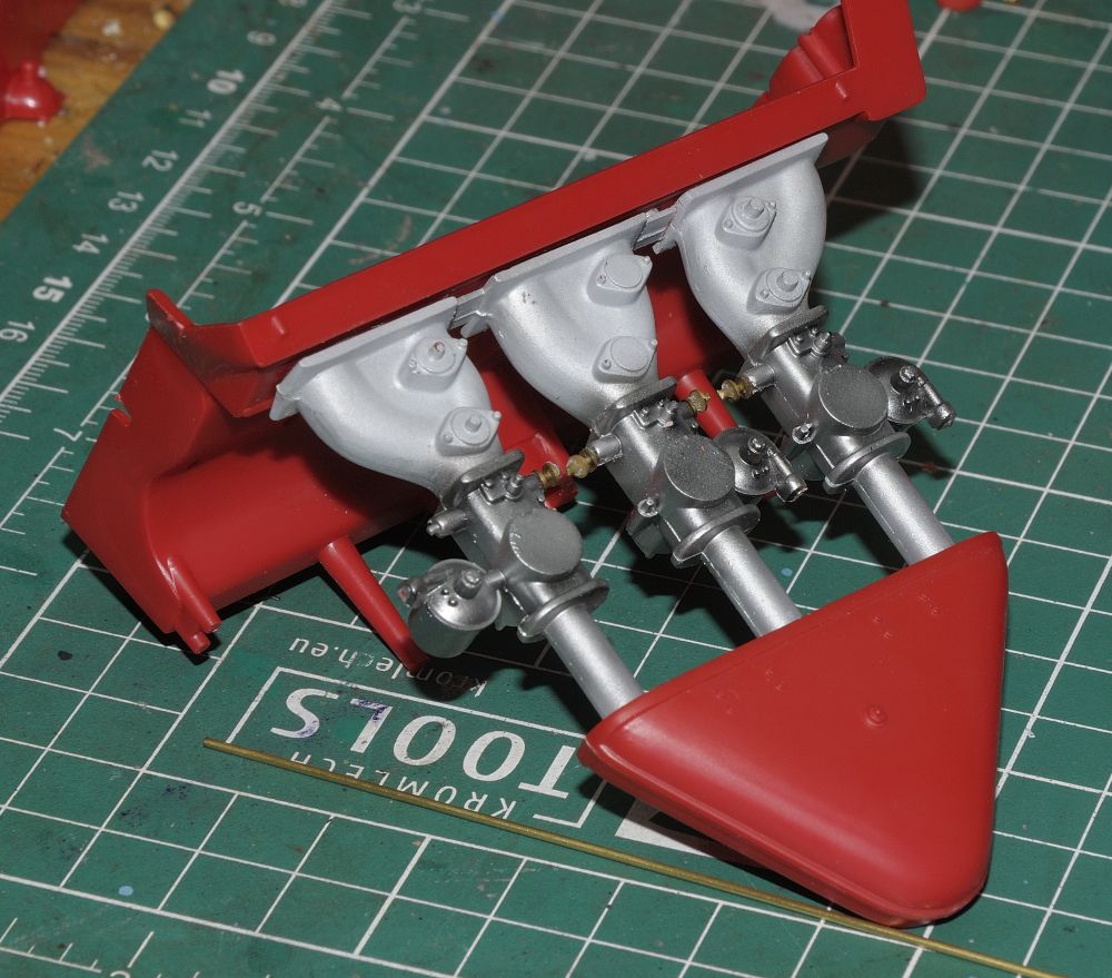

My problem now was getting the 3 carbs back in line having cut them up. here they are just balanced to gether
I used the air filter to get their position correct and just tack glued them to the engine block
this means i can attach the top pipe work again to hold the whole lot together again

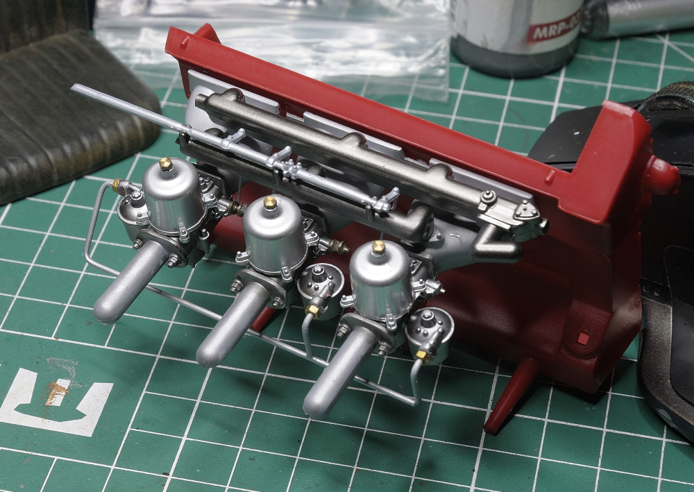

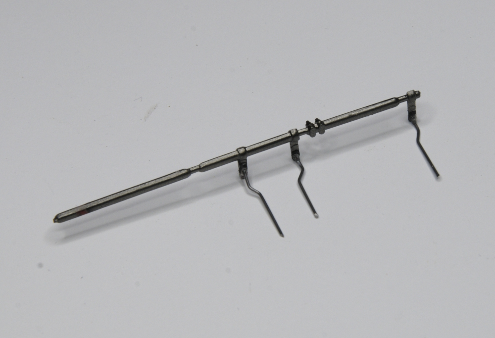

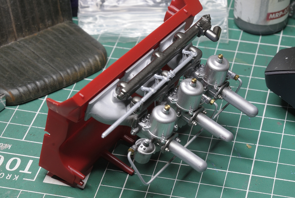

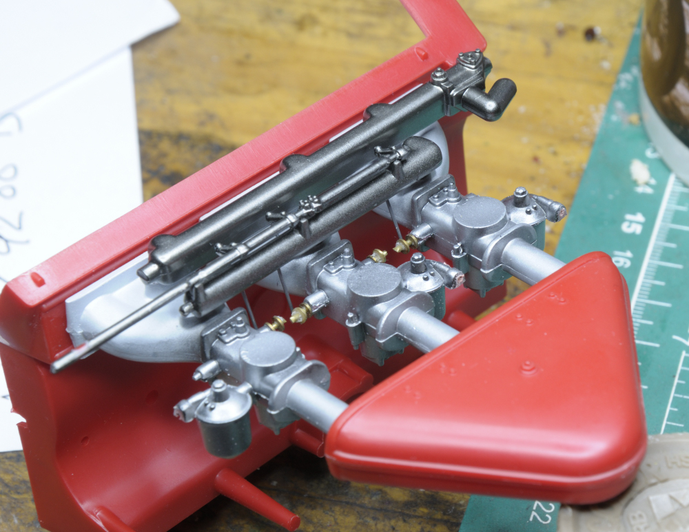

i made some linkages for the operating bar with piano wire
And fitted the whole lot together
Now i can remove the air filter and look at attaching some fuel pipes and clean up those seams. I thought the filter went up to the carb but it doesn't so you can see those seams on the inlet trumpets

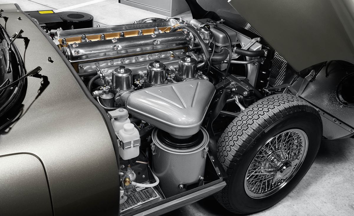

Lots of differences here, from my 65 E-Type. I remember the throttle linkage being under the manifold, and the water manifold was different. This photo looks like what I remember. The fuel lines were attached to the float chambers with banjo fittings, and if you need it I still have a key for mine.
Hi John
The Revell kit is a 1963 3.8 litre, by 1965 they were 4.2 litre with quite a few changes like the throttle linkage and air cleaner.
This is a 3.8 with the top throttle linkage and the smooth airbox although i do concede i have got the fuel connectors wrong.
The problem is, rather like spitfires, finding an original; Mk1 set up 85 years on to copy is much like finding a 1963 Mk1 3.8 jag to copy 65 years on :)
The above picture is pretty close though

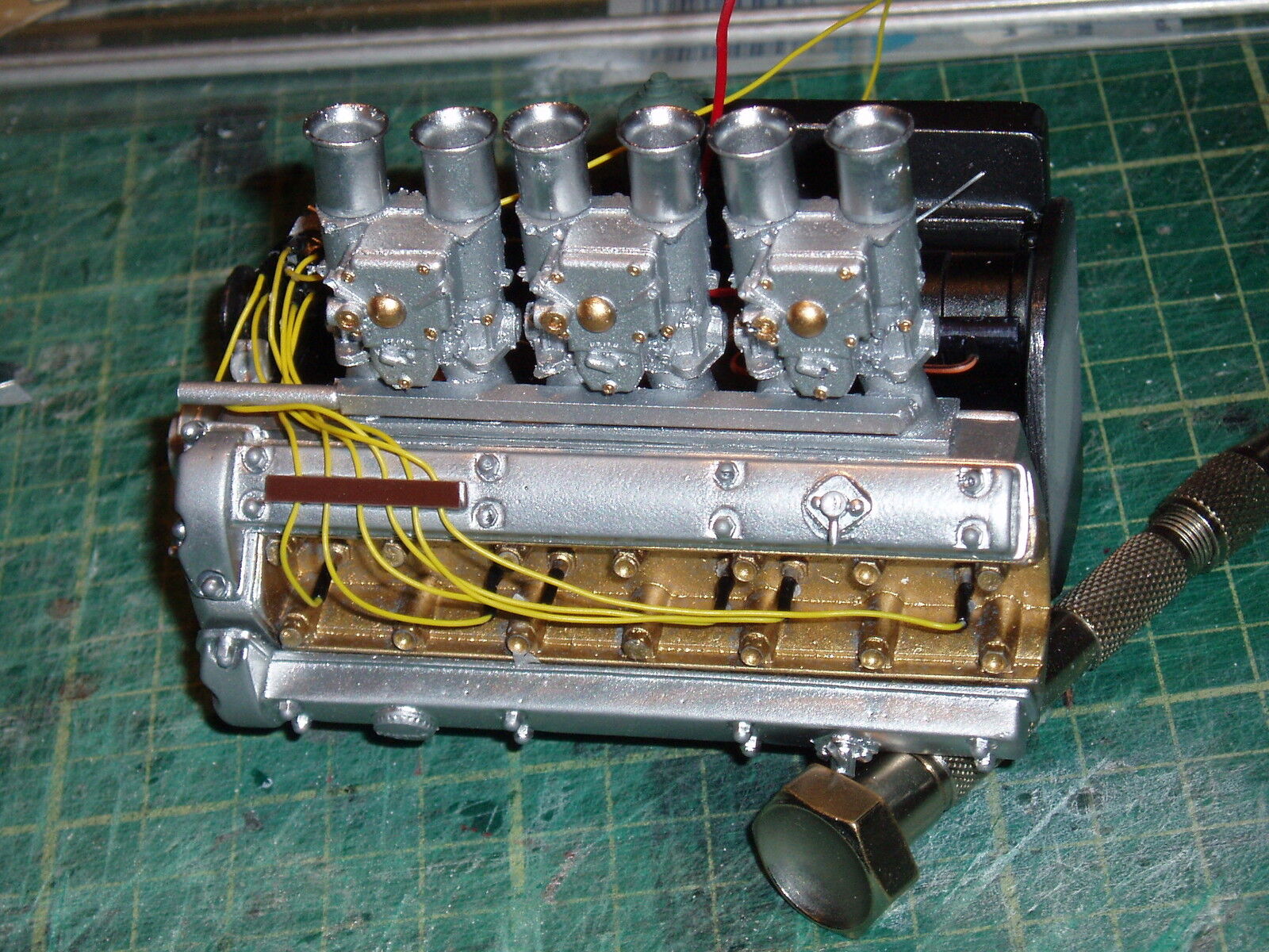

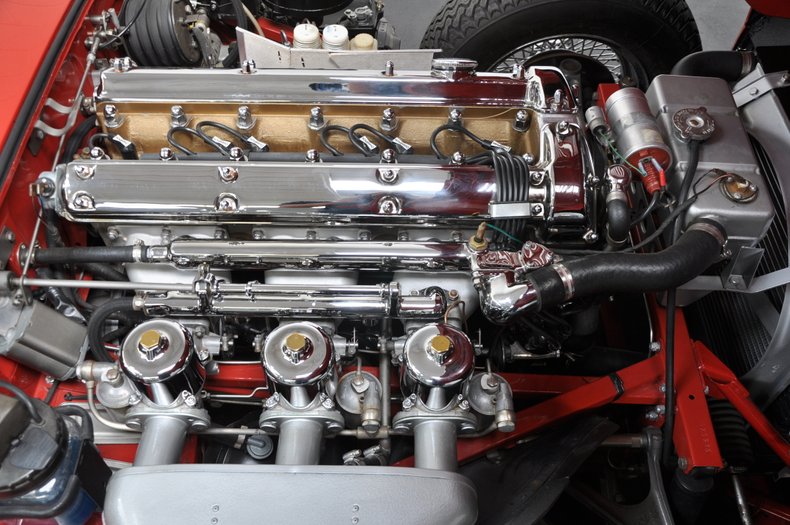

Nearly all the other Revell jag builds like this i have seen have triple Weber's like below because the kit SU.s are actually under size
I don't think it really notices and not sure replacing a slightly undersize set of carbs with a completely wrong set is really the answer (wrong as in not factory fit)

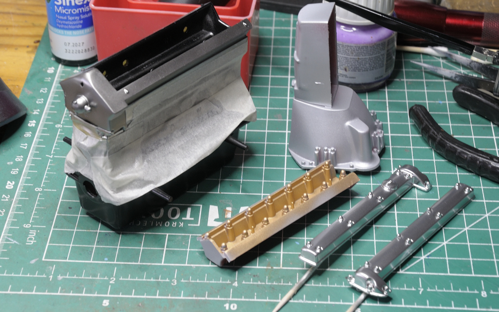

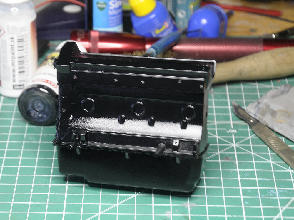

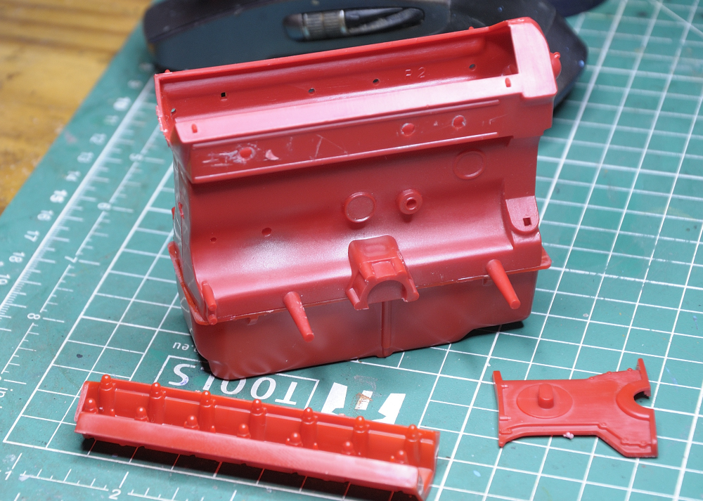

I made a start on the engine which once again is pretty basic
I thought a coat of black might inspire me
Then masked off the head which is not a seperate part , gave the top of the head a coat of gold and gave the ultra shiny chrome rocker boxes a coat of silver to tone them down a bit ( may need a bit more as they are just alloy not chrome.
Managed to find a proper Lucus label for the dynamo :)
