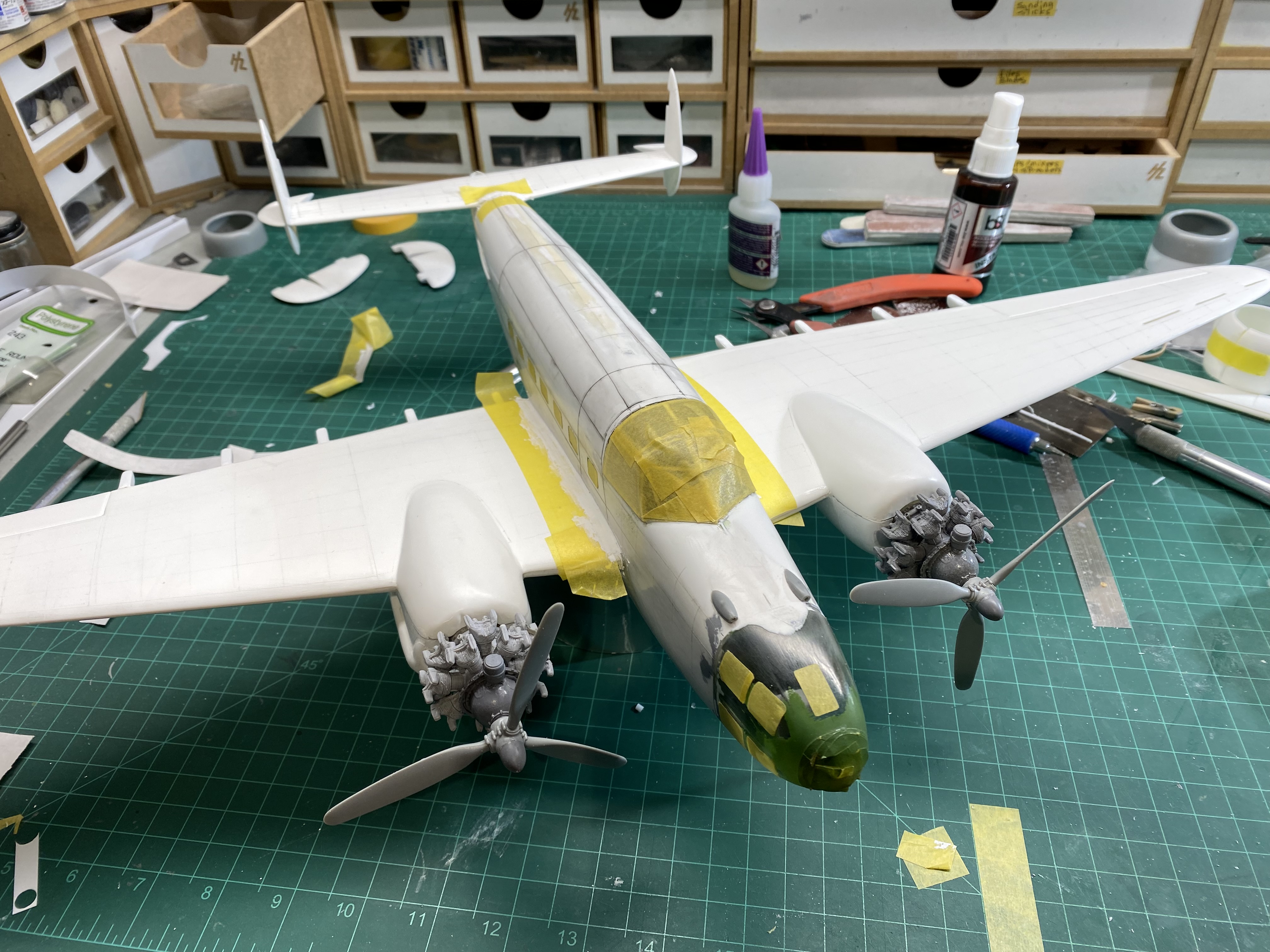

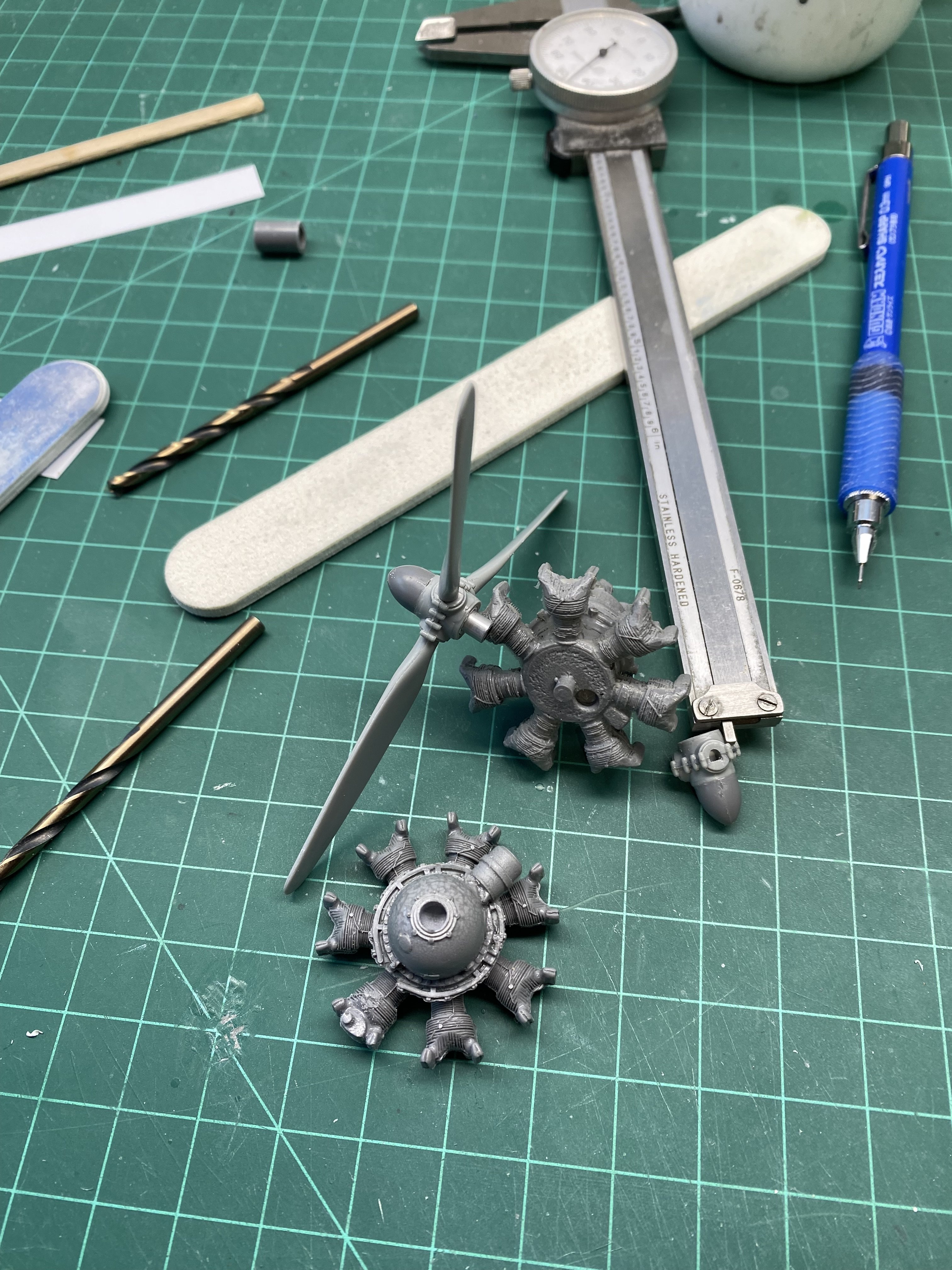

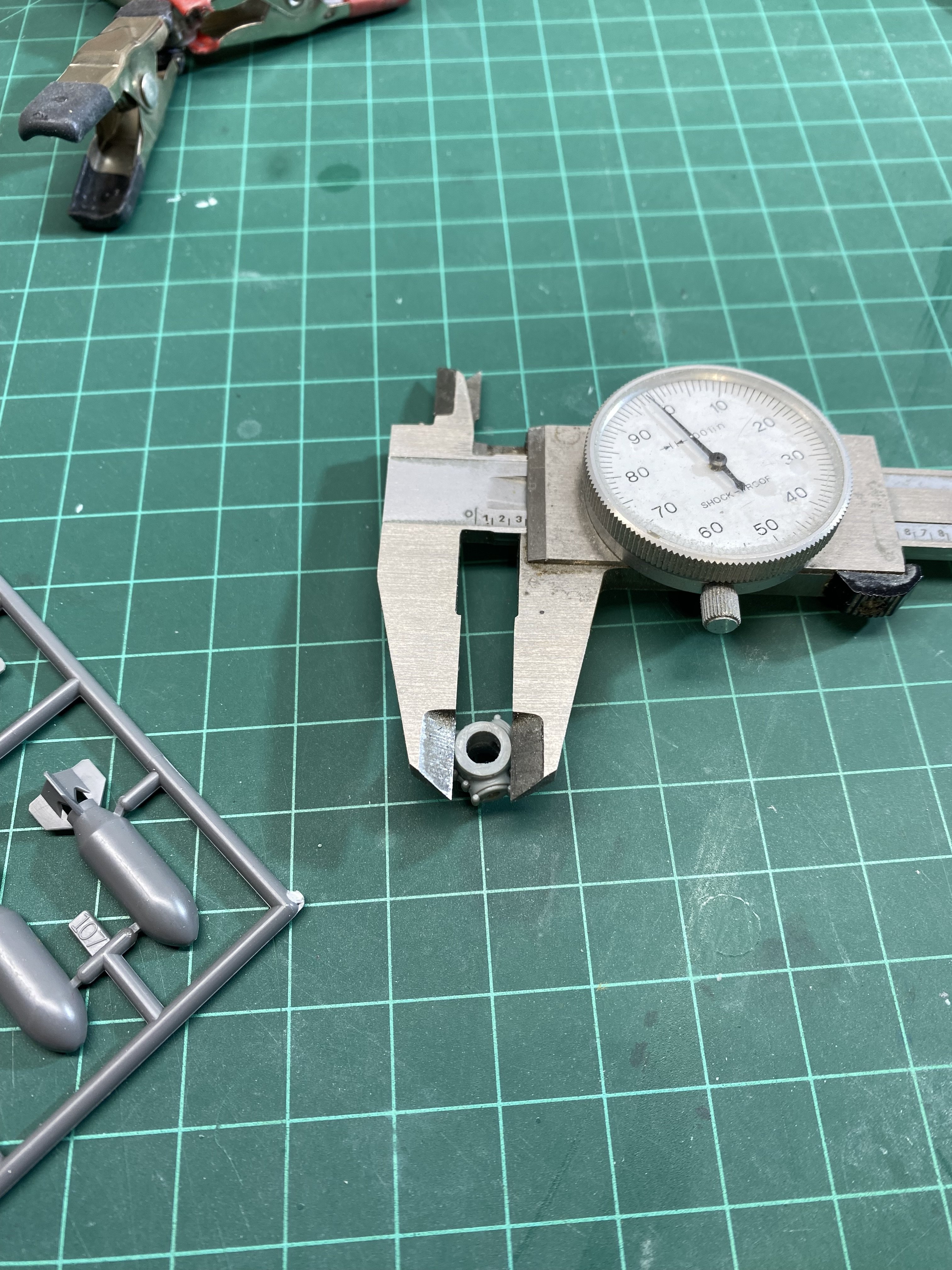

I've made up some props using spare hubs from a HK Models B-17 and 1/48 bomb noses, prop shafts from telescoped aluminum tubes to make all the bits compatible

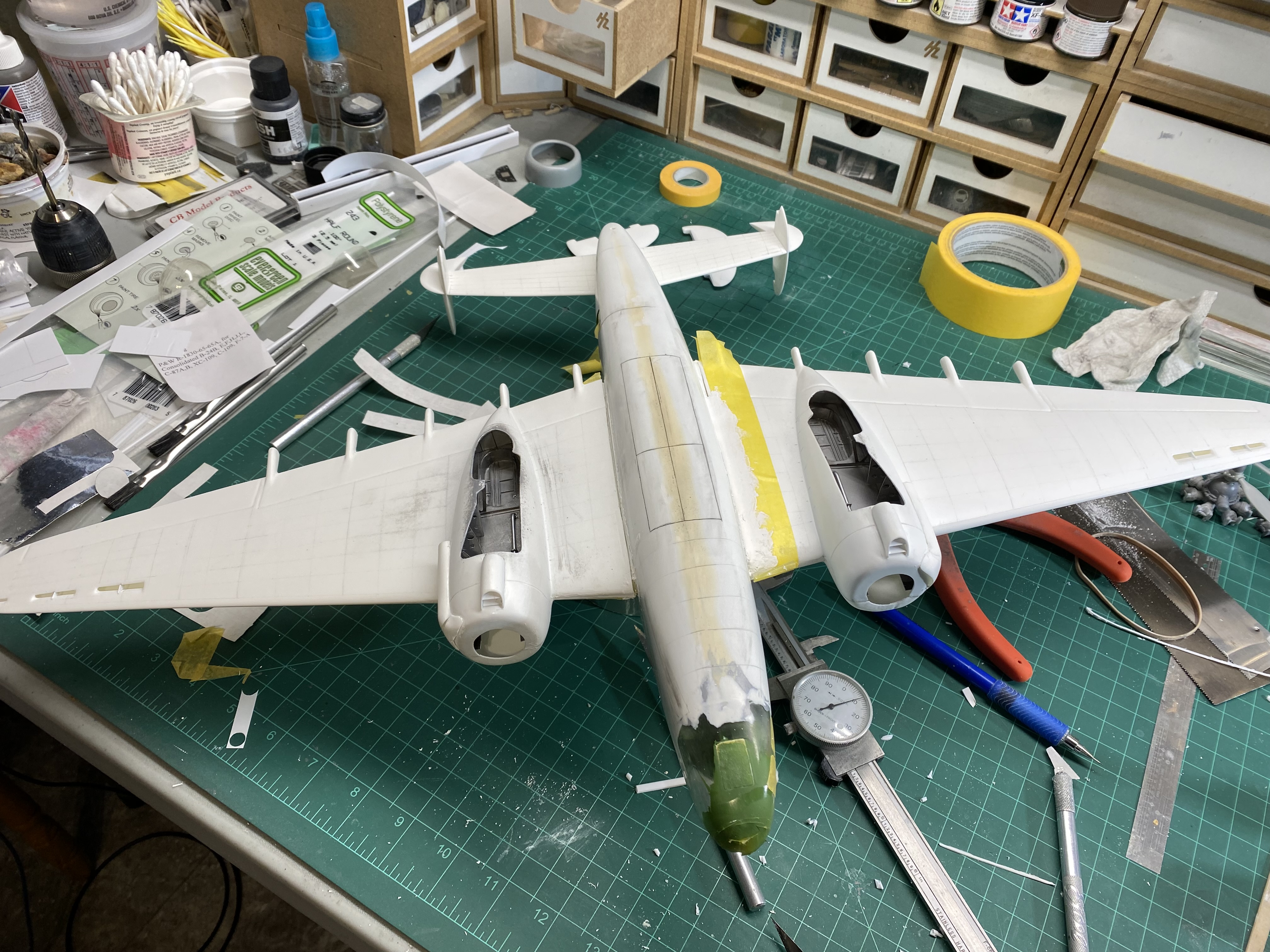

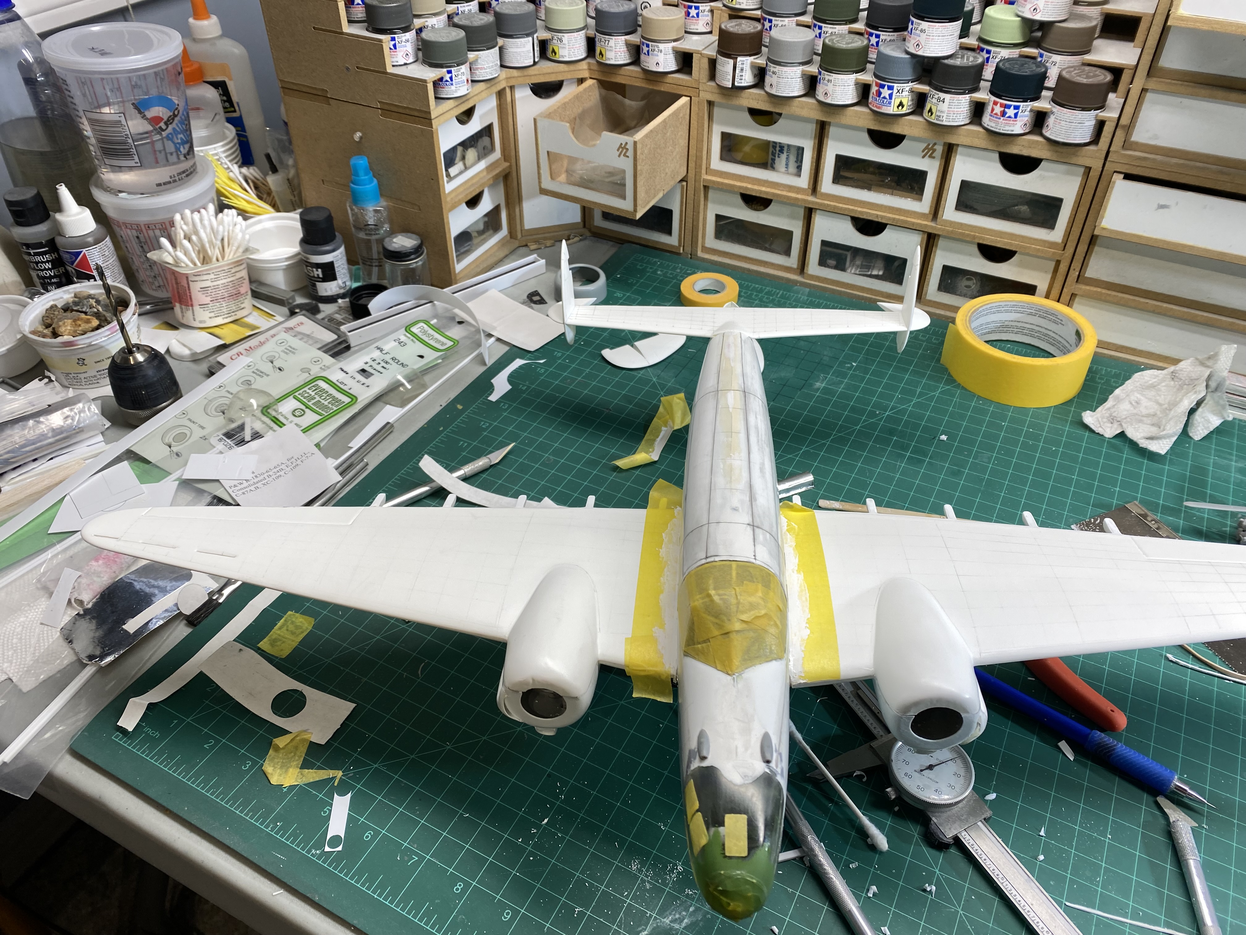

And fitted the wings...sounds easy when I say it that way. Well I had the wings fitted and was sanding seams when I decided I couldn't live with the lopsided dihedral (I knew about it earlier but thought I could live with it..Nope) I had to break the seam on the bottom of the left wing to force it down but ended up needing to finally break the wing completely off the model and remove about 2mm from the lower in order to get the wing tip down and even with the right wing. Now that's all done, filling and sanding is back underway.

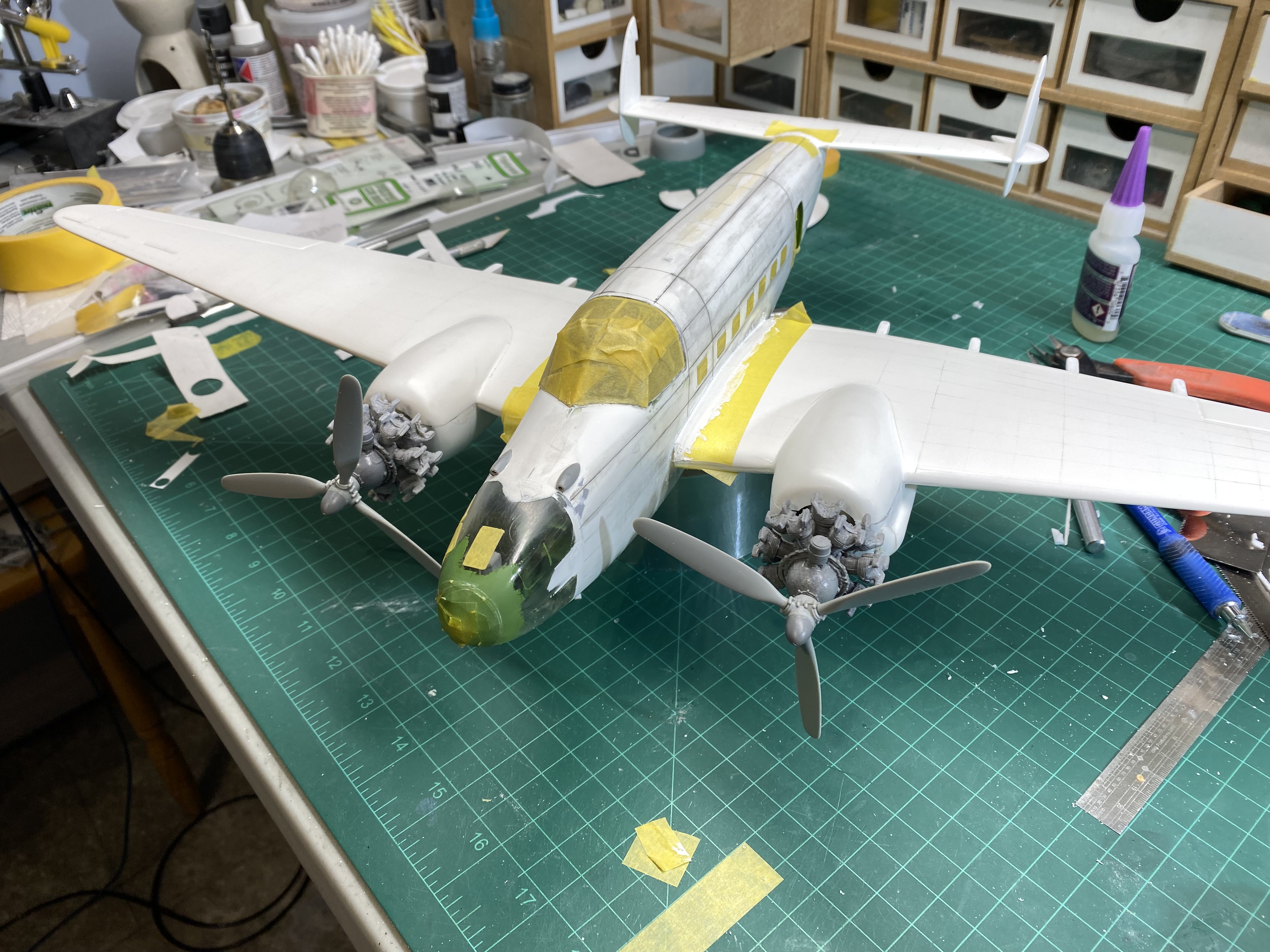

and now I've begun work (while the tamiya putty sets up) on the engine fitment
Thanks for looking

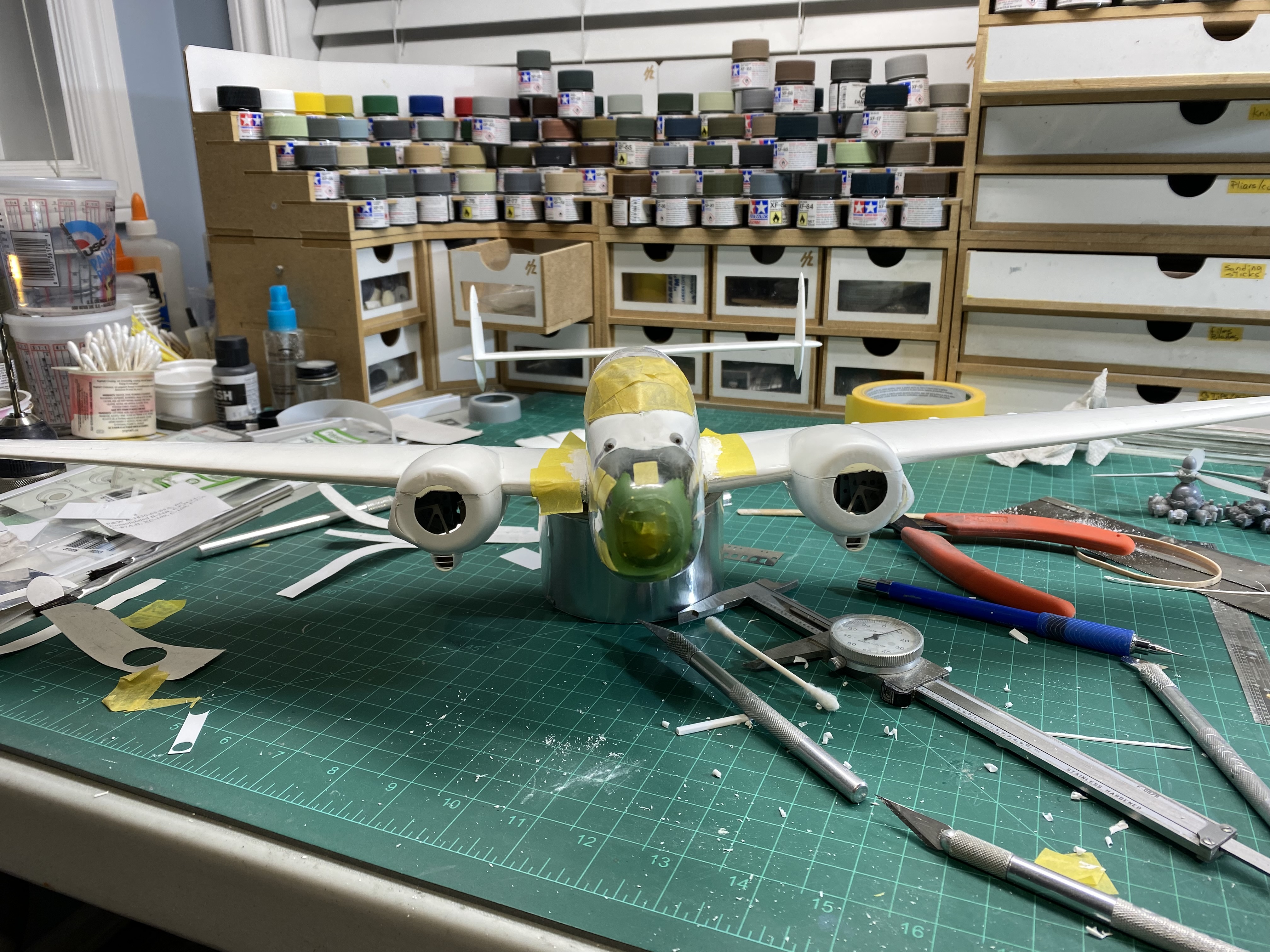

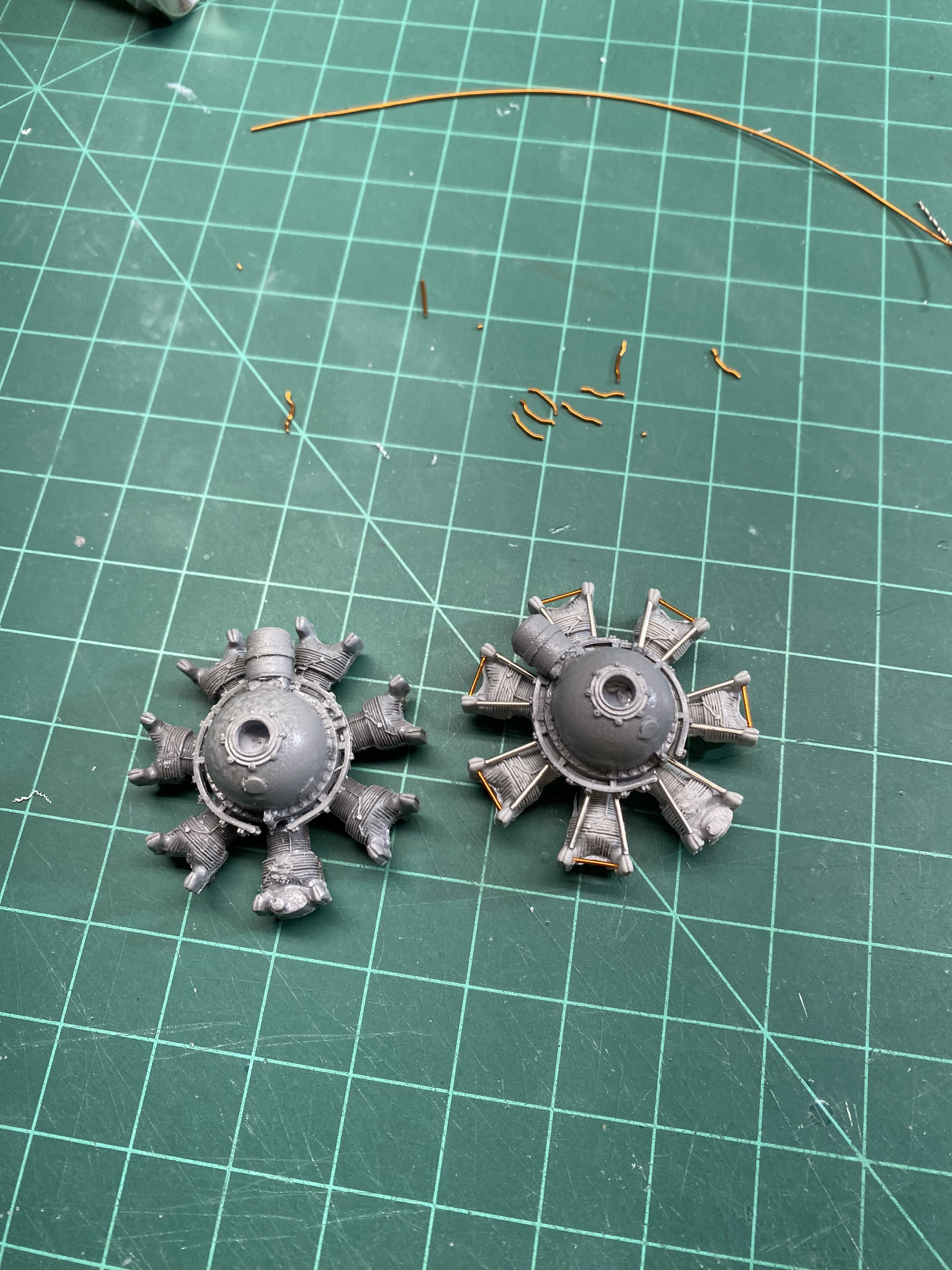

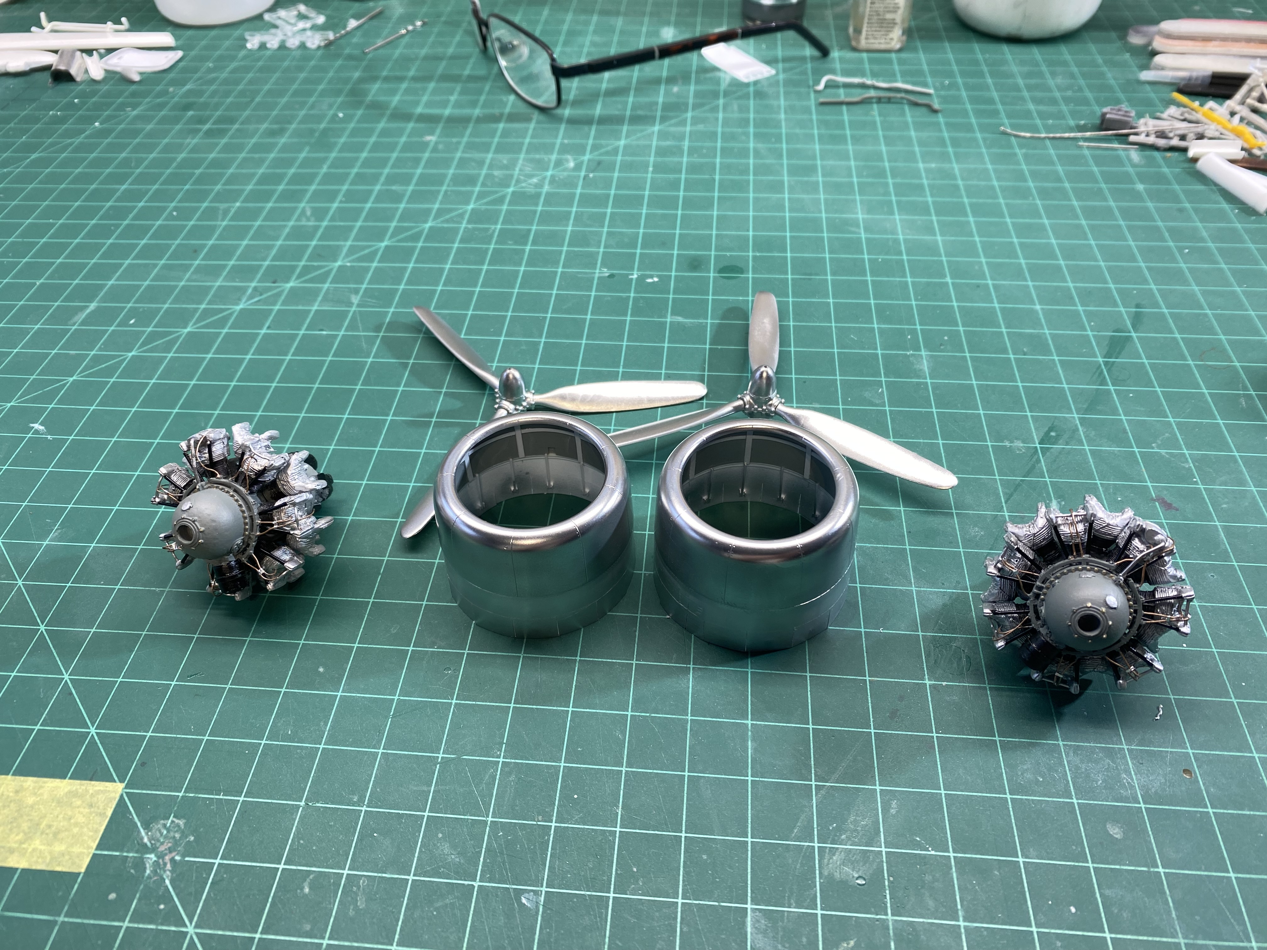

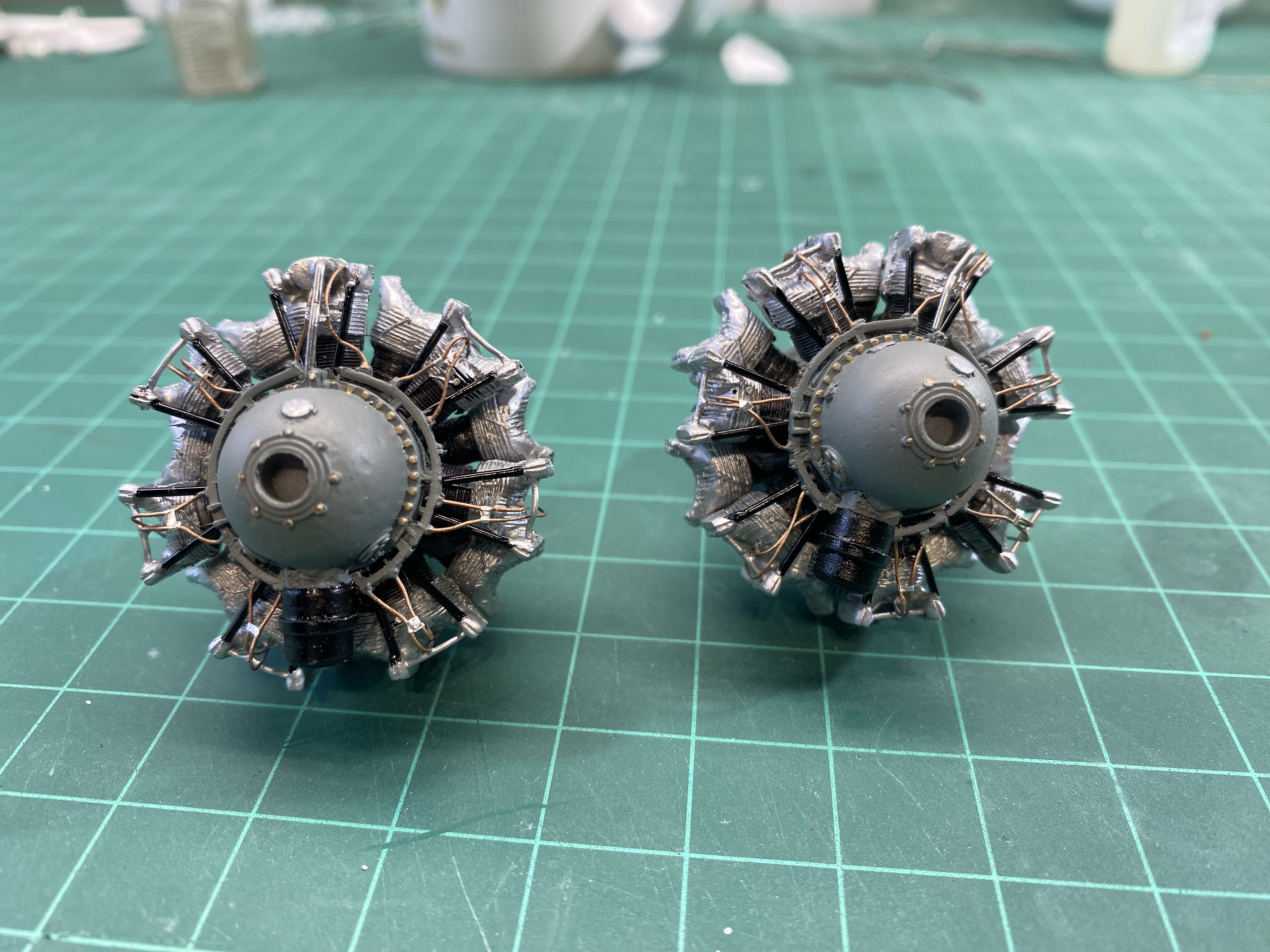

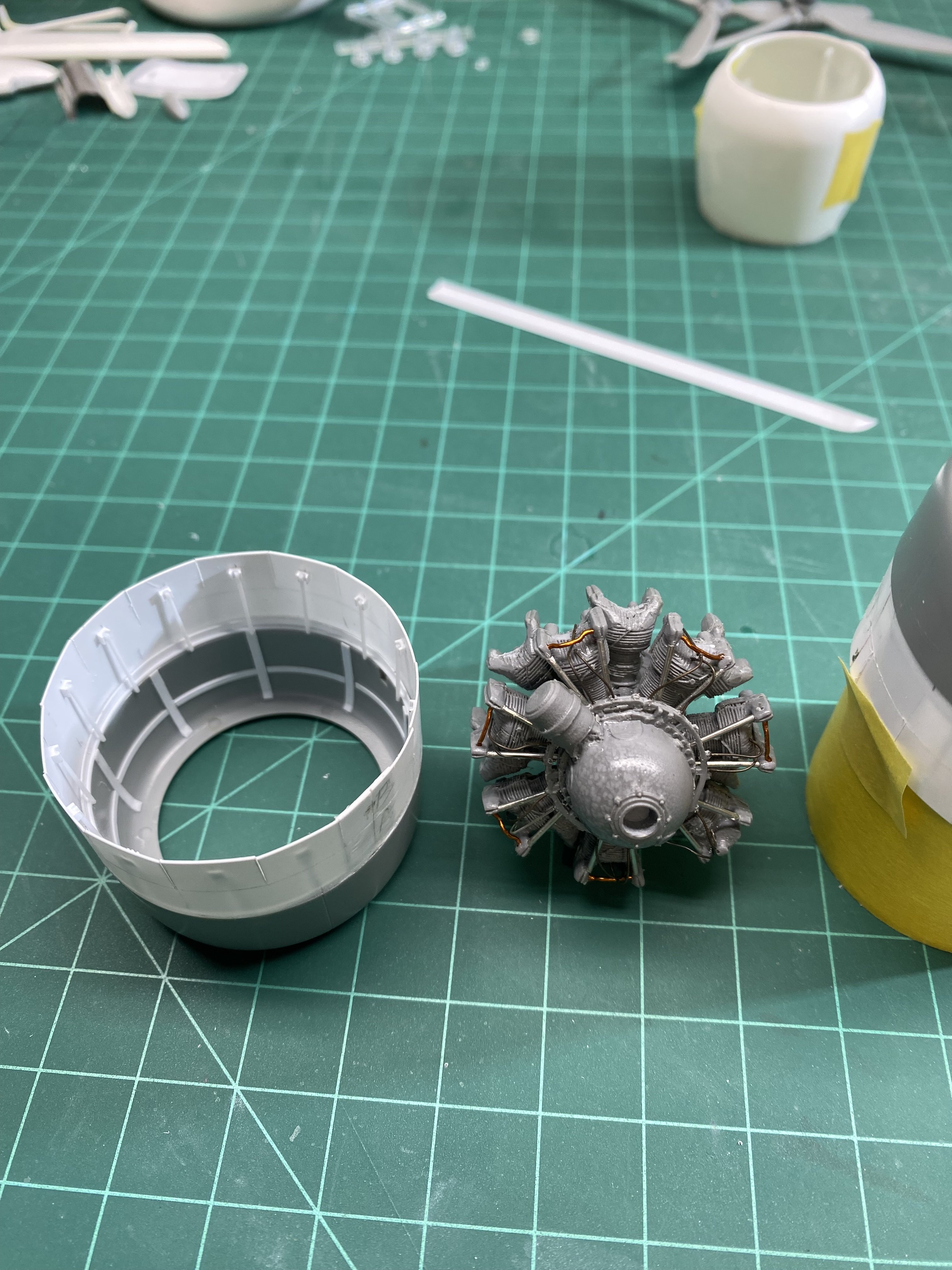

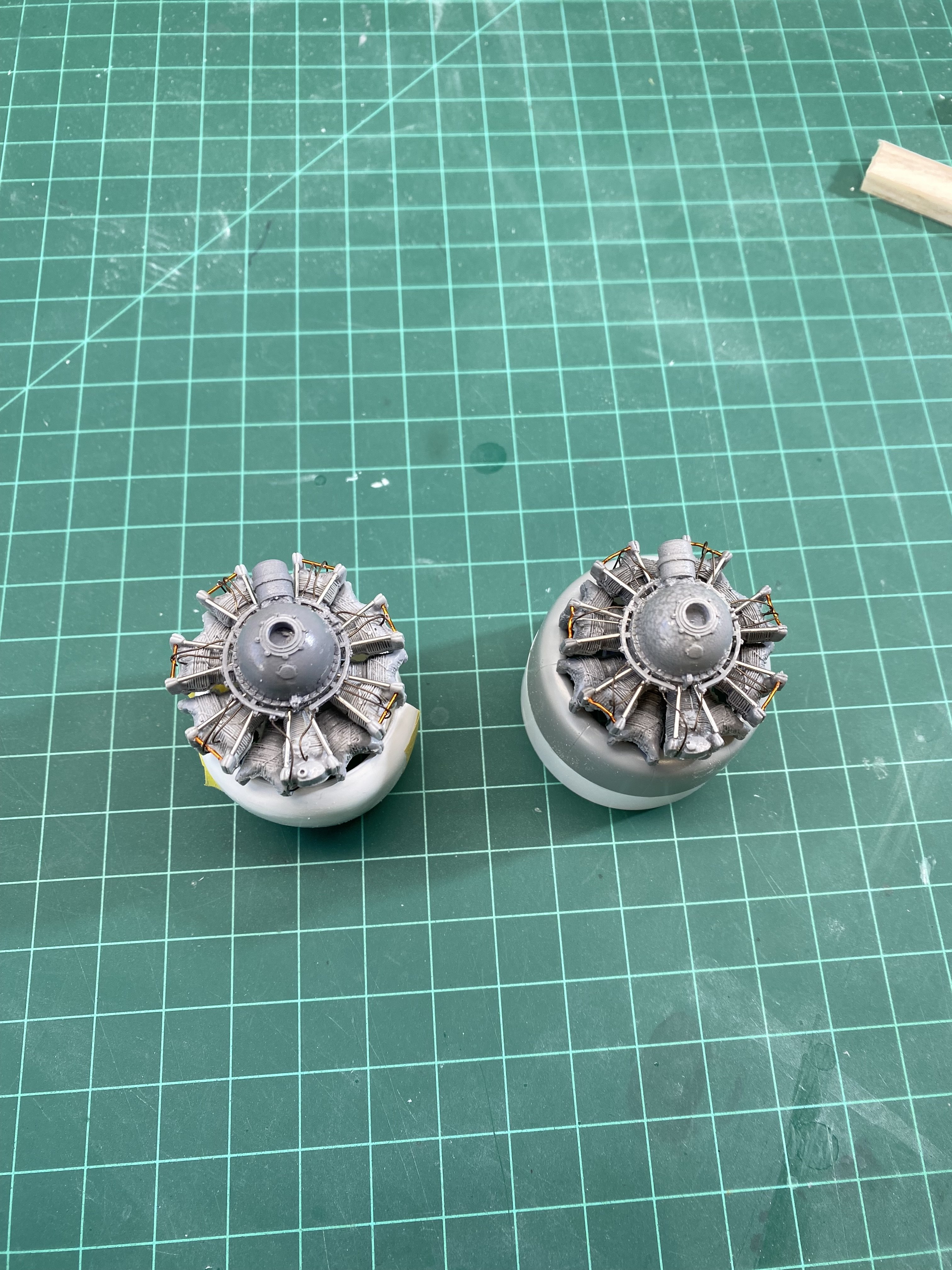

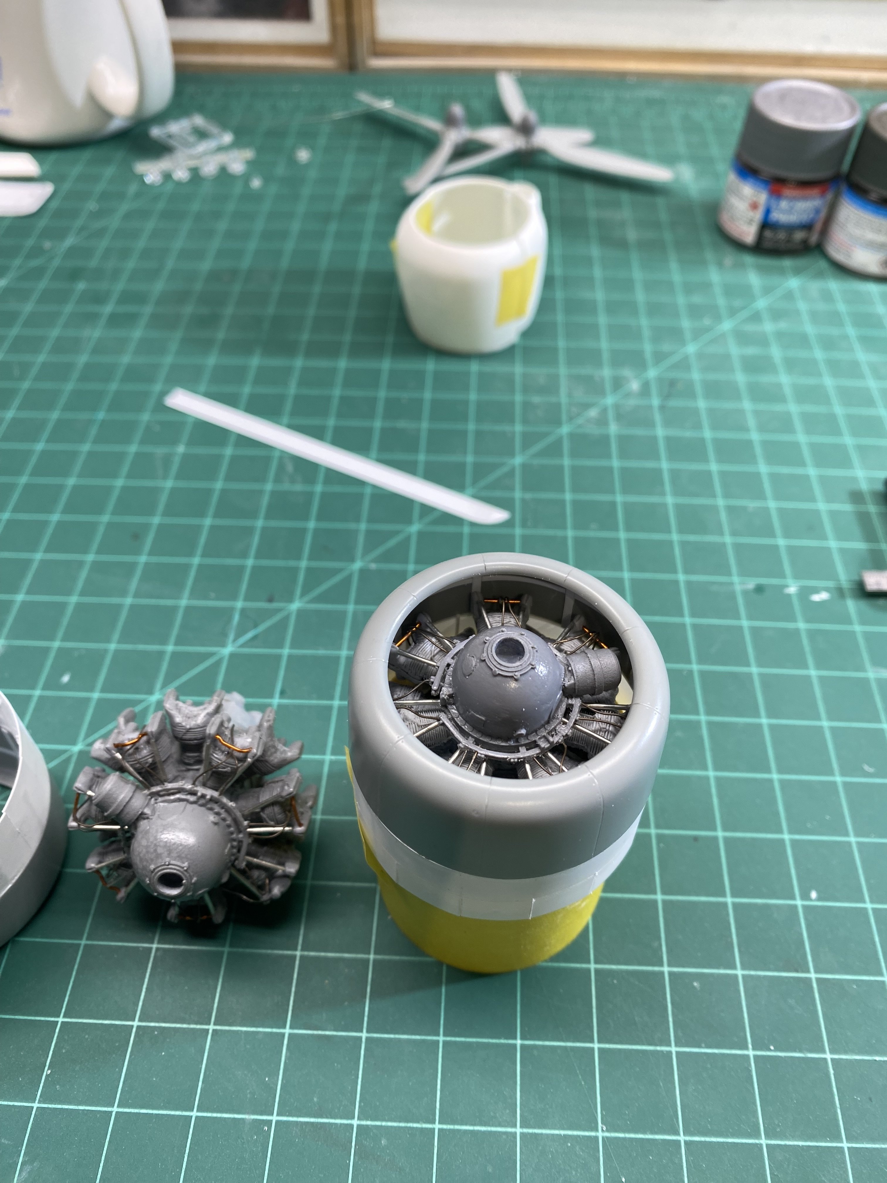

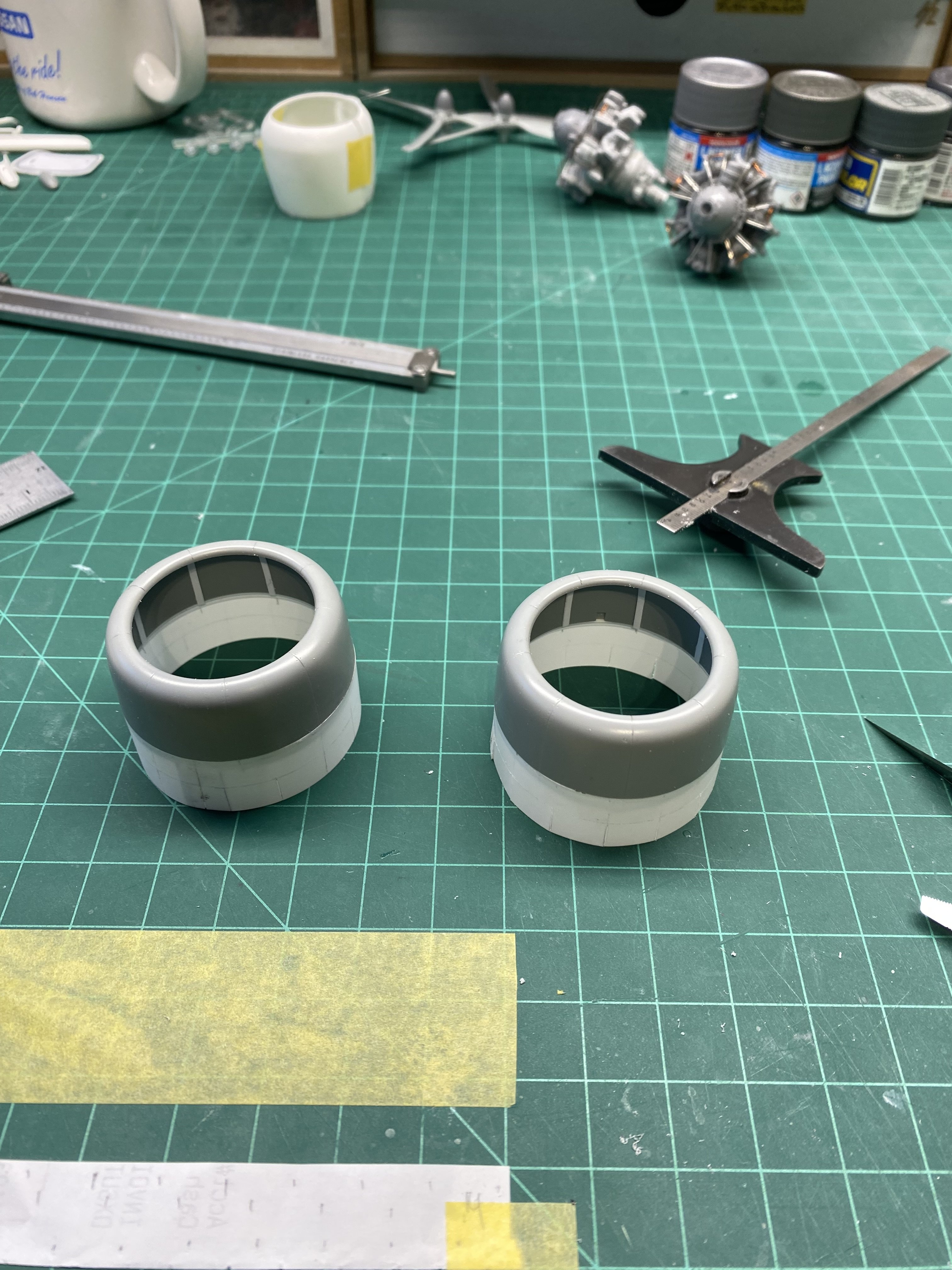

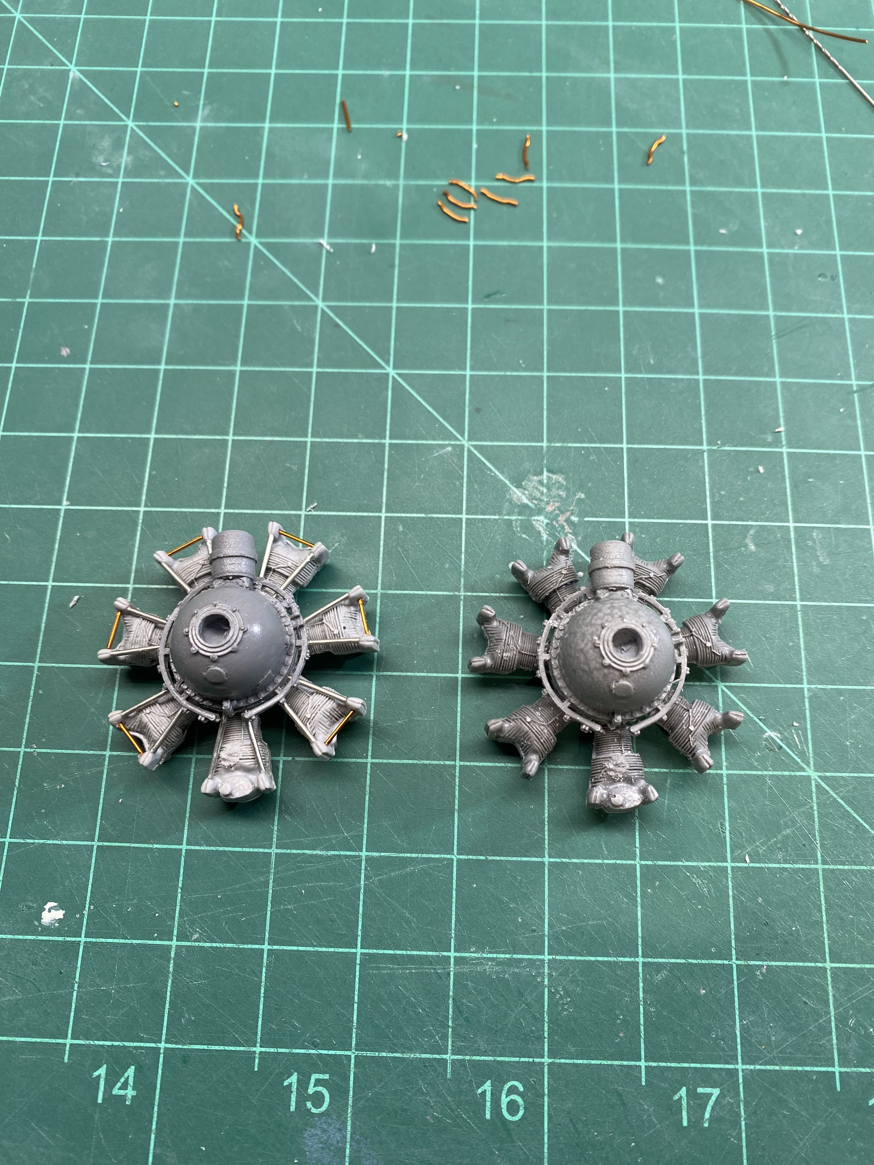

I spent the last couple of days working on the cowls and have decided I'd like to try fitting the B-17 cowls to the model (but haven't washed up the kit cowls as yet either) so I've gone ahead and added (purely fictional) details to the cowls to improve the fit (and to help centre the engines in the cowls) so to that end, I've added cowl flaps to a strip of .010" small pieces of channel and some rod and strip to the insides of the cowls, wires and rods to the engines...may look ok under paint
Thanks for looking

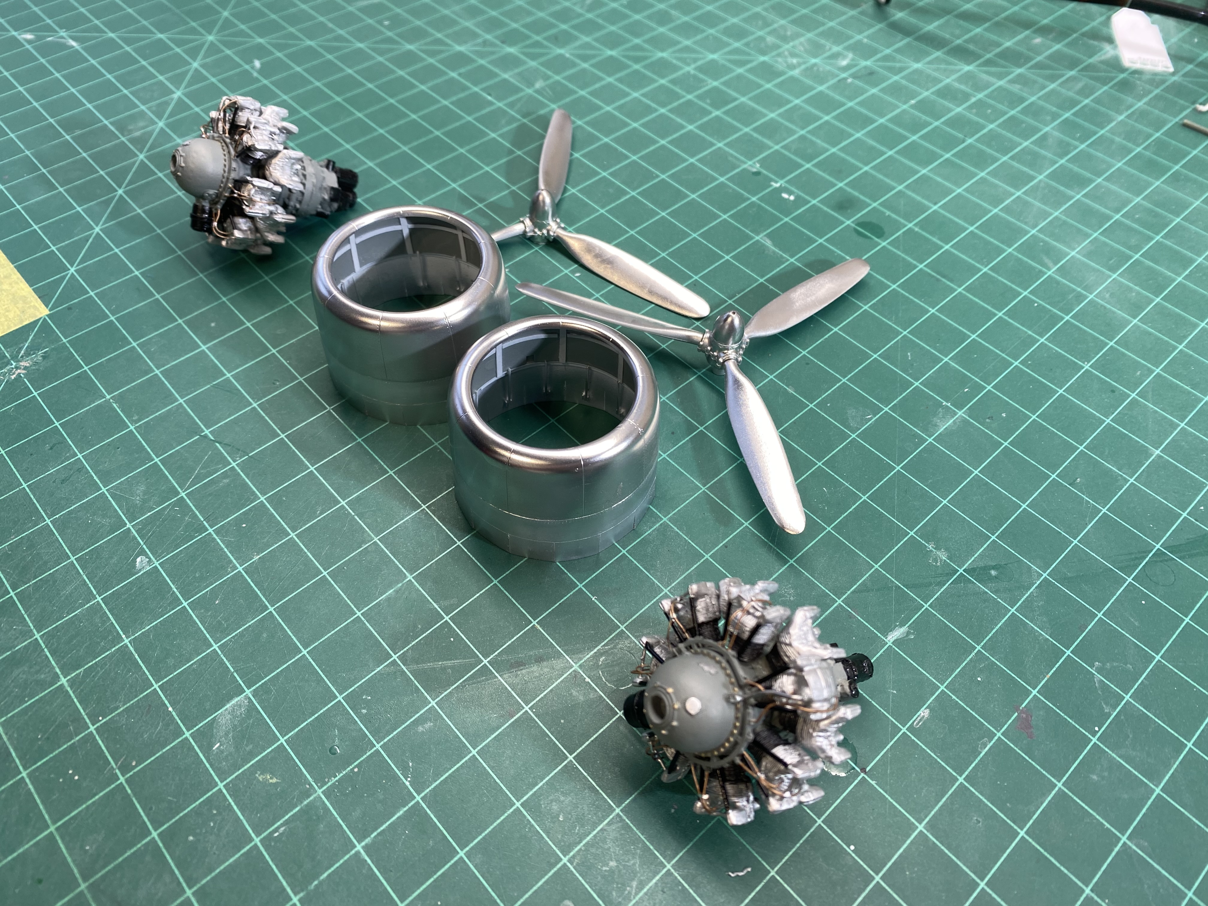

I've put some paint on and, finished construction of the Pratts and, added some Alclad "Airframe aluminum" to the cowls and props in the hopes of weathering the paint into the aluminum...somewhere down the road in the future.
That's all for now
Thanks for looking

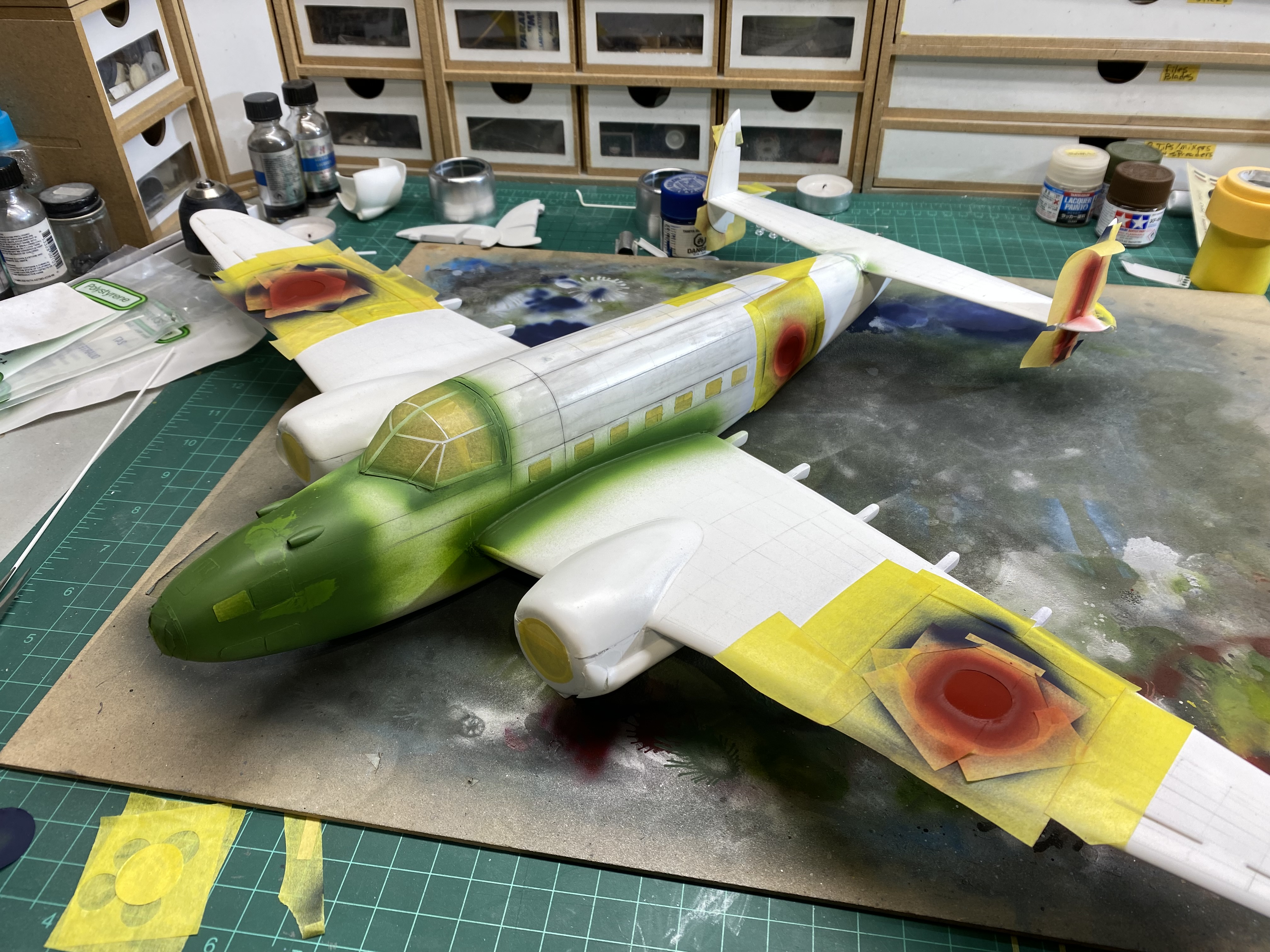

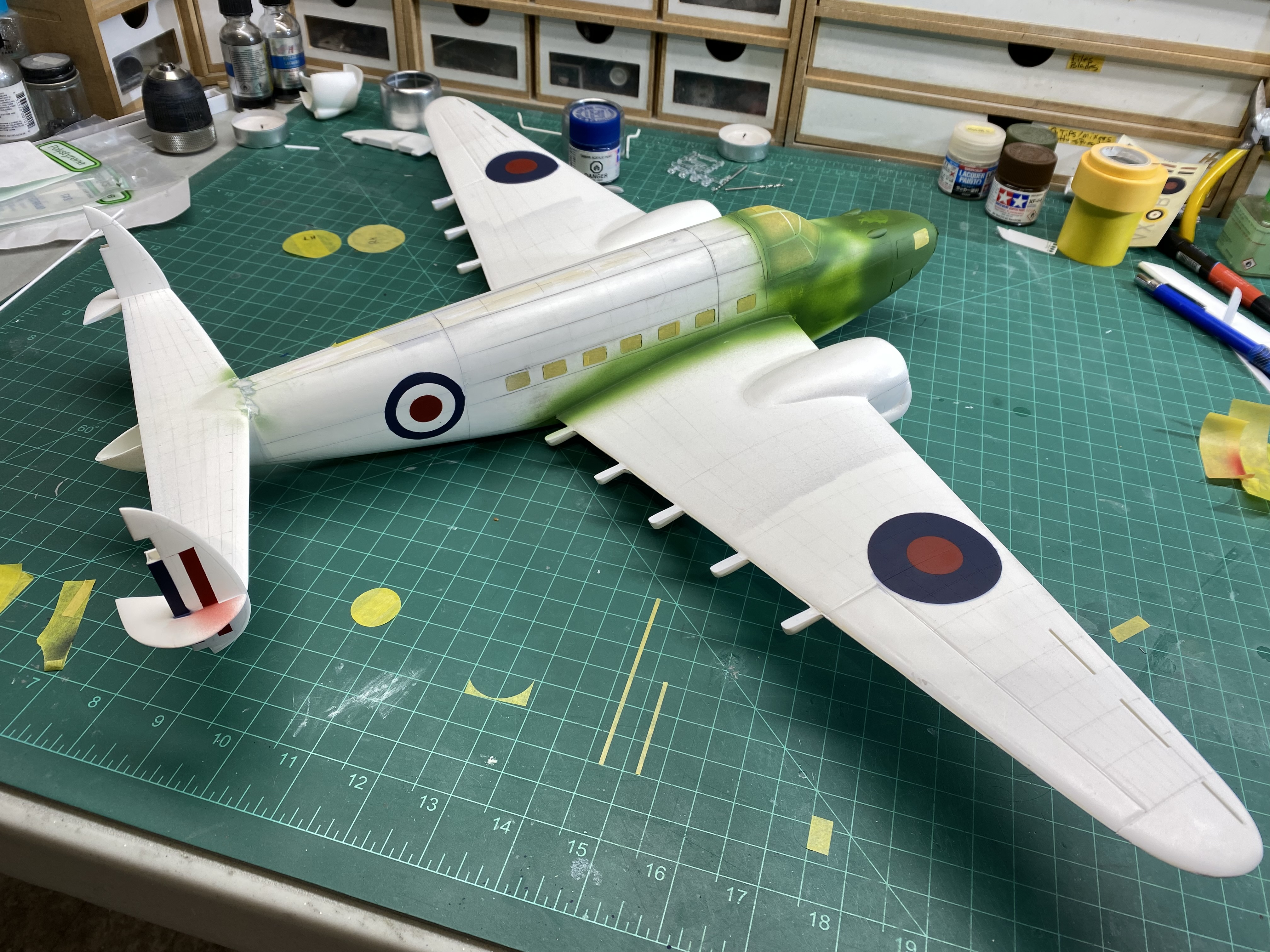

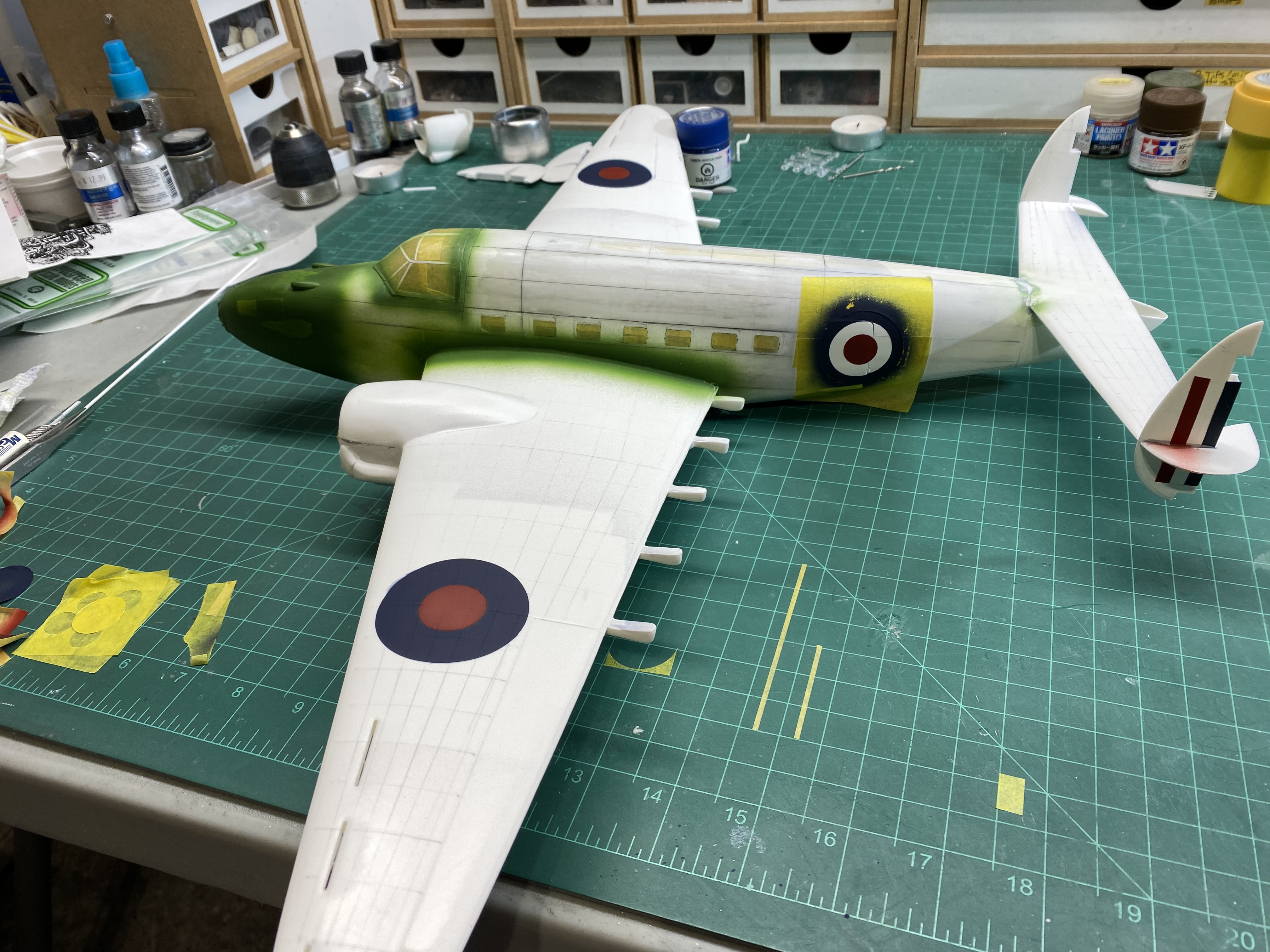

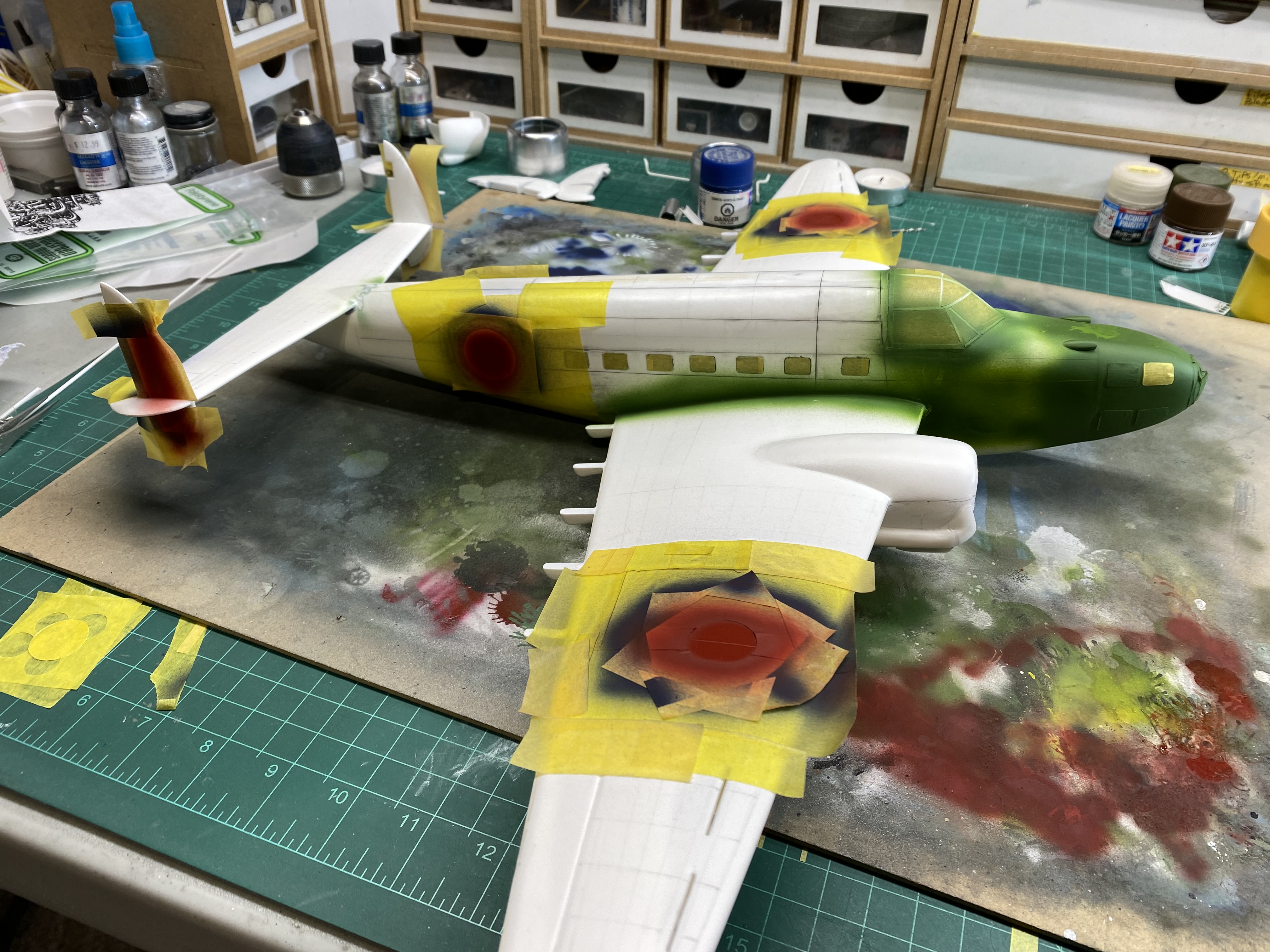

Having scratch built most details it seems a little off to use decals for markings so, with that in mind I've begun adding the roundels. The markings are mostly done now and the roundels can be masked and camouflage painting can now be added.
In my opinion, the whole reason to build models...paint them.
That's all for now
Thanks for looking

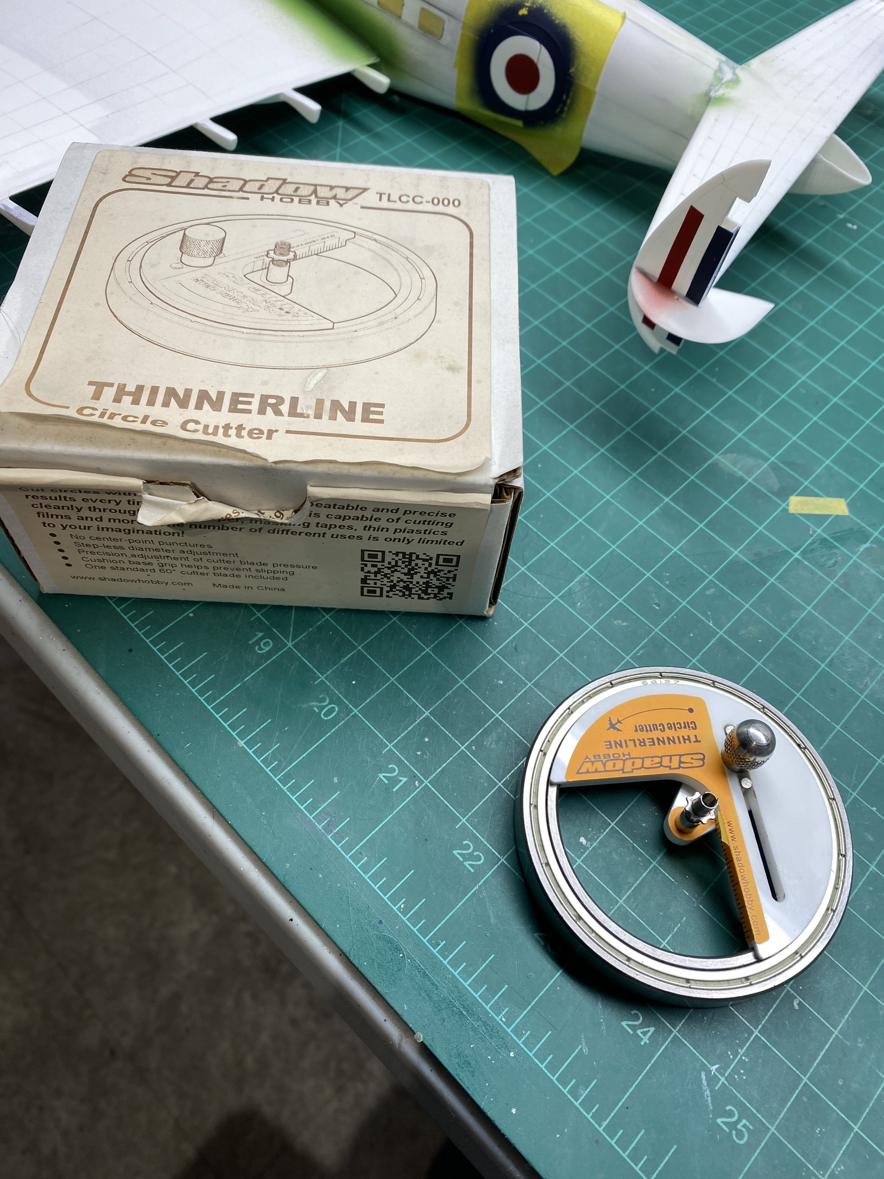

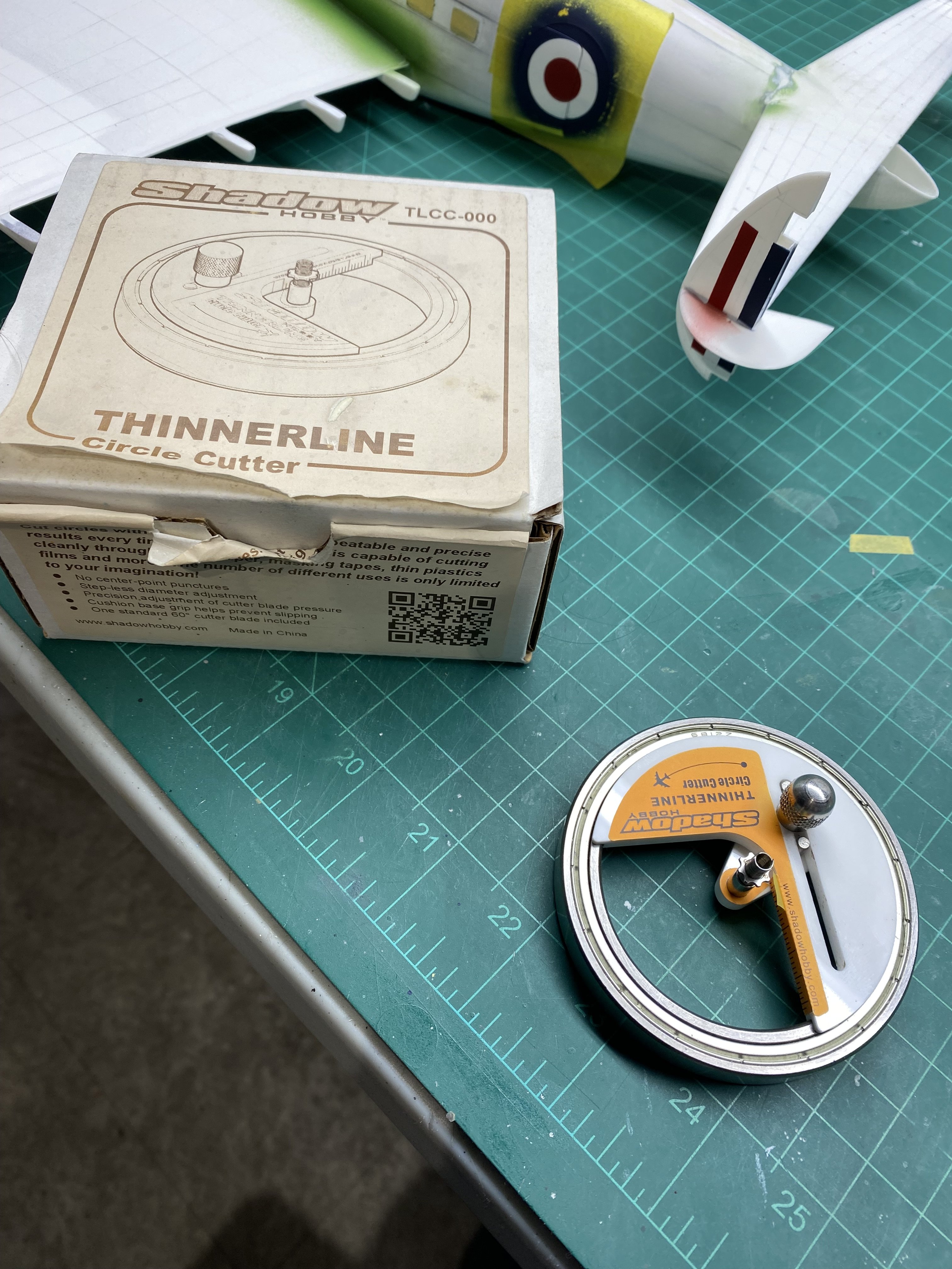

Do you have a method for cutting circles or is it just good old scissors ?
I use a "Shadowline" circle cutter, like a bearing and race with an adjustable knife attached. The knife is adjustable on a slide of 1.5" so it can cut up to a circle of 3"
As well, I also use a compass cutter. The compass cutter is great for overlaying concentric circles because each circle has a small hole from the pivot point that (if careful) can be aligned with a pencil point or pin to a previous center marking.
Here's the Shadowline;
cuts perfect circles but impossible to cut concentric circles as you never know where the center point of each circle is.
when cutting small pieces of plastic, the blade can/will grab and fold the plastic and/or tear it, the piece being cut needs to be taped to the bench or be large enough that the outer ring holds the whole piece being cut down

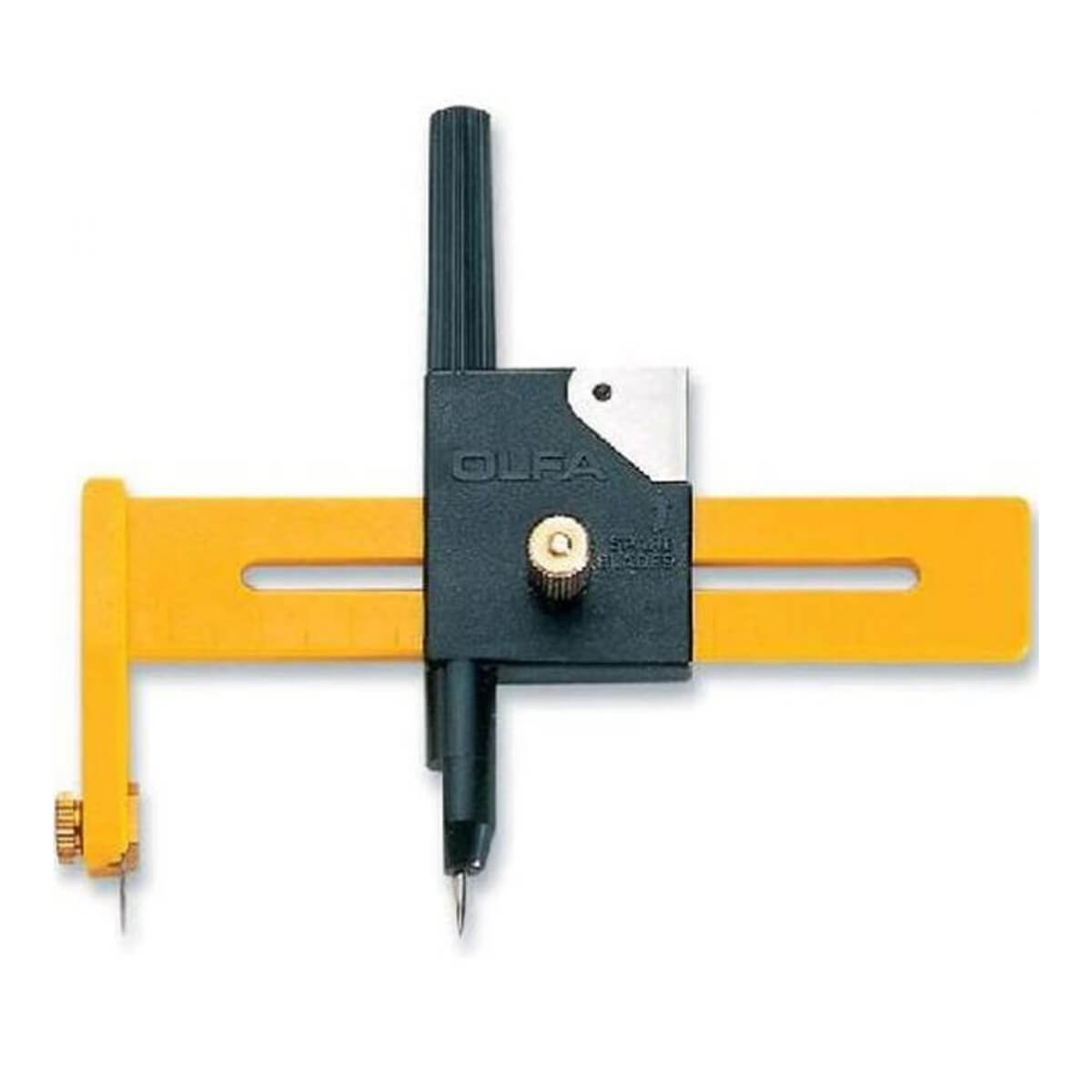

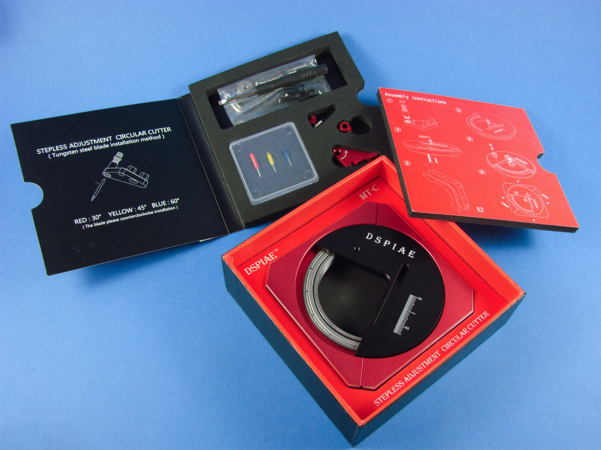

Seems very similar to this one (which I thought was overpriced):
Reviews post out exactly the same limitations you noted. Thanks @chrispisme!

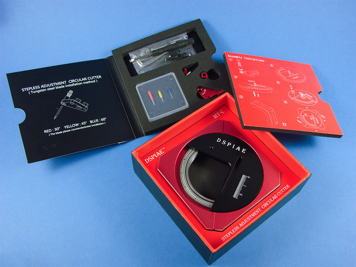

Same here about the compass but then had an upgrade to this prior to buying my Cricut Maker:
