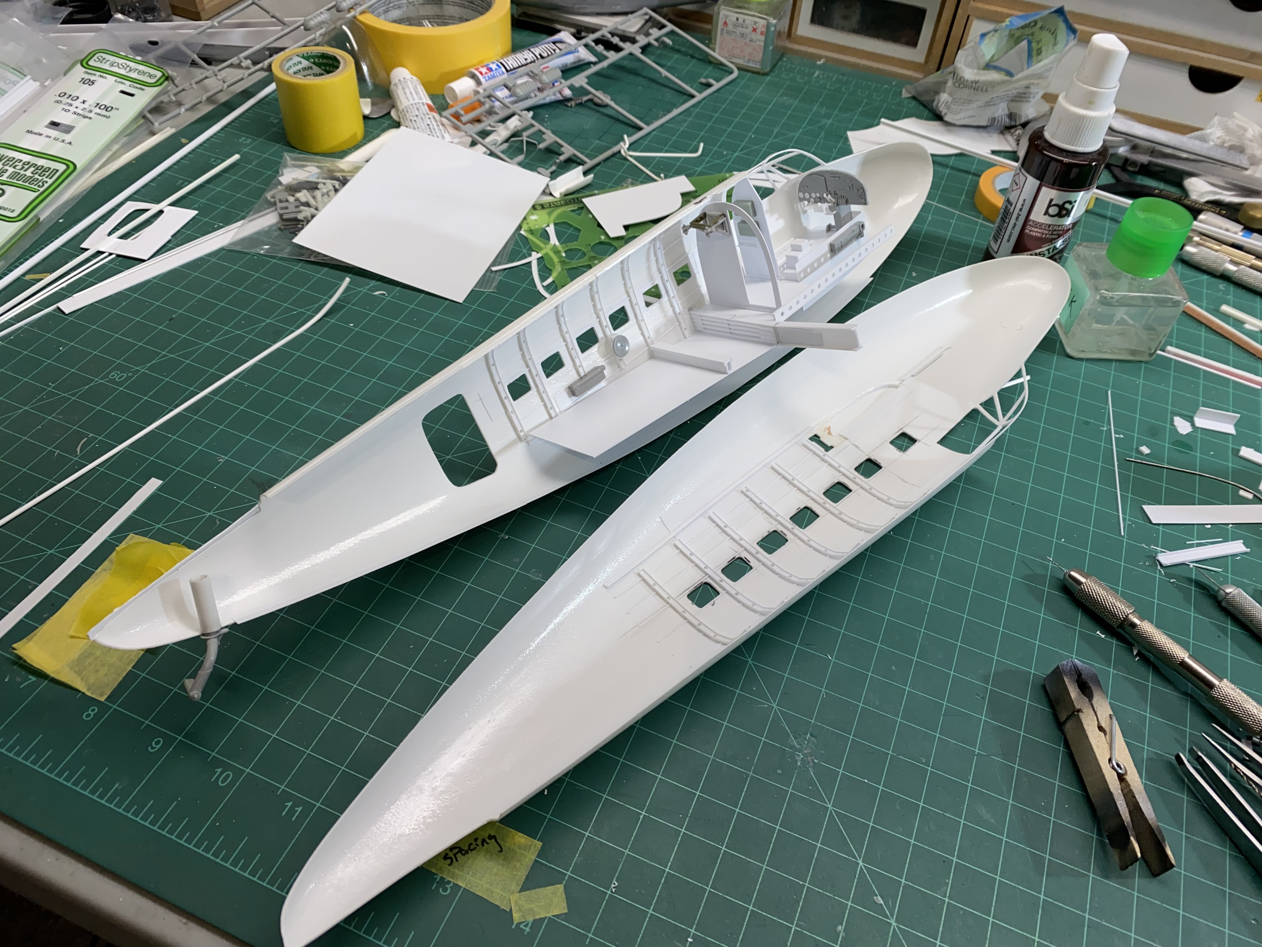

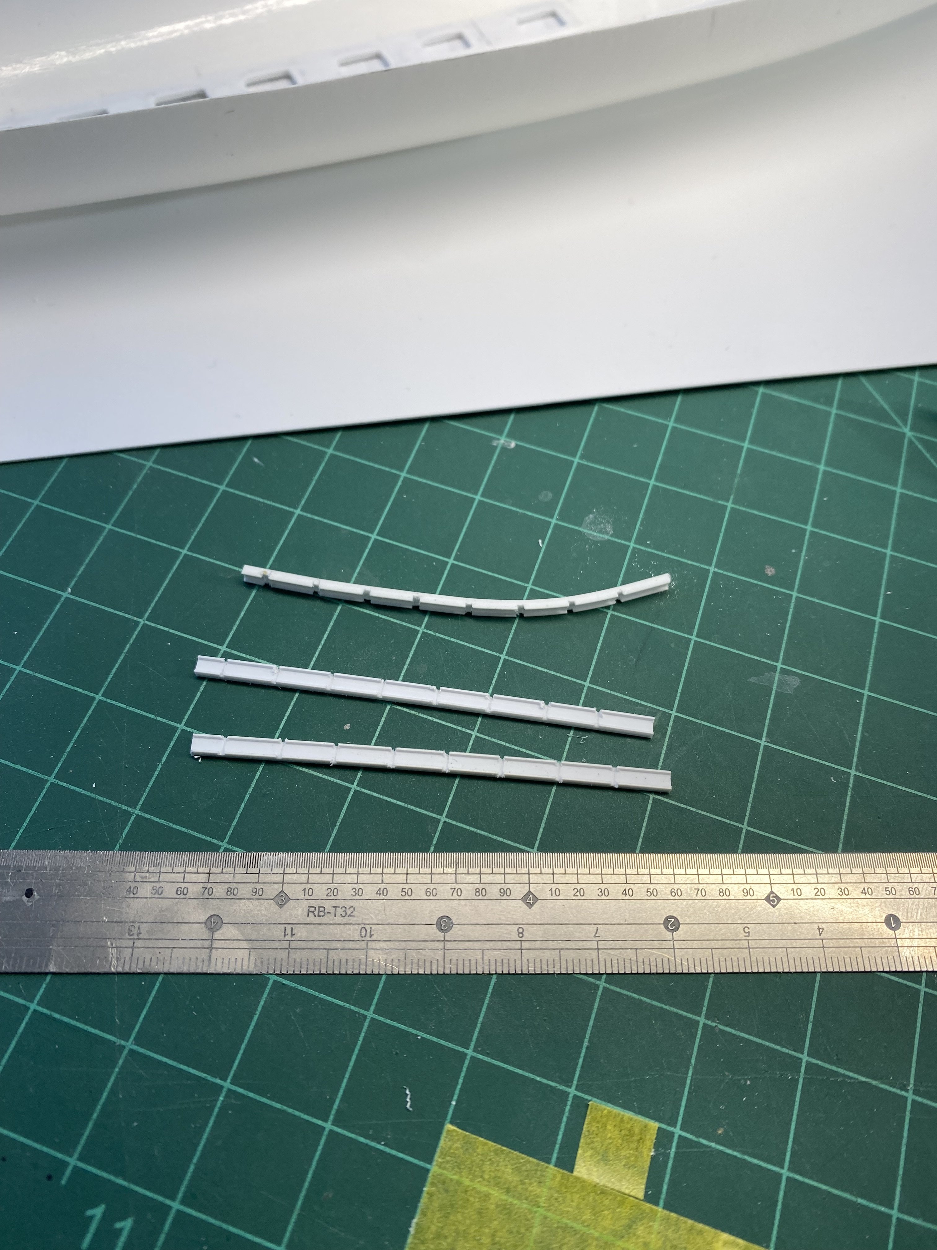

I've made a bit more headway on this battle. I'm actually (today) feeling confident I may see it through to the end...maybe

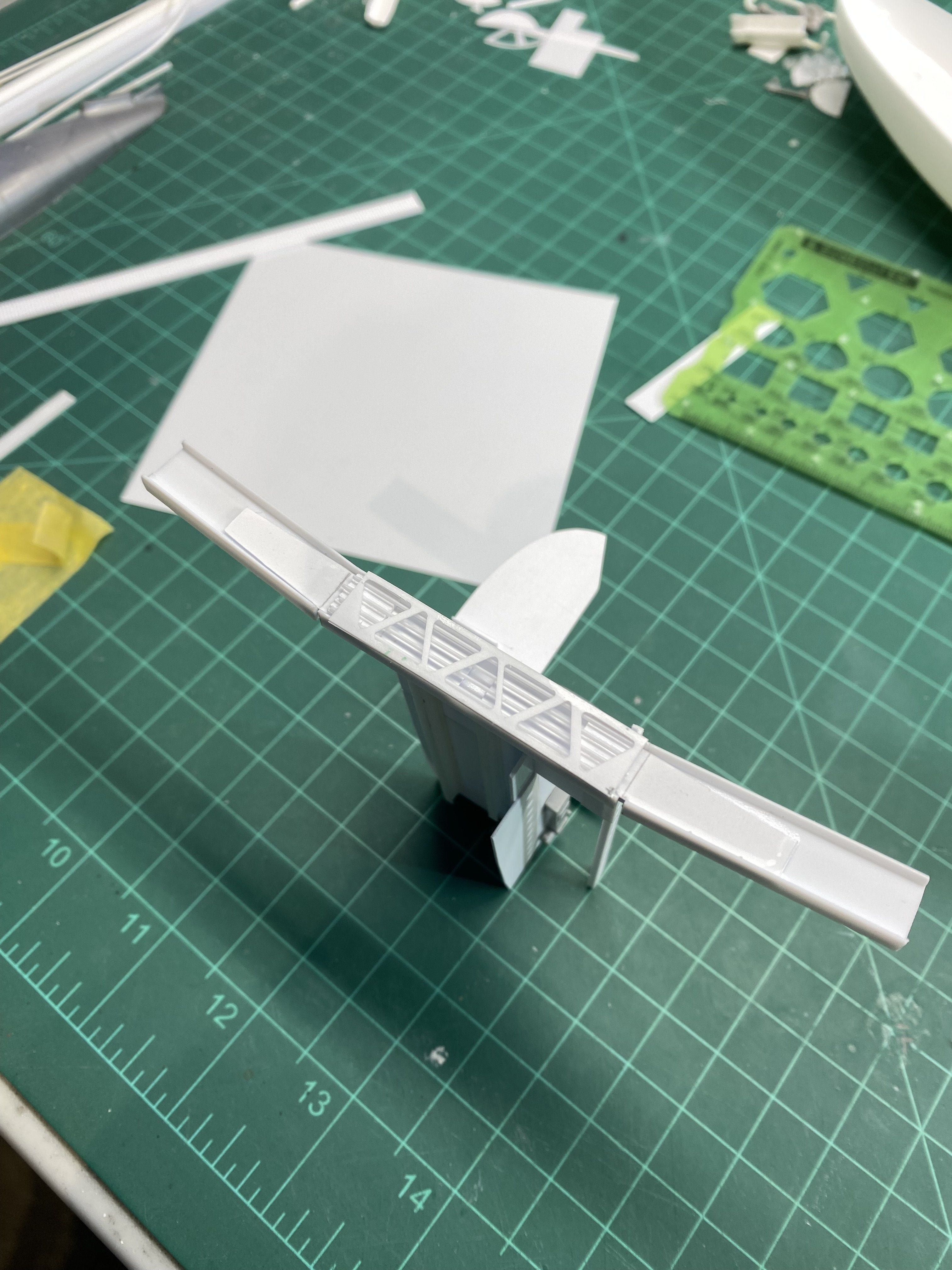

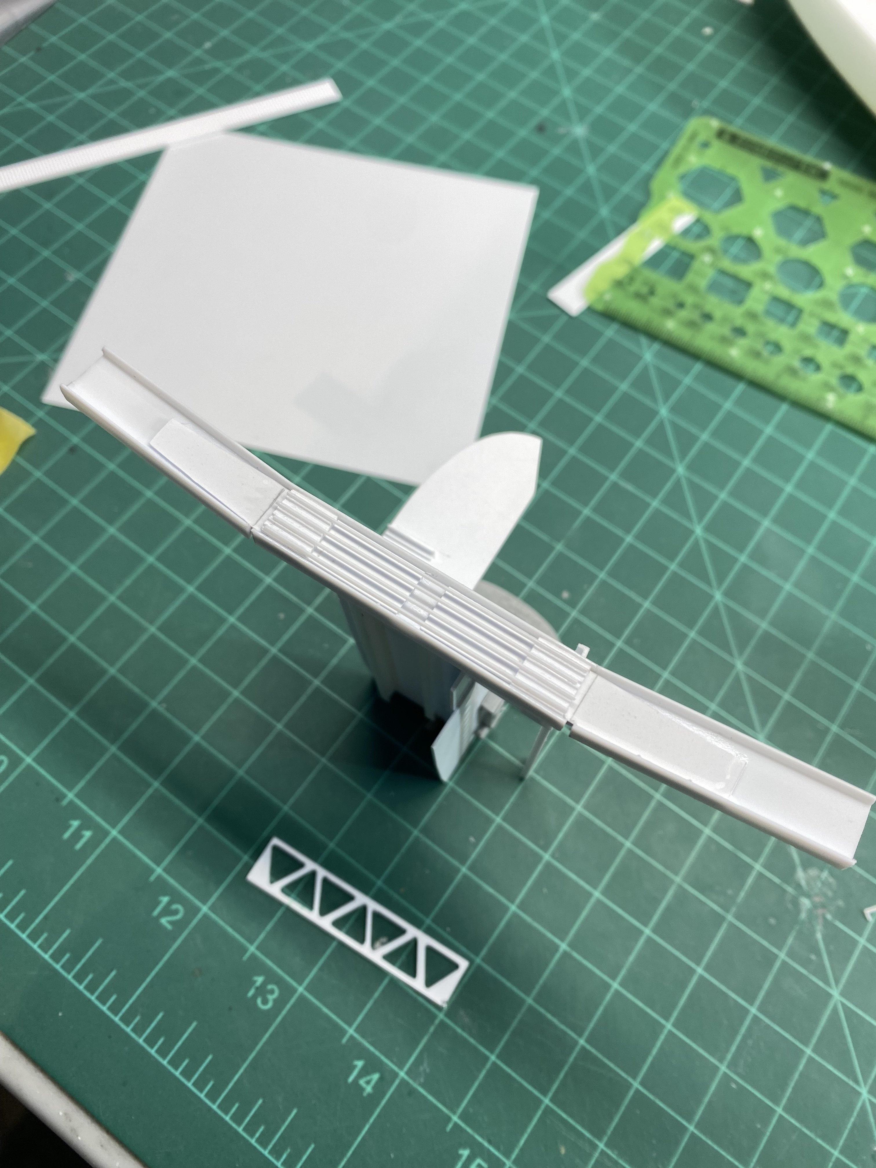

I have added some "imagineering" to the spar.
and begun fitting the airplane shaped parts together;
Thanks for looking

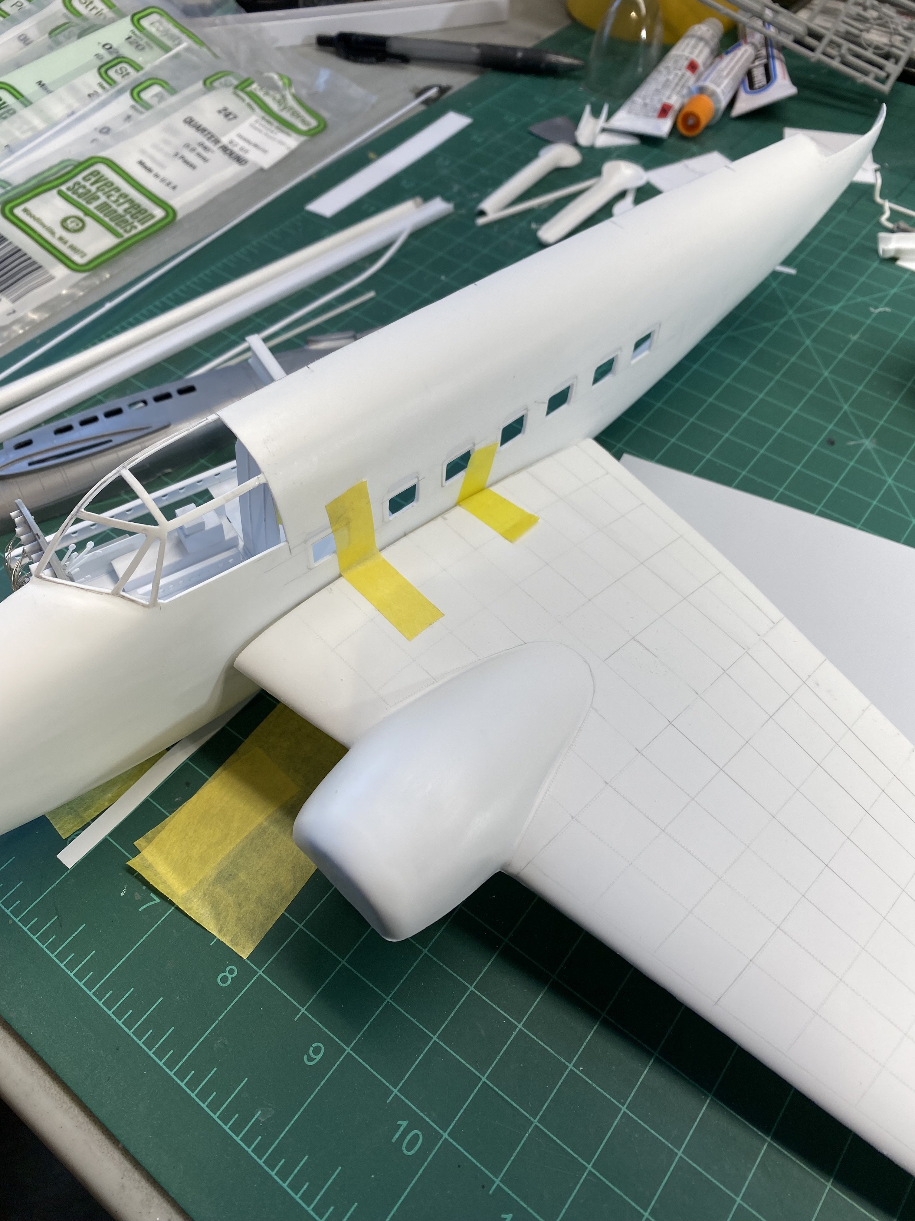

No, no wing fairings. I'm undercutting (beveling??) the inside of the wings so they will fit very tightly over the raised profile (locators) on the sides of the fuselage. The fit in the picture is not actually as good as it was moments before I took the picture (the tape having come away and loosened the fit) but in the end, I'm hoping that with the spar, some stiffeners and some Tamiya white putty the wing to fuse. should be fairly tight.
Time will tell I guess

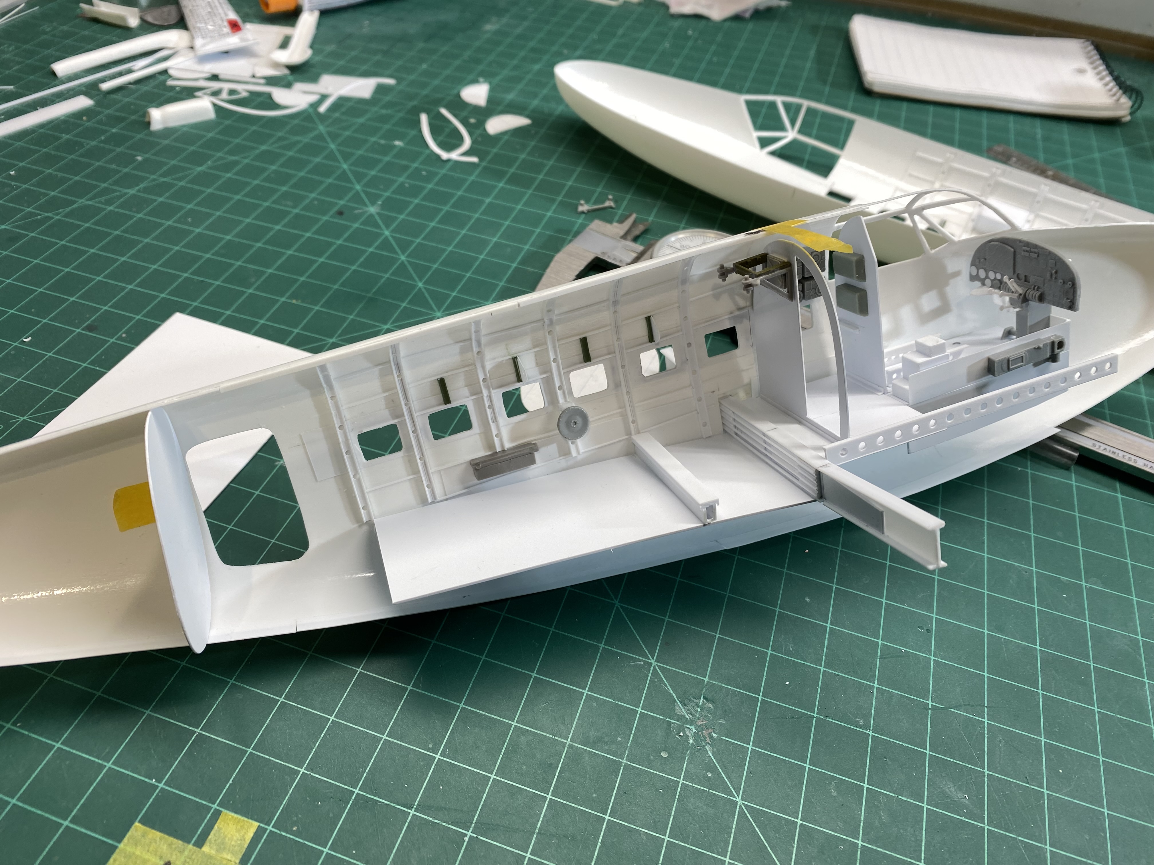

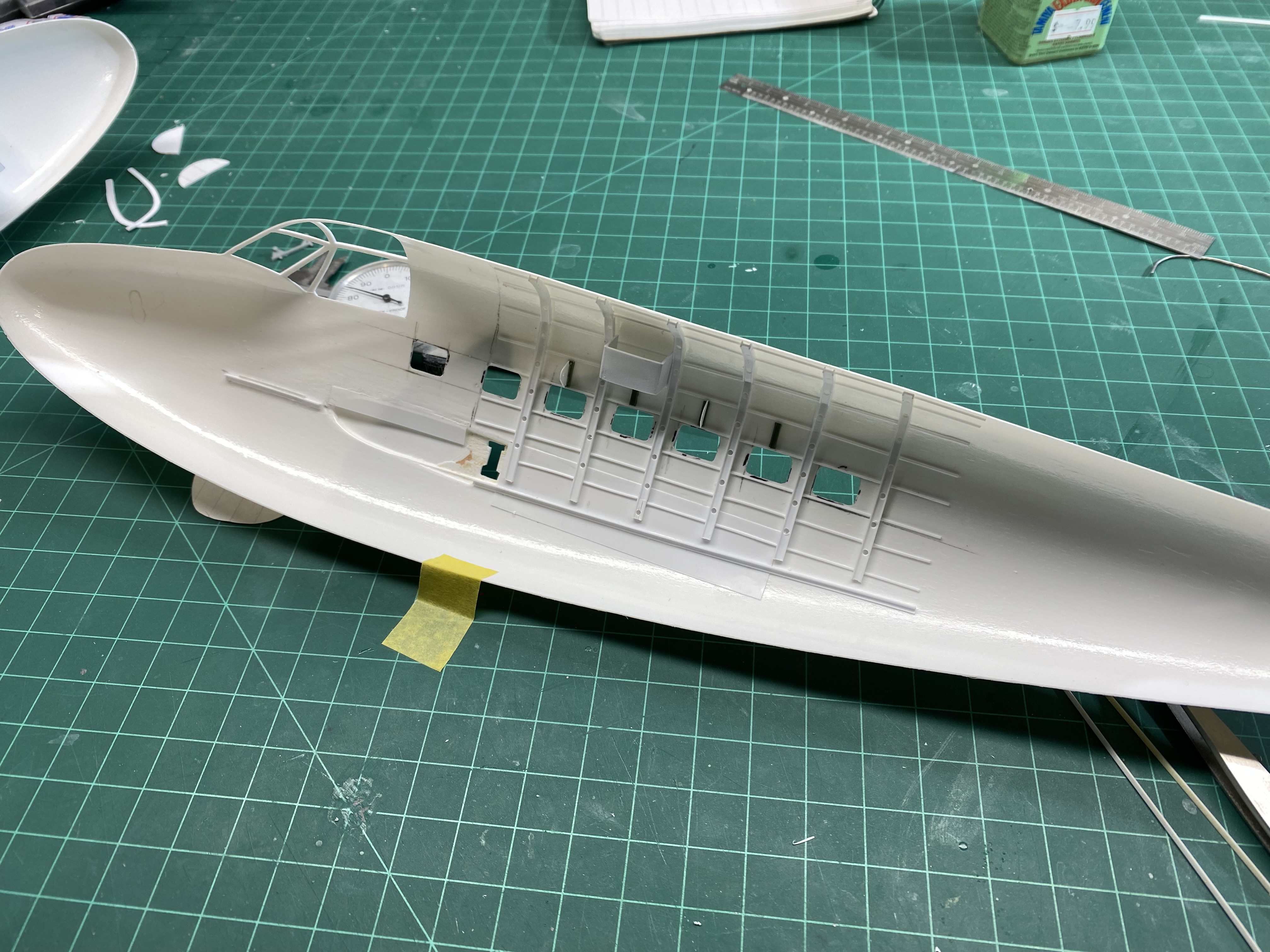

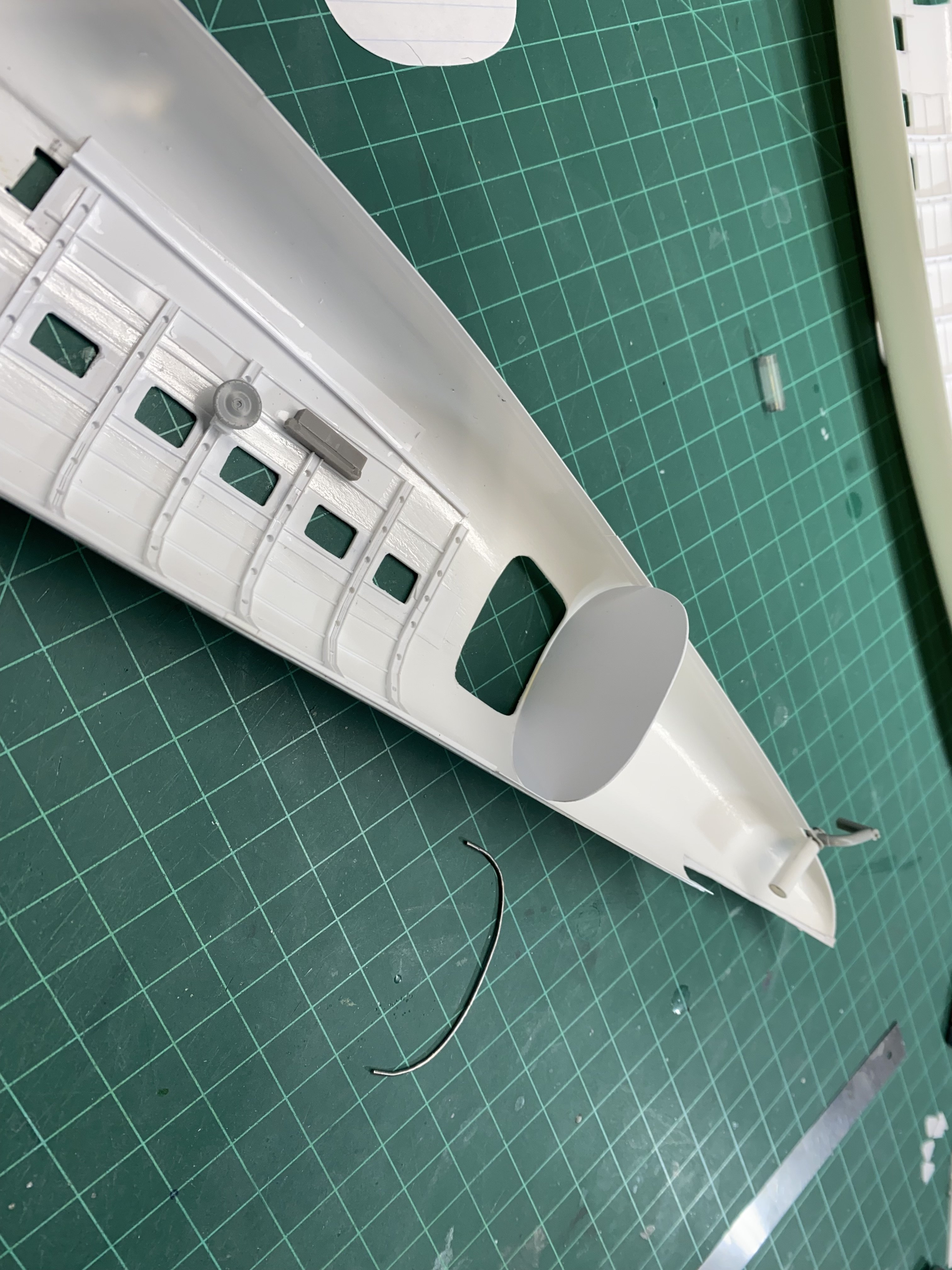

I've taken on the enjoyable job of adding an interior (again reiterating the point) it's not accurate or representative of an actual aircraft, just my interpretation of the interior working from some museum pictures and imagination
Other than cutting out the door and finishing the floor that should be all for the port side (rhymer hey)
Thanks for looking

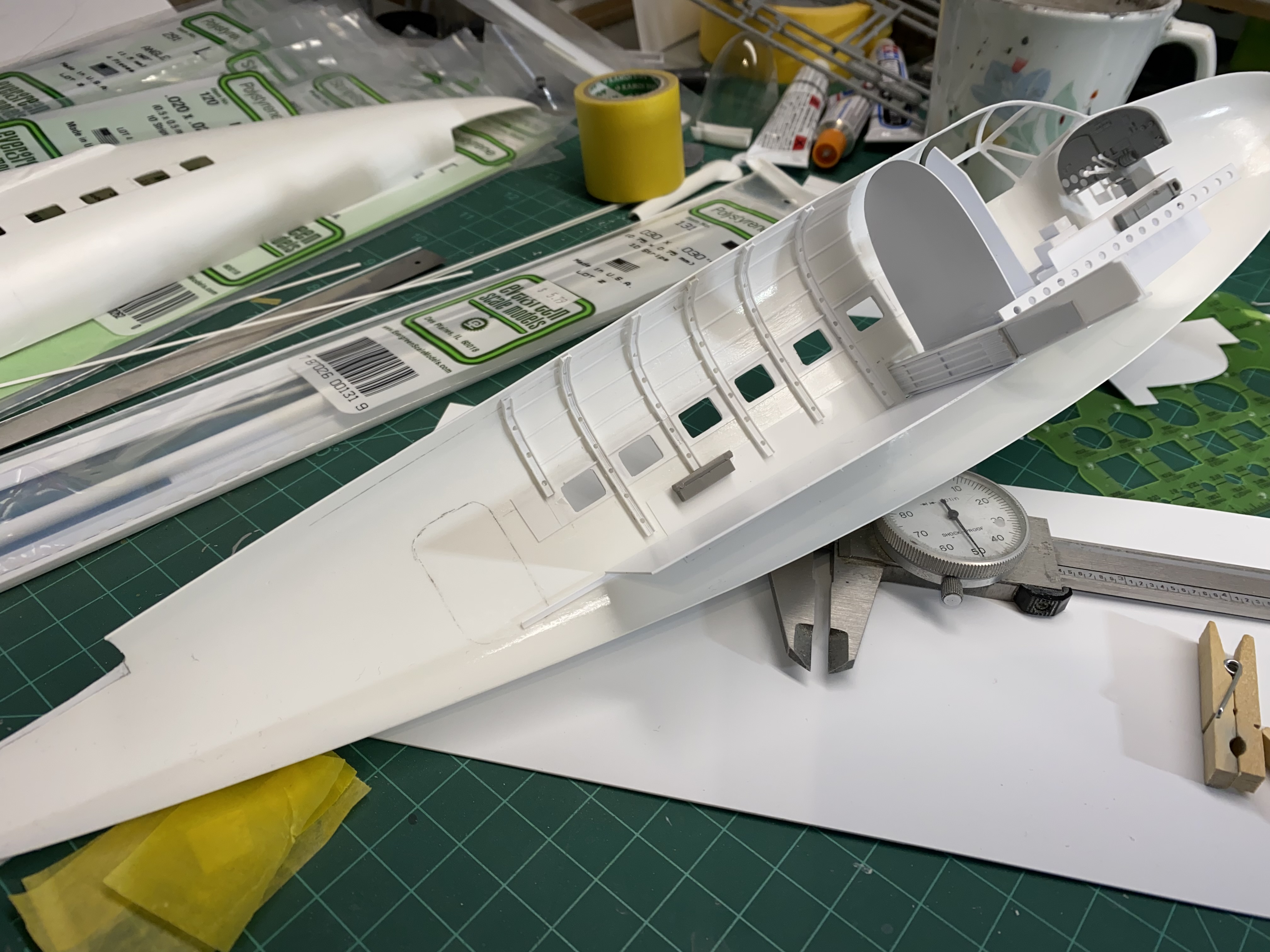

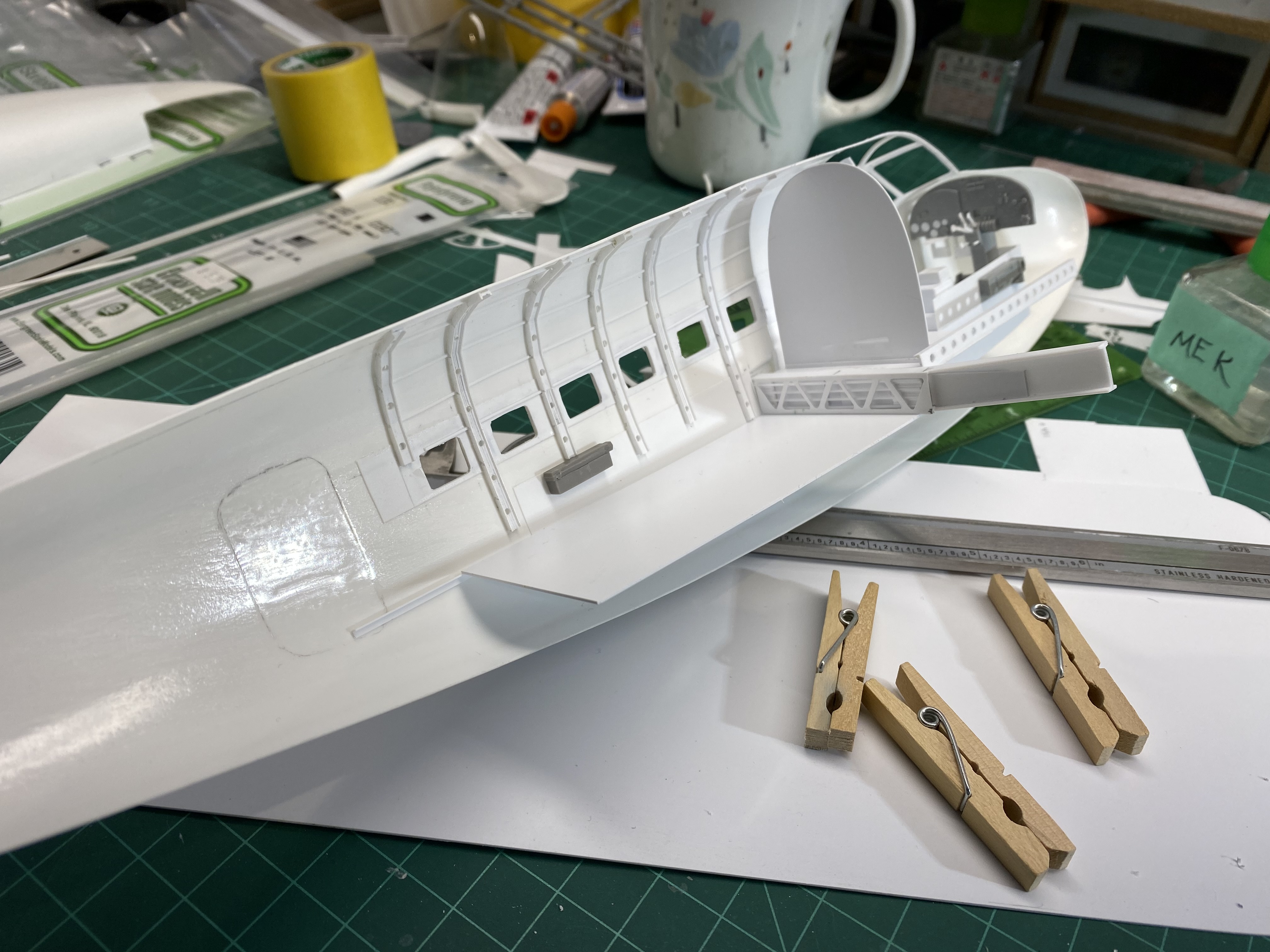

still adding do dads to the cabin, actually cut the door open so it's not all hidden away until I die and a grand-kid destroys it.

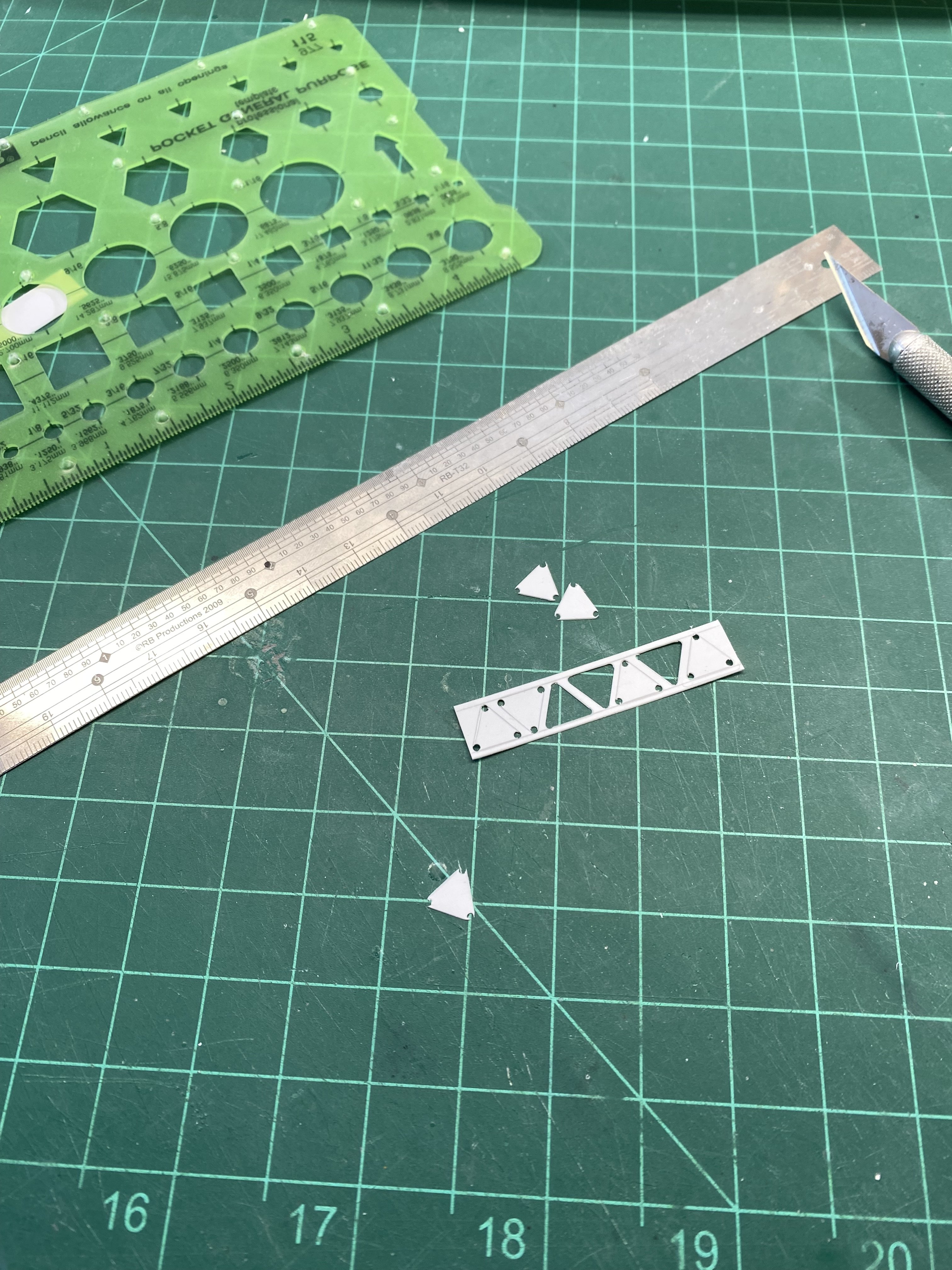

The rear spar has been added, ribbing and stringers on the stbd side a tail wheel strut from a HK Models B-17 and radios from (sorry) a Ju-88..at least there's radios in there now.
adding a rear bulkhead (because I've no idea what's back there) and I'm not adding a top turret..
the chunk of solder is my contour gauge
Thanks for looking
