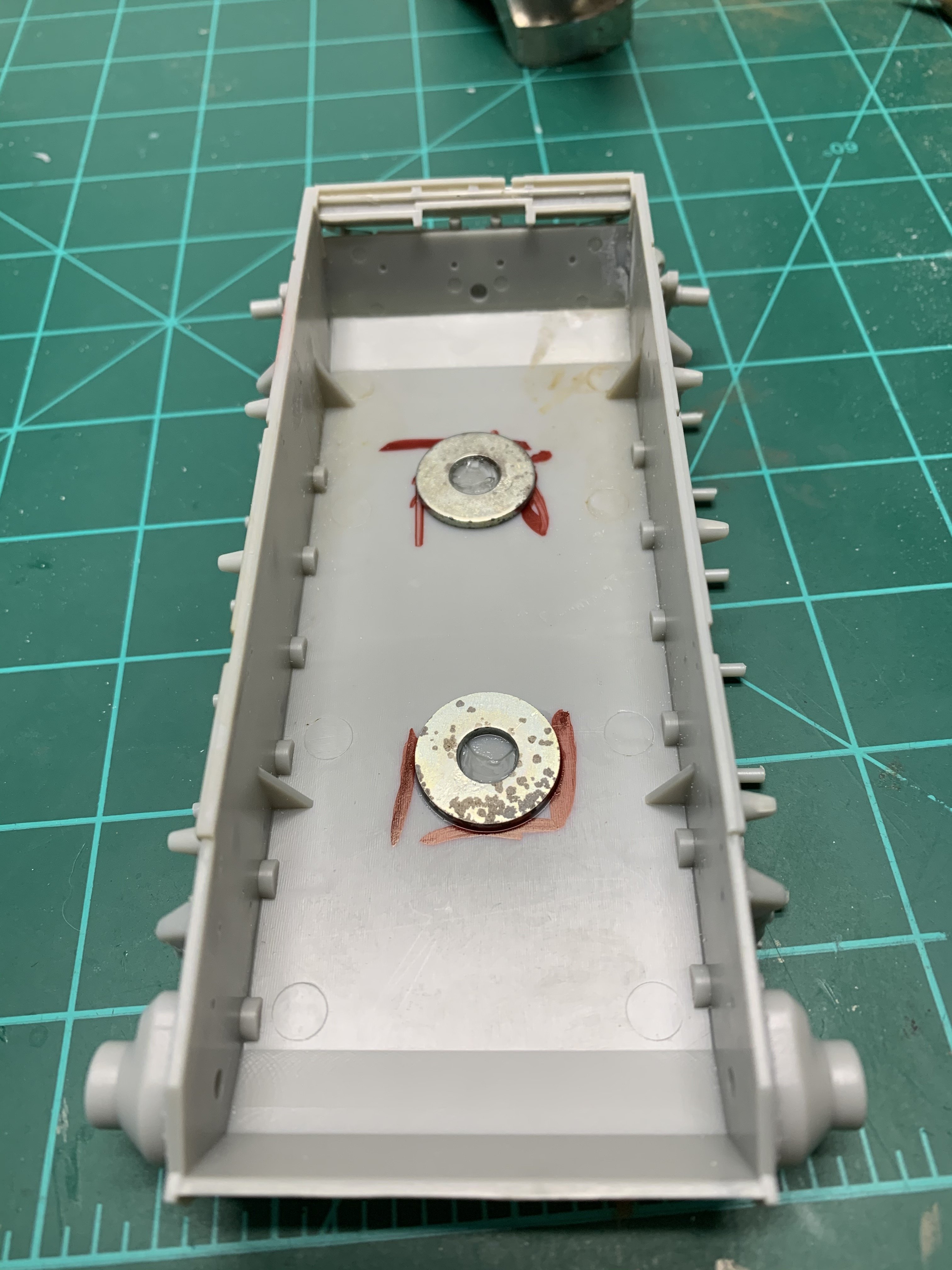

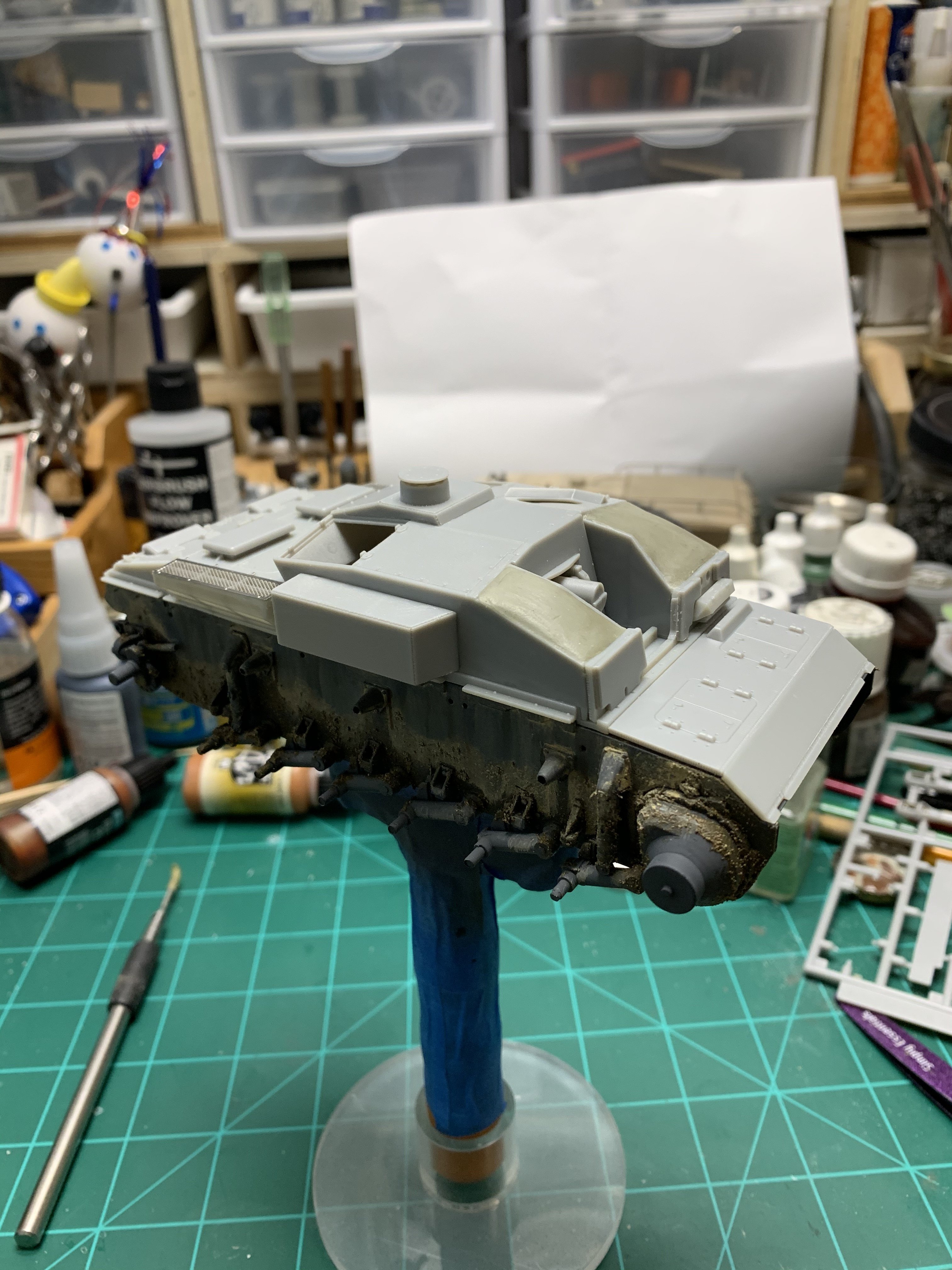

A couple old washers glued inside the hull make a rock solid attachment for my AK Interactive Magnetic Handle.

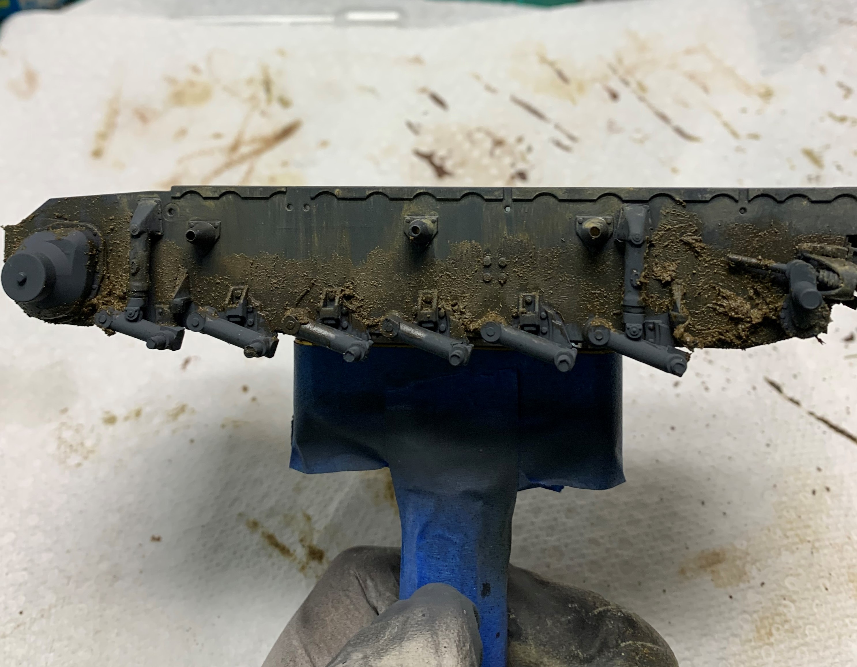

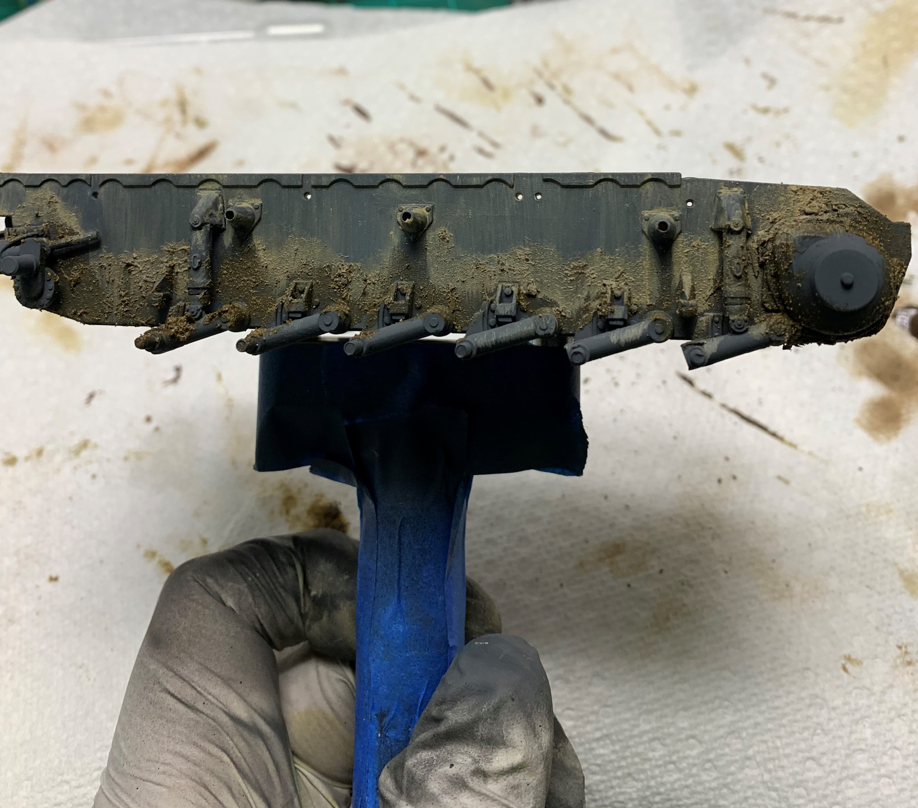

Moving forward, I added some dirt and mud to the lower hull.

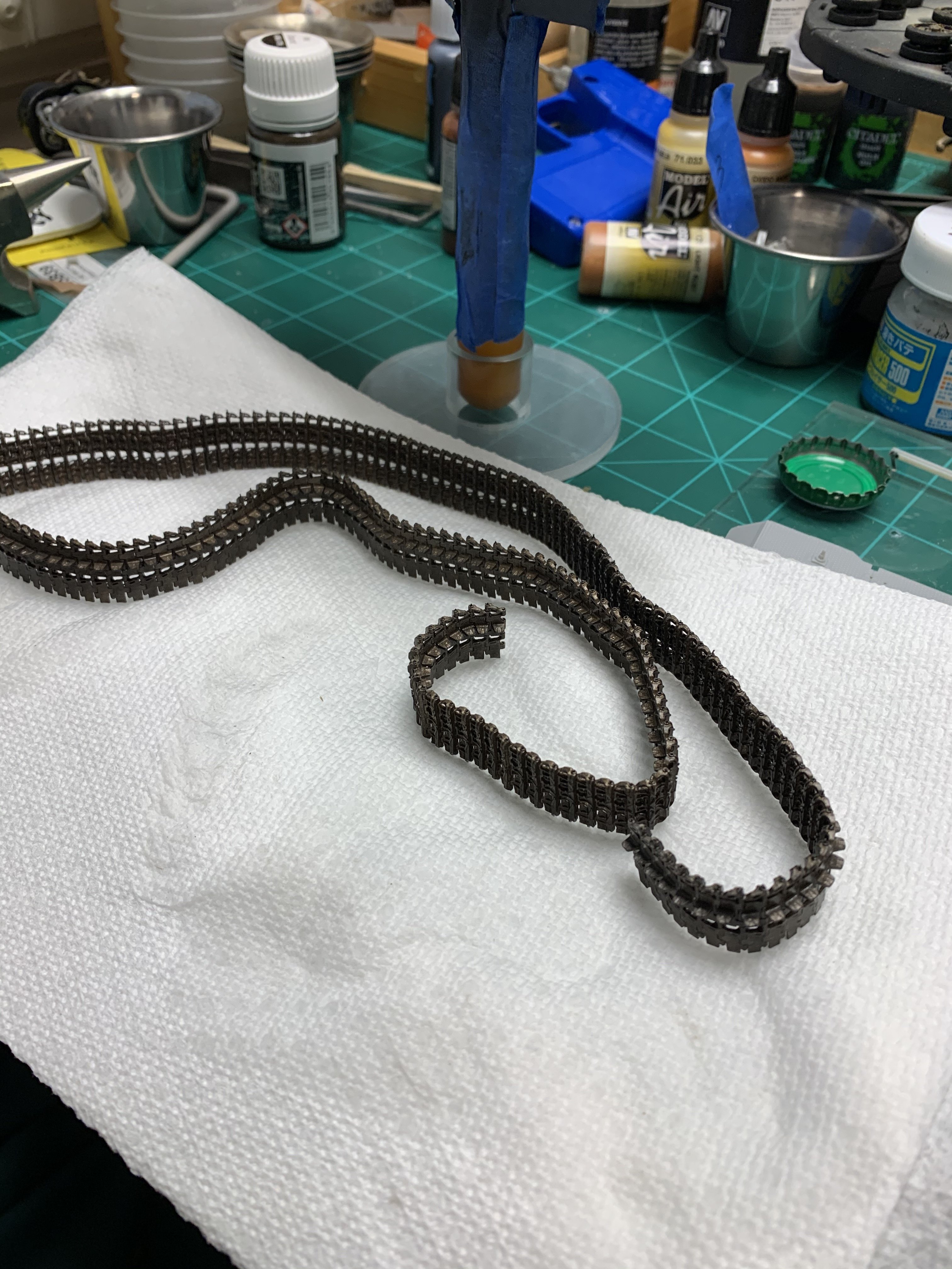

The kit tracks are supposed to be Ostketten, but they are the longer Winterketten. Since I did a vehicle with winterketten awhile back, I ordered a set of Friulmodel Ostketten.

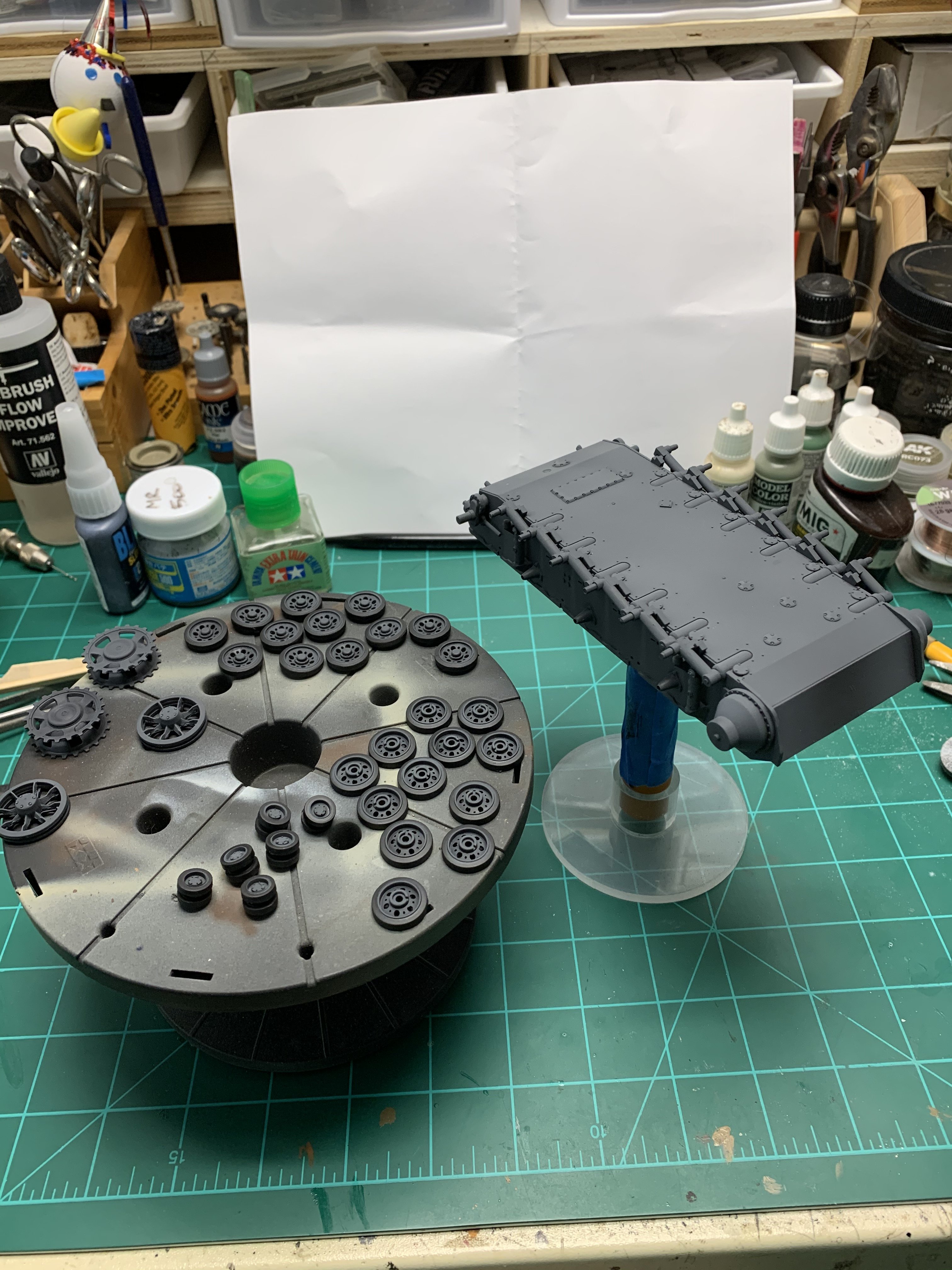

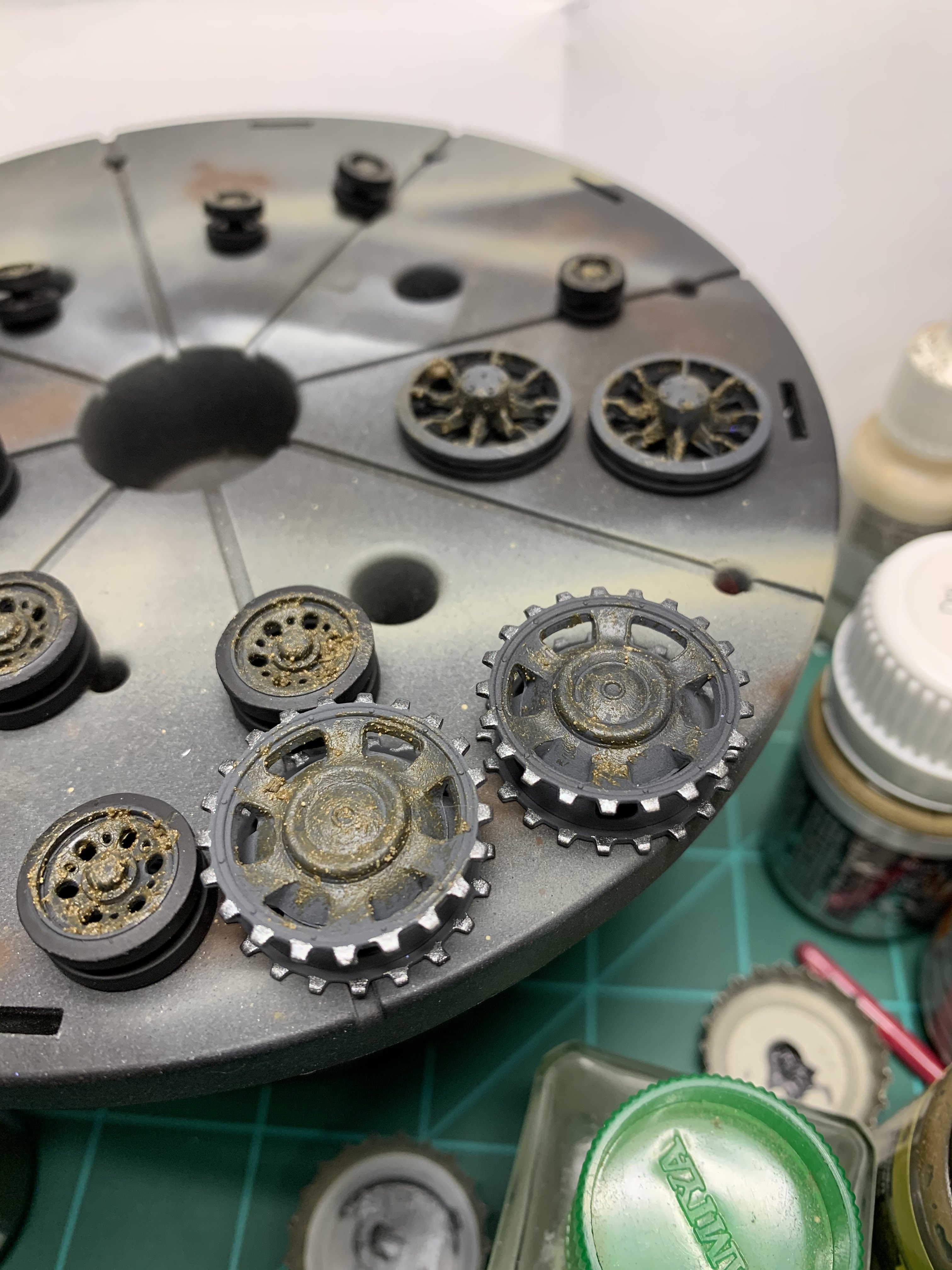

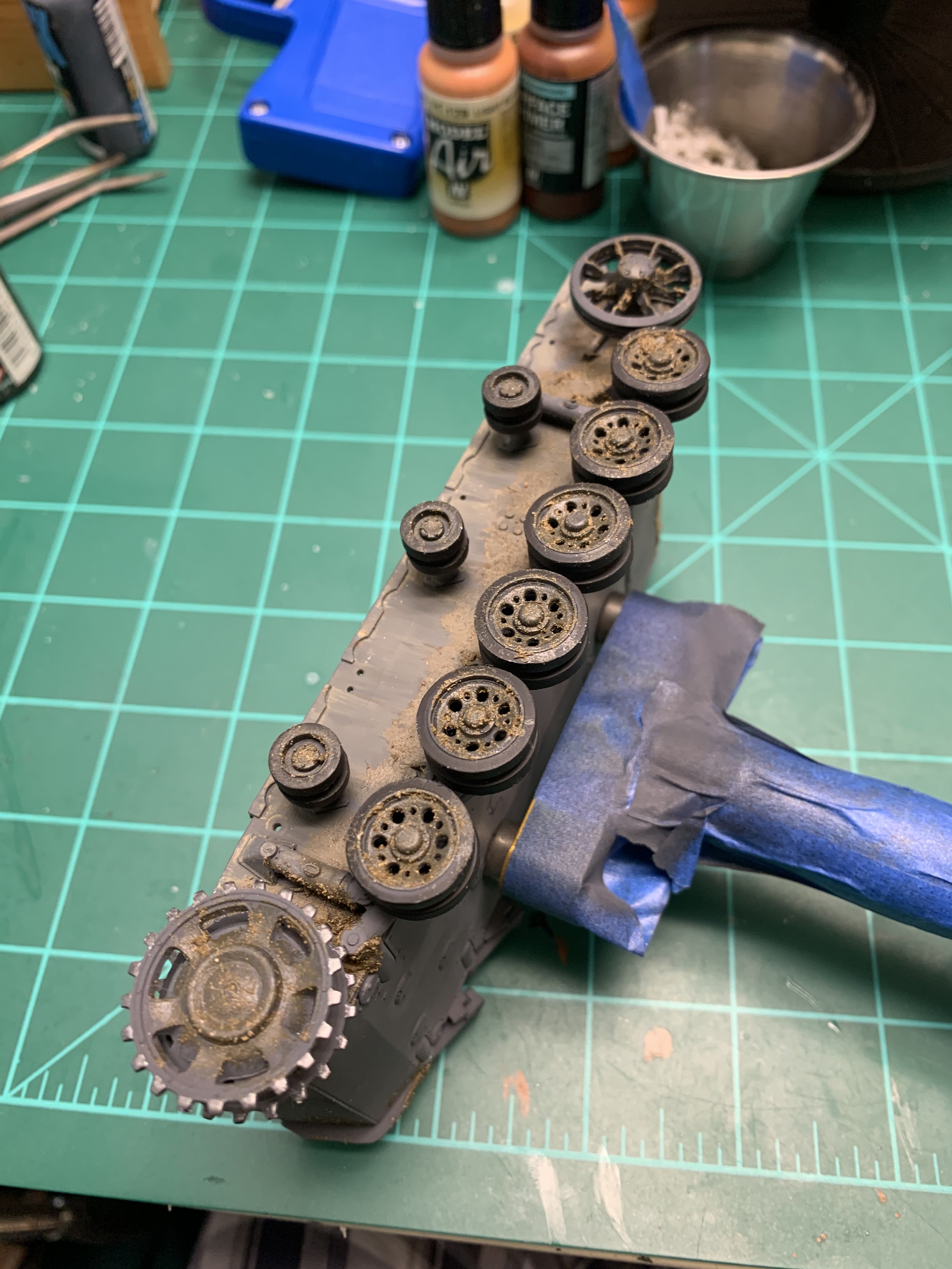

While I was waiting for the tracks to arrive, the running gear got the treatment.

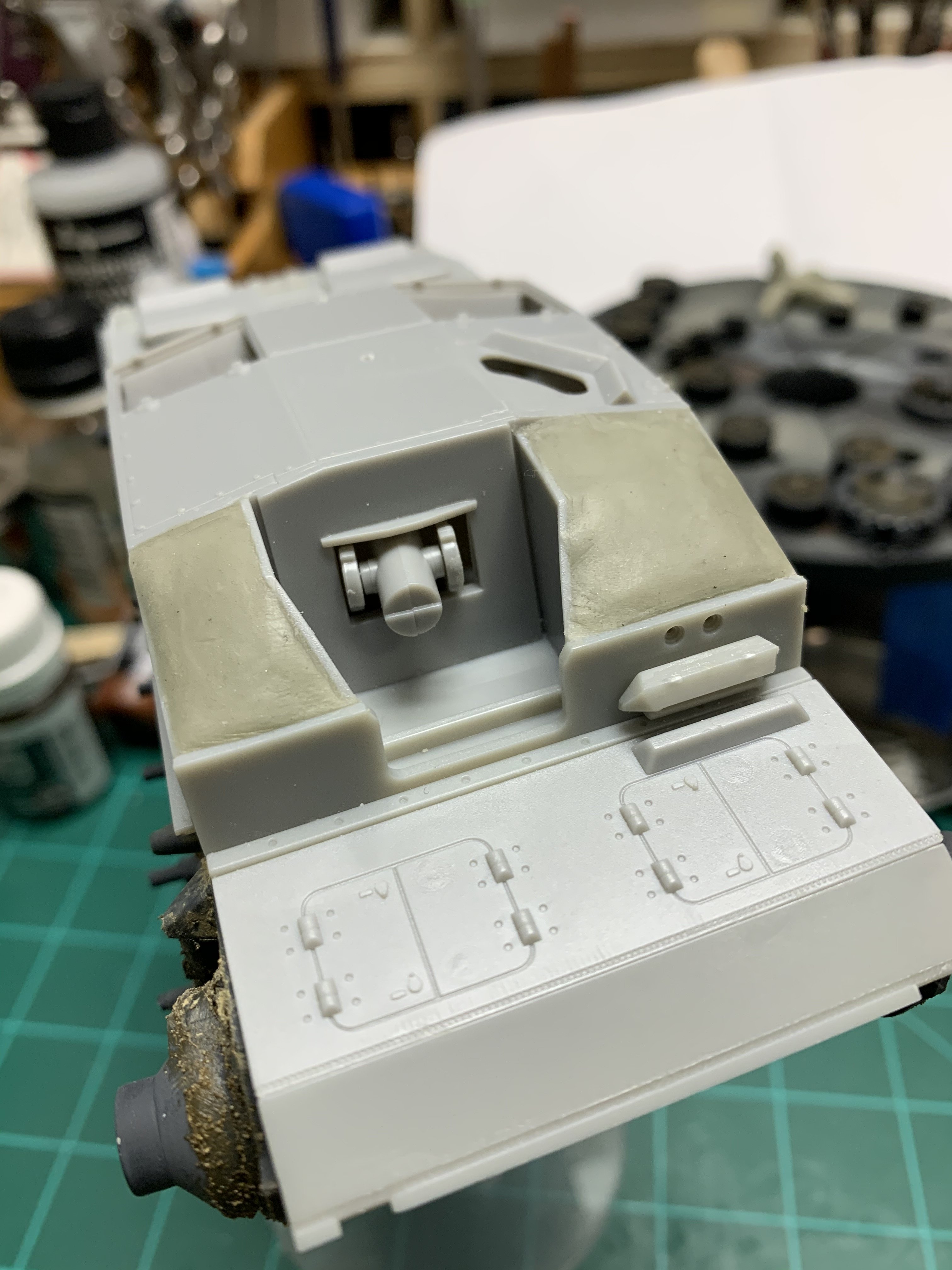

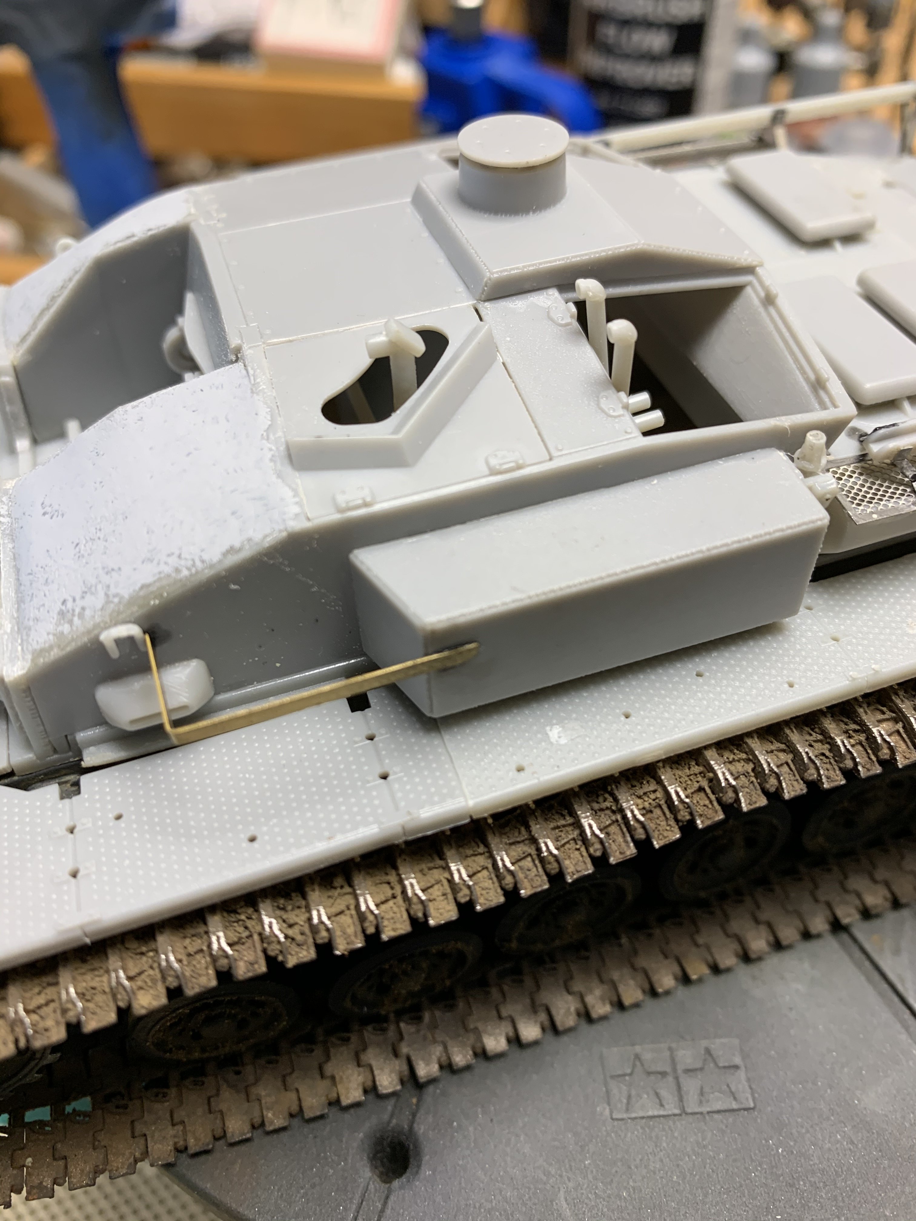

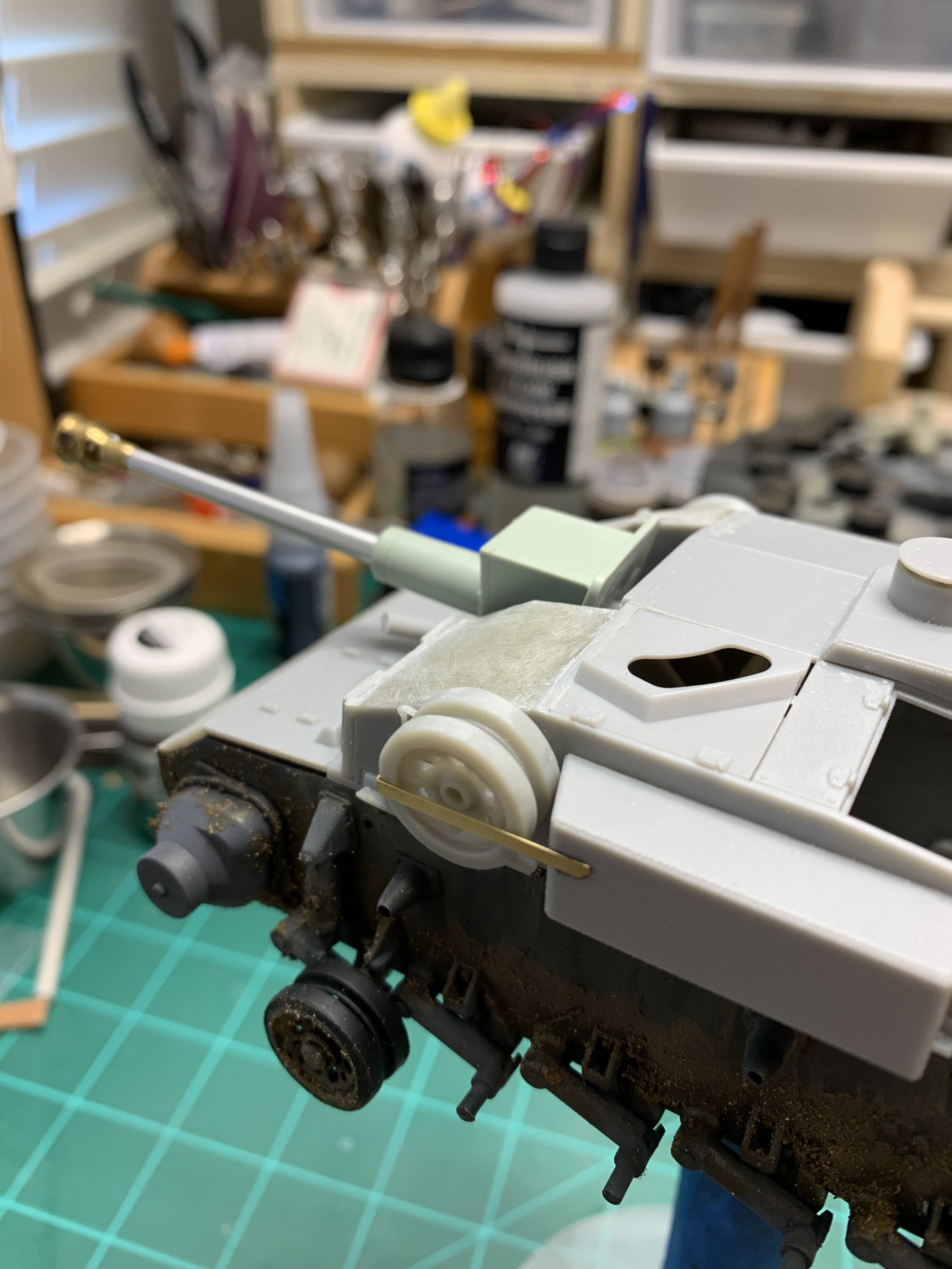

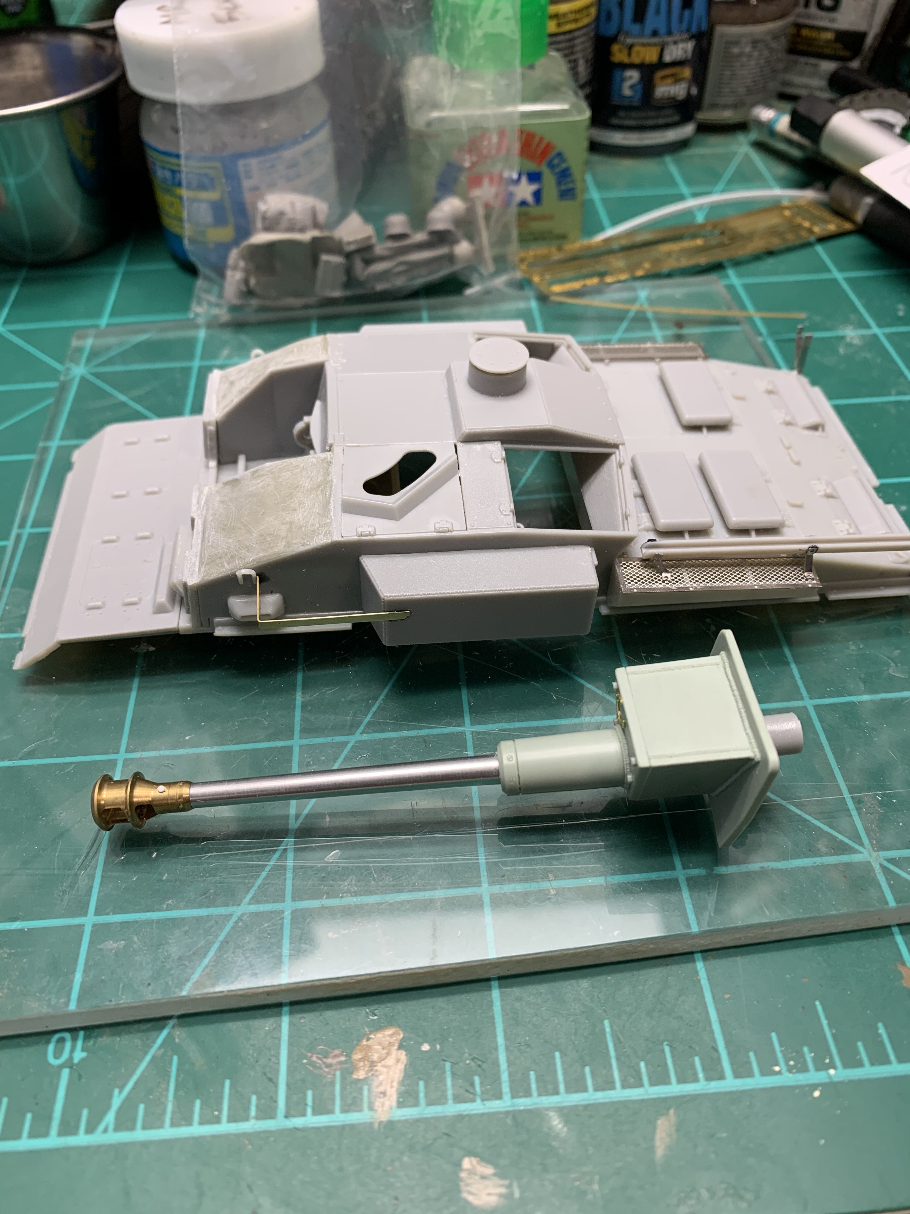

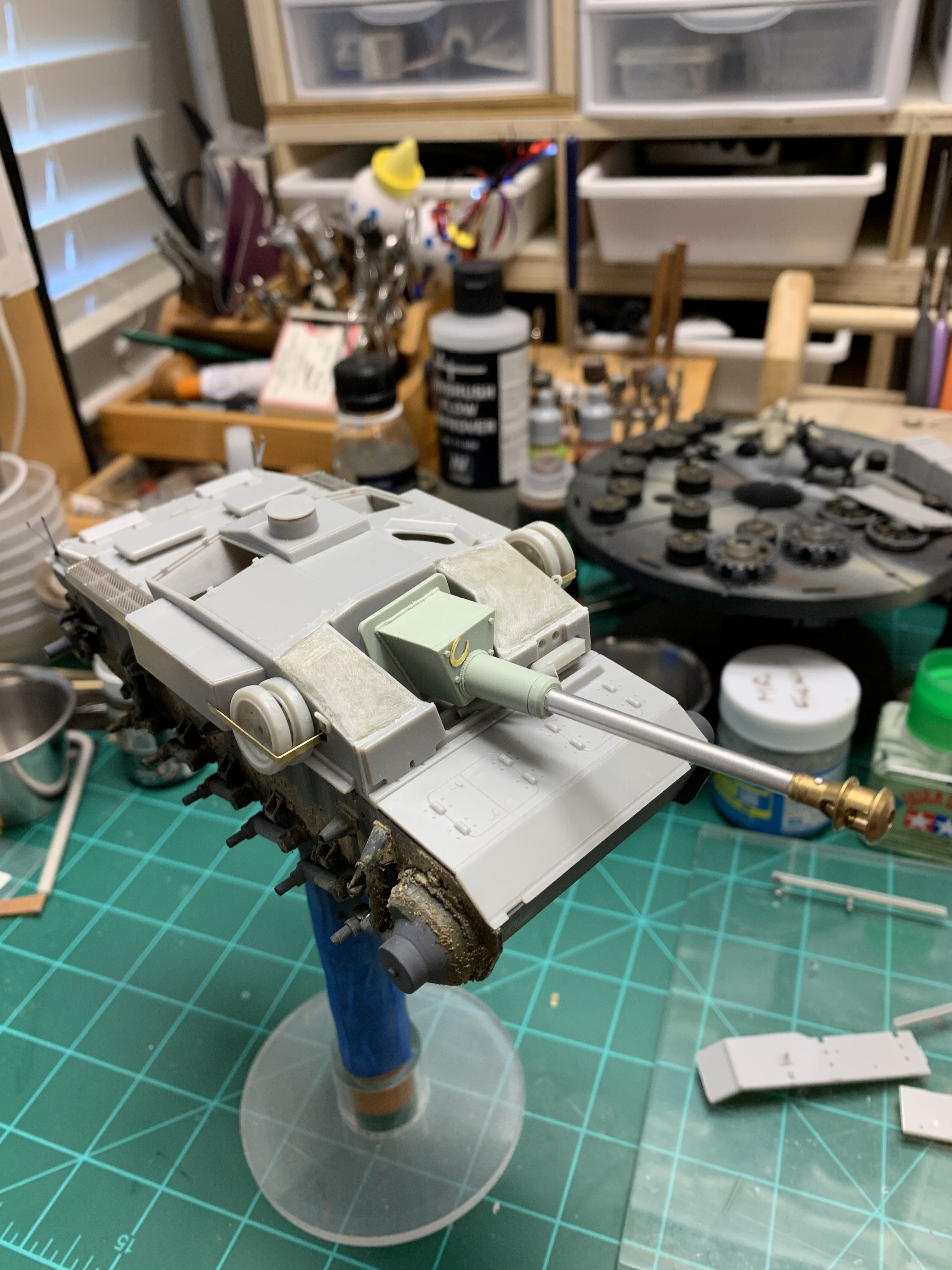

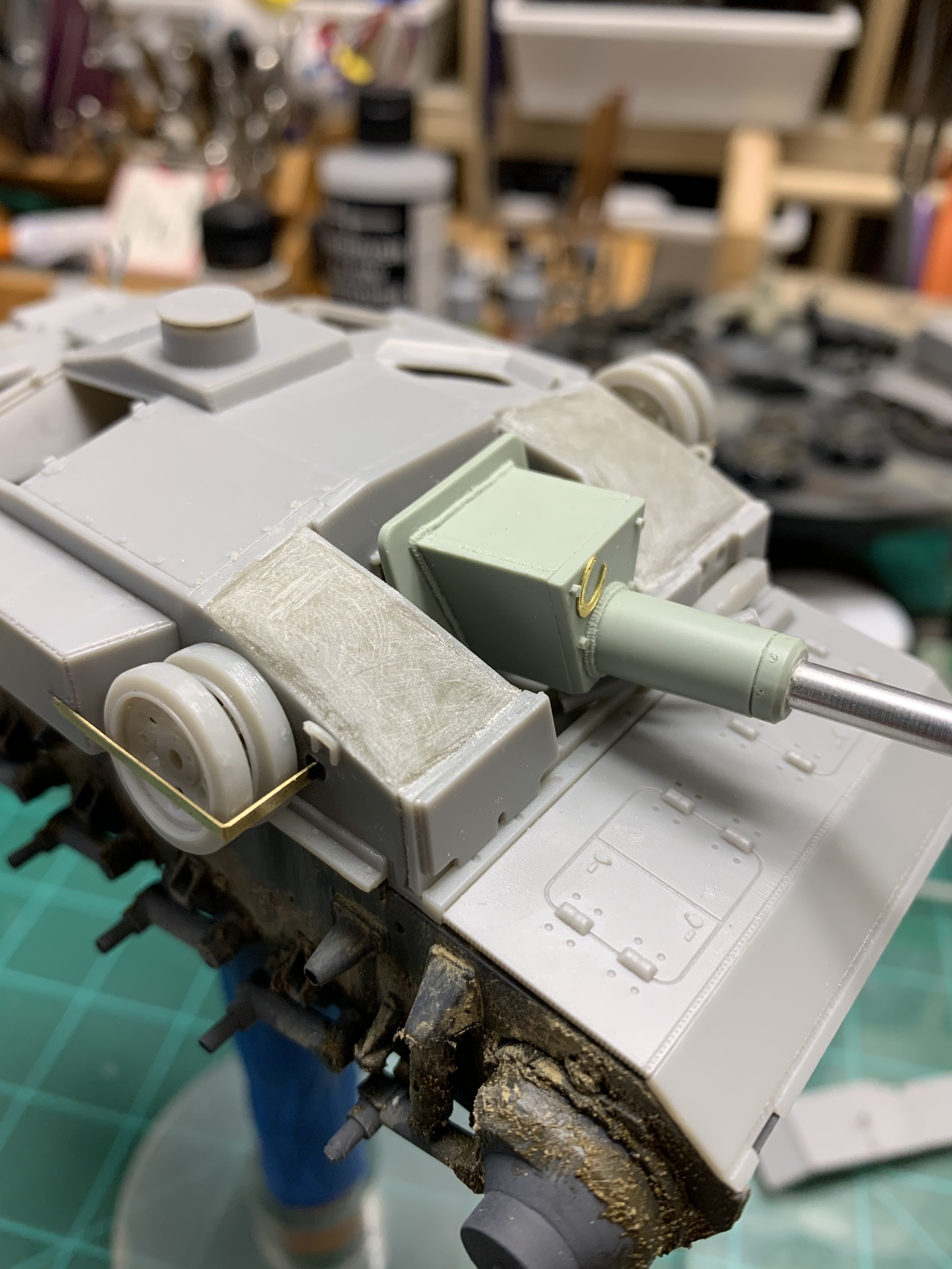

Looking for something different, a layer of concrete armor was added with Aves Apoxie.

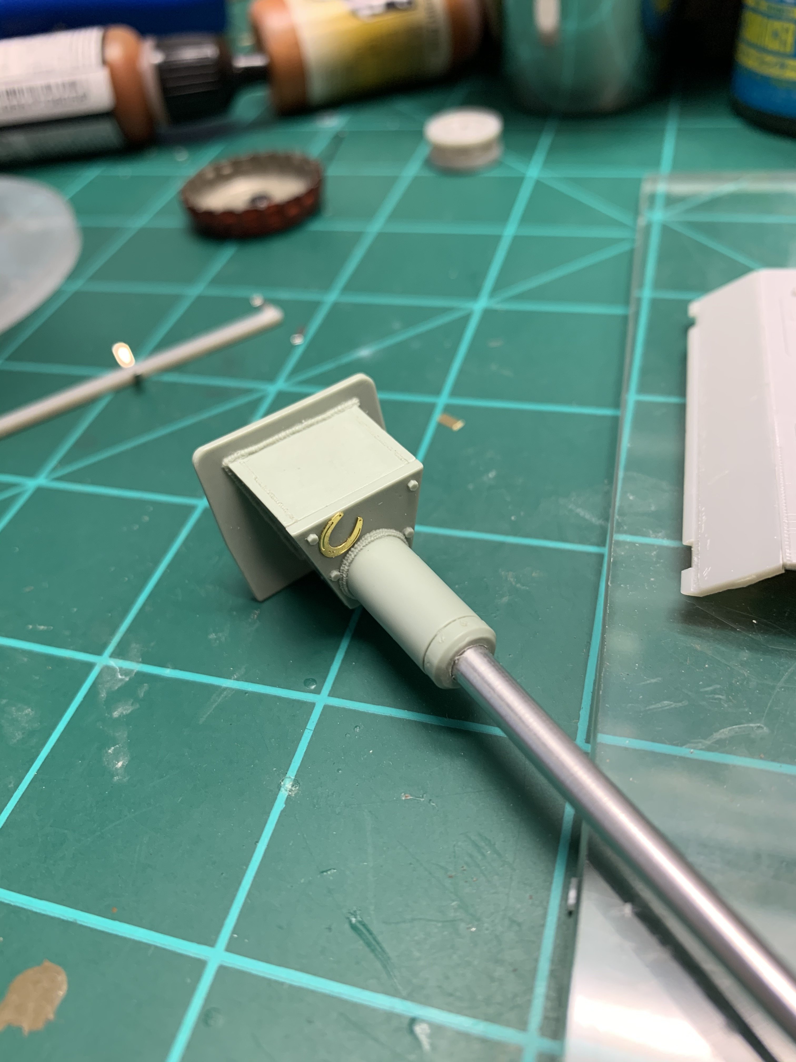

I found an Armorscale barrel and mantlet in the stash, so that went on next.
I made the spare road wheel racks from scrap PE frets and wheels from the spares bin.

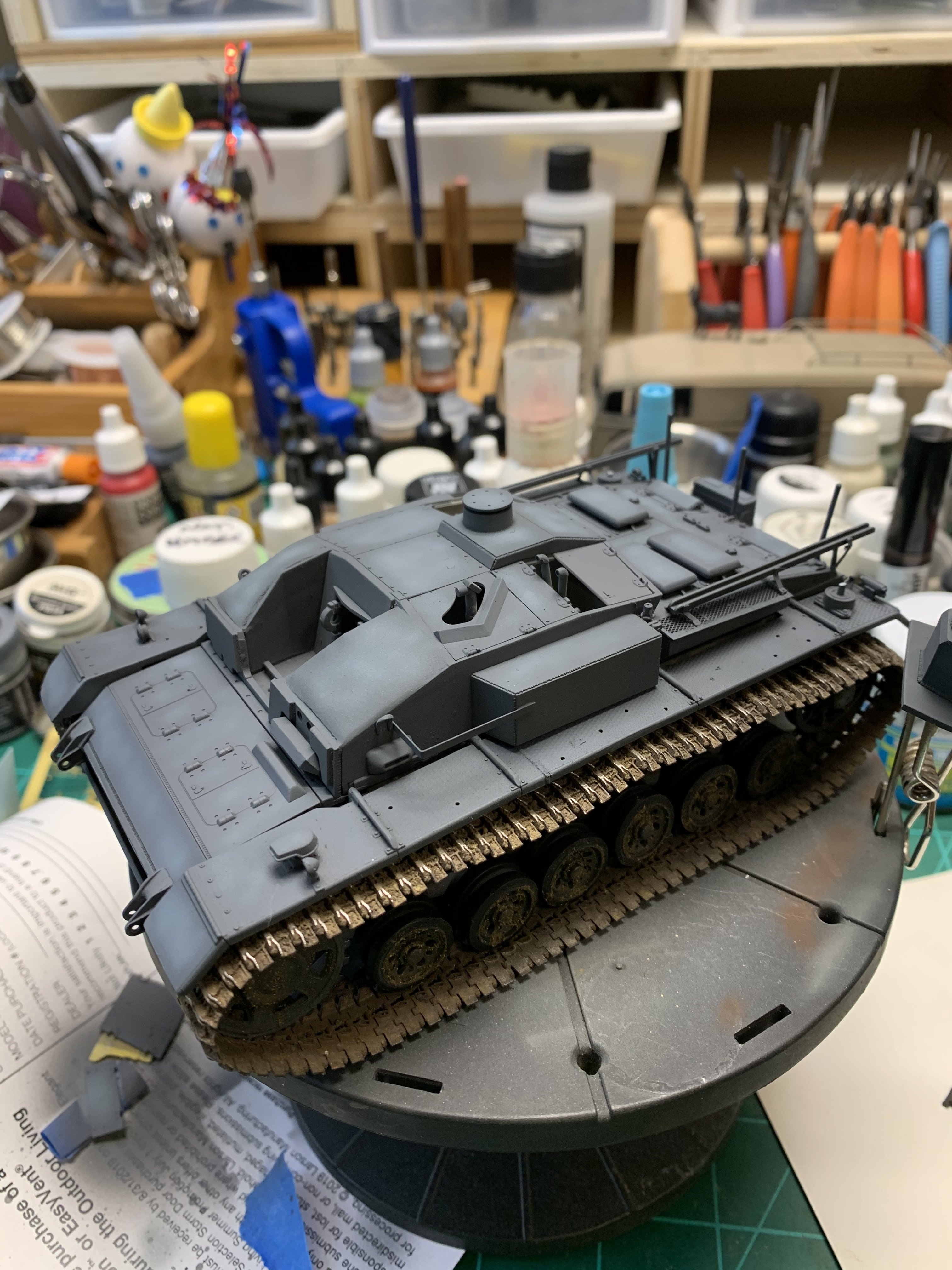

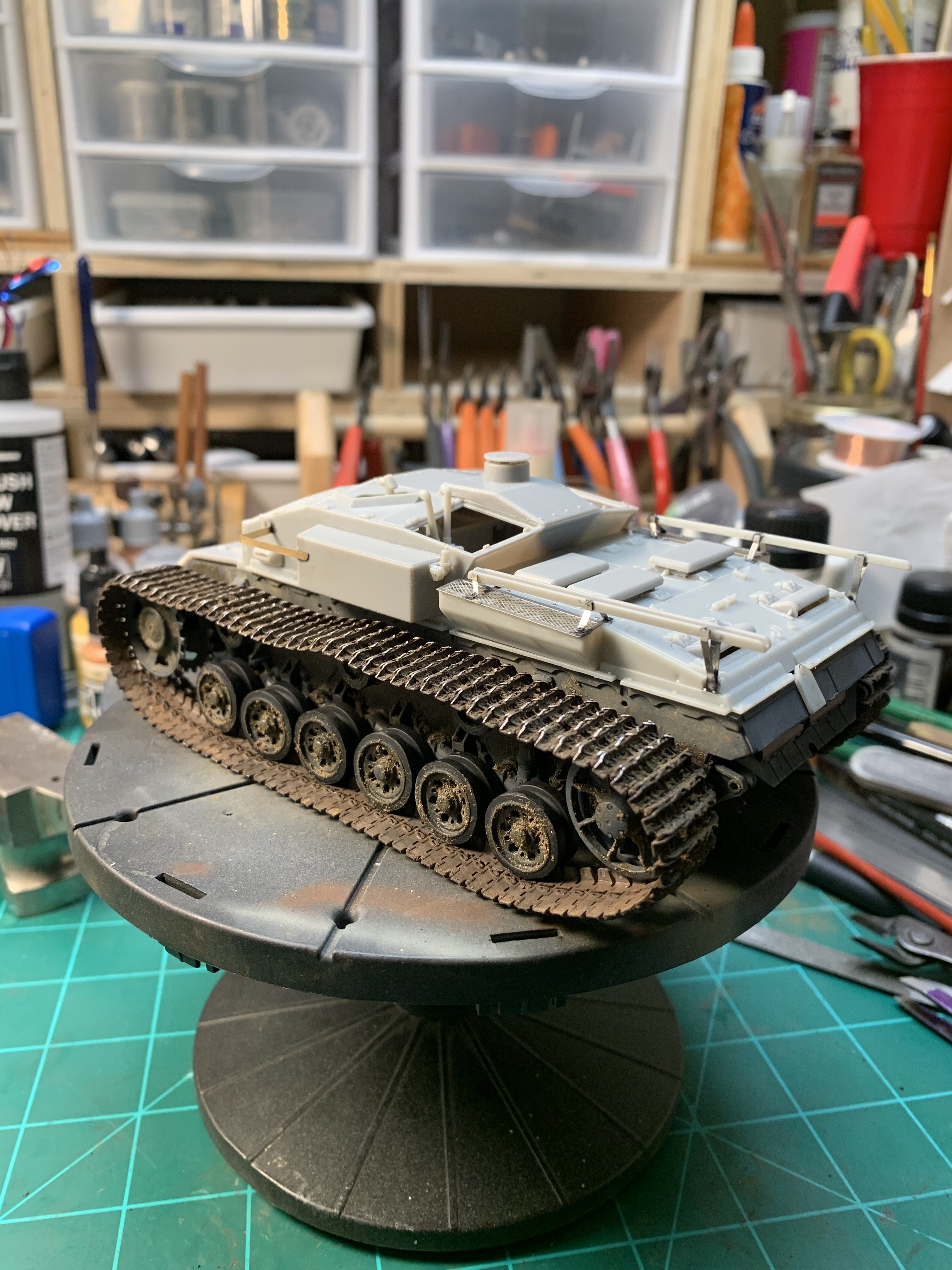

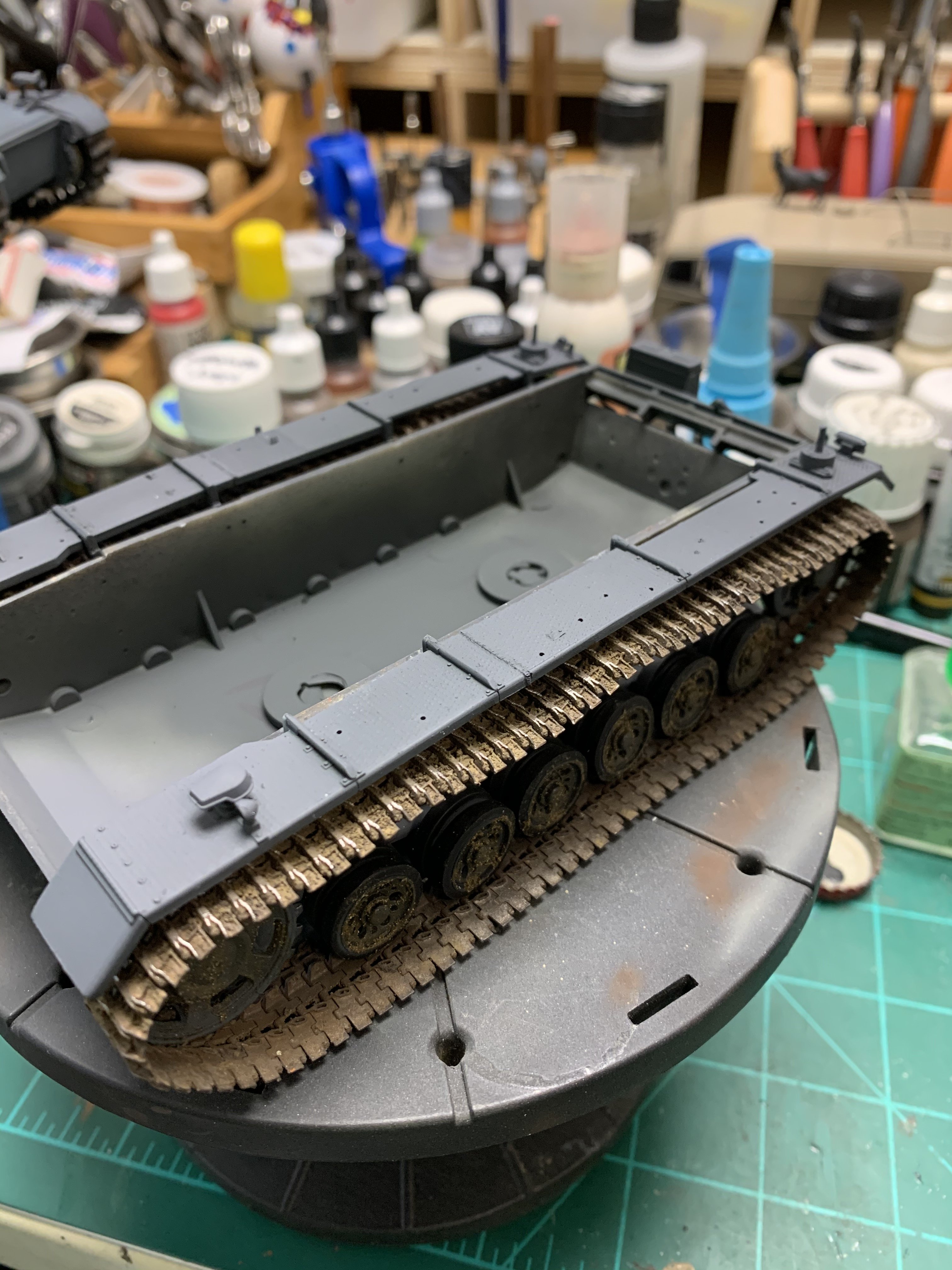

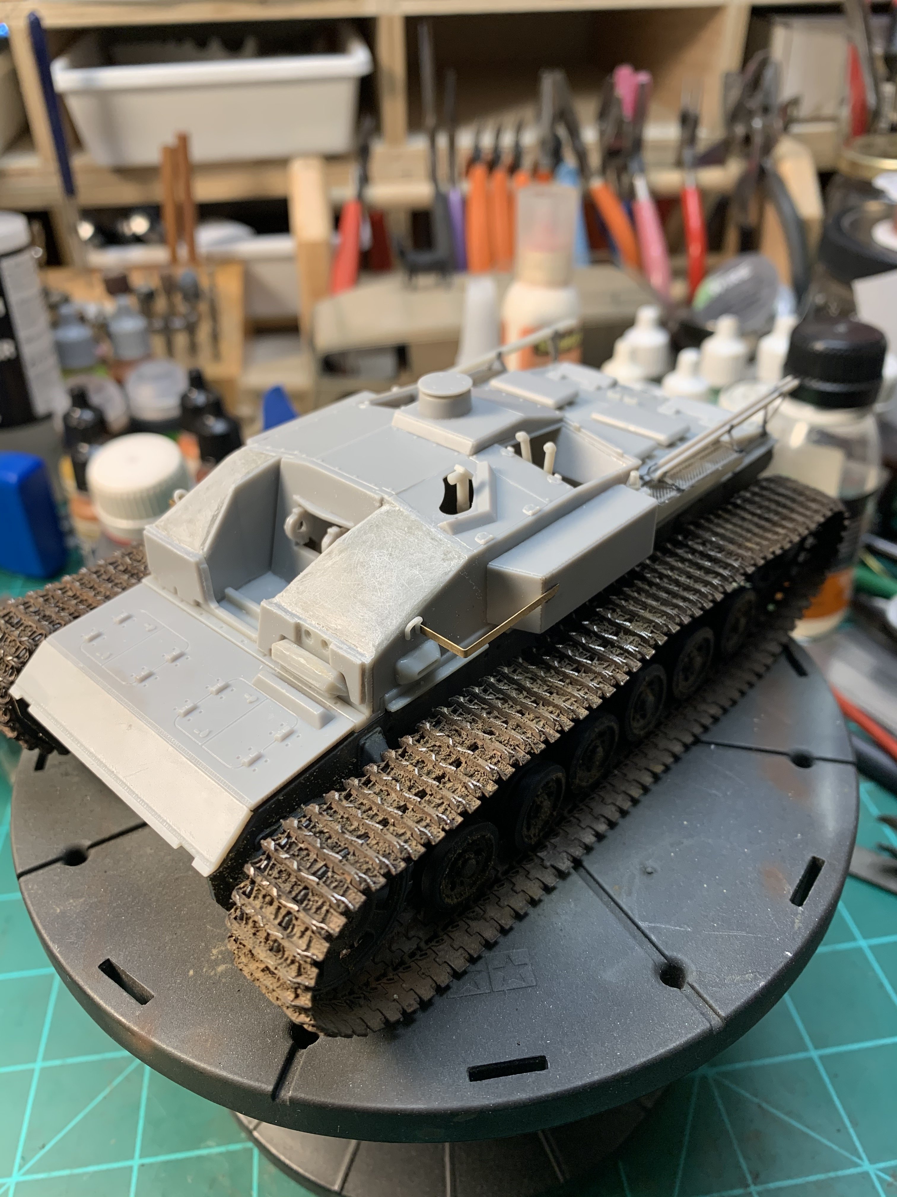

The tracks were well detailed and went together easily, a bath in track burnisher had them ready to install.
The road wheels, sprockets and return rollers went into place and the tracks installed.

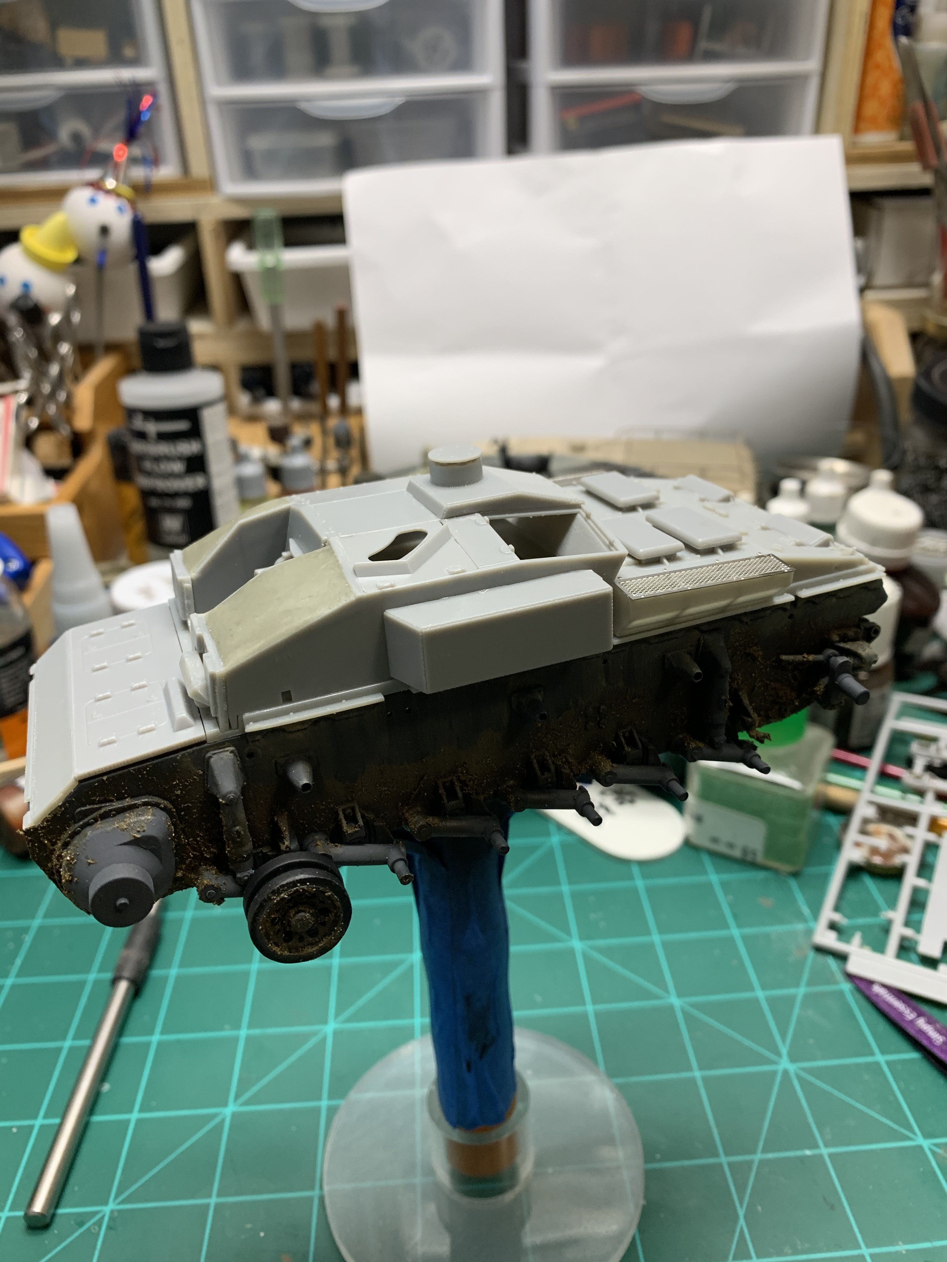

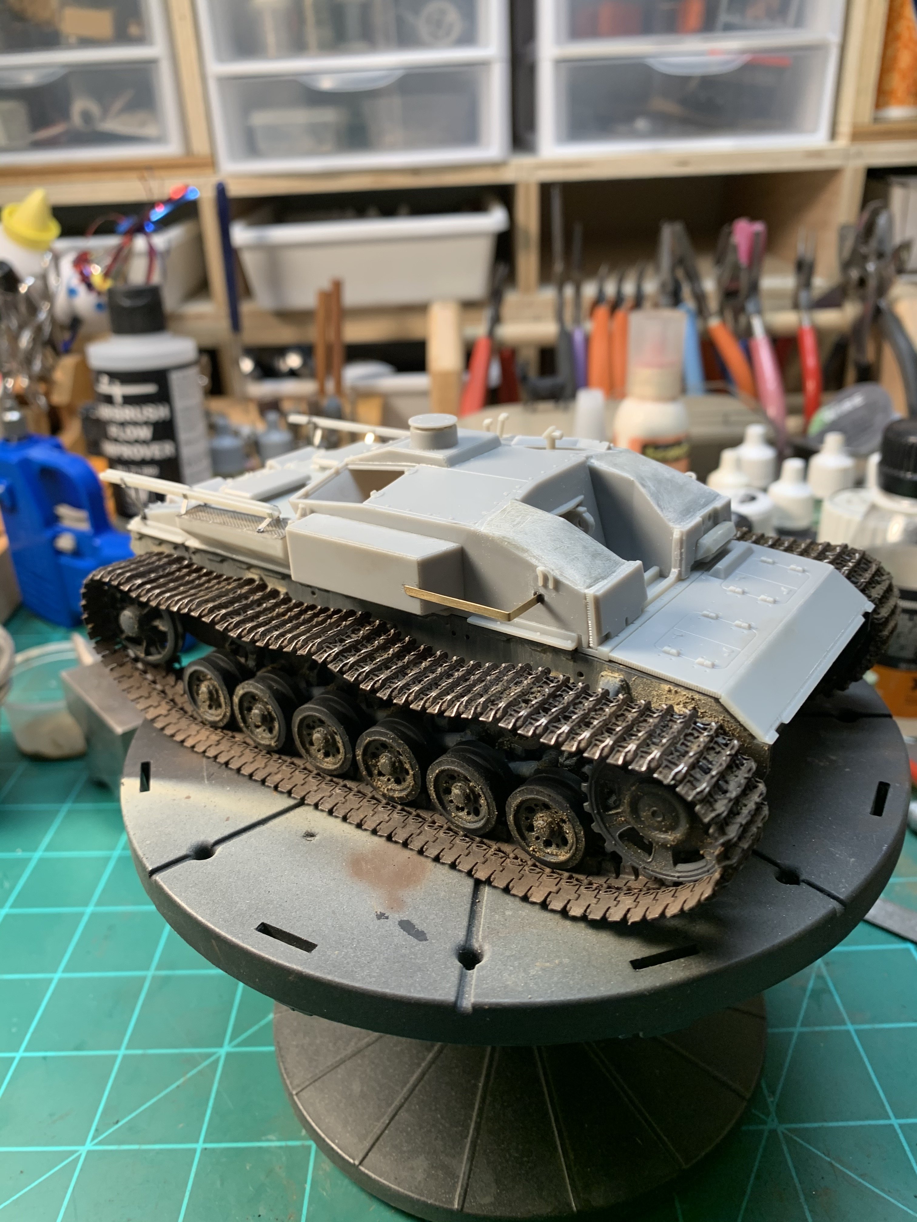

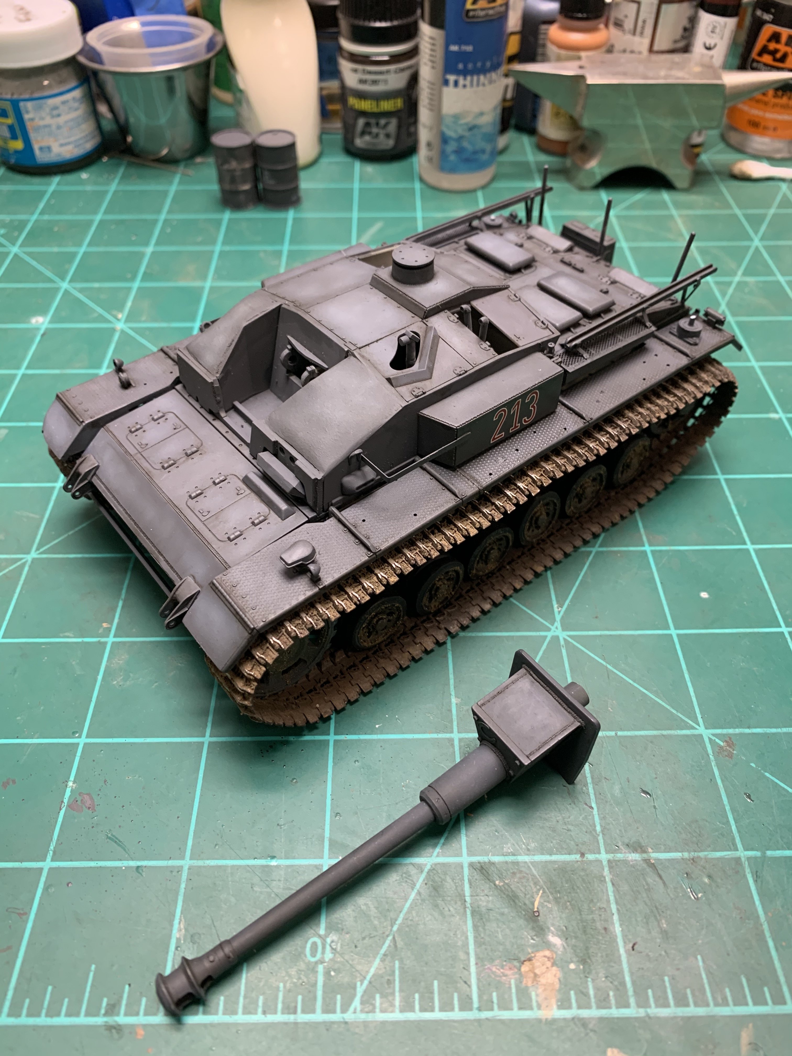

The upper hull is dry fitted to see if everything fits before paint.
As I said, I've been working on this for awhile without posting, so it looks like a lot of fast progress (but it wasn't). More to come, thanks for coming by!

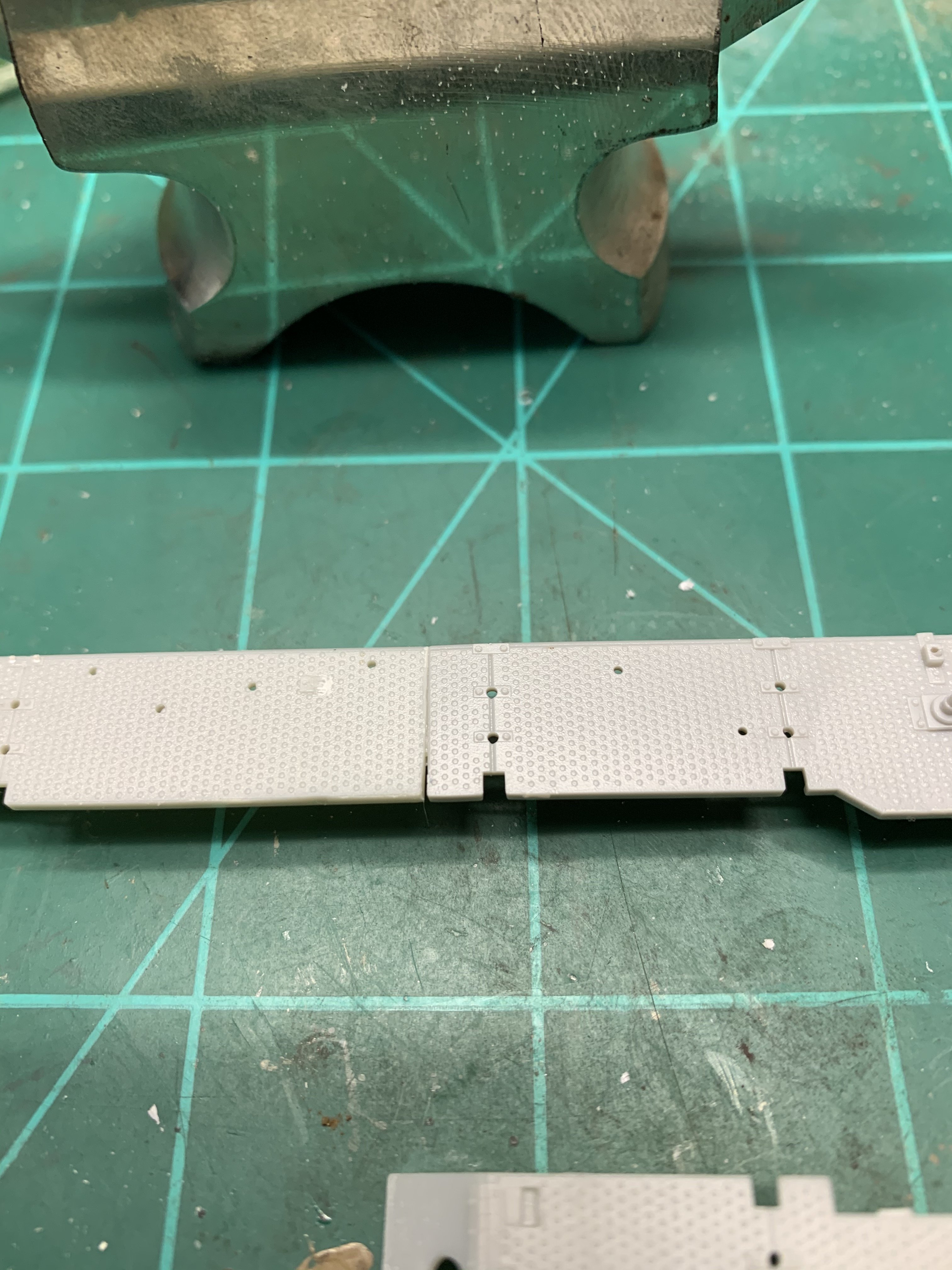

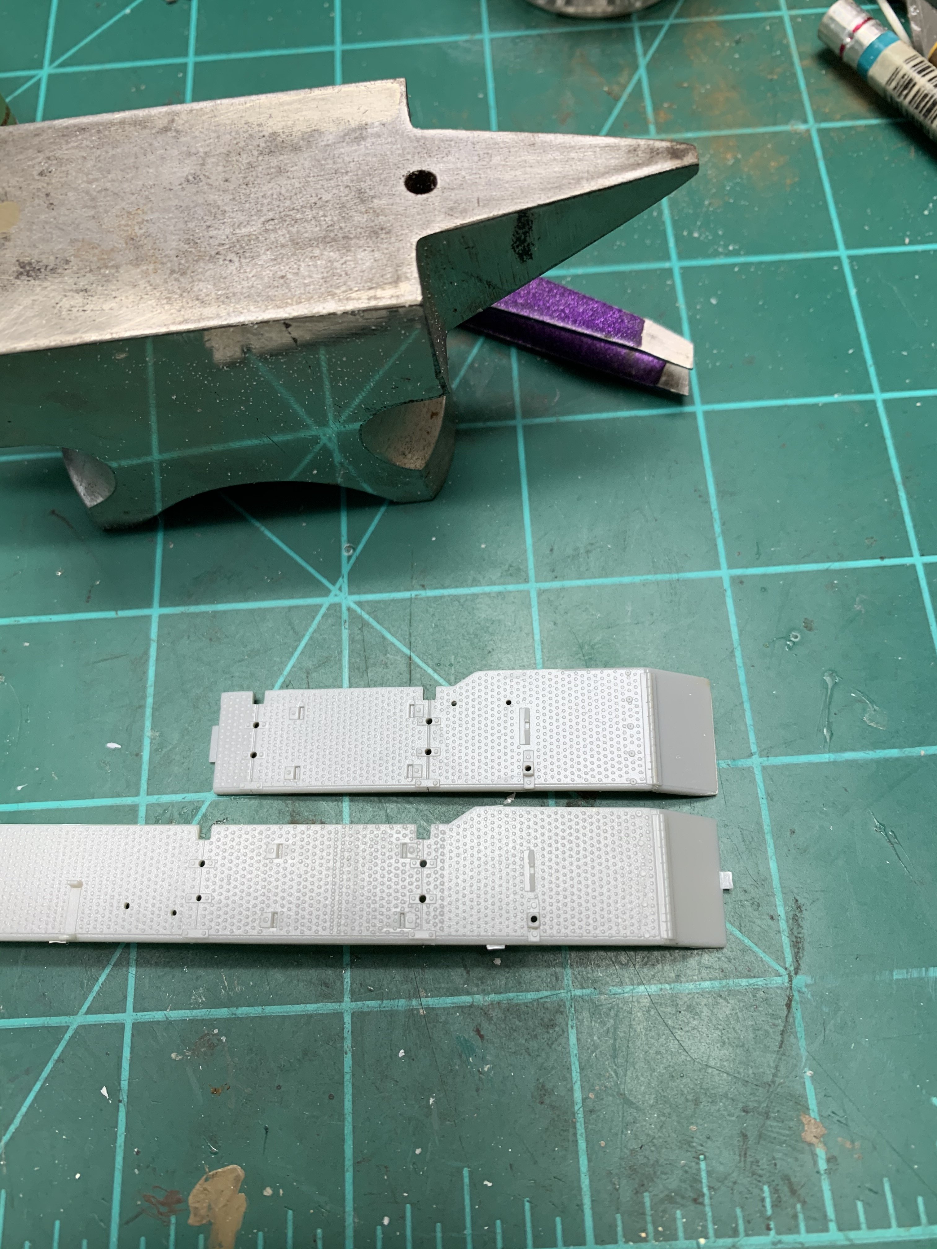

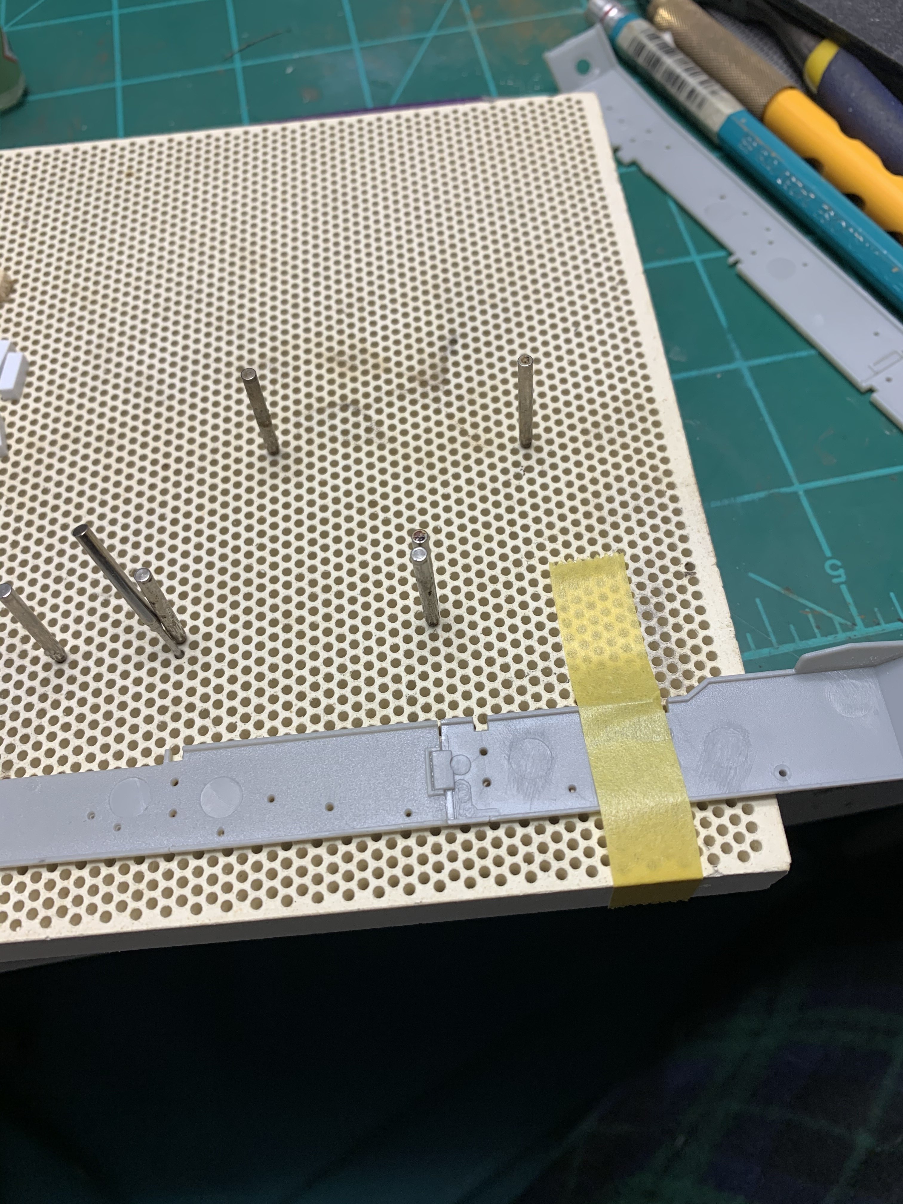

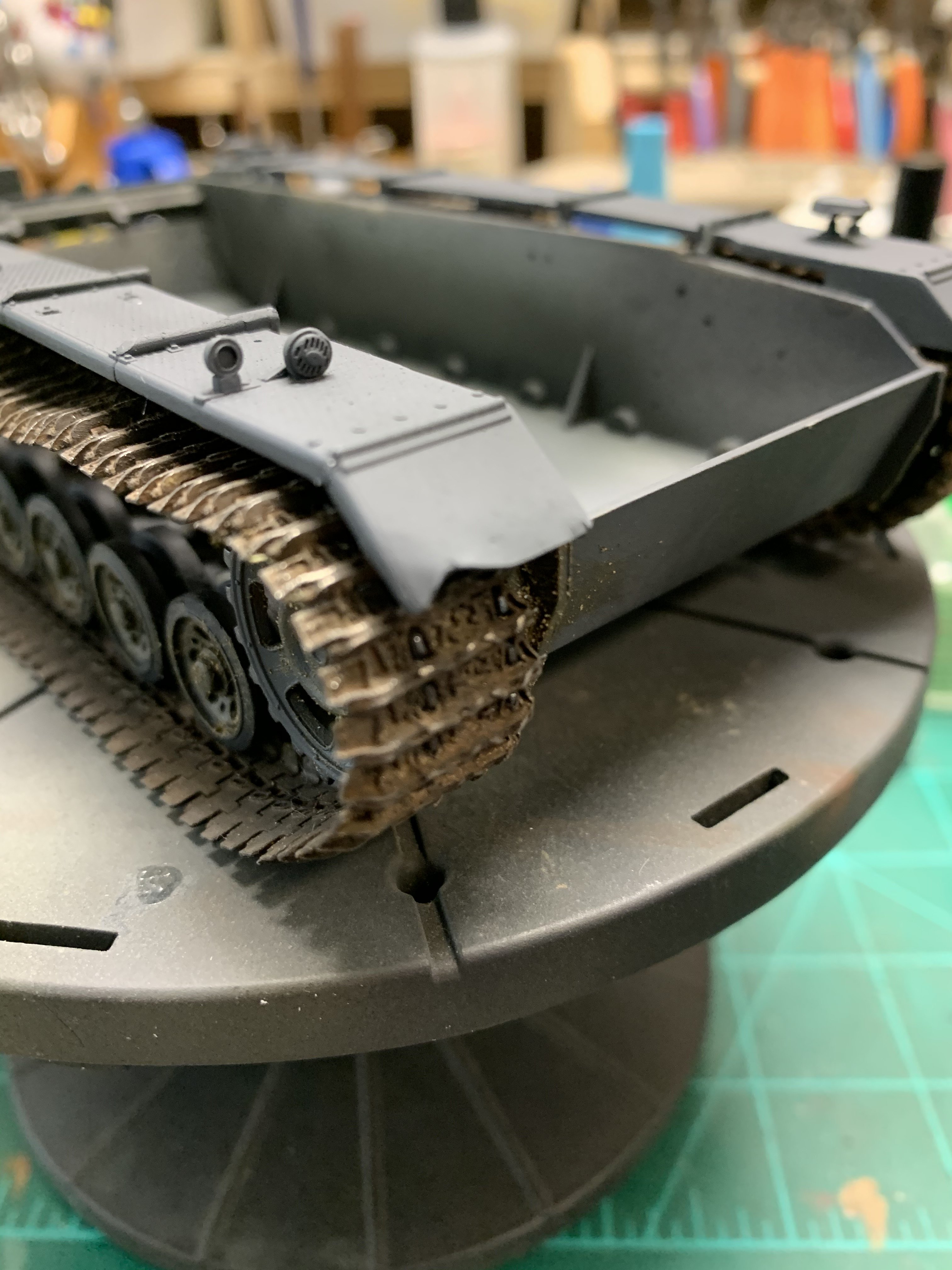

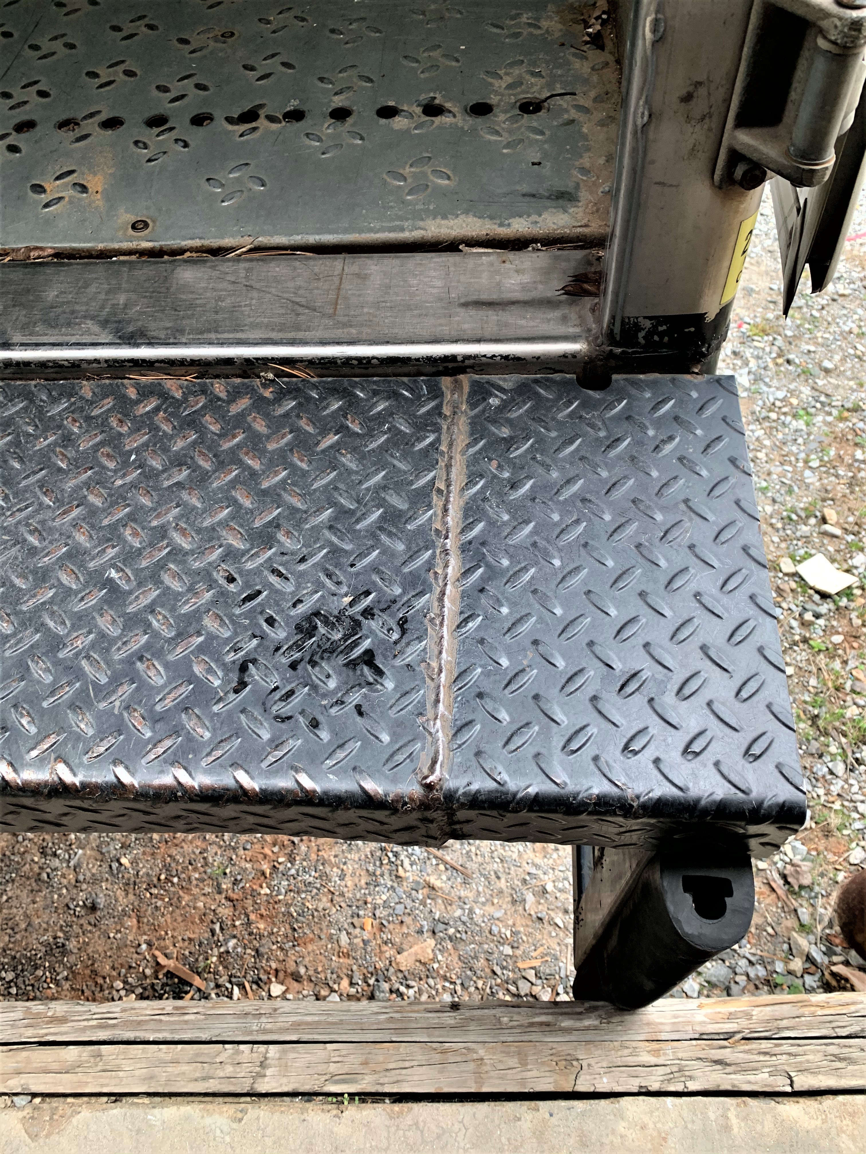

Thanks guys! Here's a little more progress. The kit fenders call to be cut off and another section installed to replace it. The section doesn't break at the joint and I was scratching my head on how to make it look right. Then this truck showed up at our dock.
BING! The light bulb went off.
I just added a weld from Evergreen half round, melted with liquid cement and textured with a blade.

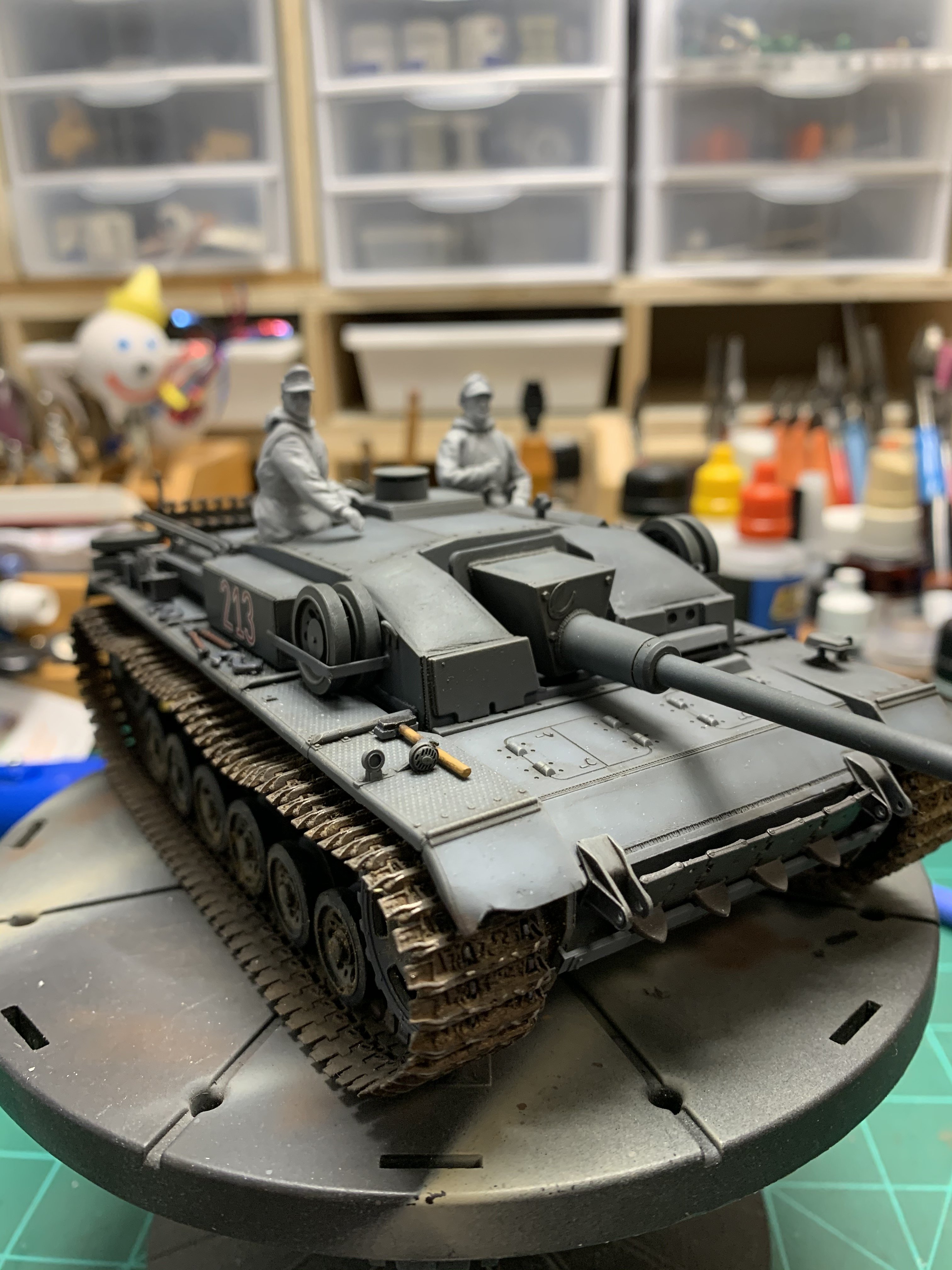

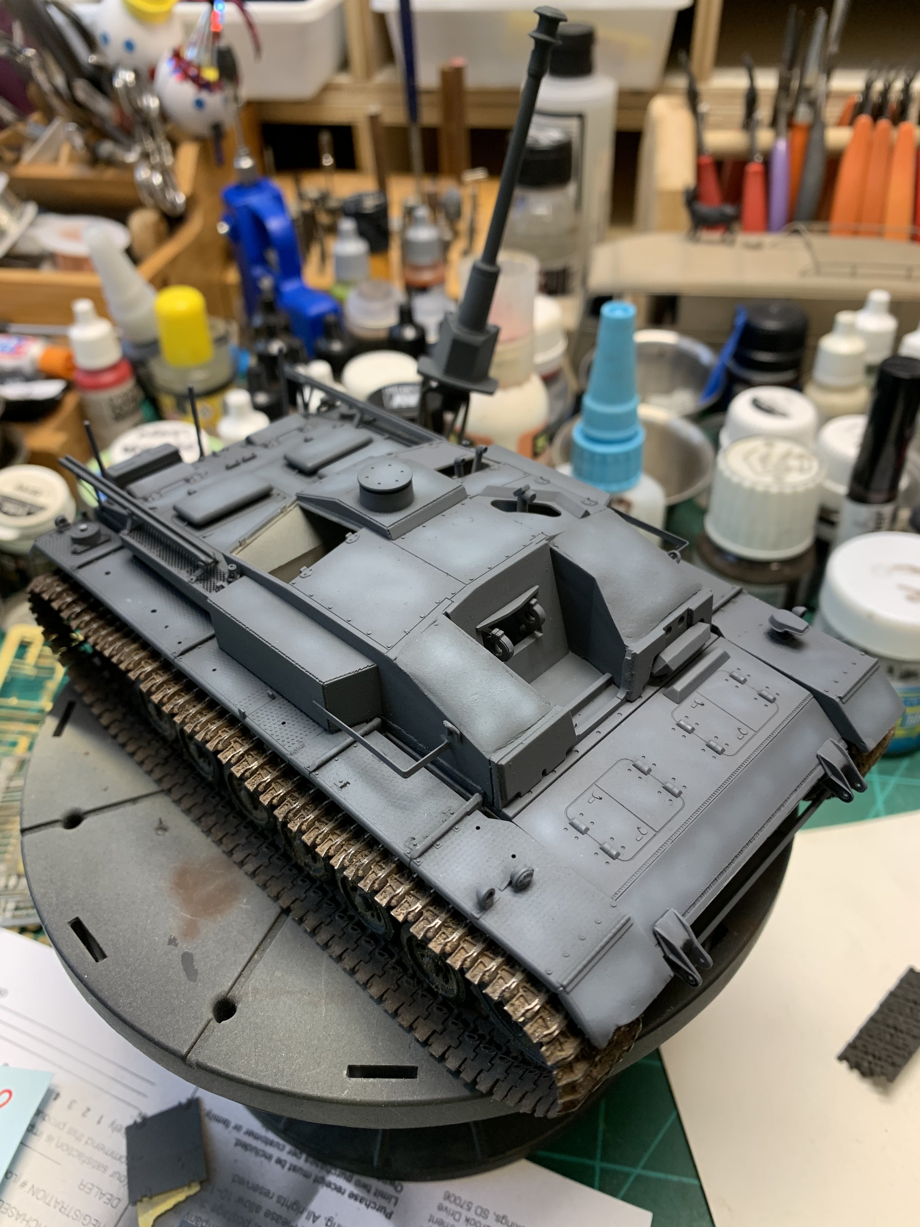

Let's paint!

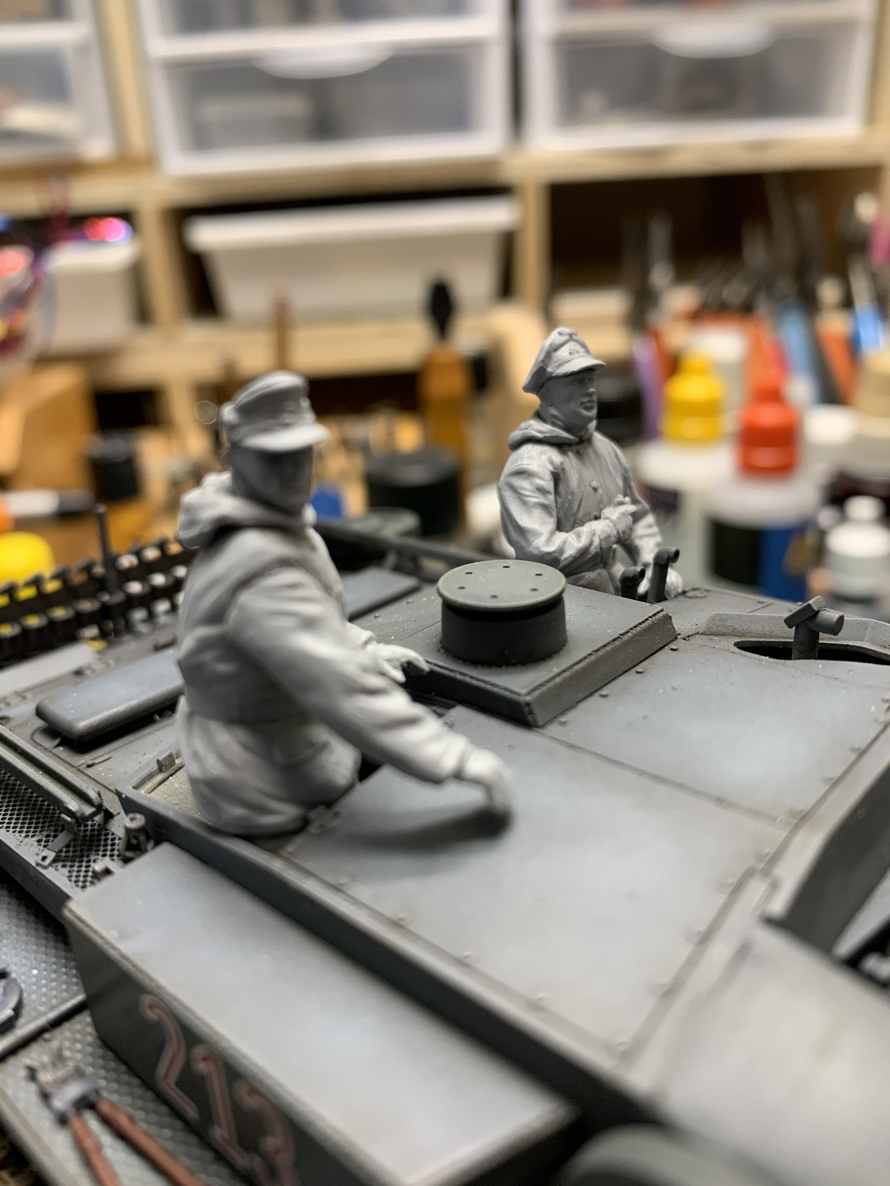

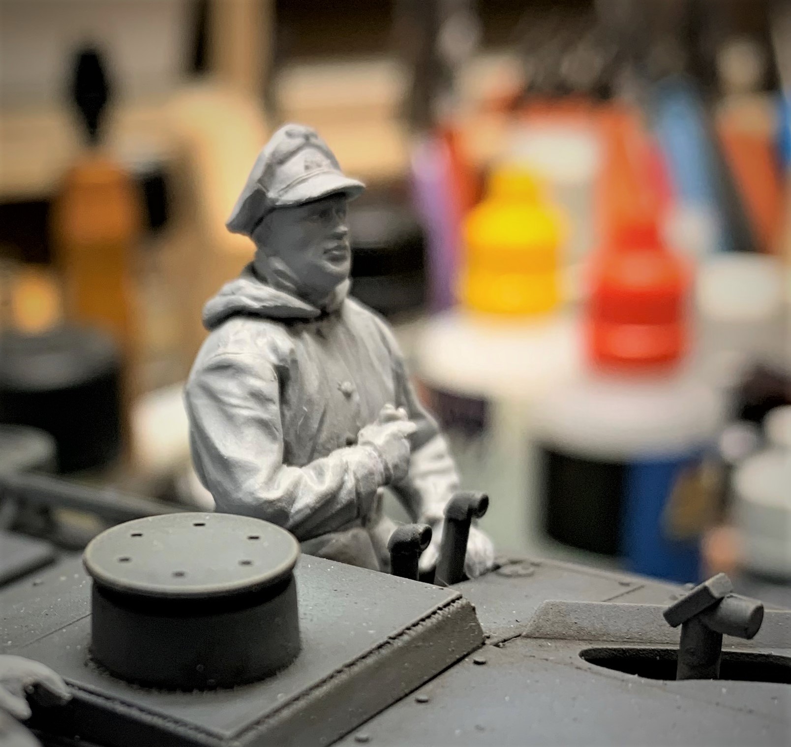

Where did those guys come from???
More to come, thanks for stopping by! :Drinks:

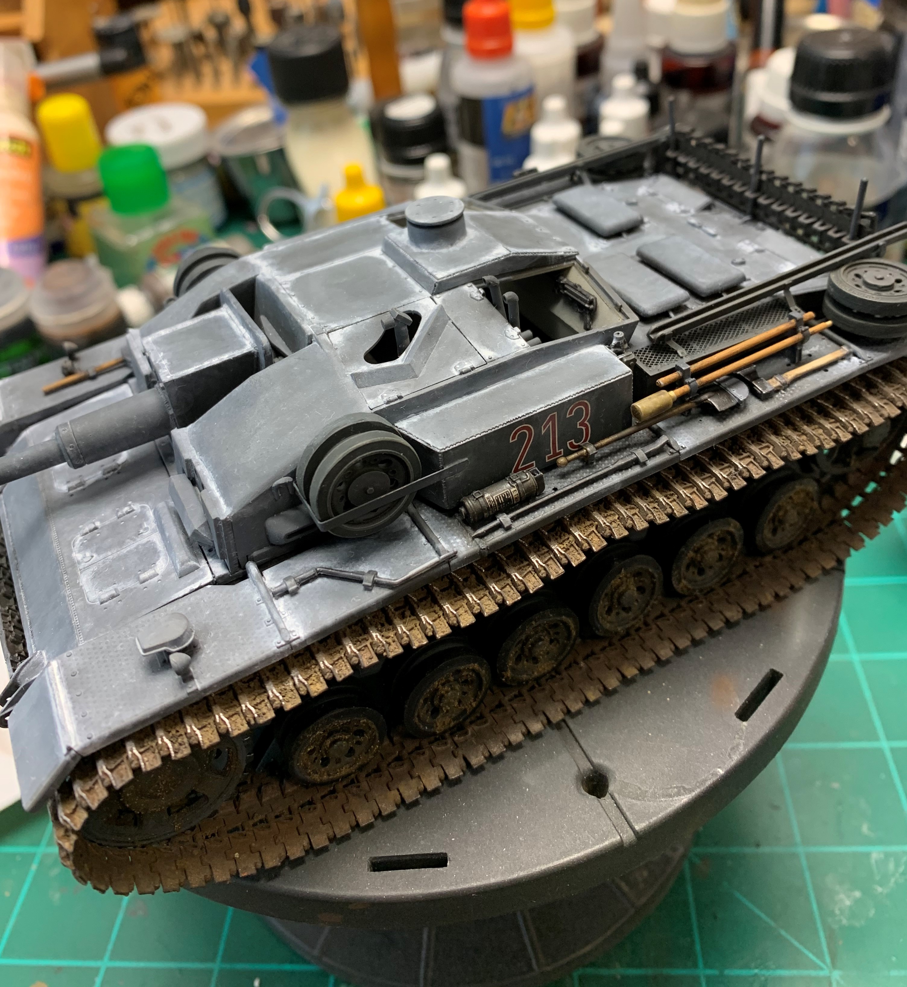

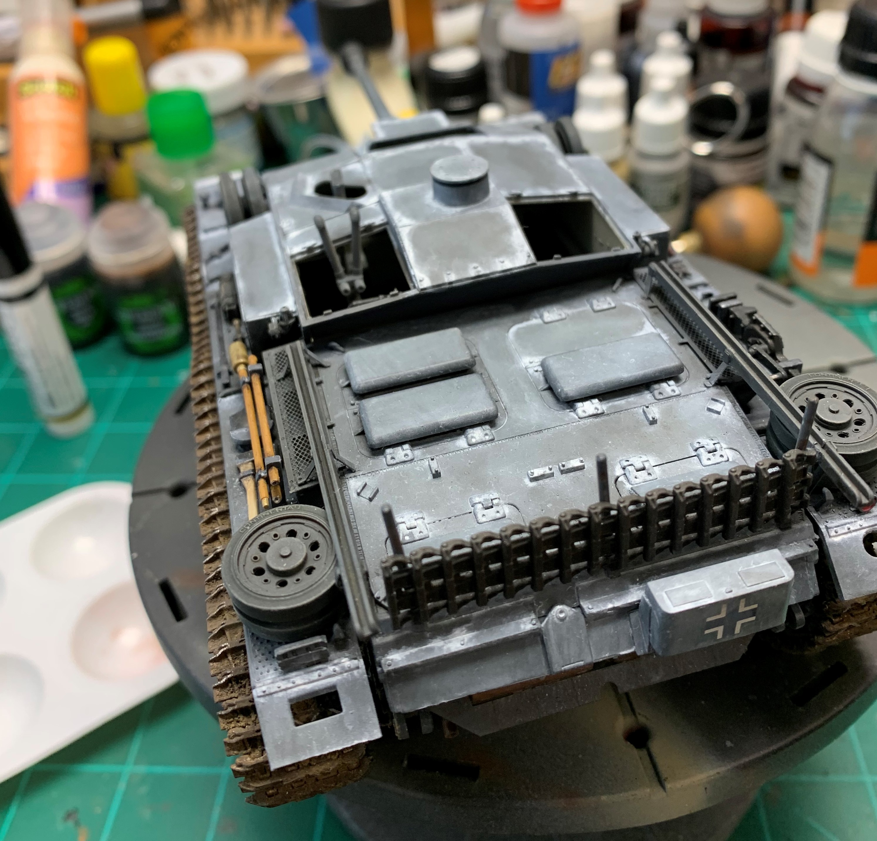

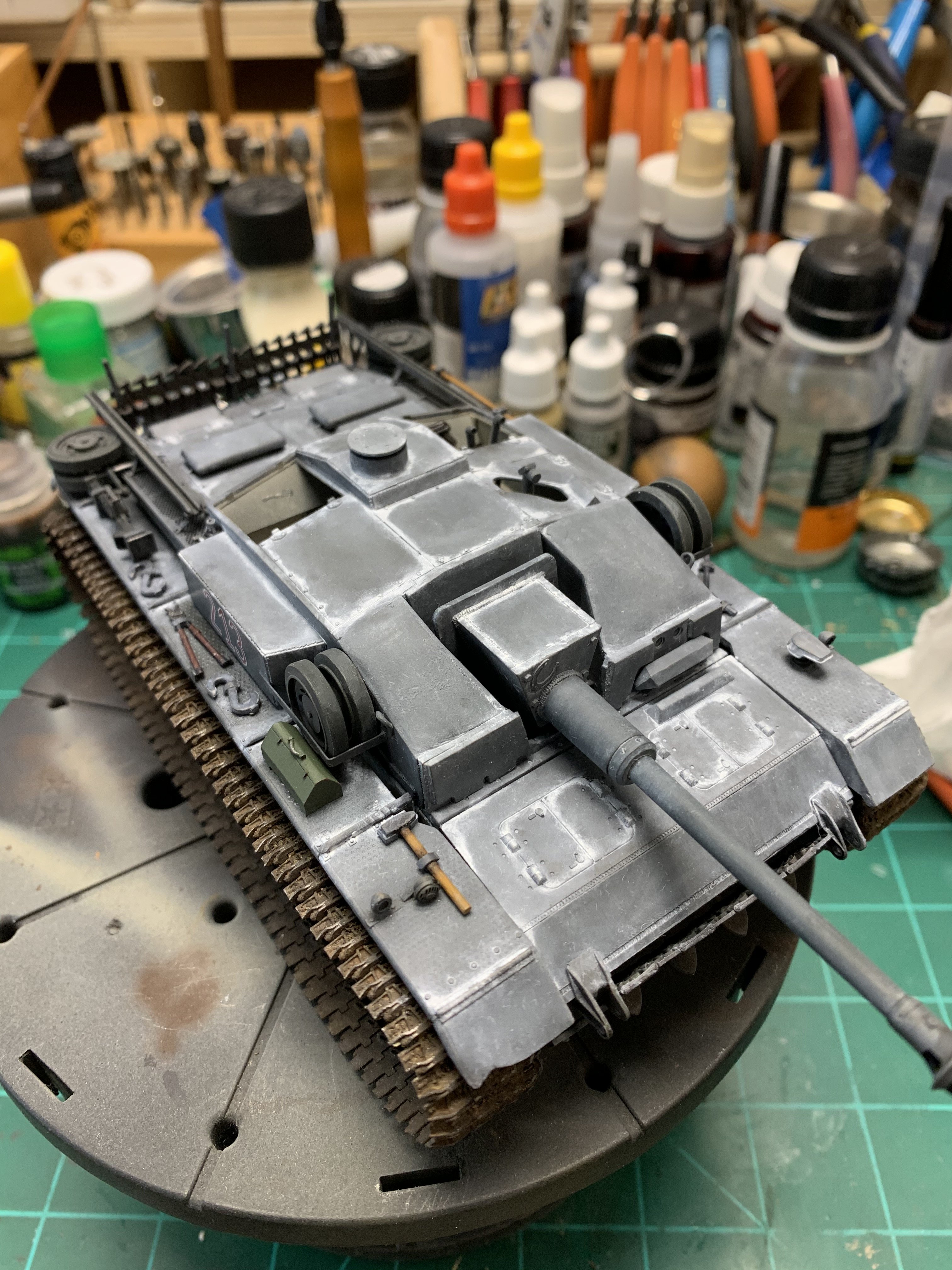

Paint and decals and Guys! Oh My!
Here's where we are this weekend, I wanted a late winter/early spring look.
The whitewash was applied to areas that would not have been worn away with traffic or weather. I used AMMO Oilbrushers and odorless paint thinner for the heavily worn look. Next up, I'll seal the oils and add dirt layers. Thanks for coming by! :Drinks:

"Odorless paint thinner"? MADNESS!! The snow effect is cool!
