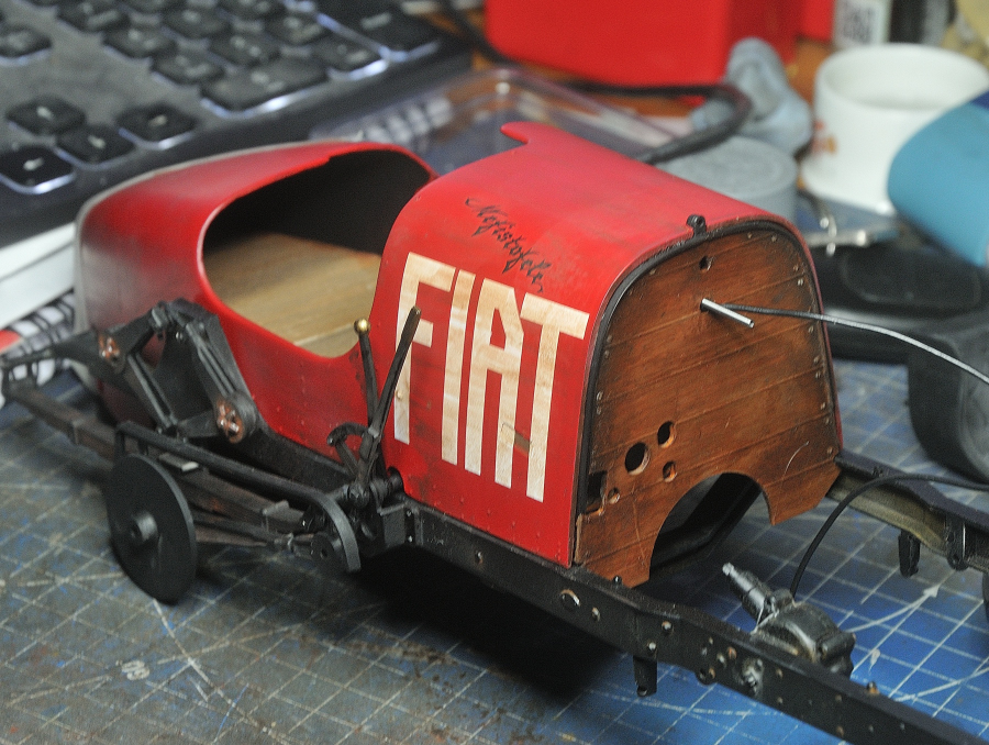

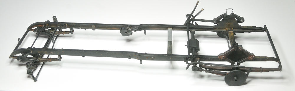

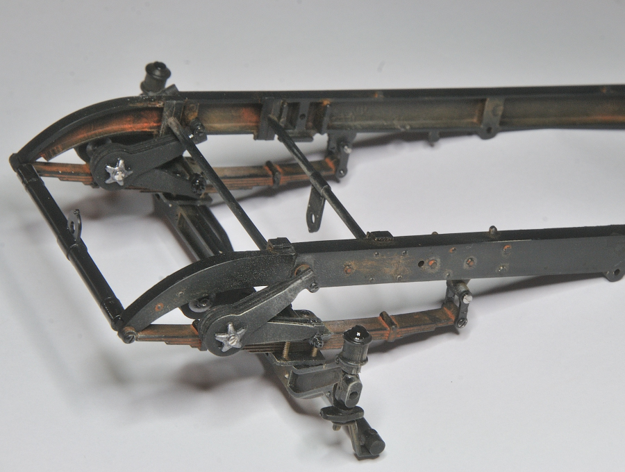

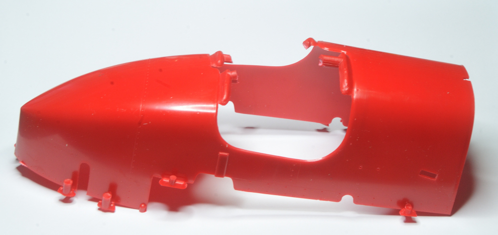

Chassis basics are done.
this is a strange model, its marketed as one of the set of between war Italian race cars by Italari but the quality of this one compared to the Alfa i built a few months ago is awful. The basics are there to build a good model without a doubt but the flash, sink marks, attachment points etc are really 1970's, the use of dozens of unnecessary screws and the brittle plastic used , do this model no favours. It leaves you thinking at £150+ its not as good as the 50 year old airfix Bentley for less that 2/3 the price.

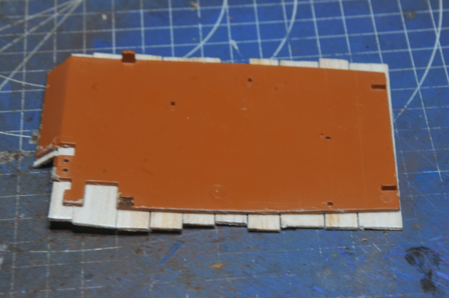

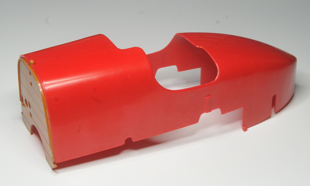

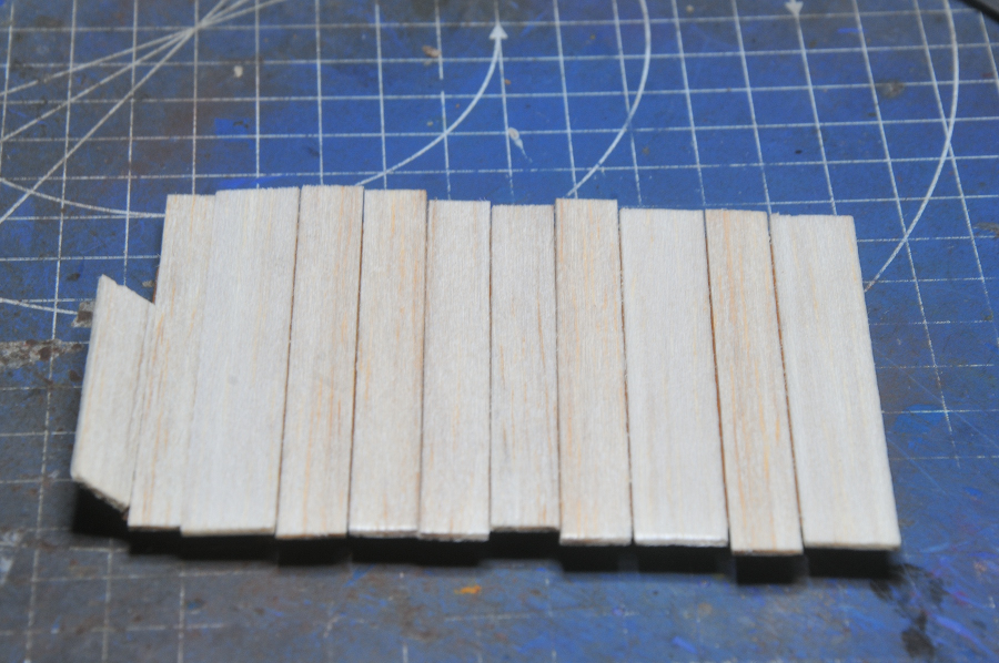

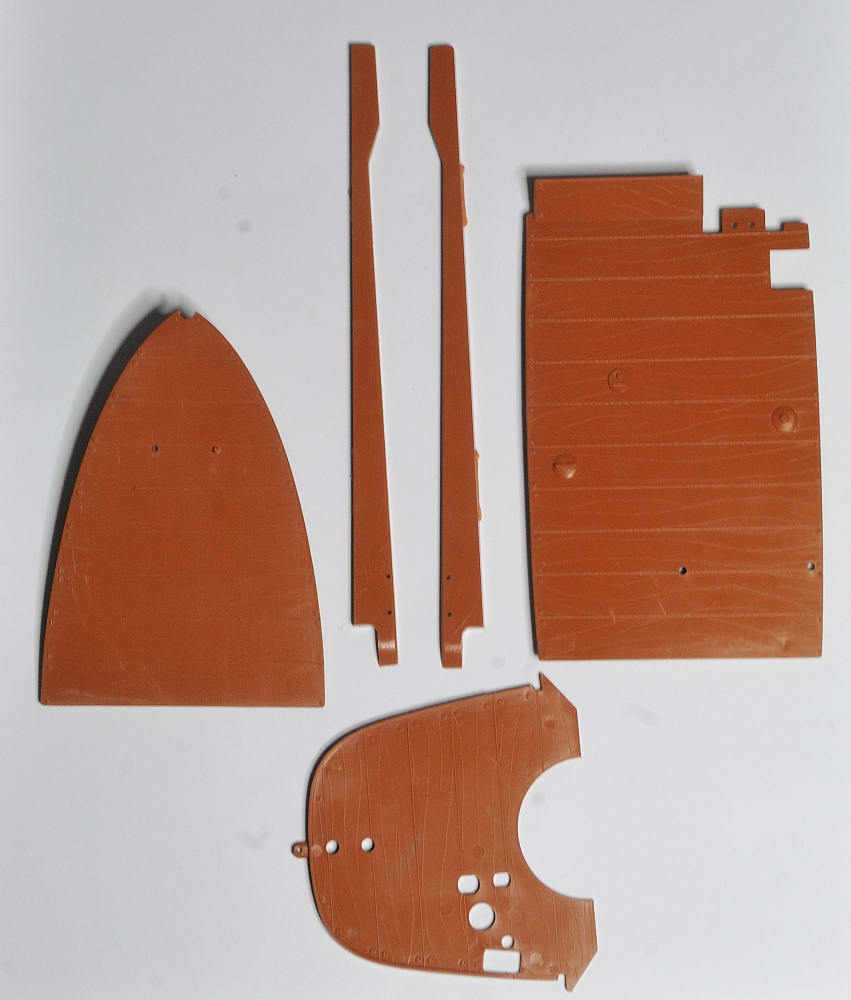

I decided i would cover wood parts in balsa. so the floor and firewall/bulkhead which are supplied in a sort of red brown plastic like this

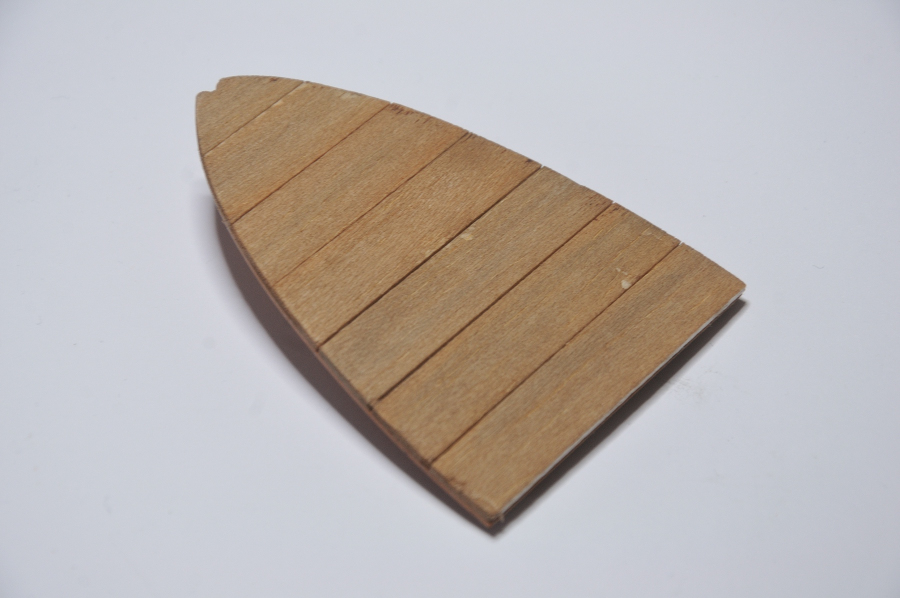

I basically just covered the parts
then trim the balsa to the plastic and stain
Same for the rear floor

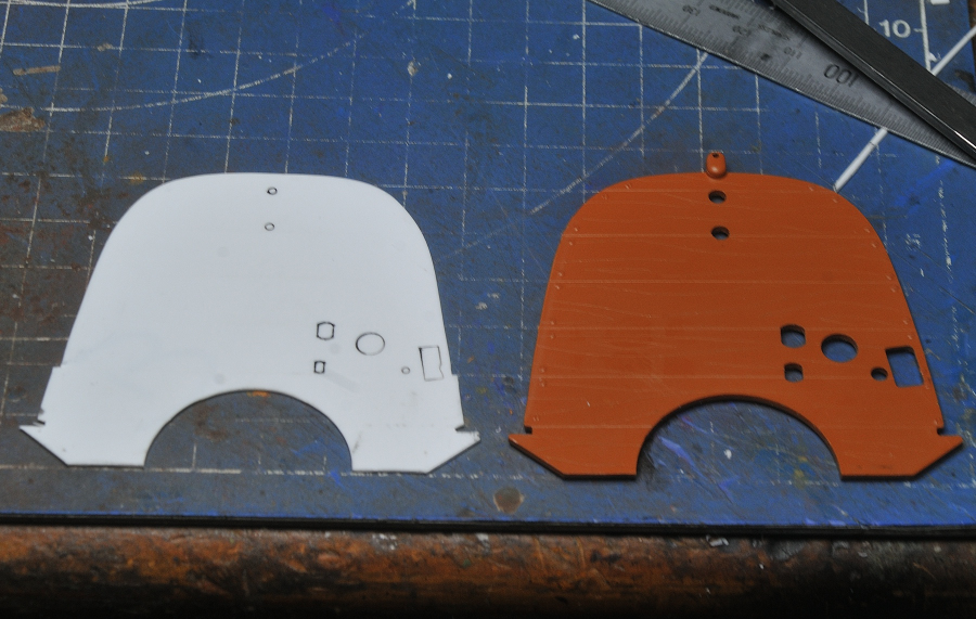

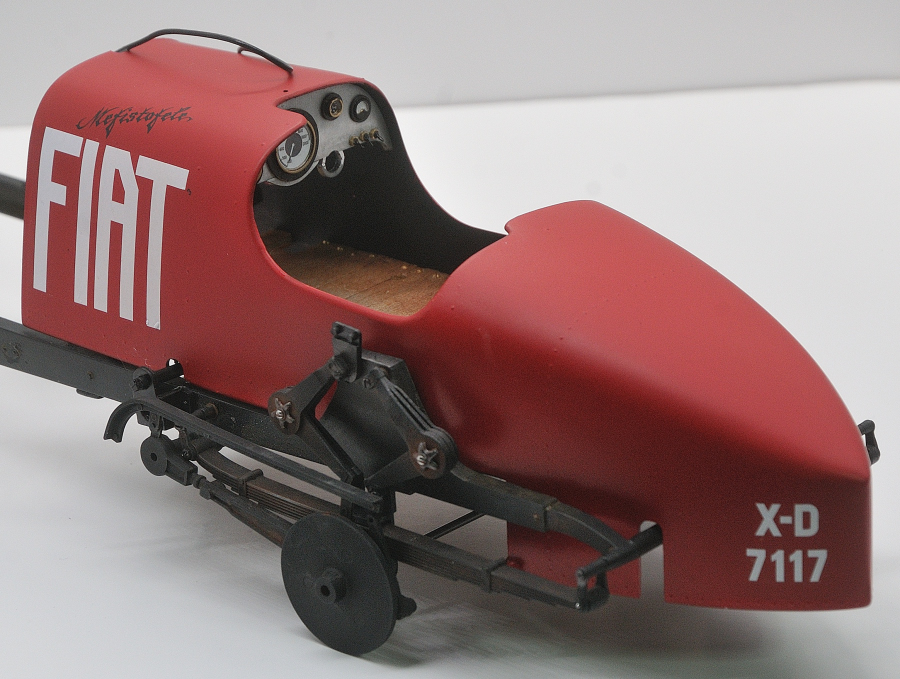

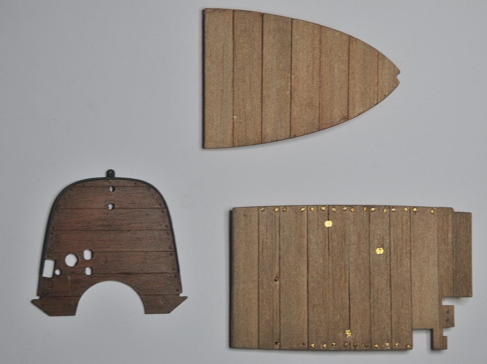

However i suddenly though, this bulkhead would be almost black with oil and grime so the above shows the plastic just coated in oil paint burnt Umber.

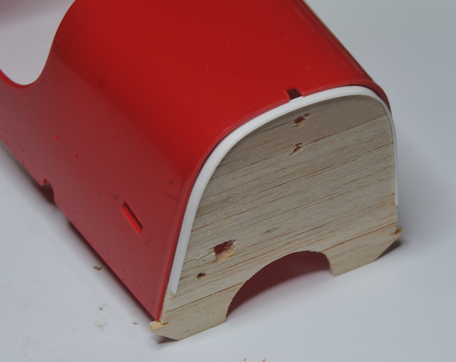

Initially i was going to cover the bulkhead in Balsa but it would been be too thick. The answer was to make a thinner plastic bulkhead and cover that in Balsa.......Yea you can see where this is going :)
I cut out a new BH in paper thin plastic sheet
covered it in Balsa and gave it a thin strip like the original round the edge and it did fit the body
I then ran into problems putting holes in the balsa, its just has too slack grain and splits down the grain. It was at this point it suddenly occurred to me this doesnt need to match the floor as it would be oil soaked anyway so i scrapped that and oil painted the original part
a wasted Sunday but actually quite fun all the same :)

My Dad used to build balsa Gliders and i think he used to burn holes with a hot nail.
Love the wood work. Maybe a better alternative if you need to cut holes would be some basswood? No matter, it still looks so cool.

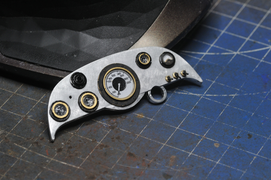

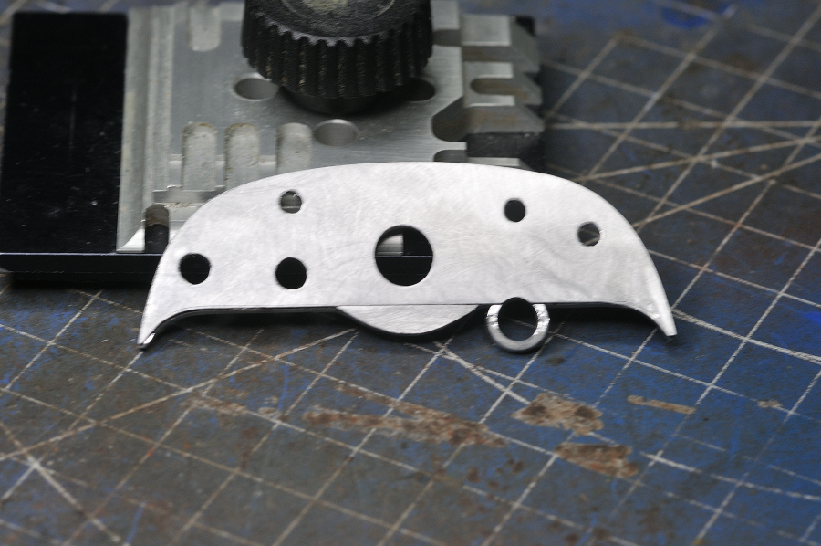

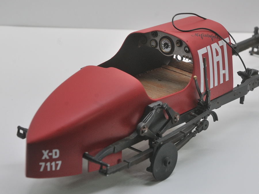

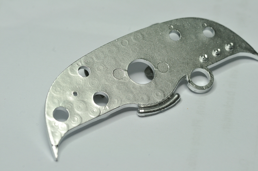

the instrument panel is a bit odd ?
I realise now the curved bit n the bottom is part of the Sprue ;-) however the circles/finish i think is an attempt at what they call engine turning.
I doubt that would e accurate because this is a one off home made car and crude ( I'm being polite) :)
Anyway it had to go and this is my aluminium replacement
and once the instruments are added along with three toggle switches thins look a lot better.
As has been mentioned the restored car is the pattern for the model however in 1925 thy didnt have modern toggle switches :)

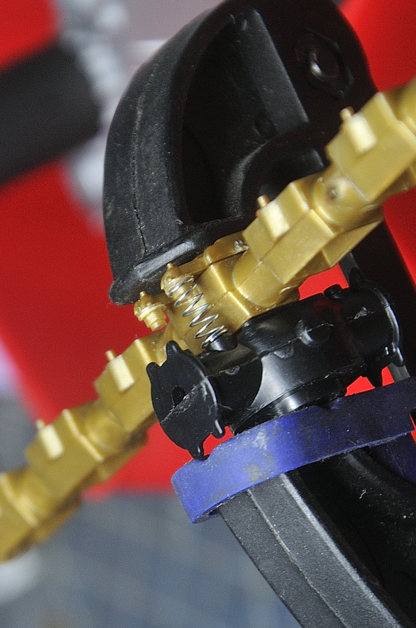

Looking over some parts for the engine the valve gear needs some work
this is a mock up of what you get
and this is what it should look like
so the kit has no valve stems or spring caps, at this point even the springs look a little feeble.
Because this right on top of the engine it needs to be put right, i just need to figure out how to do it with such small parts
