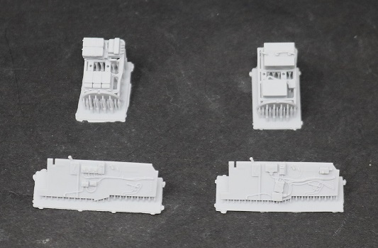

The Eduard cockpit kit arrived last week from The 48ers in Cyprus. It has both radio configurations. On the left is the SCR-274 radio and the right hand side wall configuration which the kit has. On the right is the SCR-522 radio and side wall configuration that is needed for an ETO P-38.

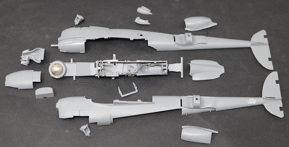

Time for some pictures. These are most of the bits that go into the assembly of each boom. There is an access panel that needs filing on the inboard side of the RH boom as identified in the instructions

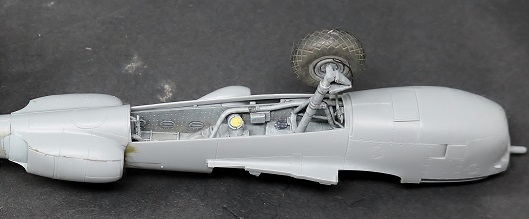

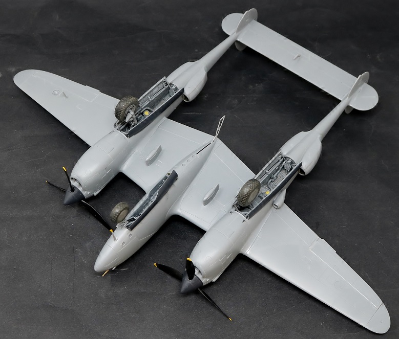

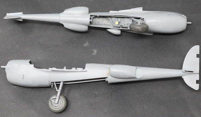

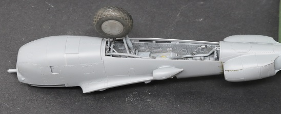

Both booms built up and the wheel well painted and weathered. I did skip ahead and added the main gear strut and wheel. The interior of the intakes under the propellor and the outboard intake were painted Neutral Grey. The radiator intake interiors were painted OD with the exposed aft painted Medium Sea Grey. When the doors are installed, the gaps between the top of the bay and the boom are filled in by their supports.

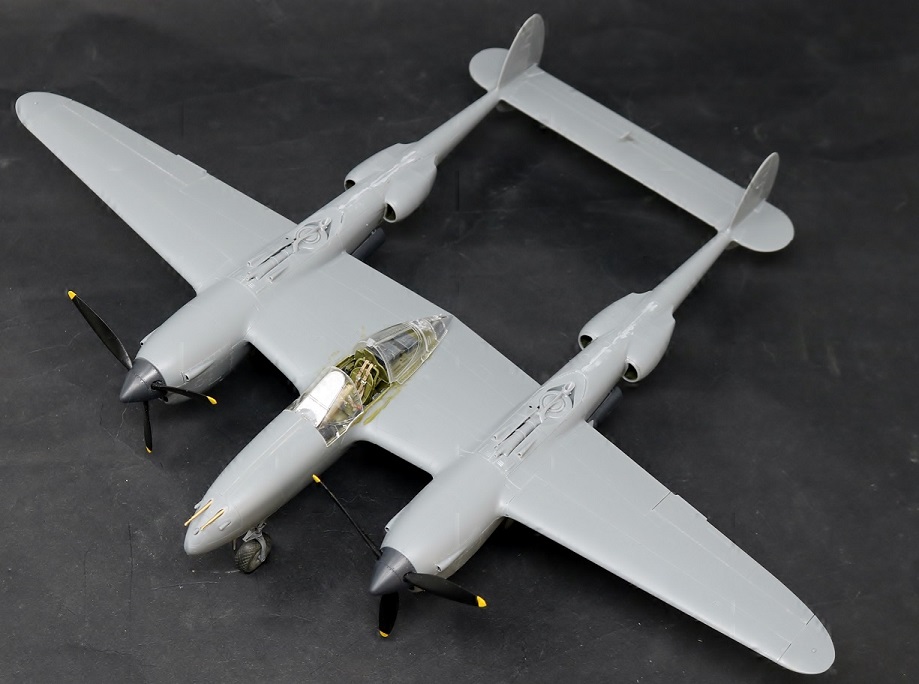

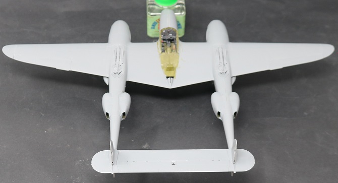

An overall look with the booms and stabilizer press fit into place. Everything is looking square.
Cheers,
RichB

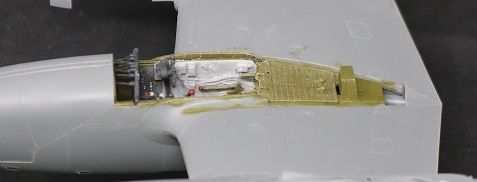

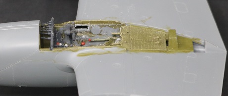

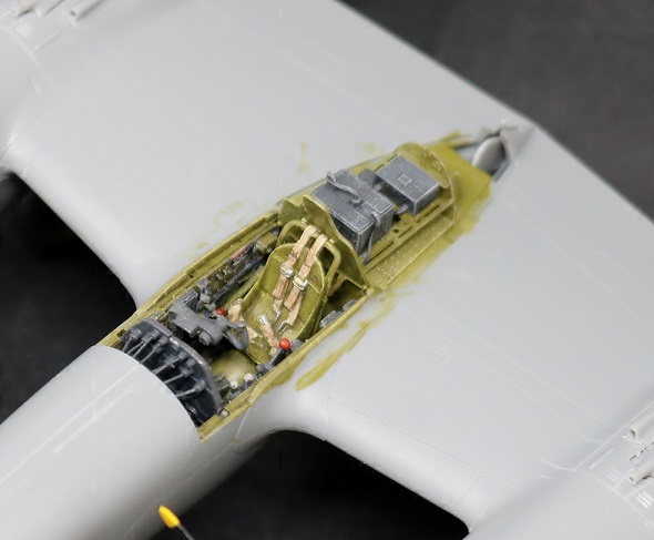

The cockpit went into surgery last night. Armed with a new X-acto blade, an assortment of small files, a sanding board, a scrapper and a nut brown ale, the fun began.
First step was to remove the raised detail from the kit side wall. There was just enough space to fit the knife blade and scrapper between the wall and other cockpit fittings. The removal of some of the boxes left a hole but that will be covered by the new wall.
The back of the new wall was thinned down and with a bit of a trim to the length, the wall slides in almost like it was supposed to go there. I'll be able to paint it seperately and slide it back in before securing it.
It went alot quicker and smoother than expected. The Gods must have been smiling on me.
