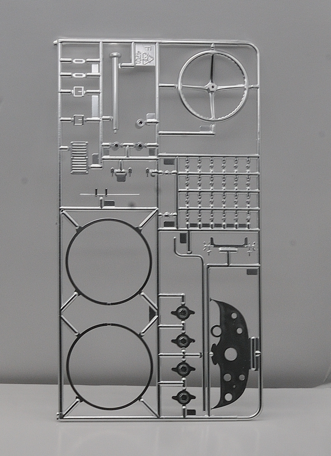

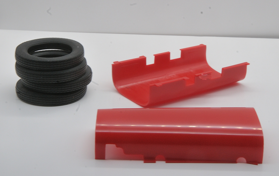

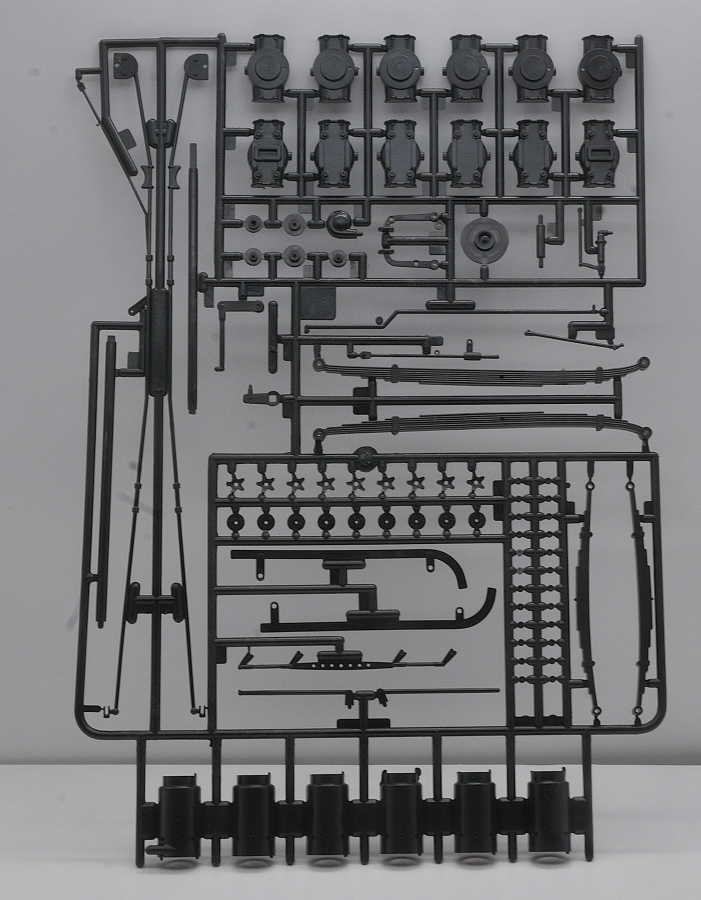

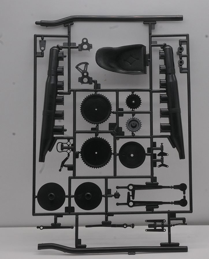

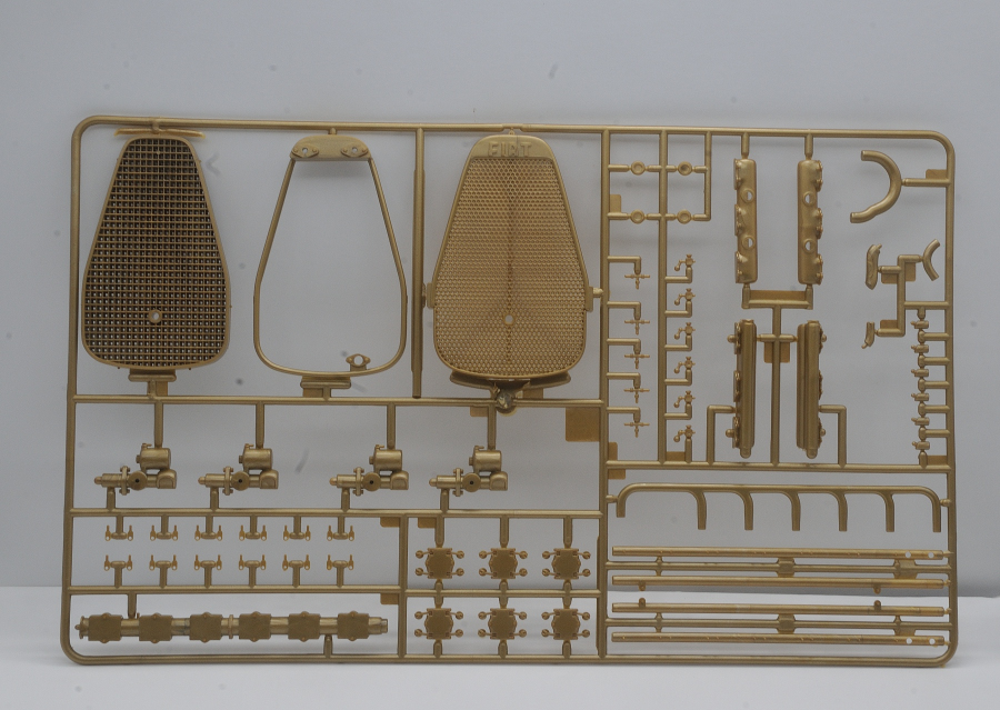

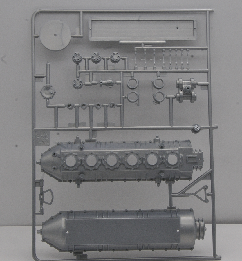

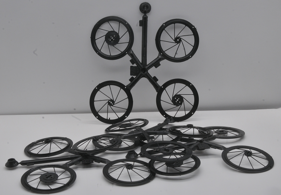

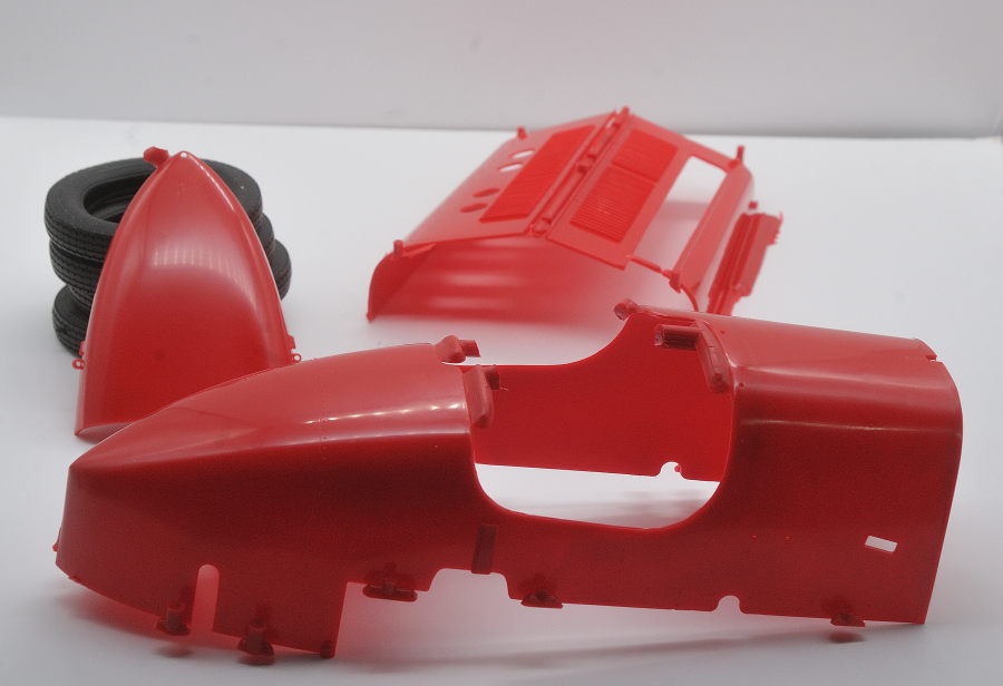

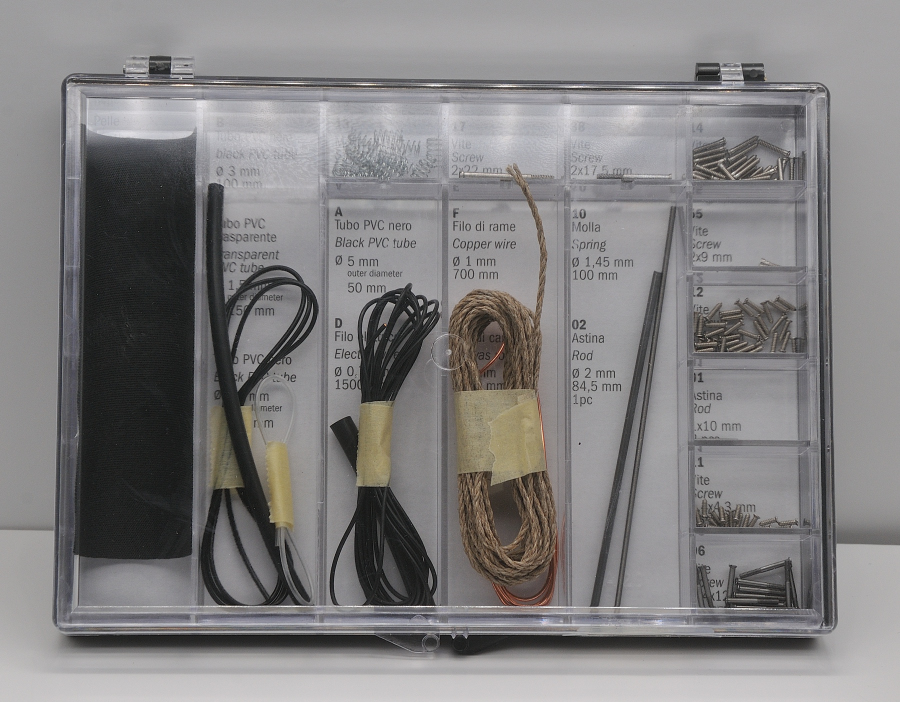

Here is a look inside the box
DSC_4664.JPGDSC_4665.JPGDSC_4667.JPGDSC_4669.JPGDSC_4670.JPGDSC_4671.JPGDSC_4672.JPGDSC_4673.JPGDSC_4674.JPGDSC_4675.JPG DSC_4668.JPGDSC_4676.JPG

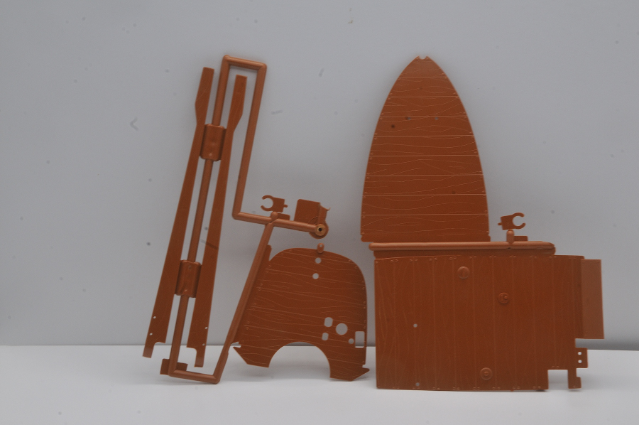

Parts are coloured Wood, Brass, Alloy, Chrome, Black and Red.

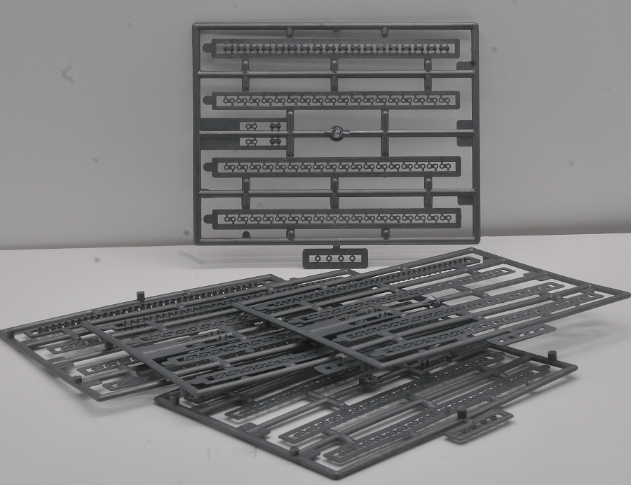

The last picture is the Chain drive links which look fun :)

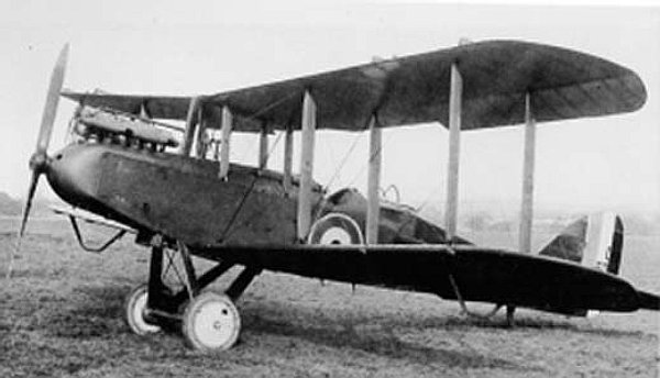

Here is the engine in its intended use :). An Airco DH-9, looks like they had the sense to enclose the valve gear :)
220 cu inch per cylinder
Something to consider when using original '20's period black and white photos is that many of the early processes would show red as a dark black color. Just looking at the above aircraft tail colors, I believe the coloring is from front to back blue white red. Note that the blue is a very light grey while the red is black.

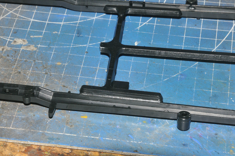

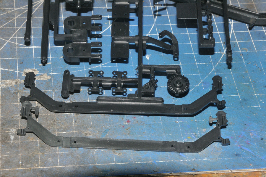

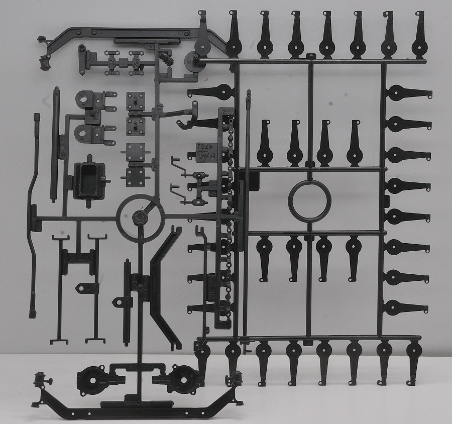

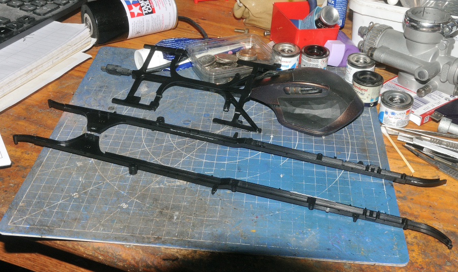

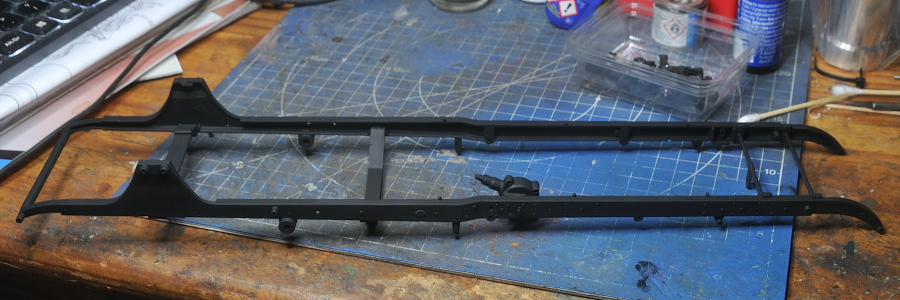

Very strange sprues not seen any like this before

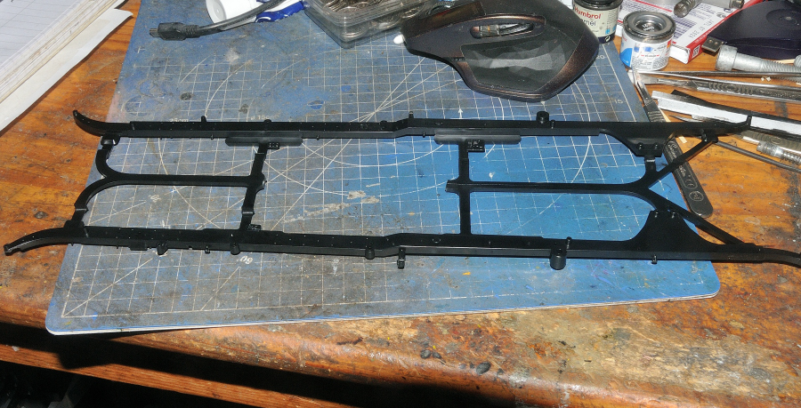

this is the Chassis rail Sprue
the centre section needs to be removed but look at the attachment points
this one is nearly 1.5 inch :)
This shows a chassis crossmember half removed and half still attached .
and these are the chassis rails removed the parts behind are the Sprues for the bin.
none of this is a problem as its just the Chassis

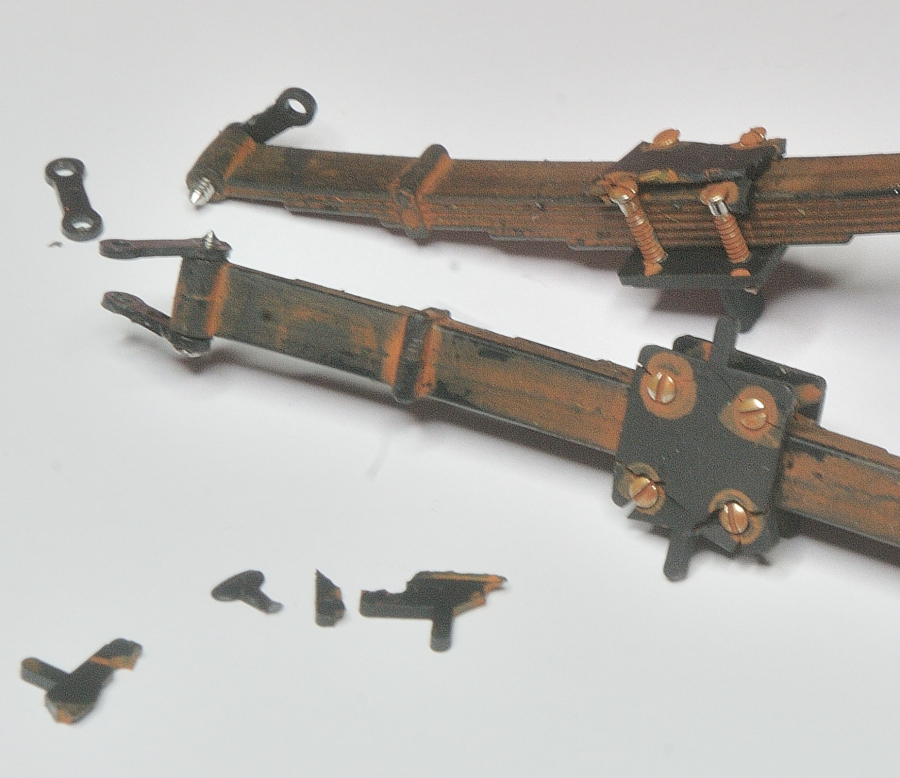

Those of you who have followed my builds in the past will know i post my successes and my failures so others might gain from them :)

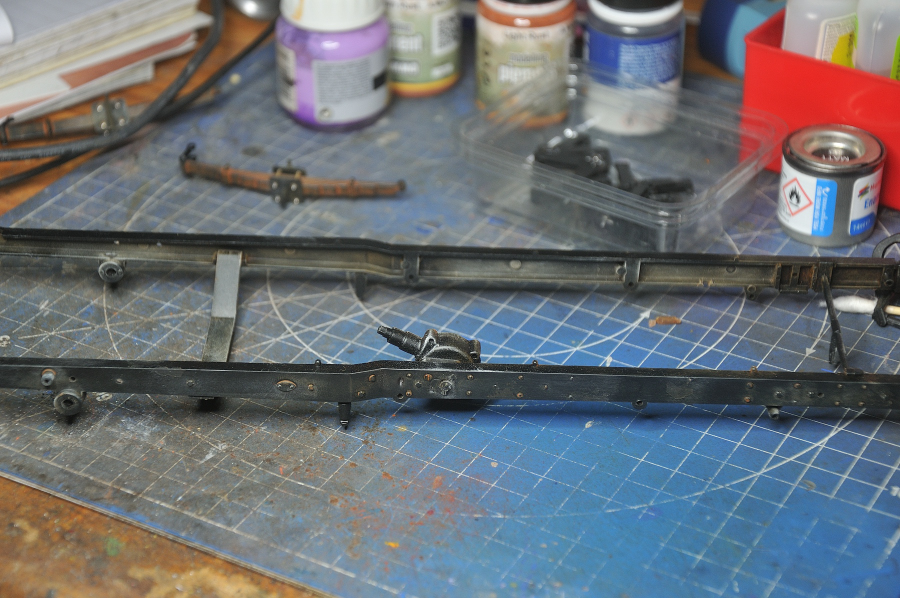

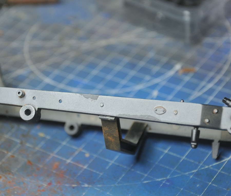

this is what happens to Italeri plastic if you put enamel panel wash by mig on it. Basically it just goes hard and shatters.
these were not over tightened, they were gripping very lightly and were fine for an hour after the wash was applied but after 3 hours they has self destructed.
Its a pain but fortunately the parts are not no hard to reproduce, i will have to order some plasticard.
footnote
i have had absolutely no luck with anything MIG from paints, especially spraying, to washes. They seem very dependant on what material you are spraying. I now need to re think this build as i had planned to use the techniques i had learned from armour building to weather this car.
Plastic is a petroleum product, so is white spirt which is the base for the wash i would think
View attachment 154916View attachment 154917View attachment 154918View attachment 154920View attachment 154921View attachment 154922View attachment 154923View attachment 154924View attachment 154925View attachment 154926 View attachment 154919View attachment 154927
