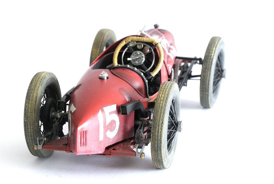

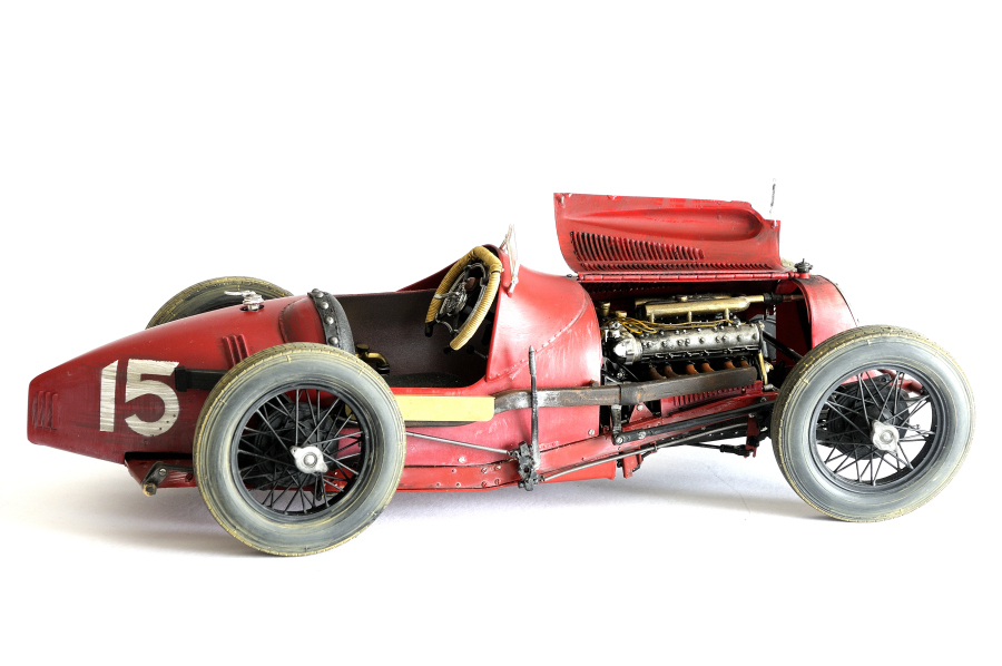

Fiat 806 GP FINISHED

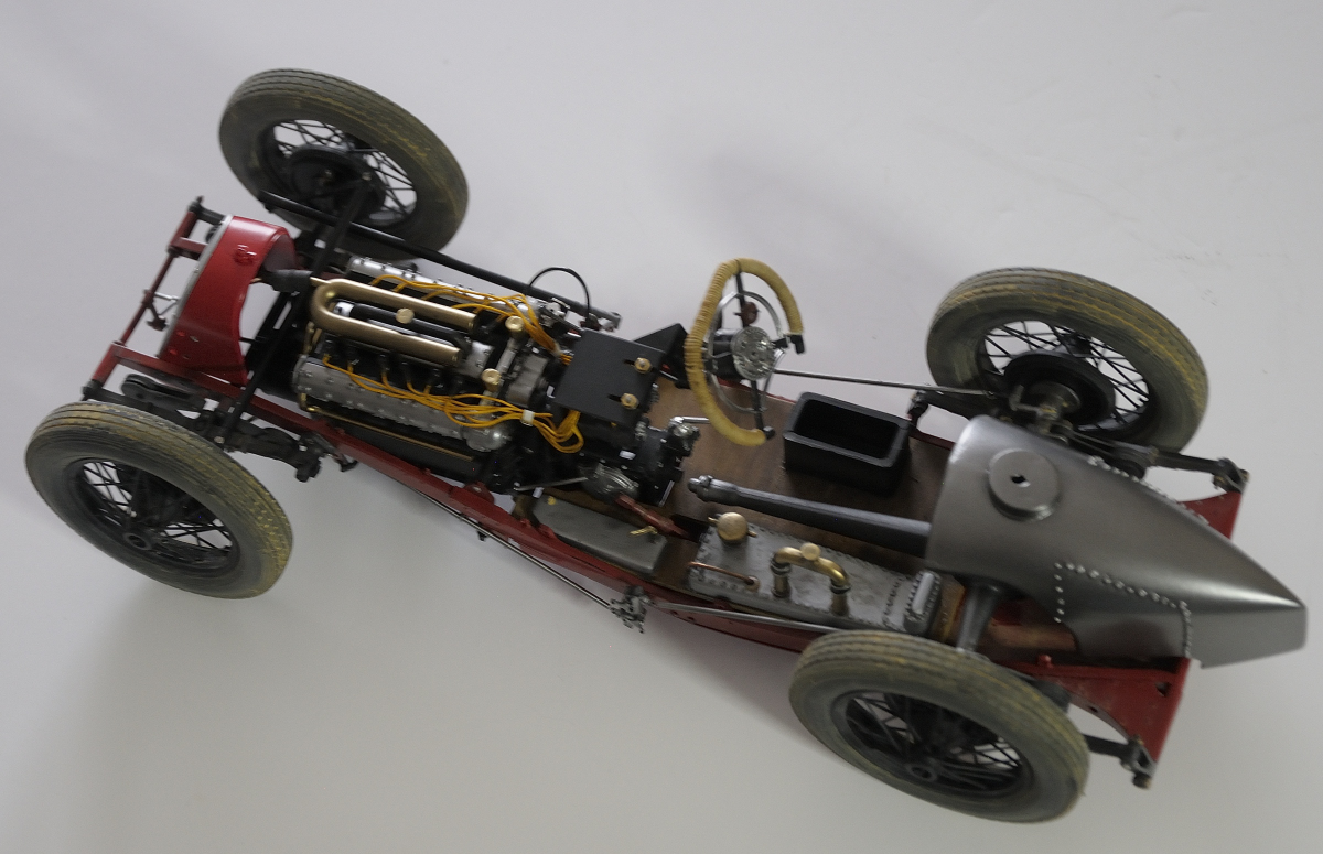

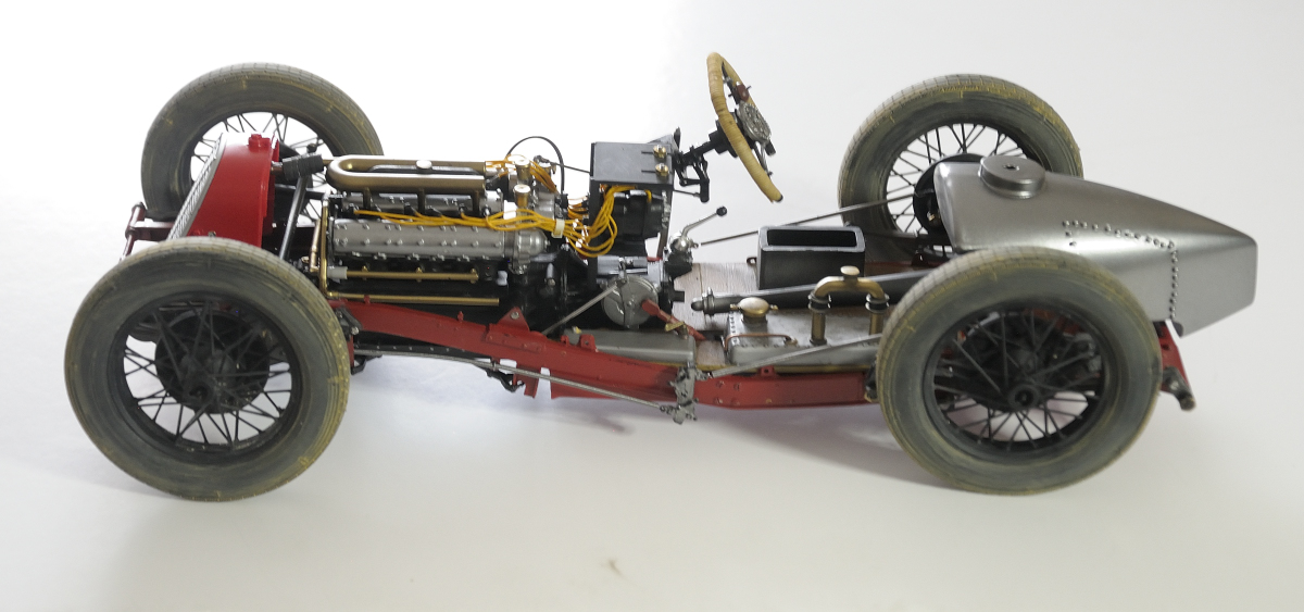

Hi Dave, thanks mate

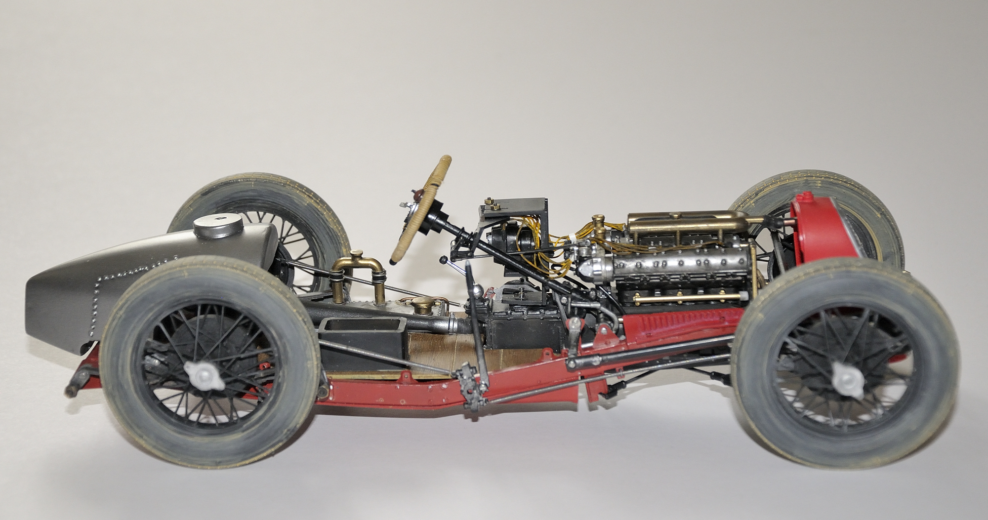

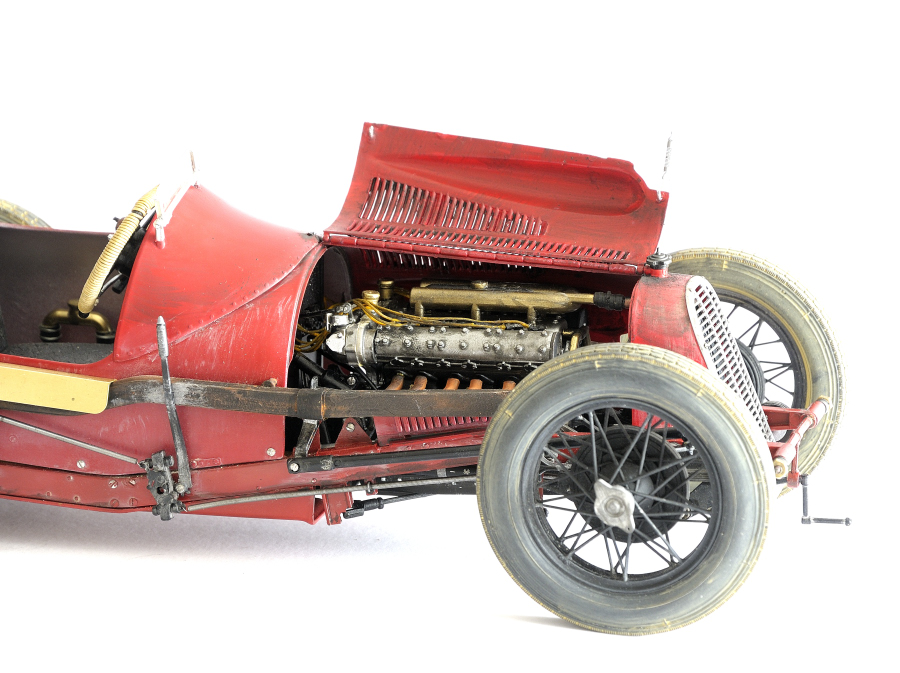

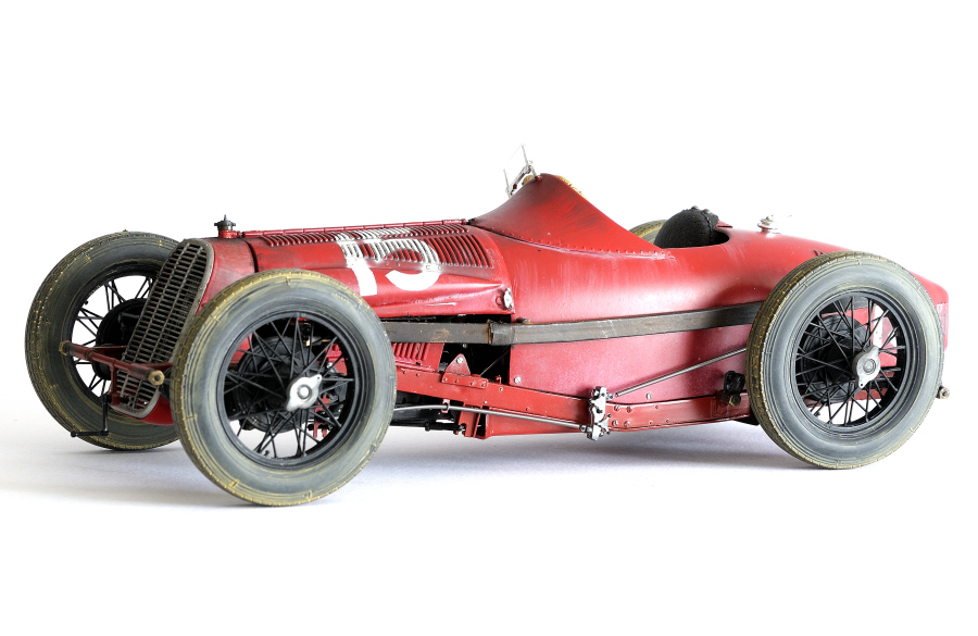

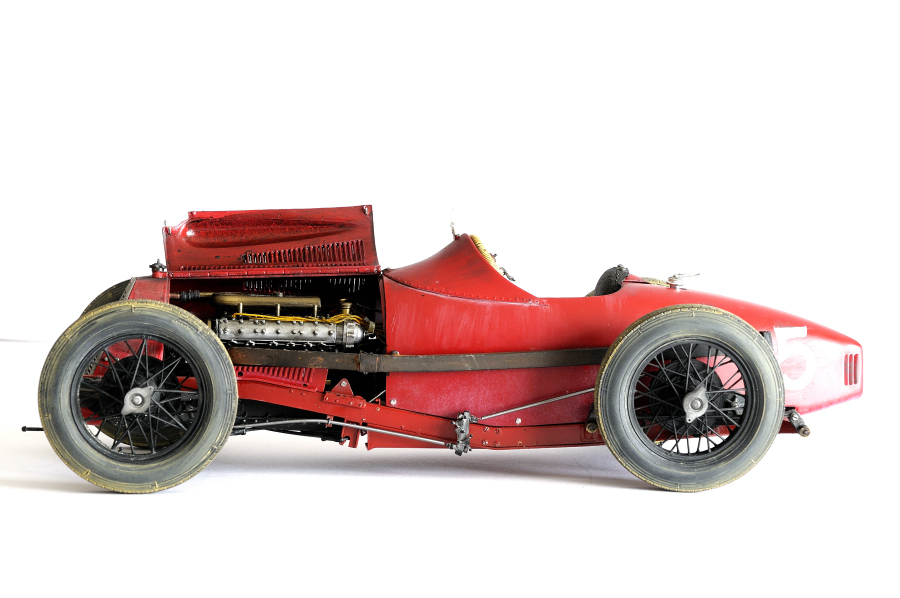

Getting there. I need to take some better lit sharp pics before i put the body on, just need to finish the plumbing first

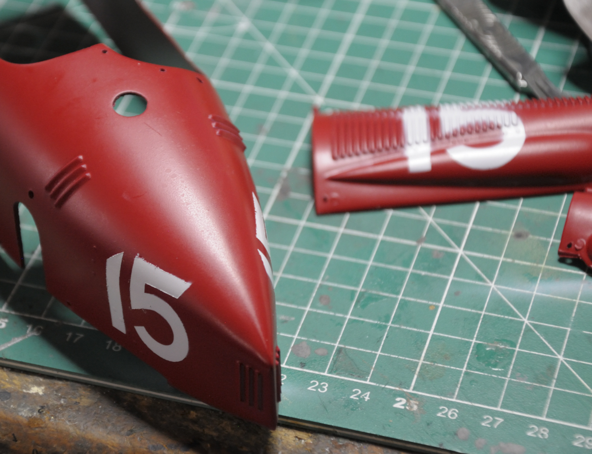

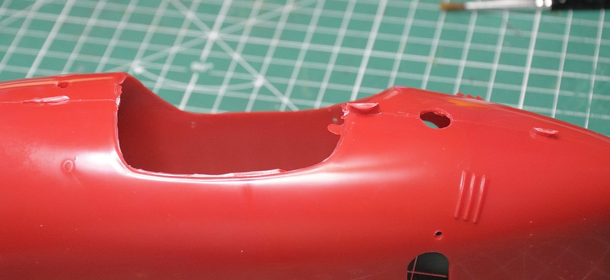

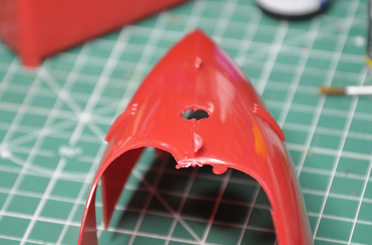

The body has some serious flash and sprue joins

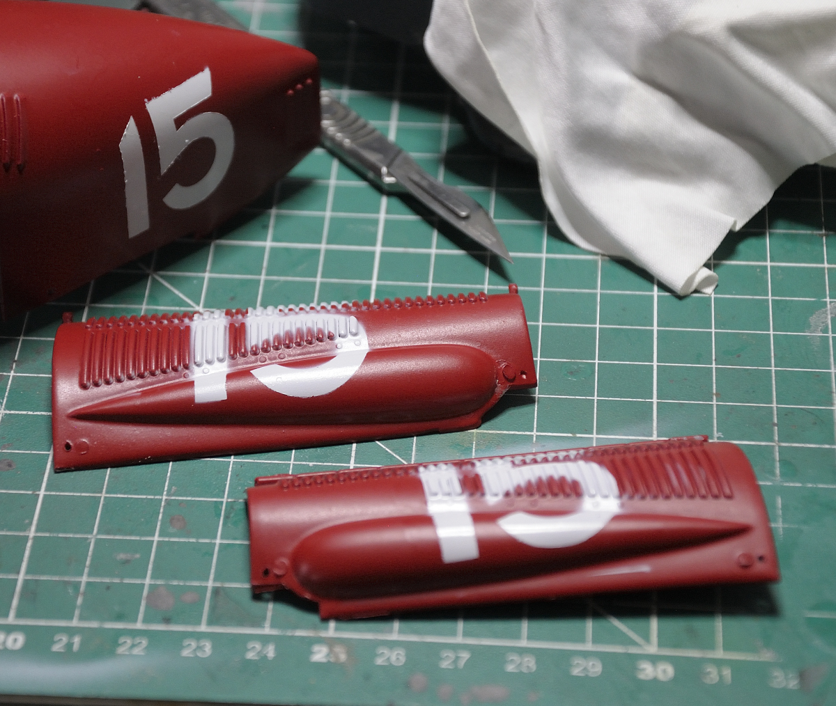

I cleaned these up and gave them a coat of Italian Red, its a bit bright but after i gave it a Matt coat it darkened it a bit

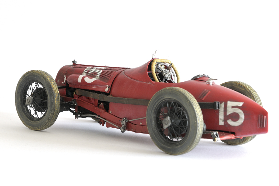

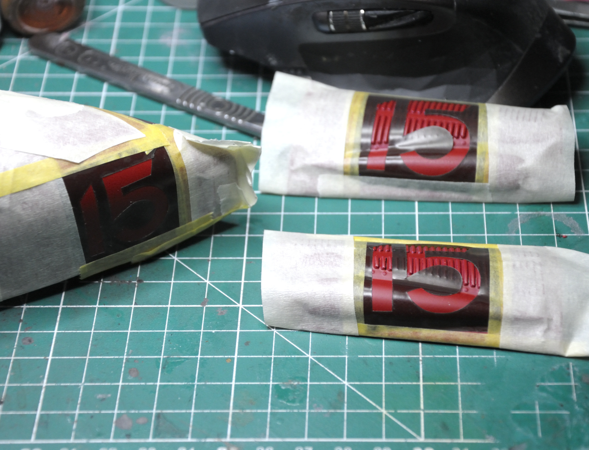

?You get a choice of masks or Decals for the numbers, i went for the masks because i didnt like the idea of getting the decals to sit on the bonnet(hood) louvers

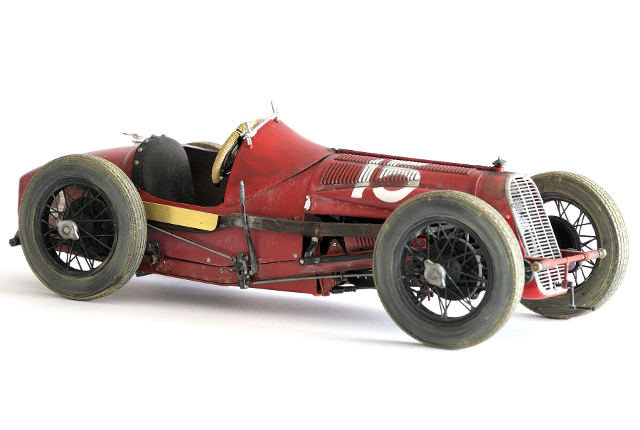

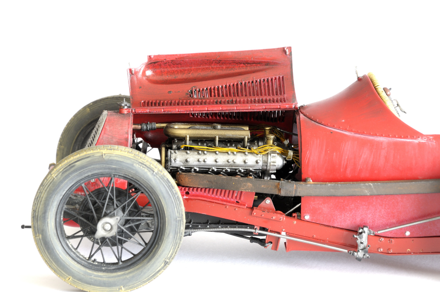

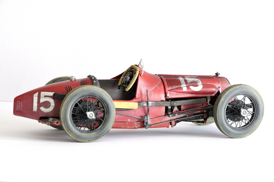

I need to now weather the finish suitably , not sure how or what direction to go but having gone with a sandy finish on the tyres i may carry that on.
Overall it looks great Paddy! I am surprised that it raced to the finish line so fast. Most of it was the chassis and engine and then wha-la, ta-da, done.
I really like the weathering you did, though something caught my attention. The running surfaces of the tires should be bare rubber. Dirt in the tread, but shouldn't be on the surface where it meets the road.
yea the difference between the stripped down model and the finished job is really only 4-6 screws TBH, i left the tyres dusty because as far as i can tell these raced on normal roads in Italy which are often dirt/dust tracks but i take your point,

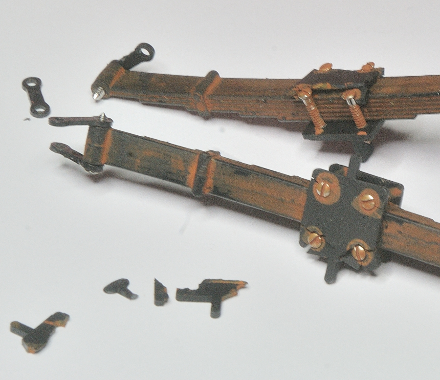

Its basically the Protar metal kit from the early 70‘s re cast in plastic. Consequently, it comes with a variety of screws and nuts for assembly but the plastic parts are not strong enough for this type of construction. The screws provided are used as self-tappers which they are not, they have to be wound in to thin/fragile inaccessible plastic which causes the plastic to expand rather than cut a thread. Just when you think you have got away with this..disaster. I found that most of the proprietary washes that are spirits based seem to harden the plastic and make it brittle. Already stressed from having screws wound in the plastic just shatters a few days later.
Note the rear hanger plate here shattered a day or two after assembly and the front plate has cracked round each screw head.
The answer is (too late for me) to replace all the 1.4mm screws with plastic dowels and then assemble as you would a normal kit.

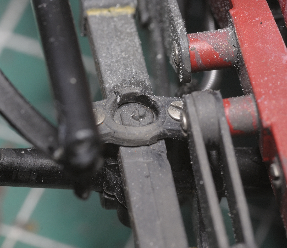

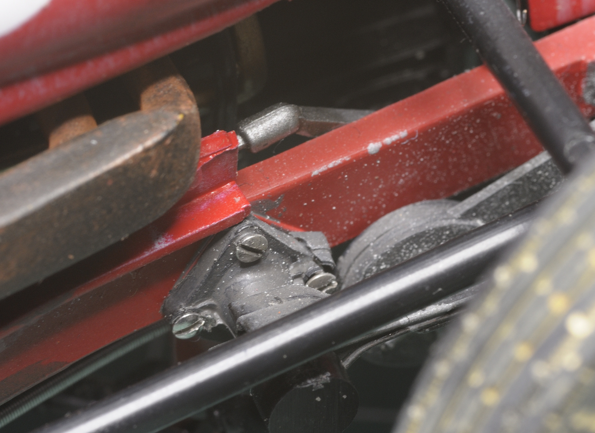

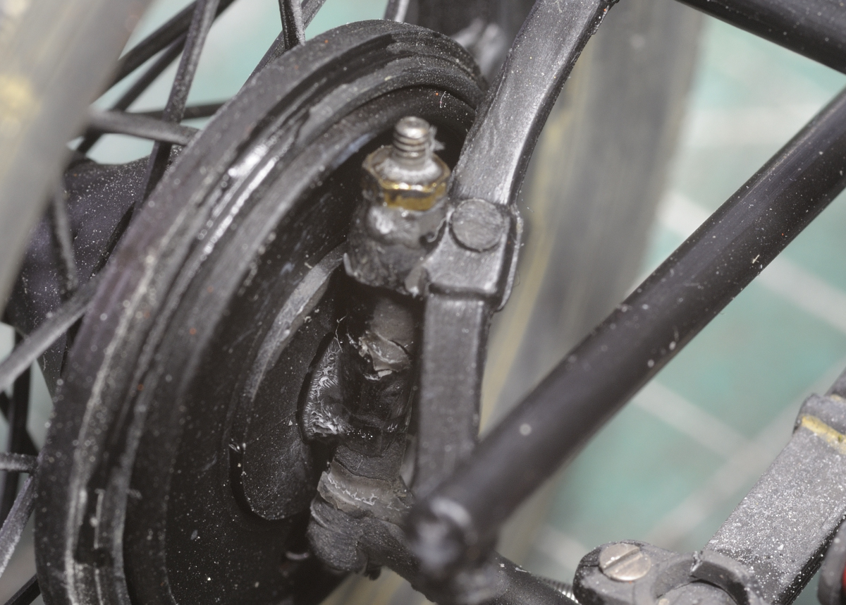

I have taken a few macro pictures of how this build is falling to bits in front of me....I could just keep quiet :) but as we say here, " i like to call a spade a spade" :)
Top shackle on the front spring starting to break up....
Front King pin, the darker bit in the middle is all thats now attached to the wheel hub as its cracked above and below.
Rear of the front spring mount starting to break up.
All this damage and a lot more occurred up to a week after assembly, I predict a short shelf life for the rest, especially it seems bits with paint of washes on. This a £150 model with probably less than £5.00 worth of moulding/plastic cost. Its not acceptable in 2023 IMHO. When you look at what people like GWH can turn out with near perfect new moulds in a high quality plastic for half the price.
Wow, and I got warped resin kit that's healing itself (more on this later) , this thing is falling apart?!
Yeah, I hear you Paddy. Thanks for the "this kit is garbage" photos. This is the kind of stuff that needs to be posted about kits. It is pretty obvious that it isn't builder error. Also it might be the formulation on the plastic.

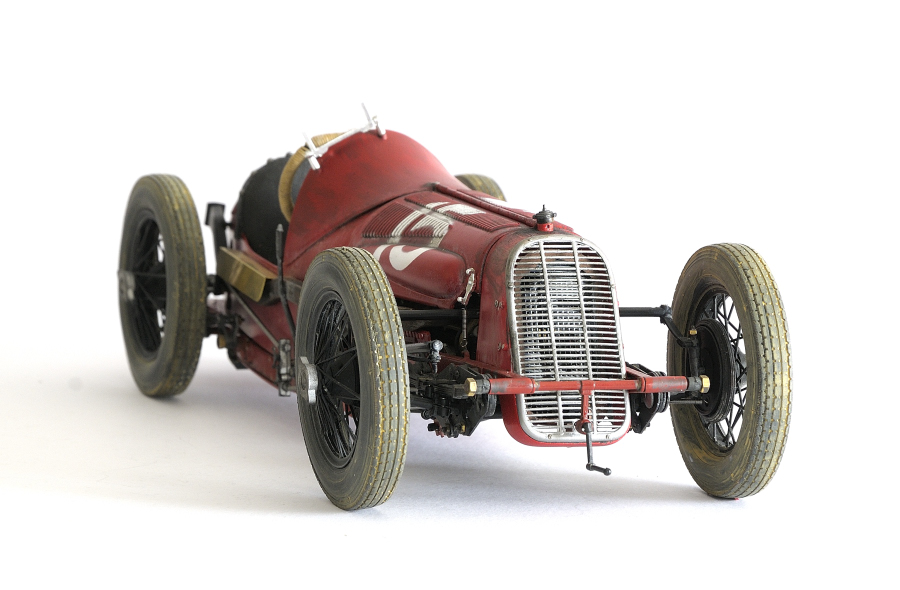

First: I love that thing, it really looks great!
But it is a shame that it does fall apart - shame on you Italeri
Stunning finish. Shame on the quality (re-engineering, or rather lack thereof) of the kit. :bash:
