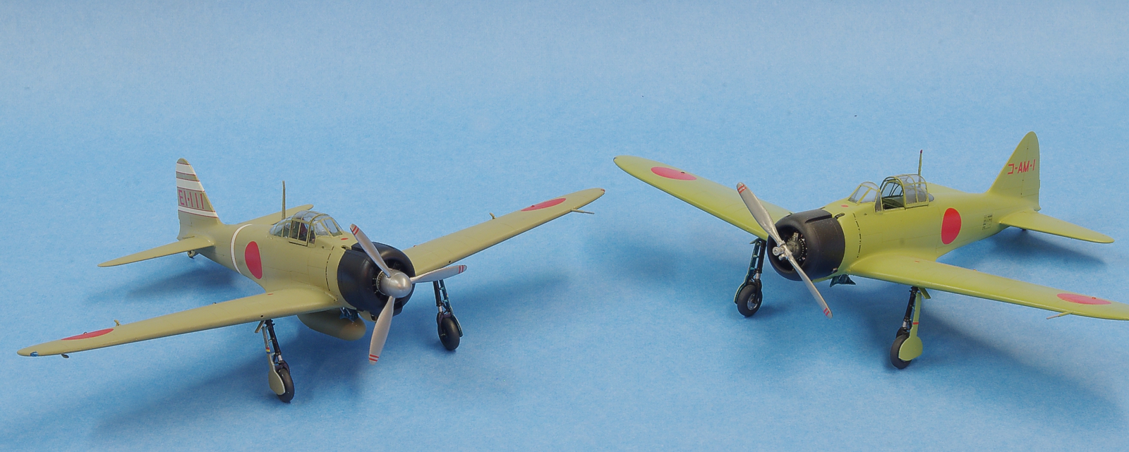

Here is a Hasegawa A6M2 and an A6M1, both Hasegawa 1/48. In Jiro Horikoshi's book, he called the prototype's color "a dimly-shining ash green".
That's great John and confirms some of what i have read, Your overall colour on your very nice builds looks pretty close to the Tamiya colour i have as well.

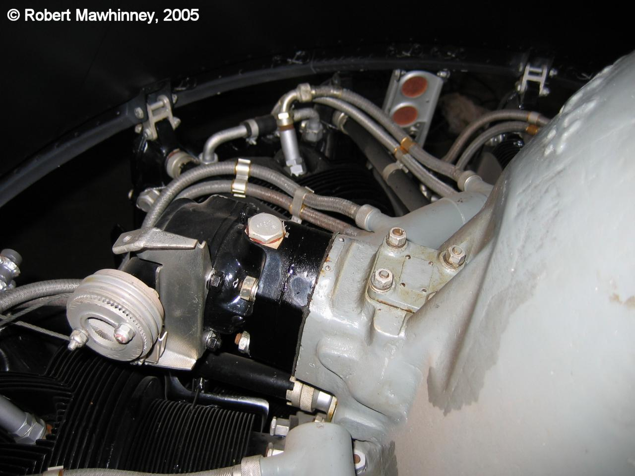

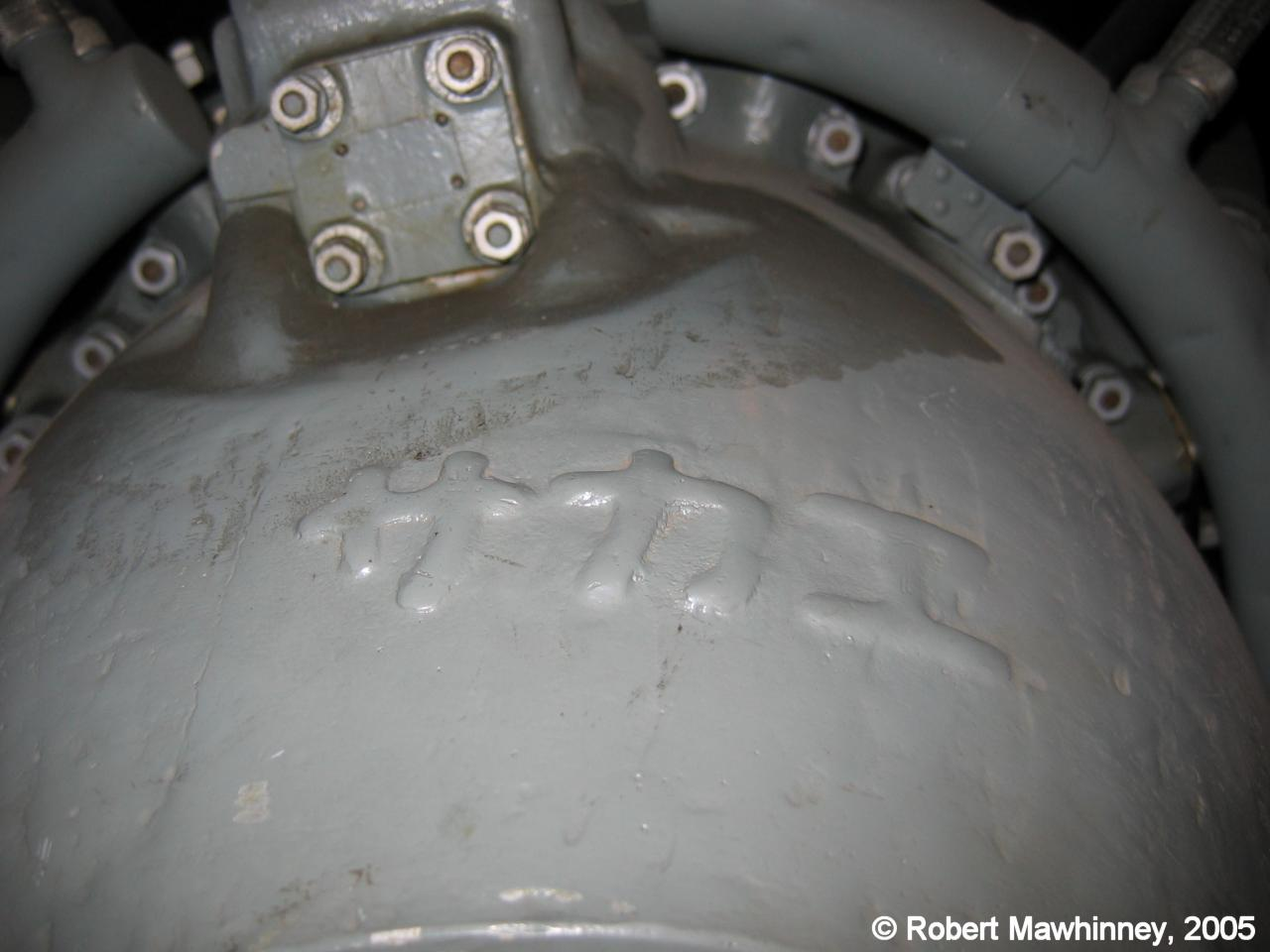

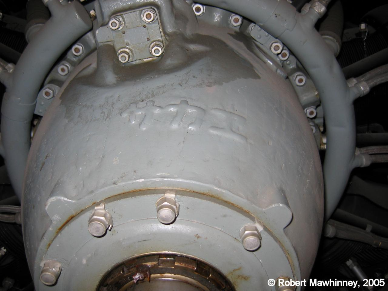

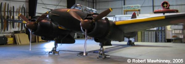

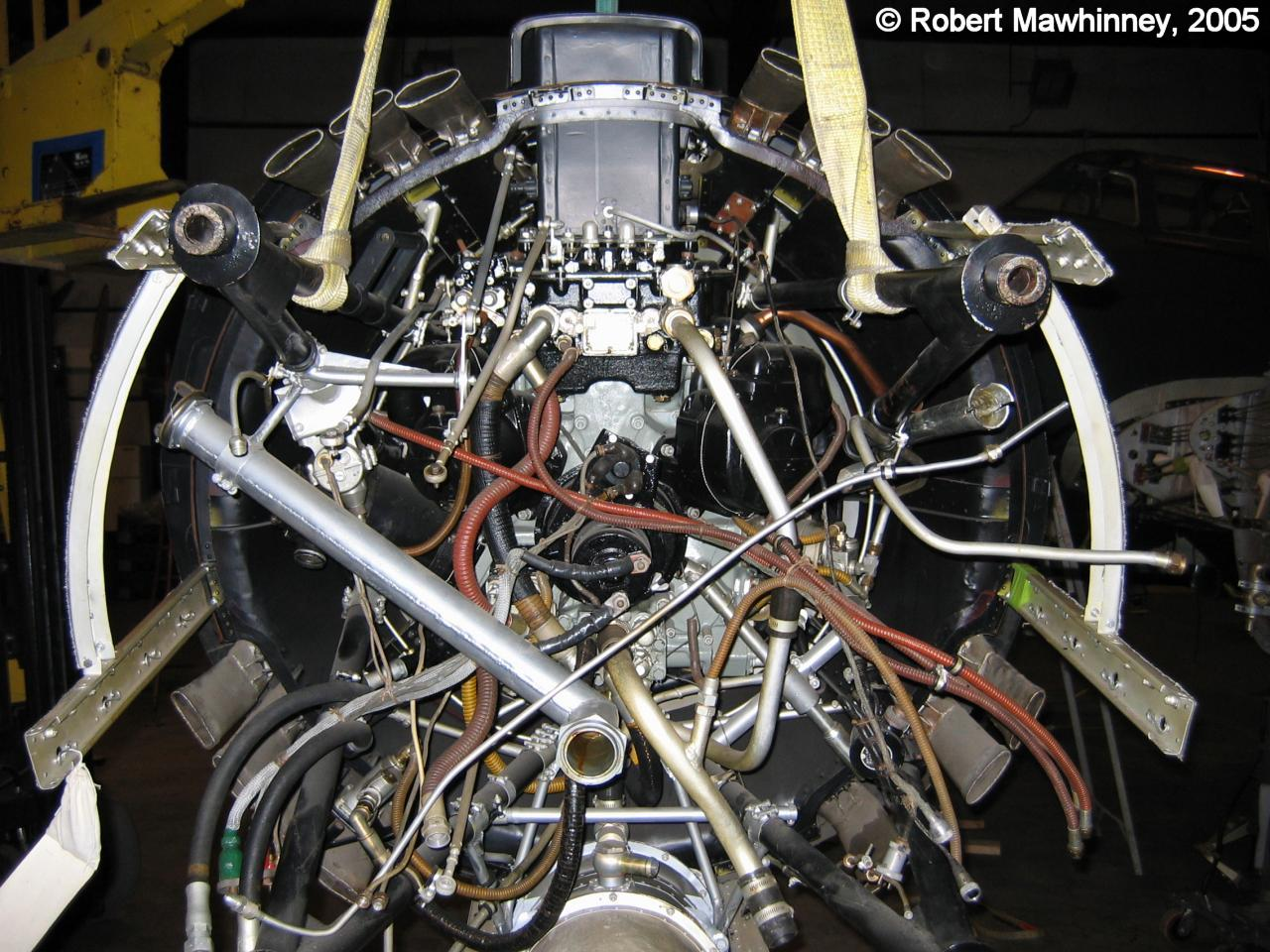

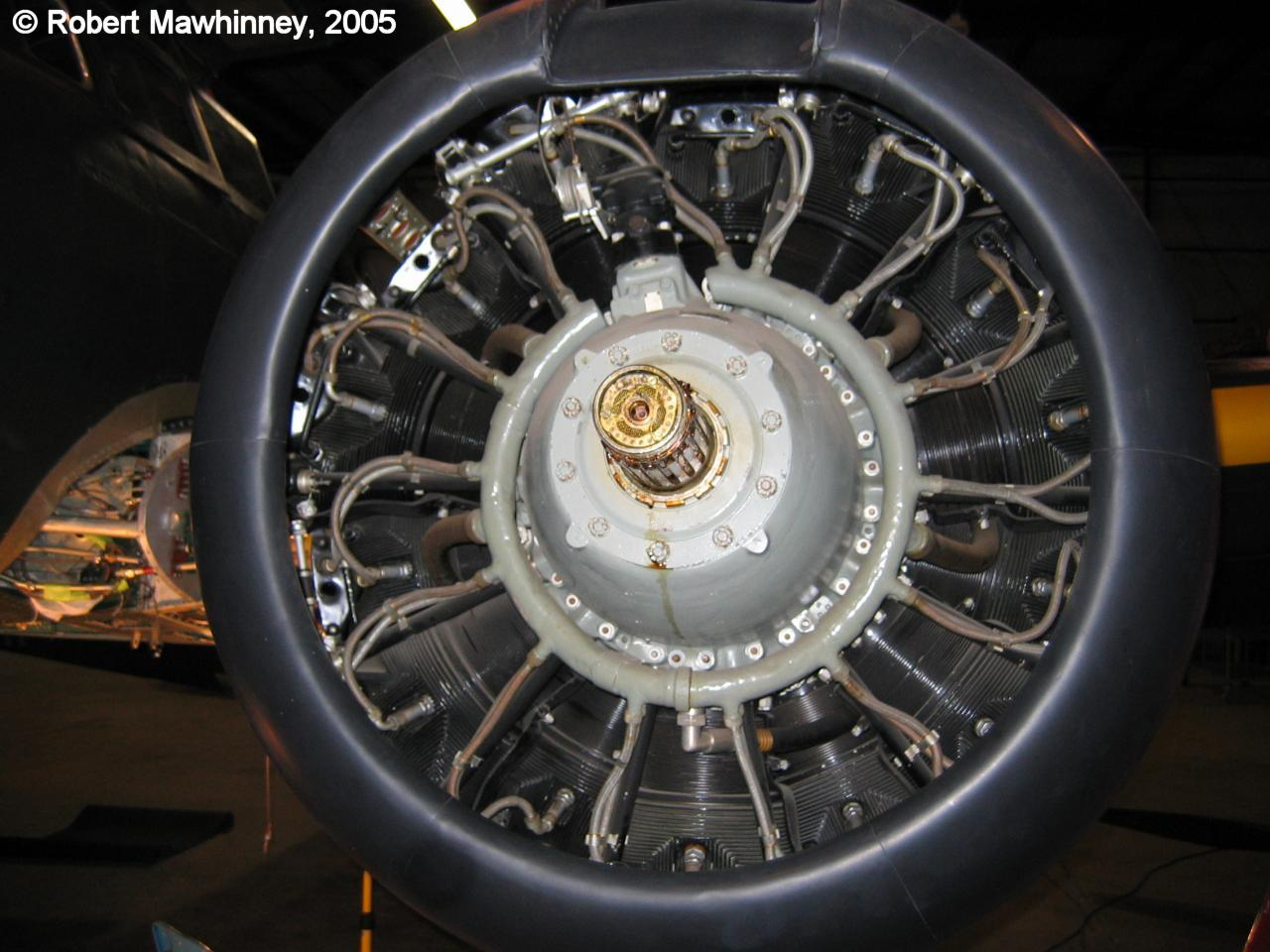

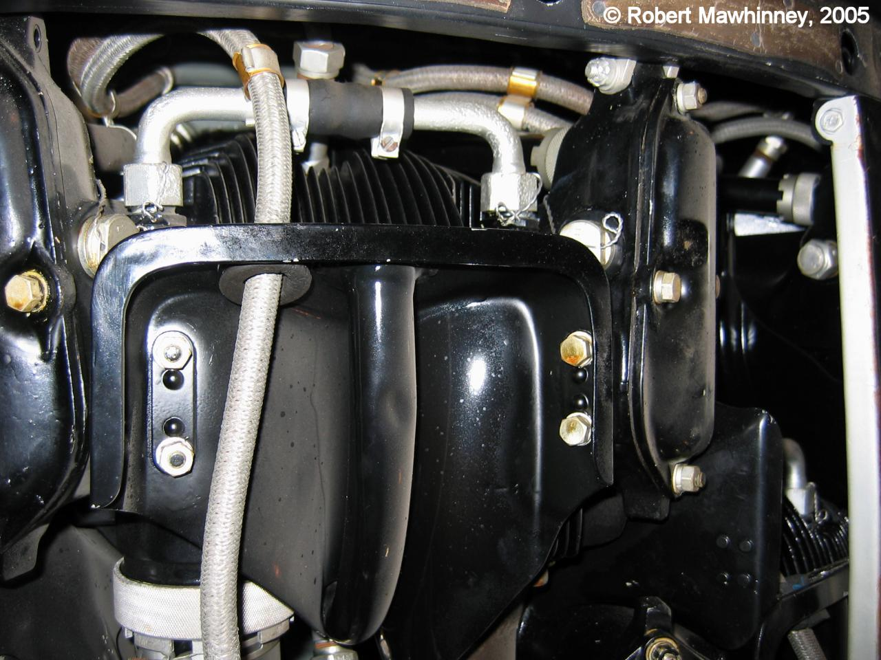

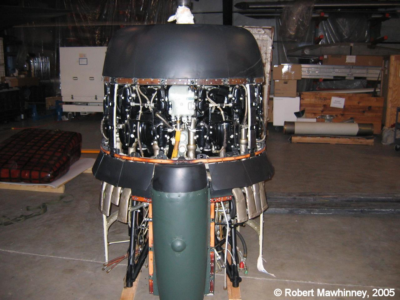

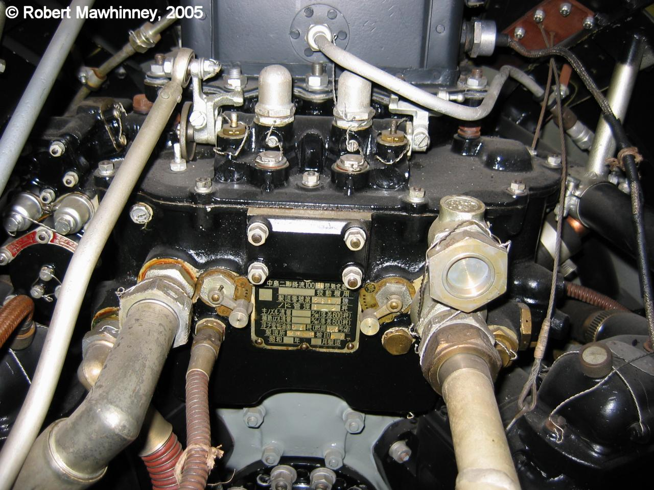

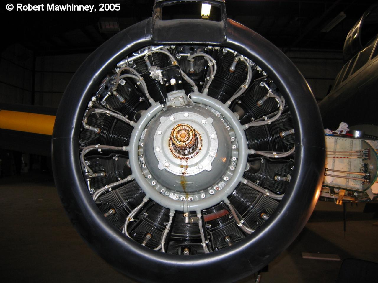

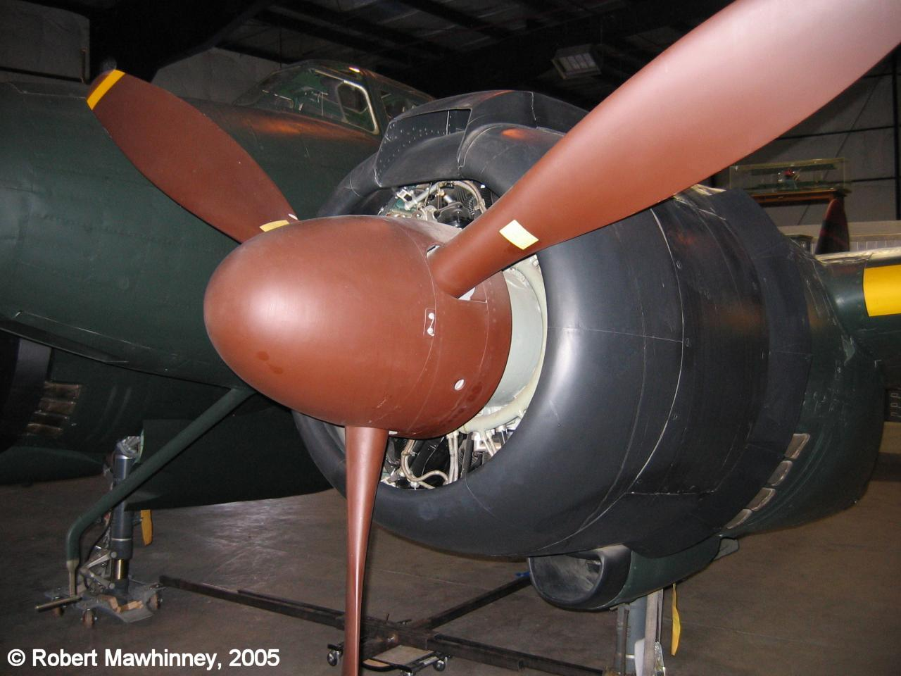

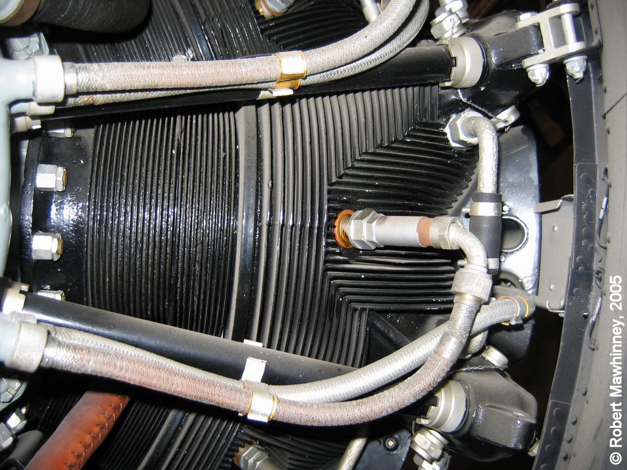

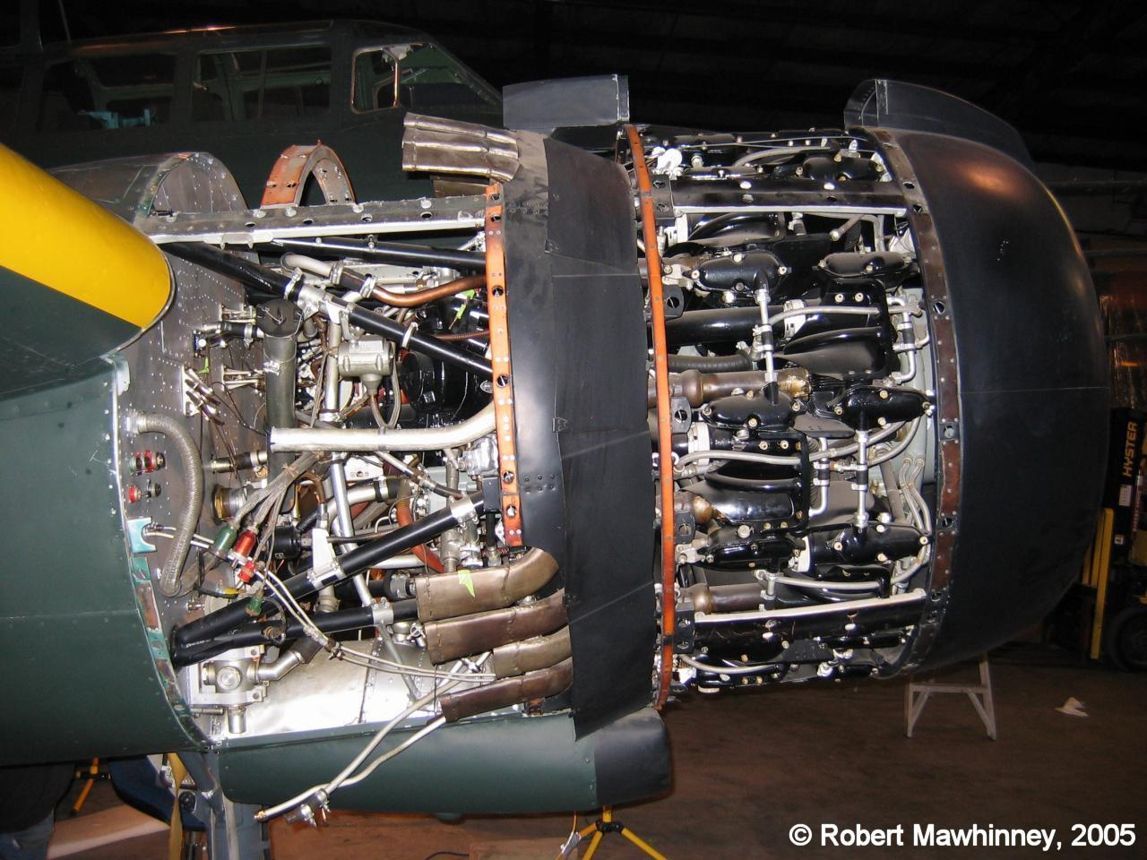

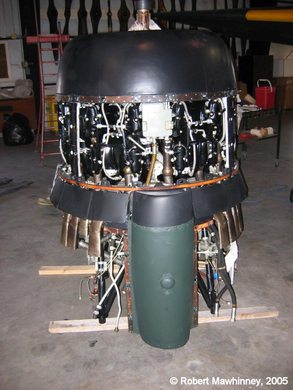

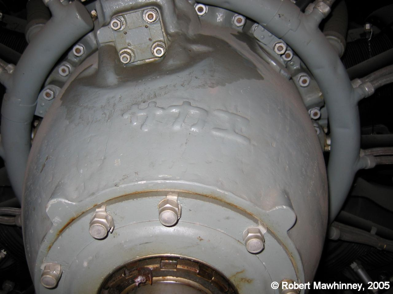

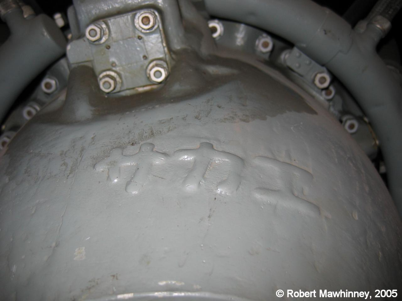

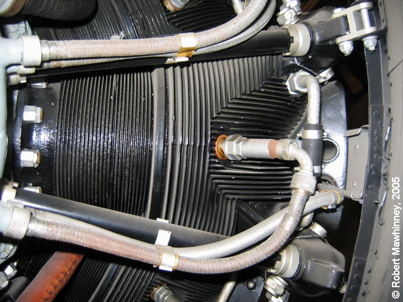

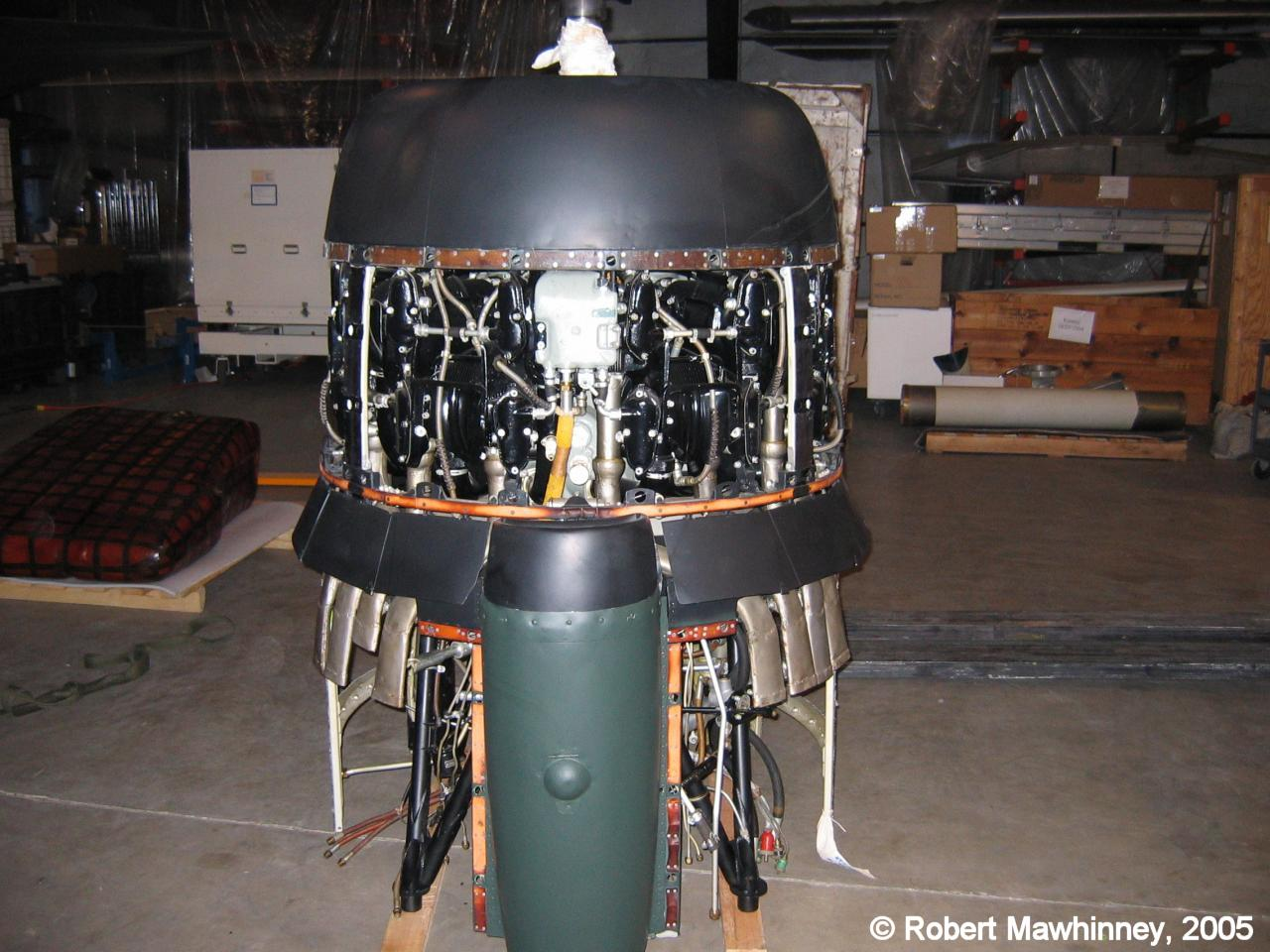

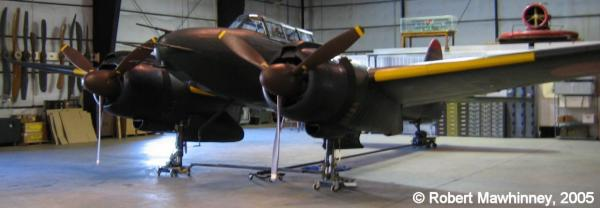

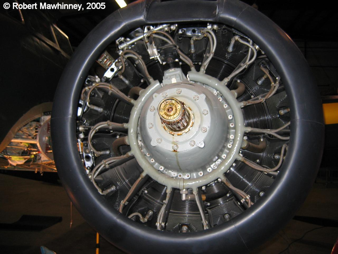

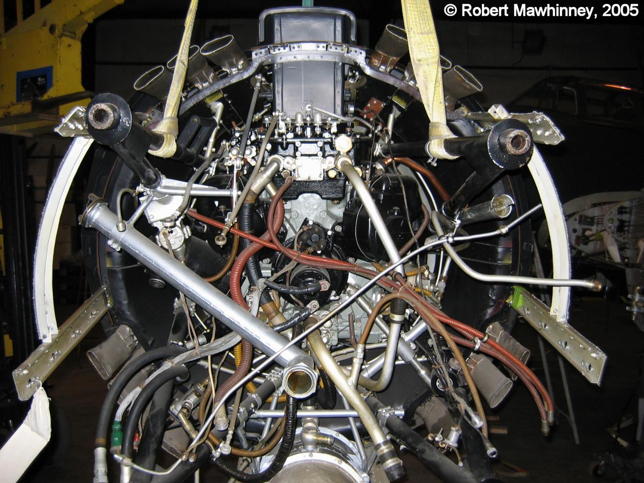

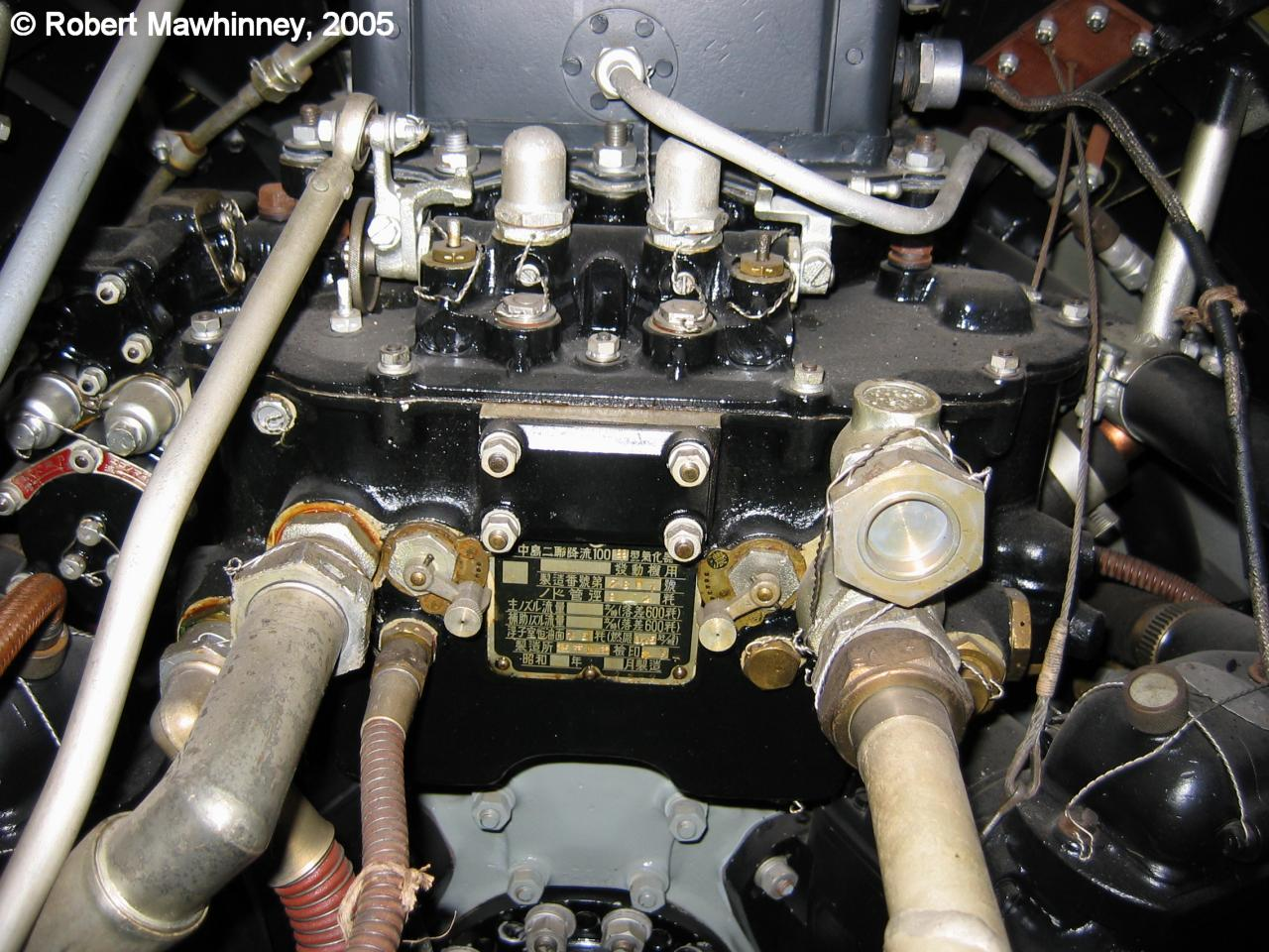

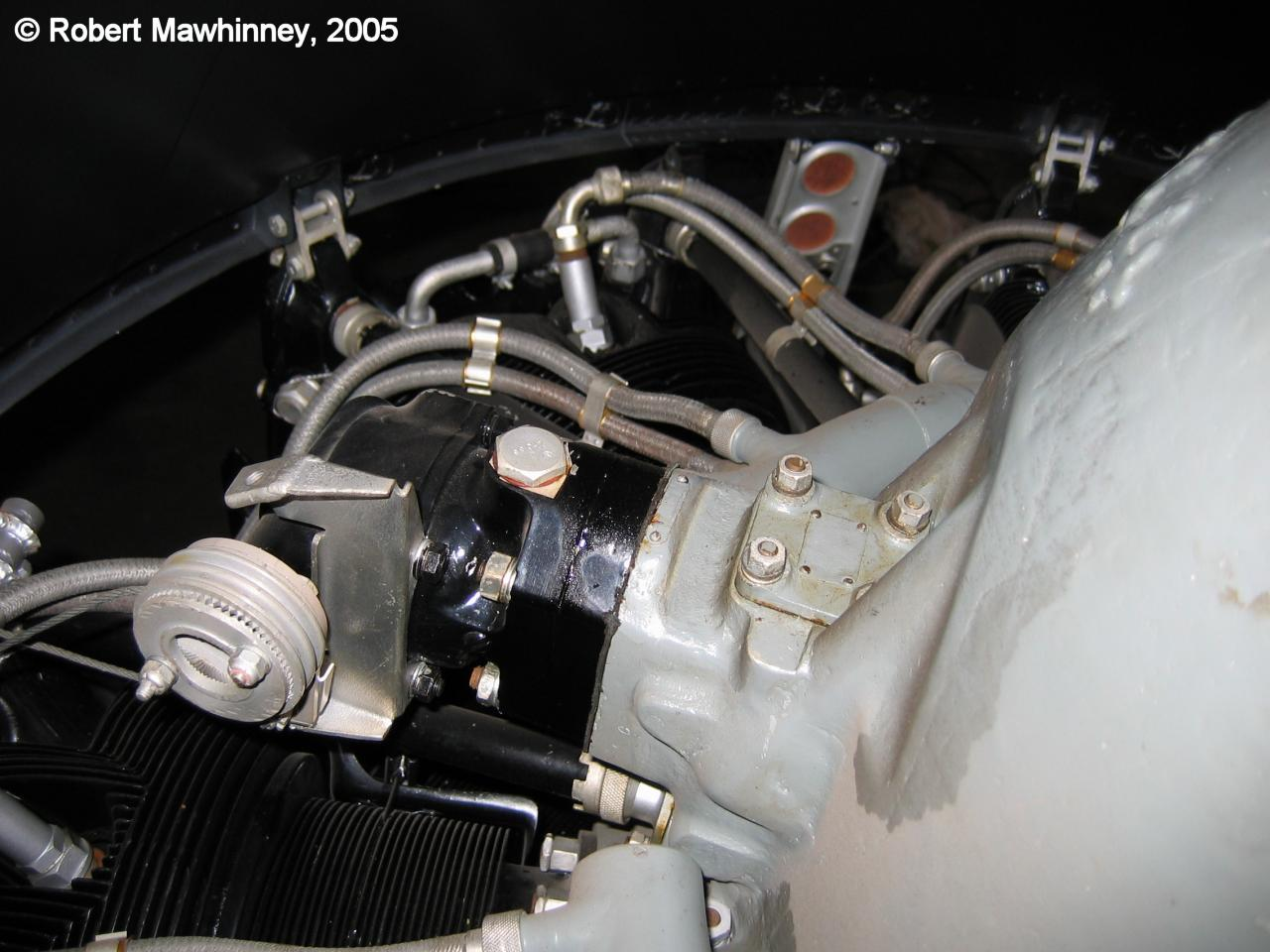

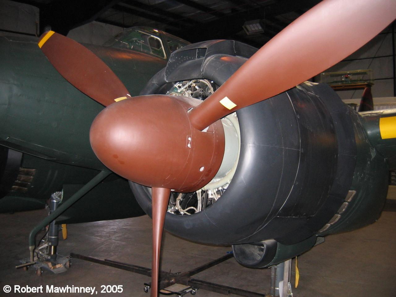

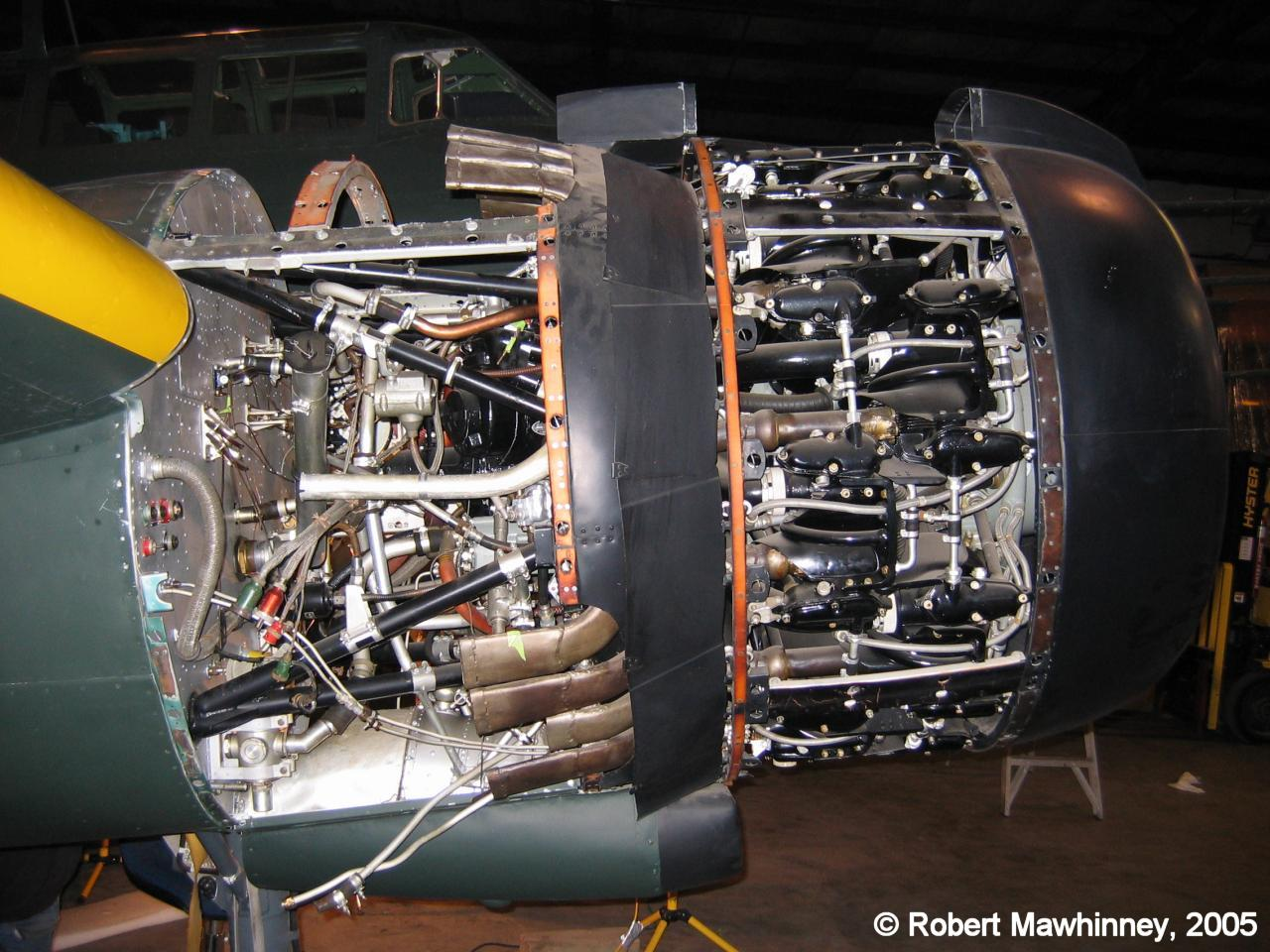

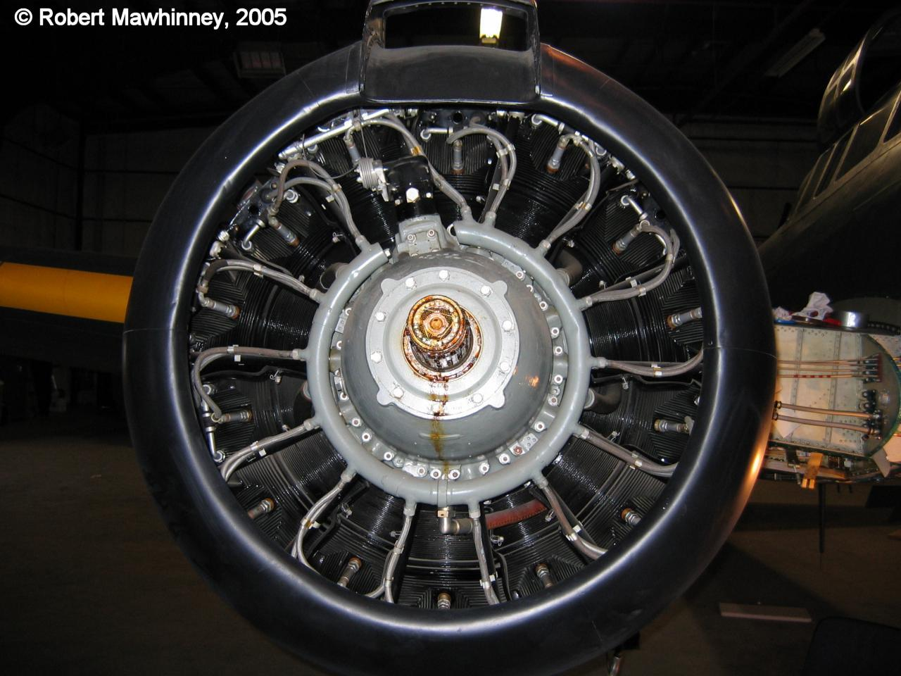

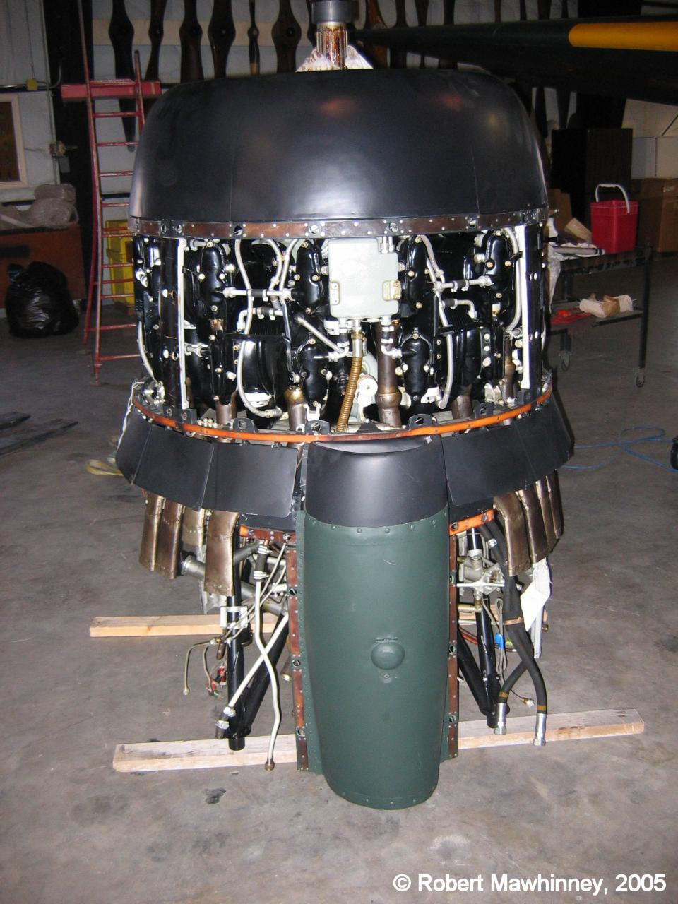

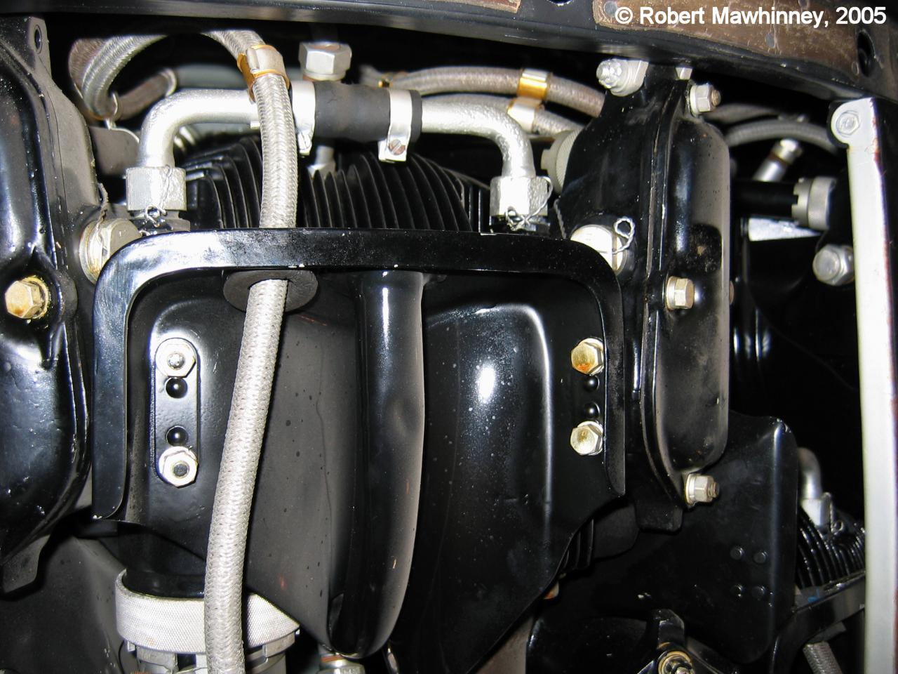

The Smithsonian is well known to preserve then recreate colors during restoration. Here are the Sakae 21 engines from their Nakajima J1N1-S Gekko:
Starboard engine:
Port engine:
Yeah, I know... TMI
