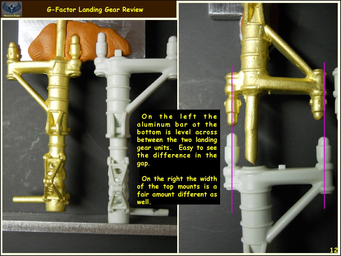

As @jknaus offered, I would recommend G-Factor anytime as they are brass and usually much better than the kit parts. I wrote usually even though I never had an issue because someone here (was it you @Heavens Eagle?) had a bad experience with them.

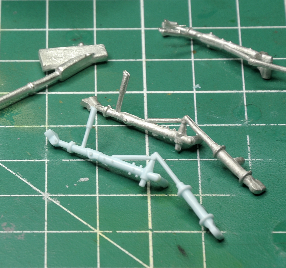

Bit of a conundrum here

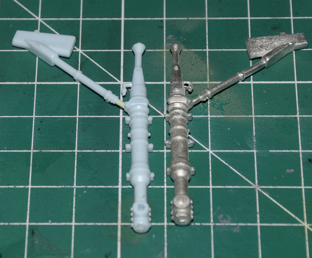

I was told i would probably need to buy metal undercarrage legs as the model is quite heavy. Well you know my thoughts on after market :)
The metal legs are a bit shorter but my worry is they are not just soft...you can bend them into any shape you want.
The plastic parts cant really be twisted and there is a good degree of spring in them so the straighten if bent.
I dont know ? Detail is better in plastic. My feeling is to build in plastic and have the metal legs as back up should i have problems with the plastic.
It would be interesting to know where the weakness is as i could possibly reinforce that area with a metal insert I would guess the weakest point is the wheel axel and i can remake that quite easily in brass which would be 10x stronger.

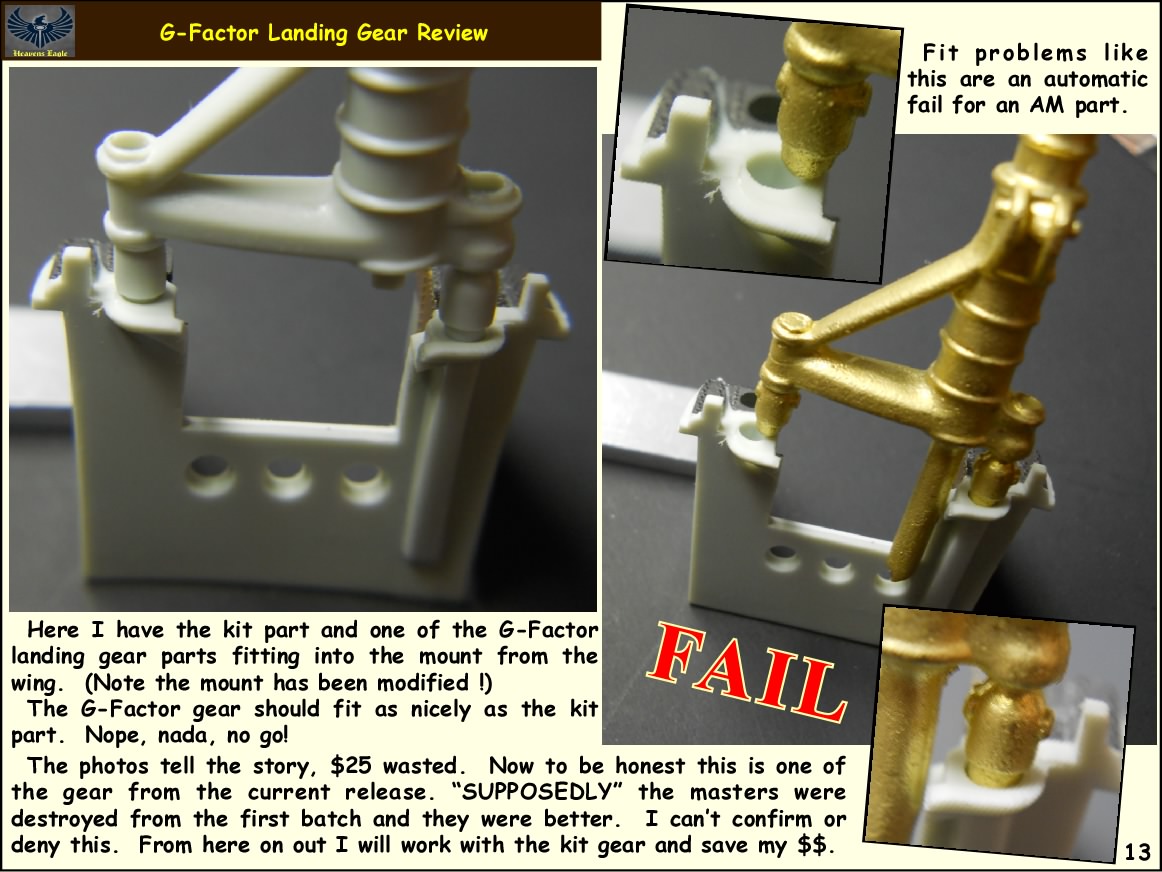

My first build for MA was the 1/32 scale Ju-88A1 kit from Revell. I went whole hog with aftermarket and anything I could get. Turned into a lot of worthless aftermarket. One of the worst was the brass landing gear from G-Factor. All they did was use the plastic gear from the kit, make a mold and then do lost wax castings. Problem with that is that the brass shrinks, A LOT! The G-Factor gear were crap! I ended up beefing up the plastic with some brass tubing and heavy wire and I would suspect they are probably better than the AM crap. At this point the only aftermarket landing gear I will buy are the bronze gear from Eduard. Most of the white metal gear are actually soft and will bend easily.
Here is the comparison of the Ju-88 landing gear from my build.
To fix the somewhat weak mounting points I did this.
I did a lot of other detailing on the landing gear and it made a huge difference. This is another build that ended up going to back burner, but not because it was a bad kit. The kit was fairly decent, I just got bored and it needs to see the light of day again and get to the finish line.

Paul, you are 100% correct the Hurricane undercarriage legs i have are small across some dimensions which is classic shrinkage in the casting.

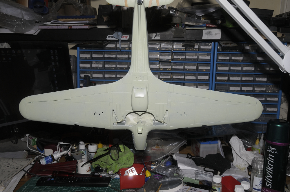

I gave this a coat of MRP light alloy, then a coat of hairspray them MRP Sky.
I had read on line that this works but you only have about 3 hours before the last coat of paint get too hard to then chip with water.
I did a test on an old Harrier wing and found after 4 days the paint chipped exactly the same as it did after 4 hours.
On reflection i would have substituted MRP light alloy for a grey but maybe once i apply a mat coat after decals the alloy will be grey anyway
The top surface might be more of a challenge because usually i would spray the whole thing one of the two camo colours then mask off the camo pattern and apply the second colour however this means some of the model has two coats of paint and some one so it might effect the way it chips.

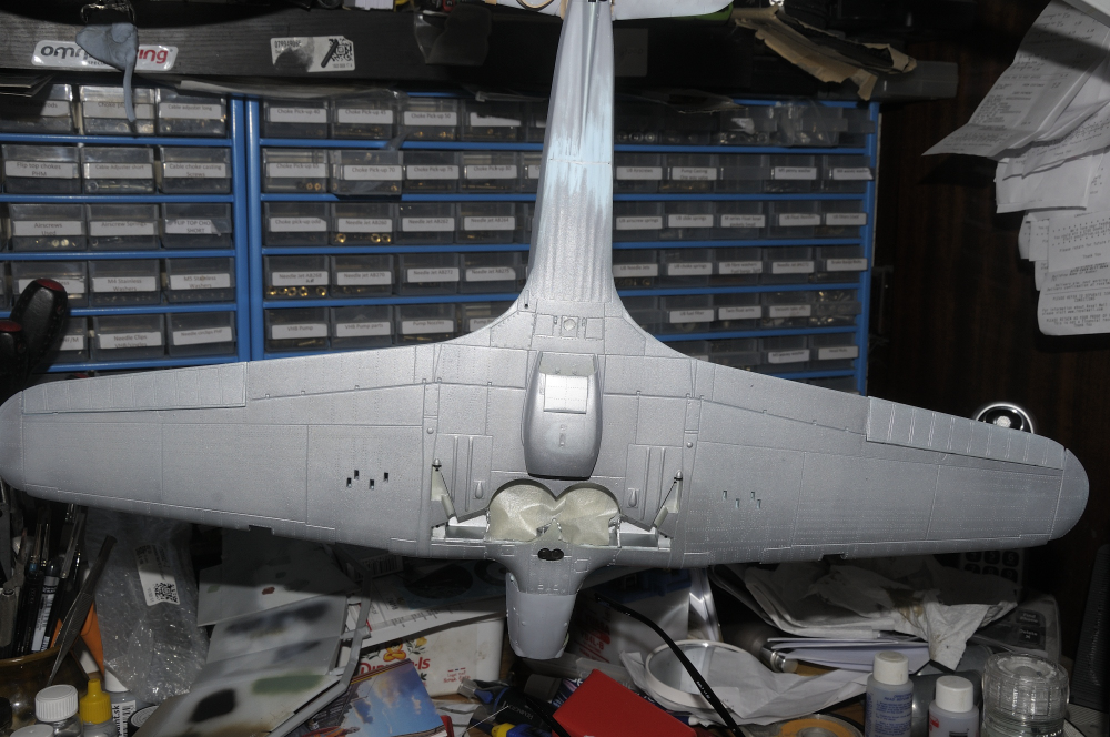

Glad to get the base coats on as its not my favourite part of these large builds. I have done some test peices as i was a little worried about the colours but they come good with a proper flat coat
Time to own up...i gave this a silver undercoat, put it to one side for a couple of days then added the top coats and completely forgot the hair spray :)

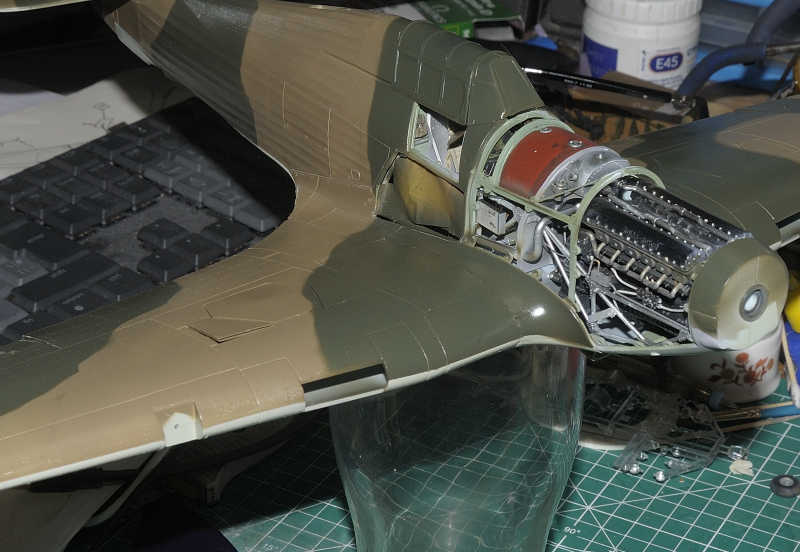

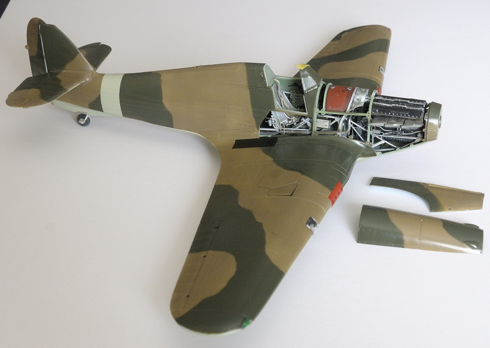

I read at the start thast the engine is too tall to get the covers on but i have found its actually the coolant tanks cap thats the culprit
That said its not a lot and as i want the othe other side open so dont want to remove the cap

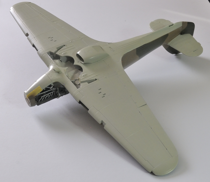

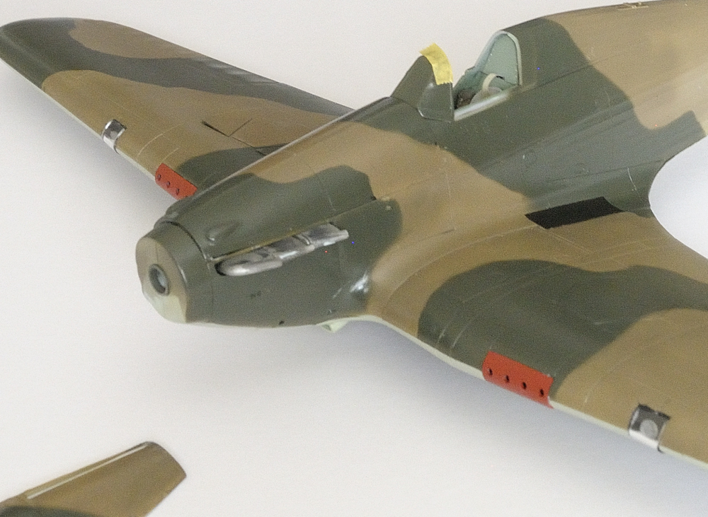

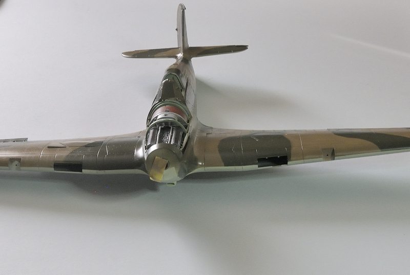

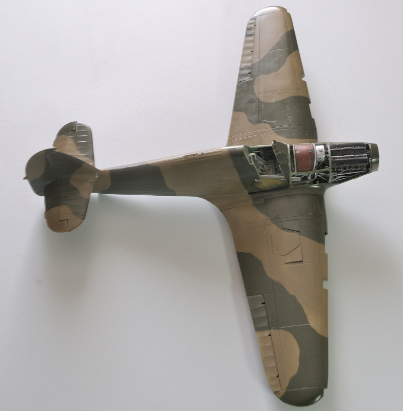

Lots of hours spent with little obvious progress but things are moving along well with minor detail /guns/lights/tail band etc
