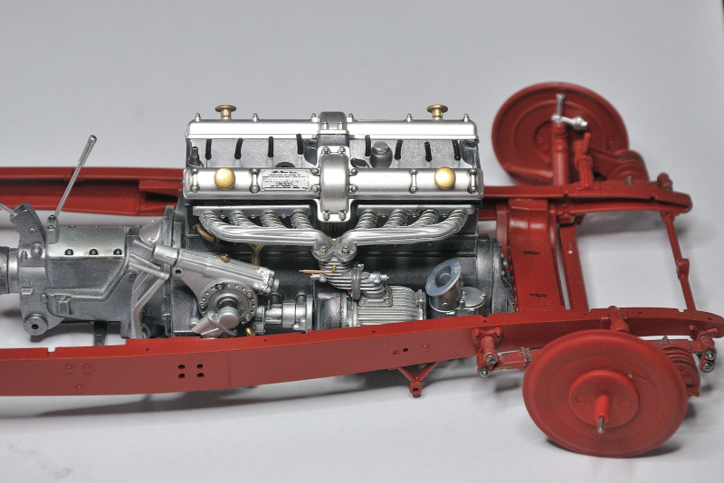

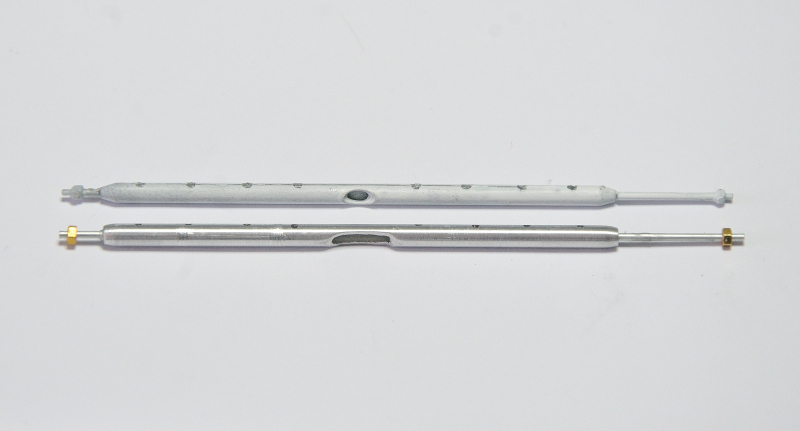

The reason ( i think) that Italeri didnt use the top tube for the plug wires is the shaft on the end is 1mm dia and it hardly supports its own weight let alone having 8 plug wires going in and 8 out. TBH i suspect the wires would be a hell of a lot stronger than the end shafts and would just bend these shafts under their own springyness ( is that a word ) :)
This might be an answer made from aluminium tube
The inlet is larger because realistically i need to get 8 wires in there but its food for thought.
I cant really progress this idea without the bulkhead and radiator fitted as that supports this top tube

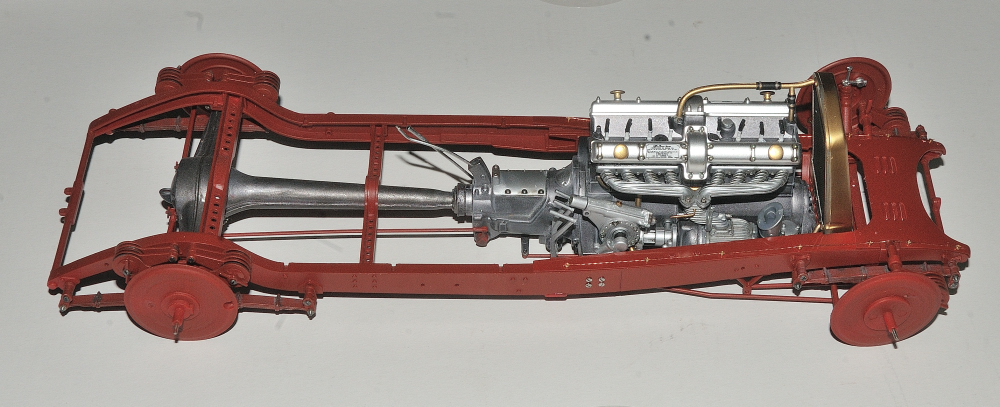

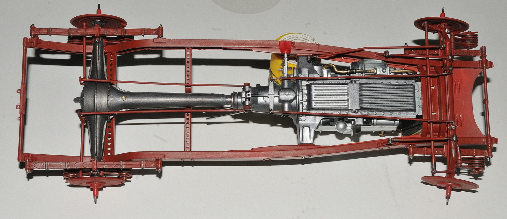

The engine in this kit is very nice, fit of parts is good as is detail. this is basically out of box accept a few added nuts etc.

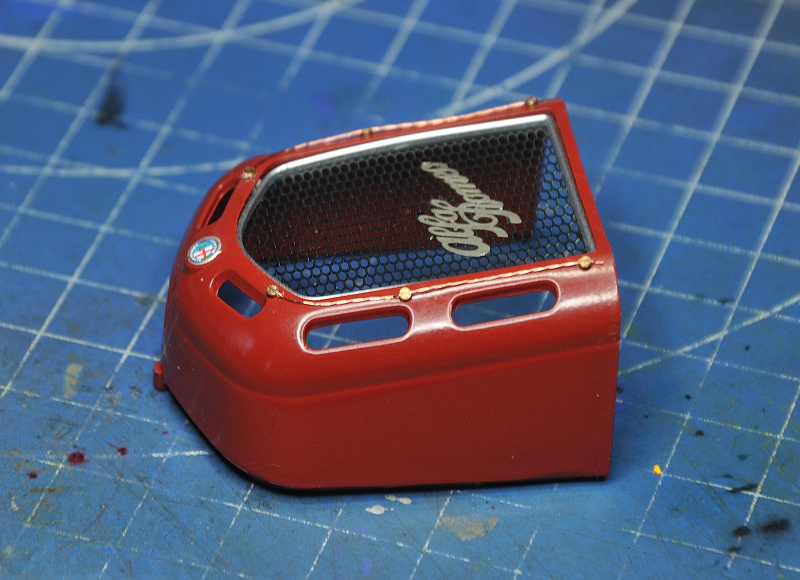

One thing i have struggled with is the air intake. at the moment i have left it off as I'm not sure how to make a mesh dome without buying some form tools. The kit gives you a PE frame and some nylon mesh but i cant make anything of it TBH.
the engine will be held in with 4 screws in the 4 holes in the chassis above, the screws supplied are slotted and obviously would not have been in real life. They use the same method to fix the body to the chassis which again will need sorting. Maybe some brass hex heads if i can find a really small tap or use dummy heads and glue the engine to the chassis.

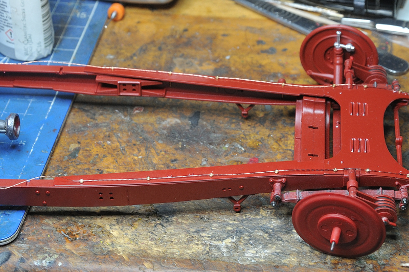

I have agonised a bit over the lock wired fixings. I will have to accept a compromise.
Initially i used a ingle strand of wire. but it wasnt quite right. the wire dia was 6 thousands of an inch but when i twisted two strands it was too thick to fit in the slot of the screws.
I bought some 1 thou wire but it snapped when i tried to twist it
The picture above is 2 lengths of 3 thou wire twisted and this fits in the screw slot so i will go with this.
Its not technically correct but without the critical view of the macro lens above, to the naked eye it looks good. to get this correct it would have required ( in this scale) 12 thou square bolt heads with a 4 thou hole through the middle, maybe possible with a HD. 3d printer but a step too far for me :)

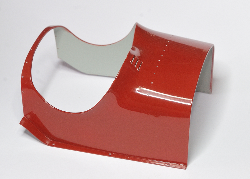

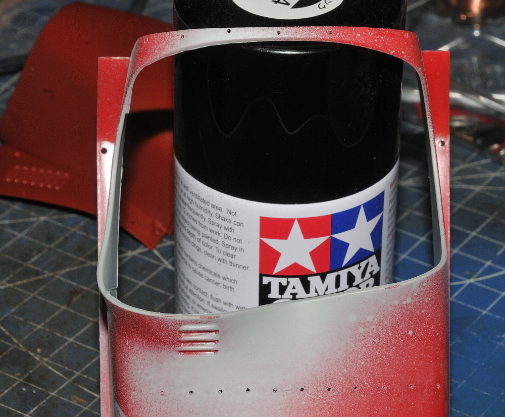

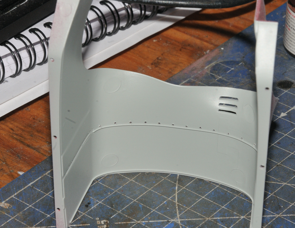

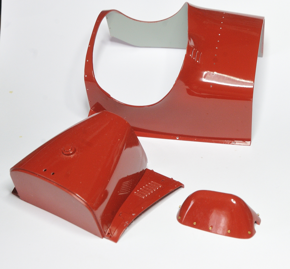

I drilled the holes in the body for the rivets and screws then found that they come through exactly where the dash sits :) Probably not a surprise as thats what they are for however it means i will either have to flush rivet or move the dash a mm.
Body work is coming along
