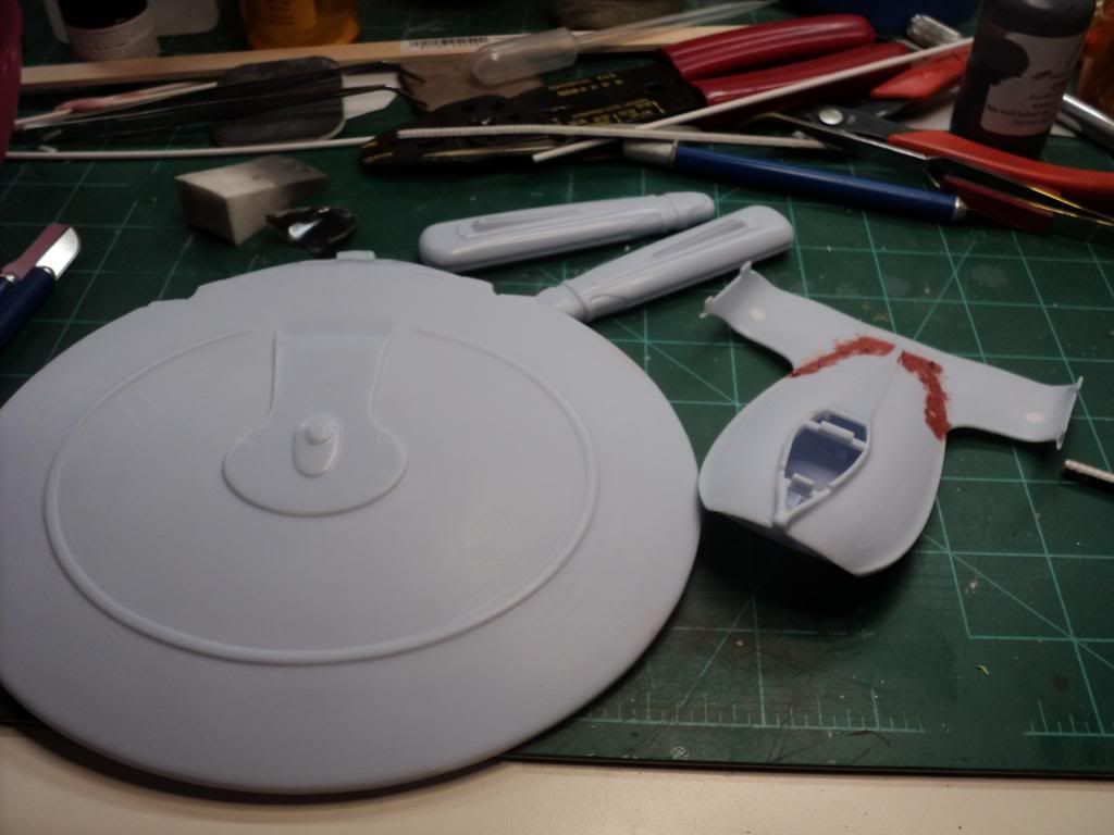

Had this one for the Sci-fi campaign, but b/c it's such a bear of a kit, I never got far.
This is all the farther I made initially
I've done a bit of sanding & cleaning and filling in some seams, but it looks pretty much teh same as above. I'll get some updated shots this weekend.

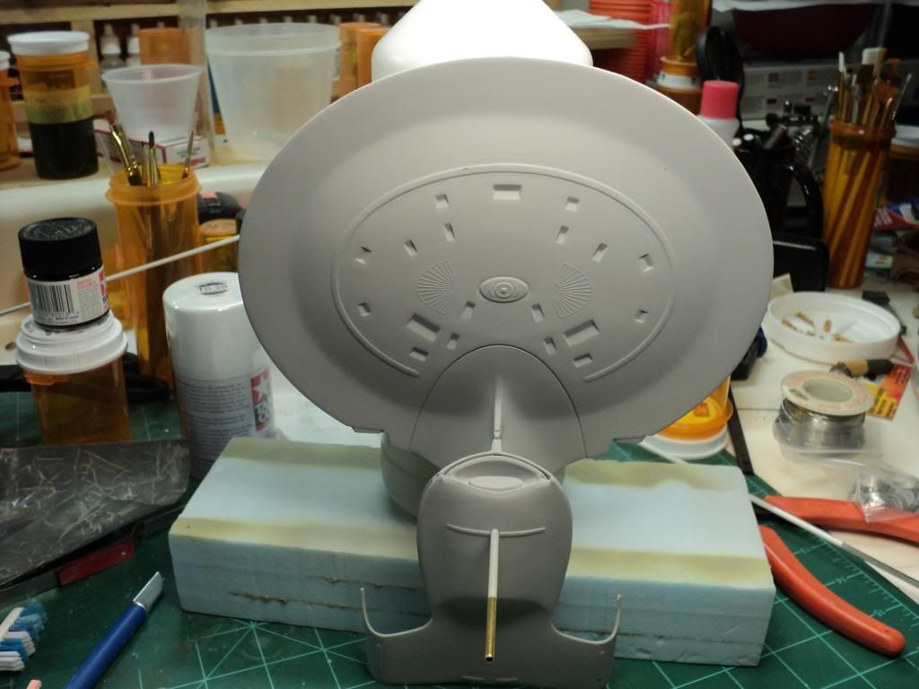

Managed to take a couple updated shots, and had a couple pic's I'd forgotten about.
Here's the updated shot of where it sits now. You can see the putty I've put down on the secondary hull to fill the massive gap there.

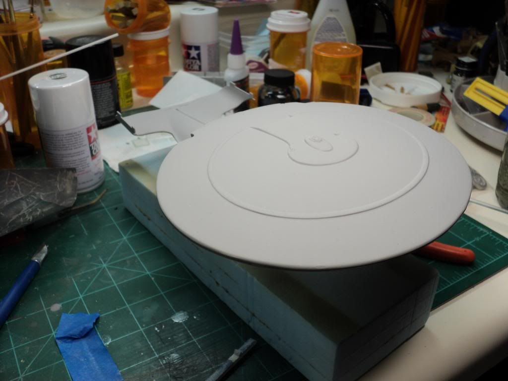

A bit more progress to show. I finally got everything into primer to see how well my filling of the massive gaps & such went.
One thing I also got accomplished is adding a rod to mount the model to a base once its done. Just used brass tube inside the model, and found a piece that would telescope into it, so I'm good to go. Already got a few ideas on what to do for the base, but will wait till its built to finalize those plans.

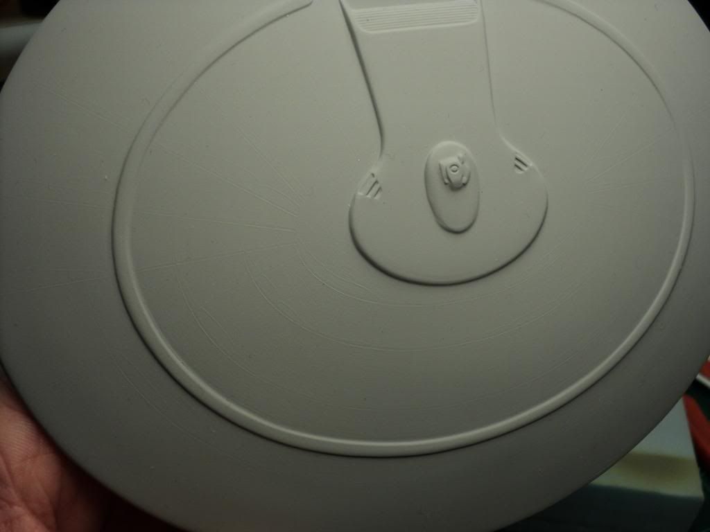

I thought it looked pretty good, and then I noticed on the top of the saucer, that all of the molded in detail was still ghosting through, which came as a huge surprise. I thought I had sanded it all smooth.
I've started polishing the primer w/ 600 & 1500 grip sanding films and it seems to be helping a lot. Its removing that least bit of the molded in detail, and the primer is smoothing out very nicely. Unfortunately it looks like its all going to have to be polished out, and more than likely repeat the primer & polishing stage at least one more time, to get it all smoothed out. I did notice around the join on the neck to the secondary hull that I have a fair bit of work left to do there, unfortunately its not an easy place to get into, so that's going to be a real fun area to work on.

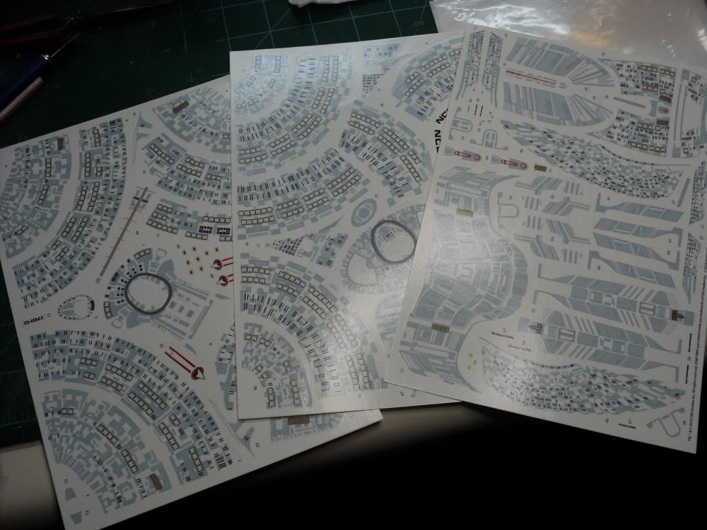

It'll make it much easier to put down all the decals. All the aztec patterning on the hull is in the form of very large decals.
So by removing all the molded on detail should theoretically make it easier to get the decals to go down, but we'll see.

It's going to be interesting for sure, but after having built several Nascar models that used large decals, I dont expect these to be too incredibly difficult. Just depends on how thick they are and how they react to Solvaset.
USS Enterprise NCC-1701-D (Sci-Fi)
I found that the great big silk-screen decals are way more manageable, if you cut them in to smaller sections. I put mine on over the solvaset, and the snuggled down nice.
