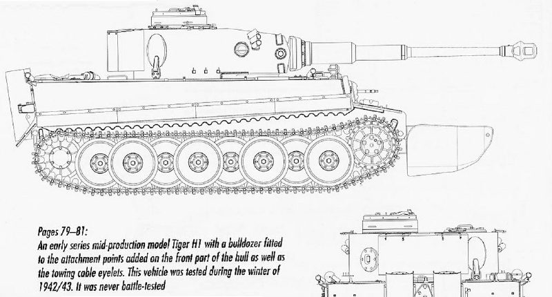

Might as well give myself an advantage at the next battle day this Winter. Based on his ref photo and a Jentz drawing I found, I built a plow for my Tamiya Tiger.

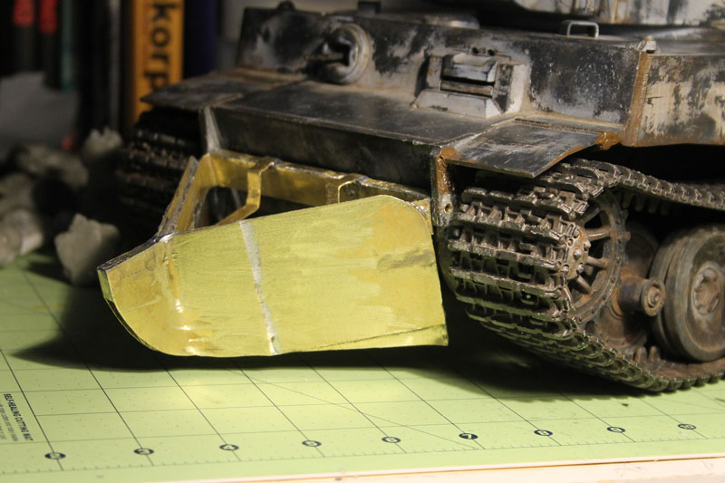

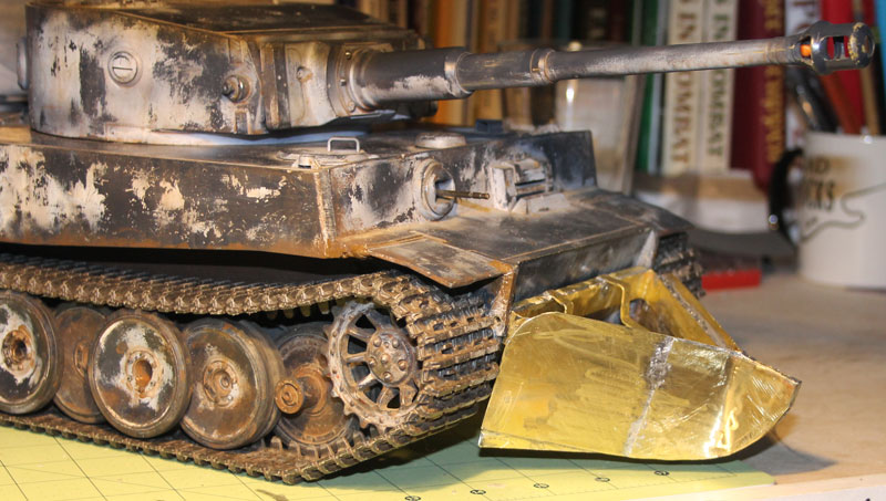

And my rendition in brass:

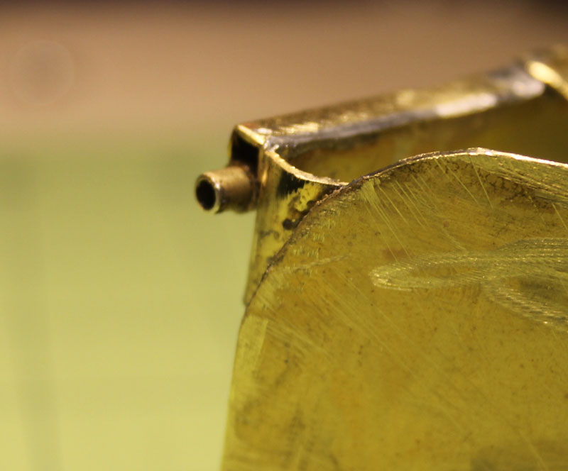

I mounted it through the towing eyelets just like the real one, one side has a spring loaded pin for easy removability:
I'm going to add a little detail and paint it up, but so far I've pretty happy with it. It plowed well on the porch, here's a quick vid of it on the shop floor:
