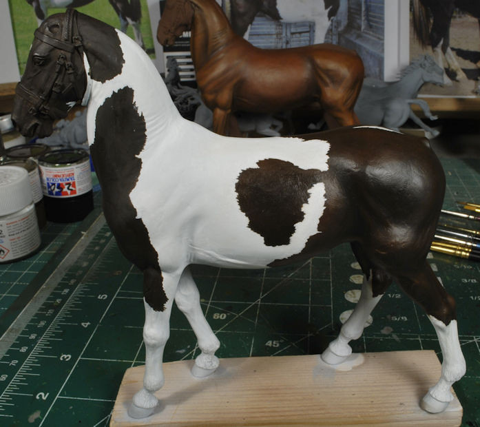

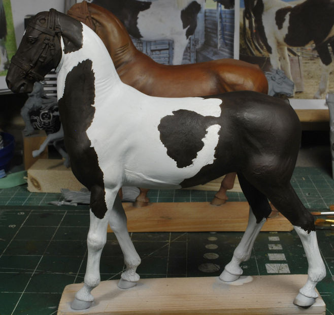

As per usual, I neglected to take sequential pics, but most everything I’m doing here is pretty basic. But I will give a short run down of the process to get things up to snuff. Having just started learning Big Dogs I kinda need to remember what I’m doing for later projects. Story has proven to be unique in her paint as each one is, but she doesn’t have the more complex patterns that we see out there. So, this is actually a great test pattern to learn on. Like the Dennison Smock, in regard to each color being highlighted and shaded individually, this will be treated in the same manner, but much simpler, with each tone getting the highlights and shadows to transition from dark to light as seamlessly as possible. That is the goal.

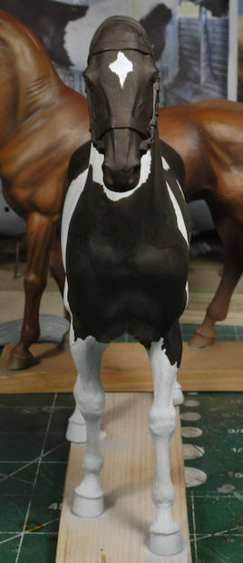

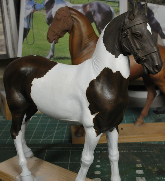

I added a few more reference photos to verify the pattern. I need to address the neck area a bit more before oiling that area completely, and I now see I may need to enlarge that patch on her left belly toward the shoulder just a bit more. It’s looking a little small to me. I will work the nose when I get to that area as well. But, so far, I think I’m close enough to call this pattern a decent rendition once I correct those few areas.

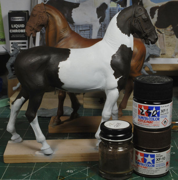

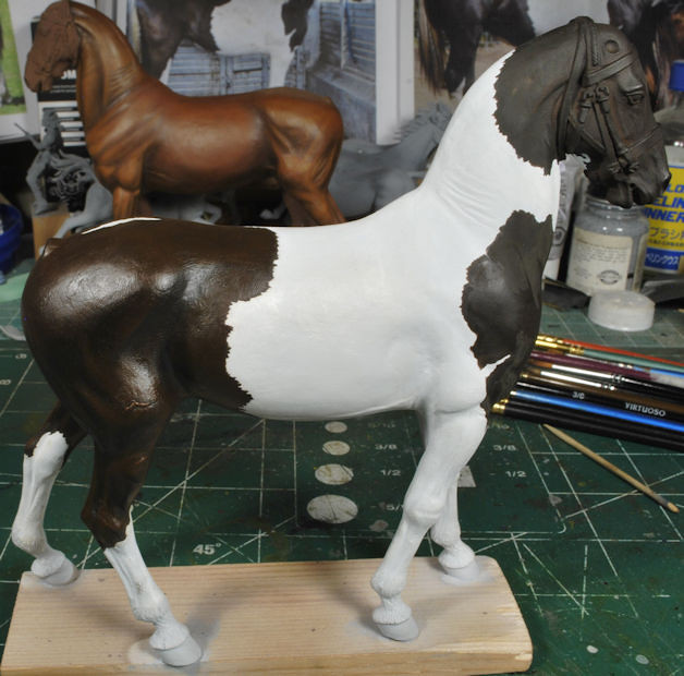

I started with a solid coat of Tamiya XF-2 Flat White airbrushed on for even coverage. I then mixed up XF-1 Flat Black, and XF-10 Flat Brown for the initial dark tone. Please don’t ask me what they call that dark color on Story. I forgot, and it’s not a deal breaker, so we carry on. HA! I know my wife could rattle off all that stuff, but not me. Regardless, the dark mixture is really close to the photos, so I airbrushed that on.

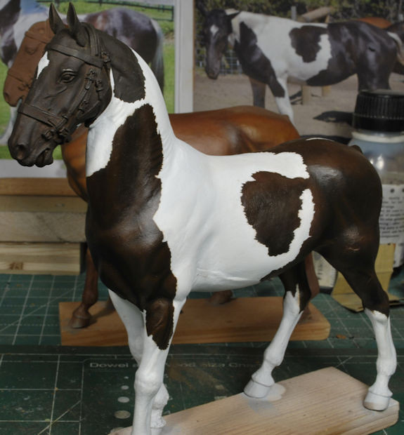

To get the pattern as close as possible during the initial color application I used AK’s Camouflage Elastic Putty. Man, that stuff is a life saver in this case and it worked great. After that coat dried completely I went back over the entire edge of each dark pattern to add in the irregularities that are visible in the pics. There are quite a few jagged edges on this paint pony and I wanted it as close as possible. Granted, it’s not such a radical pattern as many I’ve seen, but it’s there and clearly visible in the photos. I’ve added a pic of the “star” on her snout. There was also a white strip running up her back from the tail that I’ve never noticed, nor have I clearly seen them in any of the photos. This pup is getting big fast, so I may need a step ladder soon if I need more pics, lol.

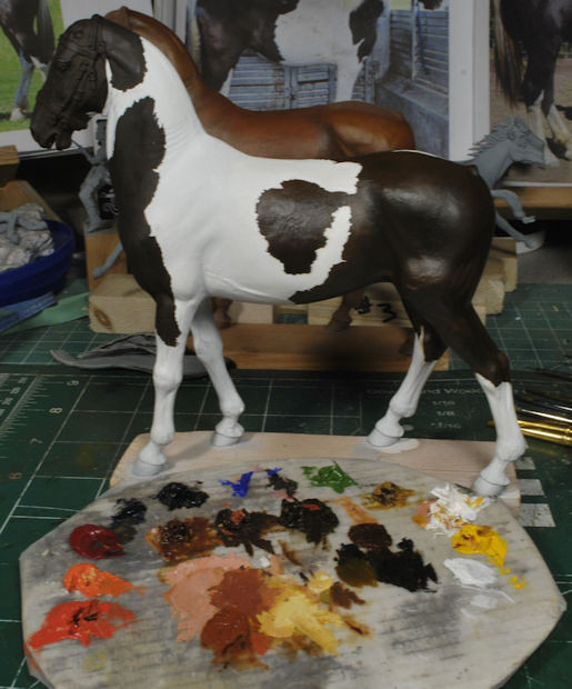

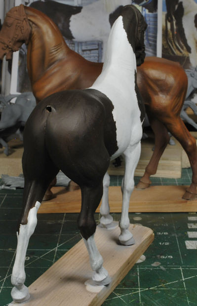

The oils have been applied to the back end of this pony, but it’s a bit difficult to see in these pics. Using a mix of Windsor & Newton Burnt Umber, Burnt Sienna, and Raw Umber to create the shadows and highlights, I worked my way from the left side to the right. Once these oils dry completely the sheen will dull and I will apply more highlights in specific areas.
The difficulty I’m finding is keeping the tones dark enough without getting carried away with the highlights. I will address the front shoulder areas and neck next. Once I’m satisfied with the initial brush work, I’ll tackle the whites.

Excellent Steve, I can see the shading over here. Story looks great!
Good deal, Bob. That sheen can not only mess with the eyes, but the camera, too.

Yes, Borther Saul, these are your babies and they are fun to work, tanks, Bro! I was going to forgo the final finish on Story, but the whites need a revisit, because they can be a head trip, if you get carried away and dismiss the subtleties of the shading. I've seen a lot of potentially great work go to pot from overdone shading, therefore, massive moderation, and a lot of walking away from the bench to reassess is what I've learned to do.
Now, if I can practice what I just preached, we're good, ya?:rotf:D;) Worst comes to worst, my trusty oven cleaner is always on stand-by, HA!

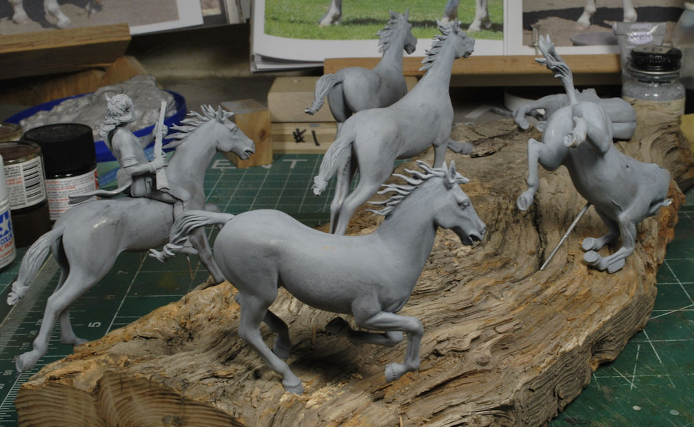

Shifting Gears, Skipping Ahead

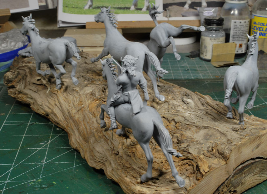

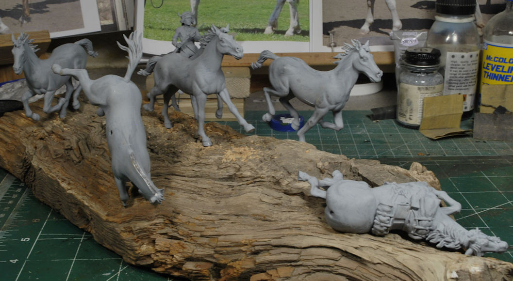

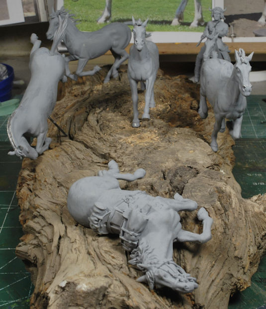

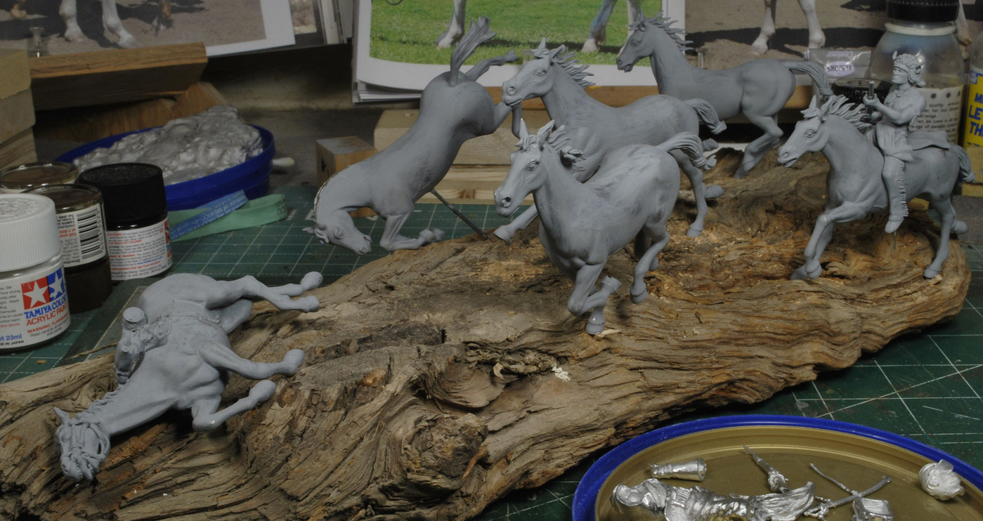

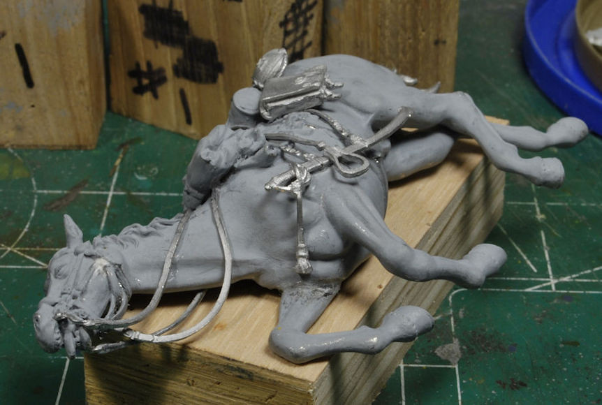

I was getting impatient with all the interruptions I’ve been dealing with and decided to put the bigger Big Dogs aside and start working on the base layout. My motivation was already faltering, so the only “real” way to reengage the drive to Ruck On was to shift gears, turn the wheel in a different direction. I love doing layout and base planning and I just so happened to have a left-over chunk of wood from the piece I used on the 42nd Highlanders vignette.
Before I get too far into the layout, I need to mention that the chest area on Story has begun, but I stopped short of working the neck and head area. I’ll get back to it later, but right now I need a redirect to keep the momentum going.

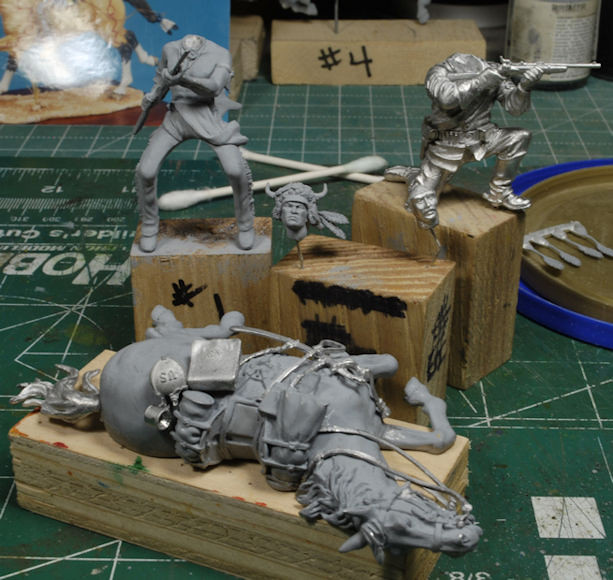

Honestly, this was the only way to compress this many ponies into one direction of battle while still telling the story with limited space. This chunk of wood has a lot of character and it just so happened to be big enough for the job, without a large footprint. I will be using air-clay and the appropriate amount of ground cover without destroying the grain. I plan to proceed as I did on the Highlander base and keep as much natural wood exposed as possible, yet give the ground cover it’s due. I think this will work, but what do yall think?
It may be difficult to imagine all the riders and their interactions with the Trooper, but each has been positioned in the most logical location for this scenario. Any final adjustments will be made once all of the figures have been assembled and put on, or falling off, their respective ponies. This layout is pretty basic, but I really don’t see any other way to make adjustments beyond minor movements in any given direction for each pony. So, if you see something I’m missing, please holler, I’m all ears.
Note; the Chief is charging straight at the Trooper, in the middle, just so you know which rider is making that suicide run. In any case, the Trooper is toast with that single shot carbine. I never understood why they didn’t issue Winchesters to all calvary troops until I read of the government selection process was a major factor, among many other reasons; training, ammo supply, etc. Regardless, it is well understood that Custer’s men were outnumbered and out-gunned in that particular battle. Remember, I am not replicating the Battle of Little Big Horn, per se, not at all. This is just some background information I found that plays into this scenario that could have taken place anywhere in the region before, or after, the Battle of Little Big Horn.
Might I add that I am not at all a fan of metal figures, not at all, and these Andreas kits are lacking basic assembly pics for some of the more intricate features. Still, for as old as these kits are, they are decent enough to make them work, even if I gotta fight em to make em work, lol.
More to follow soon and thanks for watchin. Cheers, Ski.
Hmmm, only place ground cover where the horses and other stuff are and leave the natural wood in between?
That's a big 10-4, roger that, Good Buddy! Yes, keep as much of the wood character as possible and air-clay the critical points for ground cover. If you look at how the 42nd Highlander vignette was done I will be attempting to work this in the same manner. The Trooper's pony will require some build up and same for the falling pony, but the rest will be straight forward.
Wow! That'll be action packed! Git'er done Steve.
Yes, Sir, bob, will do. Thanks!
This is going to look very exciting when done. Gary S.
Thank you, Gary. I like the action being portrayed with this set.
