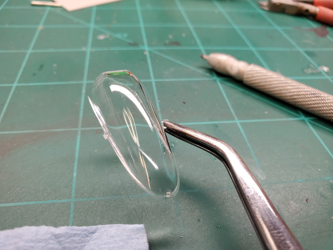

I grabbed a canopy from one of the P51s to test with. Did the dip and wick method, it's curing now. Wondering what sort of test do I need to try out to see if it's comparable to Future?

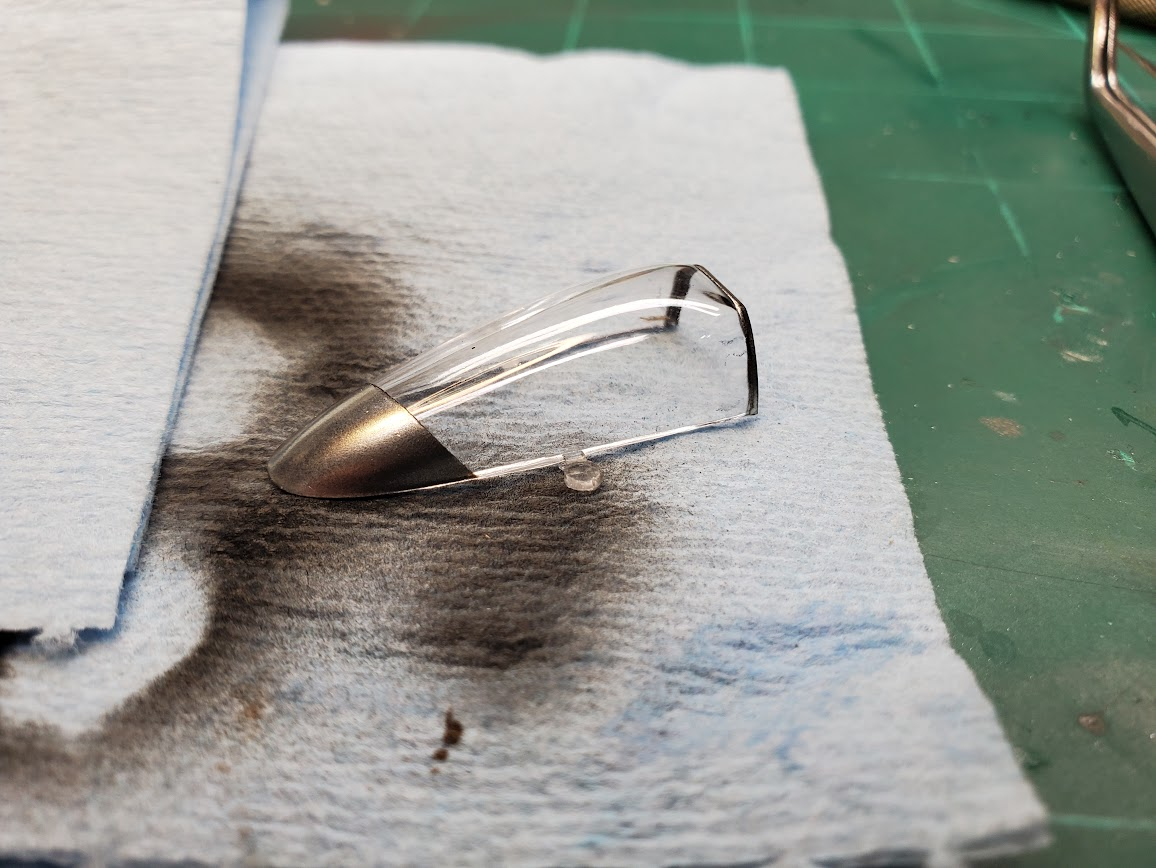

Nice shine, I've masked it off to see how it takes a lacquer coat of Alclad. Masking tape shouldn't lift it. Feels rather hard to the touch.
I've dusted off the old Williams Bro's Halls Bulldog build from years ago, got a lot of dust on the finish, might give it a mild wet sanding and give it a coat of this stuff and see how it goes.
Masking did well, Alclad black primer topped with airframe aluminum. The lacquer didn't harm the clear coat. Masked very nicely, I had a bad seal on the front canopy frame, no fault of the Bona.

Think I"ll go ahead and dip the canopies of the Comets and Gee Bee.

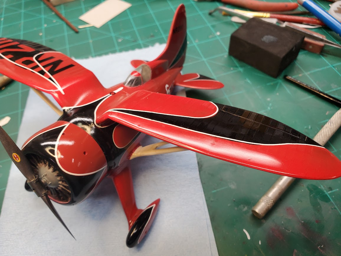

I didn't get a shot of the top wing of the old Hall's Bulldog but there were some embedded dust and other nastiness in the clear coat. I sanded though with my fresh sanding pads and gave a good coat of the Bona.
This is 24 hour cure time.
That scrap mark is where I used a scribe to see how hard the surface was. I'm not sure it's as hard as future was but it is shiny. There are some bits and pieces I could clean up and maybe take this around to the shows this season. This little thing did turn out pretty good back in the day. think I built it for the Race campaign years ago.
