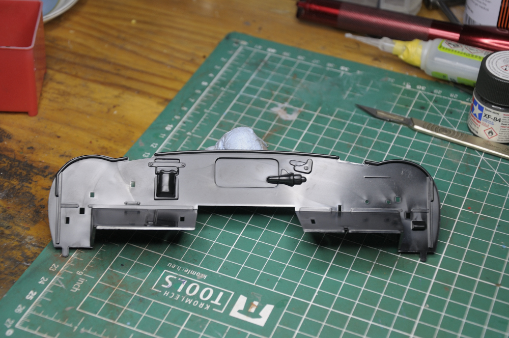

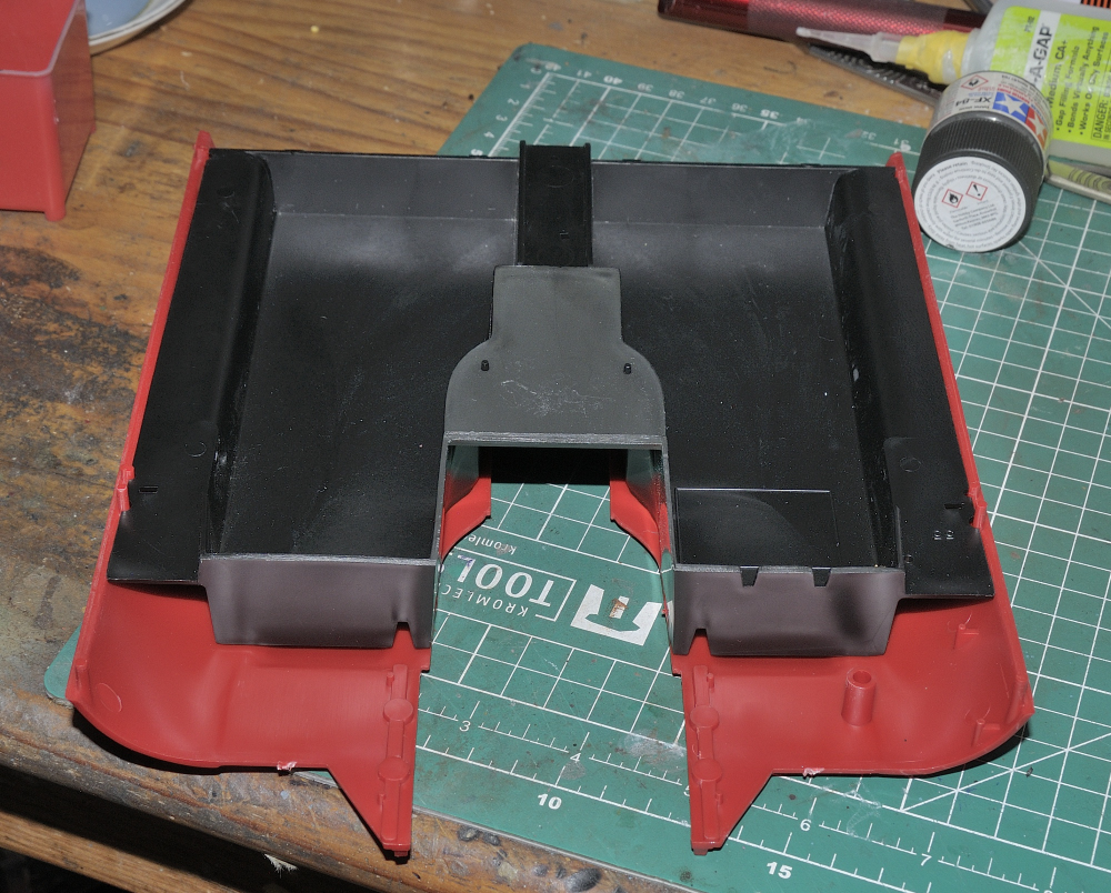

Chassis bulkhead or engine bulkhead if you prefer

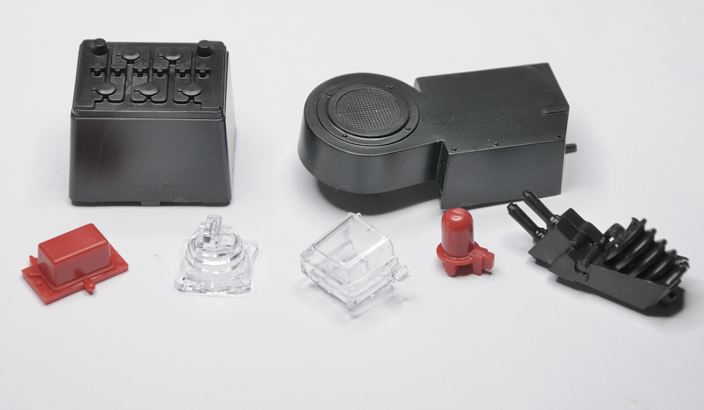

Wiper motor built in and some other bits i need to identify.

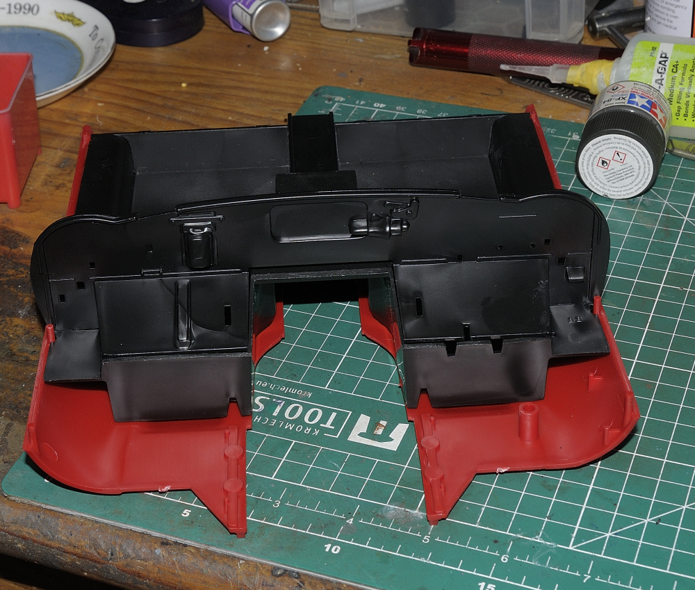

Floor sitting on the underside
Bulkhead added to the above.
Is there no end to the crudity :) As i keep reminding myself, what we have here is all the basics to build something, how far you go is up to you :)

We call that a firewall Paddy, didn't realize how many things are called by so many names between our cultures.

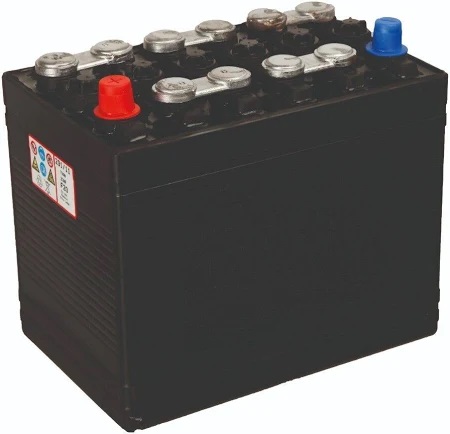

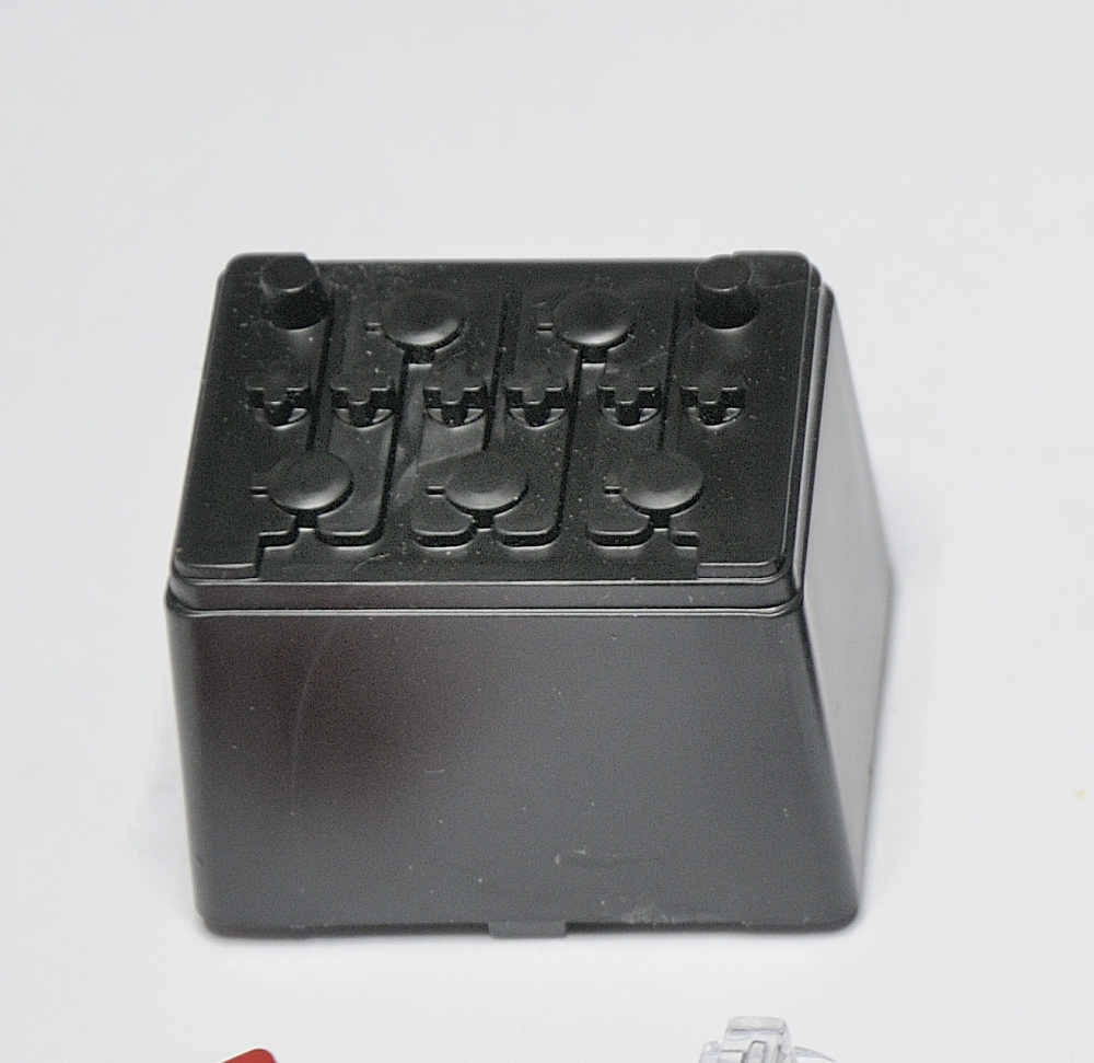

These are the parts that go on the firewall. I can see a voltage regulator and maybe a fuel filter...but what is going on with that battery ?
Is it like that to get it out of its mould ?
i think i need to address this :)
That's not a voltage regulator, it's a 4TR relay, or at least it was on mine. But being a 65 model it had an alternator, not a dynamo. And now I am bothered because I can't remember how the brake hoses were routed.
It is a voltage regulator John used in conjunction with a dynamo and incorporating a regulator/rectifier. Std it would have been positive earth but by swapping the battery leads and holding the contacts down in the Reg/Rec you could force the system into negative earth and then use a Alternator.
The 4TR was a voltage control unit used with alternators and built into later ones.
