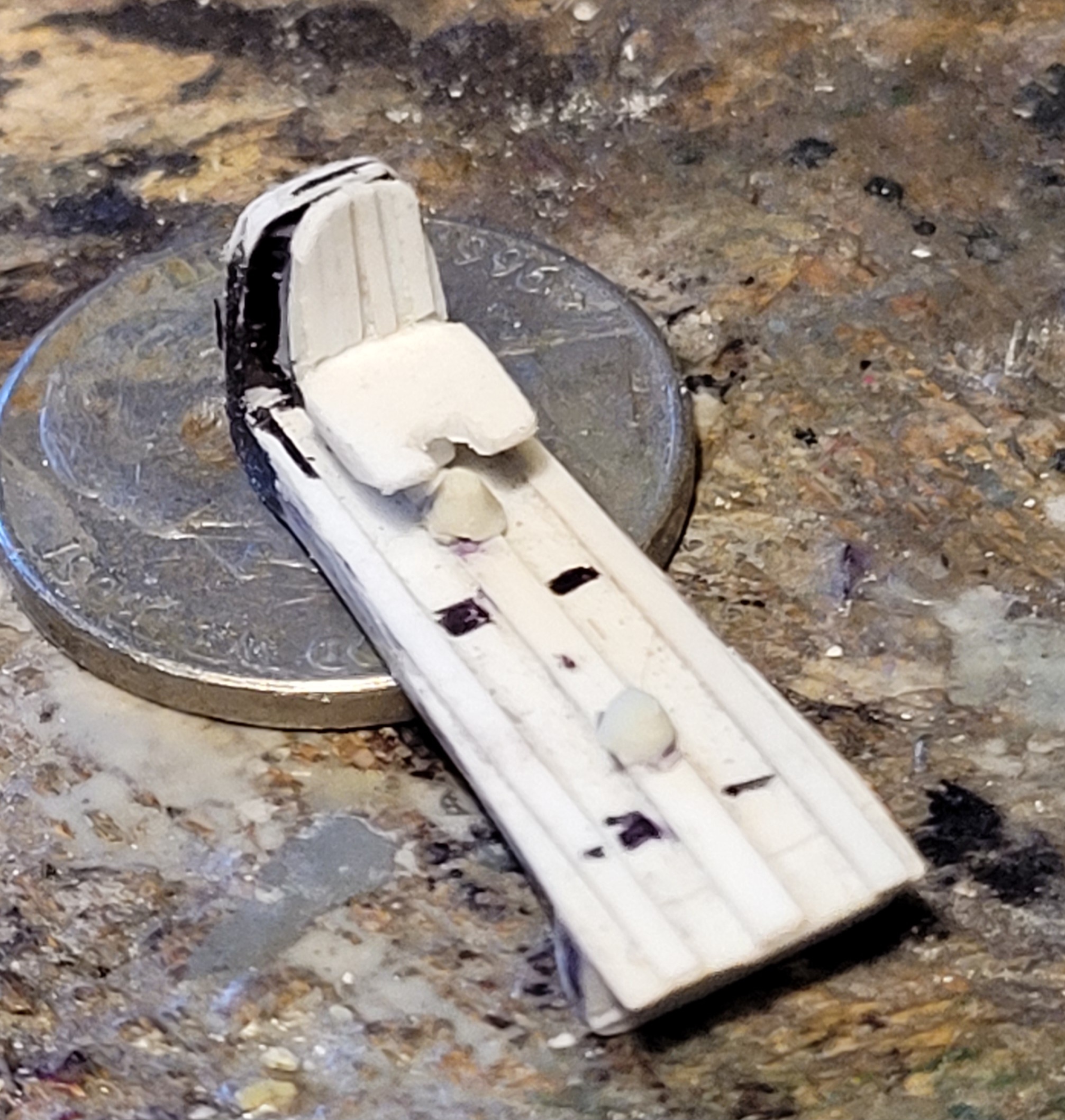

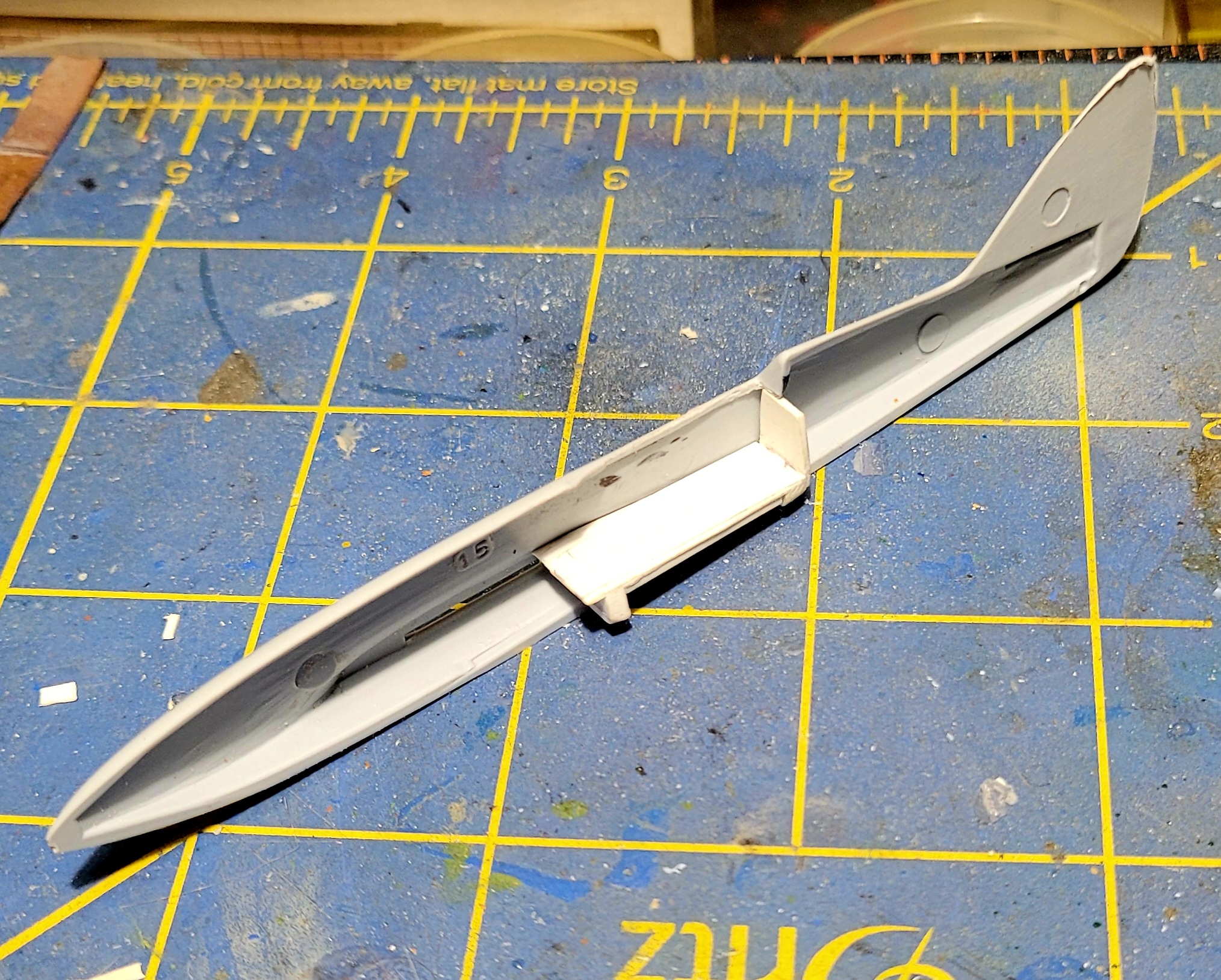

Basic floor contours and rear bulkhead so far. Fitting the styrene Master into the existing Comet proves an exercise in plastic-smithing. Seats could prove challenging. I'm using SBS' instructions a reference. I expect to produce a basic cockpit with instrument panels, seats, floor with rudder pedal and control stick boot details with room for super-detailing, as you wish, to fit the classic Airfix model.
Interesting, NO?!

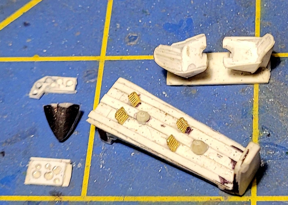

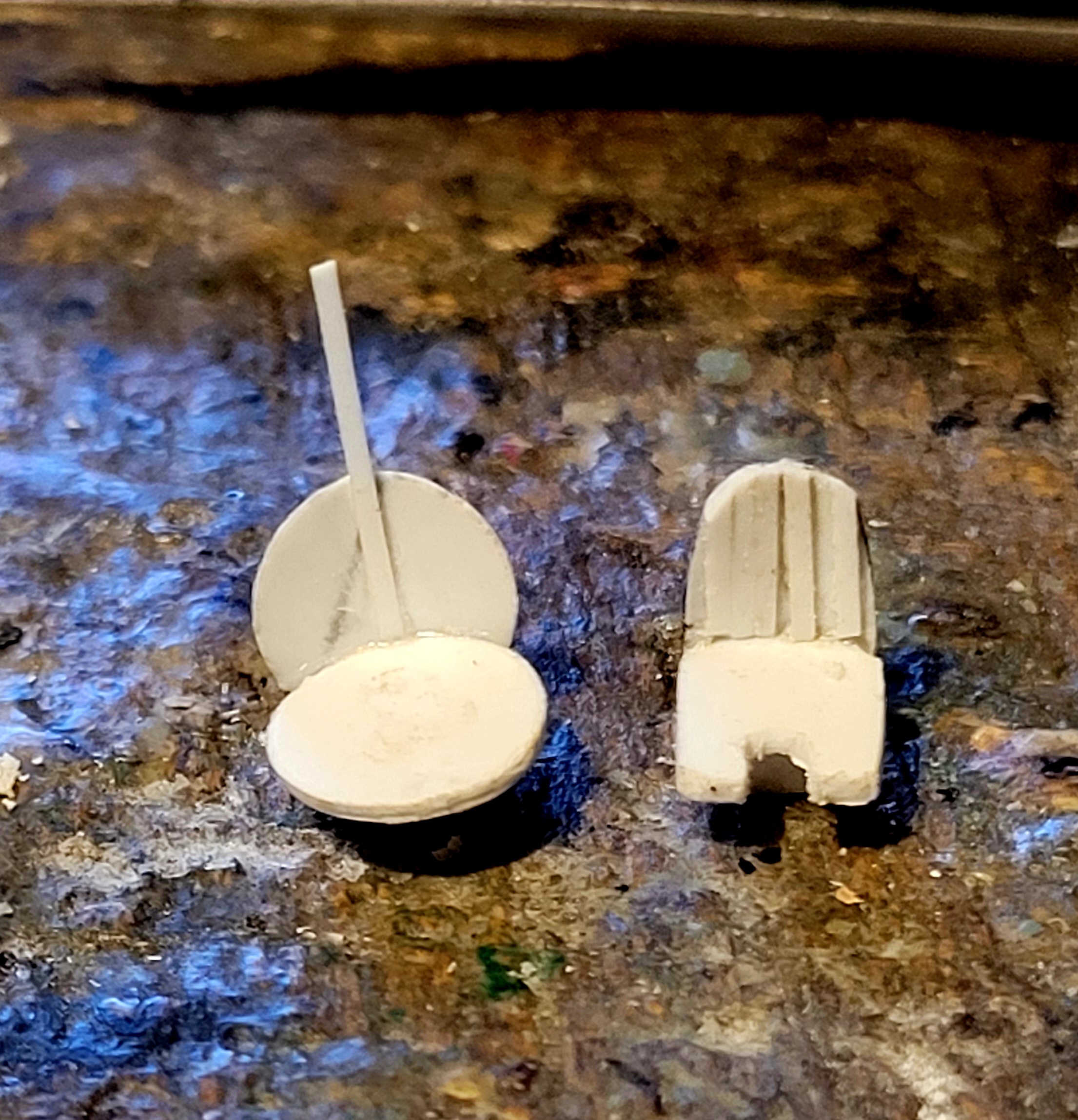

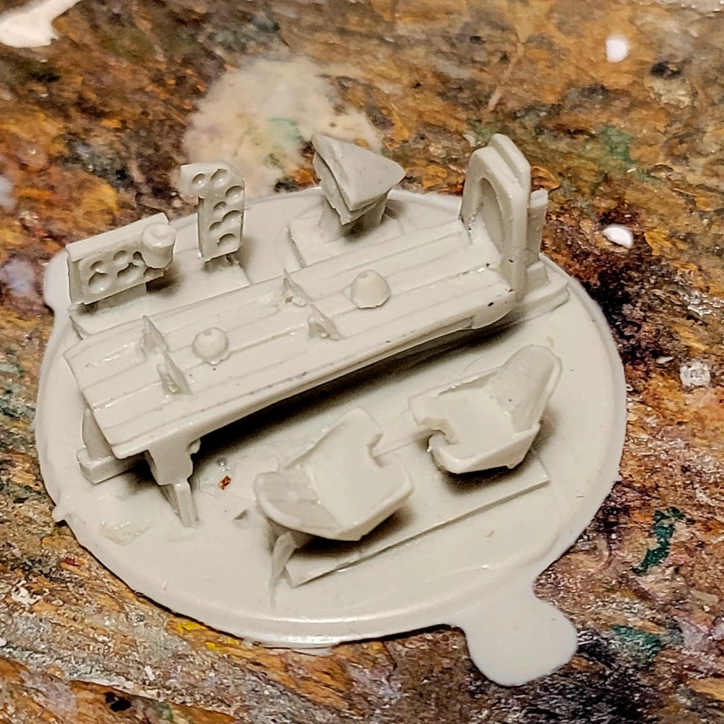

Working on the 1/72 Comet seats. Are they exactly accurate? No. Do they fit inside the Airfix 1/72 Vintage Classic (Turd) kit? You bet your Sweet Bippy! That's the whole idea! Make an interesting accessory for a favored classic airplane model.
See how it's just shapes and shaping? Anyone could do it!

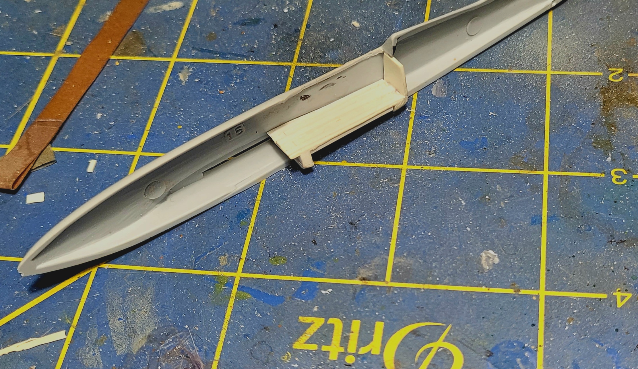

Finishing existing projects has been much on my mind of late. The Airfix 1/72 DH. 88 Comet cockpit is ready to mold.
I engineered this kit to fit inside the existing Airfix model without much fuss. The front instrument panel can mount to the new coaming. The rear I/P fits inside the fuselage. Rudder pedals are cut down 1/350 watertight hatches. Control sticks and lap belts are up to the buyer.

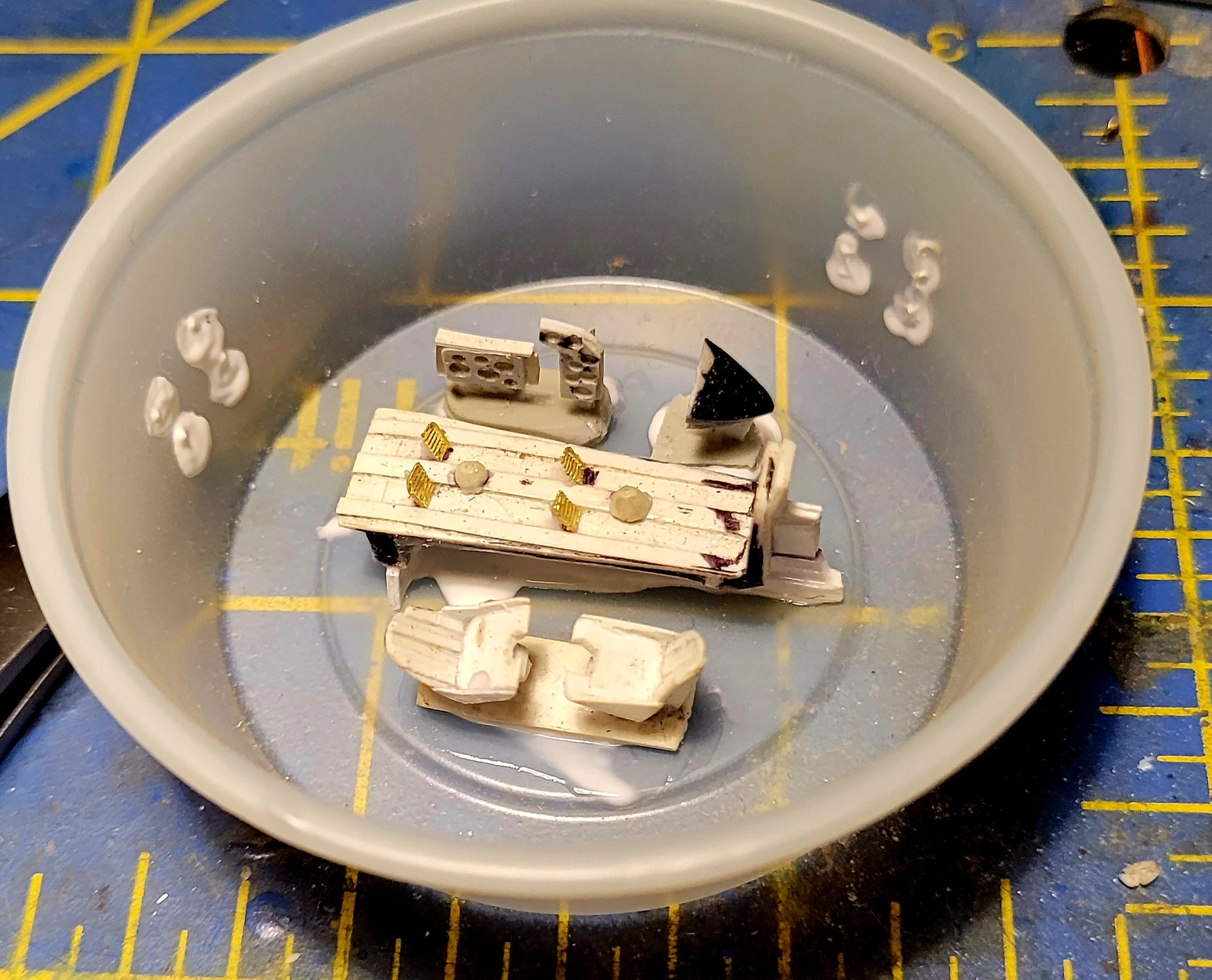

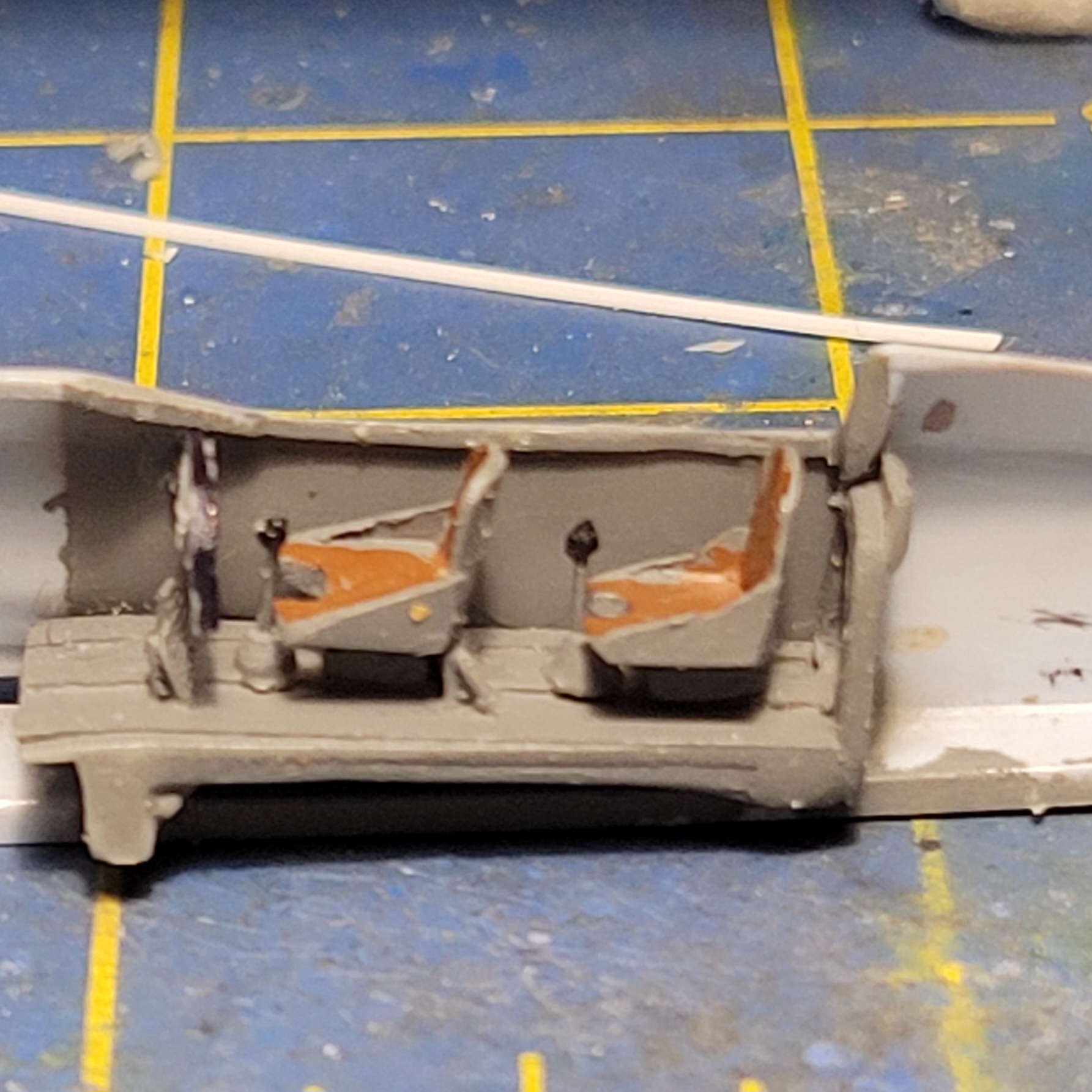

Seats, sticks and gray.
I know, I know. Pictures make the Comet cockpit look black. For contrasts sake, I went with Floquil reefer gray.

Control sticks are bits of .125 wire with a blob of C/A glue on the top.

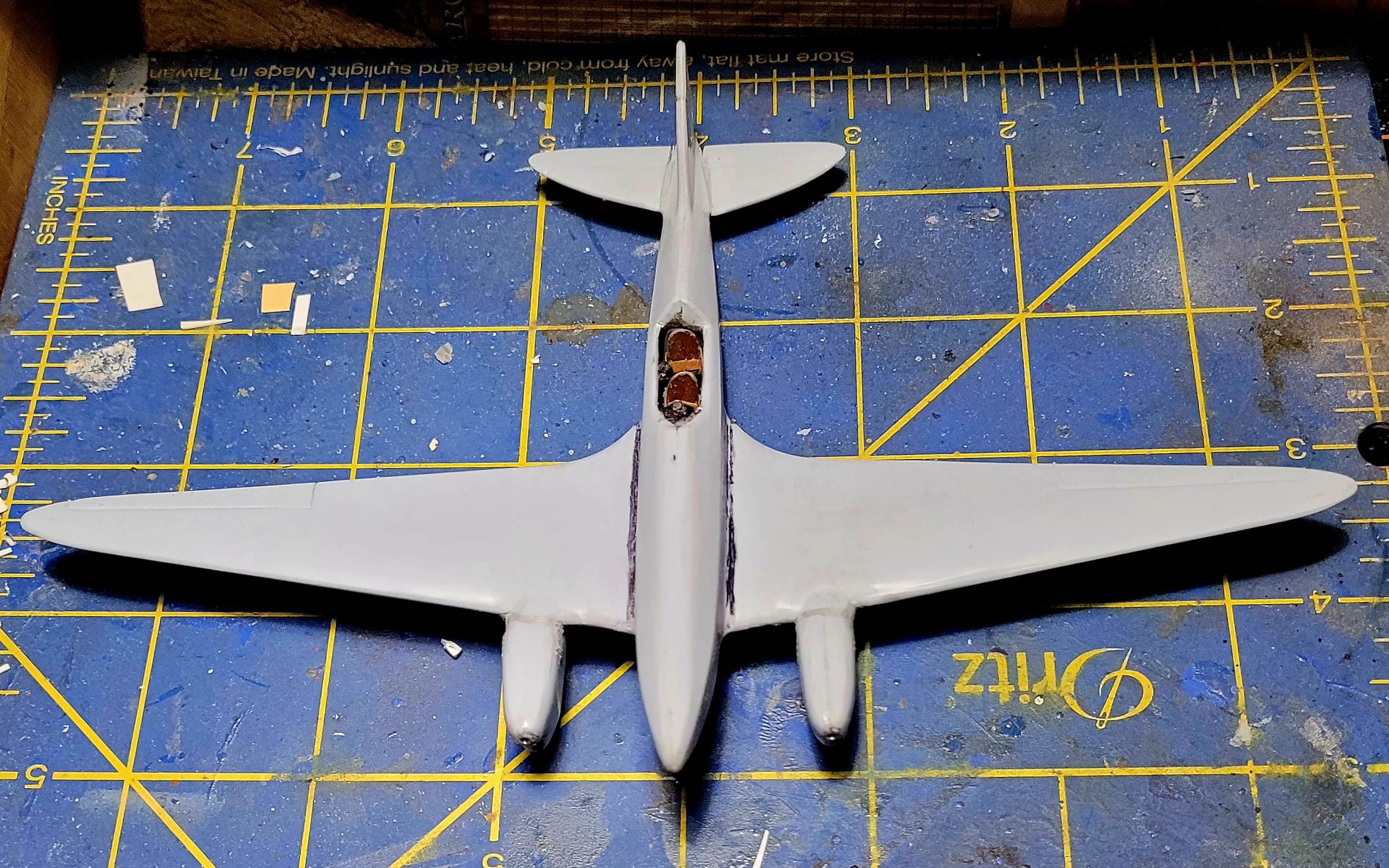

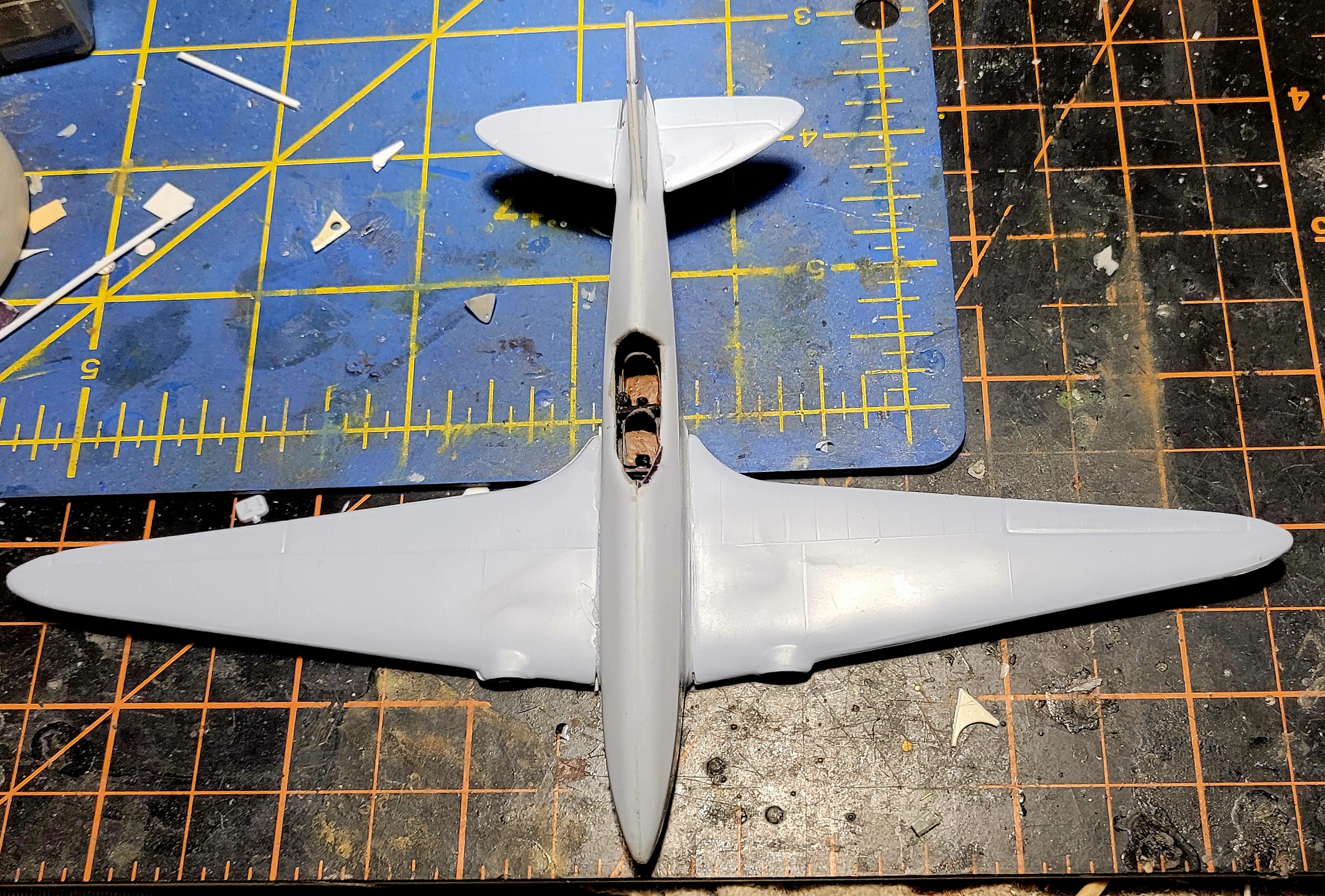

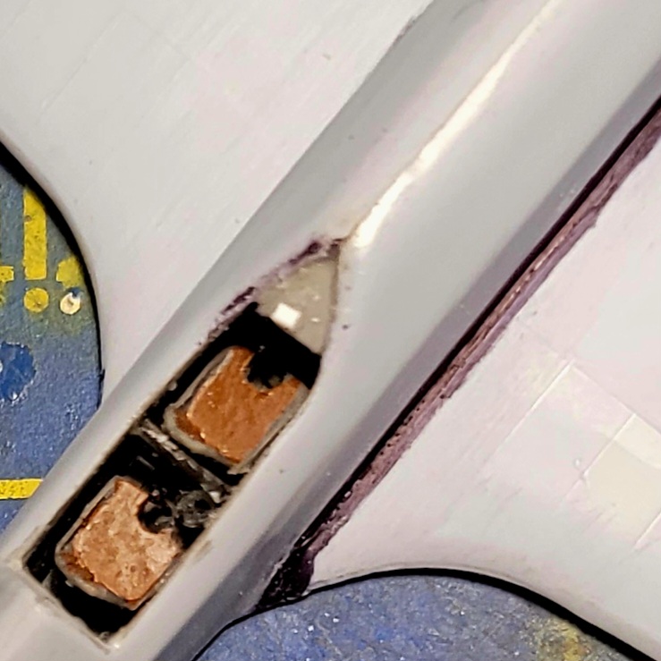

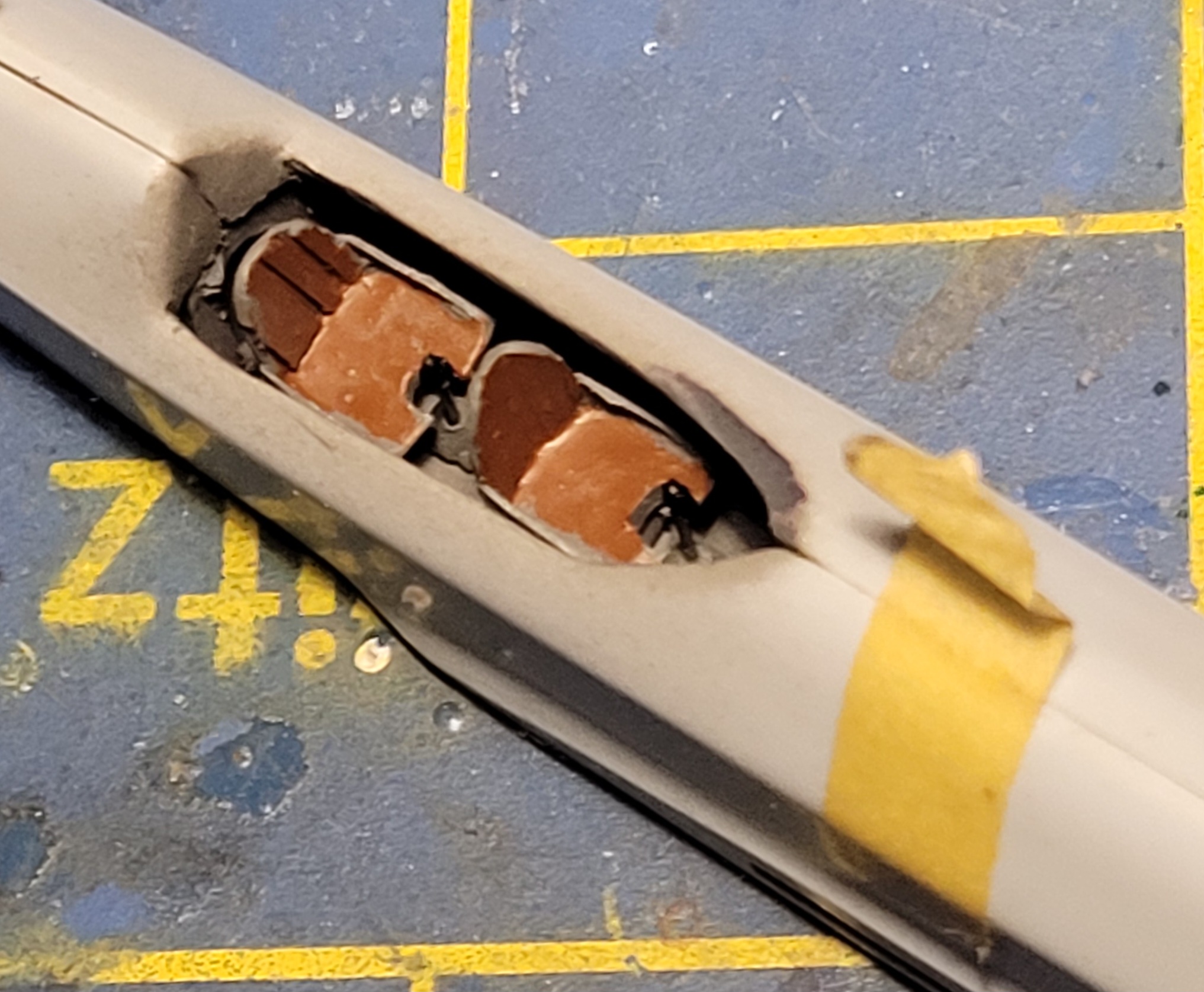

Test fitting got old quickly. I started gluing airplane model parts together and lookee what happened! MUTHERPUSSBUCKET!
Adding lap belts would have been better done before my MEK stuck the soft, vinyl-ish Airfix plastic together. Oops.

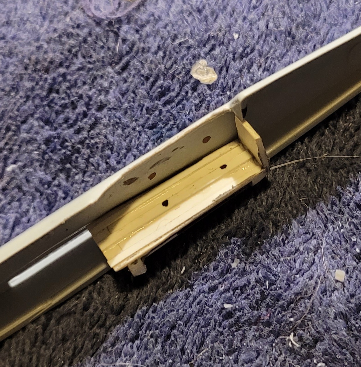

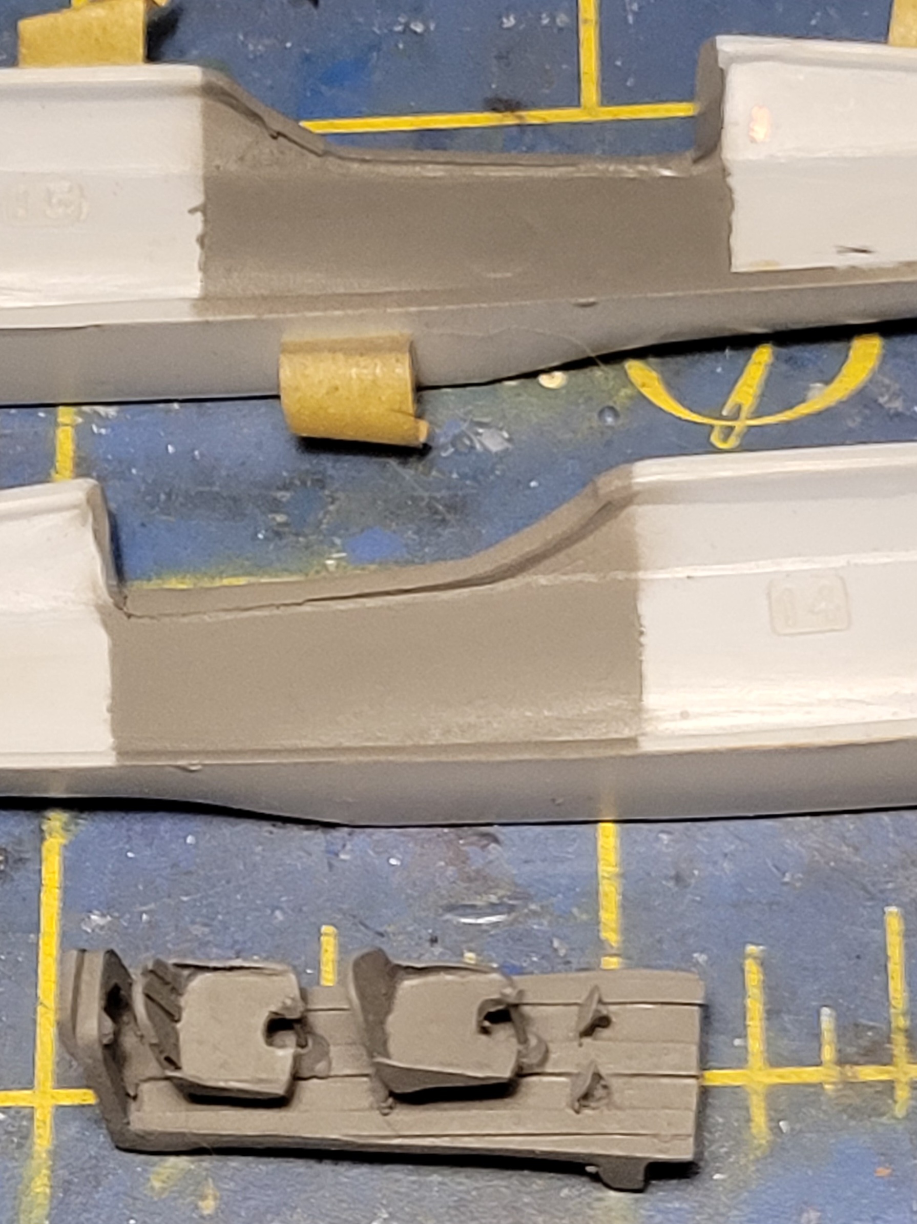

The cockpit coaming part fitted to the model. This is the only part in my interior kit that must be sanded to shape. I cut off the bit of .040 square plastic I used to hold it while I shaped, and made a compass housing.

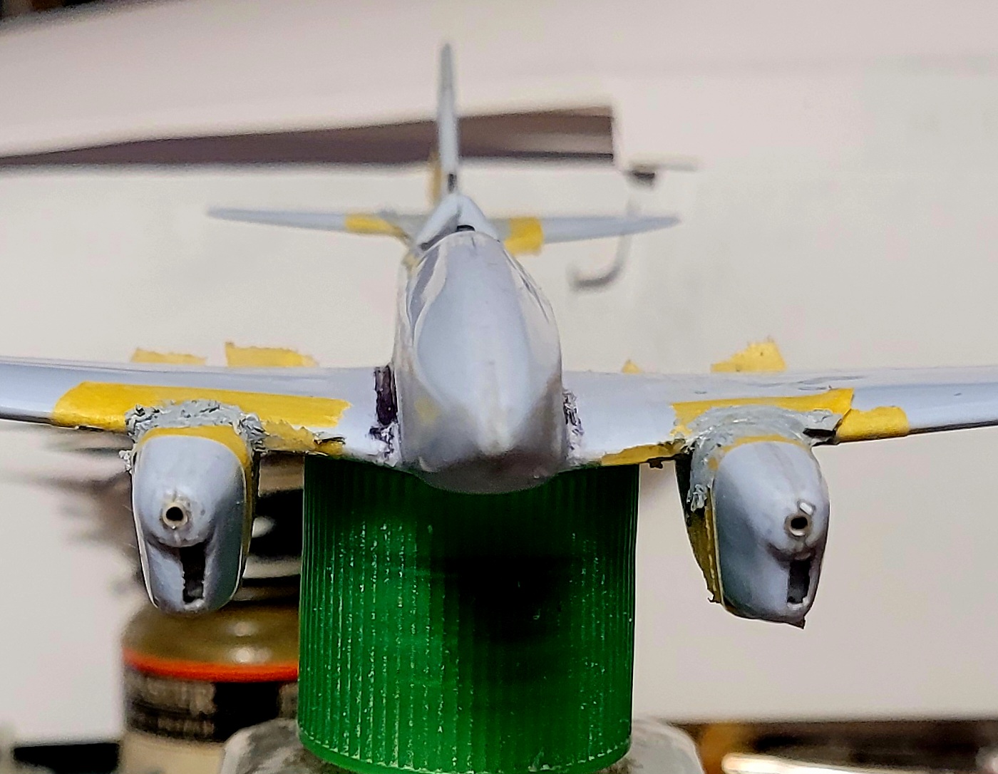

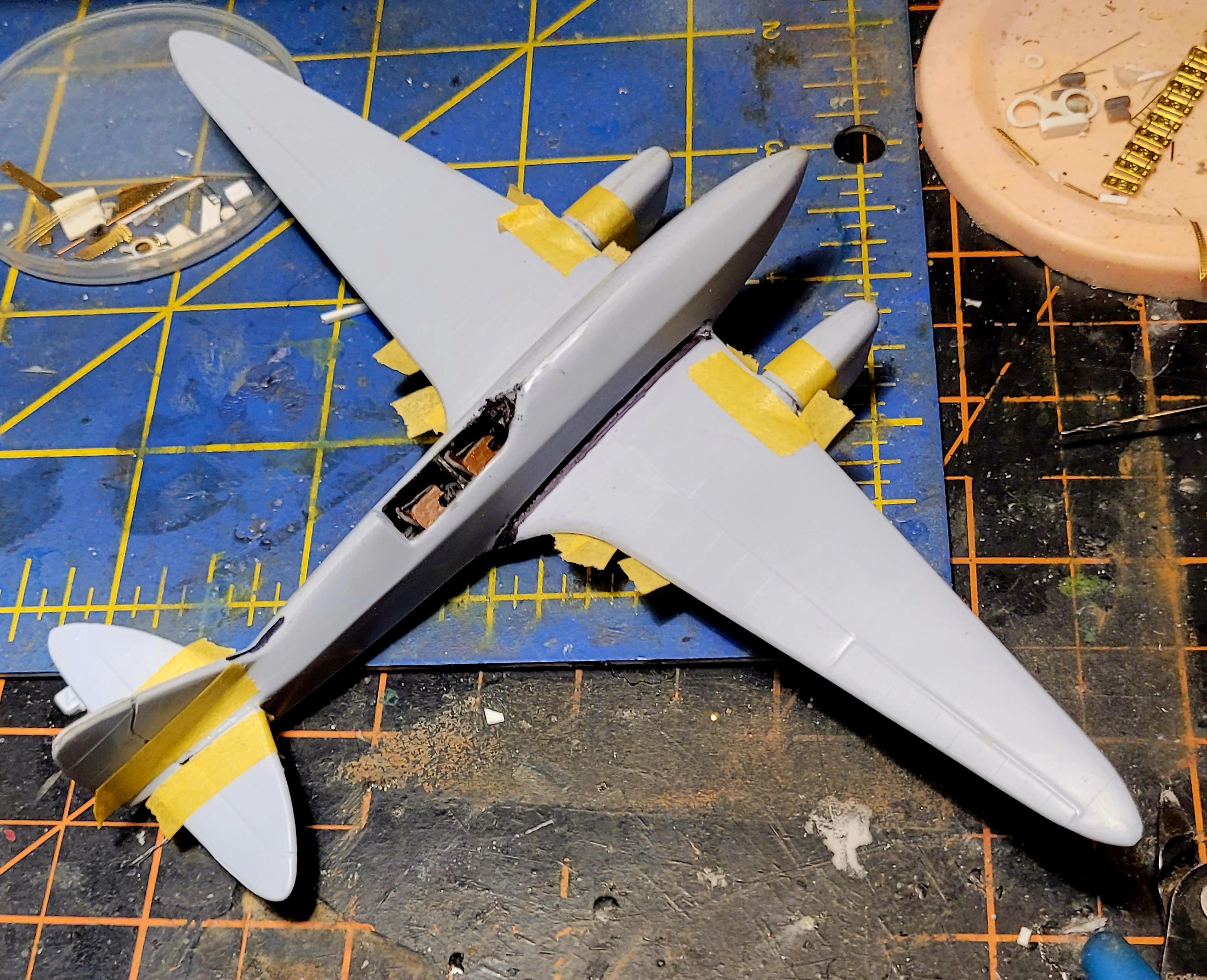

Time to ugly her up! Kit reviews comment on the amount of filler needed to smooth the engine nacelles into place. They ain't just whistlin' Dixie!:bash:
I like to add brass bosses for brass propeller shafts on my airplane models. My kit's nacelle halves weren't completely molded. Plastic surgery resulted in a much better look. I will pose the canopy open to show off the cockpit. That's wise. The canopy fits almost as well as the engine nacelles did. :lol:
Smoothed and slick! ready for primer. Alclad Chrome with Tamiya clear red overcoat?
This is NOT the amazing 1/72 DH.88 the Hungarian SBS resin kit is. This 2014 reissue is not too bad for a 57 year old tooling, all things considered. The last airplane model I worked on was the 1/72 resin Moonbat. This seems simple by comparison even after adding the cockpit parts.

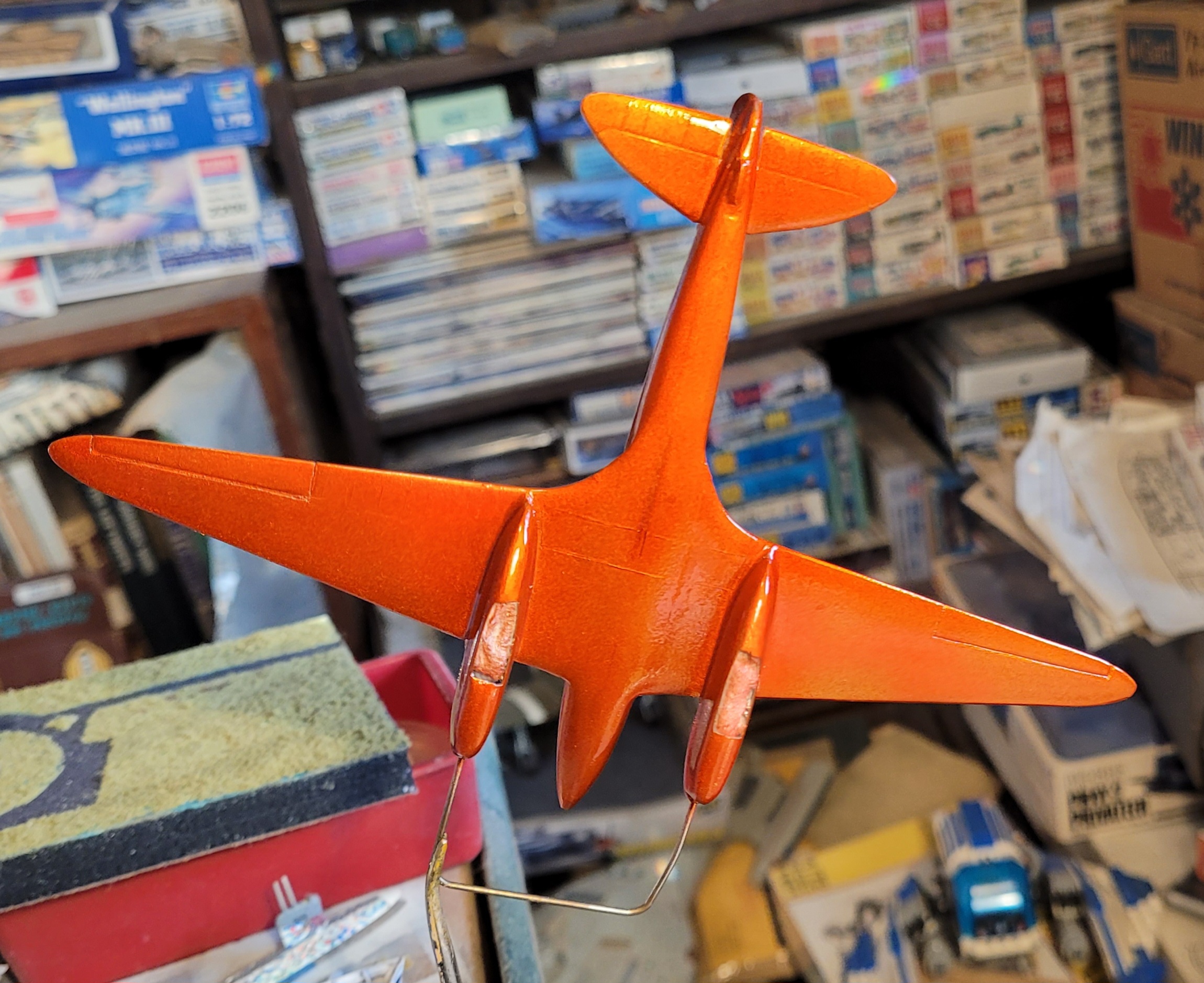

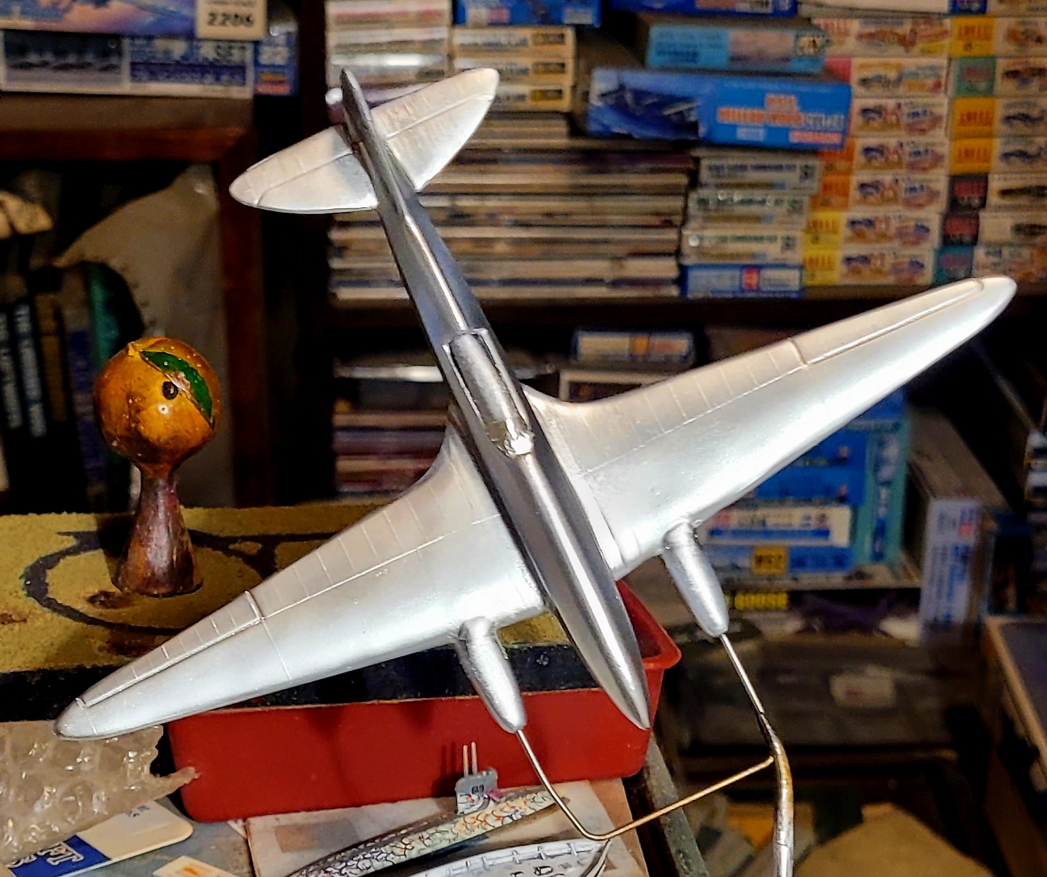

I made a brass rod jig to hold the Comet for priming and painting.
Future undercoat and Alclad chrome. Remember the Gaffney Peachoid or more recently the Golden Fying Fluck?
Stay tuned, my friends, to see how the red piece-of-candy paint job turns out!
Perhaps one CAN polish a turd! :lol:

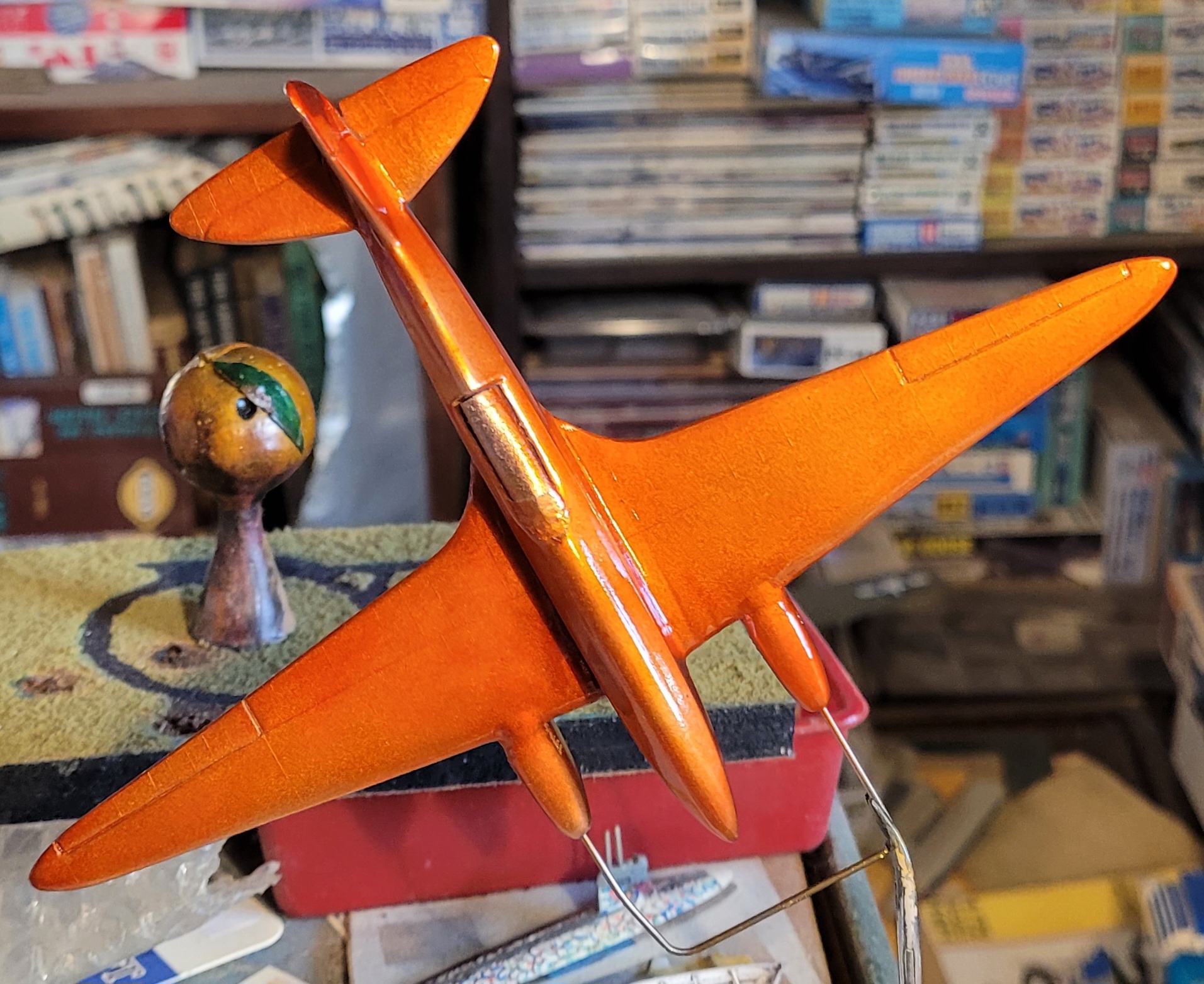

Not so very red, is it, chaps? Tamiya clear red and Alclad chrome seem to lack the opacity to cover very many sins. She's more orange than any other shade. A second coat may make the difference. Not quite the effect I had hoped for. :bm:
Whaddyagonnado?
