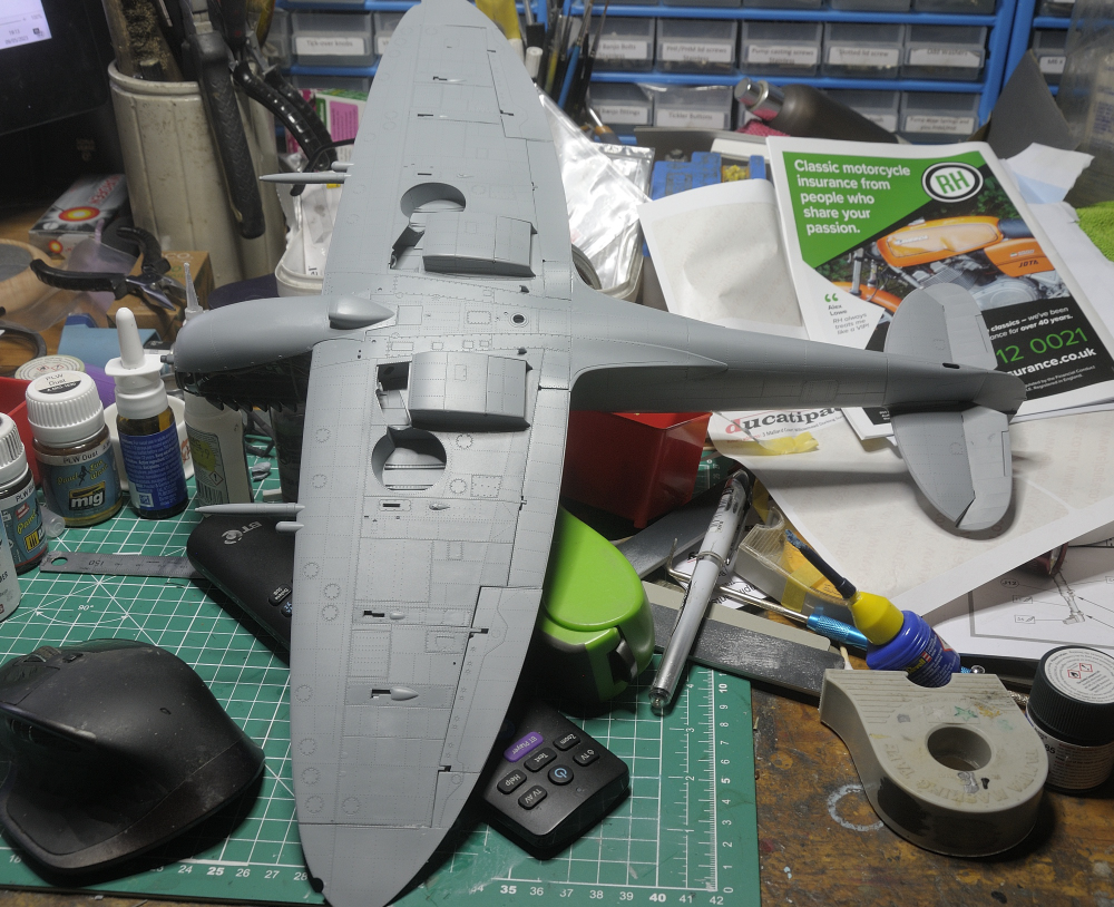

But if you replicated that panel fit on a model and took it to a show... :smack:
I think it would work but the problem as always is scale. Scale down a lot of those dings and edges and you would be hard pushed to see them. you could get away with some at 1/24 i suppose

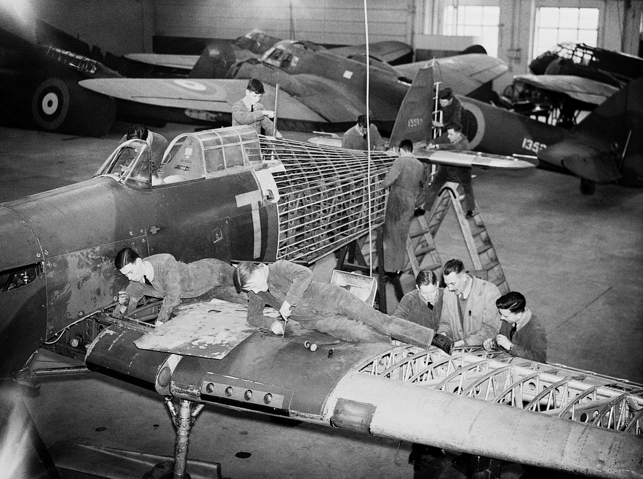

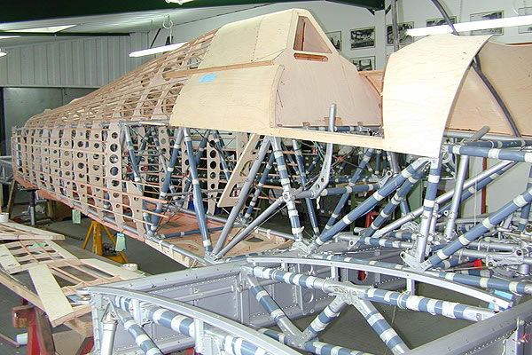

yea i thought the cockpit back was wood but looks like even the cockpit was partially wood as well.
The panels over the blue tubes would have been metal

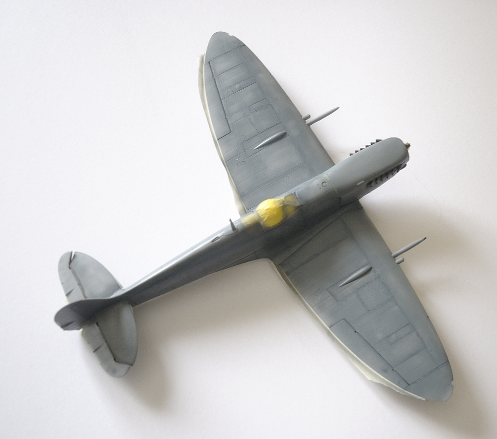

Absolutely love this MRP paint. it goes on with no fuss 10psi or 30psi, this was done with a pretty basic Pausch VLS but i use a Badger renegade for fine work.
The finish is a light sheen that will take decals without gloss coat and it will be interesting to see how their Mat coats work over the decals.

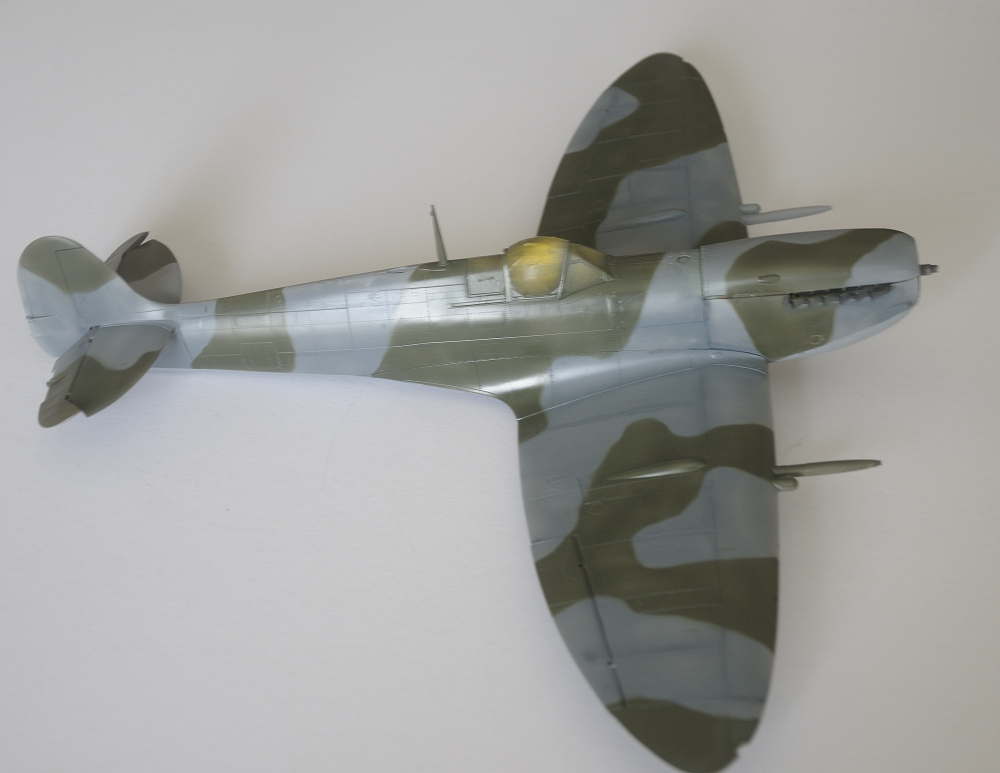

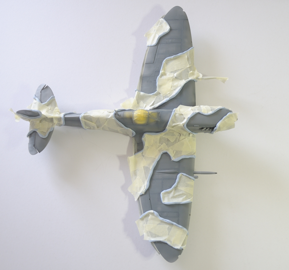

Got some "experimental " paint on it now
MRP Ocean Grey (RAF)
MRP Dark Green (RAF)
Notice how i changed the pattern aft of the cockpit, not sure how i got it that wrong but i was watching the Motorcycle GP :)
I'm never really happy with my RAF camo patterns but i find once the decals and stripes are on they always look fine. A mat coat will blend it in a bit as well.
