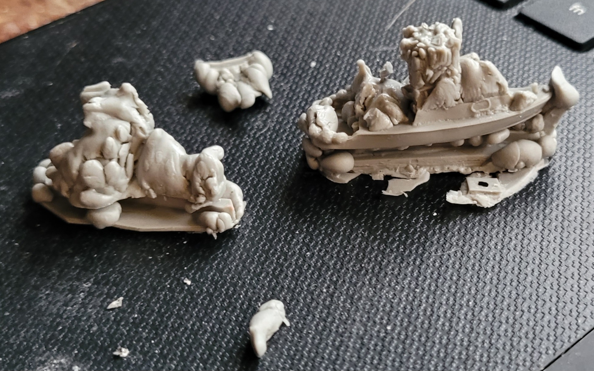

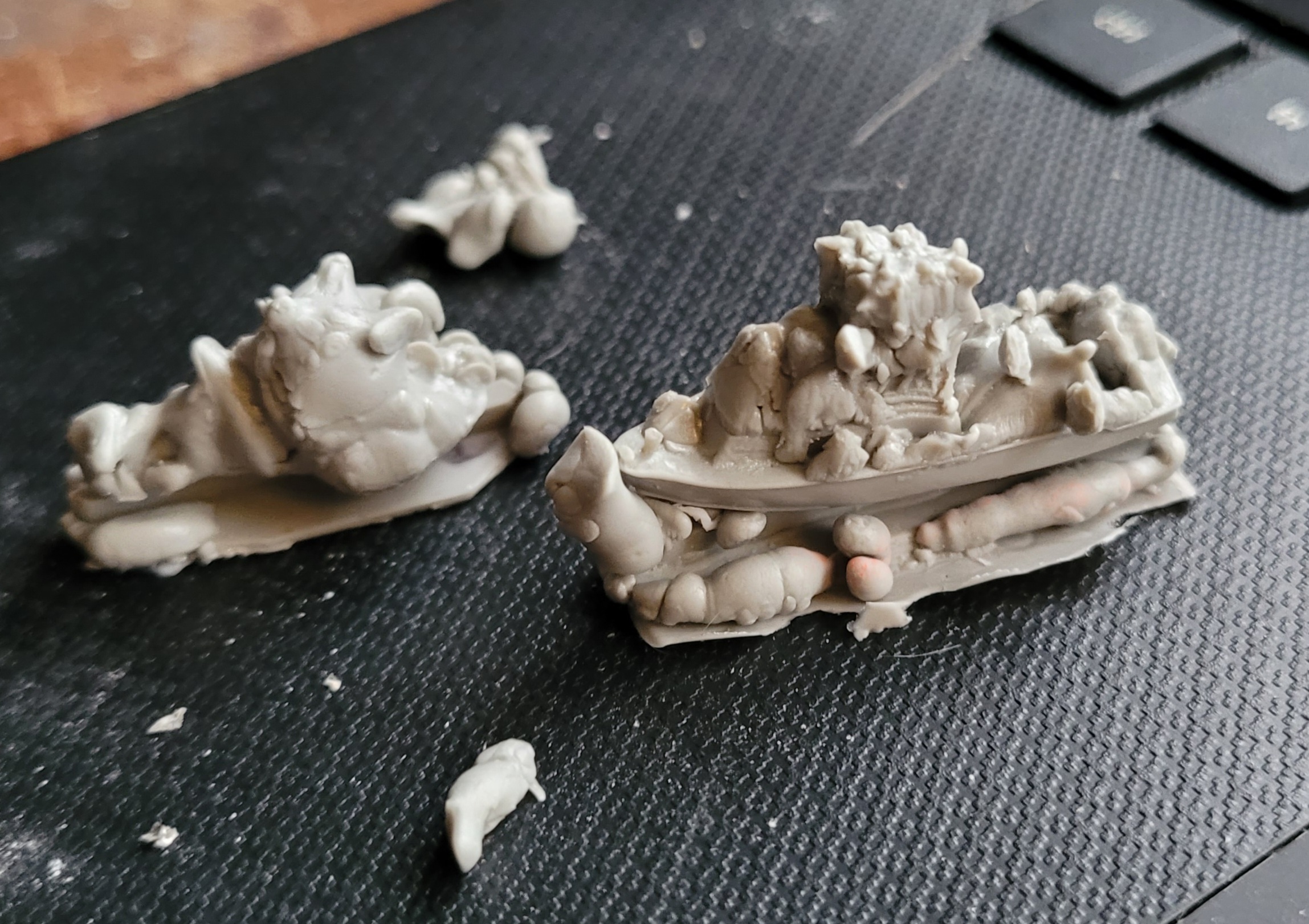

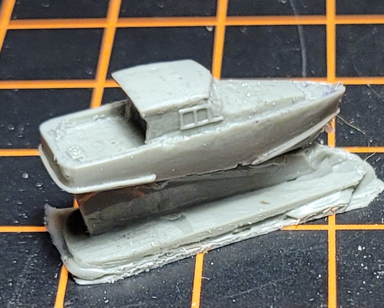

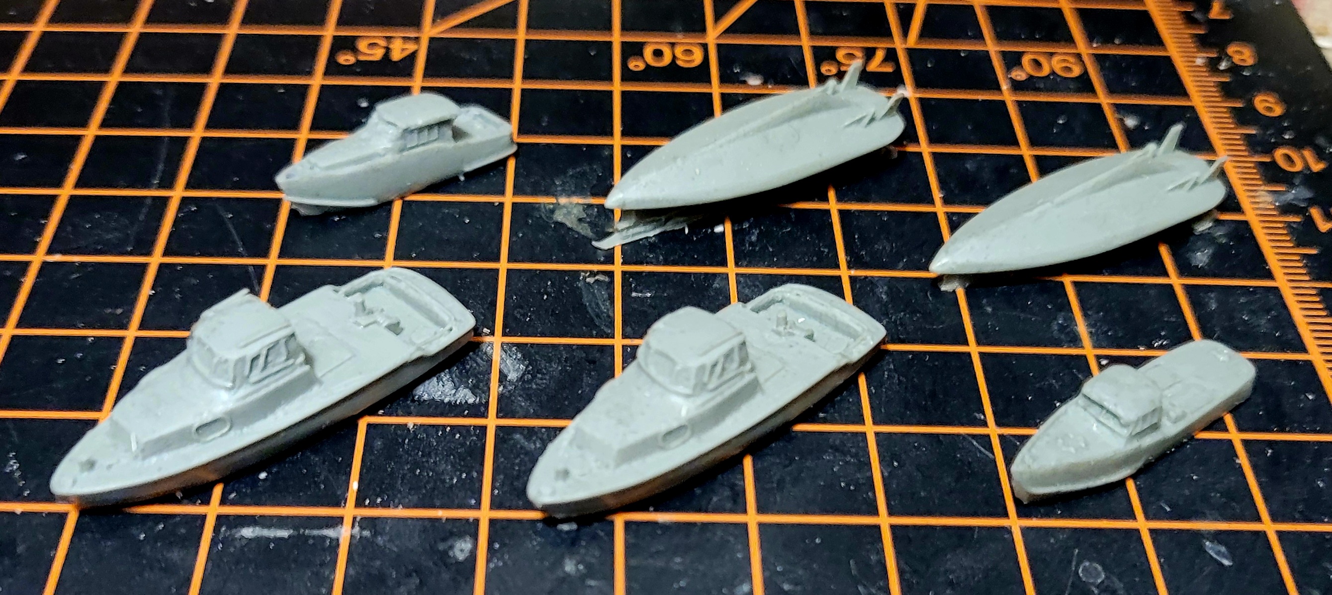

These castings are a giant improvement...........
..........over these turds!
The new 41-footer is correct. Drilling locating holes for the complex railings and adding the support for the radio mast will finish off this boat.
I will be proud to sell Kit 218 with these accurate US Coast Guard models in them.

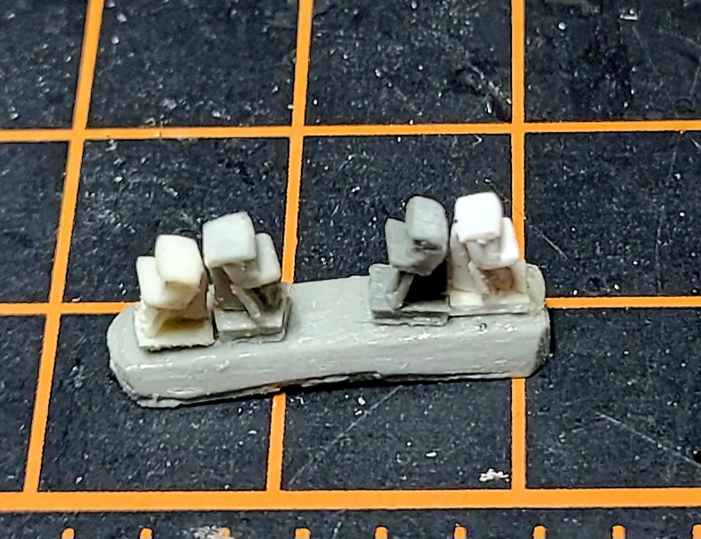

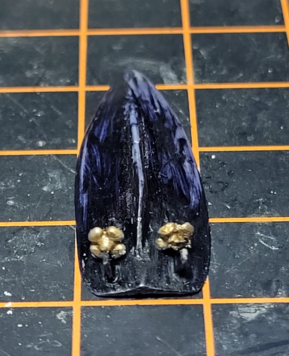

I planned to add the Caterpillar diesel intakes to the late 1/350 41 UTB master, but if I do there will be no way to drill the aft towing bitt for it's crossbuck. BFA! These ubiquitous little boats were like the wreckers of the USCG.
The Cat intakes will have to be separate parts for 2 1/350 scale boats. This revised kit is close to molding too. The pictured build is for the box art and instructional use.

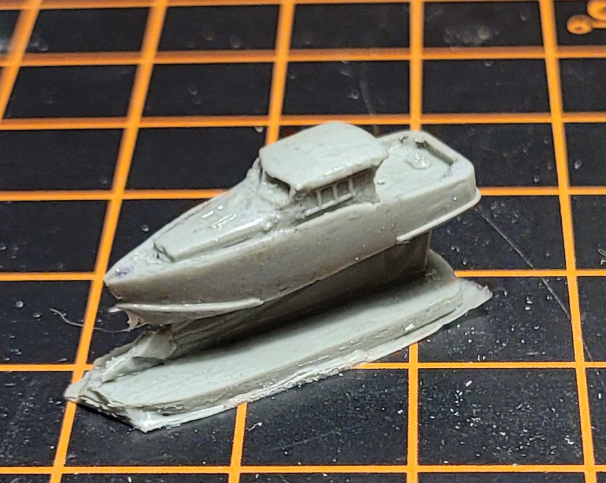

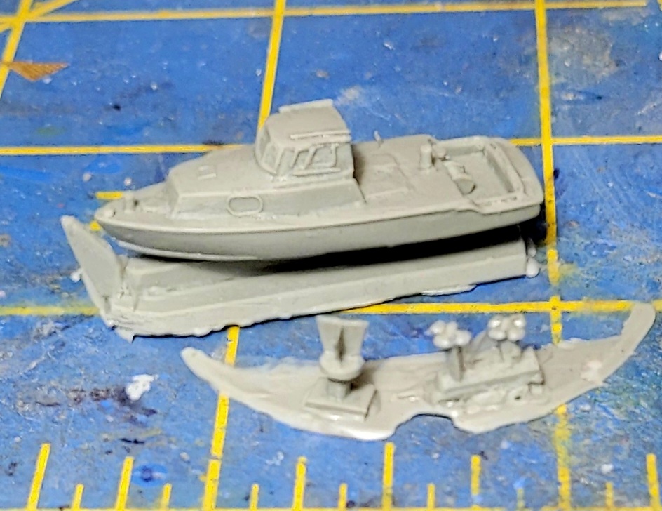

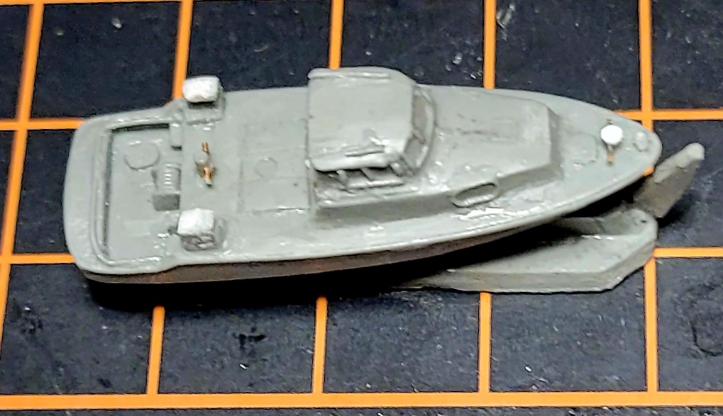

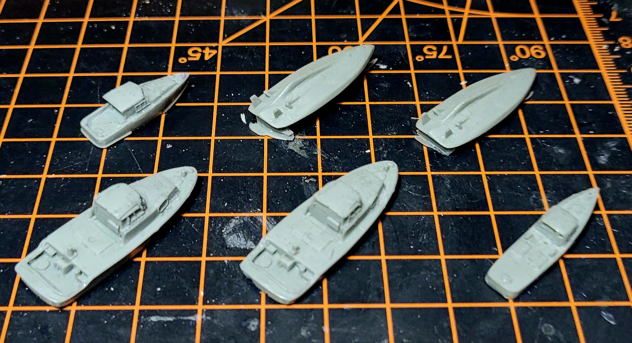

New 1/350 41-footer mold is populated. The after towing bitt had to move, but the Cat intakes still cover it for drilling.
25' Wheeler Sport Cruiser is new. The speedy 28' launch got a few improvements and will still be included in the kit.
The big SATCOM dome is NOT for these models.

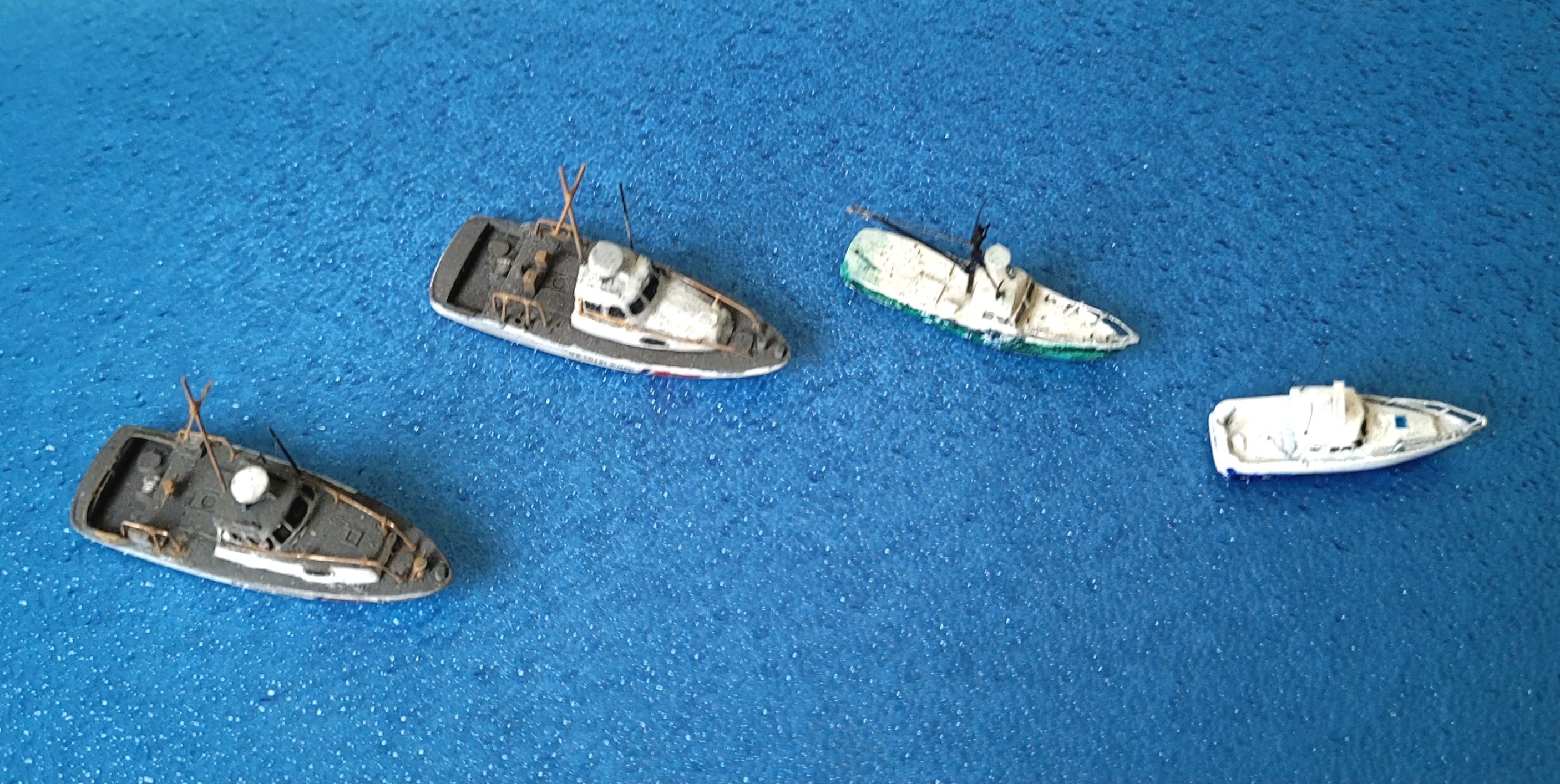

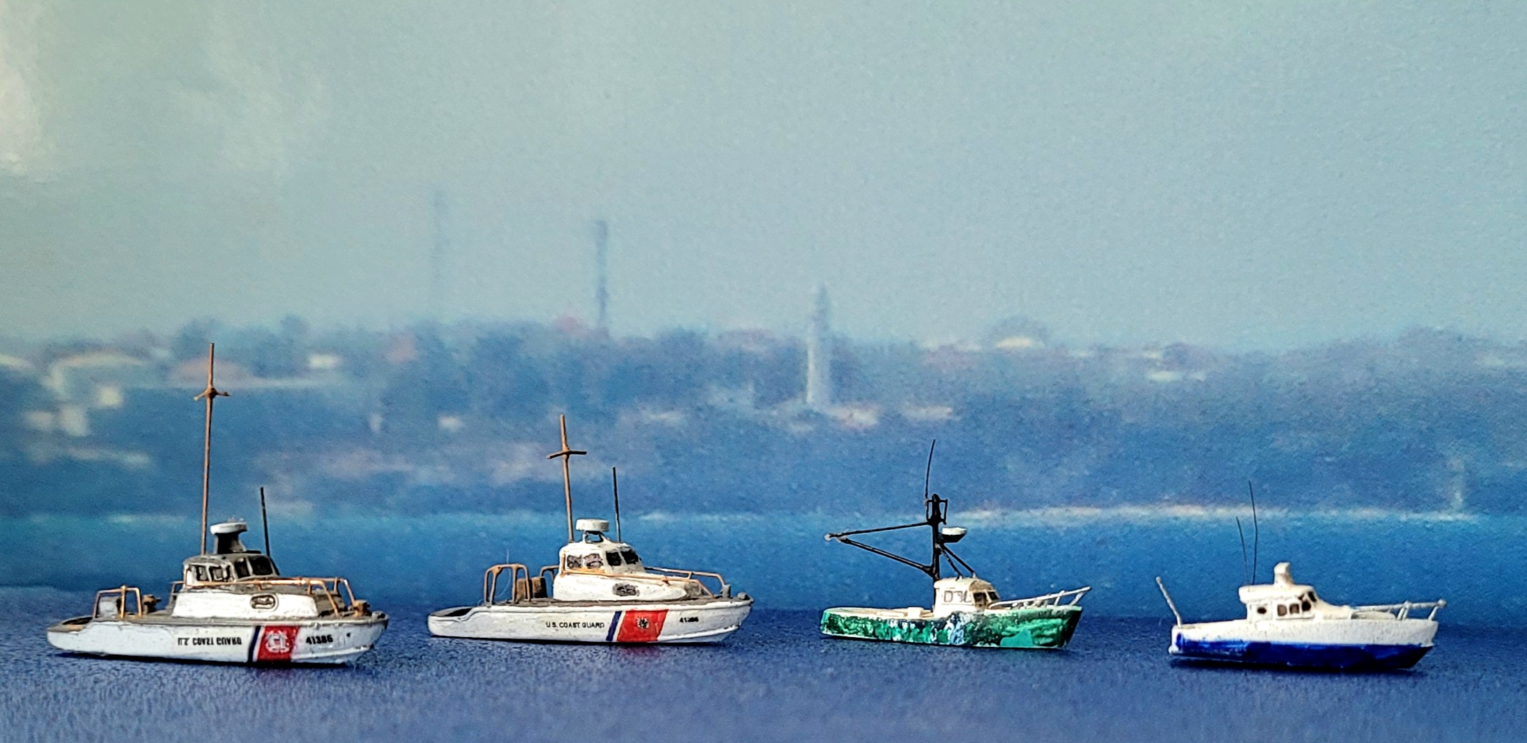

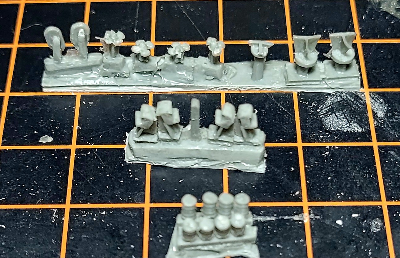

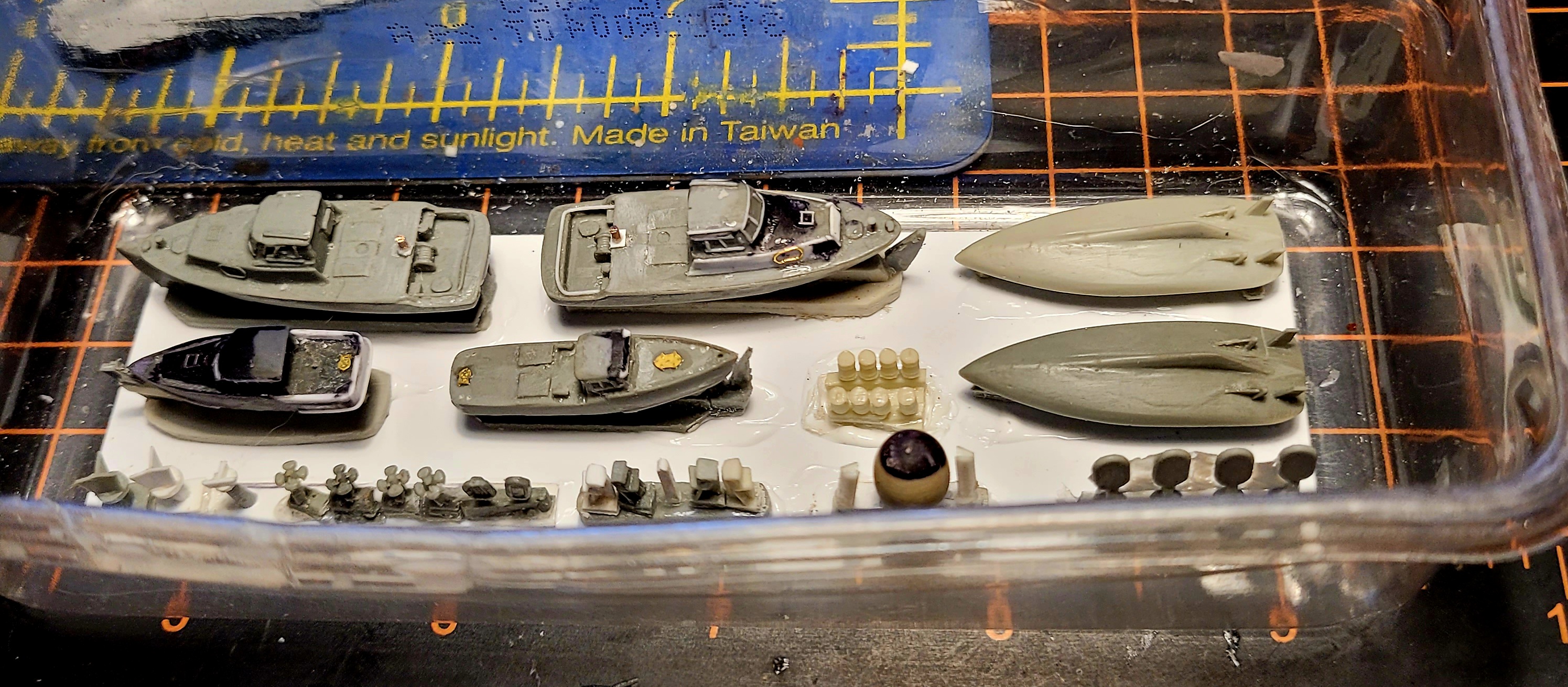

Just 6 years after it's inception, Kit # 218 1/350 USCG 41' UTB Boat set has castings I can be proud of. 2 41's with lower hulls, a Wheeler 25-foot Sport Cruiser, and the speedy 28 foot launch.
Life rafts, props, radars on solid tri-pods, Caterpillar engine intakes, and a set of 1/350 fuel barrels populate the details in the new mold.
The new addition is the Wheeler Yacht company Sport Cruiser. I'm really pleased with her result! Wheeler's also built YMS-1 Minesweepers, Tugs and 83-foot patrol boats for the US Coast Guard during World War II. An updated version of Ernest Hemmingway's 38' Wheeler Yachts boat Pilar is in production in North Carolina as I write.
The 3rd S.S. Minnow was also Wheeler built. A 38' Playmate named "Bluejacket" originally.
Thanks to the Wheeler family and their fine American company for the inspiration!

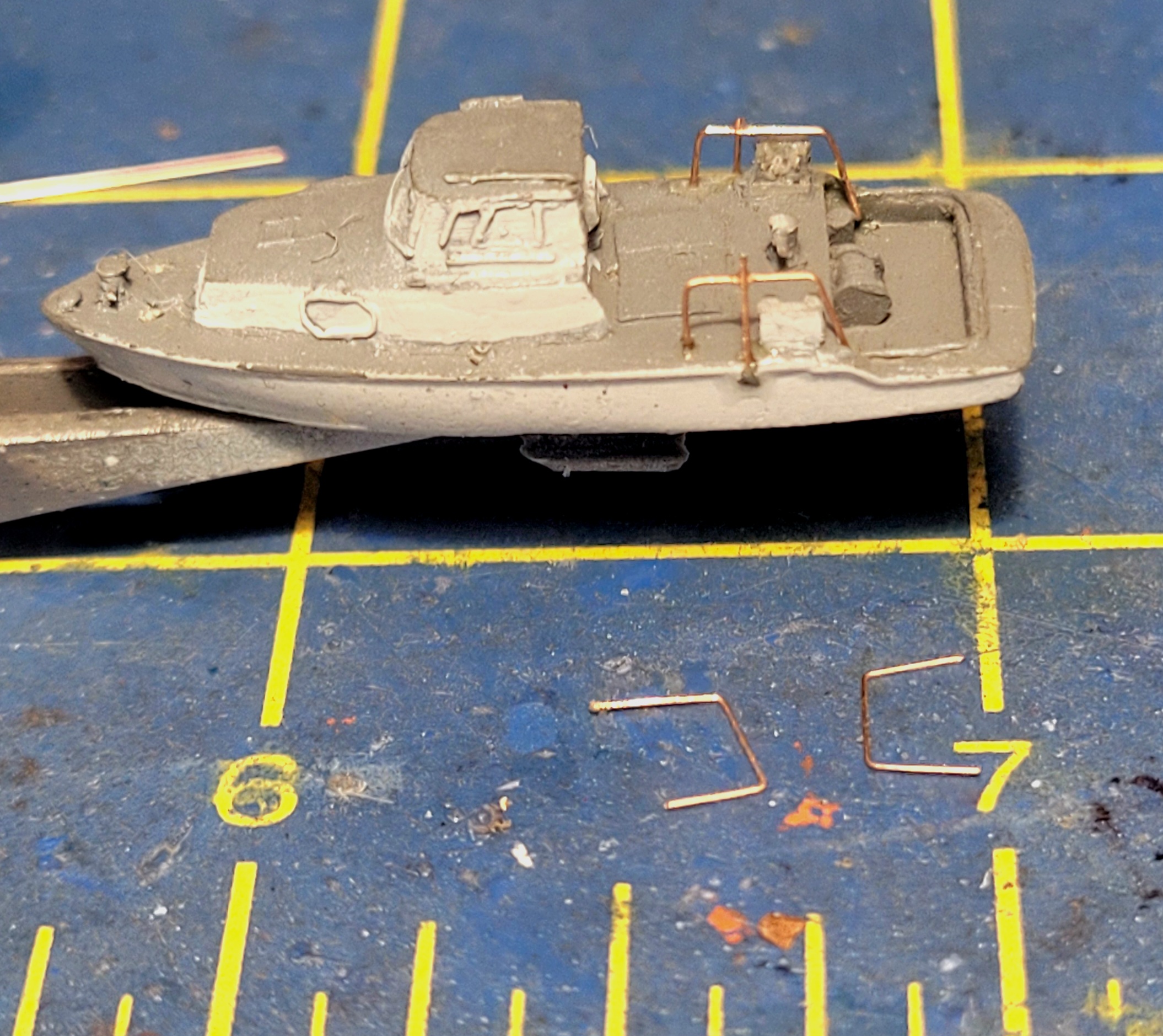

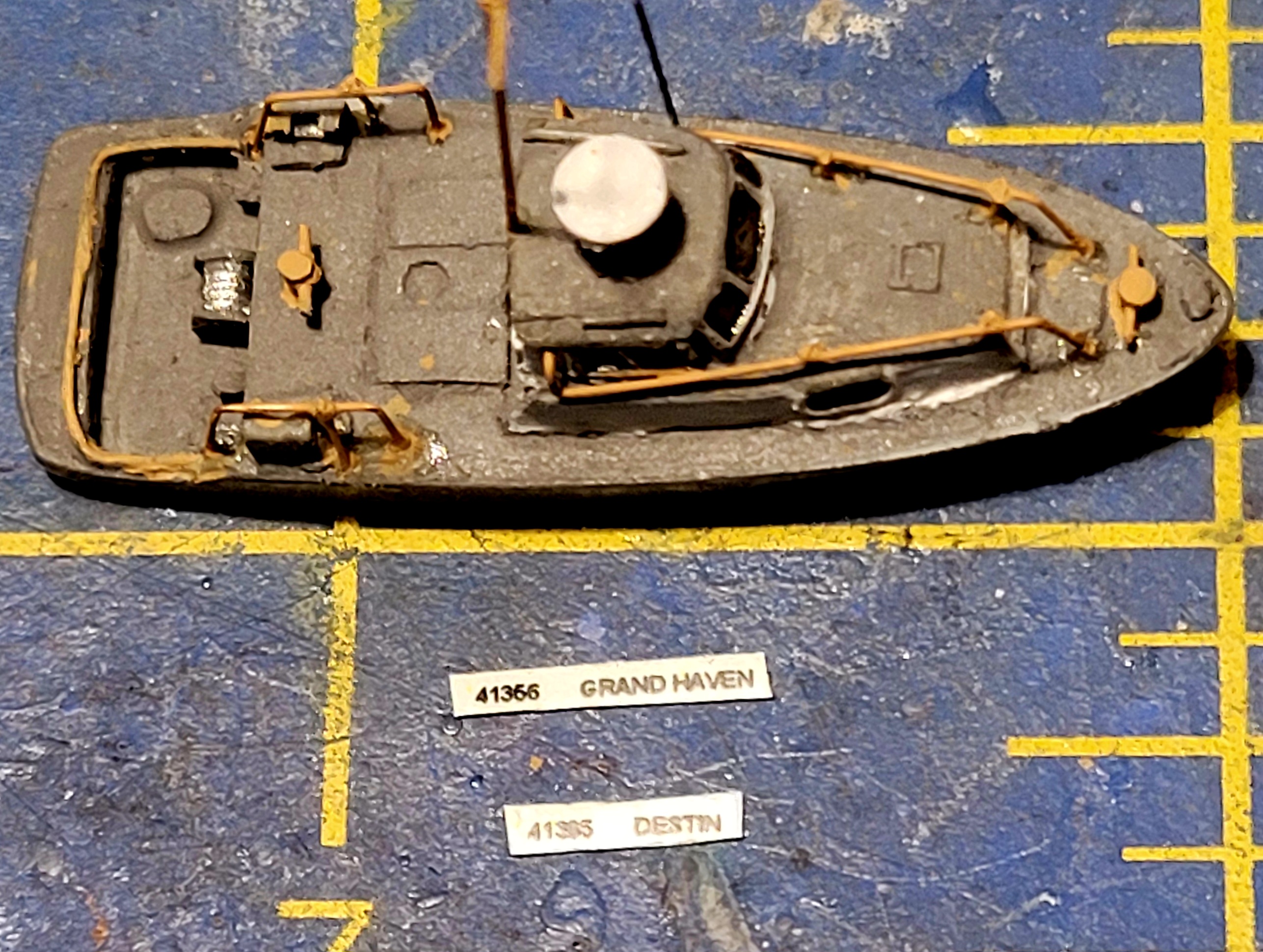

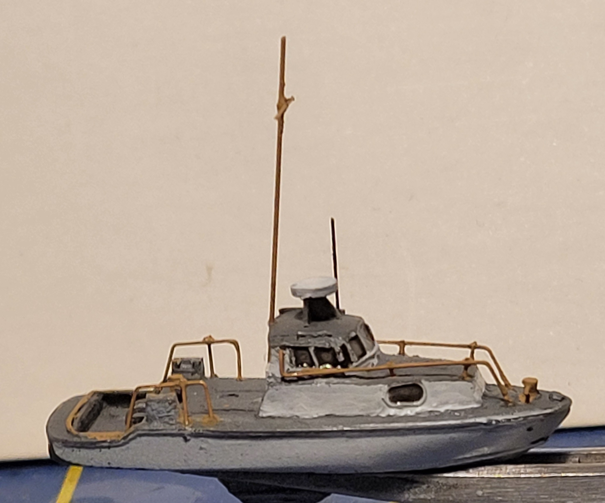

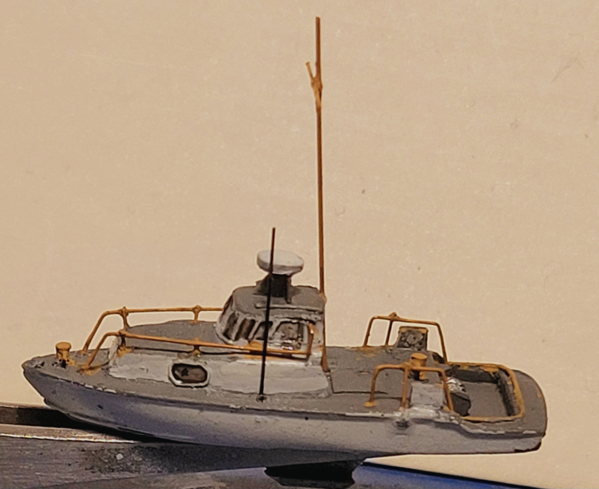

Midship's railings from .008 wire/rod. Building for instructions with tedious measurements and Dork Goggles.

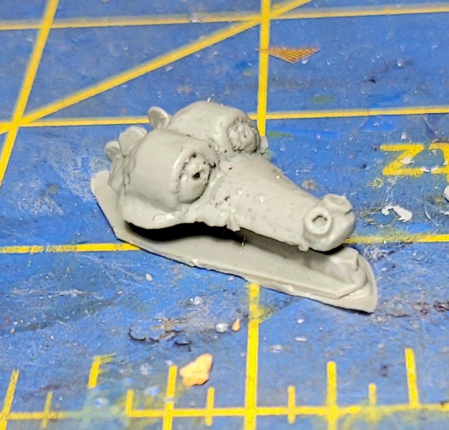

Those Cat intakes I was so proud of? Yeah, way too tall. BFA!!

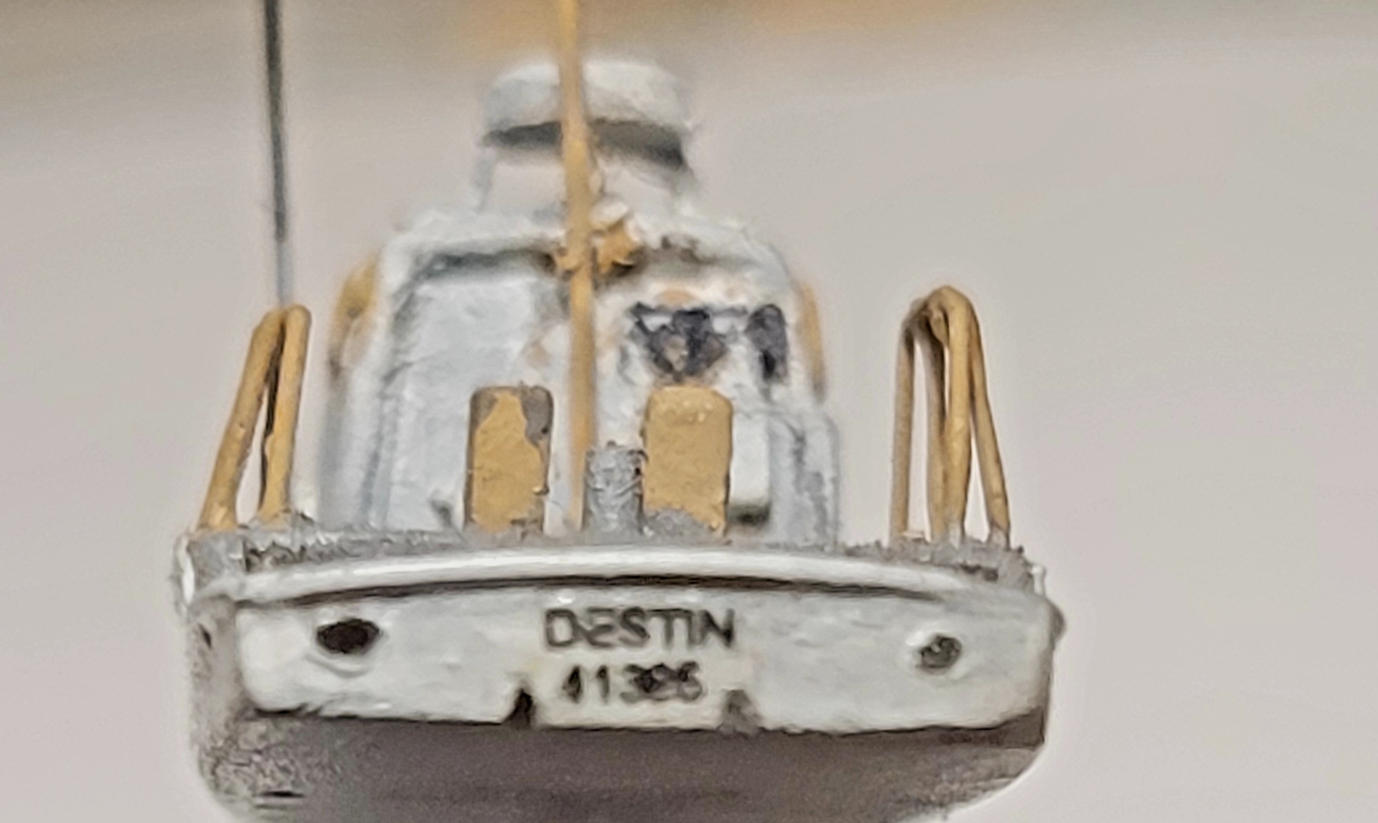

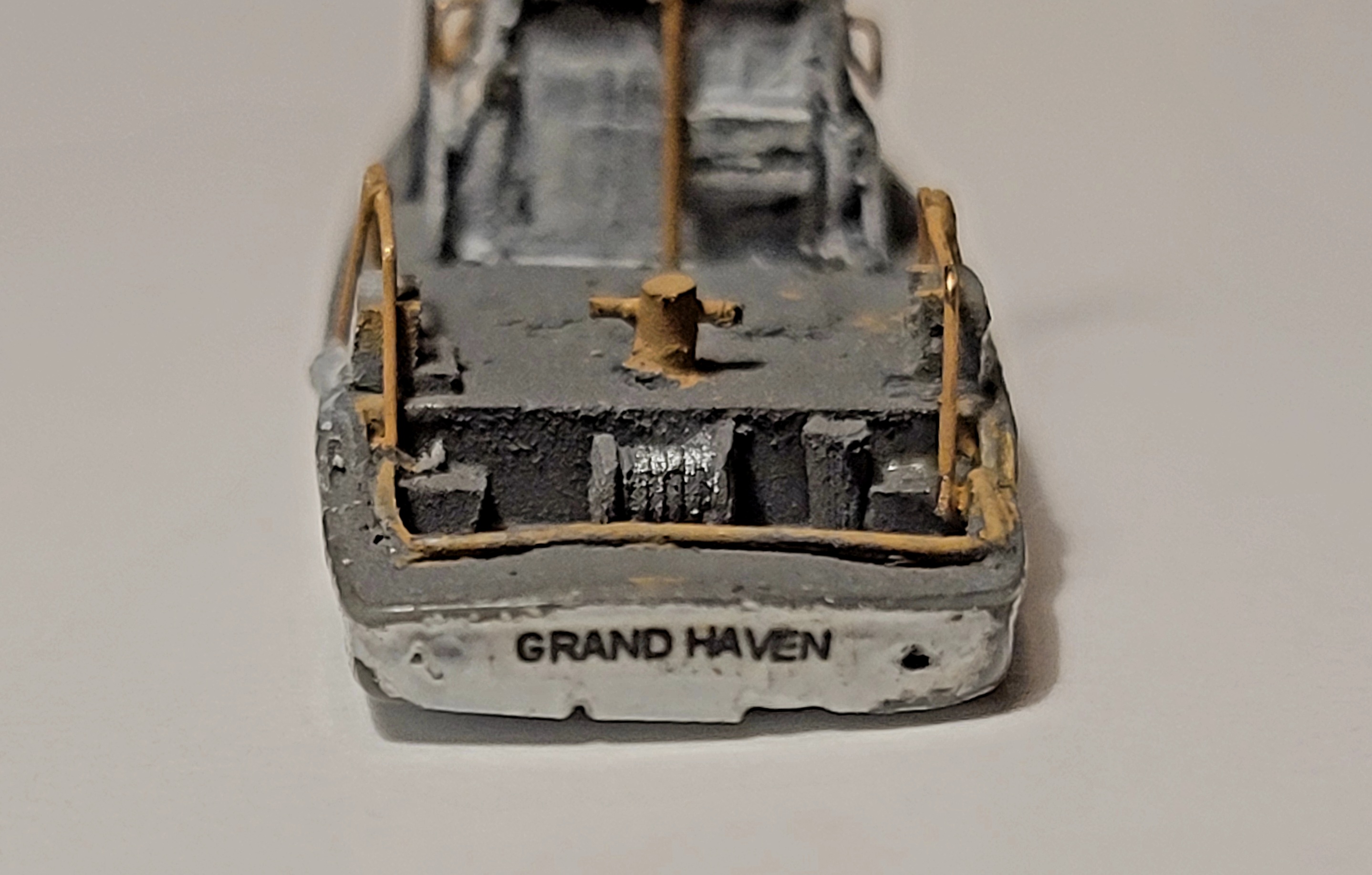

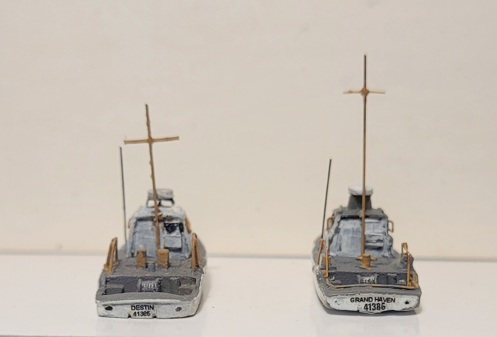

Decals. I chose Destin and Grand Haven for good reasons.

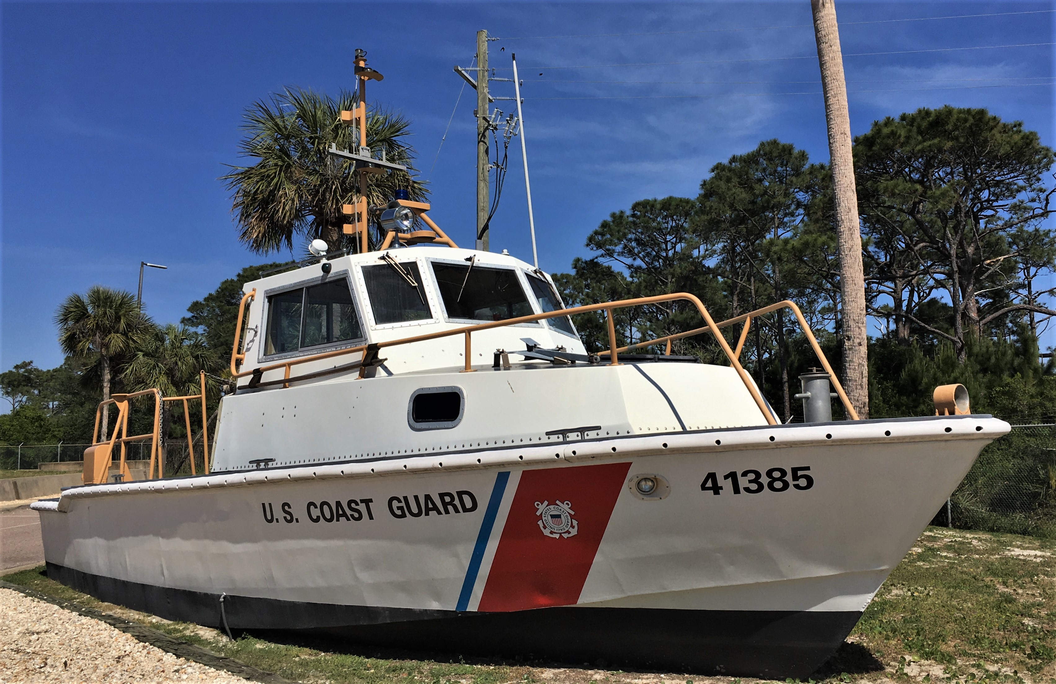

US Coast Guard Station Destin Florida is where I stopped to take pictures of their 41 UTB gate guardian.
US Coast Guard Station Grand Haven Michigan is where the last 41-footer was decommissioned from USCG service in 2014.
Oddly enough, the final 41' boat was 41414, from Muskegon.
Coast Guard vessels under 100 feet LOA are rarely named. The station where each boat was based is on the stern with the 41--- number repeated on either side of the bows forward of the racing stripe.

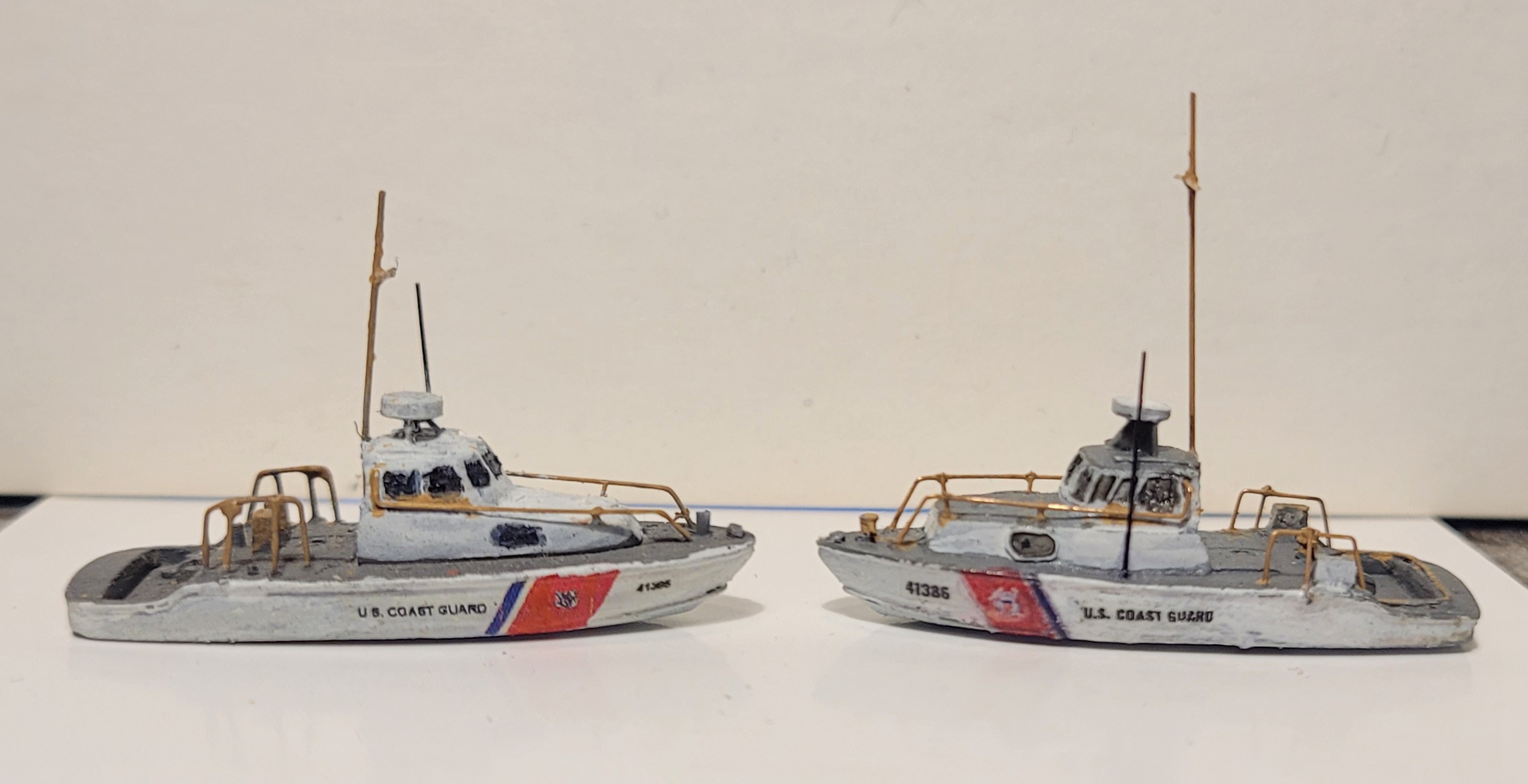

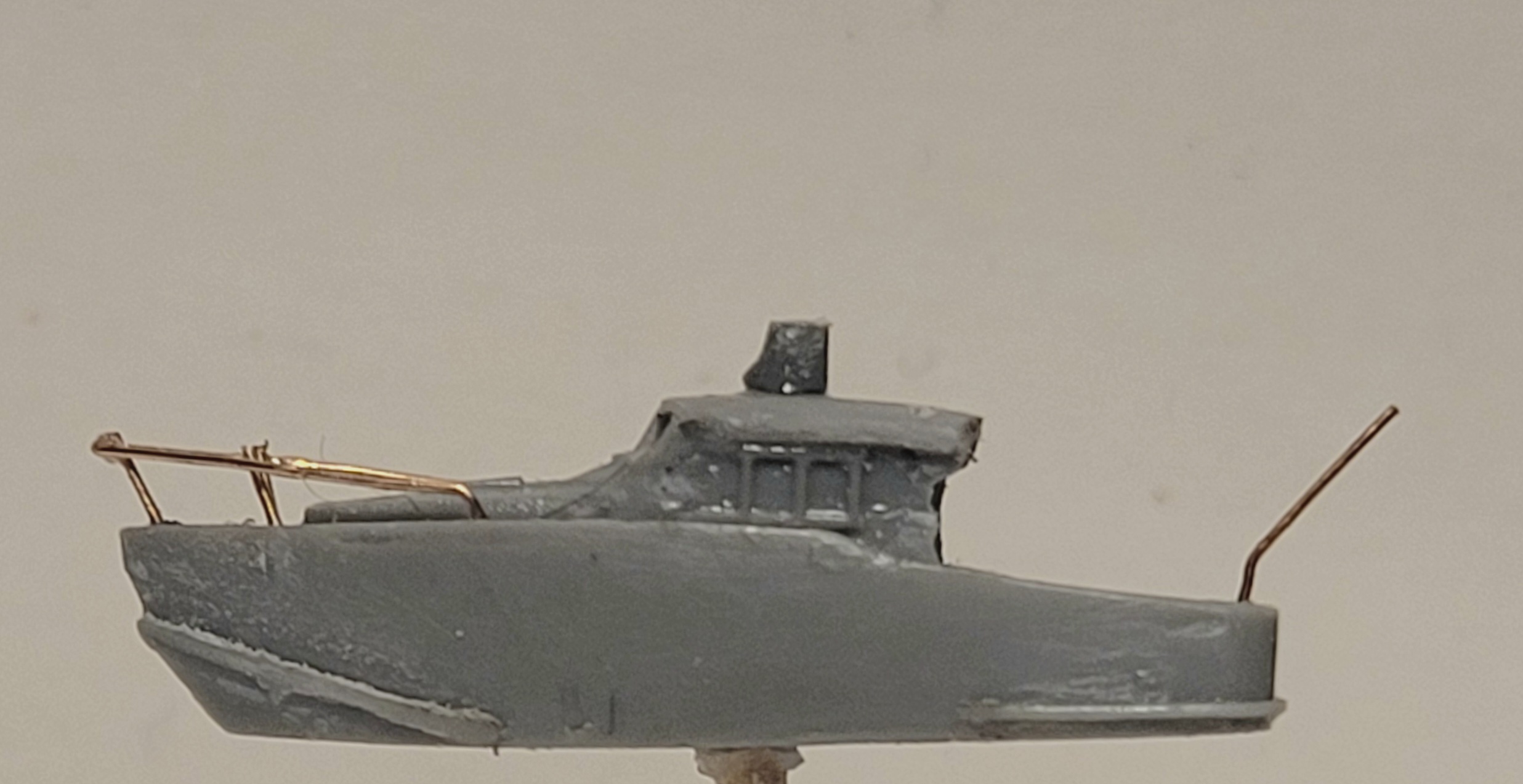

The 1/350 Wheeler 26-foot Sport Cruiser is ready for primer. You can add the bow railing if you wish to. Or Not. The Nav radar pedestal is a hunk of scrap resin.
Thanks again for looking in!

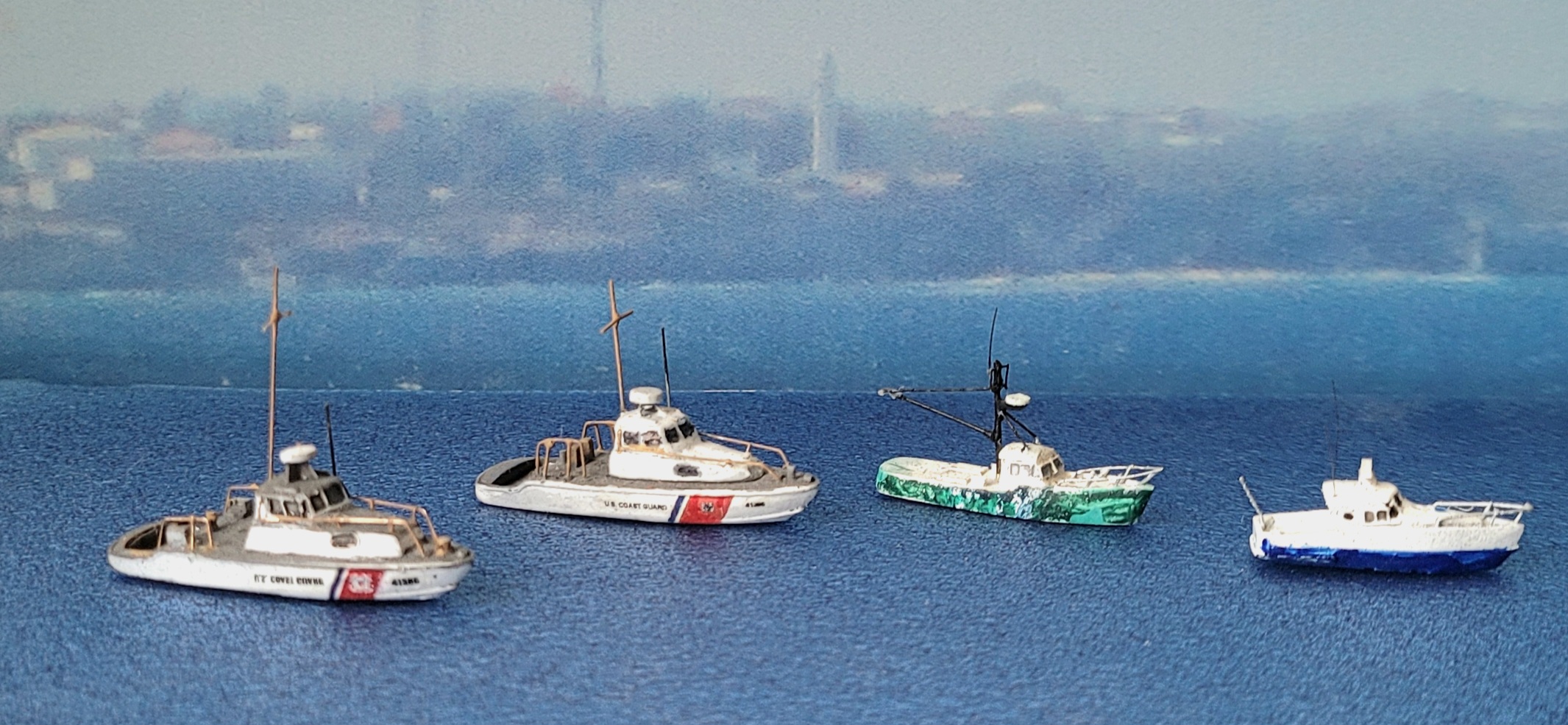

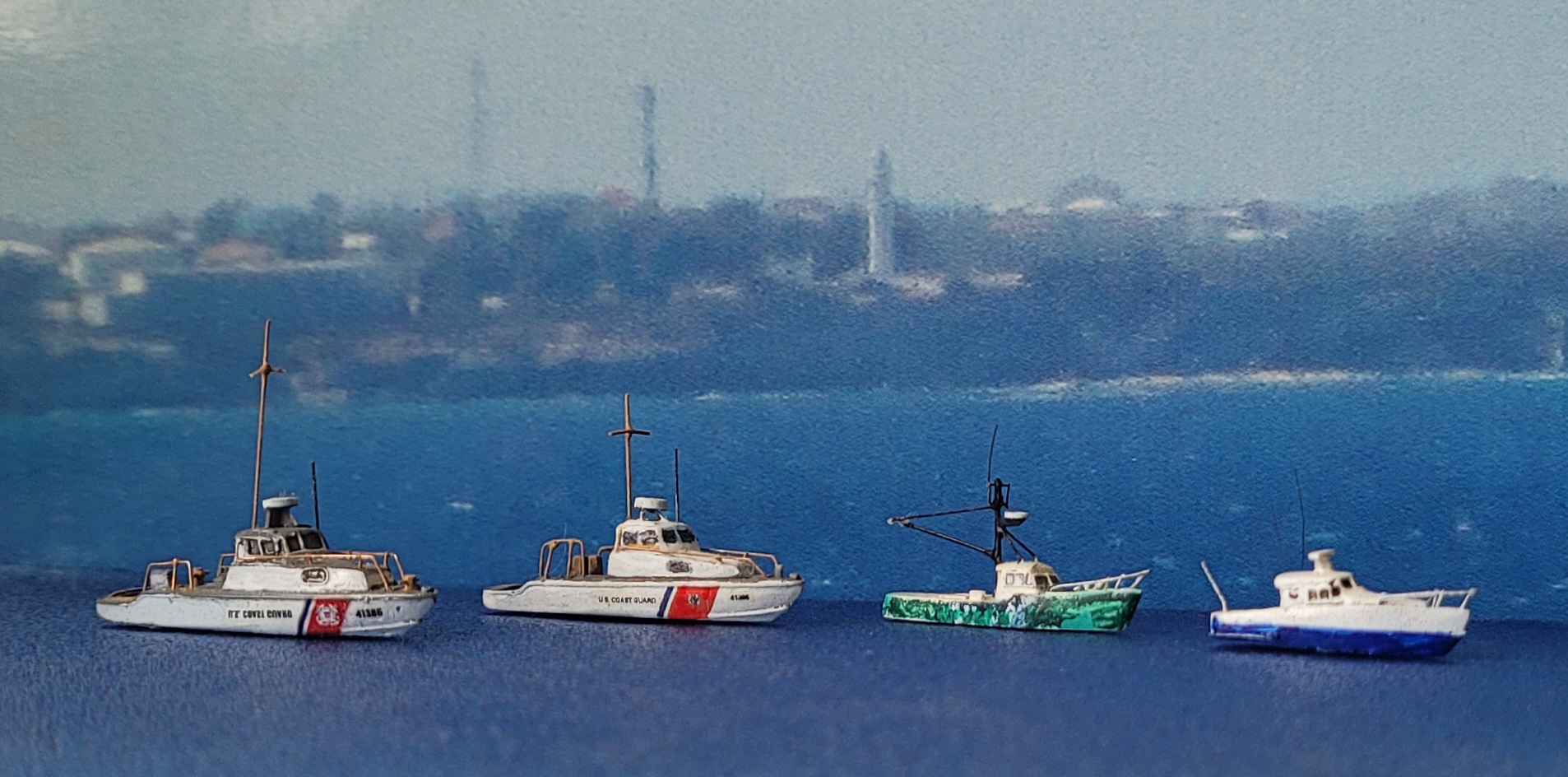

The Cheesiest photo booth on the Prairie was up today. Box art photos for TLAR Models #218. 1/350 US Coast Guard 41 UTB set. I haven't made up my mind which ones to use yet.
