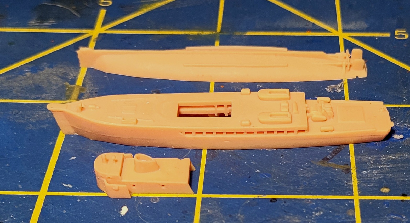

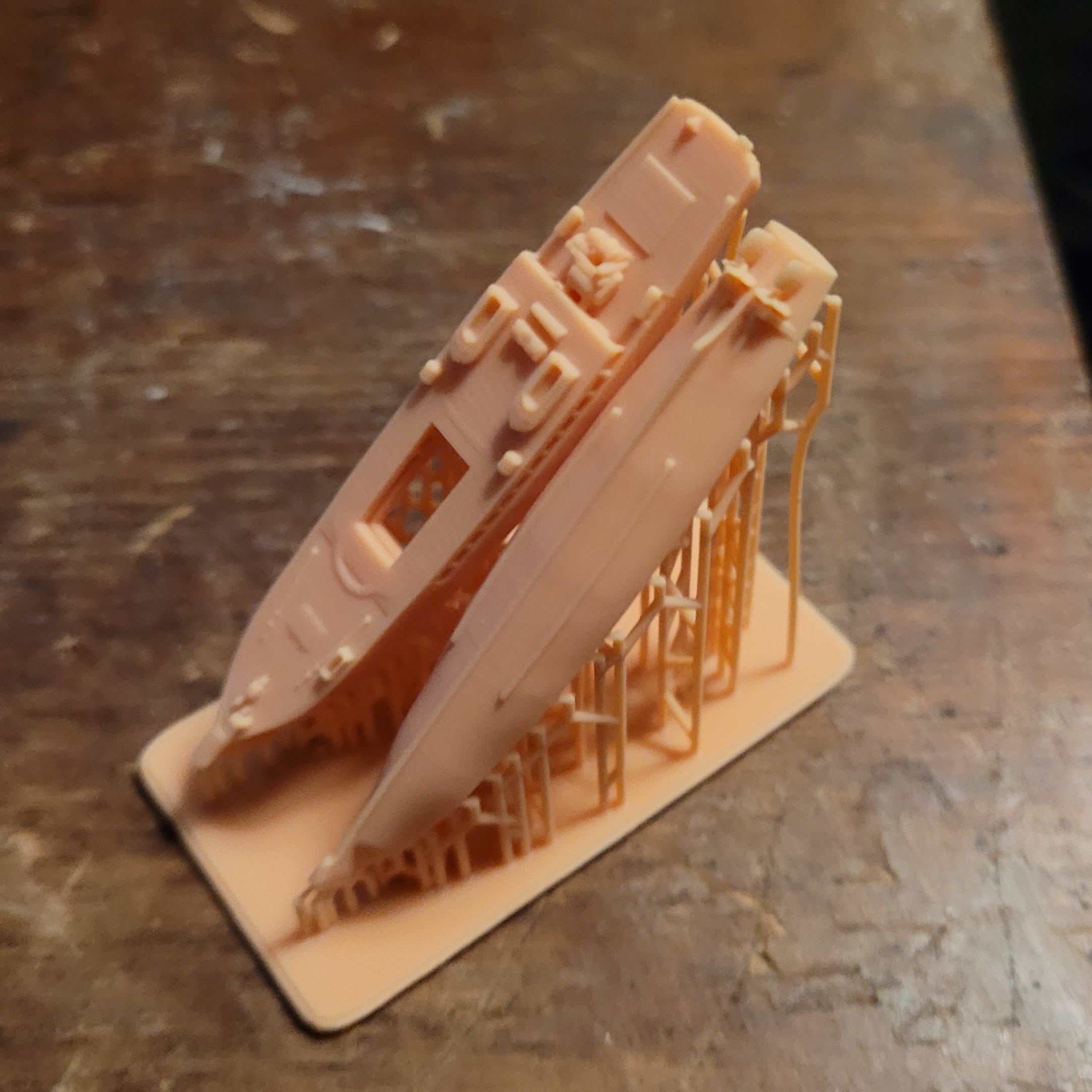

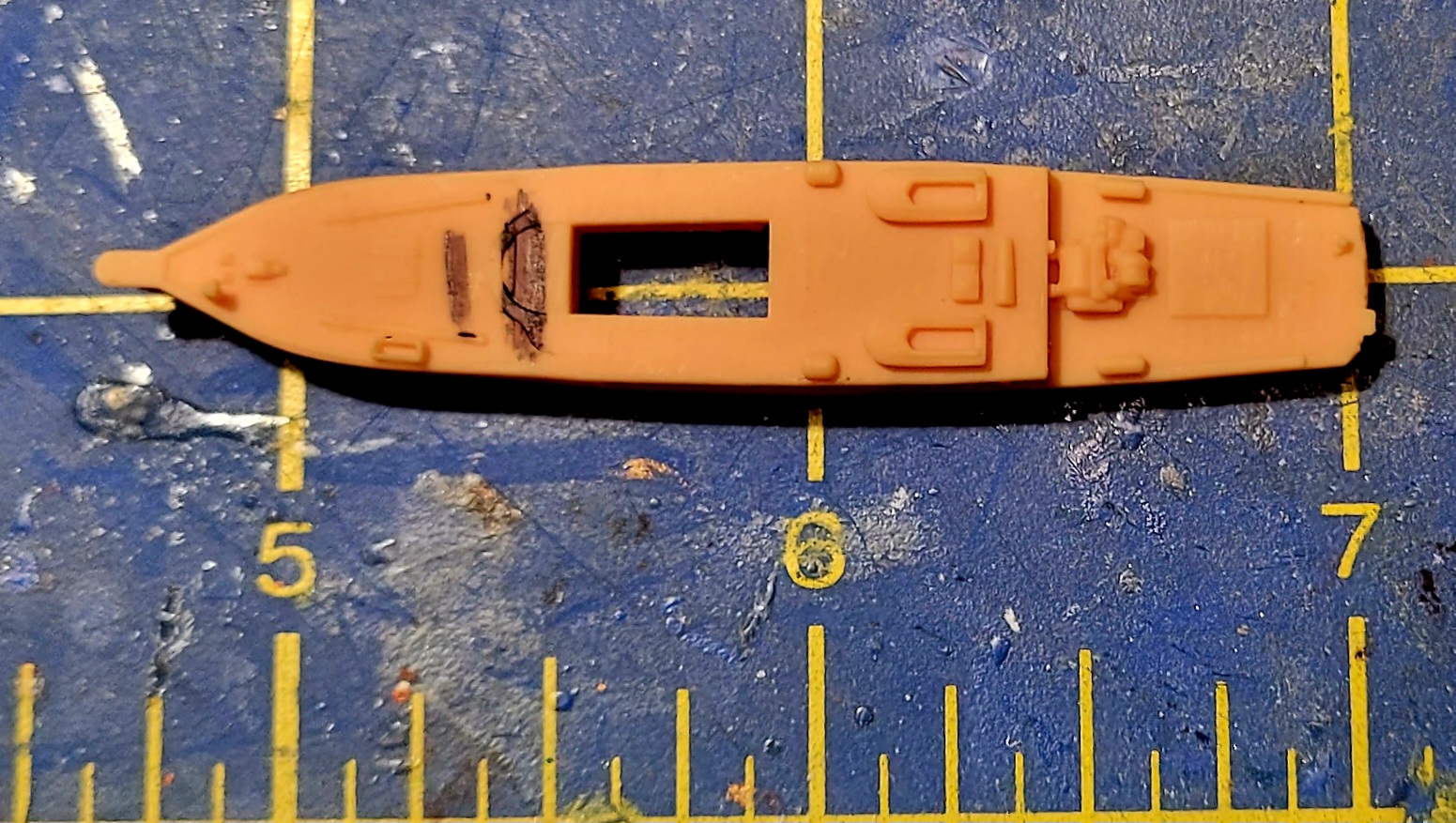

The 3D print looks tantalizing, No?! Length Over All is on the money. The beam dimension is correct. The lower hull doesn't look too bad. The forward goalpost mast is intricate and interesting! Neat-o rotor print!
Now look closer. The bridge is cool, but just plain wrong. Calypso's stack is aft of the bridge not on top of the pilothouse. The main hull is 28 scale inches (.040 inches) too short from waterline to main deck, The stern is undershot, where Calypso's stern was pendicular, the boats face the wrong way and are awful. The aft hatch is off center and neither hatch is tall enough.

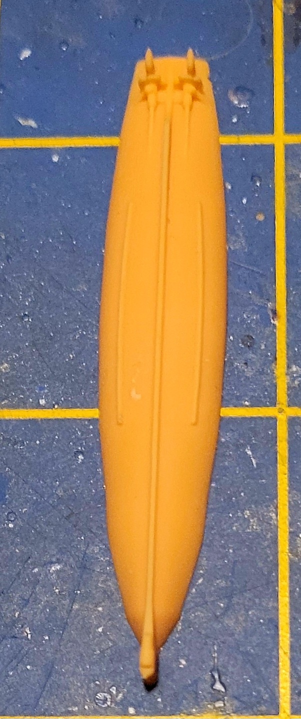

Have a look at the picture of the lower hull. See the fluting of the waterline where it scallops and peaks? Notice the underwater observation ball at the bow is missing? This was a research feature, not a bulbous bow to influence the ol' minesweeper's hydrodynamics, as she blazed along at her designed top speed of 15 knots. (running with the tide, with the wind on her stern) The printed resin is unforgiving and brittle.

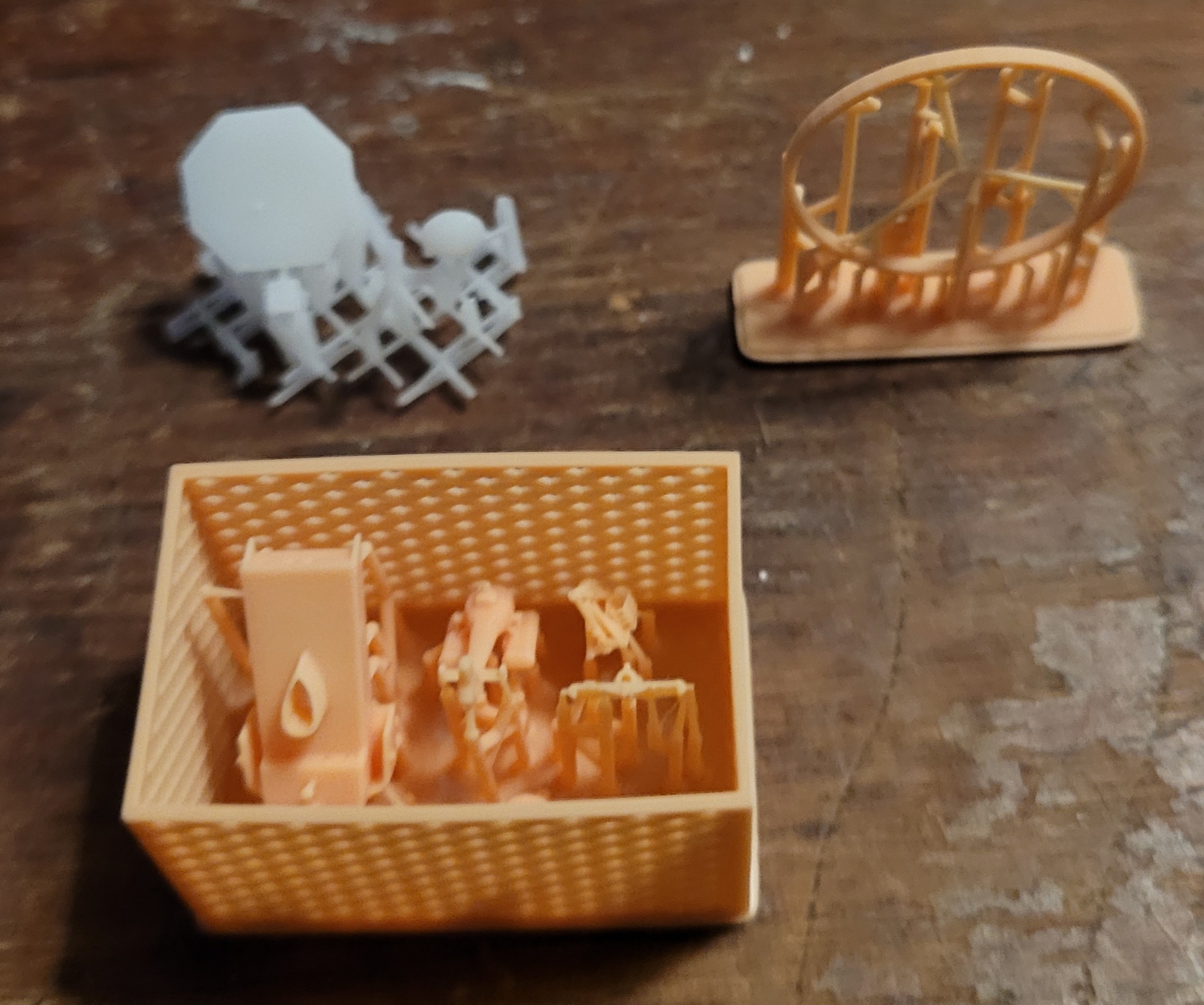

Look closely at the other small parts. The helicopter pad is not the right shape. Calypso carried a Hughes 300D helicopter on floats rather than an SA341 Gazelle on those long john donut lookin' things. The helipad wouldn't support the weight of a heavier Helo. There is no provision for mounting the helipad. The diving saucer lacks detail. Neither of my kits contained instructions or any decals.

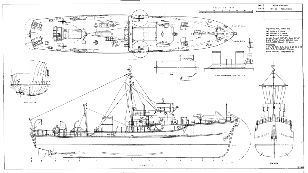

It could be less trouble to find plans and start from scratch.
