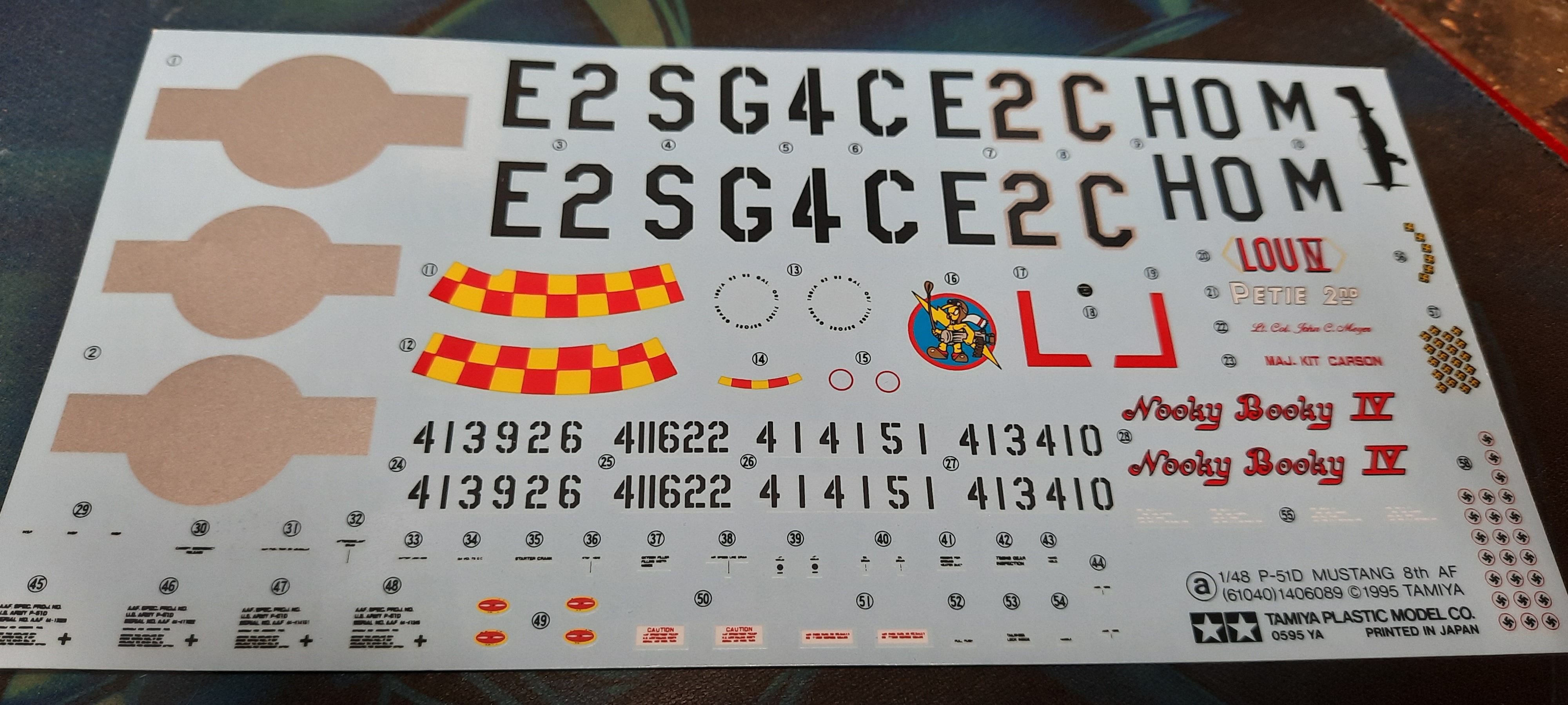

The paint has cured for about four days. I sprayed a coat of Future on top. and it dried for a couple days while I finished up the Warthog. I can't explain it either. 3 year old Griffin can't talk so he can't tell me LOL. While I have you here...you read how I had the finish prepared for decals. When I tried to use Tamiya Markfit, the solution beaded up like crazy. So, I thought that Microscale Microset would work better. It beaded up as well. I used Vallejo Decal Set and it worked beautifully, It's a little more of a cream than a clear liquid. "Should" those other two have beaded up? Should I use something else to prepare for decals than Future? Should I give up trying to apply decals and send it to you to do it for me? It drives me nuts how much decals hate me.

Microset almost always beads up on a good gloss surface, MicroSol softens the decal and should go on top, not underneath. I have sanded gloss surfaces with 2500 sandpaper and the MicroSet flows out better.

Great! Yeah, I put the solvent on top. I use the set solution underneath AND on top and let it dry for a few minutes then put the solvent on. Is that correct?

I think the Micro SET solution is a wetting agent with a little bit of a bonder. The Micro SOL solution is what softens the decals.
I personally like Solvaset. It is a little hotter than the Micro brand and can do a number on thin decals if you are not careful. I will mix it about 50/50 with water for under the decal, and then once the decal is placed, I have used my airbrush with about 5 psi to lightly spray it on the top. This does 2 things when starting from the center it softens the decal and pushes the water/solution/air bubbles out from underneath. I have done this over dead flat paint with no silvering.

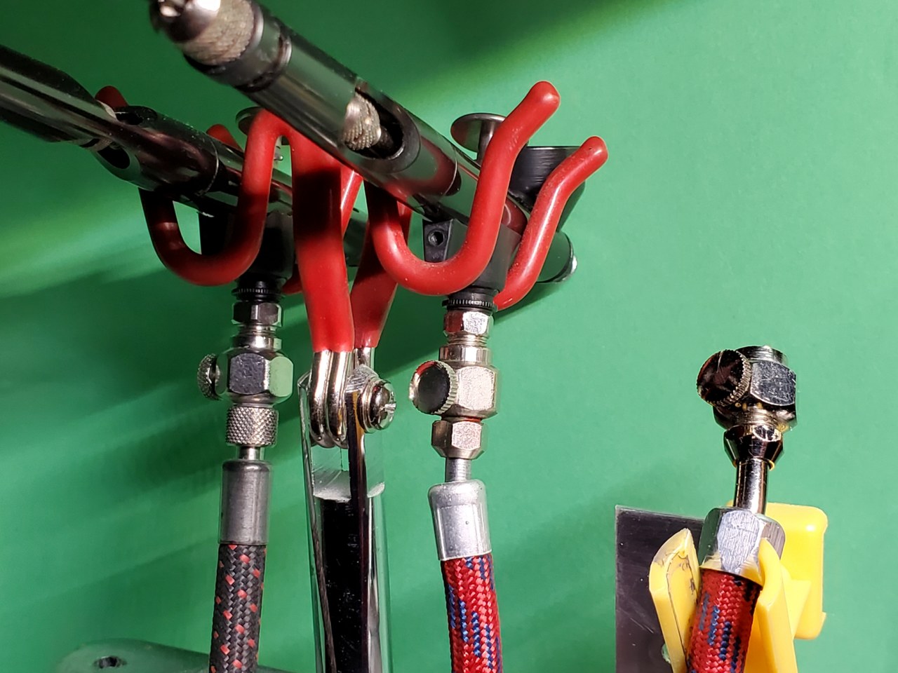

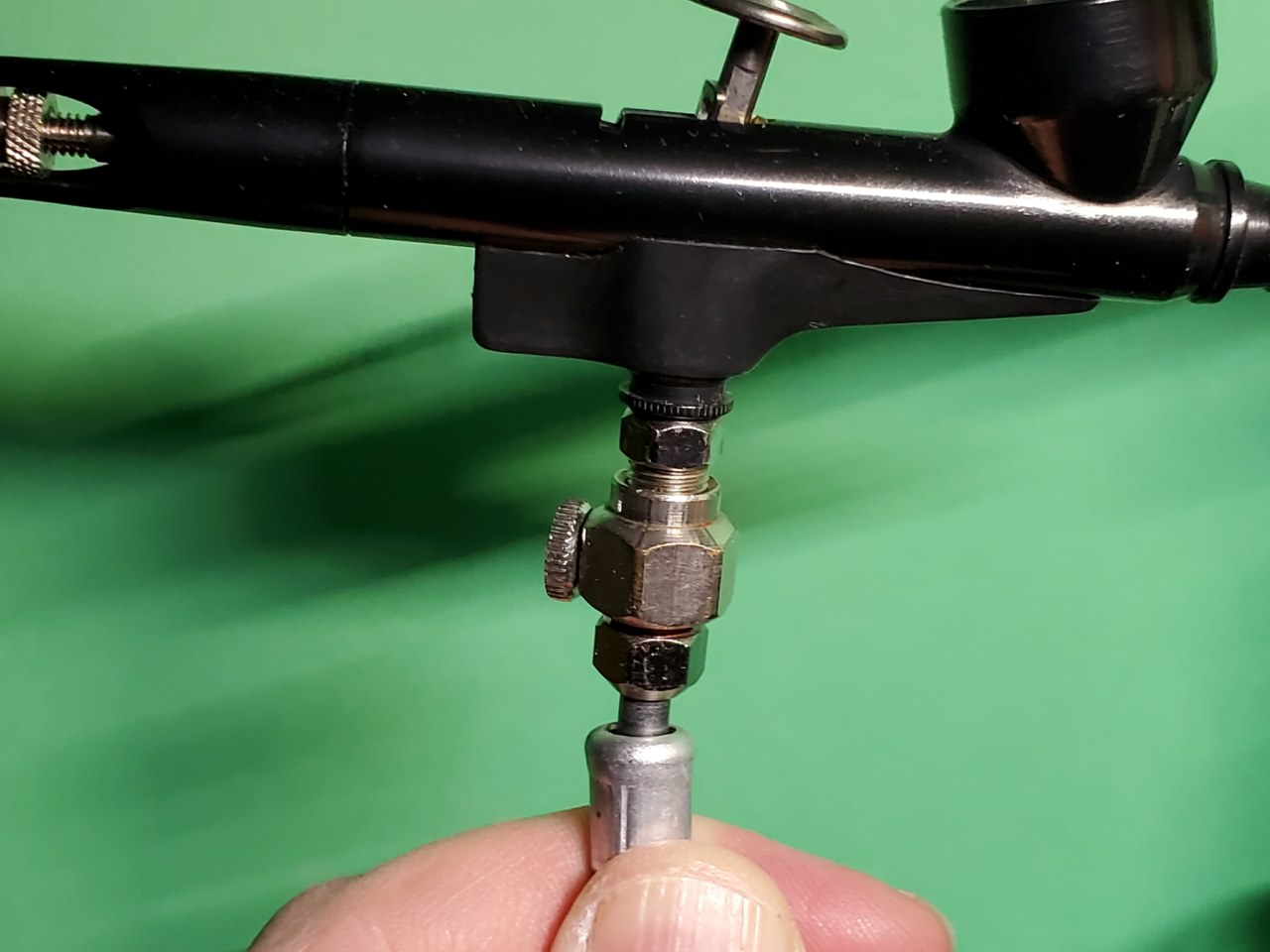

Oh and edit to add this. I also use a needle valve to regulate the air pressure right at the airbrush. Gives a lot more control than just the moisture trap control on the compressor.
I use Badger airbrushes with a Badger/Paasche adapter, Paasche needle valve, and Paasche hoses with a moisture trap about 18 inches from the airbrush.
Hope this helps. The needle valve makes a huge difference even just for spraying paint or much anything else. My regulator is set at I think 25 psi, but the needle valve is where I actually control the air flow.
