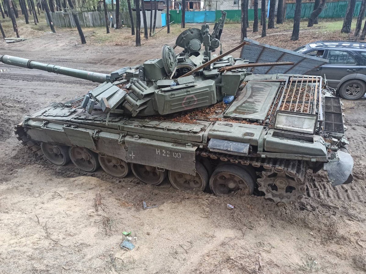

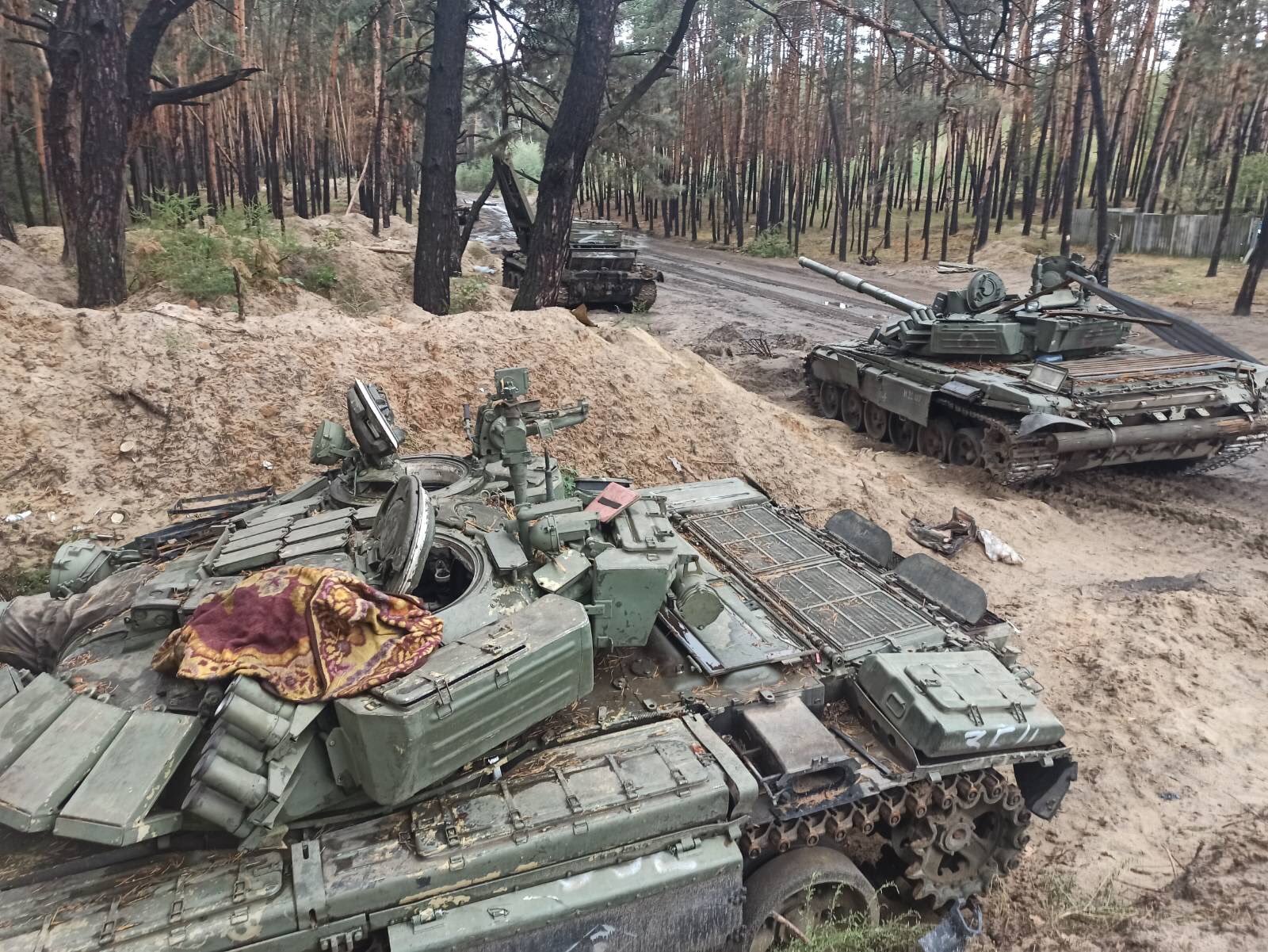

This will be the tank i will use as a ref for the look(though not using the damaged roof grate armour) while adding the fuel drums on the rear. Of particular interest are the added Kontakt-1 bricks attached to the front of the Kontakt-5 angular bricks on the turret front. Also the damaged rubber side panels and stowage, plus dead leaves.

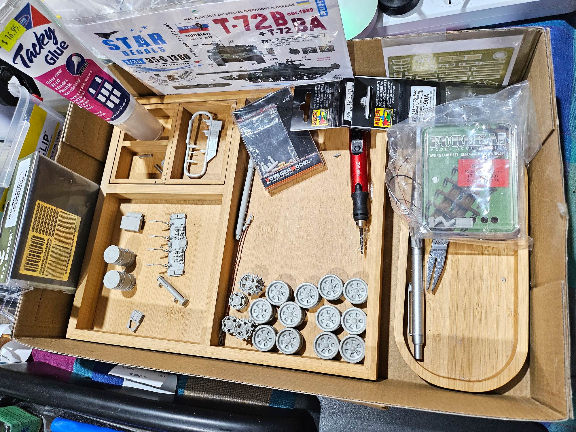

I will use the decals from this Star decals sheet for the BA version.

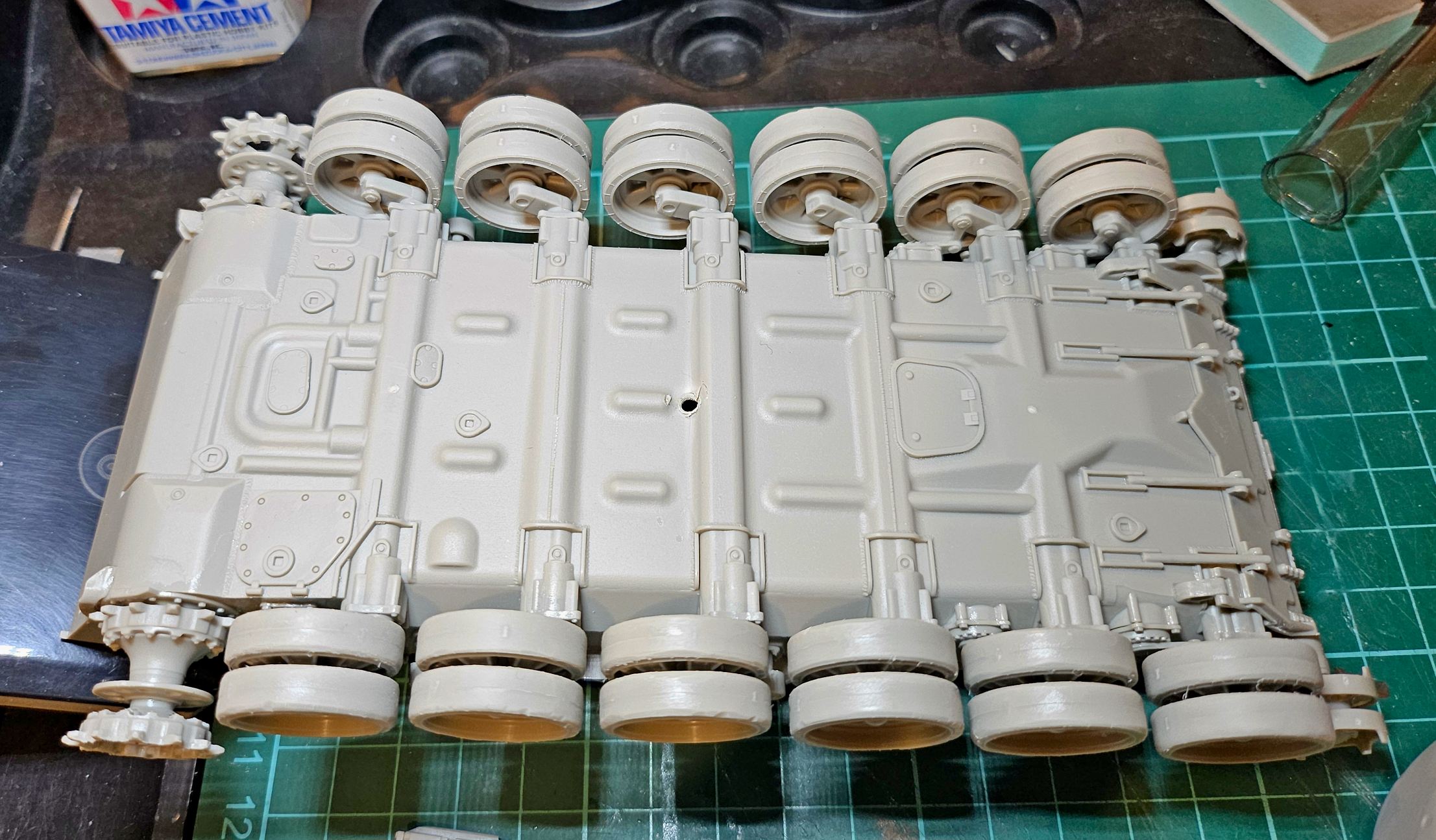

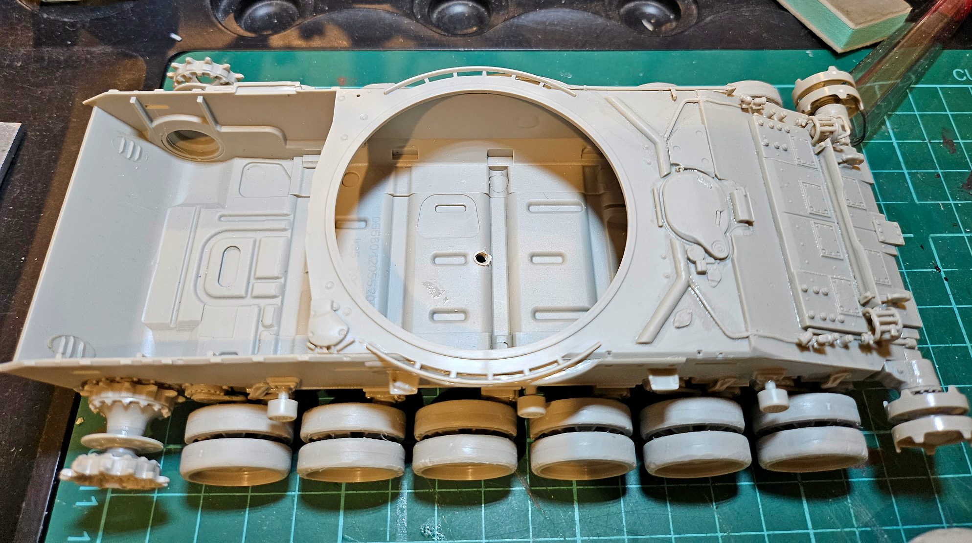

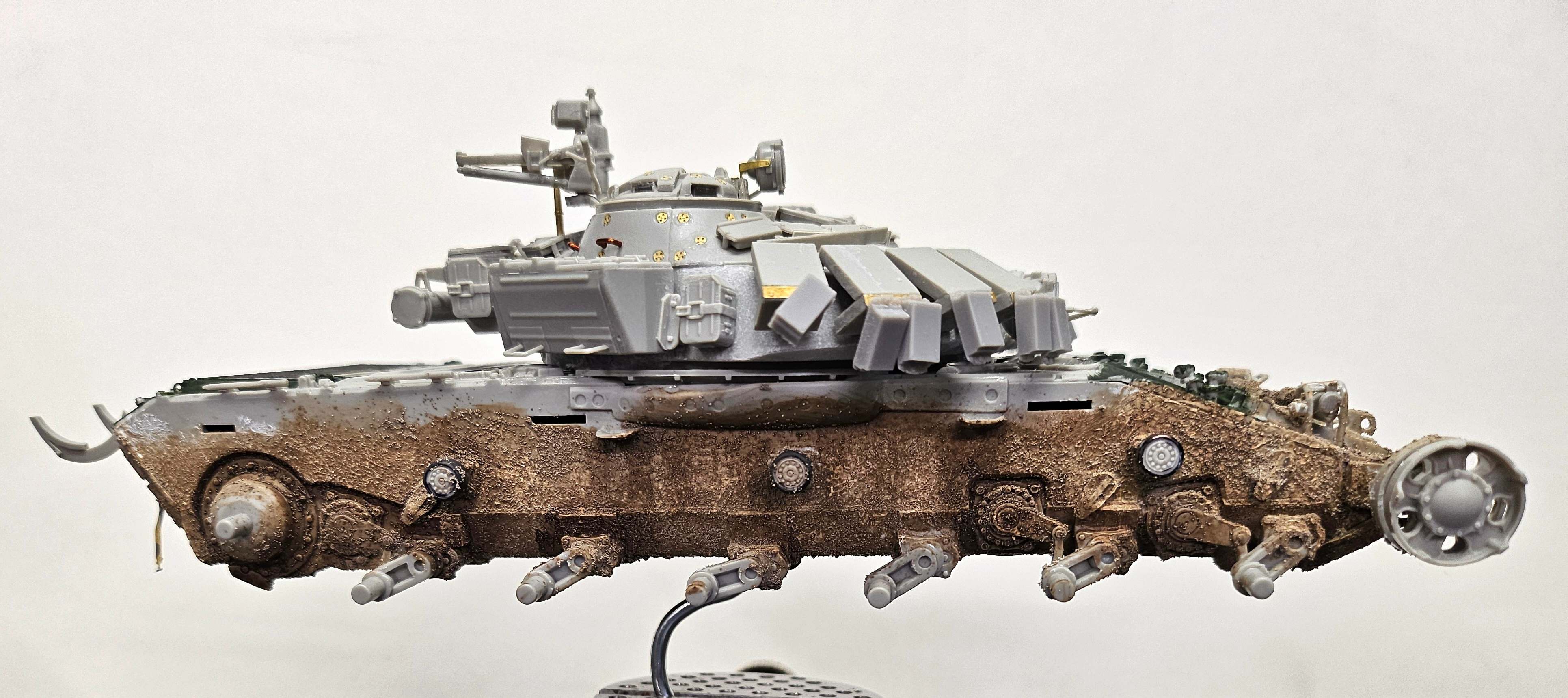

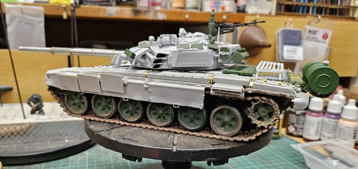

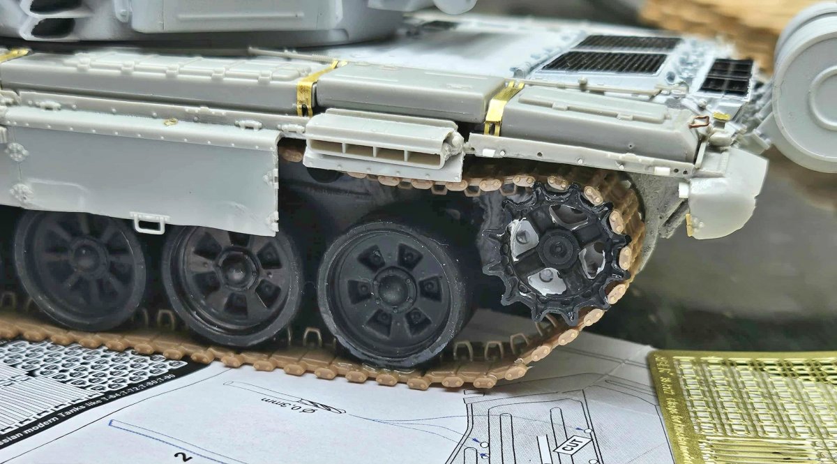

While on holidays i managed to do the wheels, chassis and start on the turret.

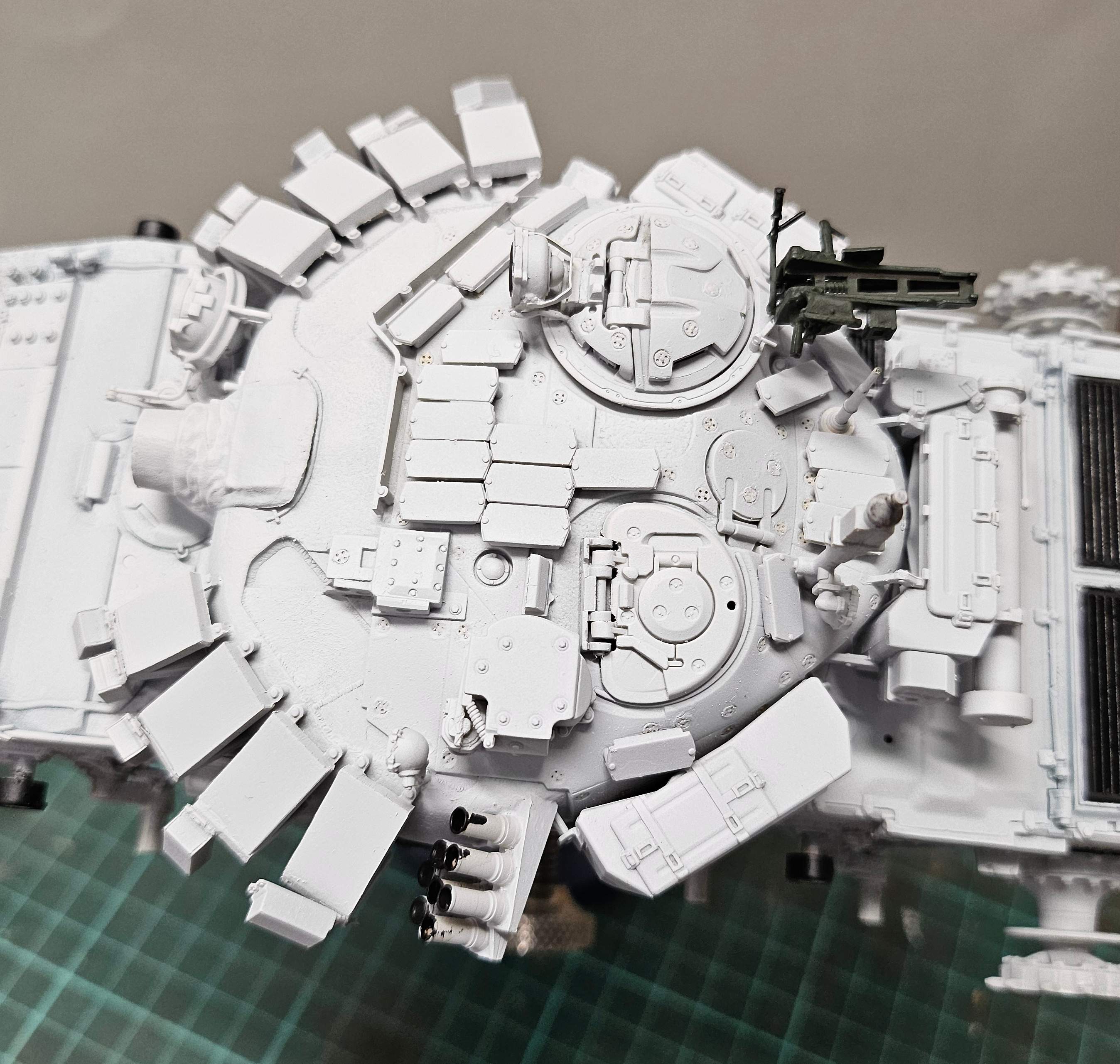

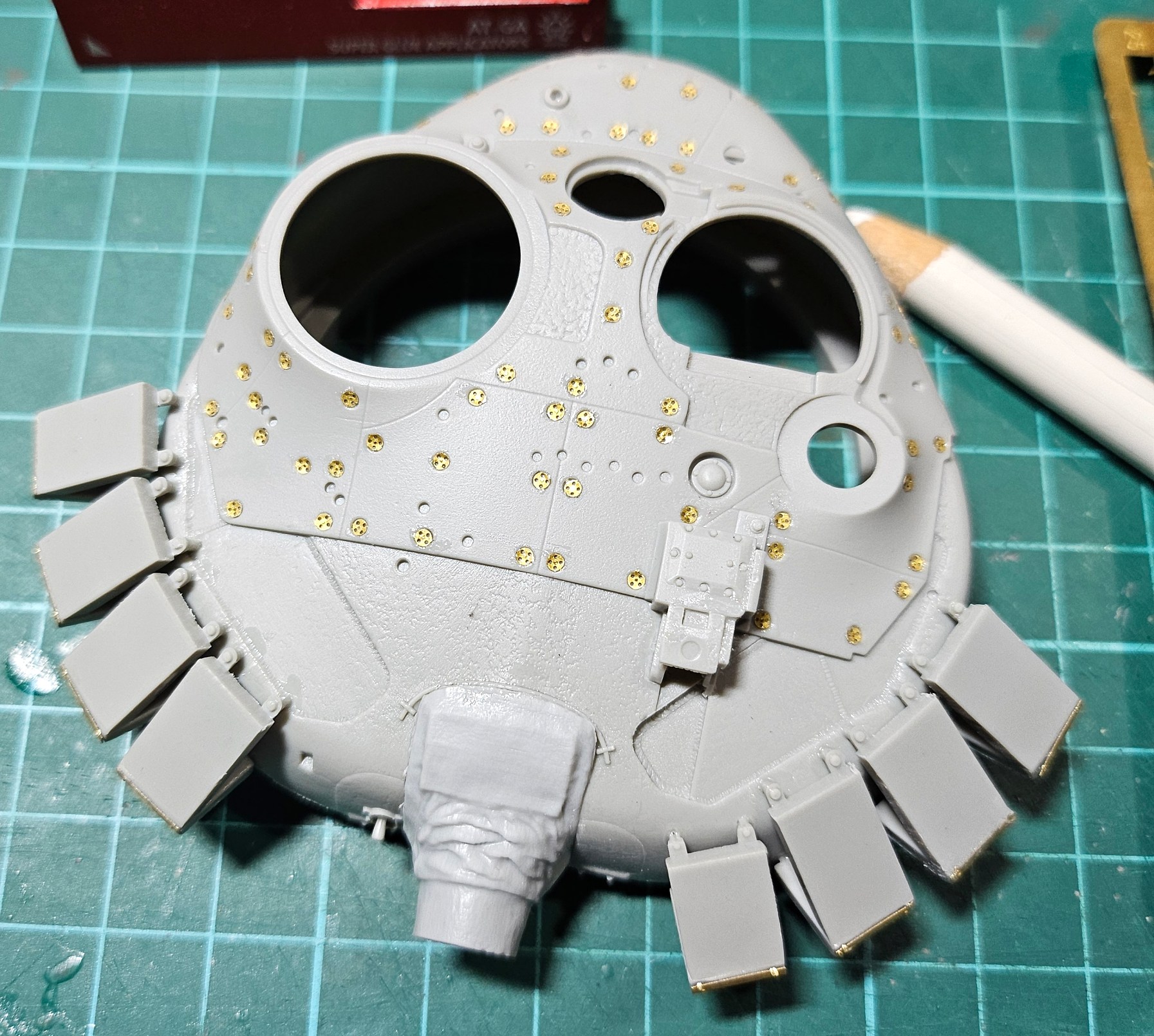

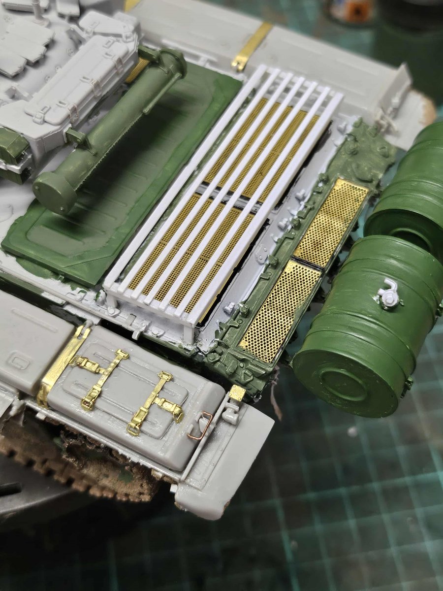

The rubber on the wheels has some mild damage. I am currently getting 'bogged down' on the 94 small circular PE details that have to go all over the anti- radiation layer on the roof top.

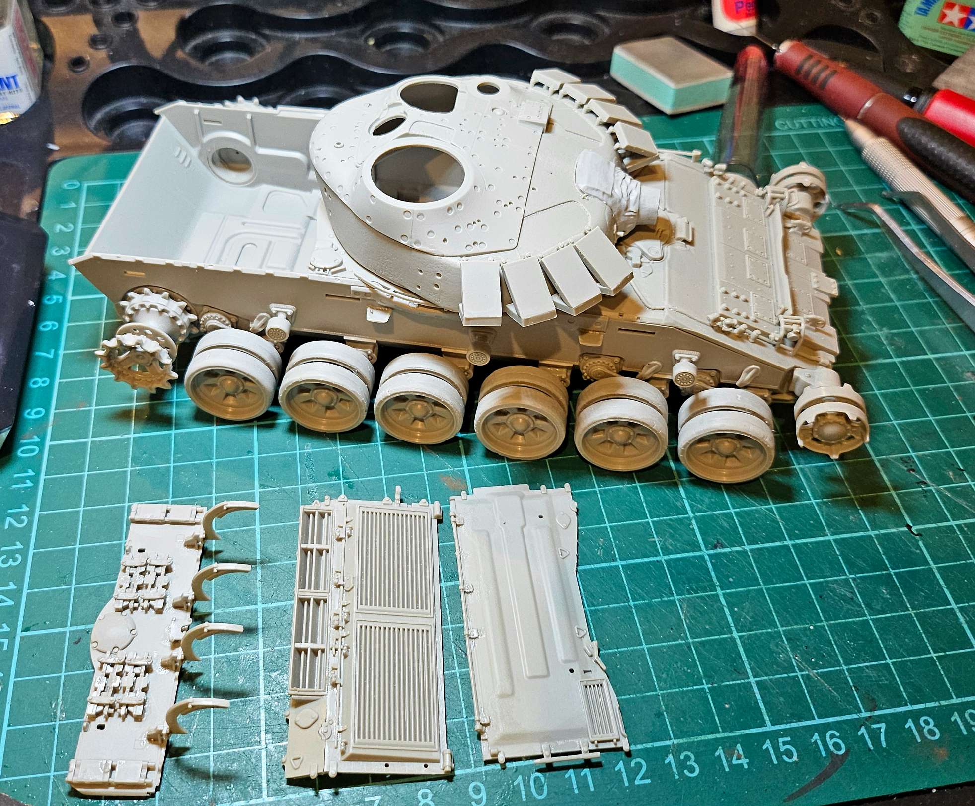

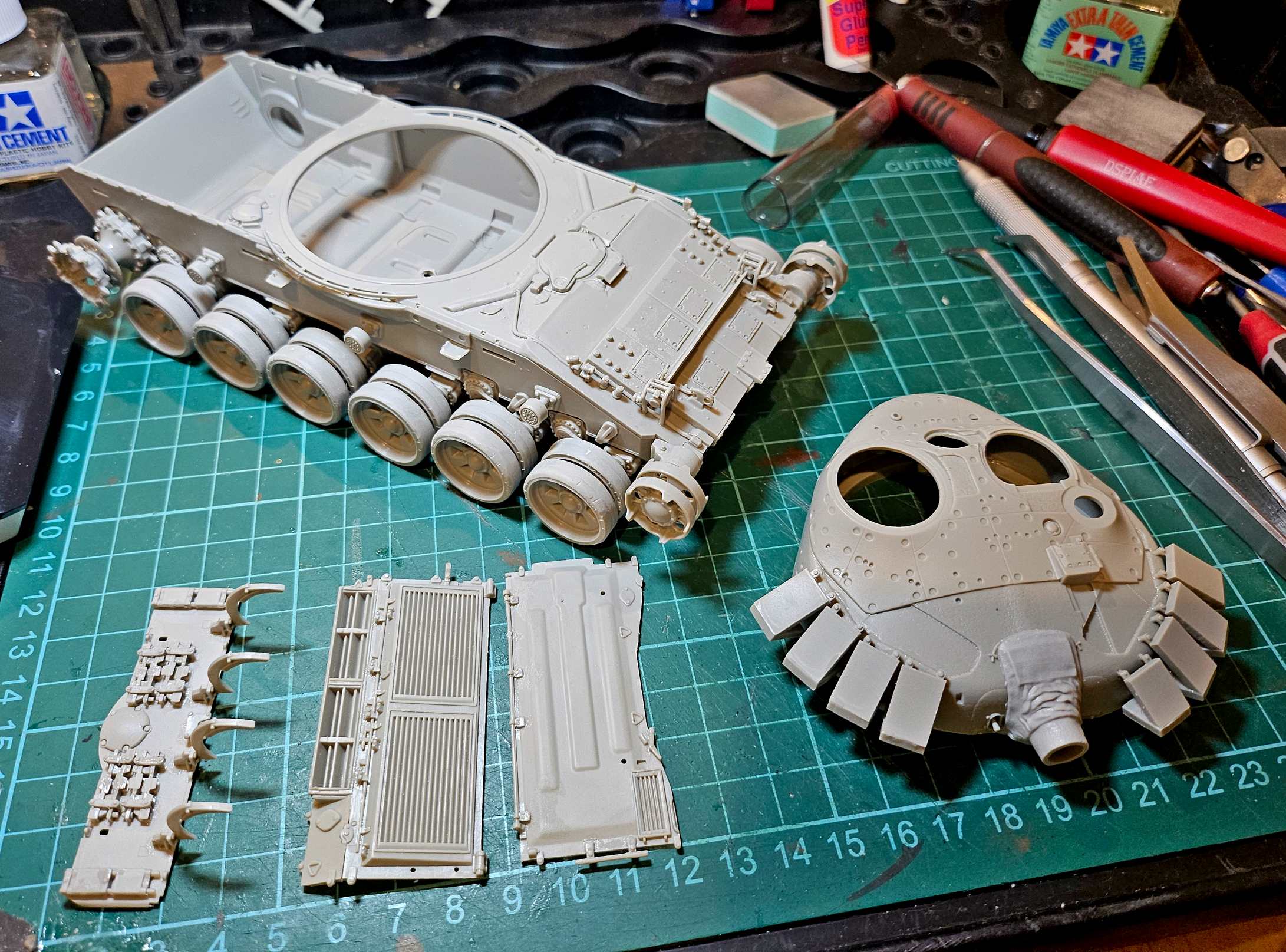

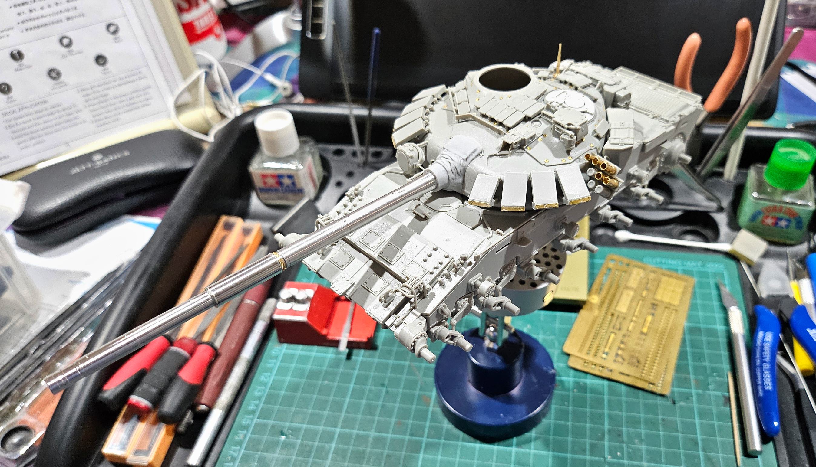

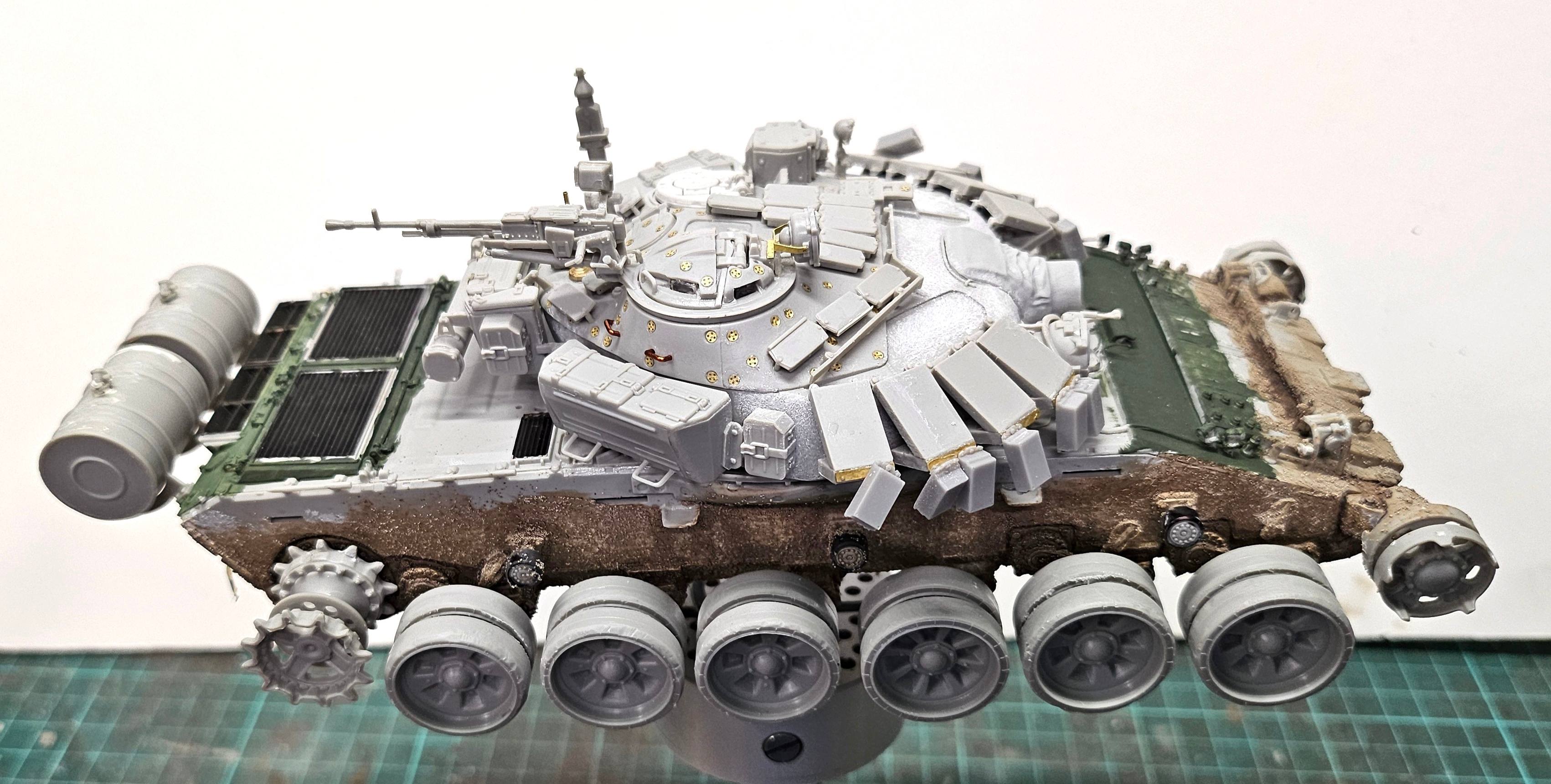

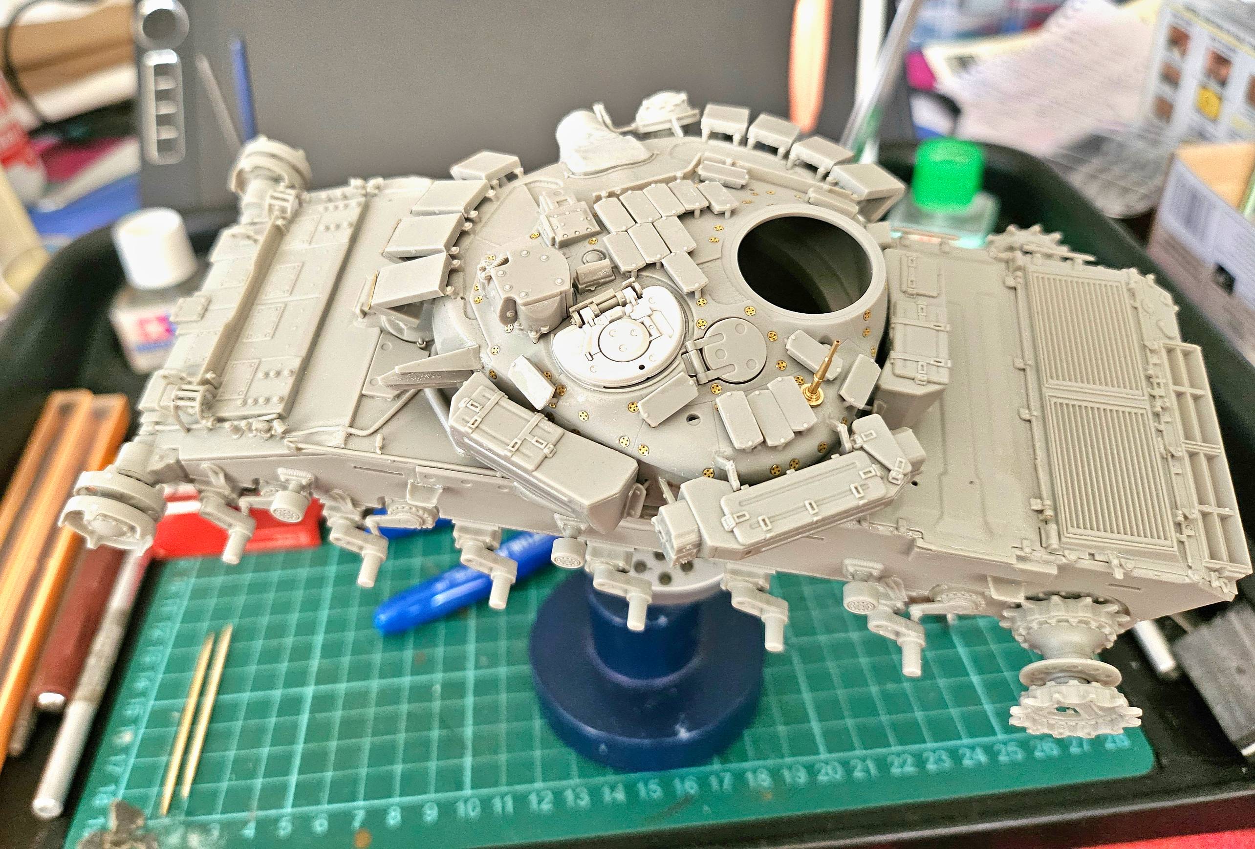

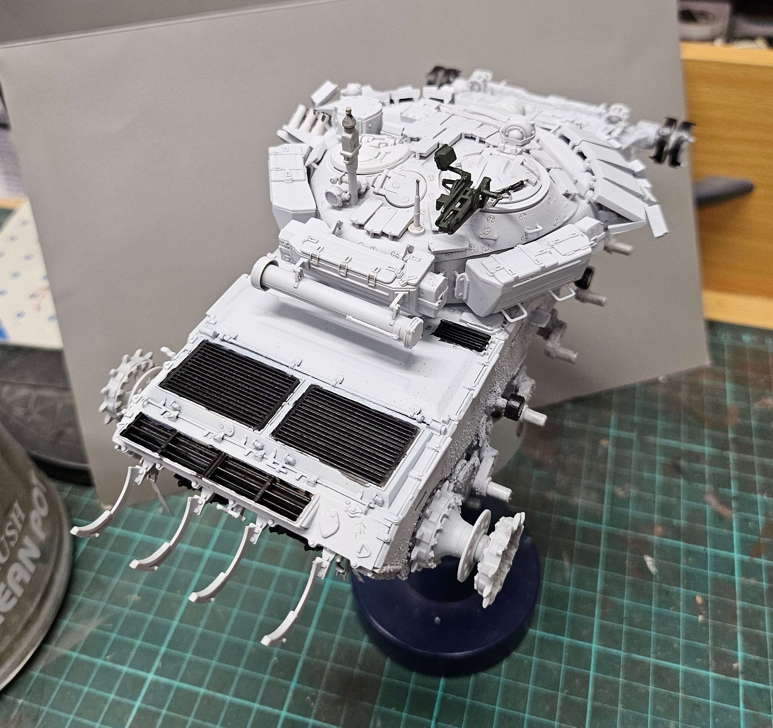

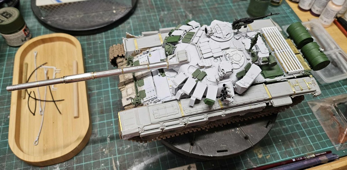

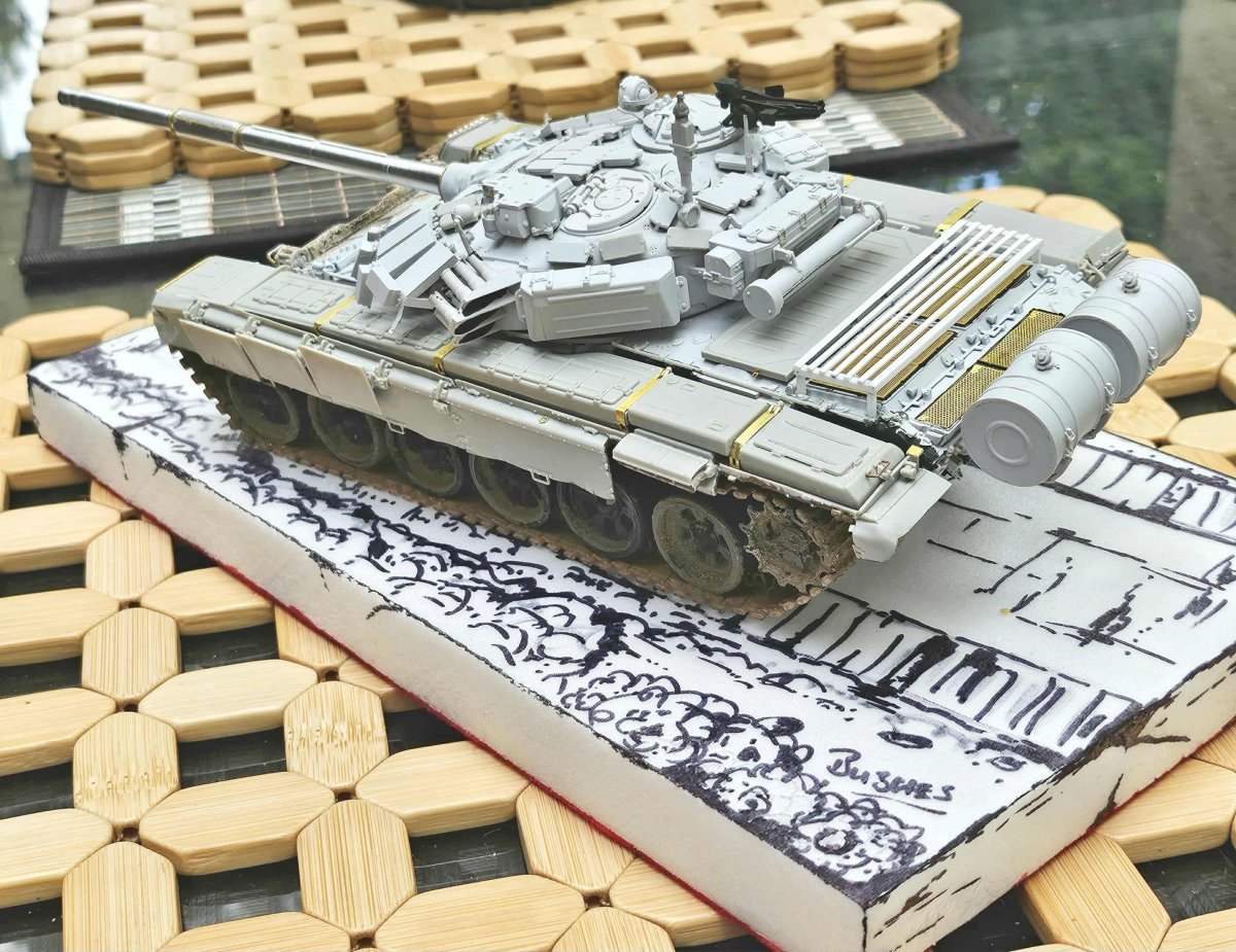

A touch more progress................ Working on the turret stuff and Aber barrel details.

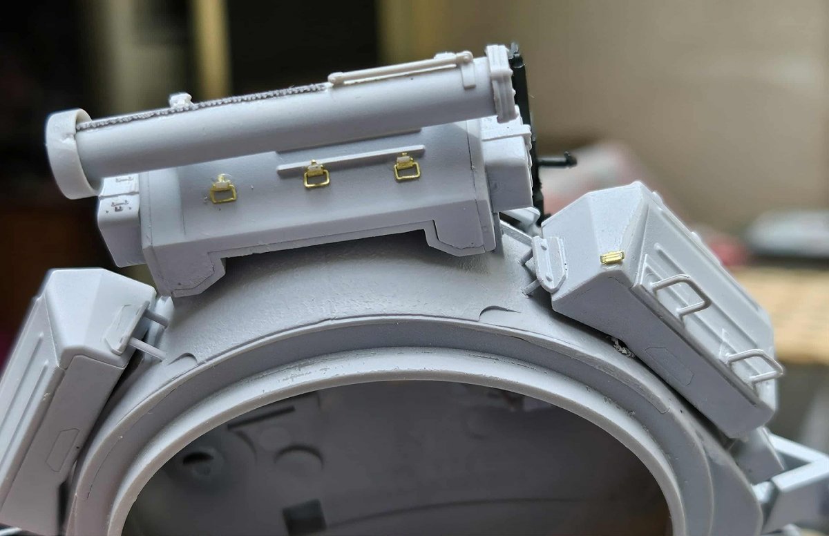

-replaced kit parts with fired Voyager smoke dischargers

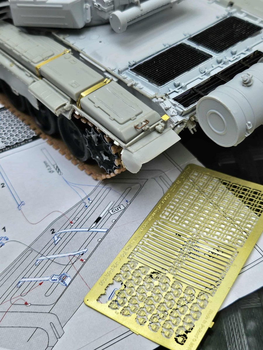

- finished detaching and glueing the 94xPE head details for the securing of the anti-radiation layer on the turret top.
- replaced kit parts with an Aber brass ariel base.
- replaced the complicated, multi-part gunner hatch from Trumpeter with the 1 piece and more finely moulded hatch (lighter colored)
- rear deck assemblies attached.

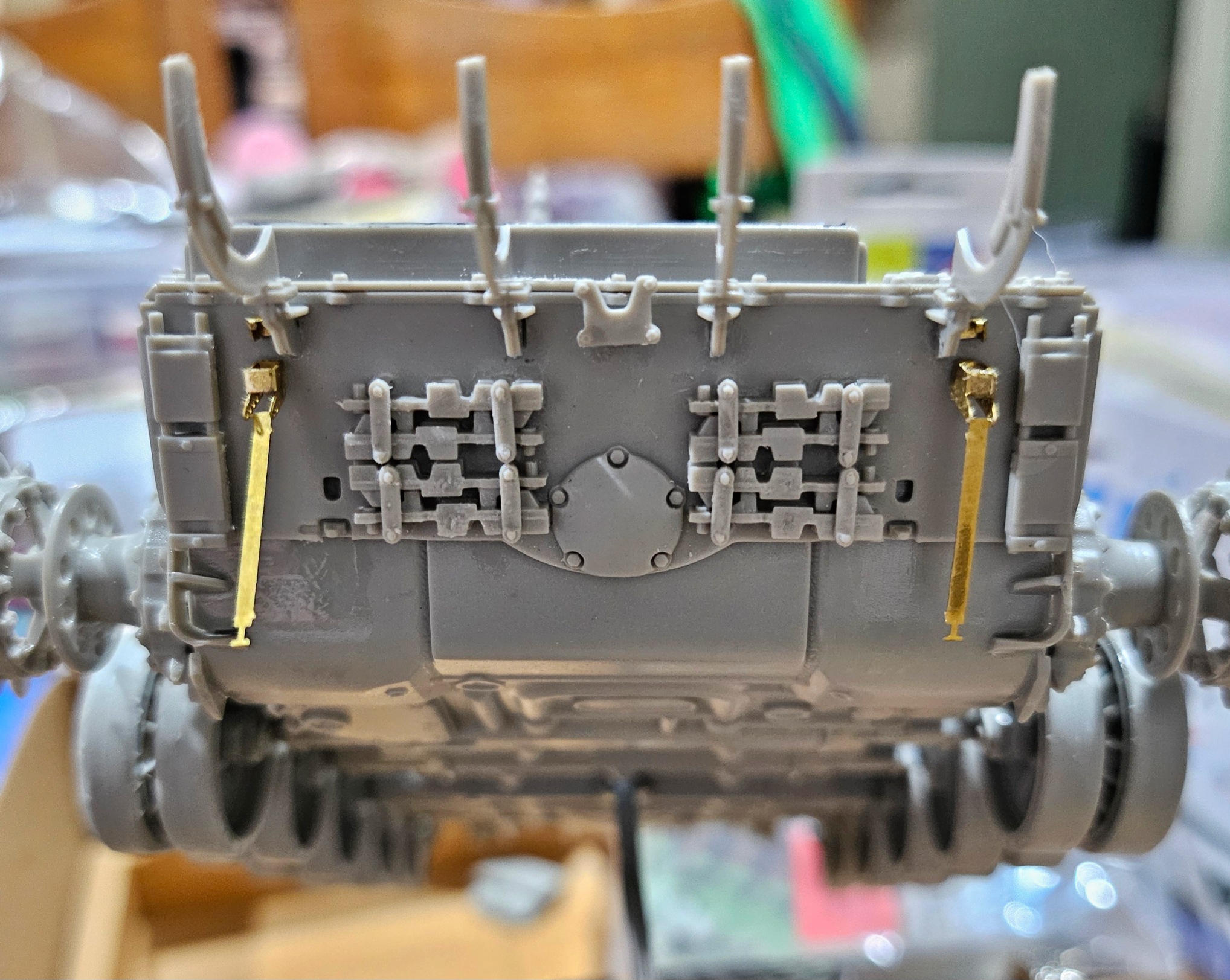

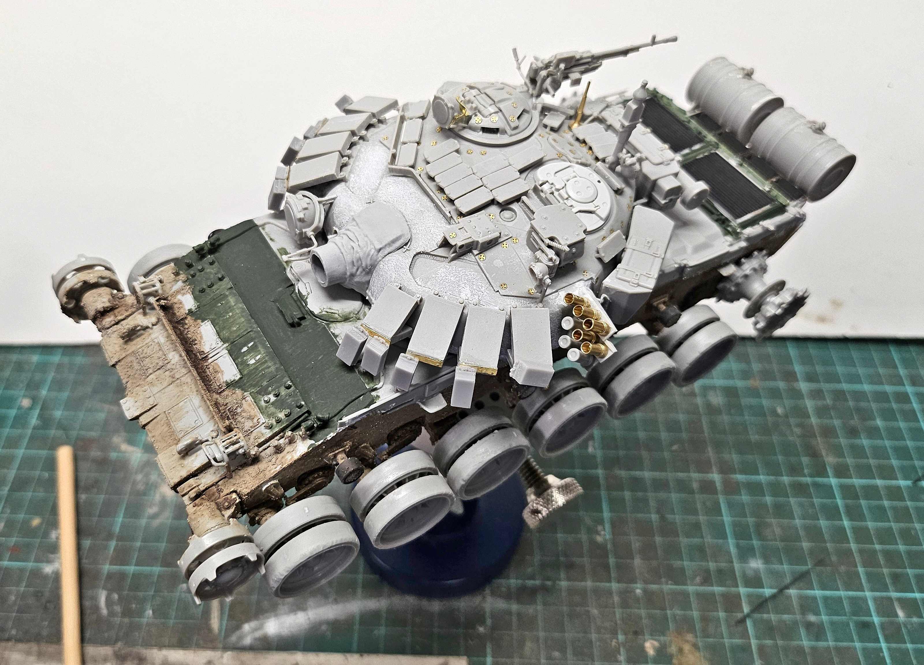

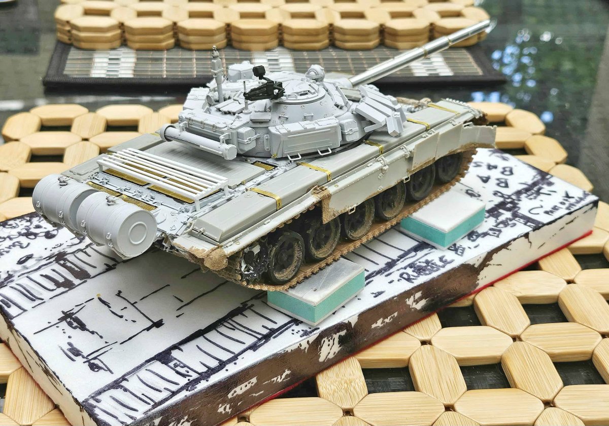

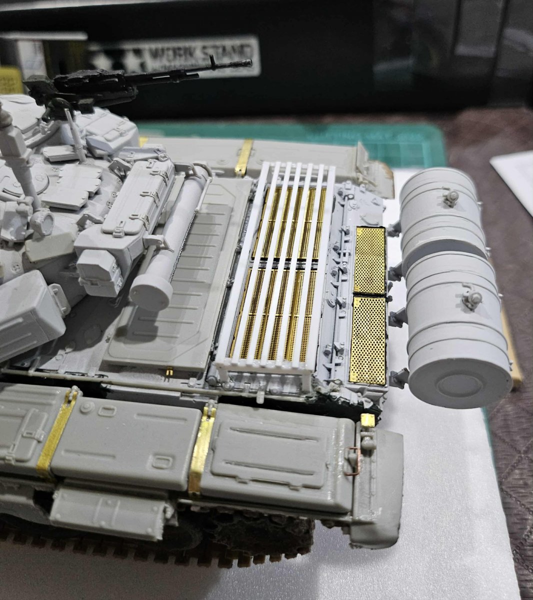

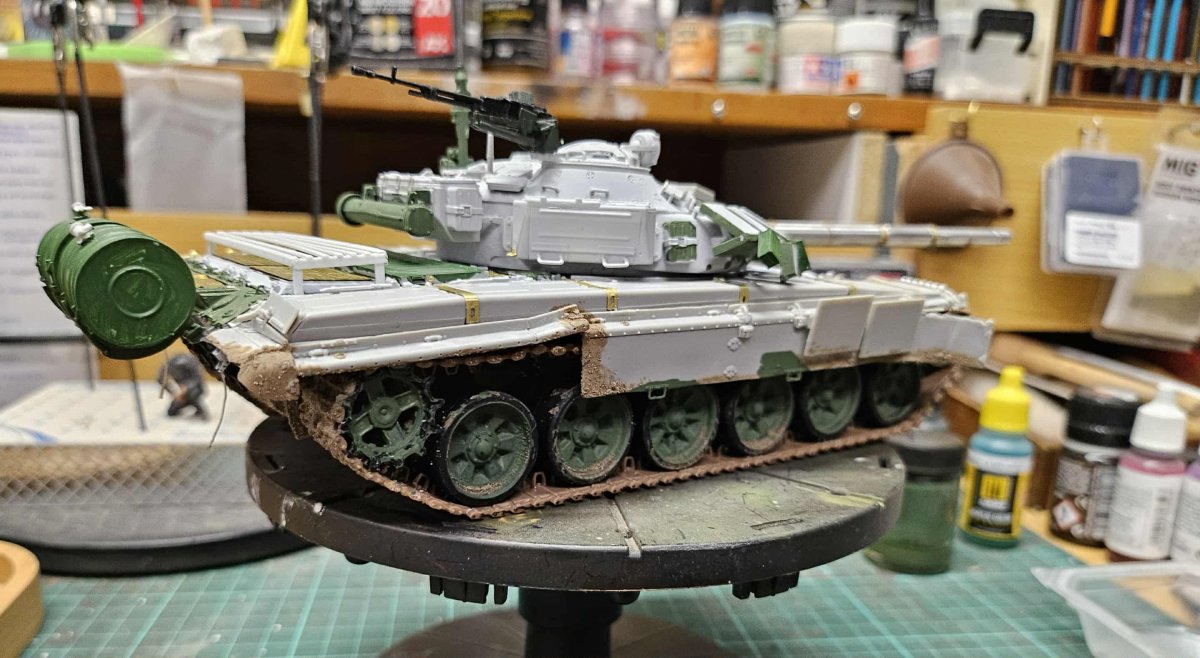

Wheels, rear external petrol tanks and rear plate done. I am going to try cutting a real piece of wood (small stick) from the forest here to replace the crappy vinyl offering from Trumpeter. The angle of the smoke dischargers is slightly incorrect as Trumpeter don't give you a very clear mounting point, just a slight mark on the plastic surface. As a result I didn't attach it at a steep enough angle and the lower inner 2 tubes , if launched, would exploded into the Relickt armour brick in front of it. So advice for the smoke rack when constructing this kit is attach the dischager tubes first then mount the assembly as a whole so you can clearly see the angle needed(which is what they advise in the instructions after rechecking just then :smack:).

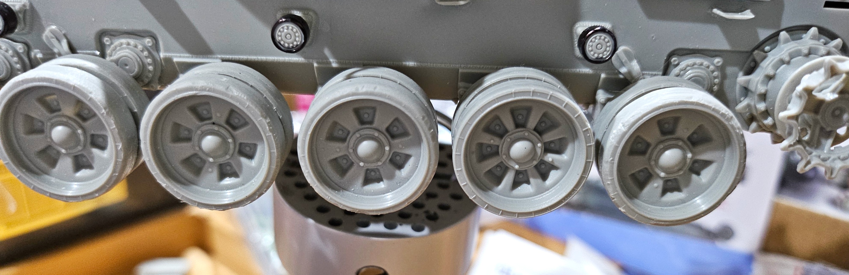

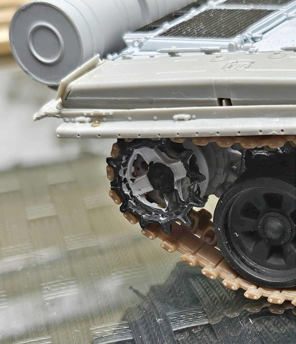

I switched-out 3 of the wheels for a different pattern [from my T-72 M1] which have 8 spokes instead of 6. This mix is not uncommon even on T-90's where 3 or more patterens can be seen sometimes as pointed out in the B3M post.

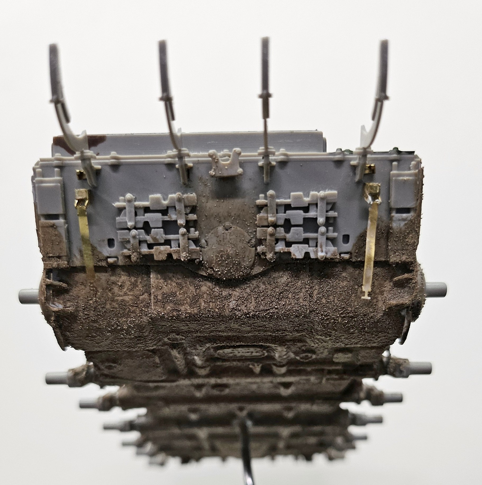

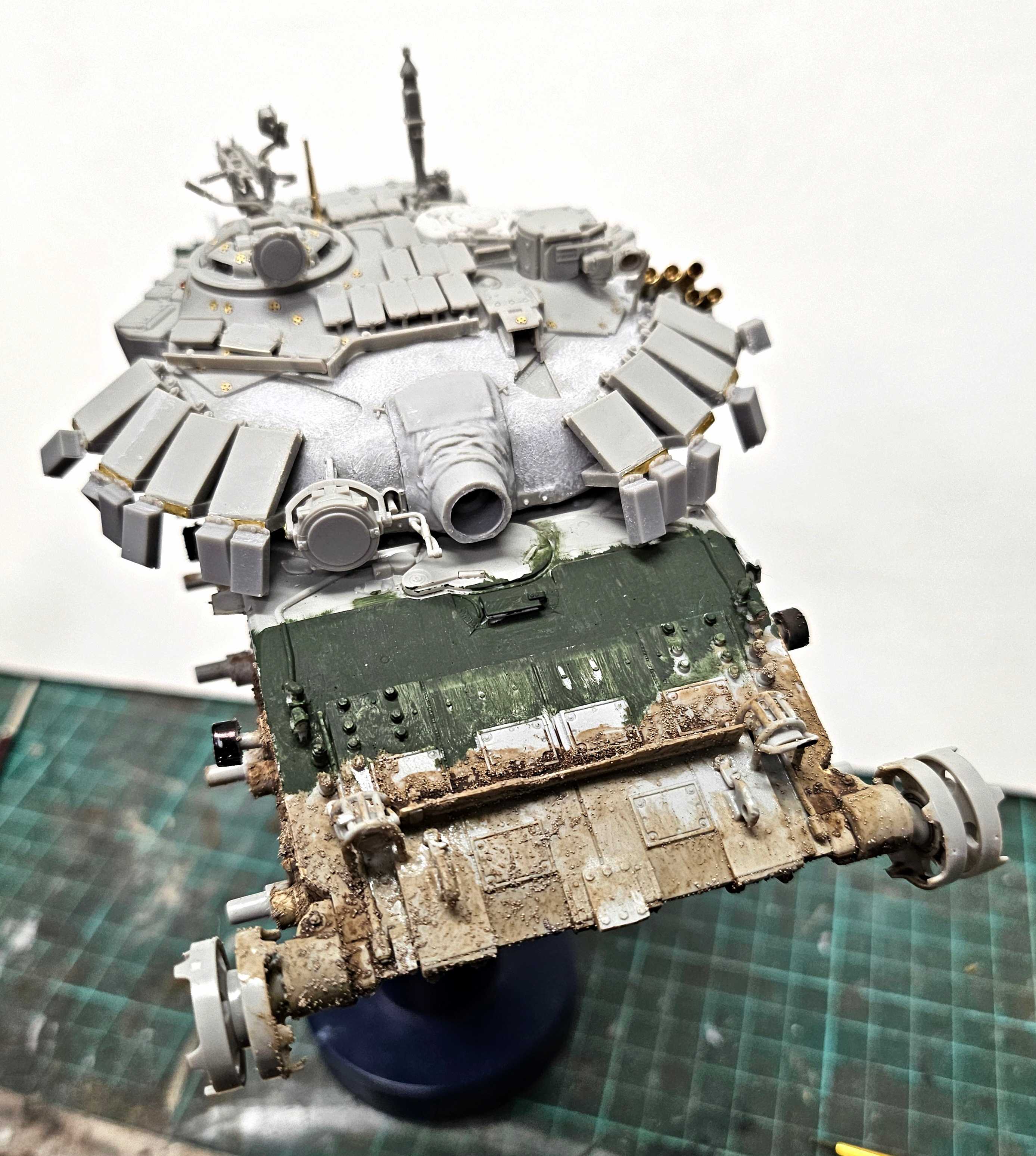

I also attached the rear plate with the barrel mounts and PE straps for attaching the unditching beam.

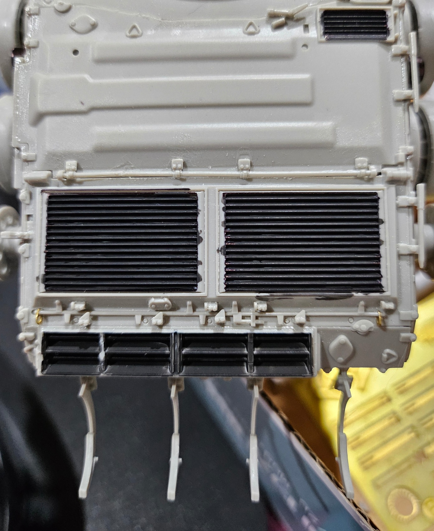

and painted the black undercoat on the engine deck grills.

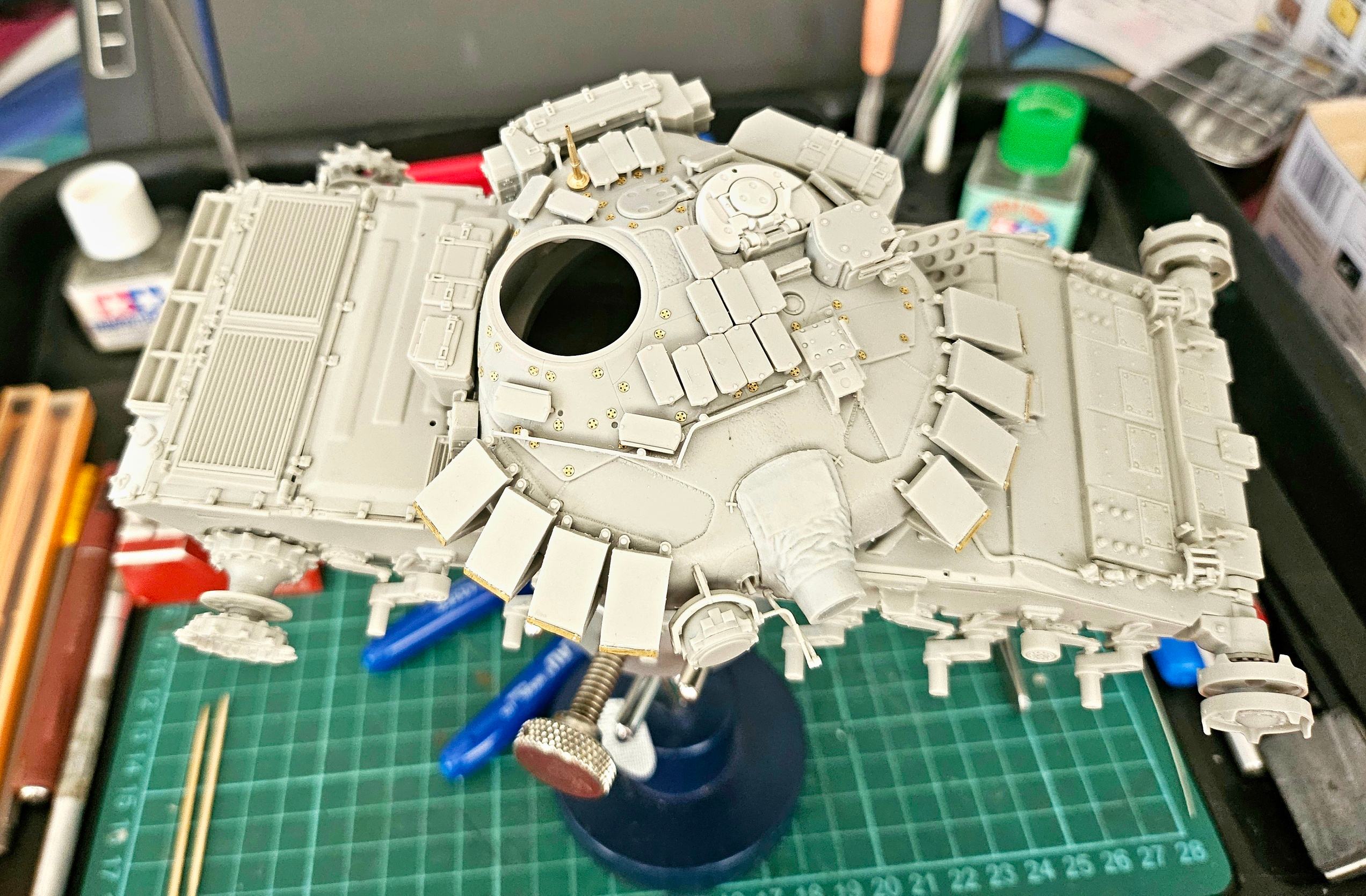

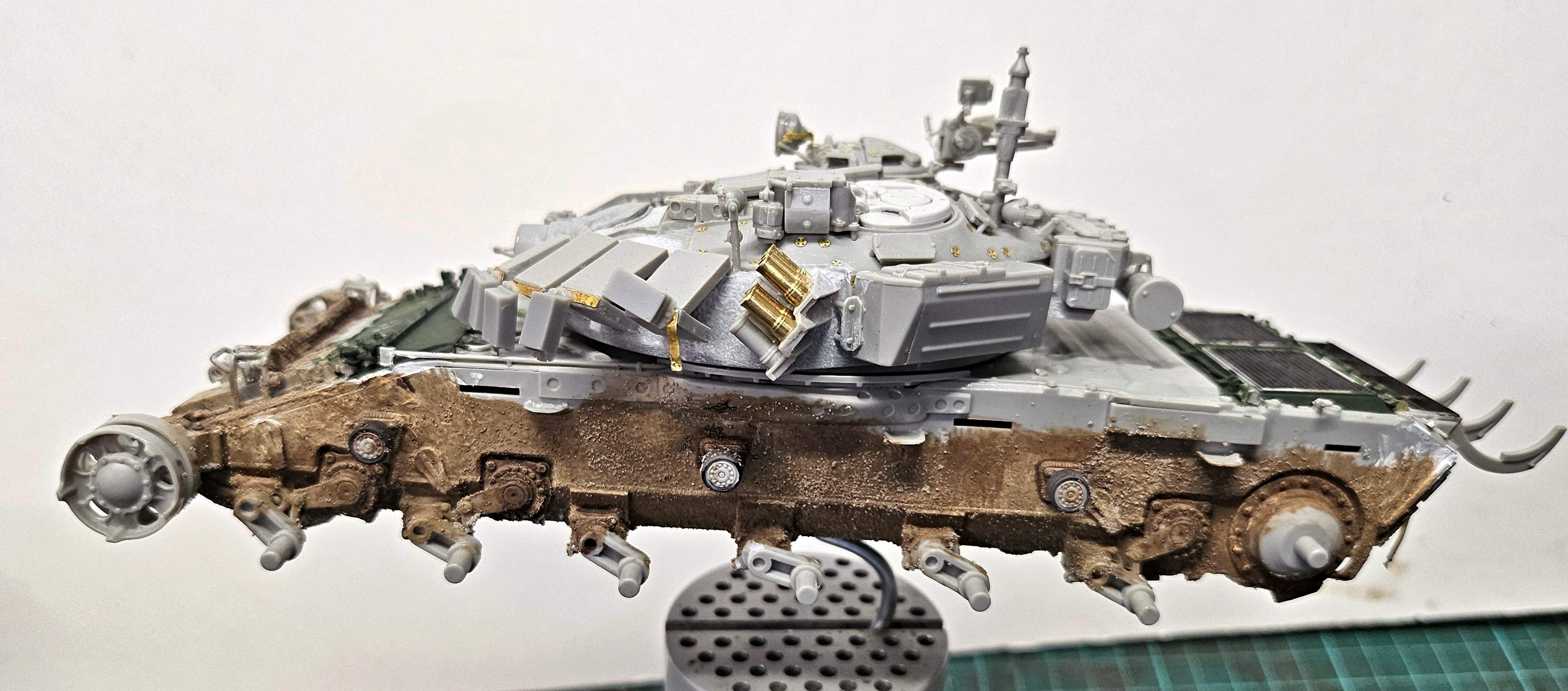

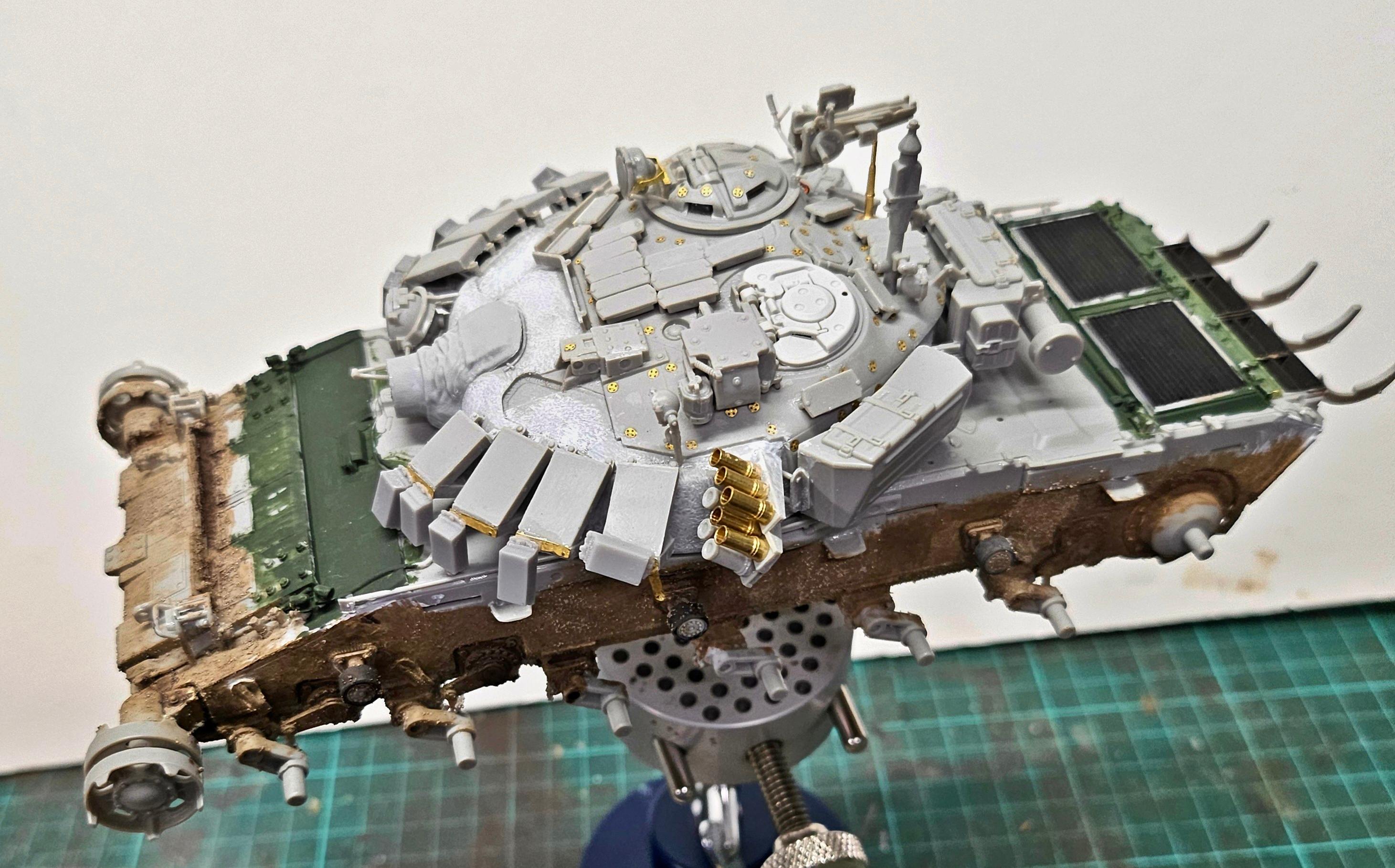

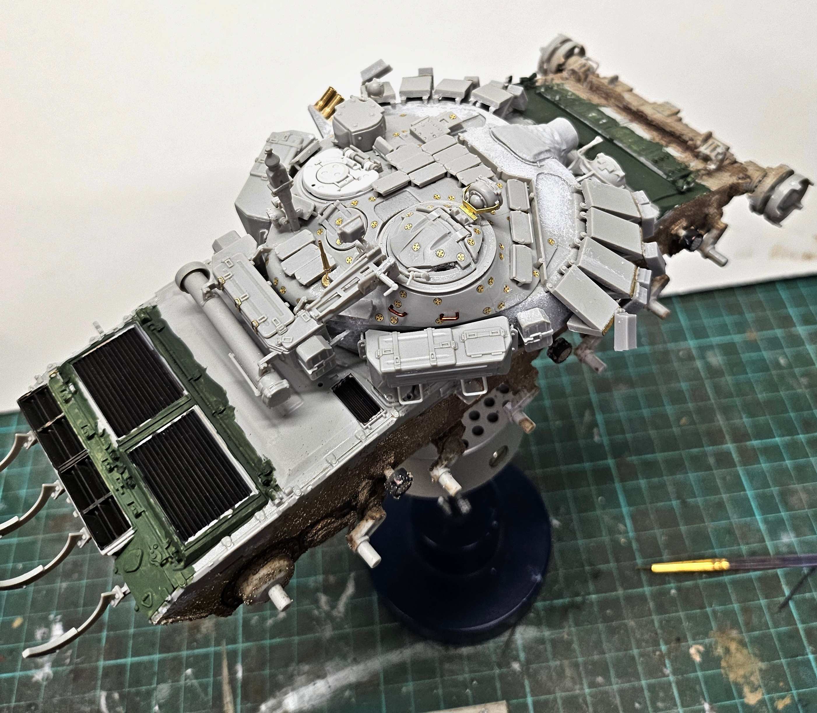

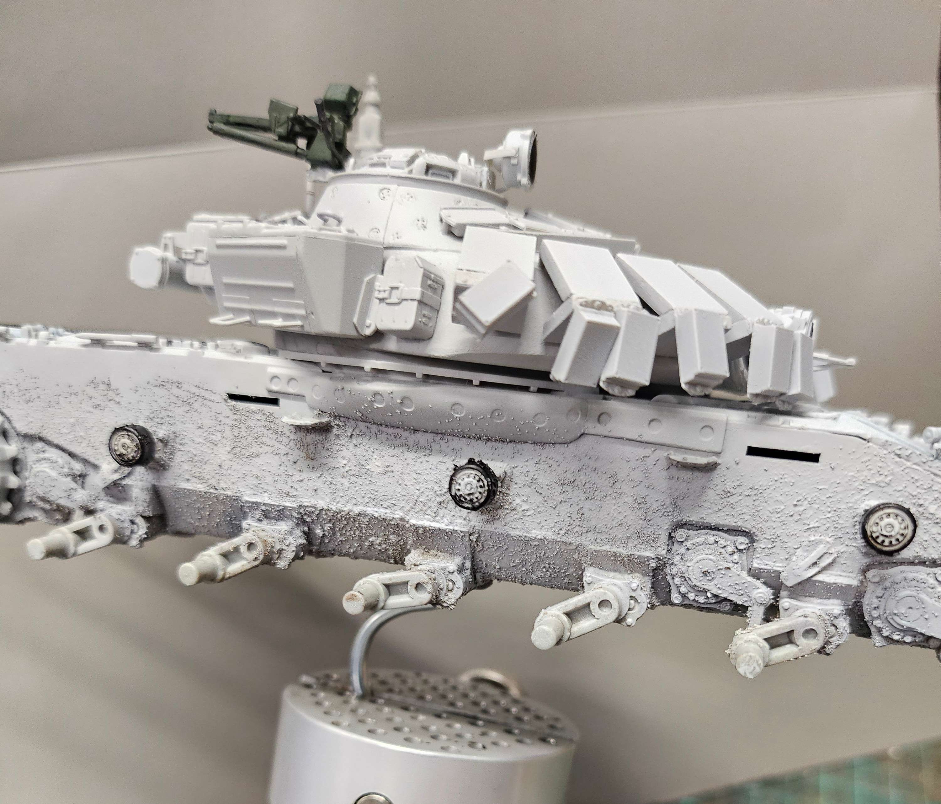

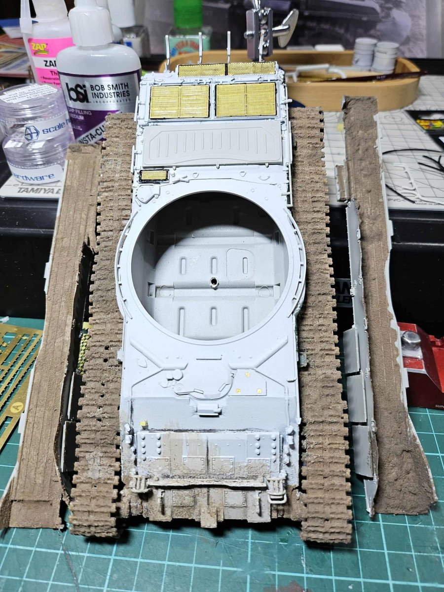

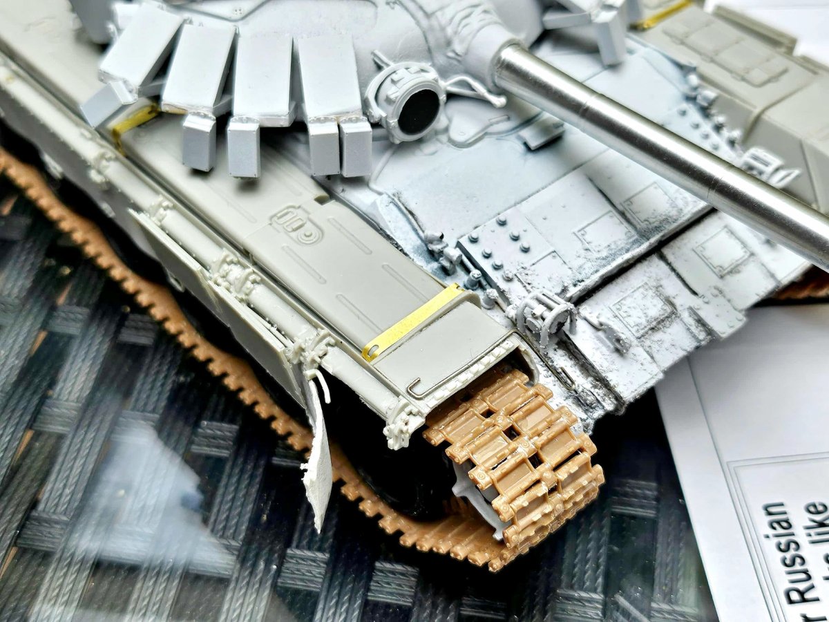

Some more progress with adding the extra ERA 1 blocks on the end of the Kontakt 5 ones, finished more PE and then added some texture. This time I sealed it with a Vallejio primer to secure the PE and begin with a lighter base than the t-72B3M.
The extra ERA 1 blocks were from Royal model.........

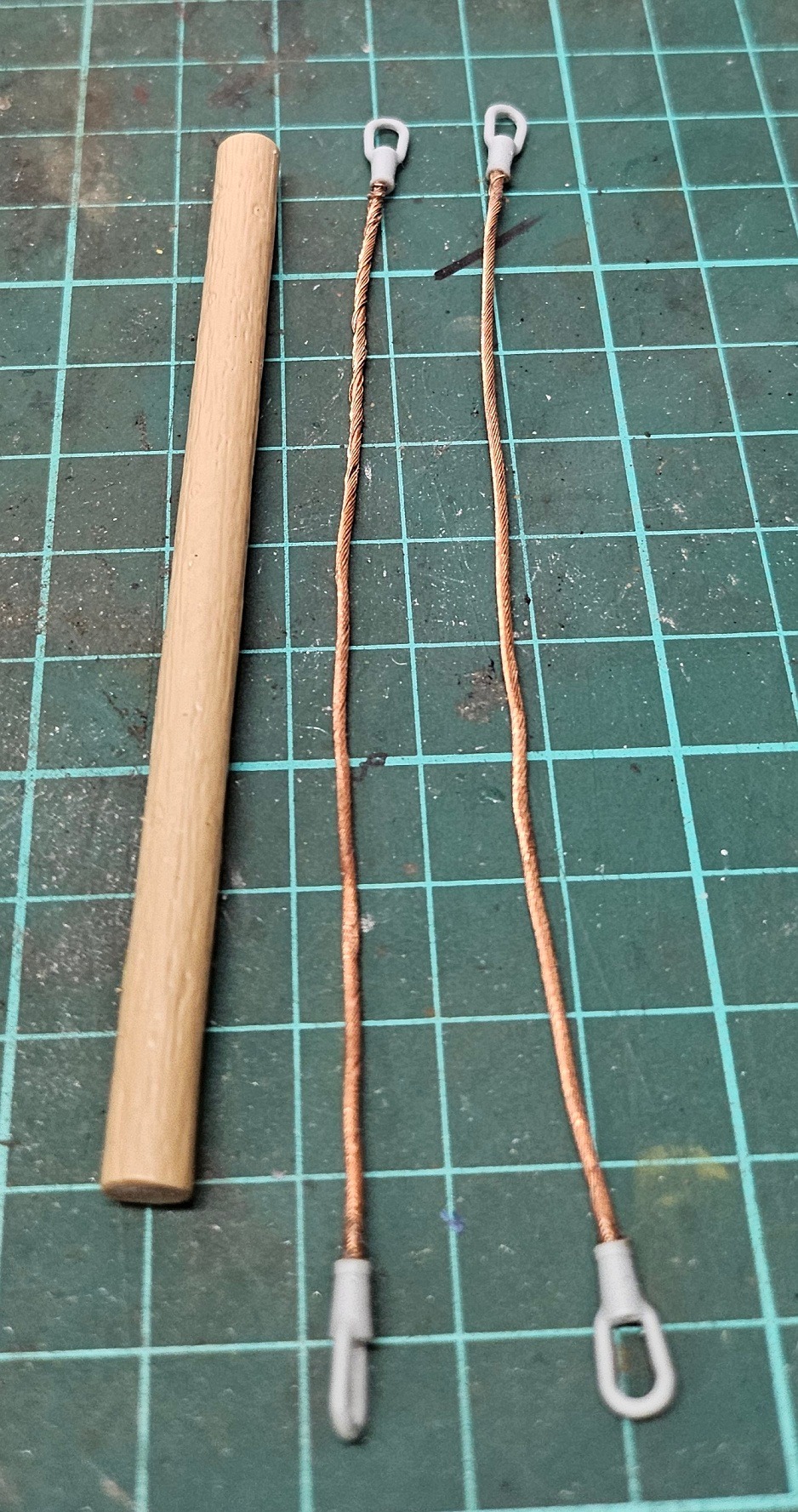

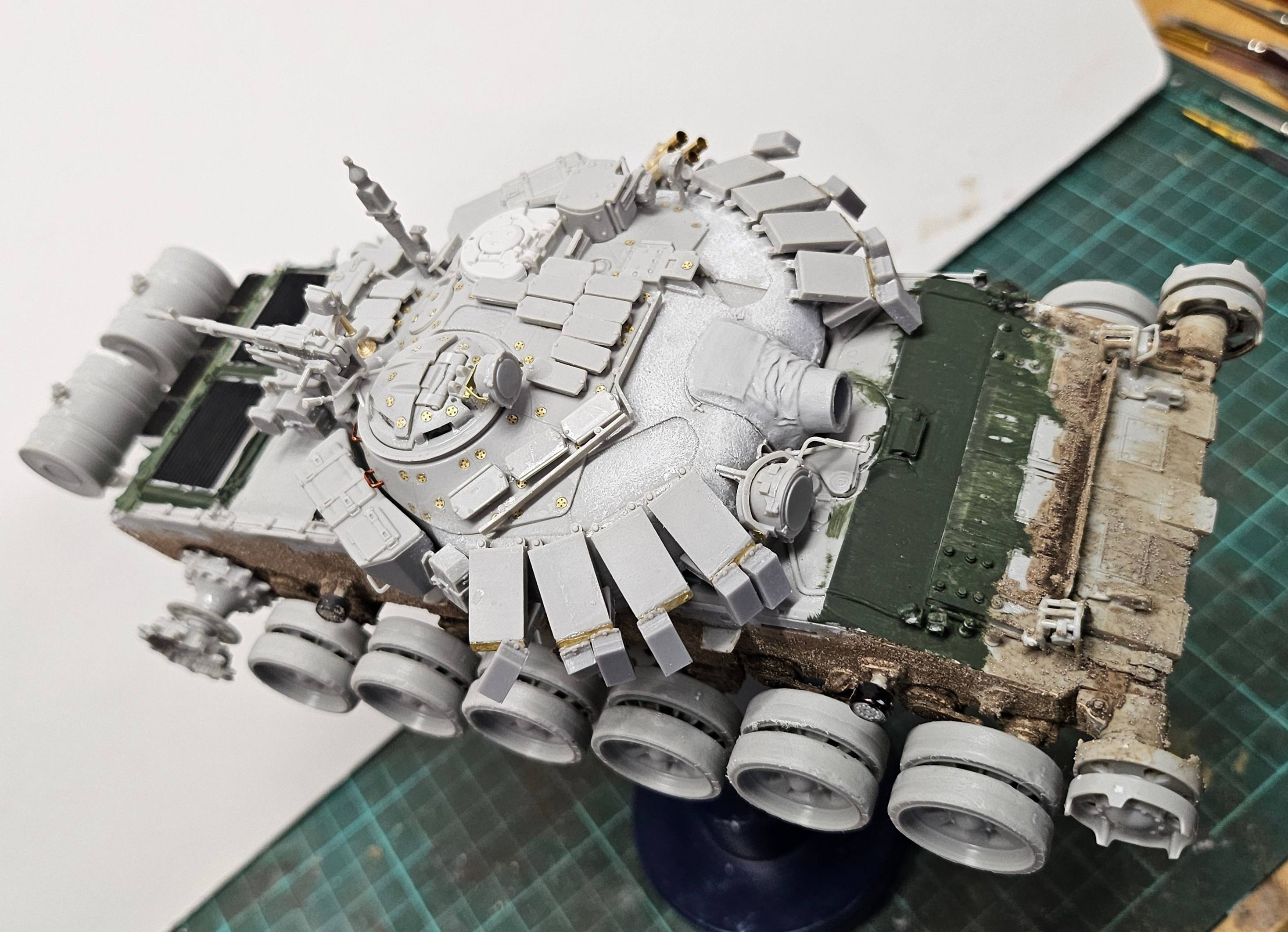

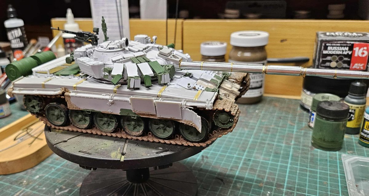

I finished the Eureka tow cables and eneded up using the unditching beam from my RFM T-80U that would not be part of that build.
I added some copper wire grab handles to the right side of the commanders cupola that seem to be missing on every companies T-72 kits.
Also used my left over Voyager smoke candles from the T-72B3M build.

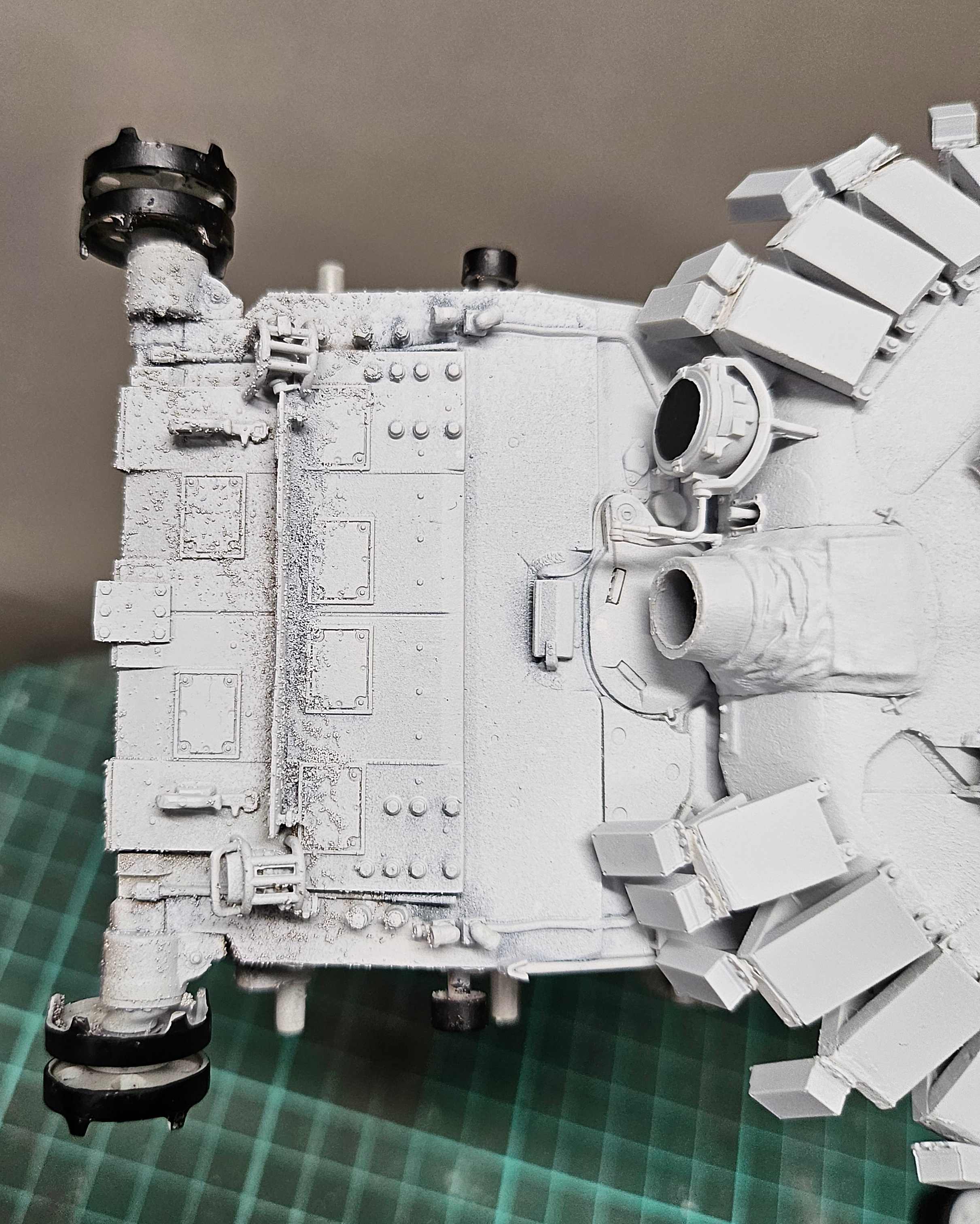

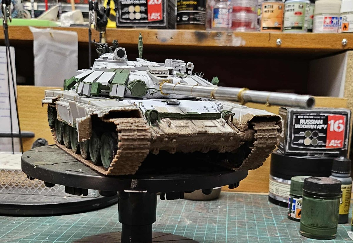

Initial hull dirt texture done once again with with Tamiya acrylic Mud.

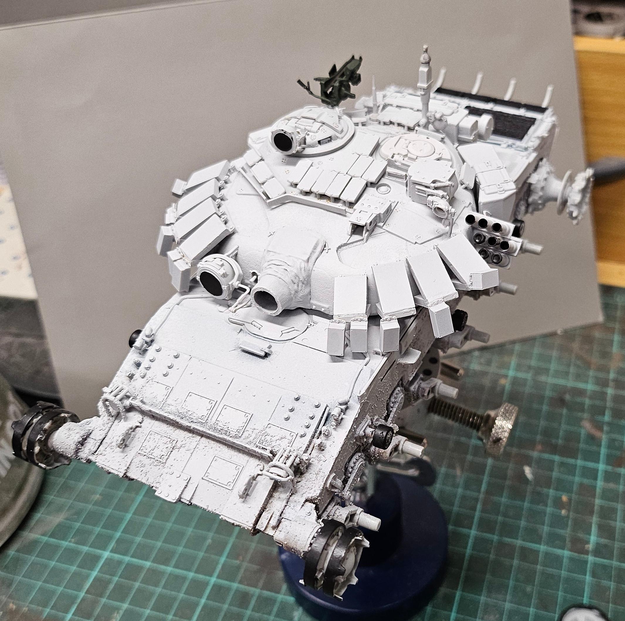

Then Primer time.....
