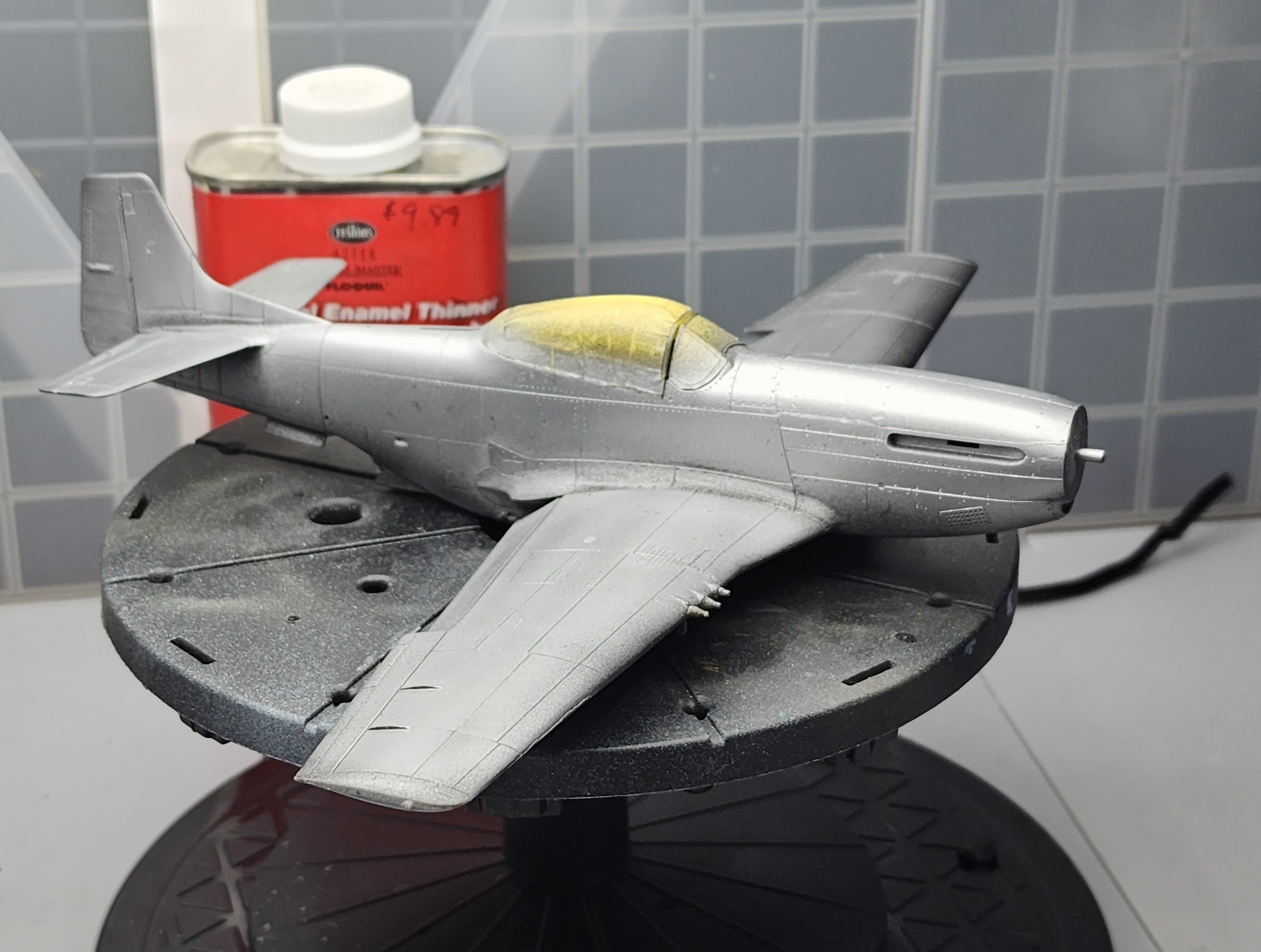

Well Mr. Puppy , funny you should ask! I finally got my airbrush parts in and could finally get back to work on the Mustang. I sprayed a black layer of Alclad Primer, then gloss coated with clear gloss Alclad. (For those wondering, my stash is very old, maybe ten years old. I am still trying to get the new stuff one or two per order. I have the black microfiller primer so far). I used old Alclad Aluminium finish and let it dry, then used my step down (1800-22,000 grit) polishing cloths to try and get a shine. It did not get very shiny.
Any advice as to whether this look is correct or should I go with a chrome finish is appreciated. I AM pleased that the surface looks pretty good. No finger prints or trapped dust or boogers to report. If this meets with your approval I will continue with the rest of the painting on the nose.
I've found that Polished Aluminum works better for a shinny finish. That base primer coat has to be absolutely pristine and glossy. I've found also that Tamiyas gloss black works better for me.
AlcladII is tricky stuff, can even vary from batch to batch. I know a lot of folks use Tamiya AS2 right from the can, I've even used Chrome and then weather the shine down.
10-4 good buddy ;)
When I did my 1/72nd P-47 I used Alclad gloss black and gave it an immediate mist of Mr. Color Leveling Thinner. This gave the glass smooth gloss finish. Then I used chrome over that. THEN used a little of the other colors to weather the aluminum in areas. No sanding after first paint application all the surface was as smooth as I could get it before starting.
The Alclad gloss black went on a little rough and pebbly so the thinner sprayed over it LIGHTLY then causes it to level and smooth out. Then let it dry for a day.
