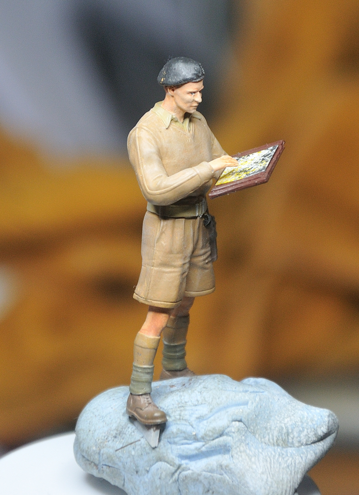

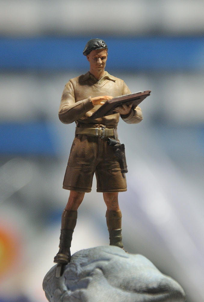

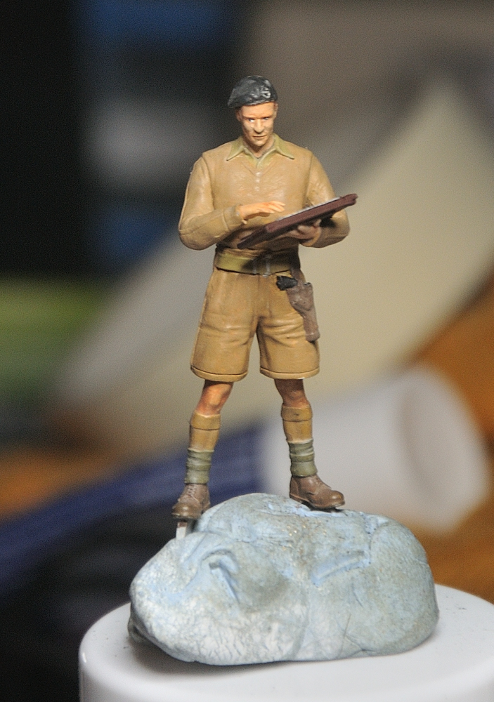

I have been messing about with a figure this week, its my second proper attempt and its better than my first so thats always a good thing, hopefully the third will be better than my second :)
I have a real problem getting a Mat finish still, nothing works from Humbrol Mat coat to Mig lucky Ultra Mat so obviously the problem is with me rather than the product. I do have success with Tamiya rattle can mat coat but only for the first 1/4 of the can, after that it goes semi gloss...
At the moment i am thinking this could be humidity as high humidity is always a problem living on an island ...

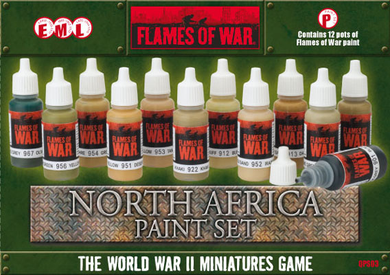

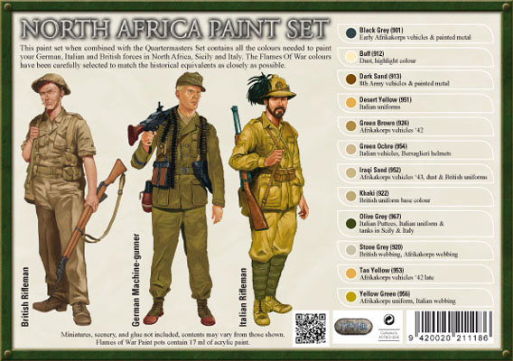

I have searched most of the paint sets available here and no one seems to do a North African set for British uniforms. Of course i can mix but the advantage of a set is being able to repeat colours over time without the mix and match process.

Its not the figures James, its the correct colours. you can buy paint sets for Northern Europe and even Africa corps but nothing English N Africa.

Remember the photo that Bob's (Moon Puppy) dad took of two Korean G.I.s in different color uniforms? I am sure that the uniforms of the British in North Africa were of the same kind of thing. I doubt that they were all the same color or condition. They were "similar" but with sun, heat, sweat, and other things they were all slightly different so don't worry about the colors matching as long as they are similar.
Also as the uniforms look to be kahki, why would they have different uniforms for North Africa. Probably they just wore abbreviated shirts and shorts where possible.

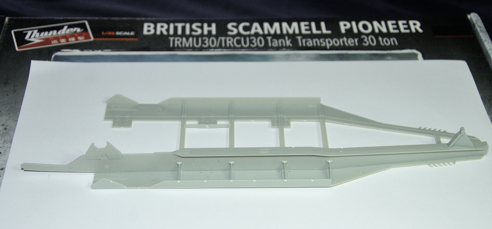

The trailer is large
this section is 11" long and there are more parts to add to its length

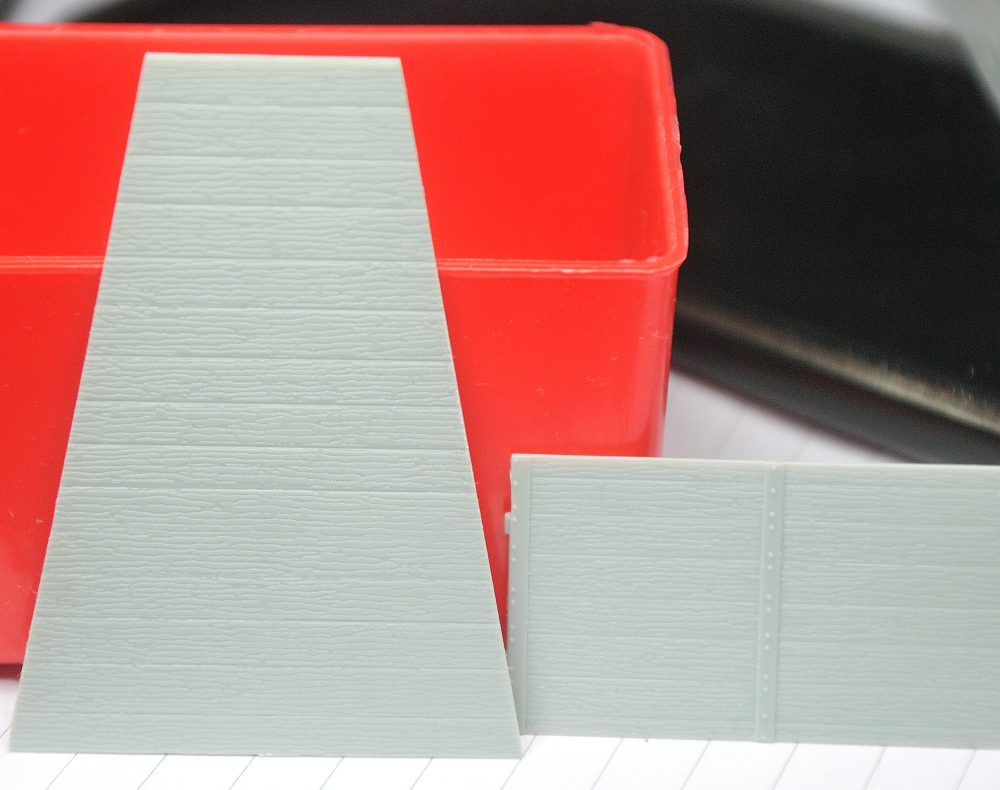

In reality it was a steel frame supporting a floor of timer slats , probably railway sleepers.
The model supplies these in various sections with moulded in detail. TBH i would rather they were just smooth and i could add my own texture detail. My options are to sand these parts ( there are 8 of them all between 1" and 2.5" ) and then give a wood effect with oils as we have all done in the past with WnW models........or.... i wonder if i could remake these with Balsa...
I am open to ideas on the best way to go ? oils would probably nearer to a scale finish and the easiest. Maybe i will have a practice with both methods and see if any problems crop up.
I think oils look best, but for something like this Basswood would also be a really good idea. Bals wood would do in a pinch, but bass wood or thin plywood would be best I think. Oh and the flames of war paints are like vallejo.

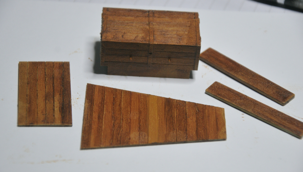

This is the first layer of oils. Looks like a terrible set of dining room furniture from the 1970's :), needs weathering, some sand and a very flat coat as i imagine wood in the desert goes bone dry. Just wish i could solve my Mat coat problems...
To give scale the peice at the bottom is about 3" long
I had another look at my figure. this is resin and i am thinking about washing it off and starting again, its not a waste as i have learned lots. The Mat coat now is slightly improved by drying it over the cooker :) so it could be a cold/humidity thing.

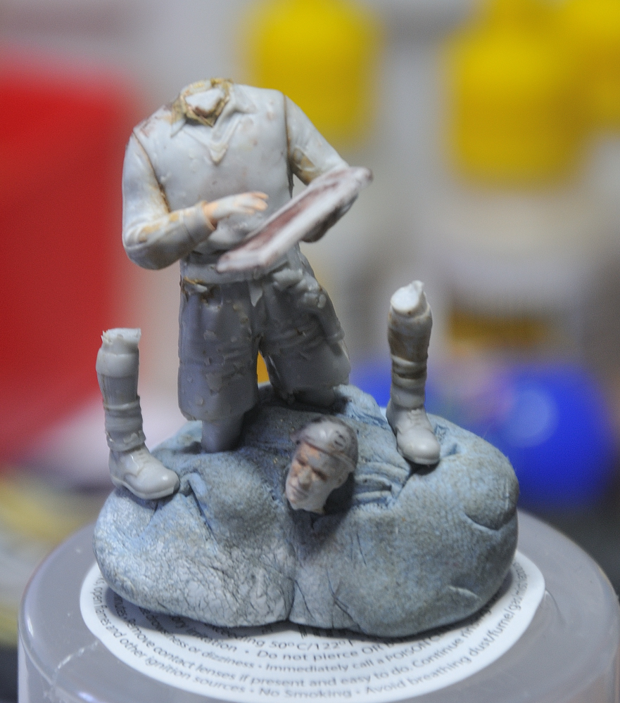

It is with great sadness i announce the death of major Tomkinson ST john Smyth who's legs and head fell off while taking a bath in acetone :-(
unfortunately the doctor says this is terminal as he has gone soft....

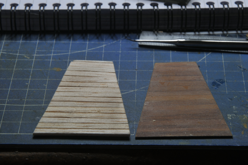

On a brighter not the balsa is winning the planks/decking competition..
The balsa is much more the look i am after with sun bleached planks, i have lightly sanded the edges of each plank so it has definition.
some oil stains and sand pigment should do the job.
