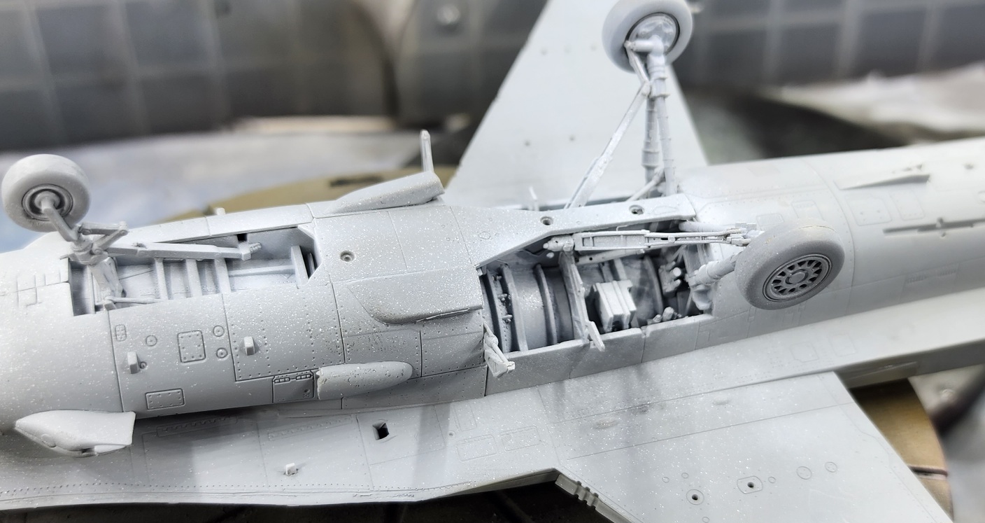

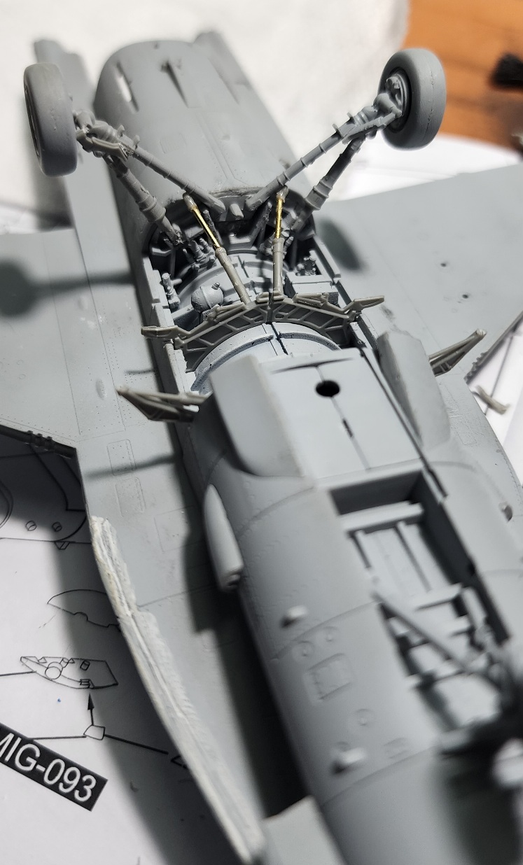

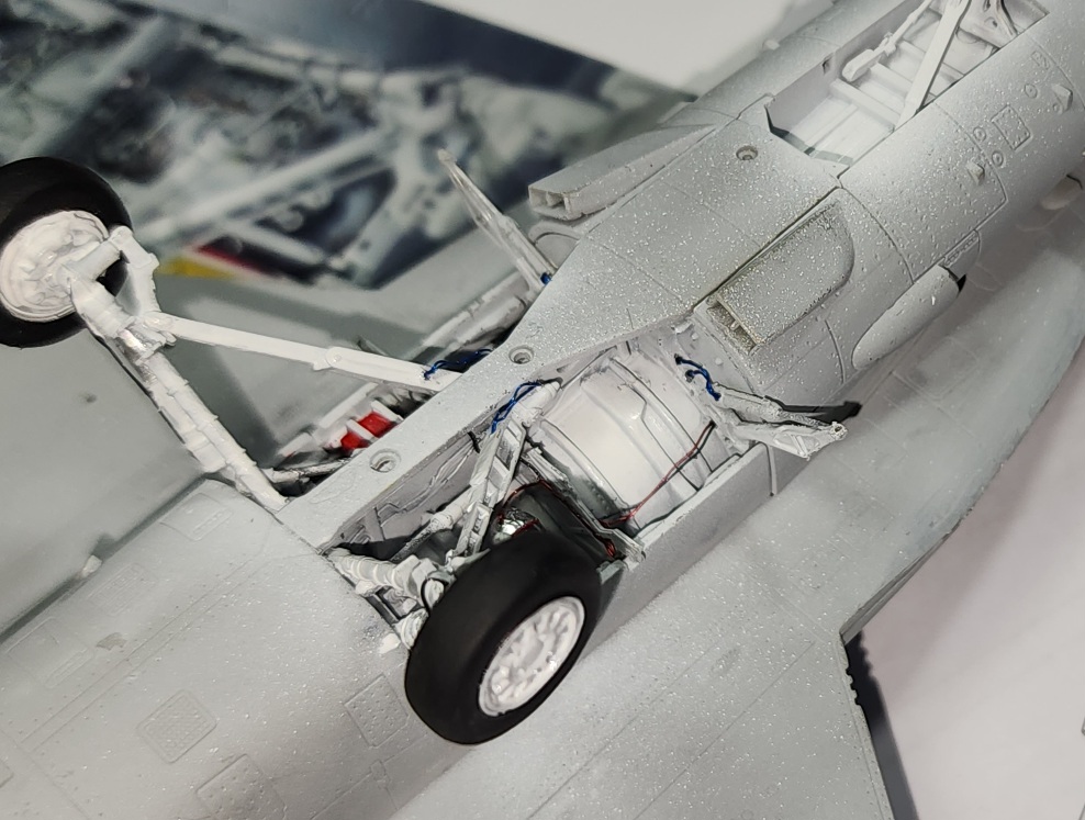

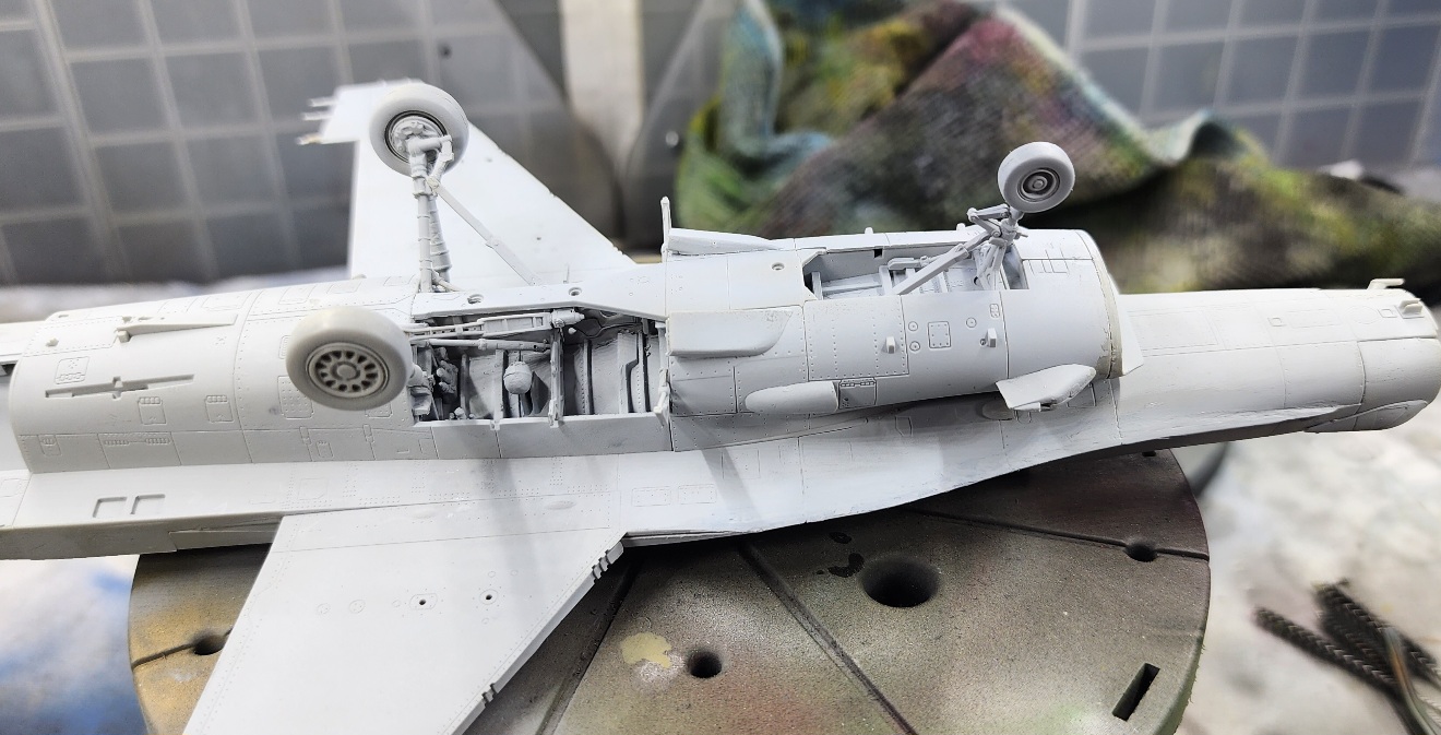

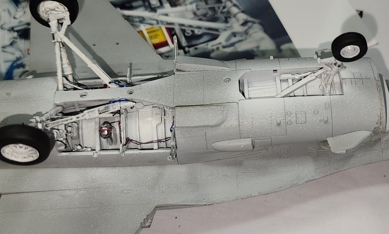

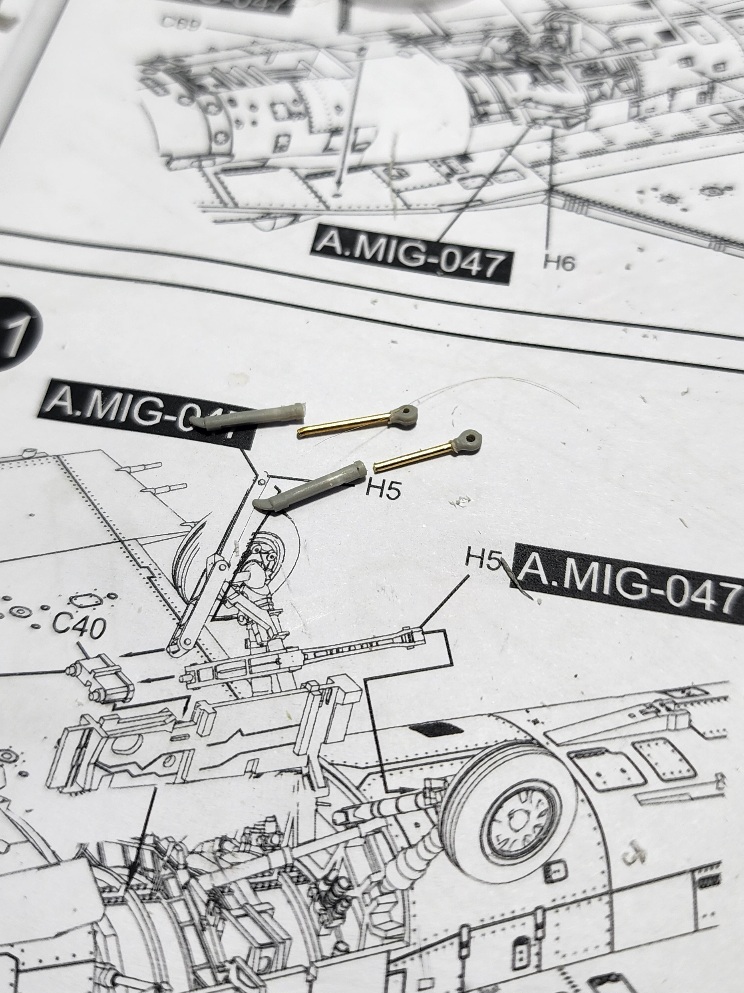

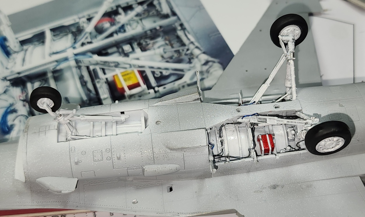

So, I have continued on with the project. I found some cool photos of the landing gear on what is evidently a large scale model, complete with wiring, lines, and looks completely real. I used colored fly tying wire to make the wires and lines. I have found a ot of the parts are very fragile or already broken when removed from the sprue and have had to remake a couple of pieces.
There was one piece that I glued together, and it held for a while but broke again while installing the wires, which I did after assembly and painting. I still have weathering to do, but I think I am done with wiring even though it is a bit sparse. I took some artistic license with the red wire just to add some more colors.

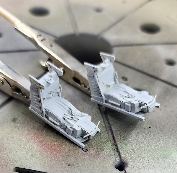

The teeny weeny seats are assembled. One of the little pull levers between the pilots legs went flying out of my tweezers and I never found it, so I made better ones. I cut off the molded cylinder bottle and replaced with styrene rod. I made seatbelts from ultra thin metal sheet cut into tiny straps. I may do one more coat of primer after tidying up some edges.

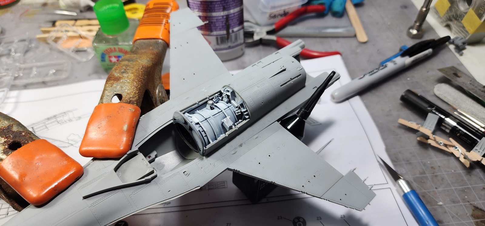

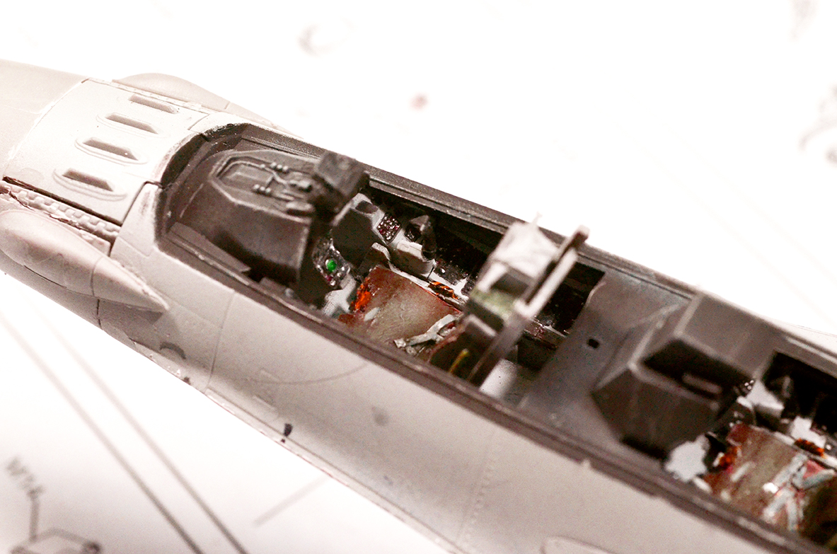

OK, as promised, some photos of the cockpit:
The white balance is a little screwy, but you get the idea.

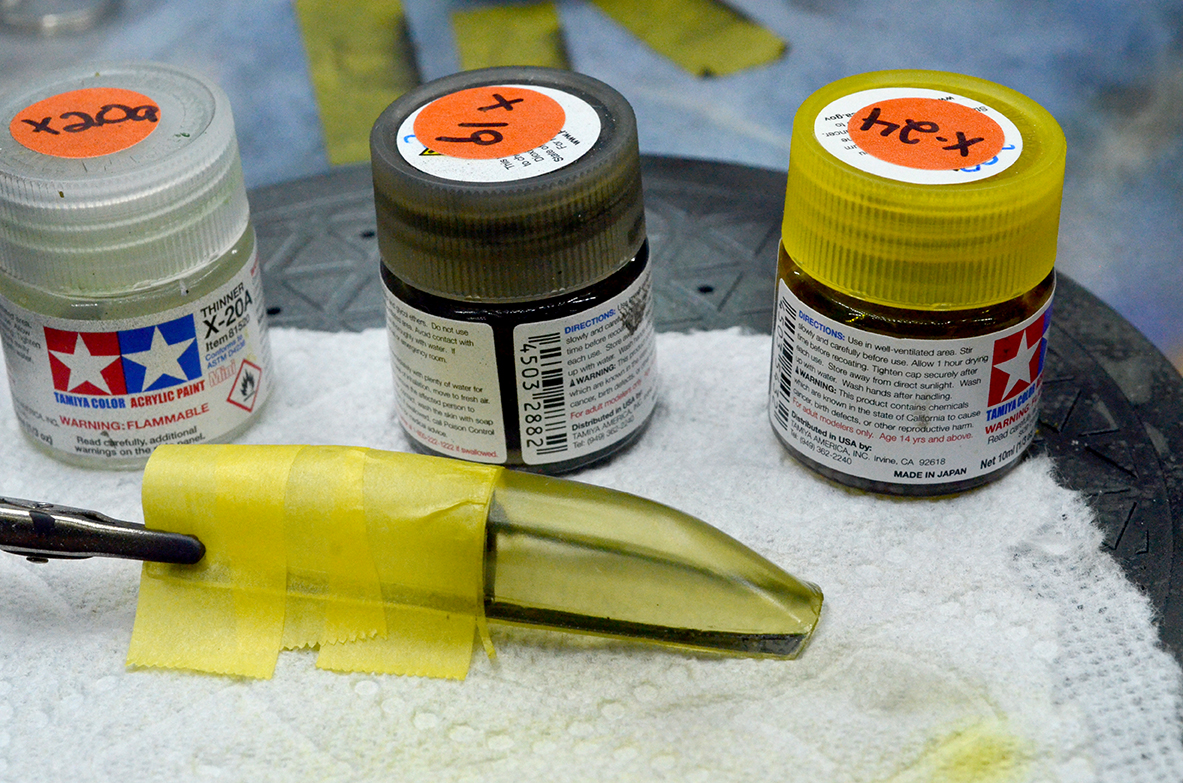

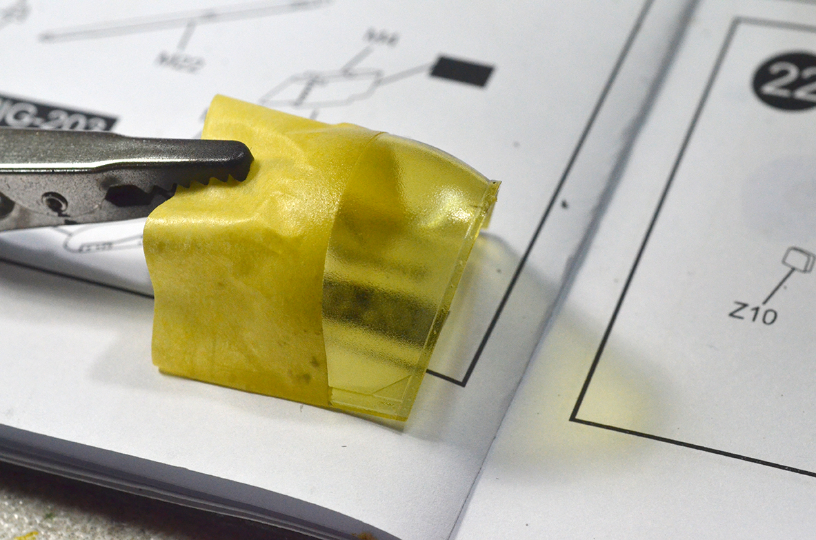

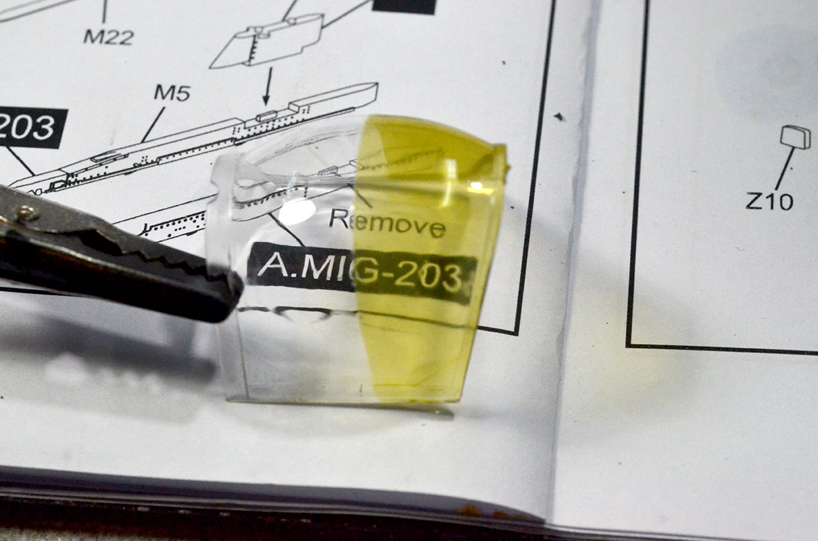

Also, I am going to tint the front half of the canopy. I would rather do from the inside, but I have already installed said "stuff along the bottom", so I am going to do on the outside. I am practicing on a spare Spitfire canopy. I used Tamiya Clear Yellow X24 (5 drops) and three drops of X20a thinner. I was afraid to use lacquer thinner on the clear. I sprayed a couple of layers of the yellow, then used Tamiya X19 Smoke, same ratios, to darken the yellow to gold. The before image is right after spraying the paints:
You can see it is pretty cloudy. Now to pour some Future on it, on the outside and not on the inside...
It cleared up very nicely. Experiment successful! On to the F-16 canopy...
On the experiment, I used a hair dryer to speed up drying. I am going to let this dry naturally. I am covering with a tupperware container to keep dust off of it. Tomorrow I will pour the clear Future and see what happens. Hopefully, the inner black rail will stay matte.
Wow Greg that was fast and it looks good. I was going to suggest a light coat from the golden paints we saw at your shop but the Tamiya seems to have worked out great. :vgood:

Brilliant work so far! I also built a Sufa in 1/72 scale some years back. One technique for masking the landing gear is to wrap them in aluminum foil with enough to cover some of the gear bay. Then seal it all around the base with Silly Putty or some equivalent material.
Keep it coming man! You got this!
Thanks Duke! I never thought of aluminum foil. You guys know so many tricks. I started to tape and putty off the wheel wells but decided quickly that wasn't going to work, so I decided to use my airbrush very carefully and spray closely to the edges, then fix any overspray that may occur. None did! Pics tonight of what I have done so far. I think the camo painting starts tonight. The canopy turned out" OK". I should have taken the tape off immediately after pouring the future on, because some bled under the tape, which should have occurred to me but didn't. It came off easy enough, but it was a little nerve racking for a moment.
