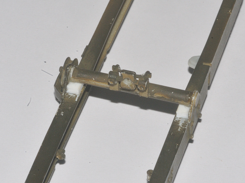

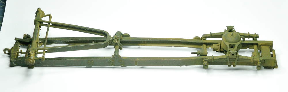

I would suggest a light tack maybe with CA until you get it for sure. I have done that before by using minimal amounts to tack parts together. Then when it needs to come apart, a slight tweak and it pops right apart. Yeah the assembly is delicate, but then once it is all good, take some super thin CA and feed it into the joins to make it solid.
OK so it looks like the Main spars twists once glue is applied as they are temporarily softened by the glue . By putting a block under each side of the crossmember it beefs up the whole section and doesnt allow it to twist like this

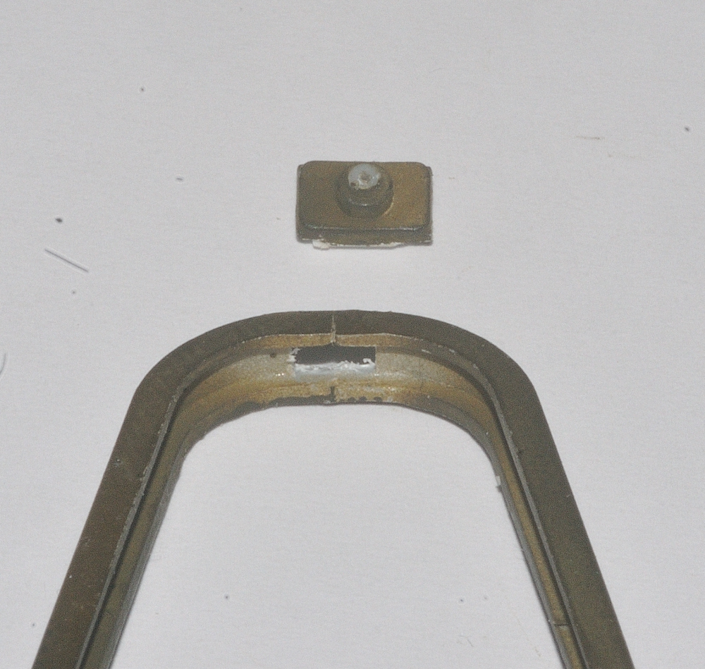

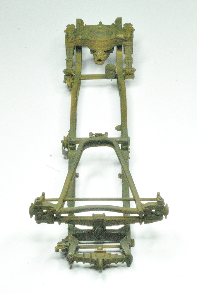

The loop on the back of the steering assembly is supplied in 2 parts and i dont think they are symmetrical so double check this as it throws the rear mount off centre. Also make sure the button that fits too the back is central, you may have to slot it over .0.5mm

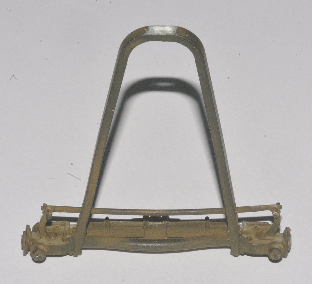

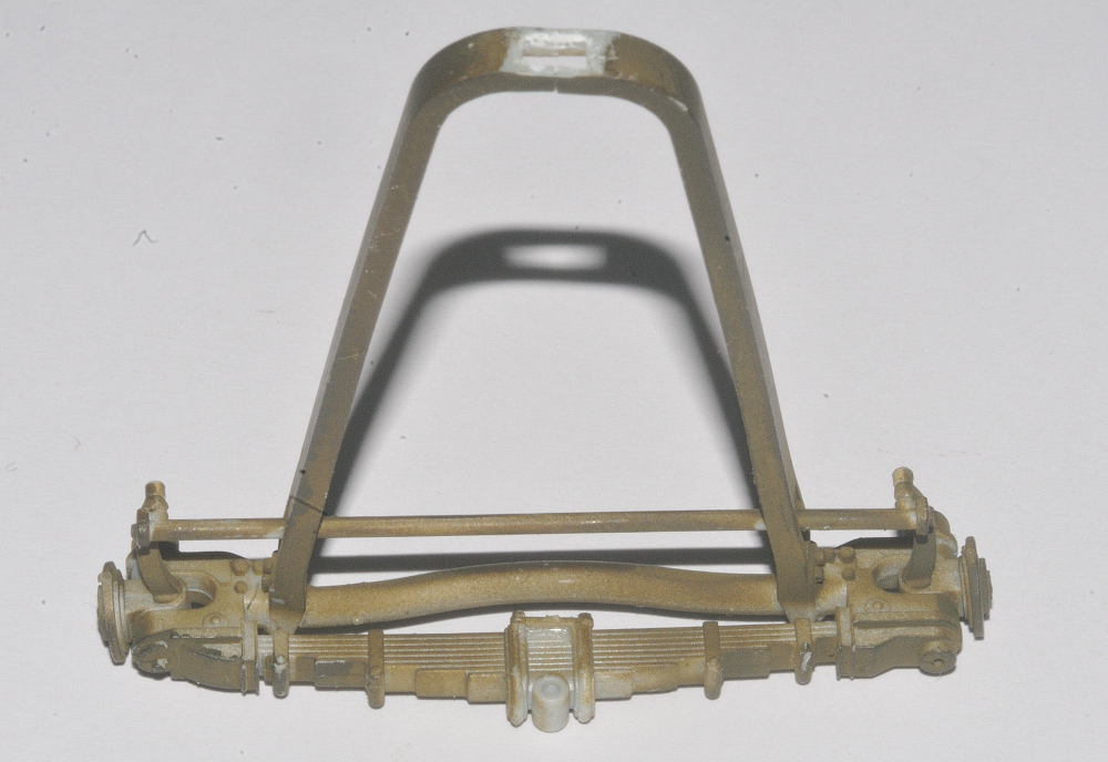

Finally check the front pivot point on the front axel is central, mine is over 0.5mm out ( its the hole at the bottom of this picture) I didn't move this but i did move the bit that fits in this hole to compensate
You can centre most of the cross bars, for example if its 1mm out just shave .5mm off one side and pack out the other side by .5mm
With care you will end up with everything centred and symmetrical like this
I can now proceed. The gear box still doesnt fit but thats a fault with box itself and not an alignment problem to do with the above
Sorry this is a bit boring but it may help someone else building one of these :)

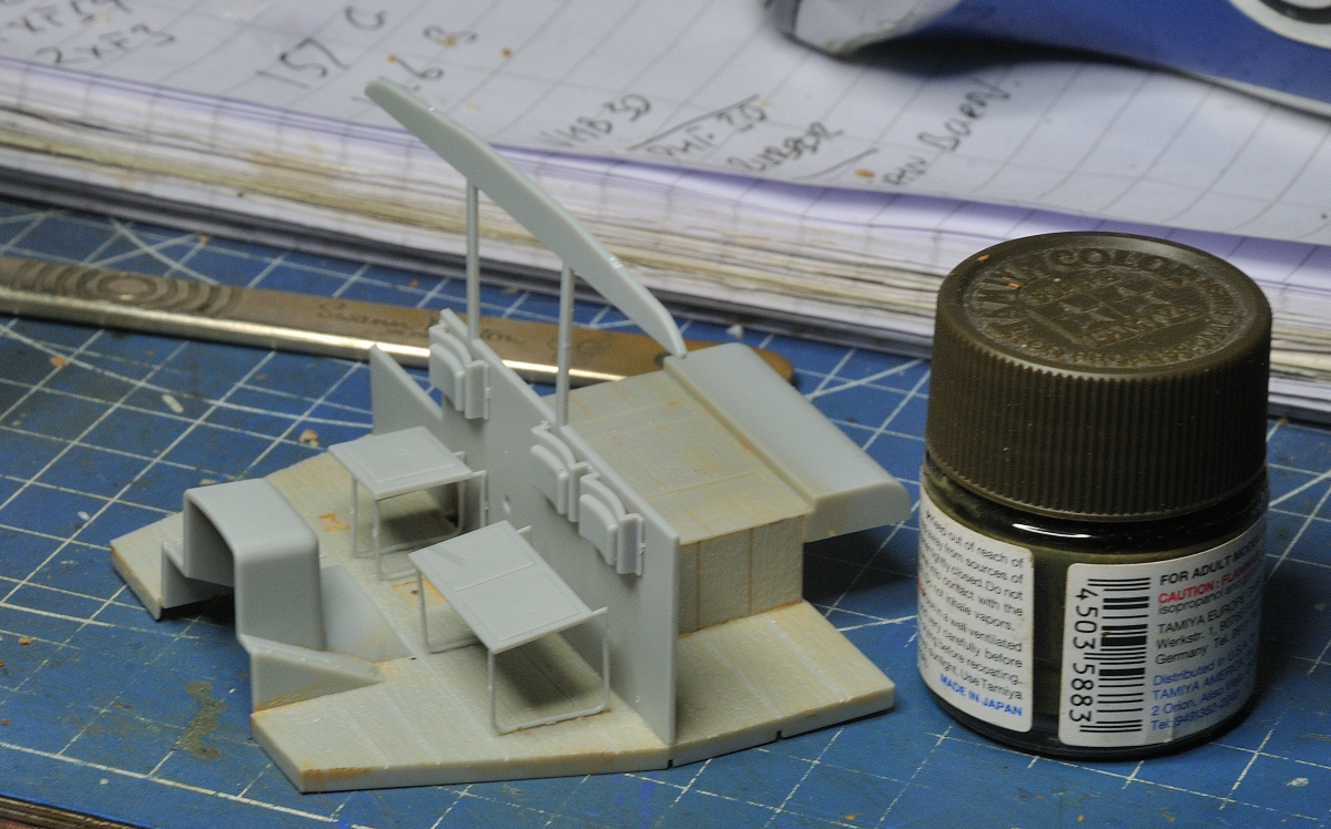

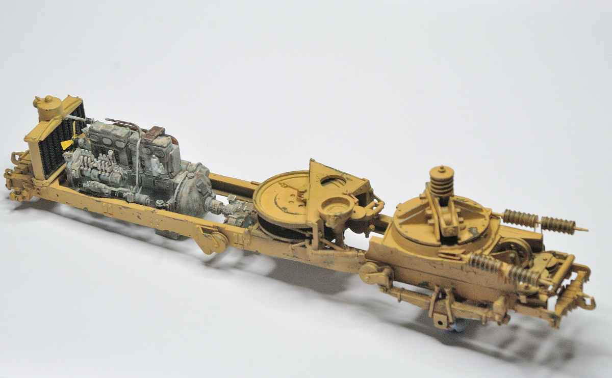

By way of a change i decided to to do a bit on the cab
you can see its quite large from the paint pot

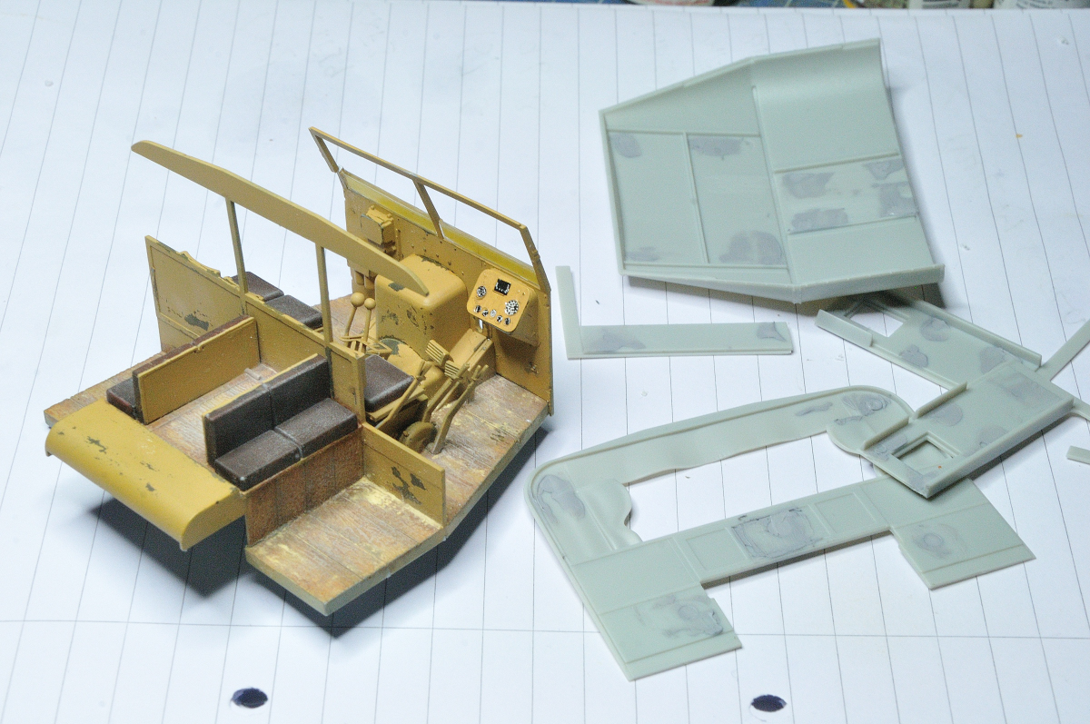

However i now find that its impossible to attach the back of the cab now, the instruction sequence is wrong and it should have been attached to the floor before the rear set assembly was fitted. Without trying to unstick the whole thing i will have to cut the rear panel, fit then re-join and fill. Picture also shows some filling of ejection pin holes underway as well :)
