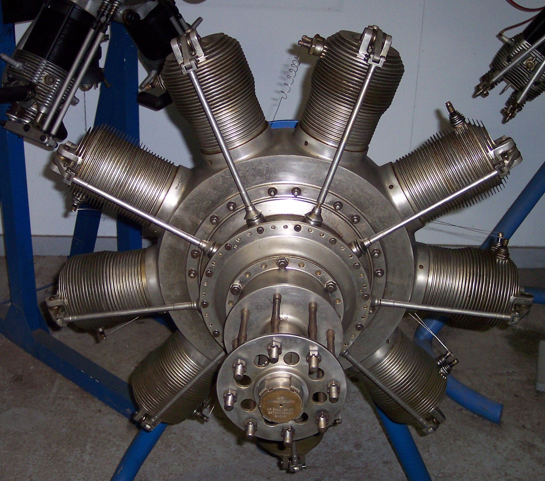

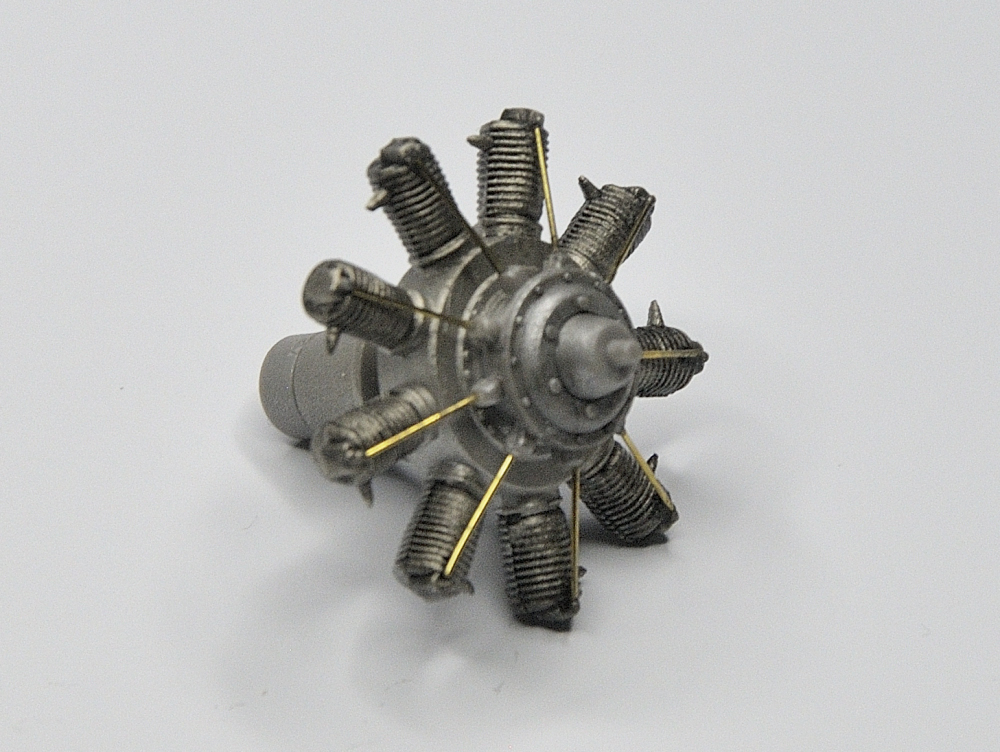

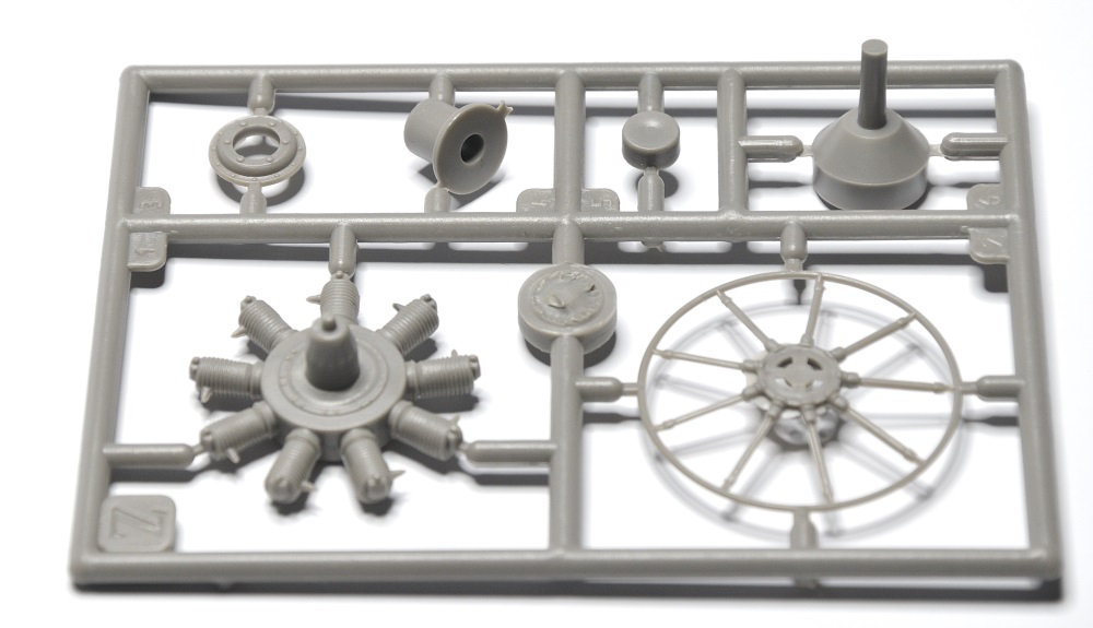

The engine is really simple, i found some pictures of a Gnome rotary, remember a radial has a spinning crank and a rotary has a stationery crank so its understandable that you don't want ignition wires and other parts spinning round at 2000 rpm :)

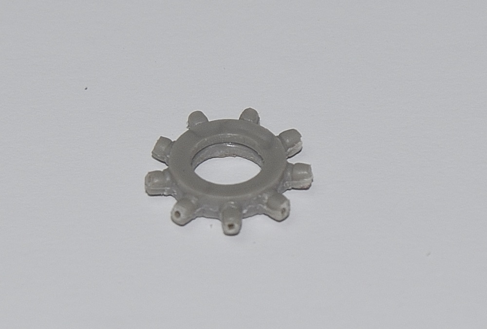

The kit motor is just 6 pieces and you don't use one of them
All i have done is drill out the push rods and added Nickle replacements

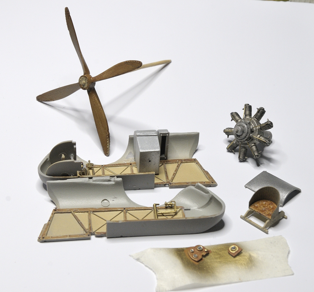

To get over the ejector pin marks i chiseled them of flat then covered them with Tamiya masking tape sections to cover the damage , then washed the masked parts with a doped linen colour wash so the masking take stays and is also held in place by the .3mm nickel rigging wire diagonals and its own glue..
The seat is PE and the wood is oils brushed to give a grain. Brass is alclad polished brass.

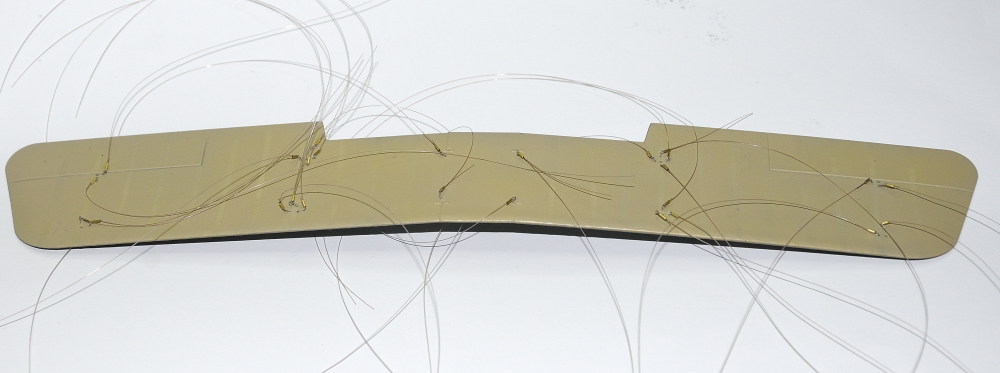

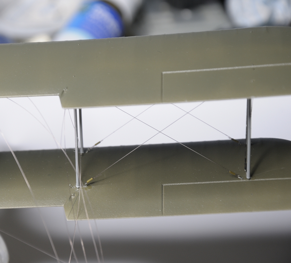

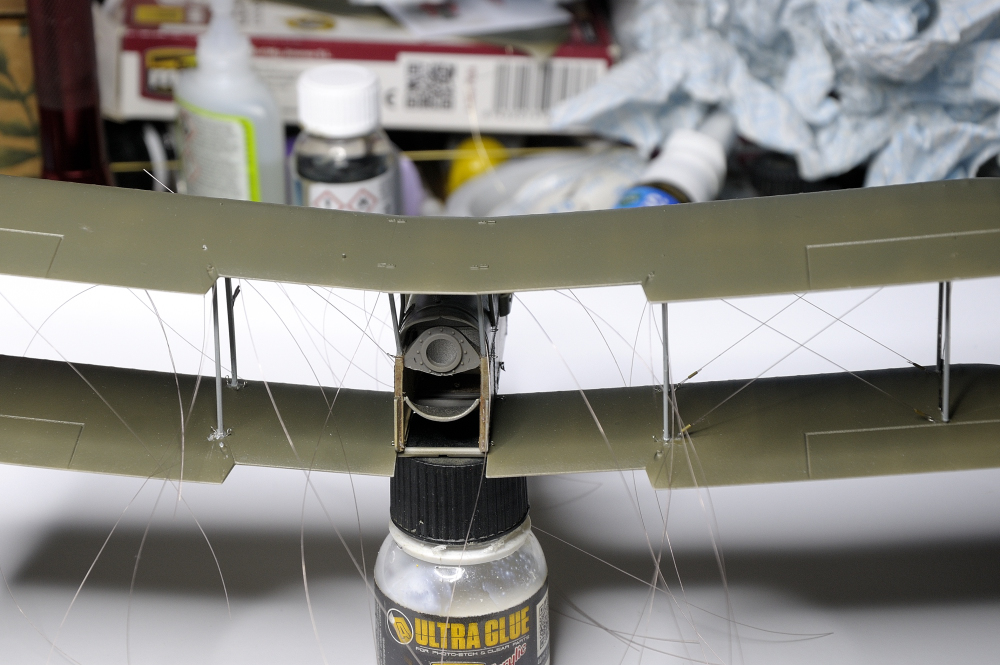

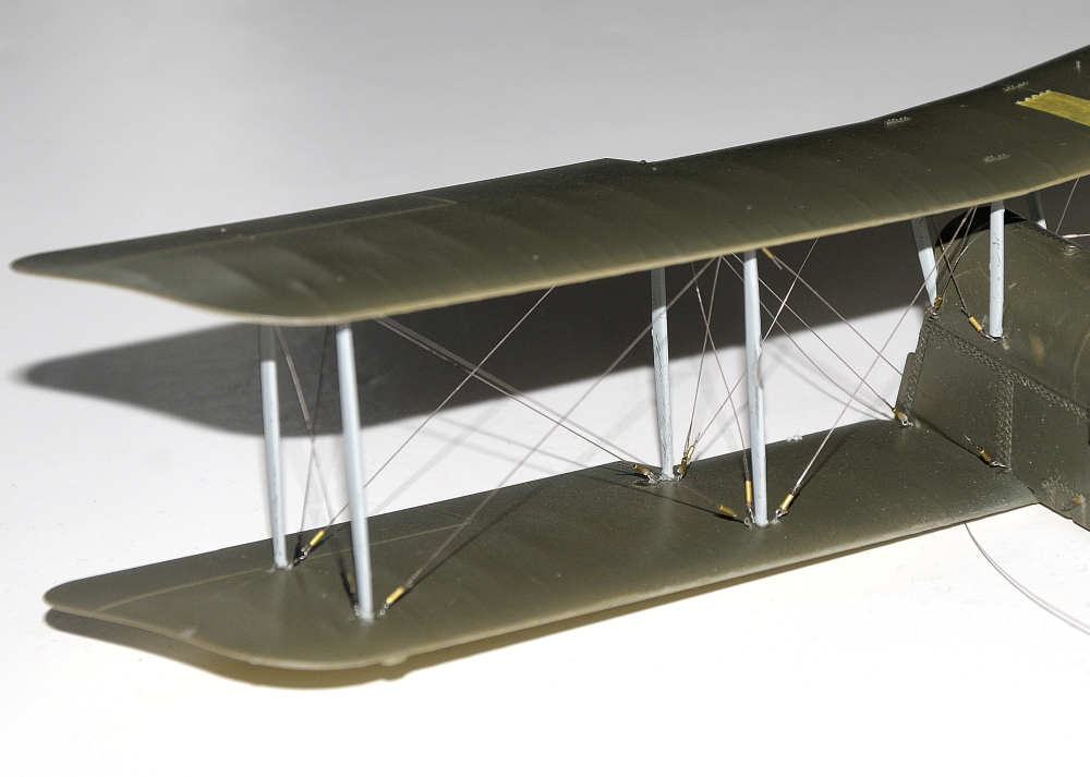

I have started the rigging and gone ahead and finished one section to be sure this method will look ok and is actually possible. It takes forever as its all tweezers and threading line through tube but it seems to give an acceptable finish. Once done i will probably do the lines and fittings black
