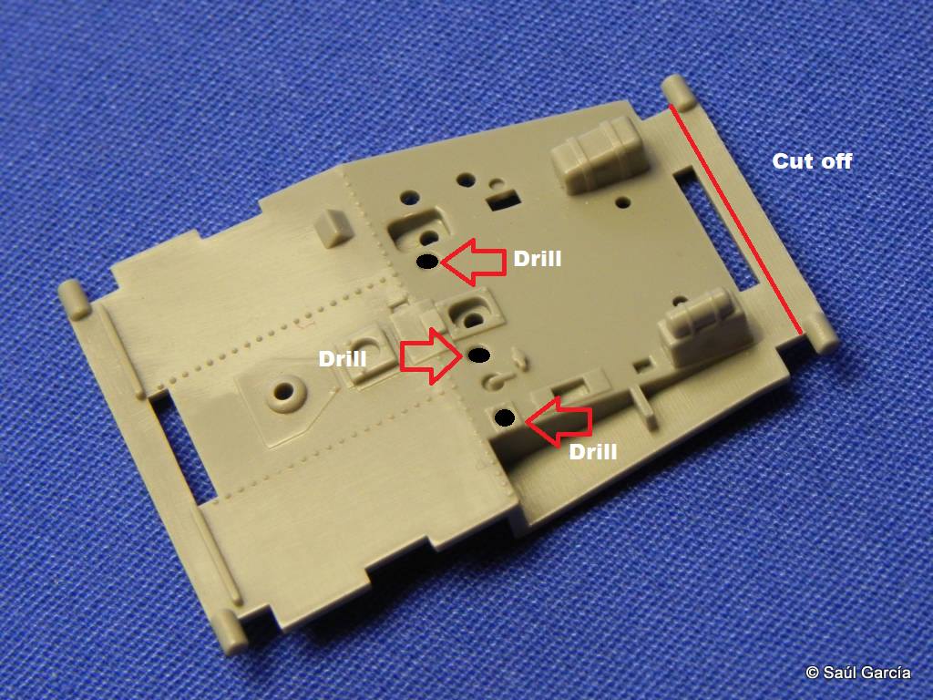

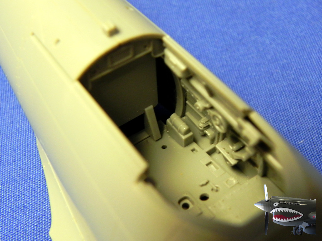

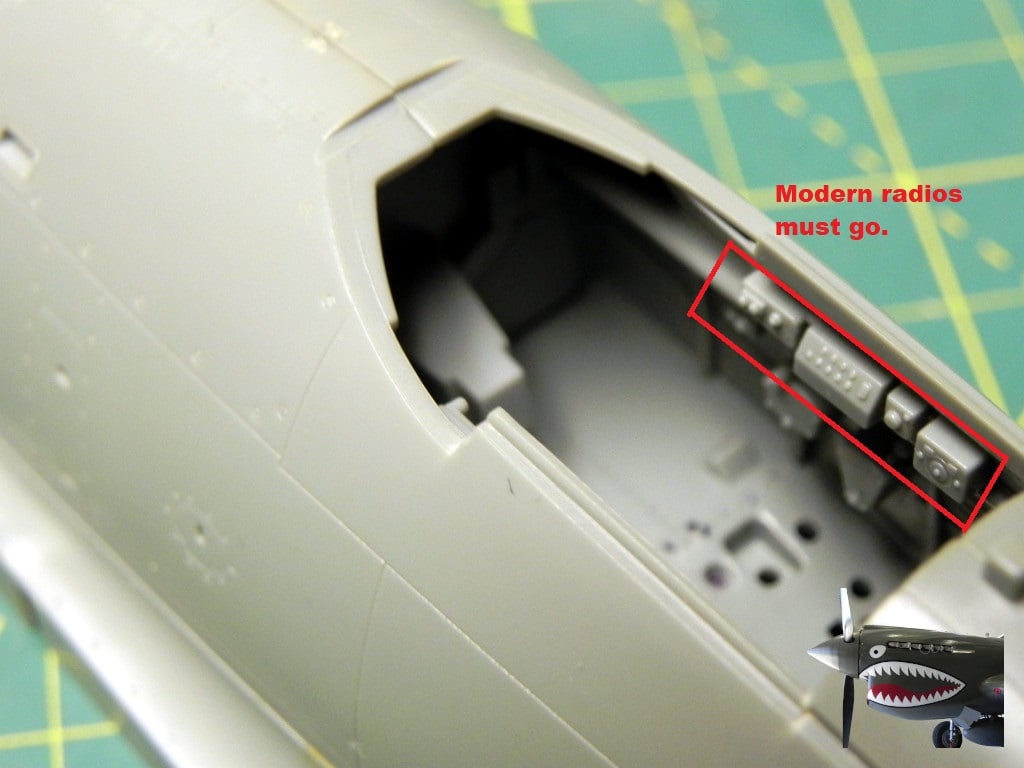

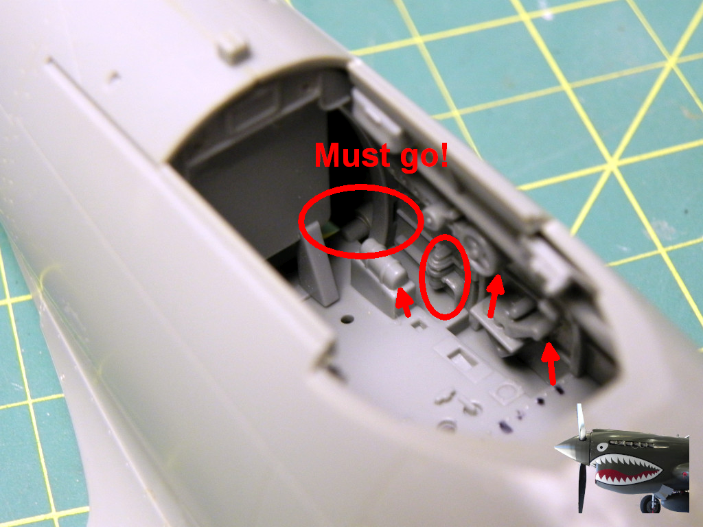

The rear anchors (on both sides) are visible, even with the seat, so they must go. Simple job to glue thick strip from below to locate the cockpit securely. Other items need to look separate and are indeed visible.

I guess it depends on what you want from the hobby.
My joy comes from pushing my limits as to what I can replicate, the "see and copy" part. After detailing, then it is the markings. I enjoy the scratch-building and detailing the most.
Regards,

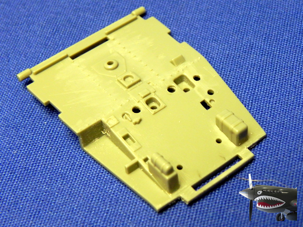

Still in progress... things must go!

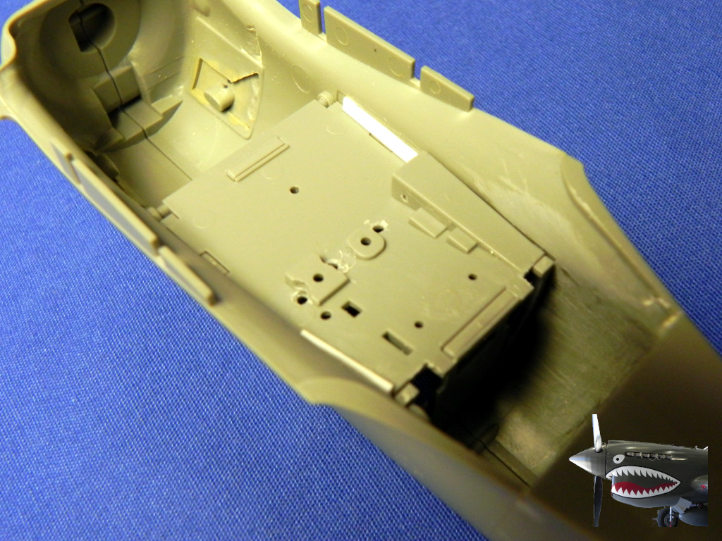

Strips to hold floor in place after to removing the rear mounting lugs.
See? The mounting lugs are no longer visible!
Yes, I actually removed half of the oversized domed rivets from the cockpit floor!
Regards,

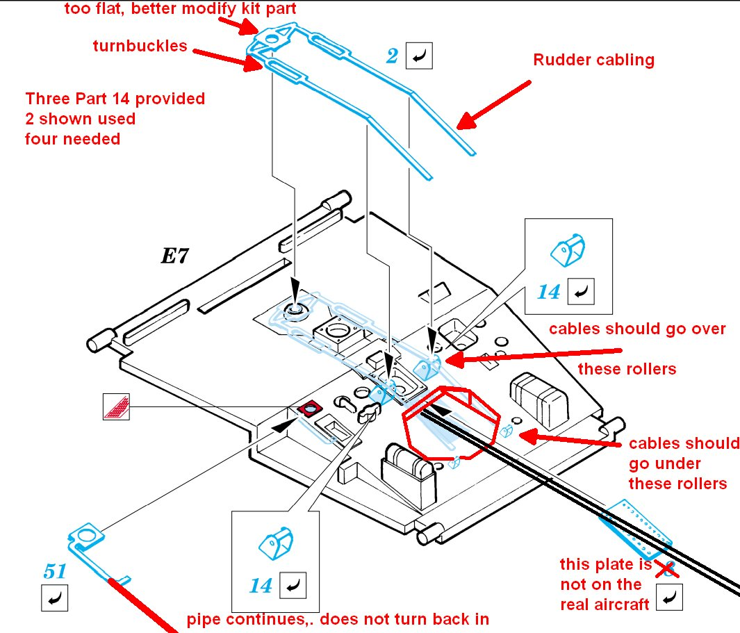

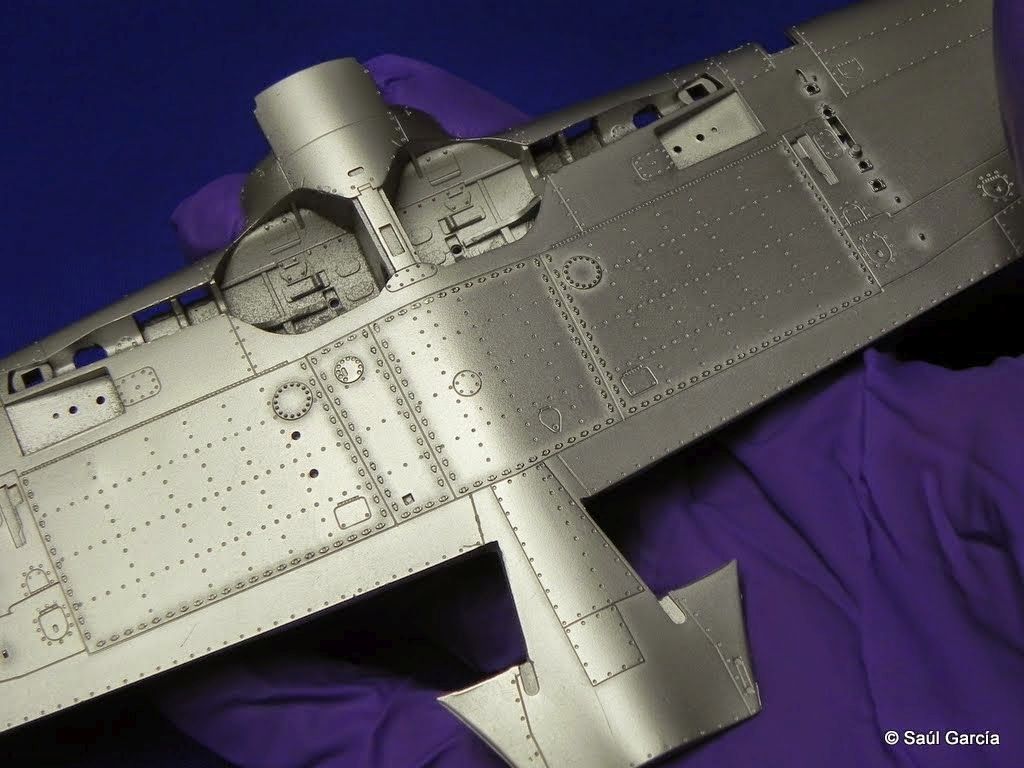

The problem with so much PE is their using flat metal to represent items that are either tubes or stand out more. So, I end up correcting the correction set or detailing the detail set. This is only a portion of Eduard's step one. Eduard provides three of Part 14 (rudder cable rollers) but four are needed in reality. Eduard decided to only provides what is visible (2) and one spare. the red octagon is a hole underneath the pilot's seat (visible in some photos) through which the rest of the control cables feed through to the rear of the aircraft:

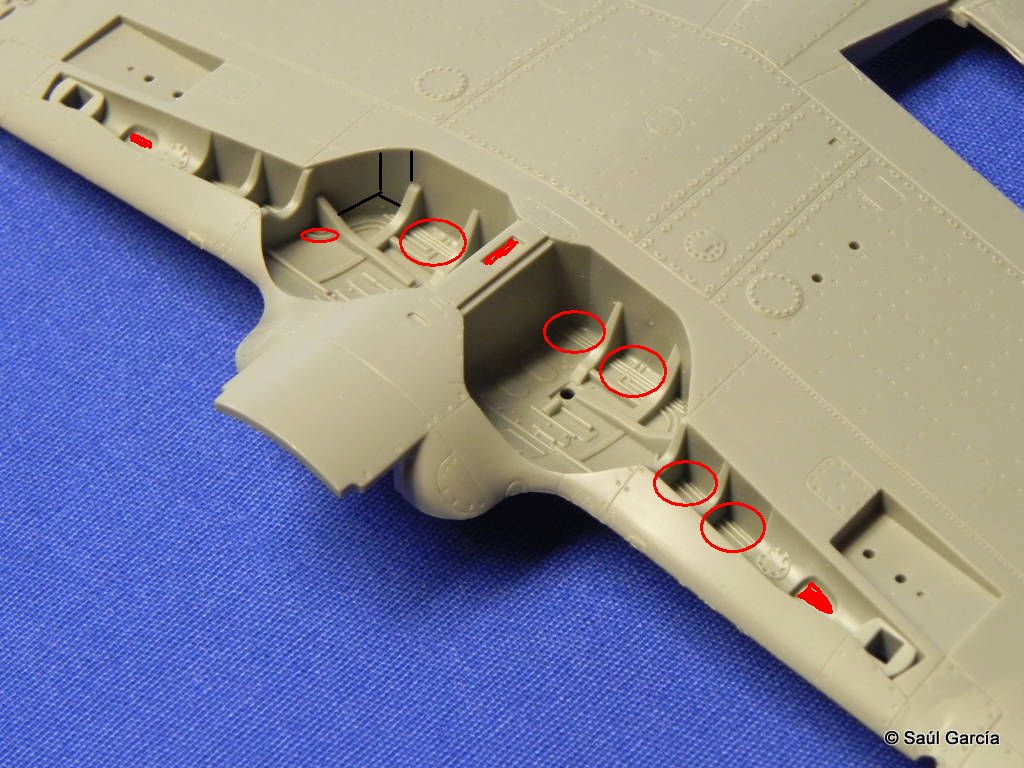

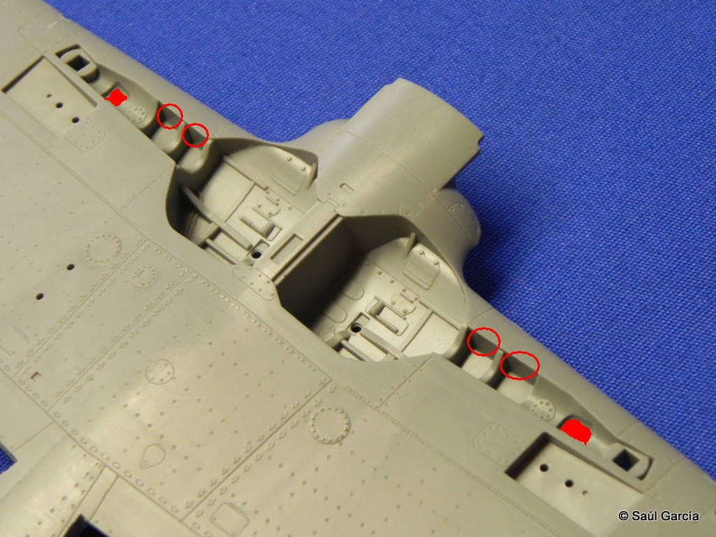

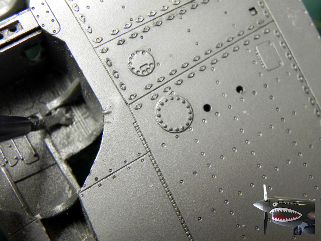

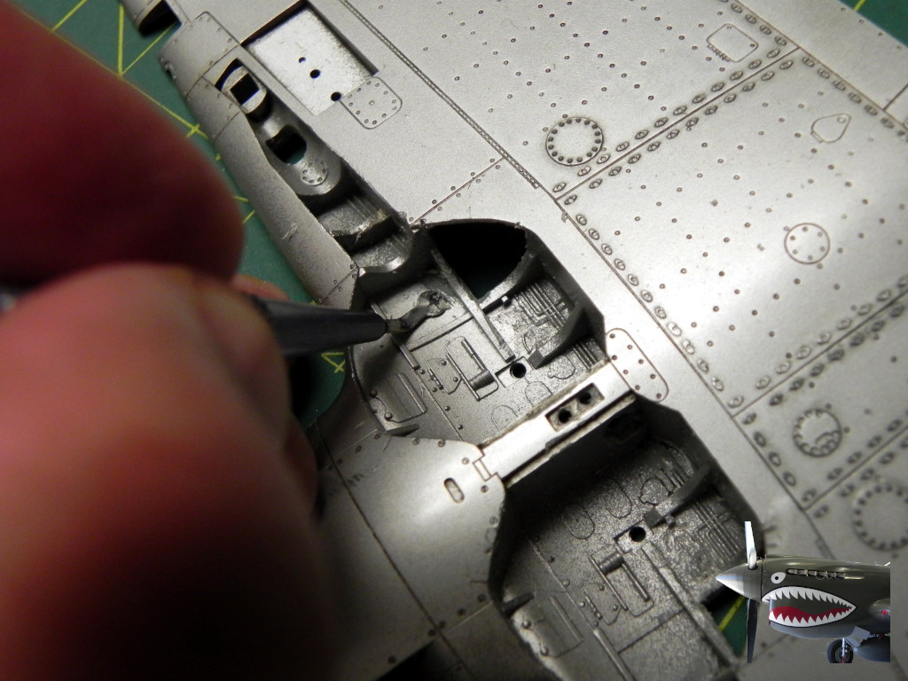

Sometimes I see things that make my to-do list longer.
Circled cabling to be removed, black lines show that the wheel bay extends deeper and is squared off. Red areas need to be opened up.

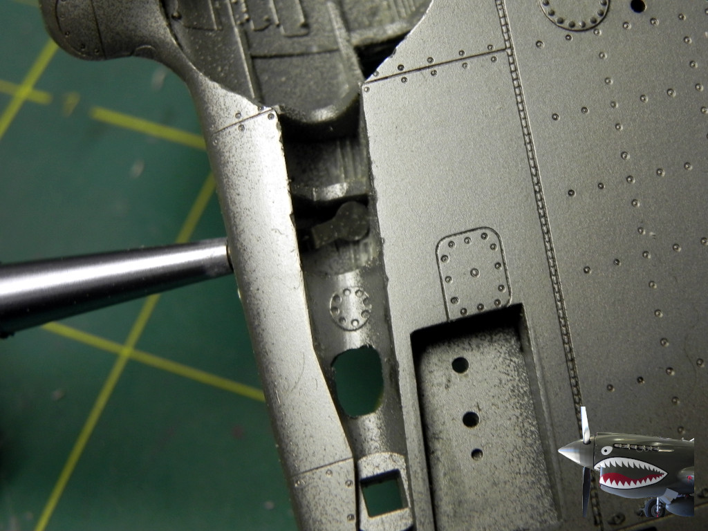

compare to original without my scribbling:
Circles show where openings need to be added and red areas as well (from previous scribbled photo):
Here, they have been opened:
Regards,
