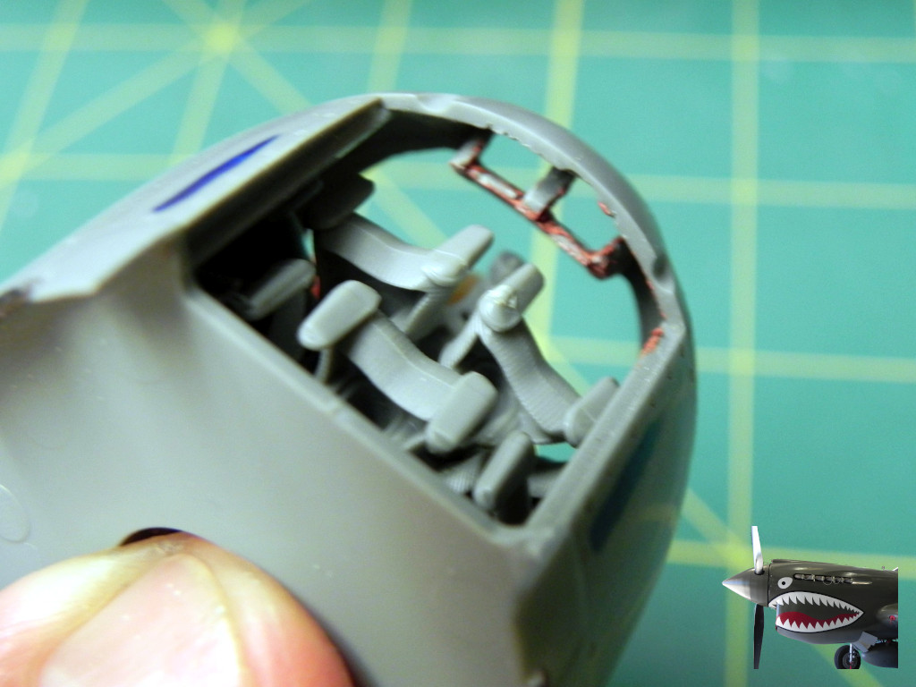

...and counting. Pulled out some small scale Airfix Mustangs for the March Miniature Madness 2023 but this called out to me instead so In finally fixed it.

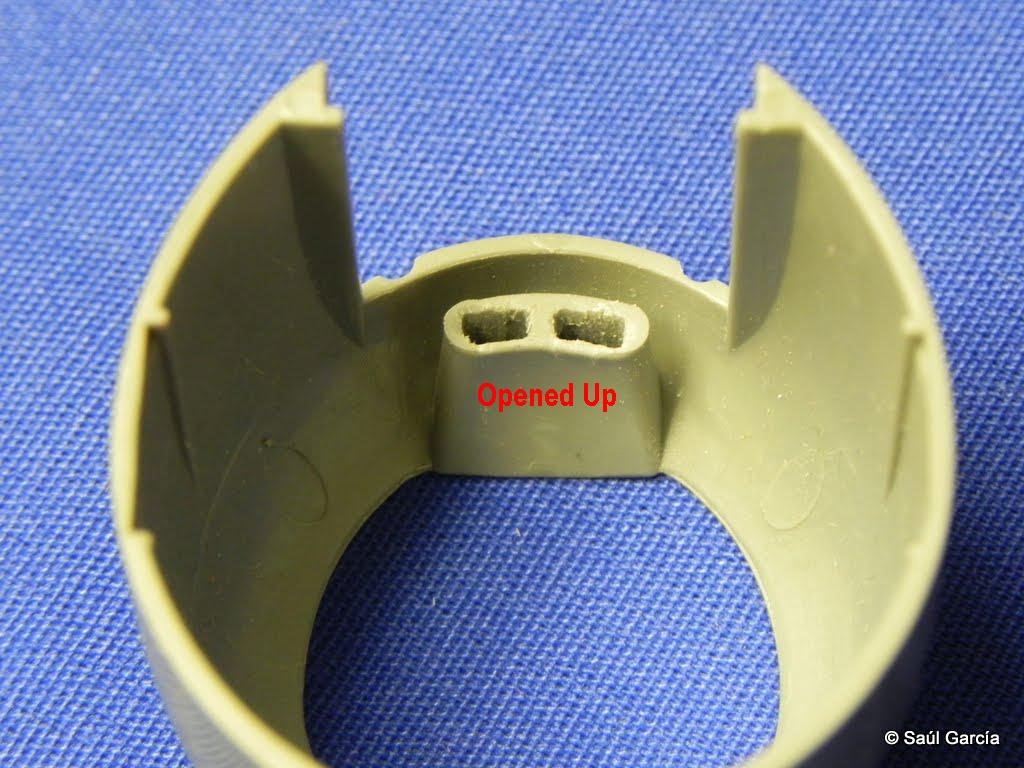

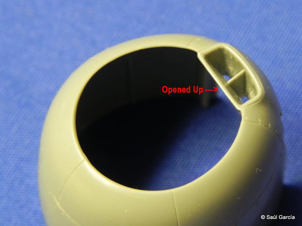

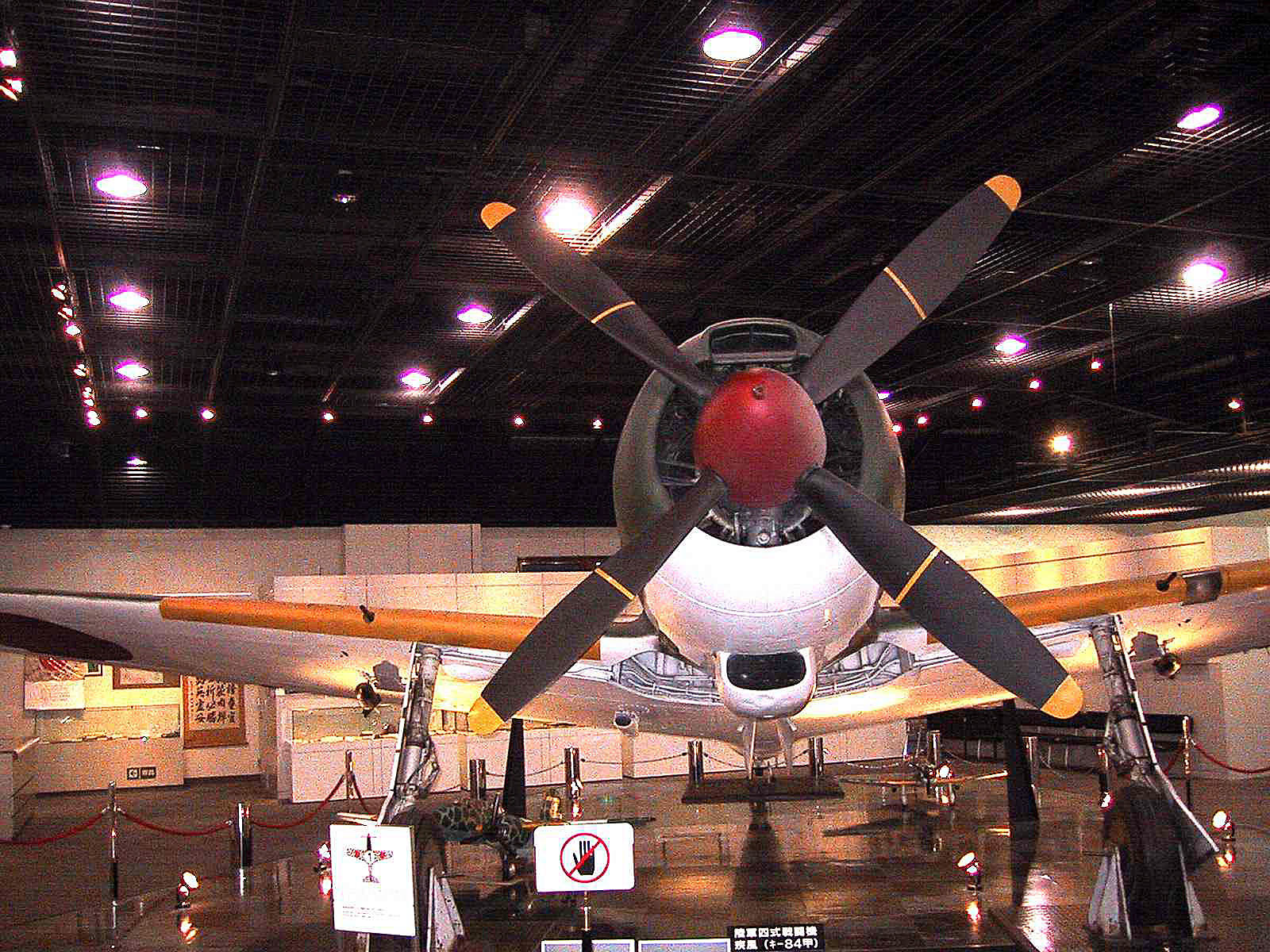

In 2011, I opened these carburetor air intakes but then realized they aimed directly at the radial's cylinders.

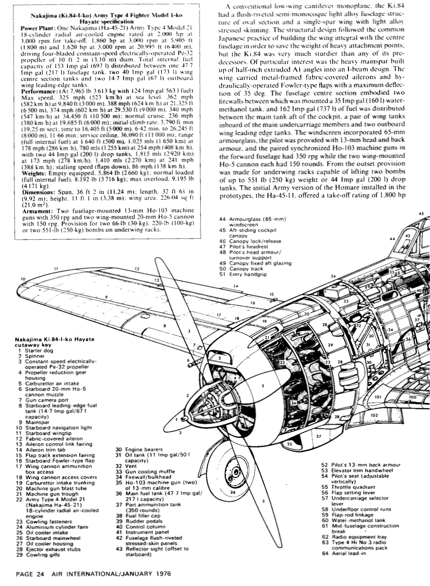

Referring to the TM illustrations and the panel line of the scoop, I noted that the intakes should swoop upwards with no roof as the scoop panel top is that...
Number 19 on the cutaway. Source is listed as Air International, January 1976:
I guess I will need to take more photographs before it makes sense.

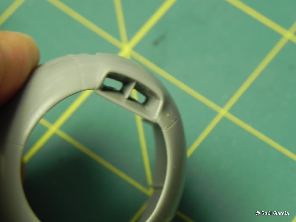

I ran into that same issue on the Wildcat years ago. the scoops were represented in the face of the cowling but if you wanted the duct work you'd have to shave the cylinder heads. Guess we need scale thickness cowl panels huh?

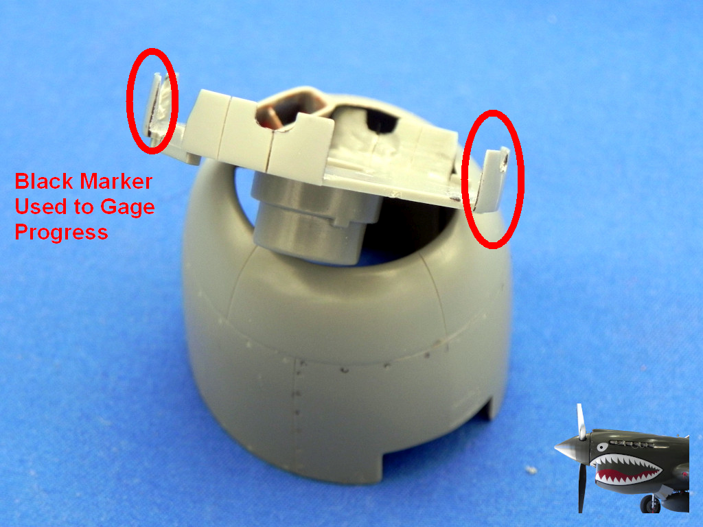

The intakes didn't go upwards at all. They should have in order to clear the cylinders. It is the reason for the 'hump' in the cowling.
Saul I have done things like this and they can tend to bite me in the can. You can do it. In 1/72 all you really need to do is thin some things down a little and make it "look" like it goes where it needs to go.

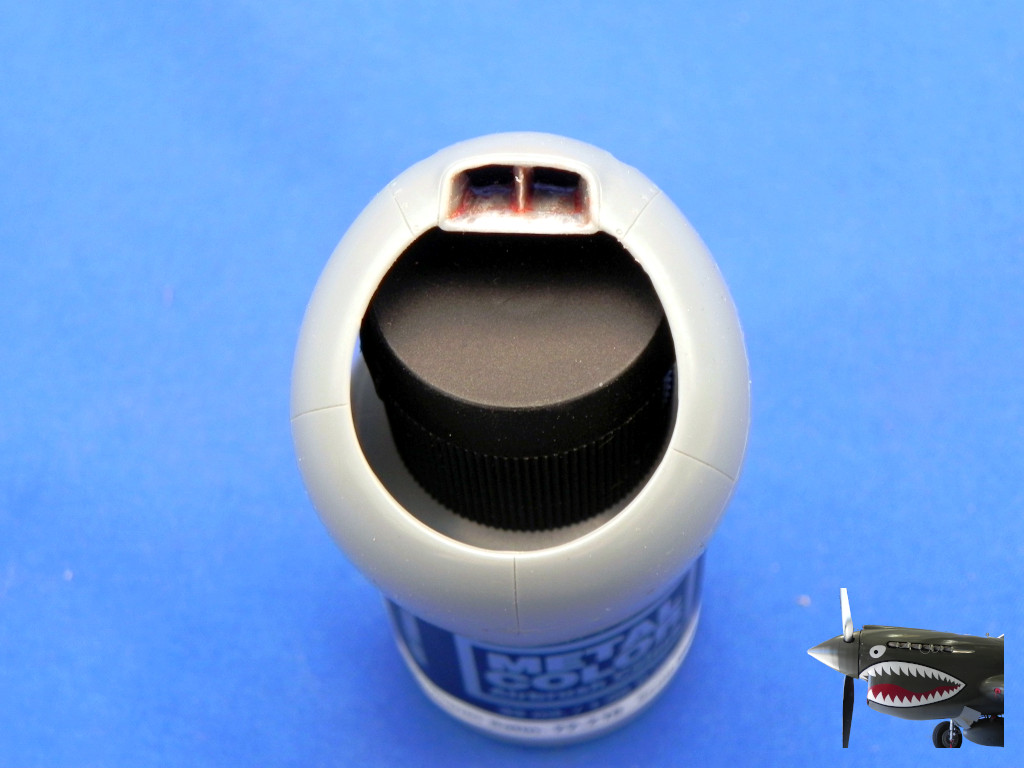

Being 32nd scale, I need to let people look into these nostrils as well as behind the thinned cowl flaps.
The intake now clears the cylinders:

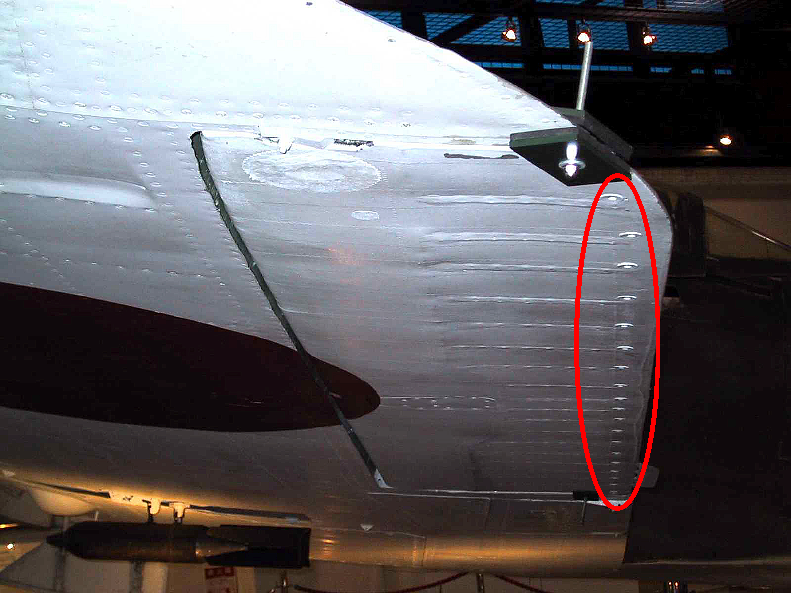

I also drilled out the seepage holes on the ailerons and added the grommets and seepage holes on the elevators. Hasegawa included the grommets on the ailerons but replicated rivets instead of seepage holes.
This is what I am referring to:
