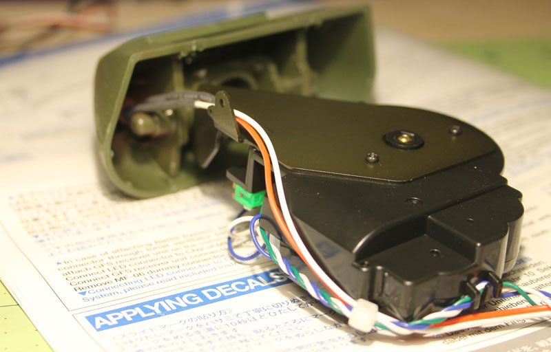

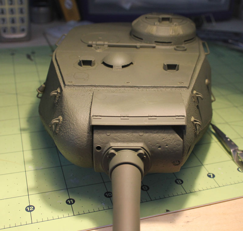

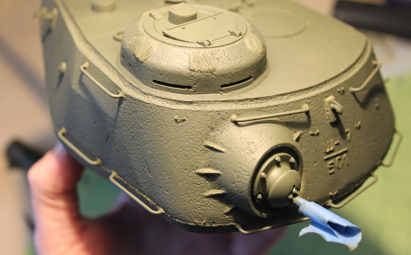

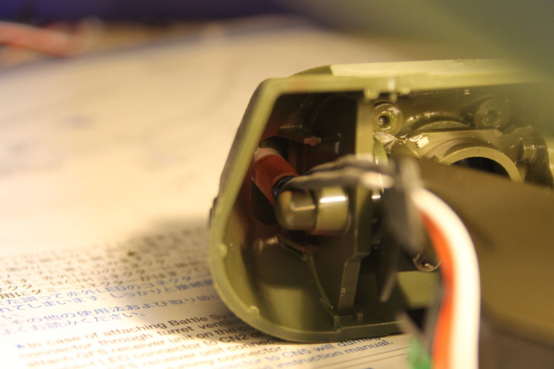

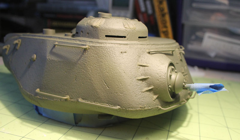

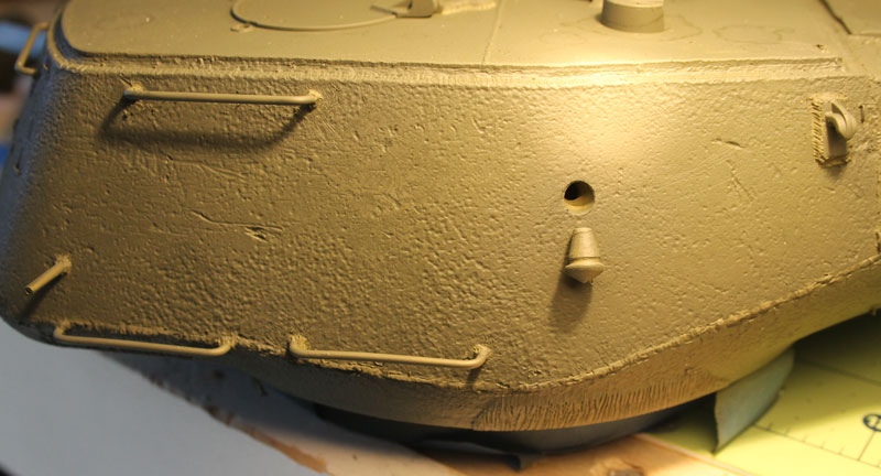

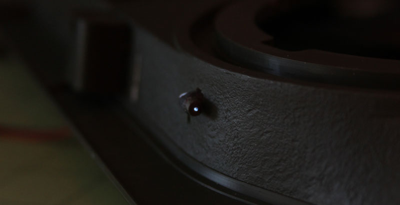

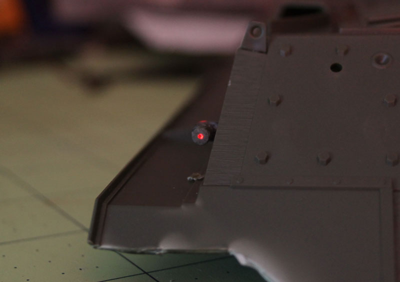

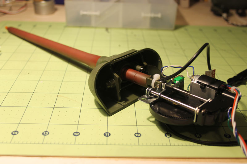

I had to figure out how to get the IR emitter into the mantlet on this one. There's a beautiful open sight hole, so no butchery is necessary, but unlike the other types (coax MG), this mantlet is anchored on the inside and pivots over the turret, so the emitter tube had to fit through the turret and not interfere with the elevation pivot.

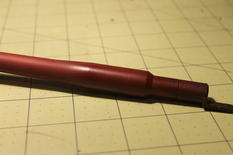

This is one of their best recoil setups, nice thick colllar in ABS, huge nicely cast aluminum barrel.
I primed the barrel with Vallejo Red Oxide, then coated with Future to give it a scratch resistant surface for recoil.
I weighed the barrel and installed.

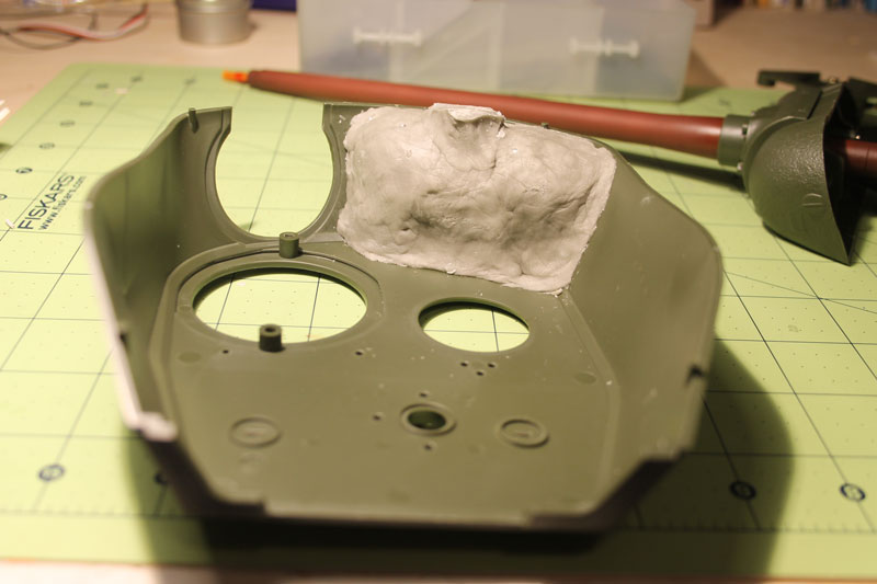

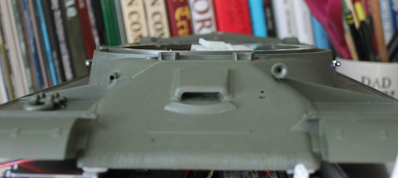

At 72 grams, I decided to use a counter weight in the turret rear, doubled the weight in steel BBs and mixed it into Aves.
