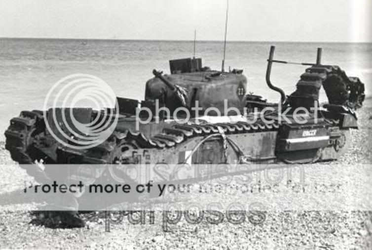

OK, research time. I was looking at Dieppe through the Lens again and I noticed tha between 7 Dingos, they have three different tyre types!
They are:
'S' Type (same type as supplied by Tamiya):
HORACE
HELEN
HARE
Chevron type (where the Chevron porms a classic 'V'):
HECTOR
HUNTER
Staggered Chevron (where the sides of the 'V' don not meet, but are staggered)
HOUND
HARRY is unkown, as I can only find the one picture taken from the right rear corner and the right side tyres are burned away
