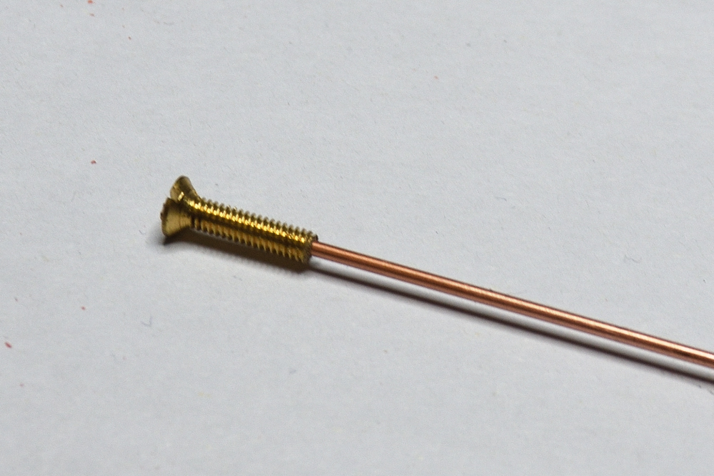

I have found the way to build these kits is ton use the screws to hold it all together than remove the screws one by one and replace with a super glued MFH alloy hex head and stem. What they call a hex head rivet. even now screws left tightened over night maybe loose and in a cracked fitting over night. I have solved this to an extent..... the screws supplied at mostly countersunk but the holes aren't so as you tighten the screw its acting like a wedge in a log and splitting the plastic so i have bought some 1.4mm flat head screws , not countersunk and that has greatly improved things.
Happy new your to everyone here :cool:
I'm a fan of Loctite on screws but I really don't know if it will work in our world. I don't think a touch of CA would help, too brittle. Sounds like you got the fix though.
:popcorn
If they were machine screws I would have probably bought taps and pre-threaded the holes. I guess these are like mini sheet metal screws though. It probably could be possible to make some kind of tap for these as well but what a pain in the can.
You can guess the price of a good quality 1.4mm tap :) probably more than the kit .....
I have some std quality and they act like reamers giving a perfectly smooth hole as as the cut and strip their own threads : 😂
As i say the real problem is actually the kit is designed to be metal and the plastic parts just dont have the strength or wall thickness for threads.

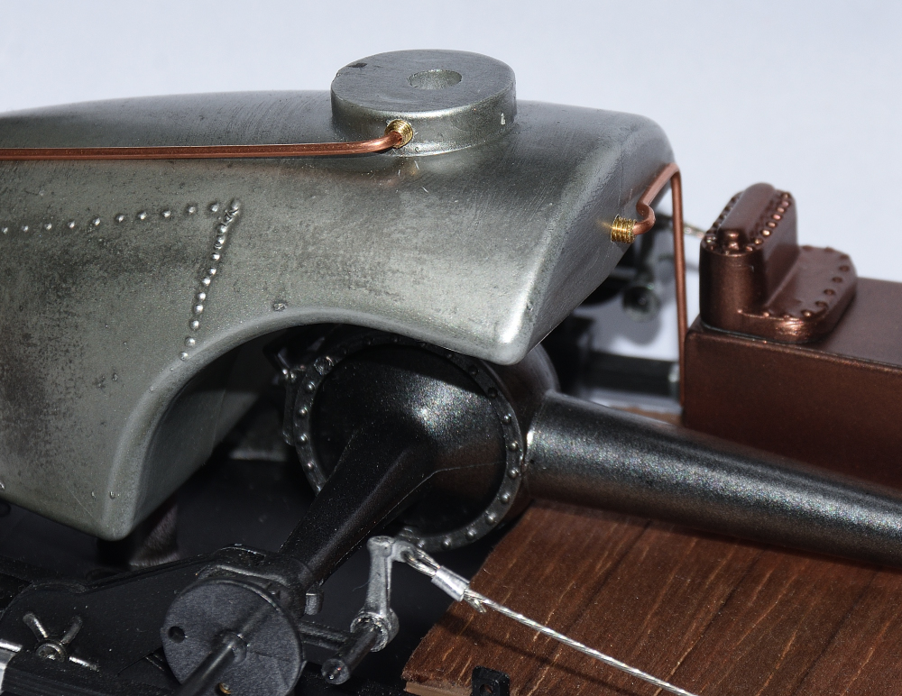

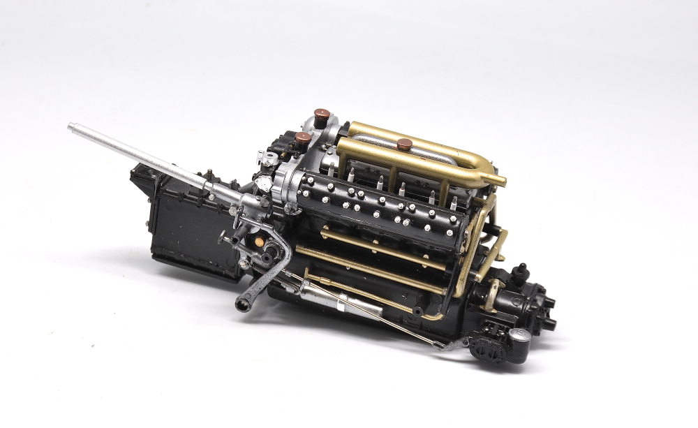

I have made up a mount for the magnetos and put the left side plug leads on and connected the magnetos to the camshaft drives.
Its actually been the most difficult part of the build so far scratching the leads and bracket and the reworking of the magnetos themselves. Only problem that needs addressing before i do the right side is the bright colour of the leads themselves.

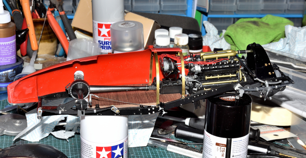

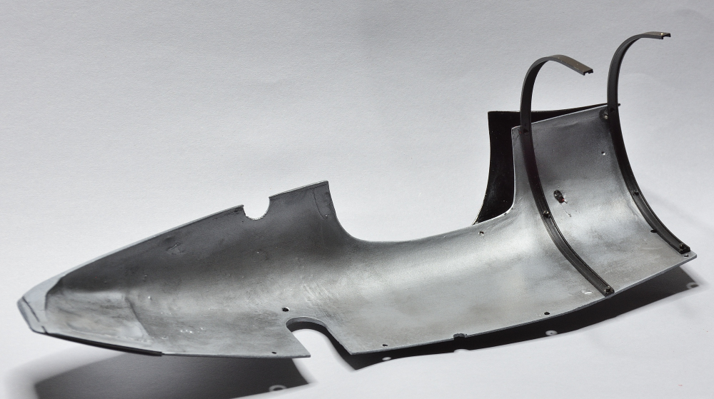

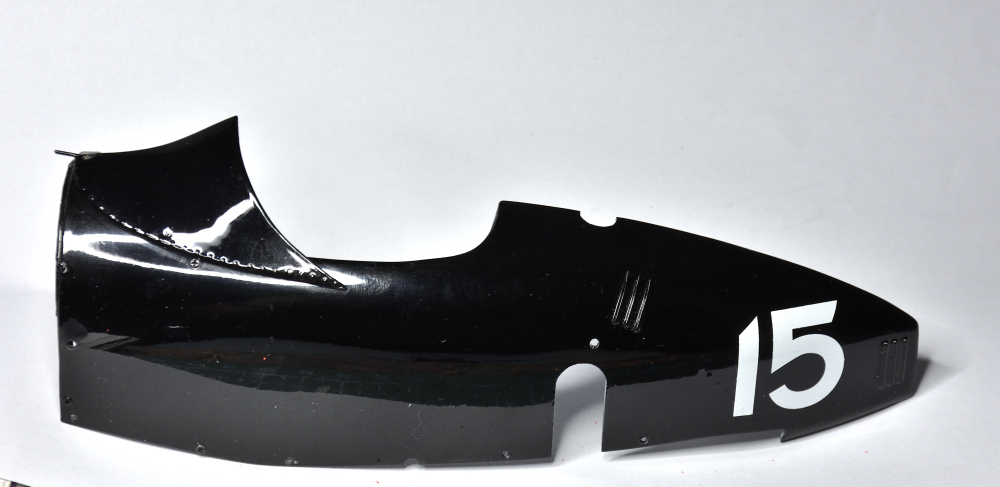

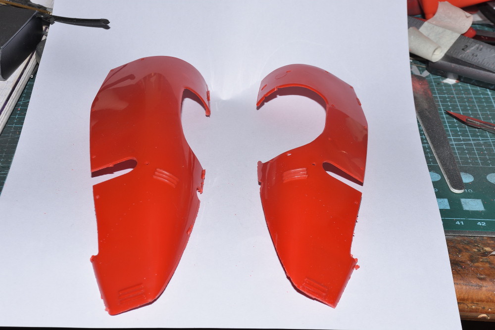

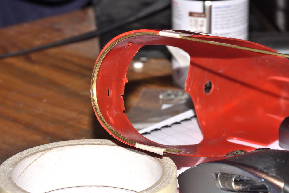

The reason i am messing about with bits that will not be seen is i have decided to build this as a cutaway. Originally i was going to just leave the body off and display it separately but that just takes up twice the shelf space. so now i am thinking i will cut the body right down the centre line.
It throws up its own problems like the instrument panel is mounted on the half i want to cut off.....lol :)
I hope this will work.....there is no turning back now :).............................(without a lot of glue )

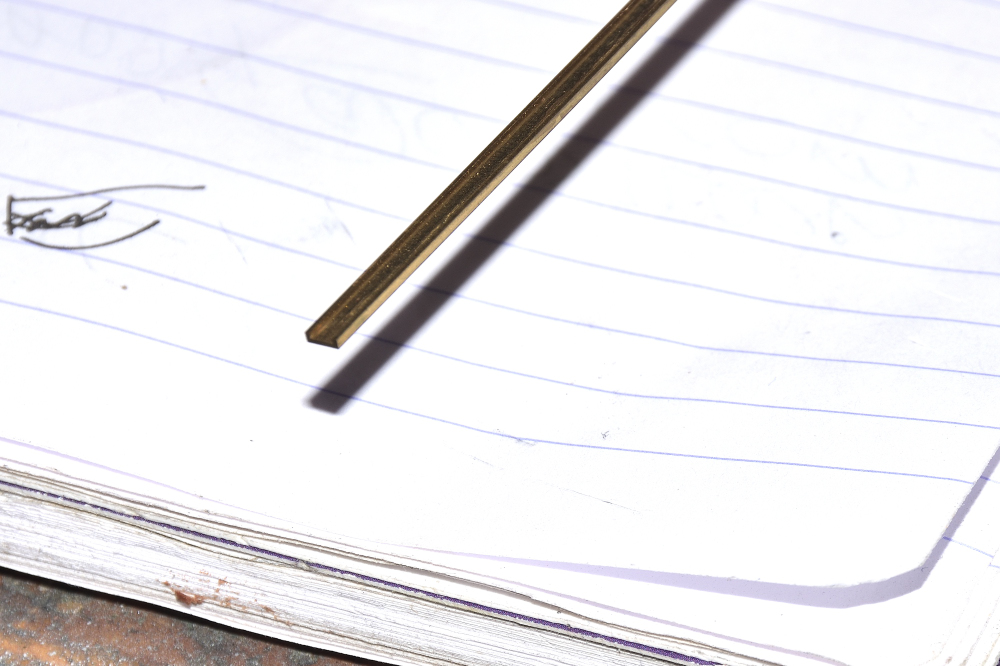

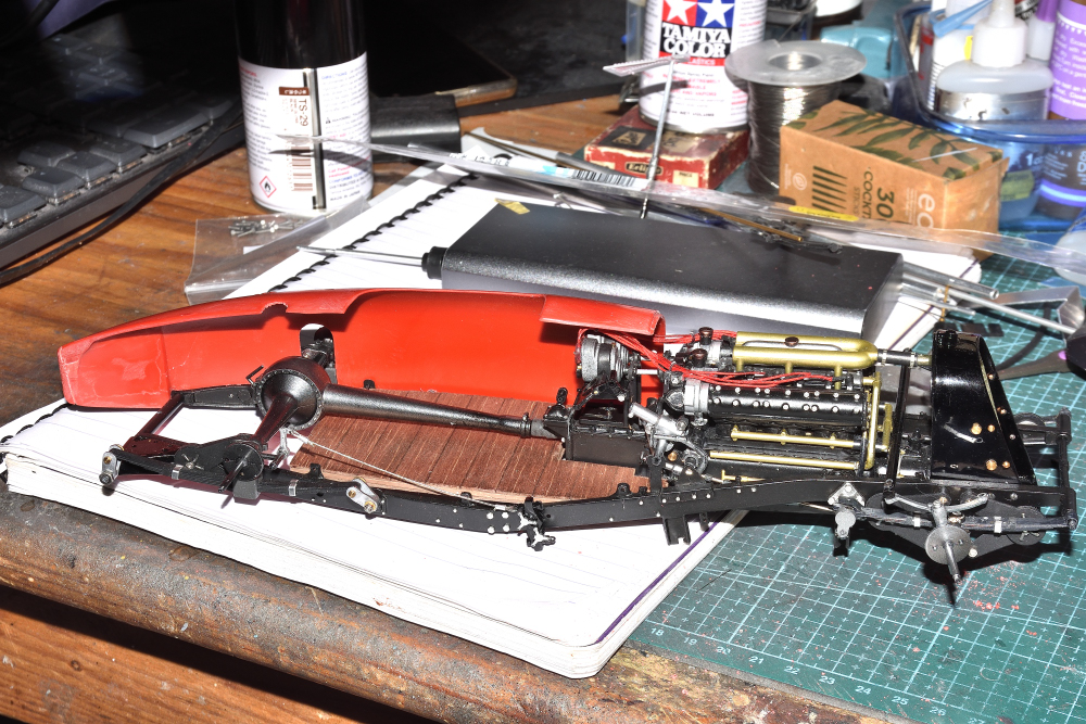

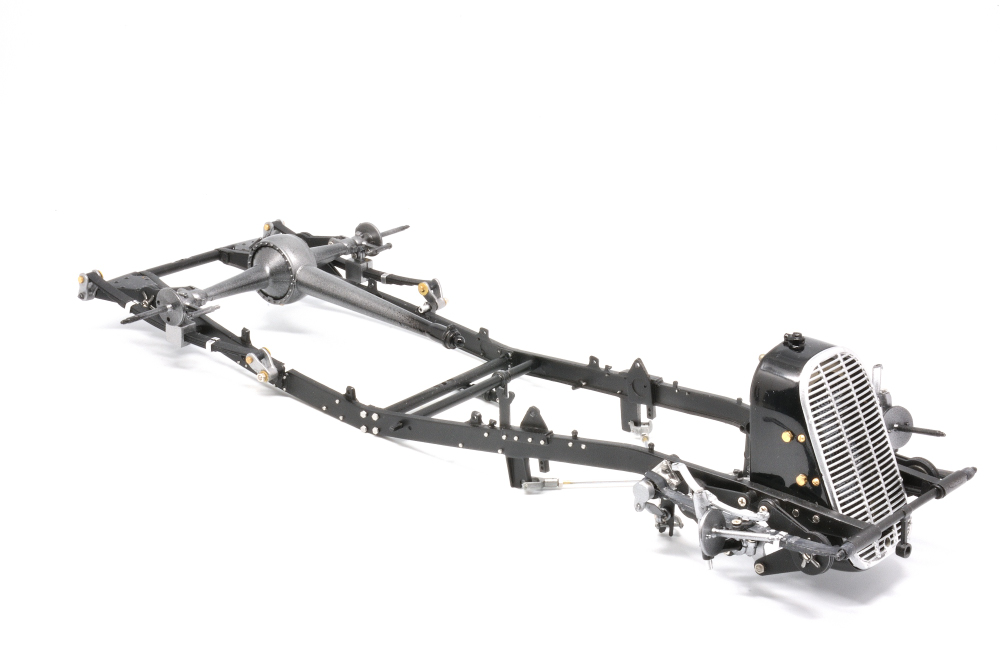

The project will need a frame . I dont know if it had one in real life, no one does but its going to get one now as i need some sort of base to build on from now on. I got some U section brass from the model shop, a bit of a gamble as i didnt know if it would bend, some brass is very crisp and snaps but i got away with it quite well
somehow i have to fix it the chassis and the half body now
I think its called winging it :)

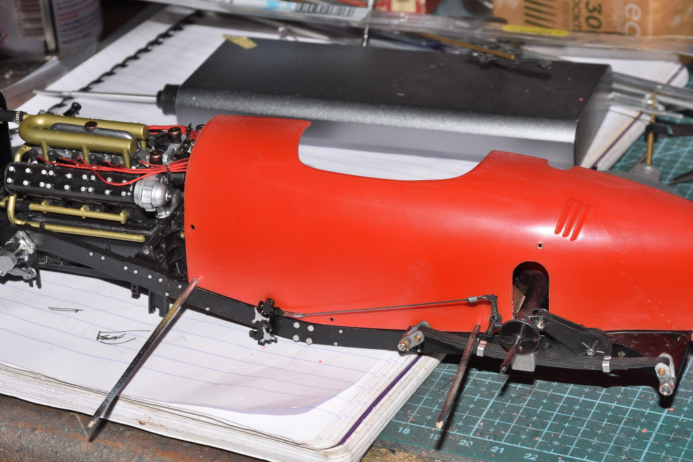

So this is a first pre build to see if the parts fit
I dont think i can leave body frame brass. it looks ok but they would never have used Brass for a job like this so as its a continuation of the Chassis i think it will be semi gloss black . The interior panels will be aluminium finish, they probably would have been black but using artistic licence :) i dont want to turn the interior in to a black hole you need a torch to peer into :)
i wish i had bought a couple more lengths o the brass channel and i could have made a third frame look behind the seat. its a 70 mile round trip to the model shop so i will see if i can get a length on line.
