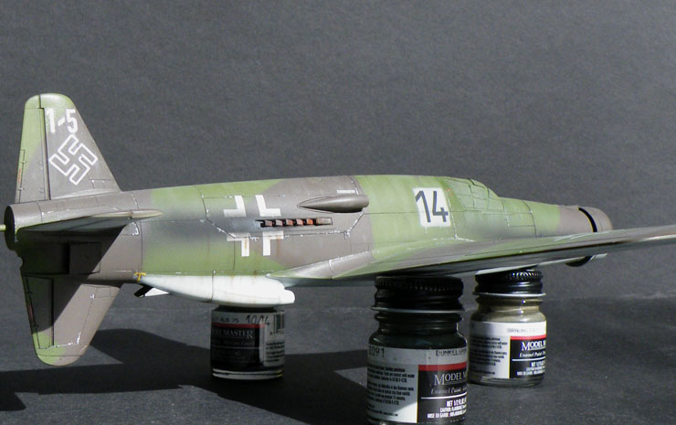

The painting of the splinter camouflage is now finished and here is how I did it.
The first step was mixing the colors needed...I use Model Master enamels but their Luftwaffe shades of paint are pretty far off the mark in most cases and in the case of RLM 81 and RLM 82 they are WAY off the mark!Mixing up passable looking RLM 82 is easy and have done it many times before but RLM 81 was a totally different story, RLM 81 is nearly impossible to pin down exactly what color it was...it has been described as a dark green color in some publications and in other publications claim its a brown color(s). Even the various paint chips that I have show variations in RLM 81 so what version do I choose for the Do 335?

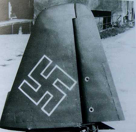

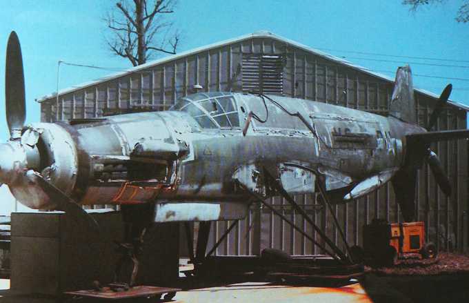

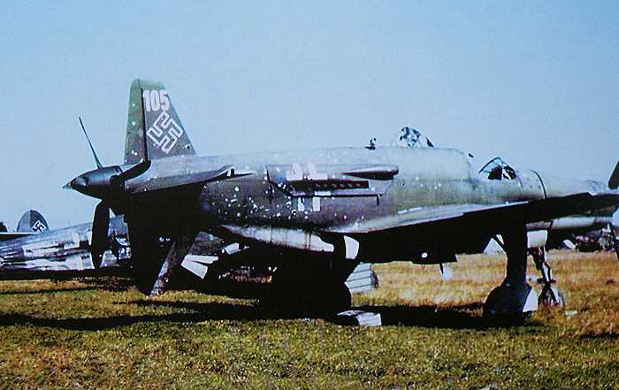

What I ended up doing is looking at the color photograph of W.Nr.240105 that was taken shortly after the end of the war and compared the colors on that photograph to the color chip pages and tried to see which one of those was the best match for RLM 81. After looking at things outside in natural daylight the color chip of RLM 81 from the Merrick book was a very close match so I used that as a guide to help me mix up some RLM 81. Normally color photographs from the 1940's are not that good for judging colors but in the case of the color photograph of W.Nr.240105 it has both good color balance and lighting and on the top fin and rudder RLM 81 and RLM 82 stands out nicely.

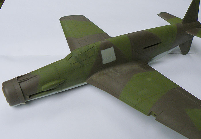

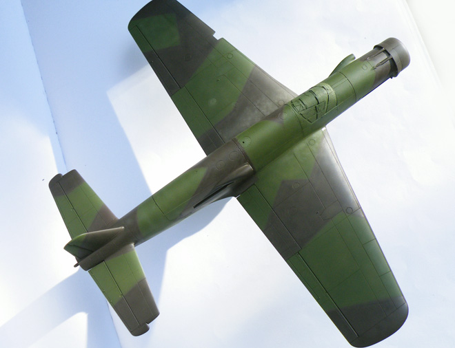

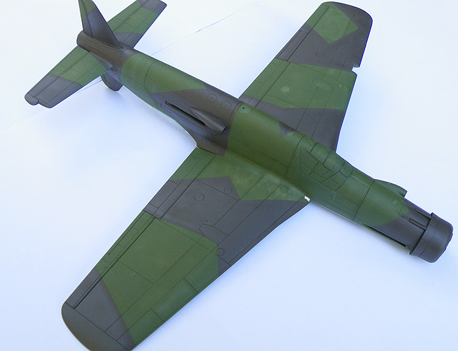

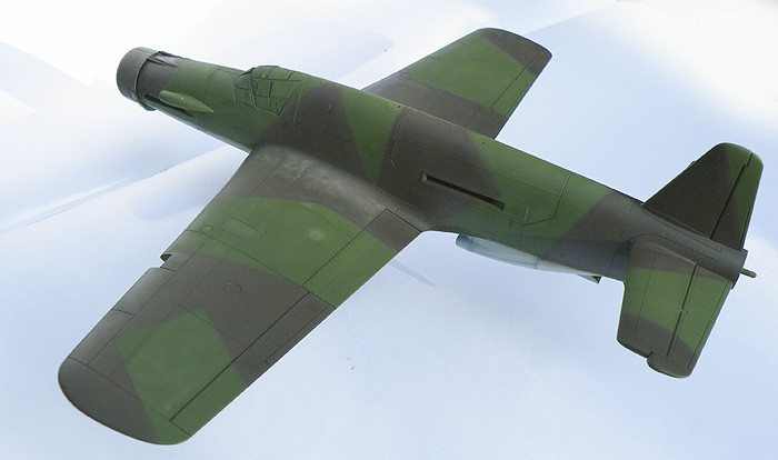

I sprayed on RLM 82 first and let that dry a day and then masked off the splinter pattern and sprayed on the RLM 81.
After looking at all the Do 335 photographs I could get my hands on it was easy to see that aside from the early prototypes the splinter pattern on most Do 335's was not hard edged but had a tight but soft demarcation line between the colors just like the Do 335 in the NASM.

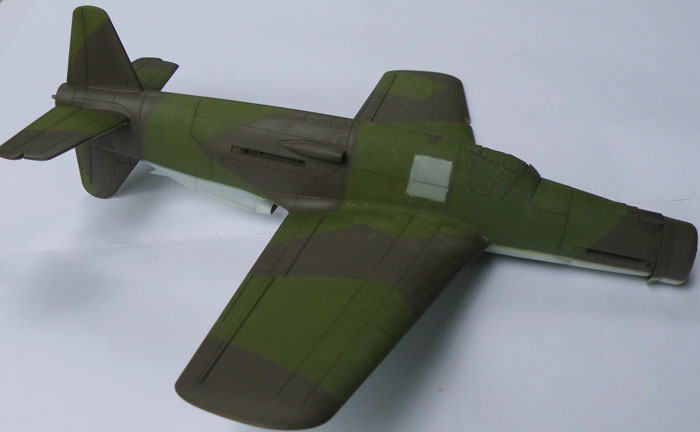

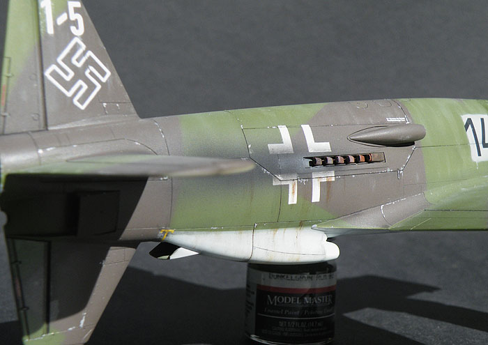

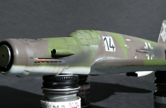

After removing the masking tape I went back over the edges of the splinter pattern and sprayed a narrow line of RLM 81 just inside the areas painted in RLM 81, this was very effective in softening the demarcation line without them looking too soft. I don't think I could get this effect freehand spraying the splinter pattern as it would have been too soft looking at the edges.

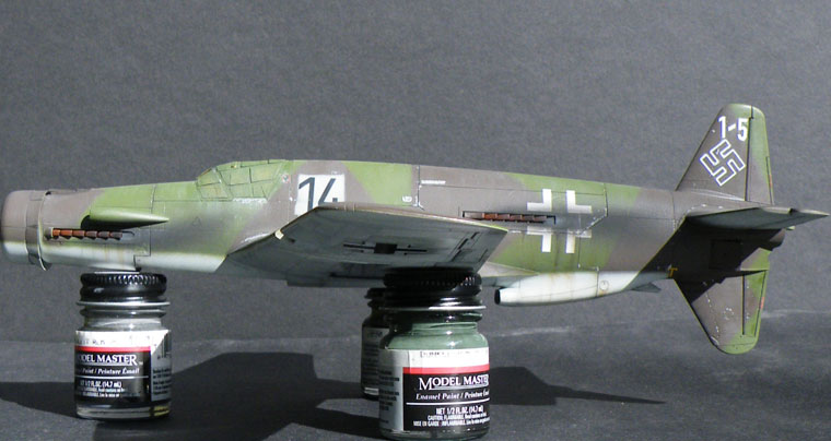

Here is the model just after the masking tape had been removed...

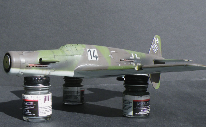

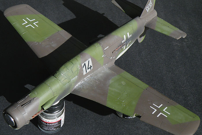

...and here it is after the edges were softened a bit. Also I did some paint fading/scuff marking around the wing roots with the airbrush with lighter versions of 81 and 82.
