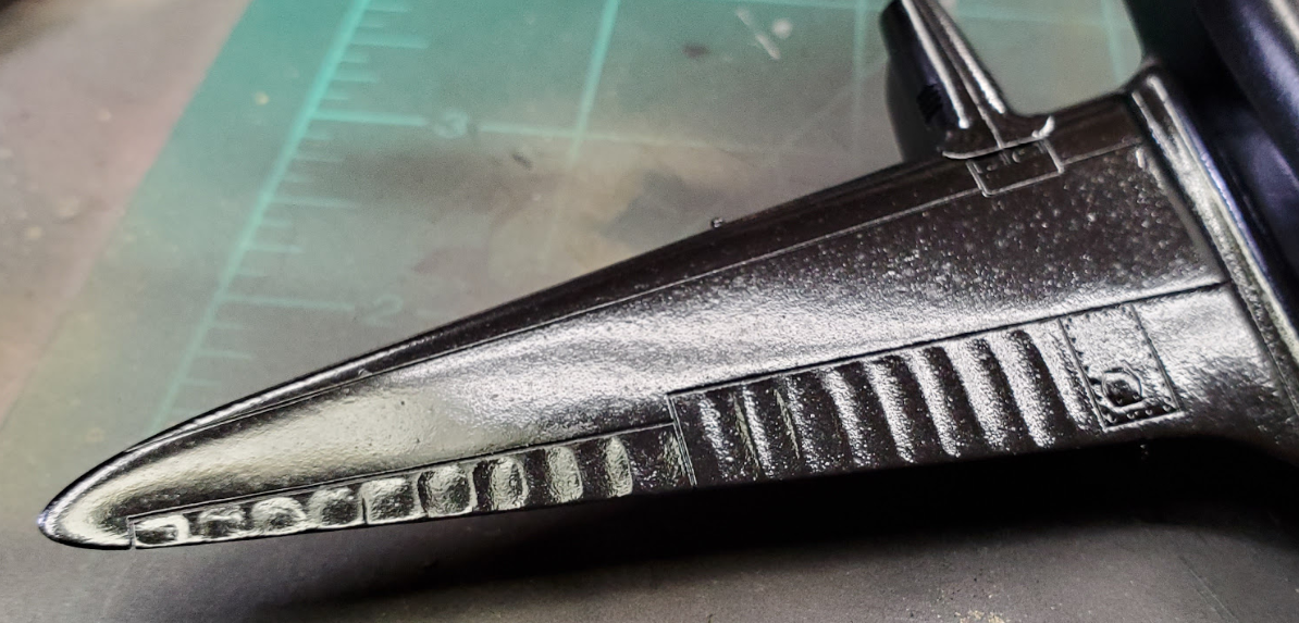

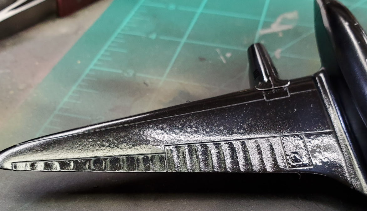

And I got done spraying and this happened.
Fired off some text to Mike since he's got the experience with gloss coats, haver a flurry of text I decided to come wash it off with water, my safe move right? Got back down in the garage and found this.
It's settling down so i'm going to give it till the AM to see how it goes. Might need to do a light polishing I guess?
Try some polishing compound on a piece of cloth. Then use future. I've had the same can of Turtle Wax polishing compound for 20 or so years that works for me. To get a real smooth gloss when your painting is to use thinner coats as you do successive coats. When I painted the Black Widow, I accidently used lacquer thinner as a final coat and it really shined, Thought it would be a major screw up. Gary S. #46 MASA

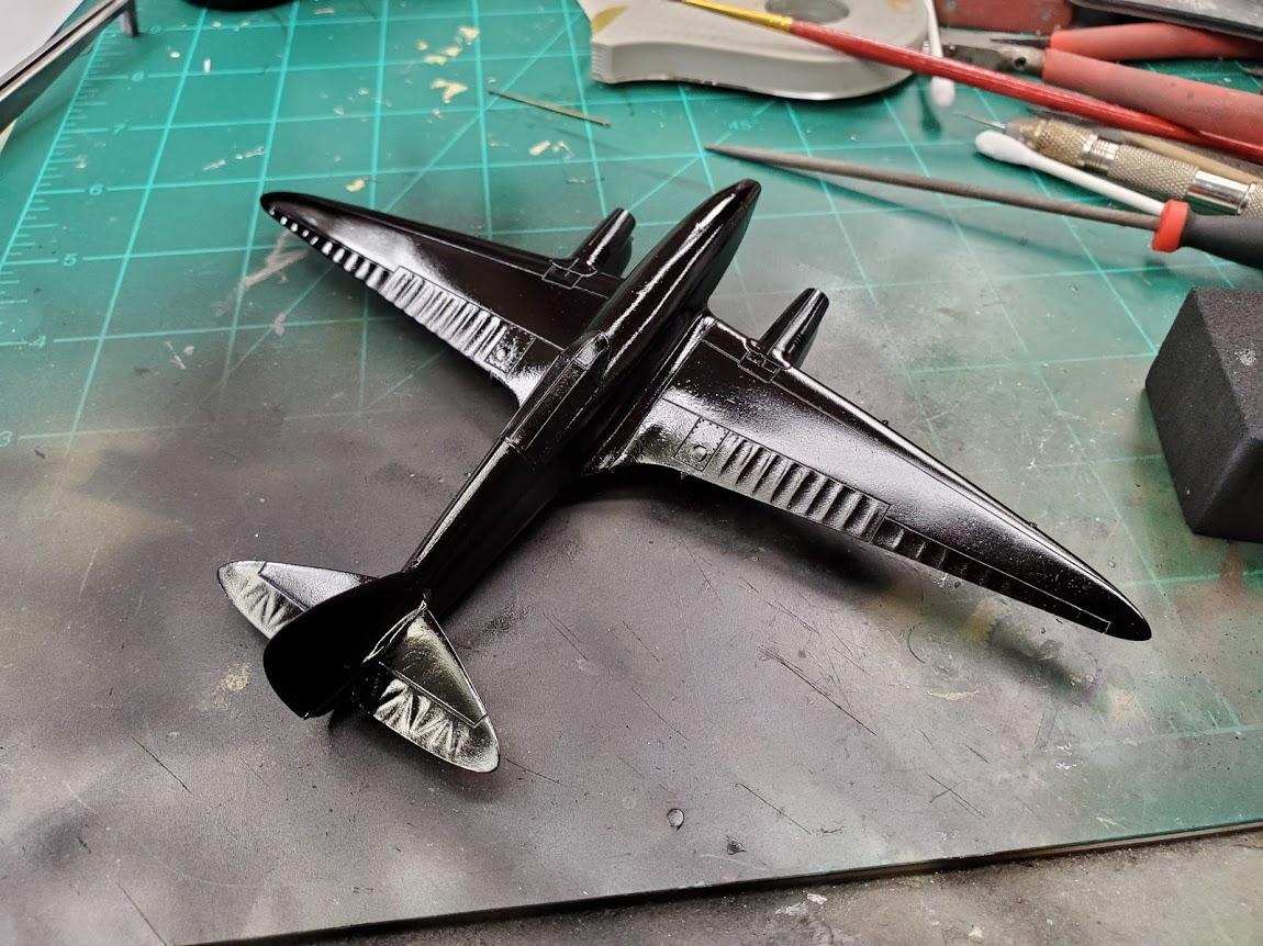

I carved out 15 minutes this am before the activates started. Sanded over those fish eyes with 1000 grit and hit it with clear coat again but with it much thinner.
I'm happy.

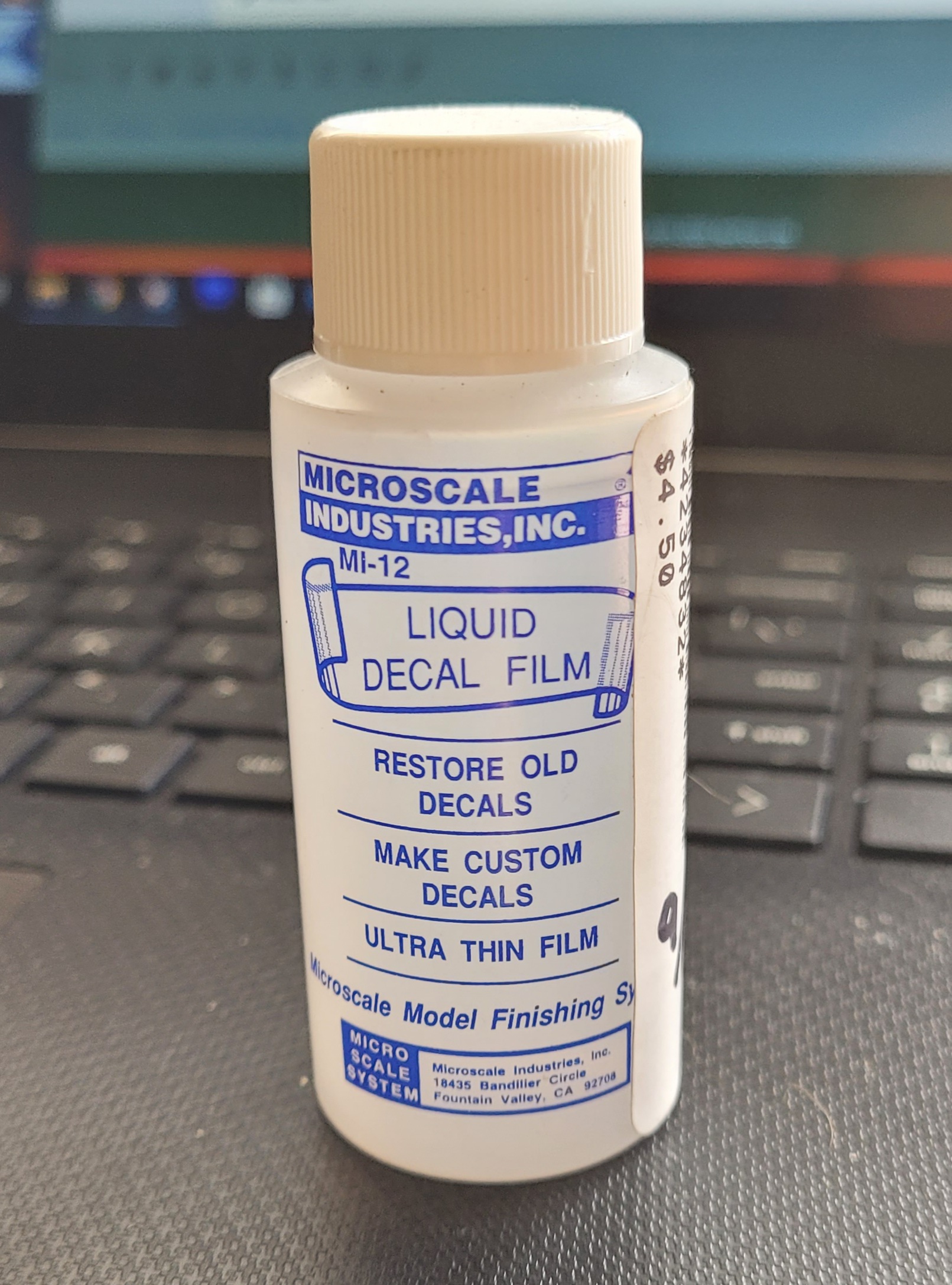

I put microscale liquid decal film on all the decals I make. It can be thinned with rubbing alcohol and sprayed in light coats or brushed on dinky decals. I don't worry about my brand new decals cracking, but it keeps the ink from running on the inkjet decals and seals the surfaces on the laser printed ones. Lots of decals that were past their prime were saved with this. Store it upside-down or it will vanish!
