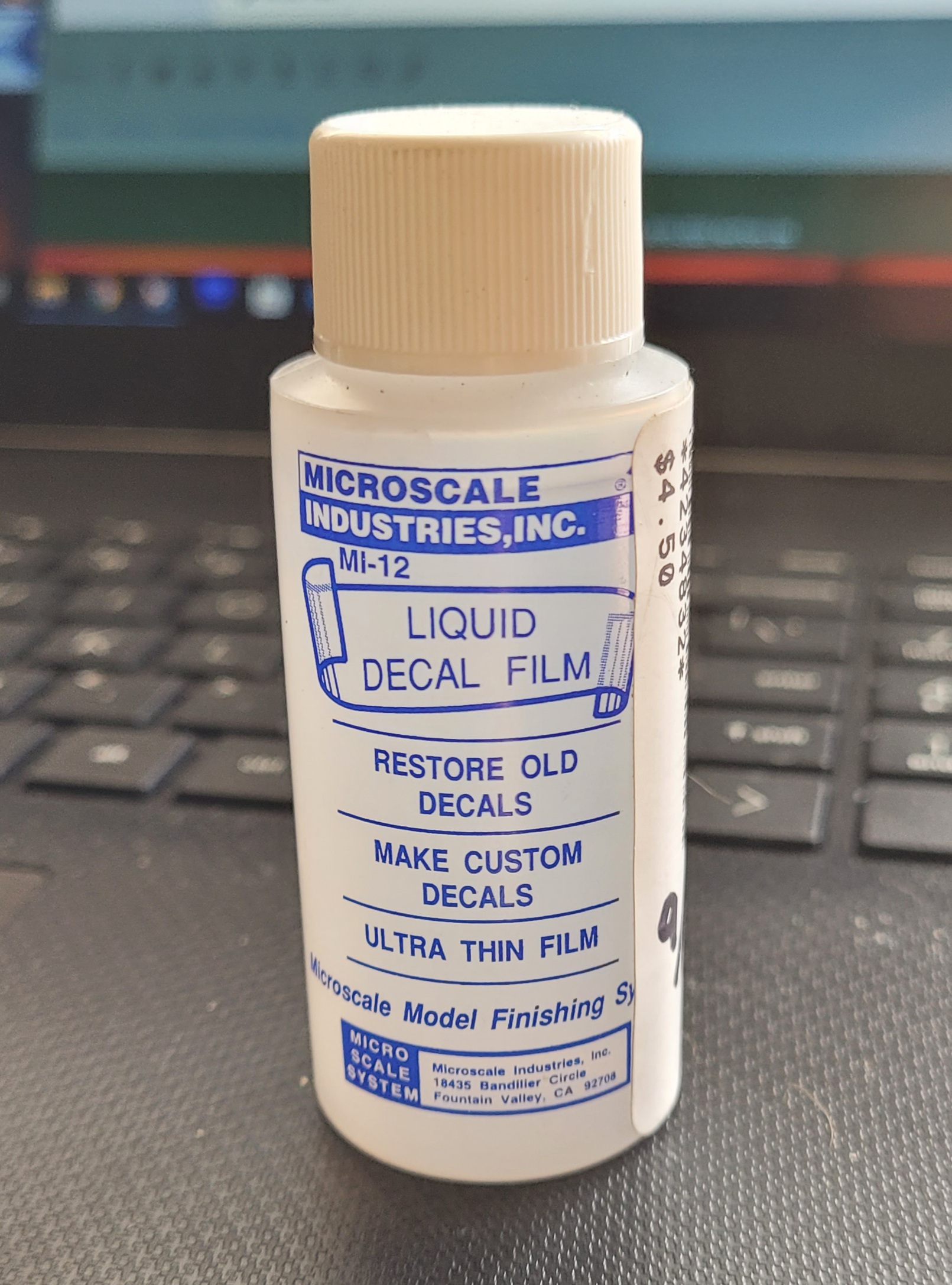

I put microscale liquid decal film on all the decals I make. It can be thinned with rubbing alcohol and sprayed in light coats or brushed on dinky decals. I don't worry about my brand new decals cracking, but it keeps the ink from running on the inkjet decals and seals the surfaces on the laser printed ones. Lots of decals that were past their prime were saved with this. Store it upside-down or it will vanish!

You know, I might have a bottle of that stuff!

Well I sprayed some of the Microscale Decal film on the paper. I'll have to wait till I get back to town to try it out.

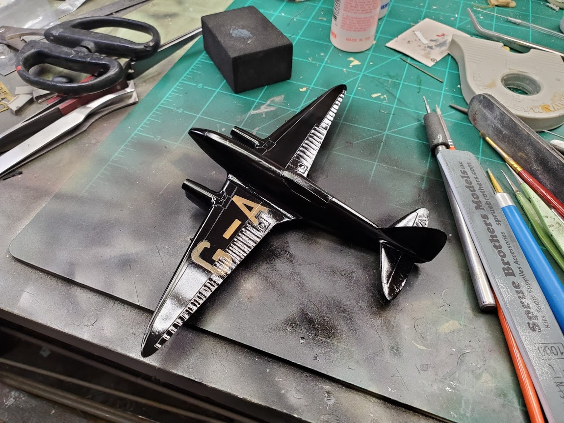

So I worked on the gloss coat a bit more.
I'm going to try my best not to bugger up the new decals.
