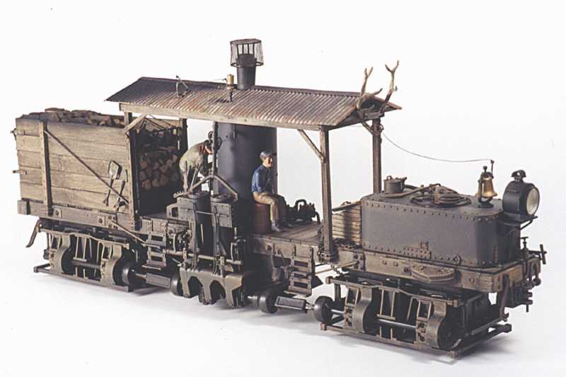

So here we go my project is to make a backwoods shay ... It will look something like this when finished ...

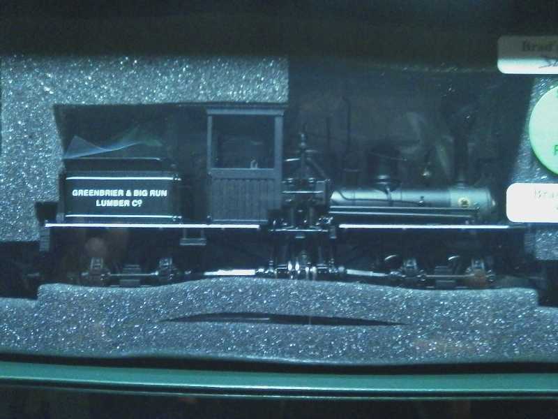

The Donner's ... Are shown below ... First off we have a On30 two truck Shay (1/48)

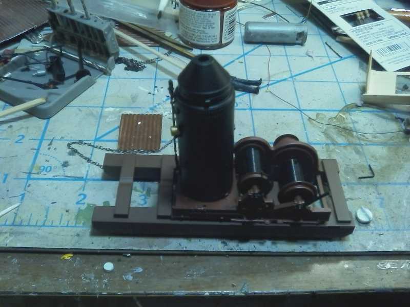

Then We have a On30 log skidder which I hope to use the vertical boiler & donkey engine on the front of the loco ...

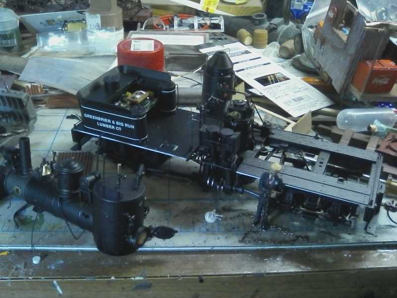

The skidder & loco have been disassembled and modifications have started ...
The boiler off the skidder was too small in diameter to fit over motor ... So I'll filling the area under old T boiler ... Which will be the source of steam power in my sawmill that I plan on building for my next module ...

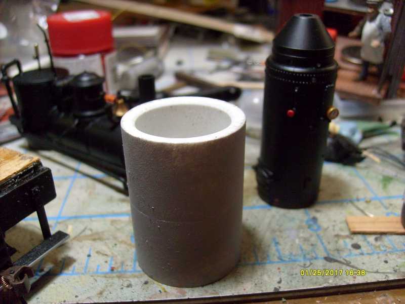

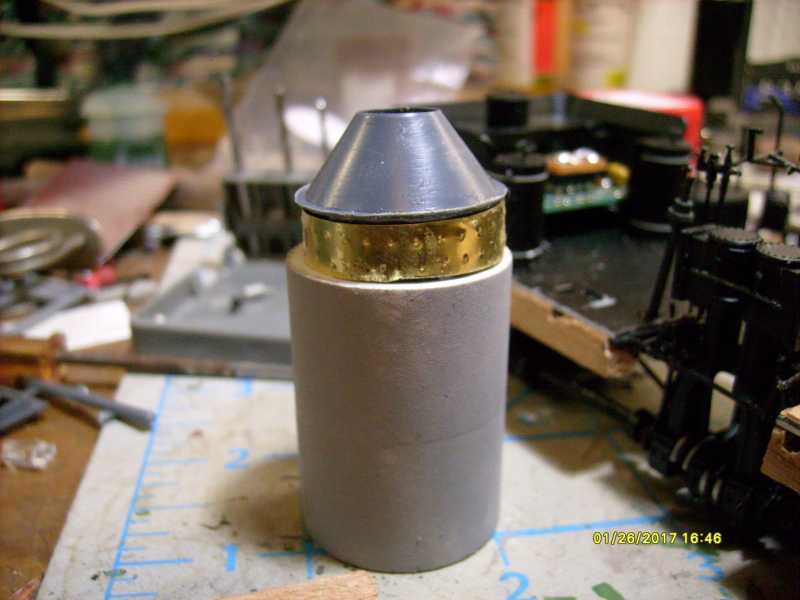

Then the vertical boilers off the donkey engine was too small in diameter ... So some PVC pipe coupler looks about right for the job ...

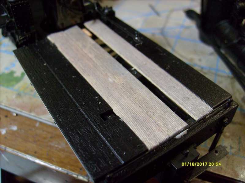

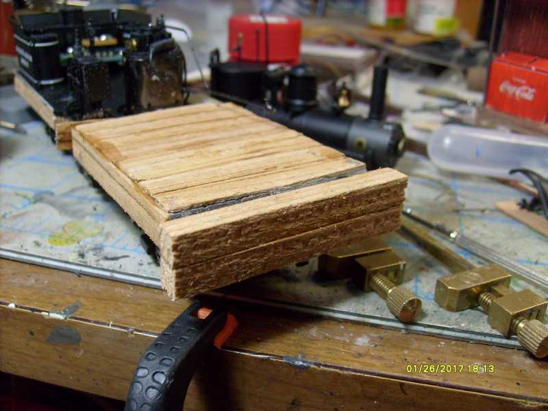

Thanks James :good: ... I've been working on this a bit ... Yesterday the sides were giving Me fits. So I added some wood to it instead of the angle Iron, Now I see that This loki will be wider than the one in the picture.

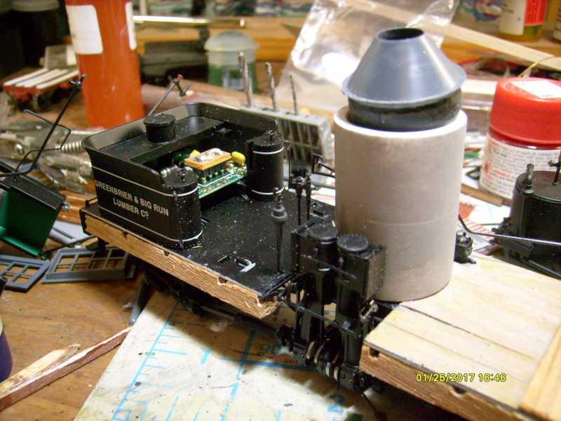

But that's Ok this will still be in tolerance for the clearances on the layout ... I'll just it a bit bigger ... the photo is of a HO anyway ... the one is On30 scale (1/48) ... On to the Boiler, I looked all day for my brass strip material. Trip to Hobby shop today will fix that, here's what she looks like with the two GWS bases glued and ground down ready for the brass ...
And sitting on the Loco, I'll add some wood strips down the side to hide the edge of platform ...

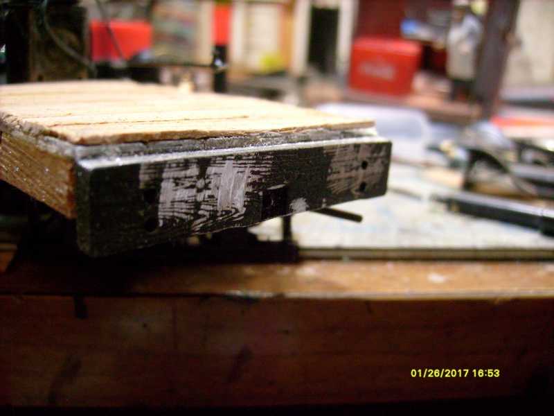

Bottom edge needs some work ... but all & all from a distance I think this would look good ... although AMS is lurking in the background ... the front needed some work so I removed the steps & coupler pocket ...
Then with dermal I removed middle tab & rivets ...

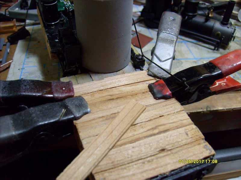

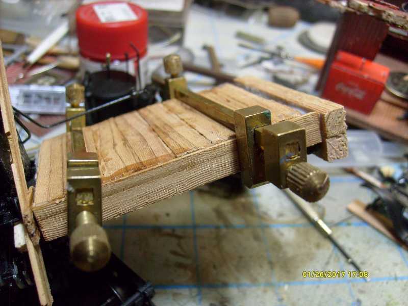

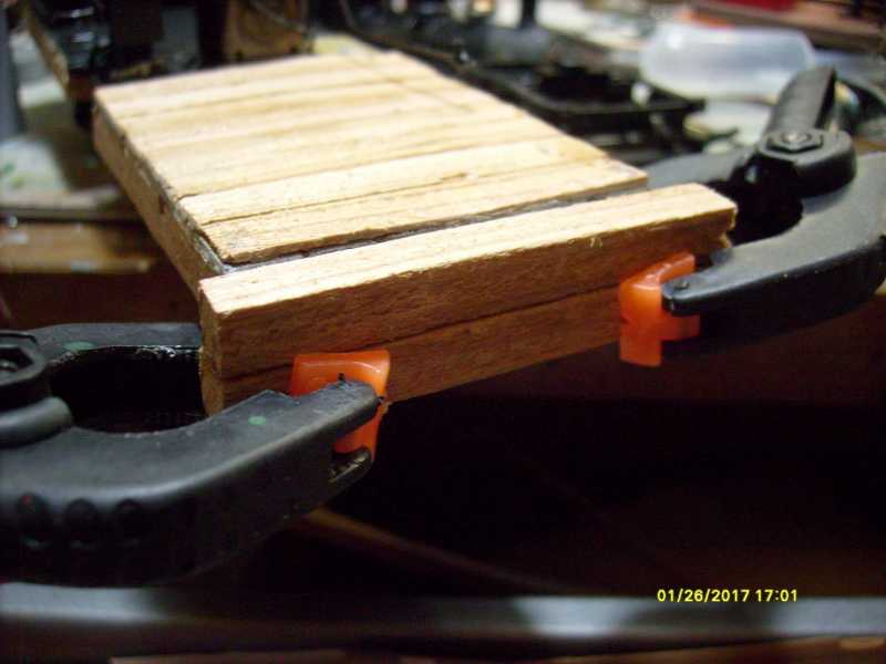

This is western red ceader wood that I cut with miniature table saw ... added bumper blocks & side board, just waiting on the glue to dry ...
Thanks James ... did you ever buy some of those for yourself ? .... anyway continuing onward through the Fog.

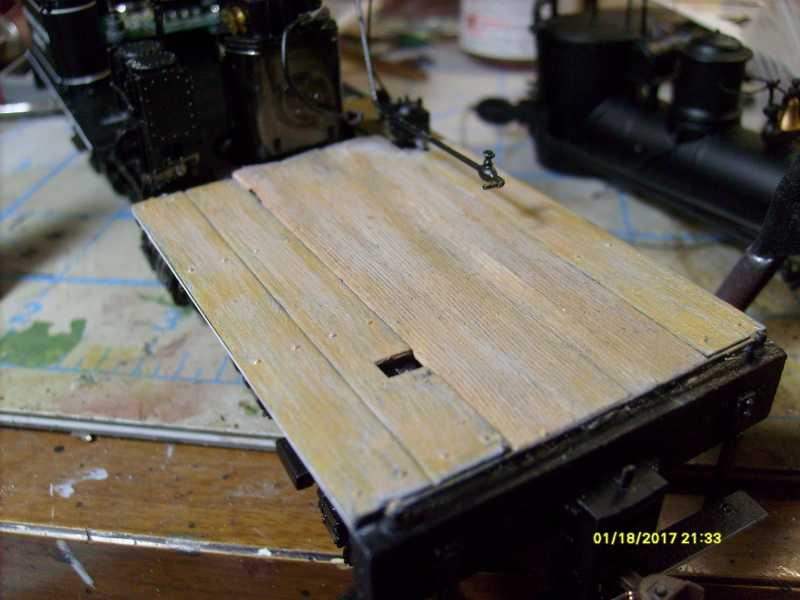

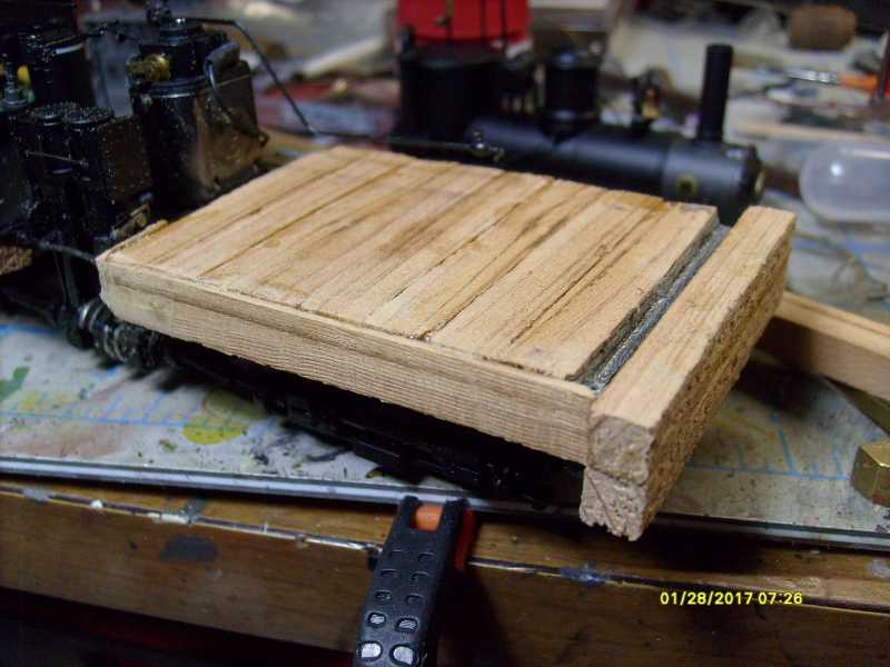

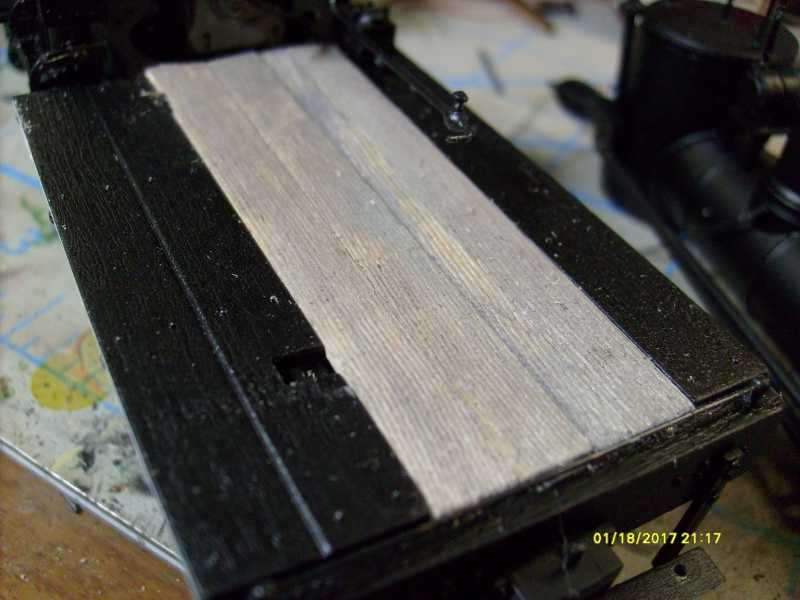

This is where I've gotten to on the decking ... in next photos I'm cleaning up the deck work ... I've spent the last few days looking for my bundle of wood I cut ... only to realize I wasn't looking where they were ... :rotf

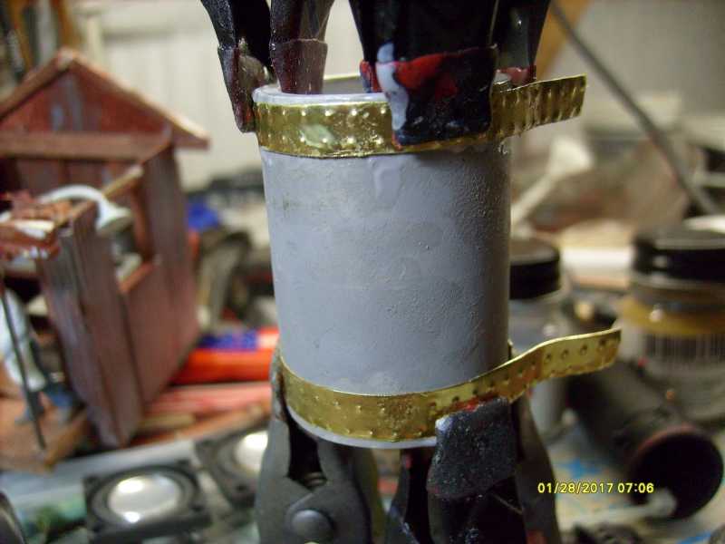

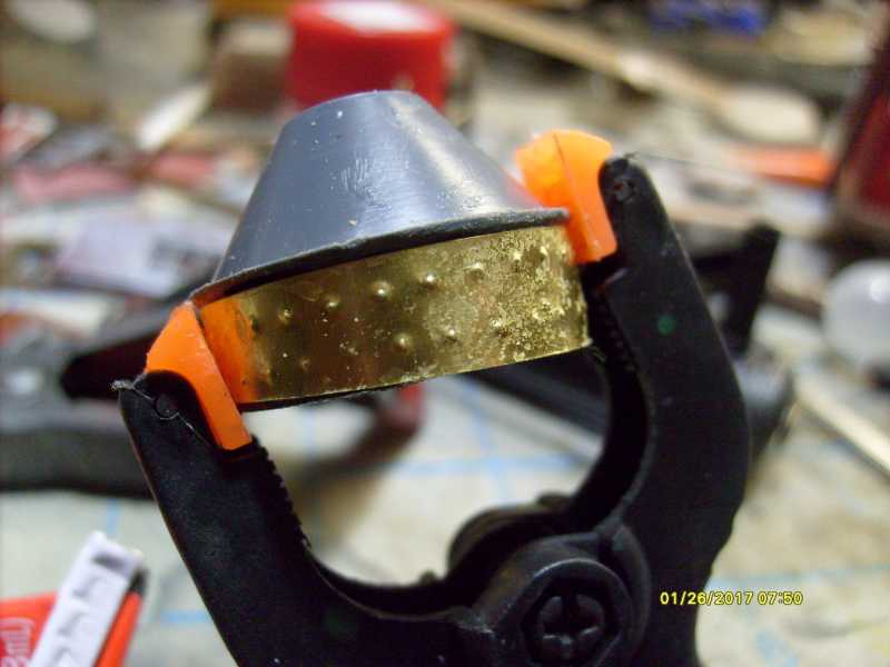

I'll fill in the little space at the front reason for my search ... Meanwhile I was working on the boiler ... a bit rough but after paint I think it will look good ...

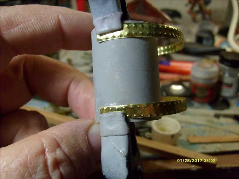

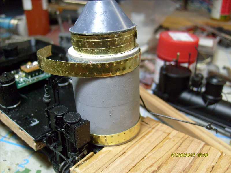

the bands kept coming off ... I haven't found the right cement yet ... I also found a firebox door that I'll add ... :soldier :ro: :dude ...
I trimmed the front bumper down in the last photo and I think this glue will stick ... time will tell, I've been worried about being able to attach brass & styrene to a piece of PVC ... :hmmm
Thanks MP ... at least I'm making progress ... time will tell I'm going to experiment with my weathering pens next ... I must get the other side on also ... :salute
For the problem of the brass bands coming off. Maybe wrap the bands around a smaller diameter cylinder so that when you put them on the boiler they are under tension inwards instead of wanting to spring back out/off? Also, maybee straightpins every so often as a rivet to hold the brass to the cylinder?
