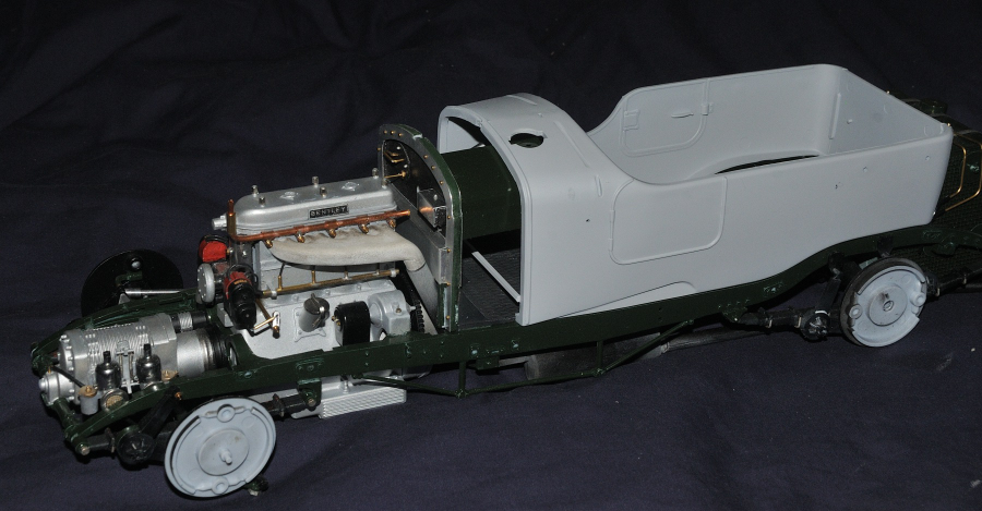

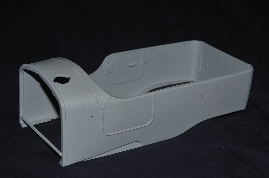

after soe time heating and bending the 2 sides an the rear of the body and adding a spreader bar to the front it now sits on the chassis nicely with out having to stretch or force anything.
i am a bit daunted by how i can make this look better. It needs press type studs for the tonneau cover, an alloy frame round the front and detail inside . I am not using the rear seats instead there will be the rolled back tonneau cover which will obscure a lot of the inside.
Currently reading up how to make the front seats look like leather, i have done it on a small scale with brown leather straps but these will be Green and quite large....wondering about oils ? but not sure what colour the base coat would be on green ? maybe a much lighter shade of green than the finished leather dark green ?
Positioning points are a bit vague on this kit so i cant fit the radiator or anything else up front because i dont really know where it should sit so i need to get the body on...then i have a fixed point to work from and the radiator will go exactly the length of the engine side covers away :)

The body fits well now, nice work.

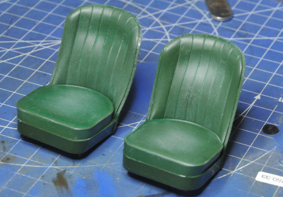

I painted the seats leather with Tamiya XF56 and then a wipe over with a green oil paint but i was really disappointed with the joins on the seat fronts and back especially down the sides like this

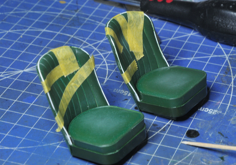

so i either pull them apart and start again or sleep on it......Didnt fancy re flocking the backs so decided to add piping round the edge of the seat to cover the crap joins.
This is 0.5mm plastic rod glued on with normal styrene glue

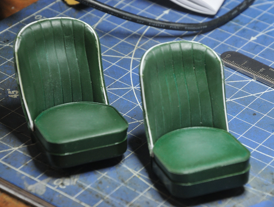

then painted to match and i am a lot happier with these joins especially over the top where they will be seen the most
Talk about making a simple thing rather complicated :) Need to take a few days off now as work is piling up :)
will lightly weather the leather when the oils are dry.

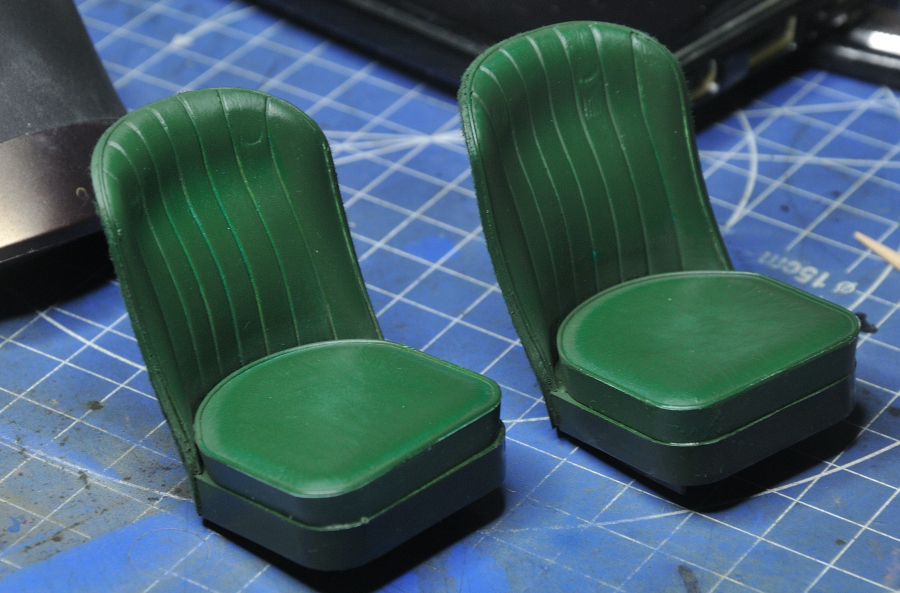

Despite some of your troubles along the way that turned out very well Paddy. Sometimes there's just no easy way to deal with things like that.
Cracking job Paddy. The "little" change of adding the piping makes a world of difference in the finished product. :Drinks:
