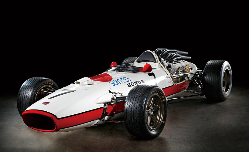

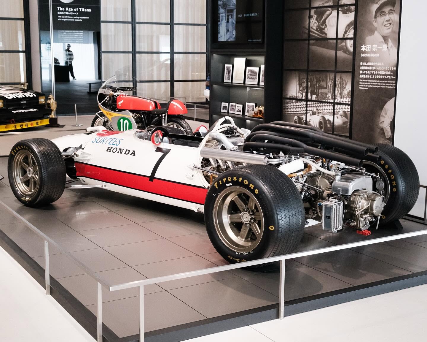

an original in the Honda museum
and another in the Fuji museum

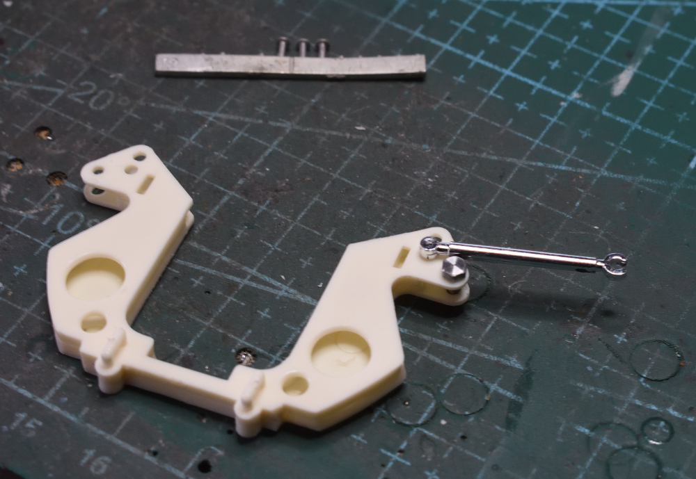

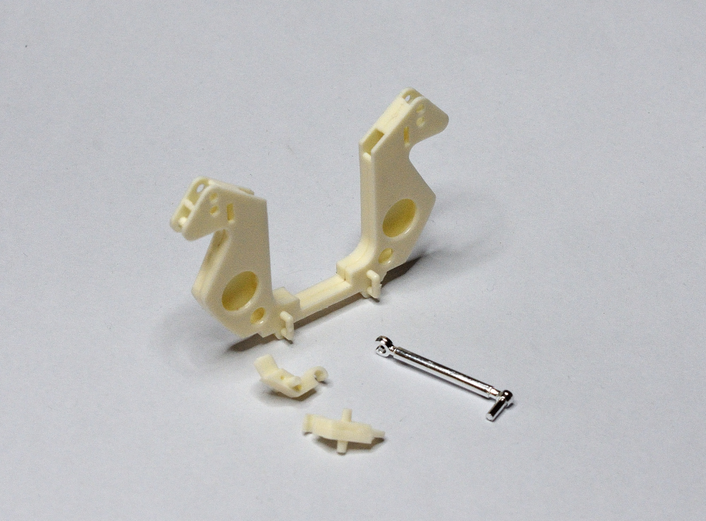

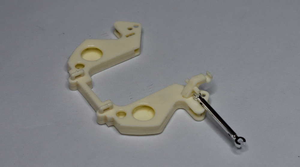

I think the problem i need to solve is there is a lot of chrome type struts on the suspension. The kit has a Chrome fret but its not great and of course you have you problem of the attachment points to the fret and damage to the finish. There are also problems like this
you can see the bracket at the top of this rear engine mount. The suspension arm is held in place by a pin in the bracket. This all wrong, the suspension arm should be bolted to the engine bracket, the pin is a Tamiya addition so the suspension arm is held in place and can still move.
You can also see here that the pin at the top left should be a bolt to hold the shock absorber but Tamiya in those days used a C sectiion clip like on the chrome part to snap together parts
Thinking caps on chaps
If i use a bolt to hold the shock then the suspension arm will foul the head. The reason being the entire bracket is the wrong shape , its on the right lines and will look ok but its a representation rather than an accurate part. This opens a can or worms because if i alter one part i will have to alter half a dozen more to suit. I could try making a pin and drilling it and fitting a much smaller head to the pin and make a fake bolt. That way it would add a little detail which the whole thing lacks and it would make a nice model but its not ever going to be correct. The kit looks like its designed to have working suspension which seems a bit pointless and it may pay to fix it in position because its going to be the pivoting of parts that causing the problem because the pivots etc are all way over size so they are strong enough to bounce under the load of the springs.....Hmmmm more food for thought.😄

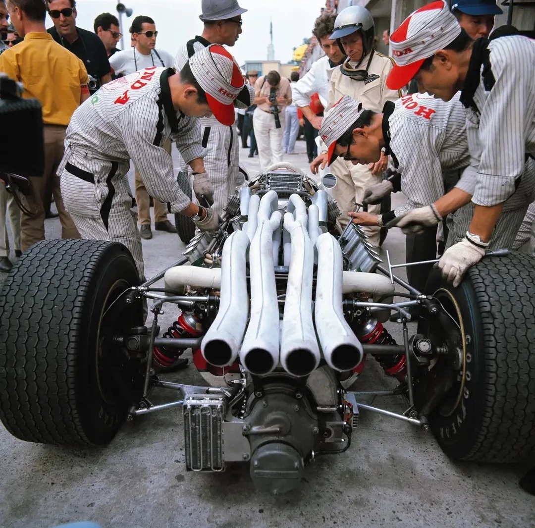

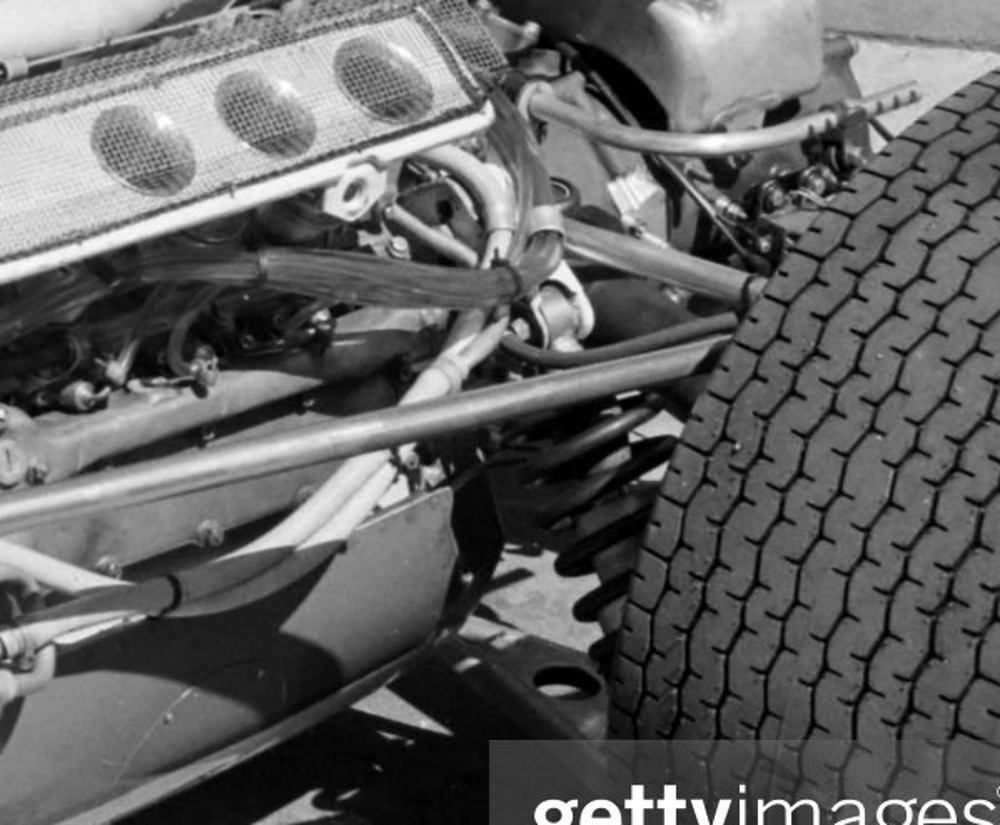

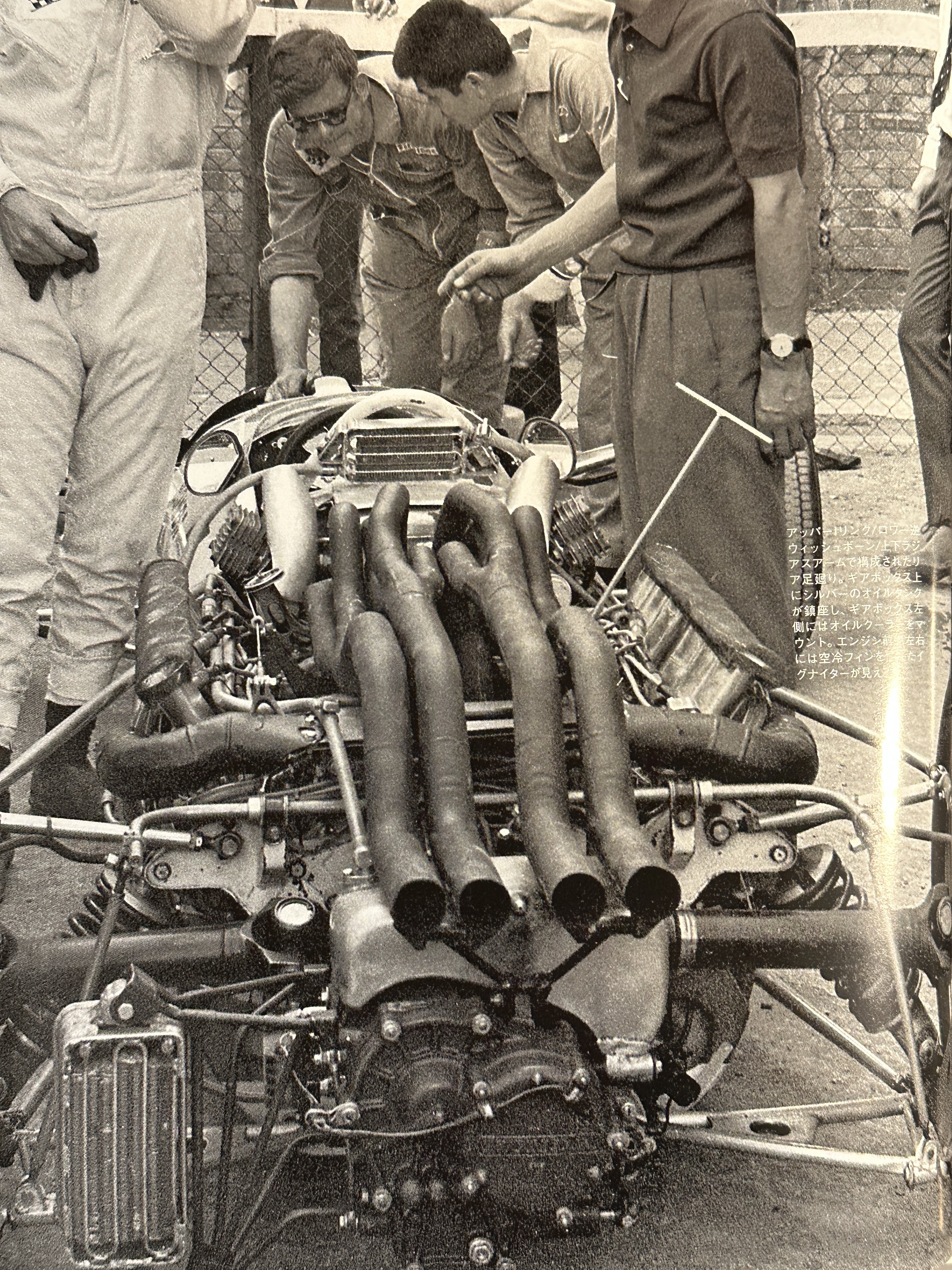

I see what you mean by simplified parts Paddy. I took a look at photo's from my Joe Honda 1967 book and thought I'd share one period photo that shows the pinning of the rear shock, and gives all the readers here an insight to what Paddy is trying to overcome and the task at hand.
I have a suggestion for a body colour. Mr Color 316 which is FS17875 on the jar. It's a (slightly off) gloss white. I've noted a few Japanese modellers use this colour, having colour matched it with a Honda Museum car I believe?
What a stunning rear end. Just love those exhausts....

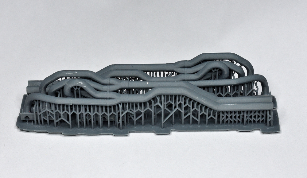

Hi Paddy, you might know about these exhausts or have them already, but I thought it's worth mentioning just in case you had not. Unobtainium (based in UK) make 3D printed replacement exhausts for this Tamiya model. They look really nice.
A good photo can solve a boatload of questions and give solutions for what Paddy is trying to do. His bolt head looks way too large and from the photo above there isn't a bolt head there anyway.
Some really good points thanks. two things i have learned with F1 is there are no two cars the same and like modern aircraft restorations, modern F1 car restorations are not a lot of help. The advantage for me is it would be very hared for anyone to pull me up on basic detail like wheel colour or exhaust colour or even body colour. The disadvantage its quite nice to have a set of basics to follow sometimes.
Anyway having worked out how to make a 1.5mm bolt with a half size head i can see as you say its not a bolt or at least if it is is put in from the front and the bracket is tapped which is most likely.

You can see from this period picture the exhaust are seam welded on this car which is typical Honda of that era, all their motorcycle exhaust were made this way......however Terrys pic which is also period shows a std tubular exhaust....
I will go with this however which Nick sent from Unobtainium
as i am assured that the std included kit exhaust is impossible to assemble :) (wont stop me trying though :) )
