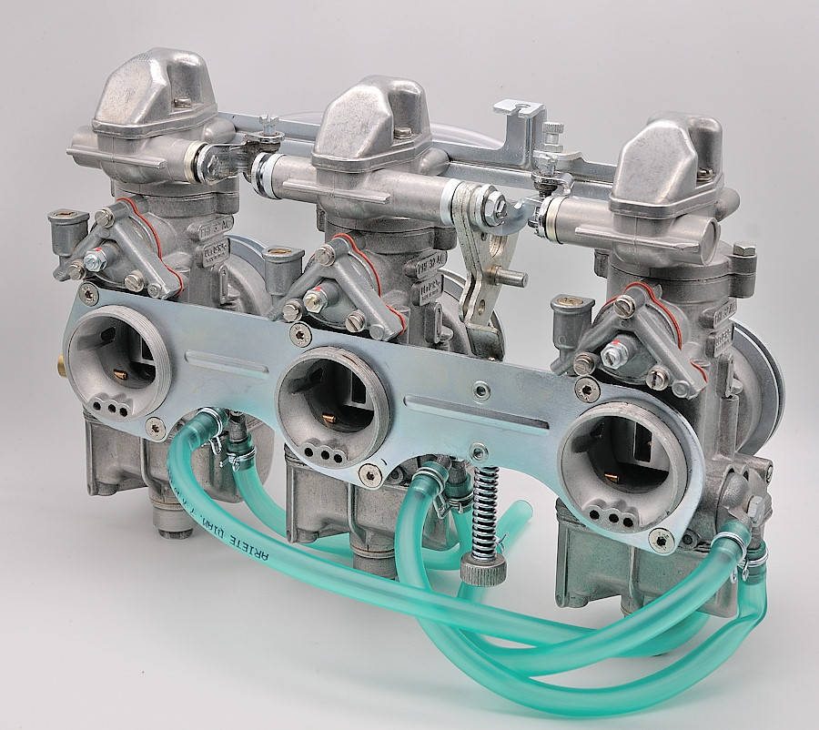

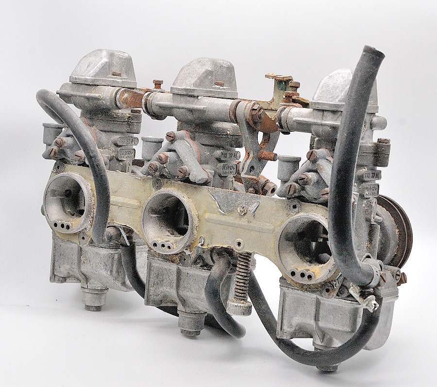

Best i have been able to do this week is turn these
Into these
But i haven't forgotten the Bently, i just need to earn a living on the side :)

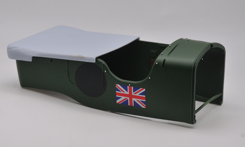

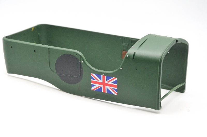

Managed to get a bit of time on this.
the cabin is now 3 coats of Tamiya of XF26 Deep Green with 3 coats of flat clear on top. the clear has crazed the decals but actually it looks fine as the flag was painted on the leather so would have been of a rough texture. the body was wood frame, alloy skinned and then covered in leather hence the Mat semi gloss effect in contrast to what will be gloss metal work over the engine etc.
Not sure about the hood in the second picture. I'm experimenting with sticky back vinyl, cloth and paints to get a sort of canvas finish, ideas welcome :)
I turned the brightness down so you can see the hood.
Body looks really good. The hood looks a might thick to me, have you ever tried using a disposable lens cleaning cloth? They have a texture and thickness that seems like canvas to me.

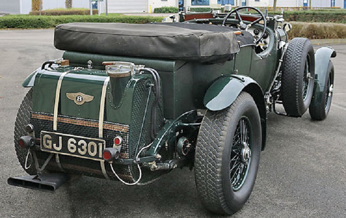

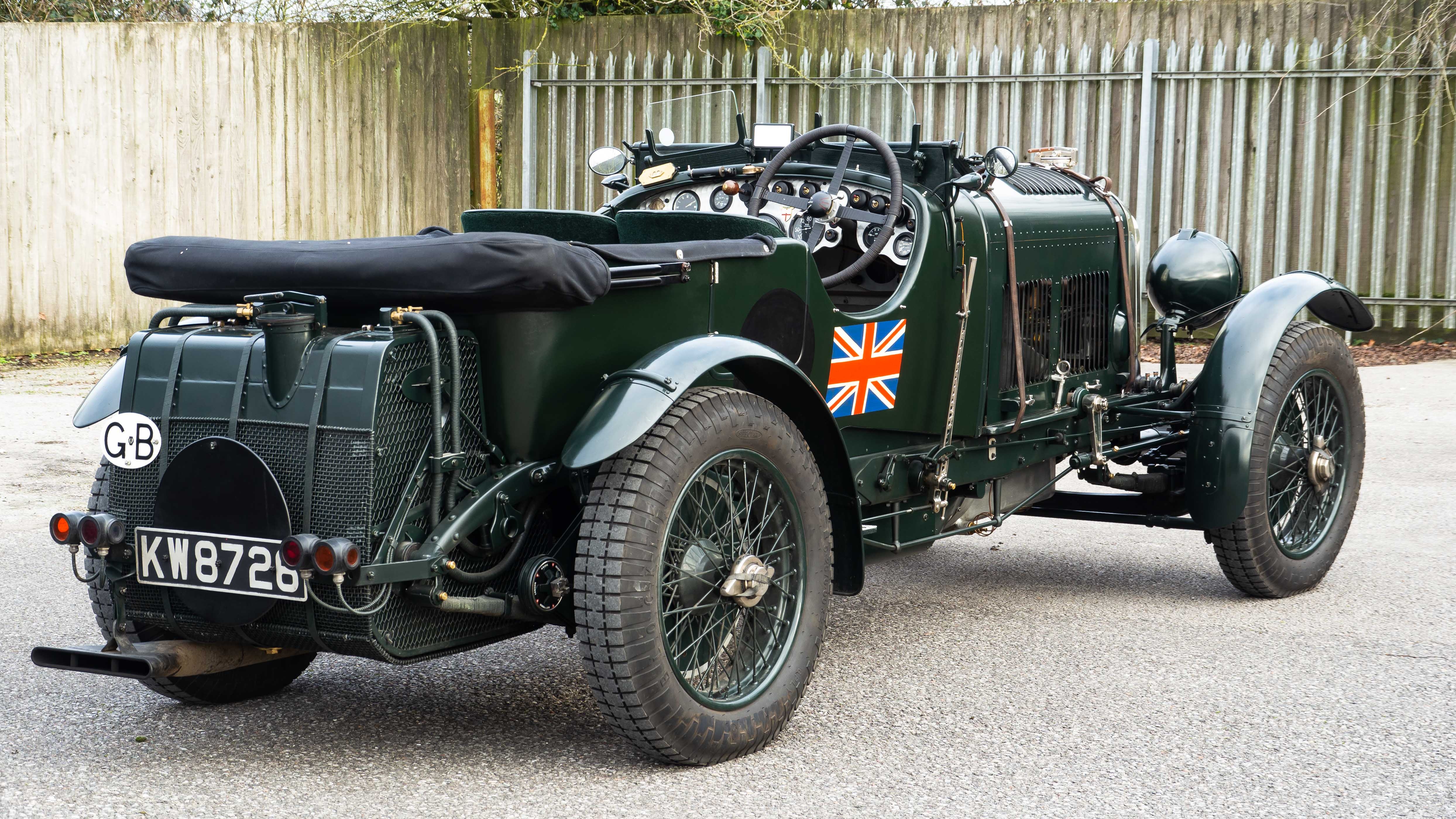

Ah i can see now, the kit part set me off in the wrong direction.
What i should have is a separate cover over the rear seat and a separate folded hood at the back
You can see it on these 2....

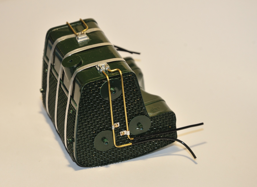

you can see from these two that the detail is quite different on all parts, each car is individual reflecting its hand made construction, look at the fuel tanks, absolutely nothing the same but still identifiable for what they are..
