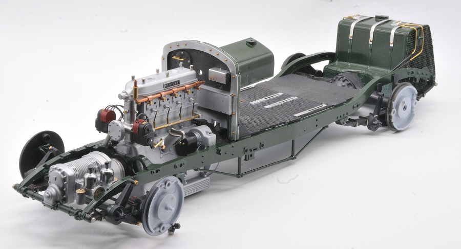

Airfix 1/12 Bentley blower FINISHED

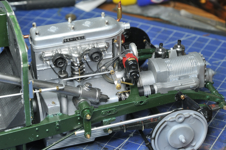

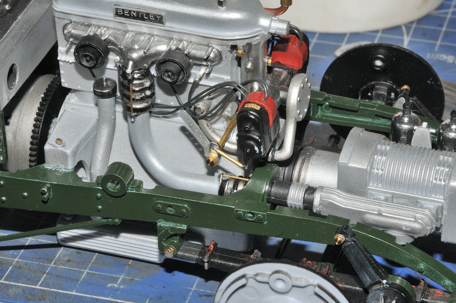

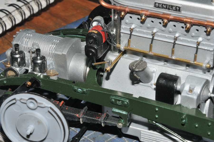

this weekend I added an advance/retard mechanism to the magneto's
the car has two mags one each side and they are linked by a cross shaft. there will be a control rod going back to the bulkhead once i sort out where the steering shaft goes so i can miss it with the rod ;-)
Next step will be to fit some proper mesh to the radiator
Then i will do a bit of a round up here as the thread is getting a bit disjointed as i keep going off on tangents :)

The side with the conduit will have the exhaust manifold fitted right next to the plugs so the wires are channeled to stop them flapping about and burning on the manifold. :)

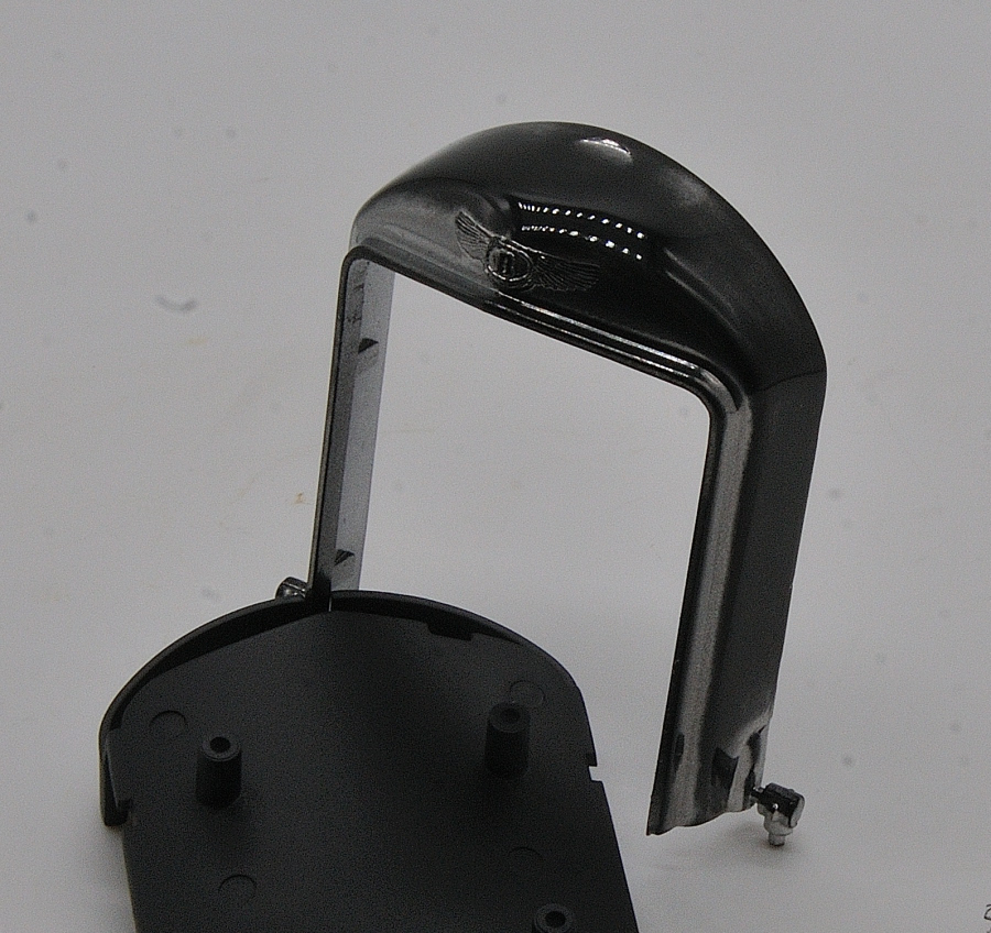

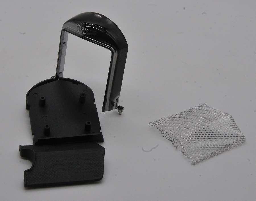

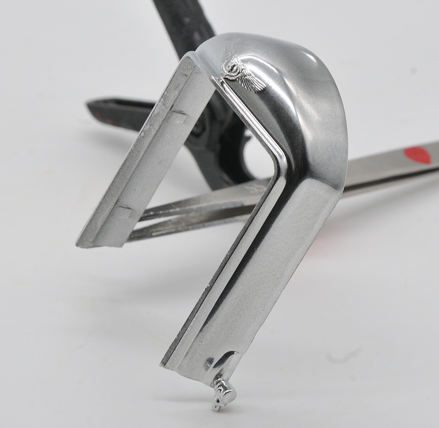

Well as predicted by some the chrome turned black after a few days. Having searched the net for a solution i am told its all down to spray pressure, i suppose the excess pressure dries the Alclad too quickly before it settles out on the surface., one thing every one agrees is don't lacquer it or you will lose the finish.
I have now resprayed it at a lower pressure (5psi) to see what happens

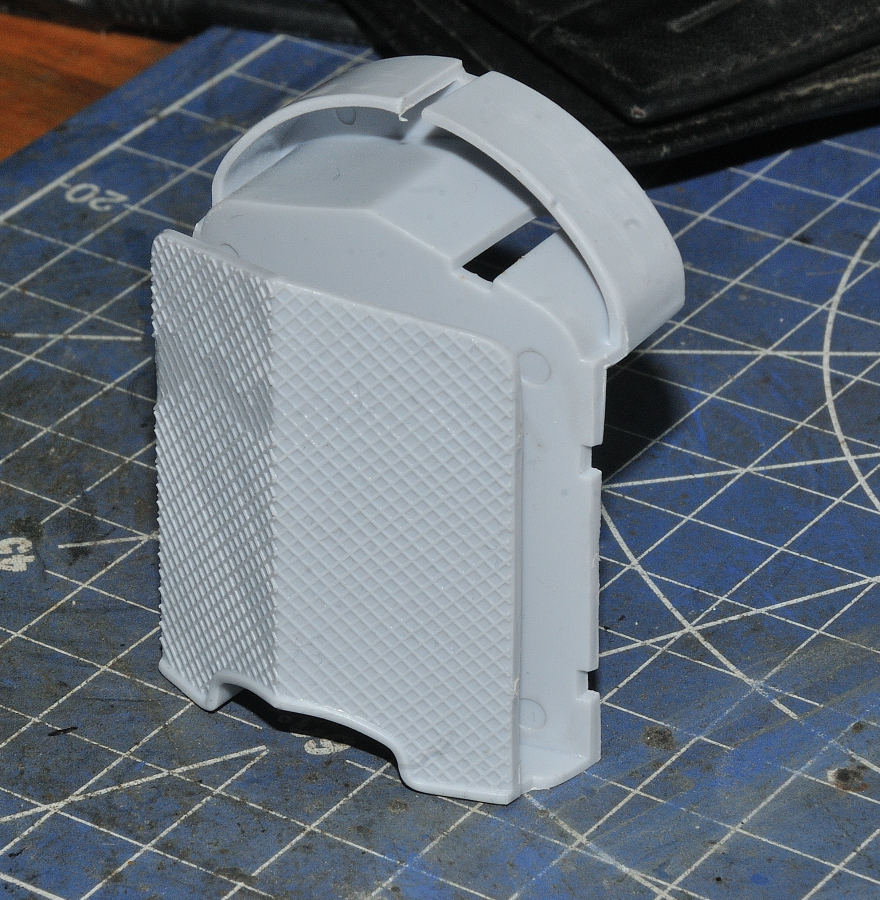

This is the radiator core

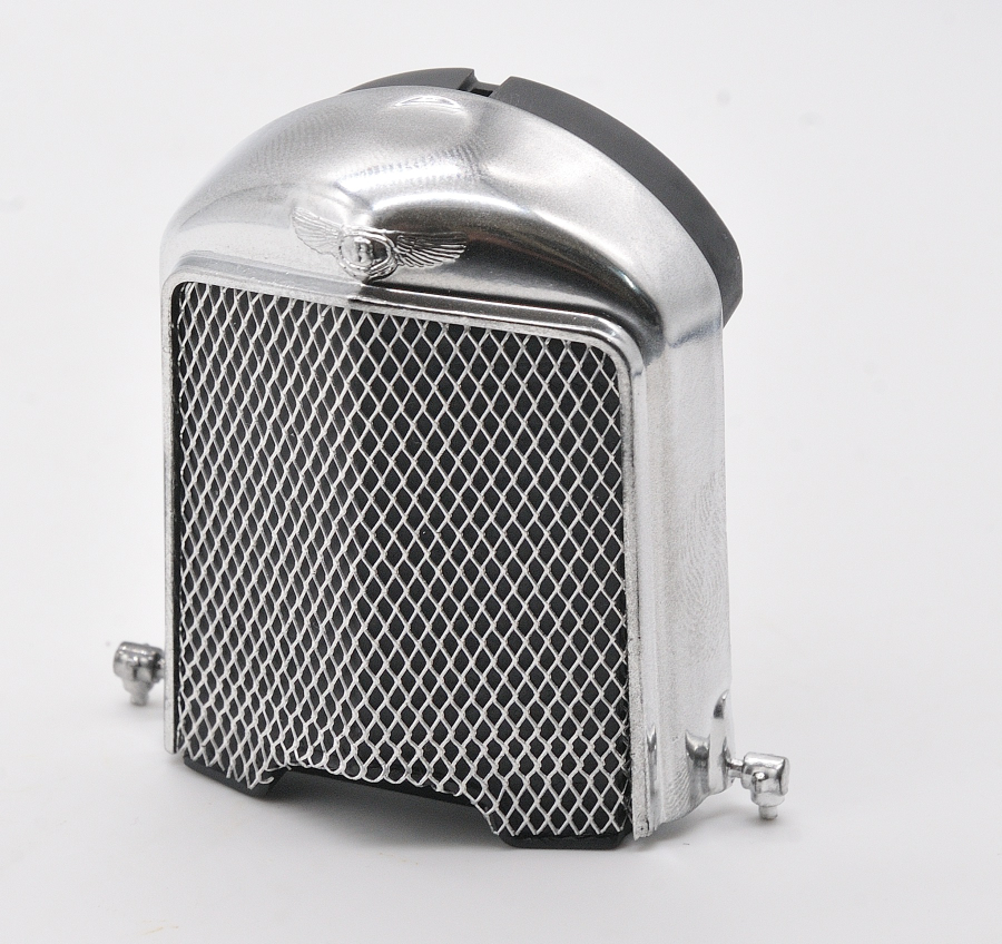

And sprayed black, the mesh i used is alloy self coloured

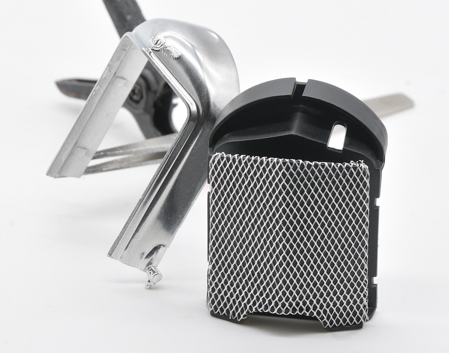

The rad surround was resprayed
and loosely assembled while i wait to see if the chrome survives another week

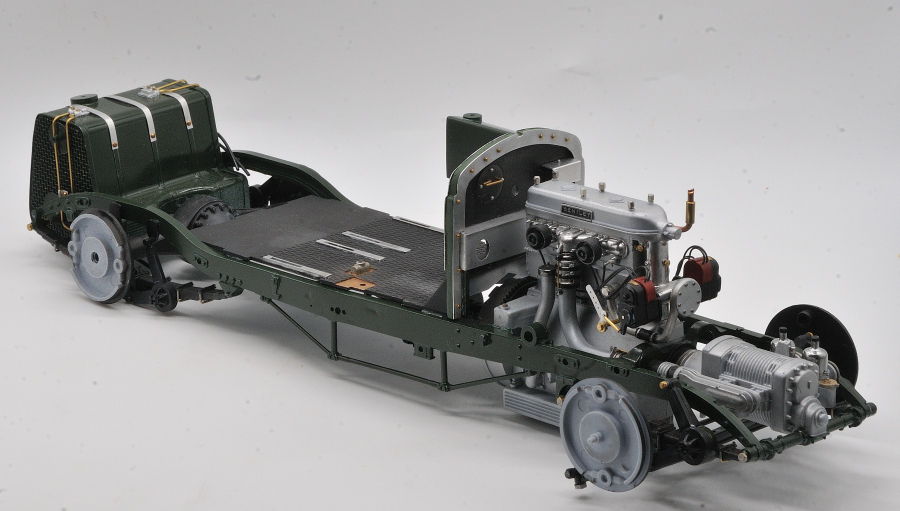

And a quick round up of where i am
My little P-47 had a base coat of Alclad gloss black. Then I sprayed Alclad chrome over that. Then some other aluminum colors in various spots. Had no problems with the paint at all. Might be because it is a different formulation on the black paint as you said yours was Tamiya.
Still looking good Paddy!
Man!! This build is looking specacular!!! Your Alclad skills look great as well as your fabrication abilities. As an alternative I have sprayed Molotow through an airbrush and sealed it with Spaztix Ultimate Chrome Clear and had some good results. You've just gotta let the Molotow dry for a couple of days before applying the clear.

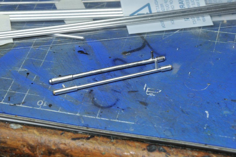

today i added the steering column, The rod for the steering and the rod for the advance retard on the magneto's which is the cranked one with the adjuster nuts to the bulk head.
On sat i went down to the local model shop and bought some alloy tube.
I made a new one of these as the plastic one looked ...well like plastic really..
and here it is with the other parts fitted today
