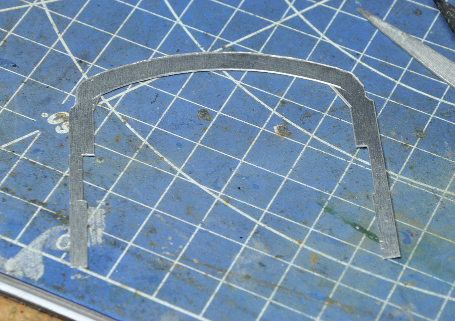

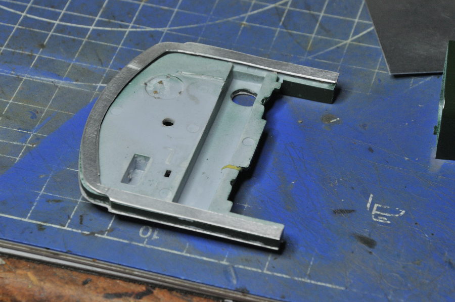

Using a 0.5mm sheet of alloy i have cut out the frame that goes round the edge with a scalpel by scoring many times and then very slightly flexing the bit i want to remove till it breaks away
Very rough and ready at the moment but i have the basic shape now that fits the plastic part so i can start to clean up and refine the shape
it Fits !!
Even if it out of focus. I think the original would have been wood and they fitted an alloy frame both sides to give it strength because the engine covers sit on it
I will probably stick it to the plastic, then clean it up so the edges line up and reverse drill the holes in it and add the nuts and studds tht would have held it unless i think of a better way to do it.

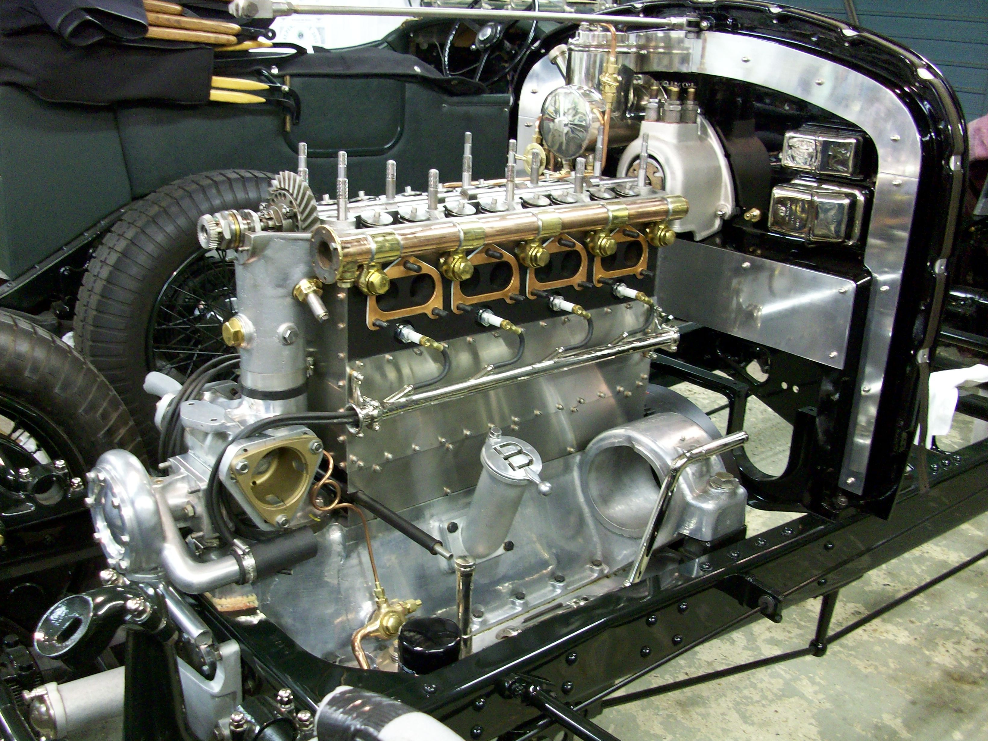

Here's the real thing looking rather over restored :)

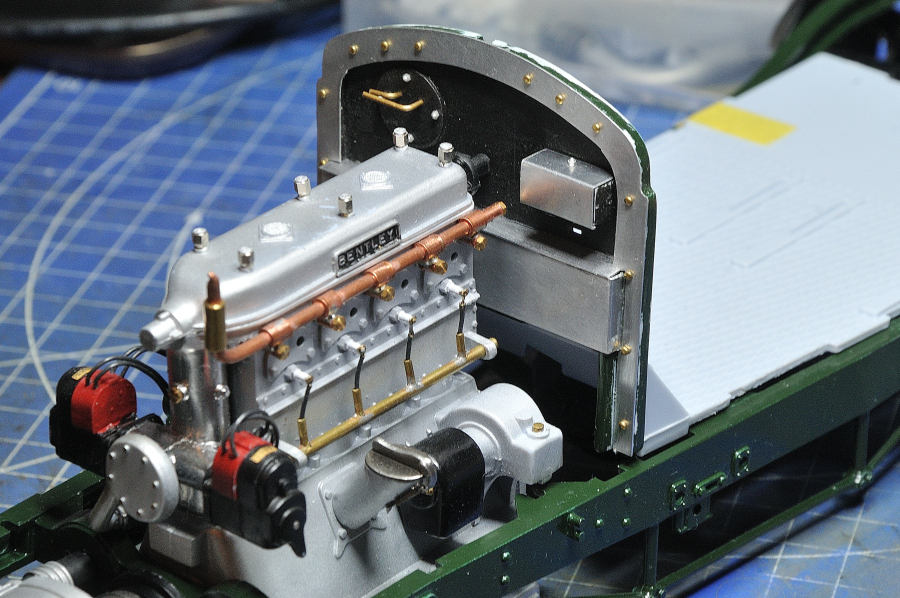

this week i have been planning ahead

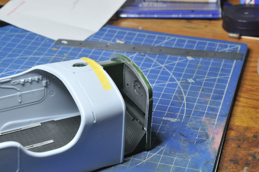

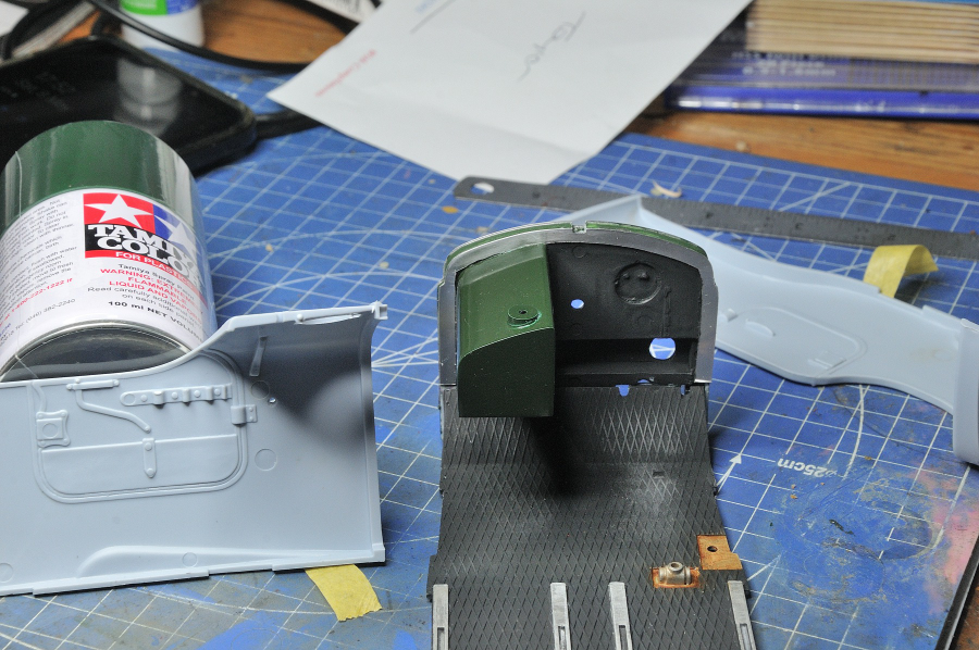

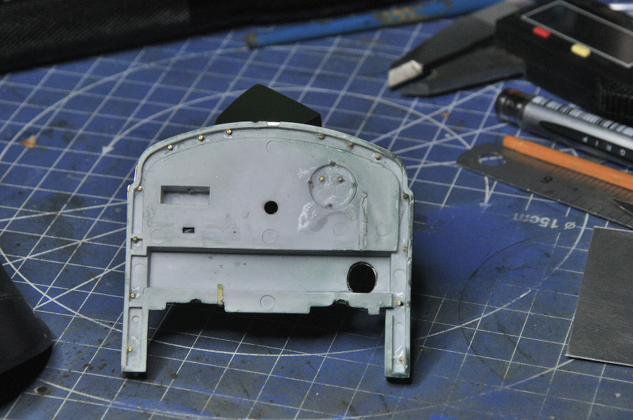

I realised that the back of the bulkhead is as visible as the front, airfix don't offer any finish to the back as you can see

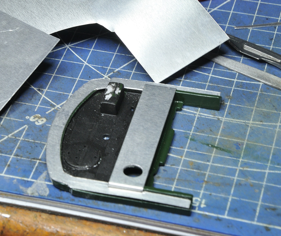

In reality there is another alloy frame round this on the back and the bulkhead is sandwiched so i cut another
The bonnet ( or hood as you call it) extends over the bulkhead and back to the fabric body so with the hood up you would see the drivers feet :)
So the rear of the bulkhead is now black with an aluminium frame like the front.
