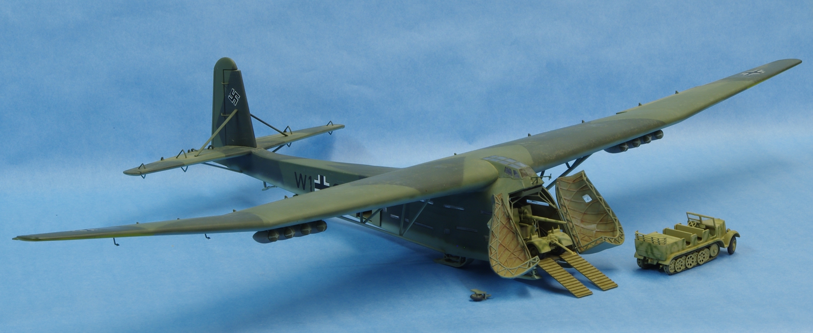

Hope you're thinking about the weight of this thing when you're thinning the walls. Maybe some brass riggers and stringers for strength?
Me 323 Gigant in 1/72 ( Rated R for resin)
Way ahead of you Bob. Isn't that heavy, and didn't thin them that much. It will be getting stuff added back in which will make a little difference, Fourty year old kit. Kinda crude and lumpy. Taking out the lumps. :pp

Did you have to use any kind of mold release agent when doing the rubber mold on the plastic pattern or when pouring the resin?
Great tutorial Paul! (y) (y)
No mold release is needed on the pattern stuff. It could possibly mess up the rubber setting up. As far as casting the part, a little mold release on the rubber can help a bit though onesey twosey stuff you probably don't need to bother. If using the acrylic sheet on top, it needs to be pretty much blemish free. A light smear of something a little oily will help the resin to release from it. Flexing the acrylic sheet pretty much popped the resin cast off of it.

Well!
This POS has been sitting on the shelf for a while. (Yeah you read it right, Piece Of Shhhtuff! :D )
The last entries here were almost 2 years ago. It has been on the shelf that long. In a way it has been a good thing too as I just found something that would have had me quite ticked if I had gone ahead and finished it. More on that later.
In the meantime I found that there was some more work done that had never been posted. Thus it is time to at least get the Piece of SHHHtuff caught up to where it was last left and then drop the bomb on what I just found.
Here we go!
More to come...
This will get it all caught up.
Just imagine finding this AFTER finishing this beast! :bang head :bang head :bang head :bang head
I would have been P****d! As it is, I have been giving the wing hot water treatments and changing the curve to the other direction (but only a bit) After a couple of days it begins to curve back down. The resin has shrunk and I am not sure it can be fixed.
As there is NO WAY I will build a second one of these the glider version (the Me-321) that I have is probably going to be a parts donor and go into the spare parts box. This section of wing will become green and I will "eventually" get around to finishing it.

That is a fight. Outstanding job on the fuselage. What are you going to do about the wing? Maybe there's an issue with Resin against Styren?

No no no, Italeri kits are hard enough without adding to the misery!! I barely survived mine out of the box, with all the little doodad parts and so many indefinite attach points. The plan is they are so big no one gets close enough to see the details!
